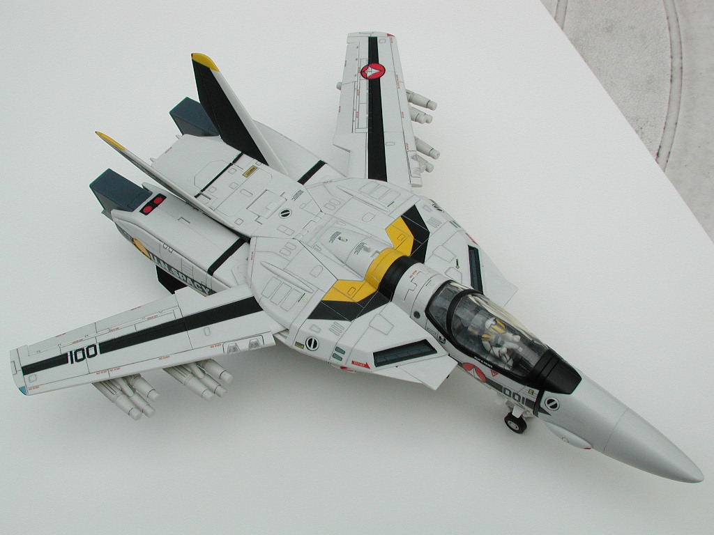

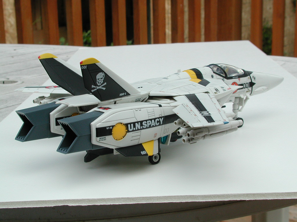

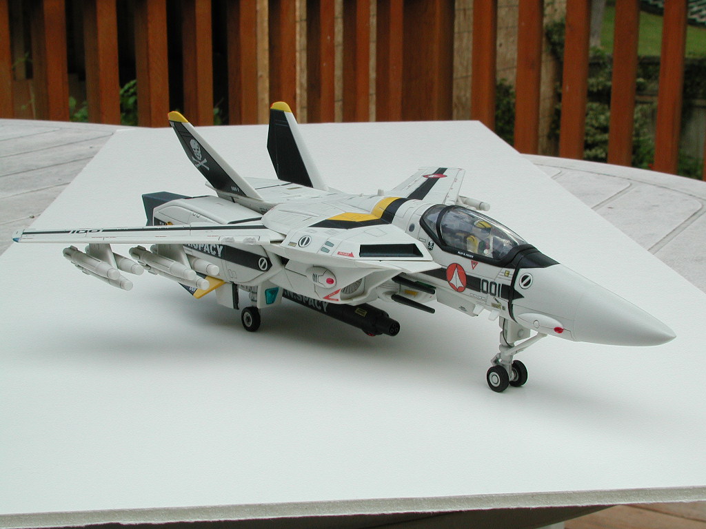

wm cheng Posted September 26, 2003 Author Posted September 26, 2003 With the gears down and the forward diagonal crack/seam as large as it gets - its not too bad with the decals in place. I applied the decals with the gears up, so the seam closes up, then I let it dry and sliced it with a sharp x-acto knife before I extended the gears again. You'll notice that there is a whitish blob in the front gear door where the light is. I painted it silver and what you see here is a blob of Microscale Krystal Keeler drying - its essentially white glue that dries exeptionally clear that will form a lens over the silver painted light.

wm cheng Posted September 26, 2003 Author Posted September 26, 2003 Here's a shot above showing the light grey artist oil wash in the panel lines. Hey Graham - if you are reading this, I have a wishlist comment for Yamato - or a real challenge to customizers on this board. I wish Yamato would consider opening up the top chestplate intakes - I don't need it to be very deep, just like the Hasegawas would be fine with a little filler piece in behind. I considered cutting one out (and may still) but the plastic is pretty thick, hard and brittle. For something this scale 1/48 and all the thought that has been put into it - it seems a shame now that we have this flat closed intake right on top where you see all the time.
wm cheng Posted September 26, 2003 Author Posted September 26, 2003 Oh I keep forgetting to answer this question, the decals are not pre-cut nor the decal carrier film pre-cut to follow the contours of the designs. The entire sheet is one large decal film - and you have to cut each thing out individually (and trim as close to the designs as possible). I found the white stuff like the pilots names and skull harder to do since its printed on a white background paper too - but if you look carefully enough with a bright light and patience its managable. Don't any one get scared off with waterslide decals - this stuff is much easier than a model - its pretty forgiving. Hey ZorClone, as long as you didn't clear coat over it, I think it should still work. I would dab a lot over the decal and let it sit for a while - just let it evapourate on its own. I might do this a few times, and you could help it by pressing down on the edges when its semi-dry. Of course it works best when its wet, but it doesn't hurt to try - and apply and let dry several times. Post some pictures of your bird too - I'd like to see. A few people have asked me to do this customizing. Well basically, I don't normally do this for anyone else, its kind of a passion of mine. However since I am not working at the moment and I do have some free time (and need cash ), but its not cheap. Basically it takes two full days or so of full time work to get one of these babies up to par - the decals alone took 6 straight hours of work without breaks! Plus you need time to let the oil washes and clear coats dry - mask the canopy. Most people wouldn't/couldn't afford it, so its a labour of love - and I would recommend anyone to try it themselves - its most rewarding. That being said, if I were to do it, I would just charge my time (luckily when I do work I have a great rate, minus a substaintial bonus since I do love this stuff), probabily in the neighbourhood of $300usd or $500cdn + shipping (Valk and decals naturally not included). A props house would proabably charge twice that. Ah, if I don't get real work soon - I might do it for a new VF-1A Max with fast packs Anyways please enjoy - its really not as hard as you guys make it seem - its just time. And what better way of spending time than with Macross!!
