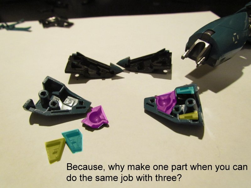

Took the legs apart as far as I could before I hit an impasse of superglue. I can take pics of the parts and put them up, but basically the name of the game with the 171 is "how many tiny little superfluous parts can I throw in here to make the design as complex as possible to assemble?"
It's not enough that they have pieces sandwiched between other pieces, and screwed together.. they have pieces, sandwiched between inserts, then pressed into a larger structure before being stuck between layers of plastic, and screwed/glued together.. Maybe it's a way to relieve stress on some of the parts? I have no idea, but the pieces just flew everywhere, and they're ridiculously tiny. I'm probably going to save myself the trouble of fixing the dumb thing, and redesign the knee joint from scratch.

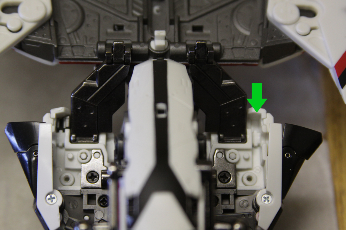

Hmm. I'm starting to hate this thing.
During transformation from F to B, tiny pieces fell off.
Has anyone also had the 'pleasure'?
I need to know where the frakkers go back on.
If I remember right, anime52k8 posted a picture a while back showing where those pieces go.

Found the pic in anime52k8's flickr gallery:
Ok, I'm curious. I haven't experienced any problems yet on my Alto's 171Ex. But what this tiny things do? If ever that falls off and in case you lost it, would it fail to transform it back or something? From the looks of the plastic, is this some kind of locking tabs?
Anyways, thanks in advance. ^_^

See, this is the kind of thing that baffles the hell out of me with the 171 design...
WHY did they need to make all those tiny pieces? Are they so incompetent at designing things to fit together that they need to make dozens of spacer pieces to fill the gaps left after assembly?
The internal structure is exactly the same way... it's never just two parts that fit together.. it's a part that gets padded with two smaller pieces before being inserted into a slot that was just designed too wide. Why?!

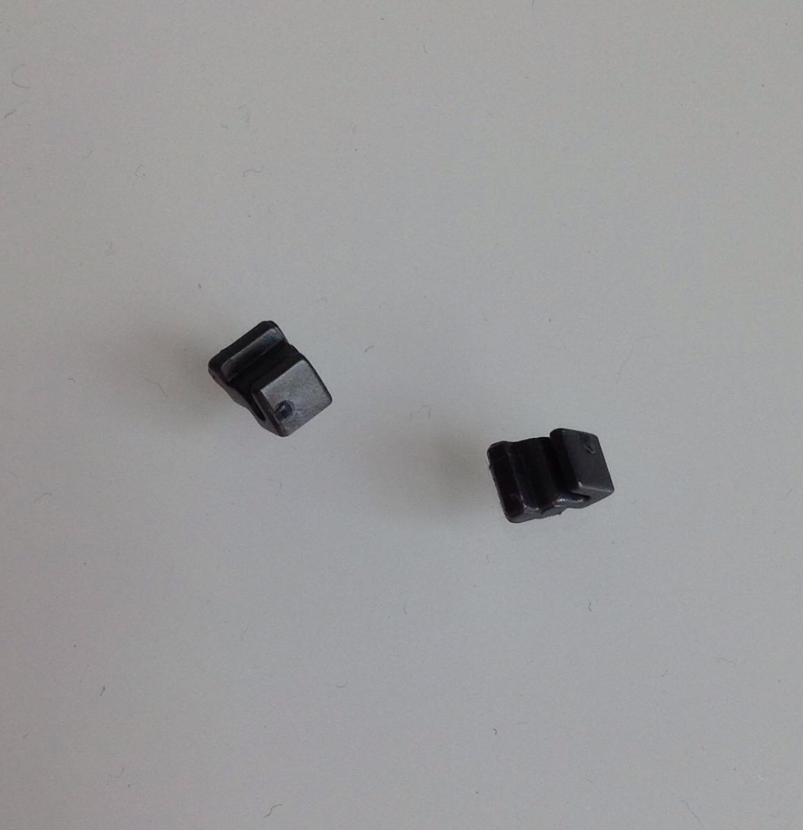

They'e meant to help lock the metal swing bars in place. Really, they seem to do nothing at all, as far as I can tell. I keep fiddling with mine, trying to see what preventative measures I can take to repair/reconstruct/prevent further damage, but it's all uphill. Black NUNs triangle starting to fail, although I've reinforced it with a whole bunch of glue. On the upside, it's survived my transforming it several several times now, all issues aside, so there's that. I hope somebody can fabricate some sort of replacement for these soon, though.
They're awfully small parts, but I wonder if they can be recast in resin to be a little stronger... c|:

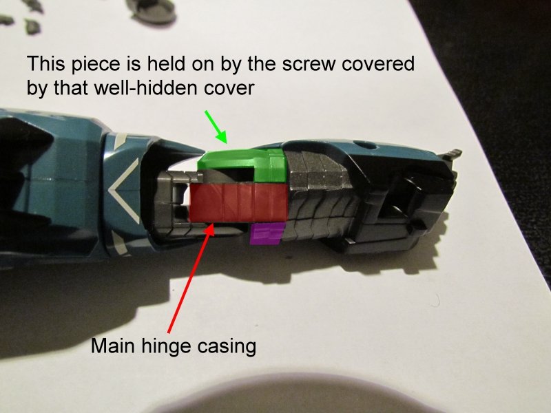

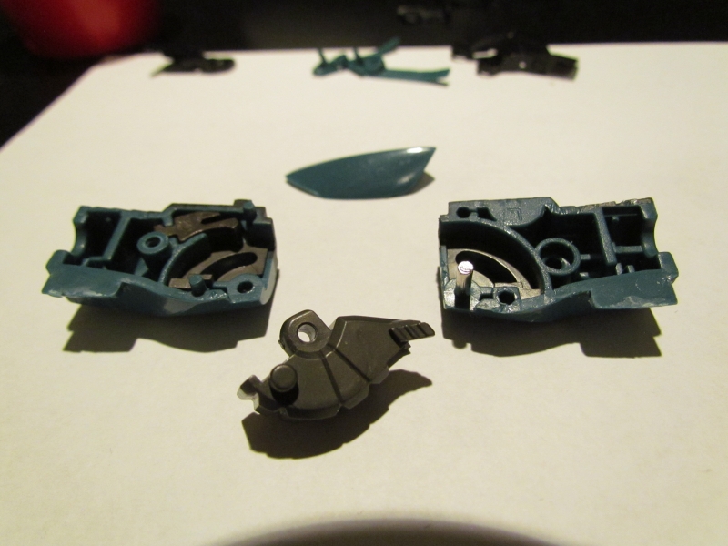

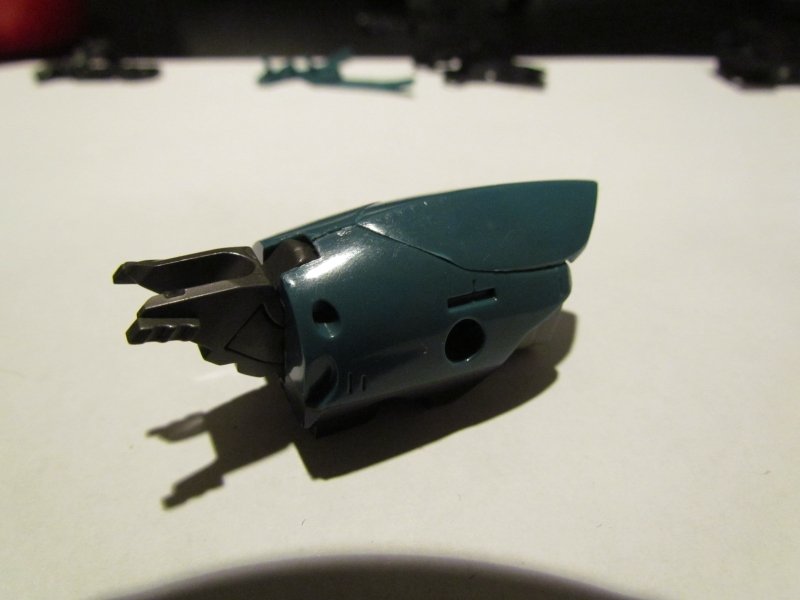

So, this is Part I of a two part series about how the VF-171 CF can completely explode from looking at it funny.
This is basically a photo diary of my adventures disassembling a shattered knee joint.
Before I get to the knee, here's what happens when you unscrew the hips. They come apart fairly easily, but as you can see, there's a ton of pieces that might fall out and go everywhere. For some reason, they felt the need to pad the lower half of the hip joint with extra plastic pads, instead of molding it to fit directly into the metal thigh. Could be for structural reasons, I guess, but it's a lot of little pieces to do a simple job (Bandai seems to take that as a trademark).
So, to start, here's how the leg looks when it's working fine.
Here's a second view, with a slightly rotated thigh swivel, and color coded parts.
This is the thigh section from my broken leg, still in decent shape, minus the pry marks from trying to get the darn thing apart.
Here's what you see once you get it apart (minus the swivel joint, I'll get to that in a minute).

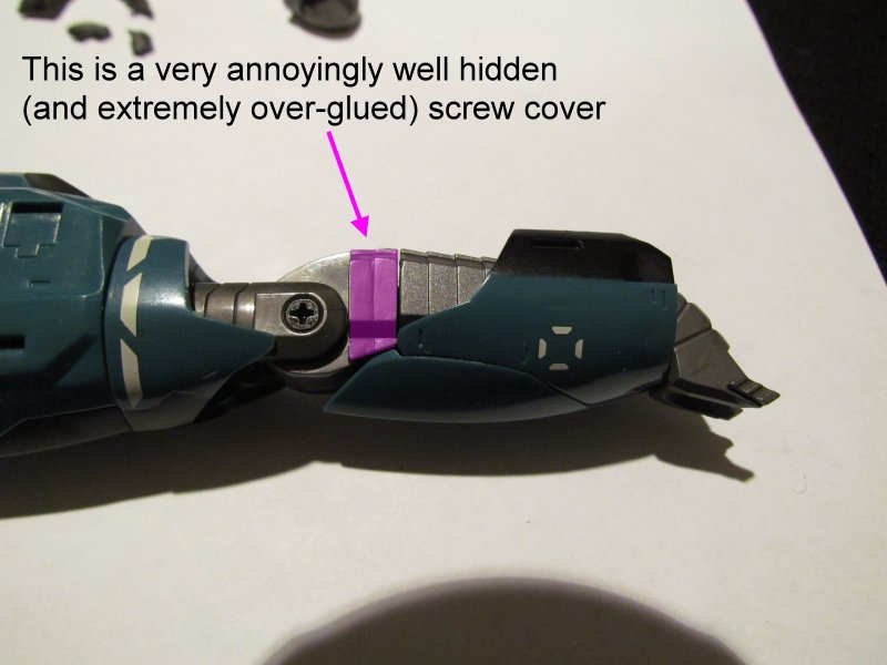

Here, you've got a cover with far too much glue on it, holding together two large tabs. Get that cover off, and the thigh comes apart with a single screw, and you can access the upper thigh joint and hinge pin.

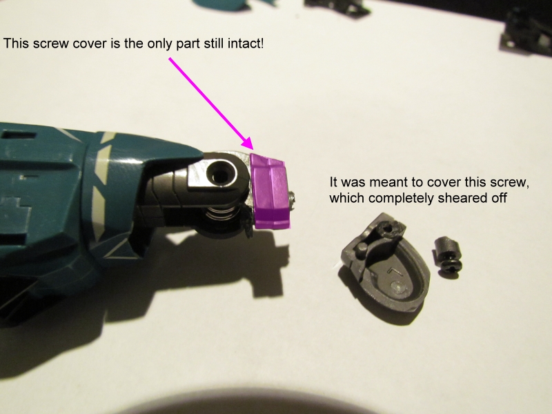

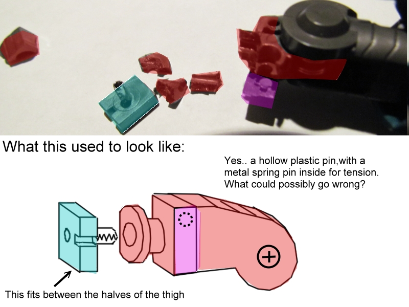

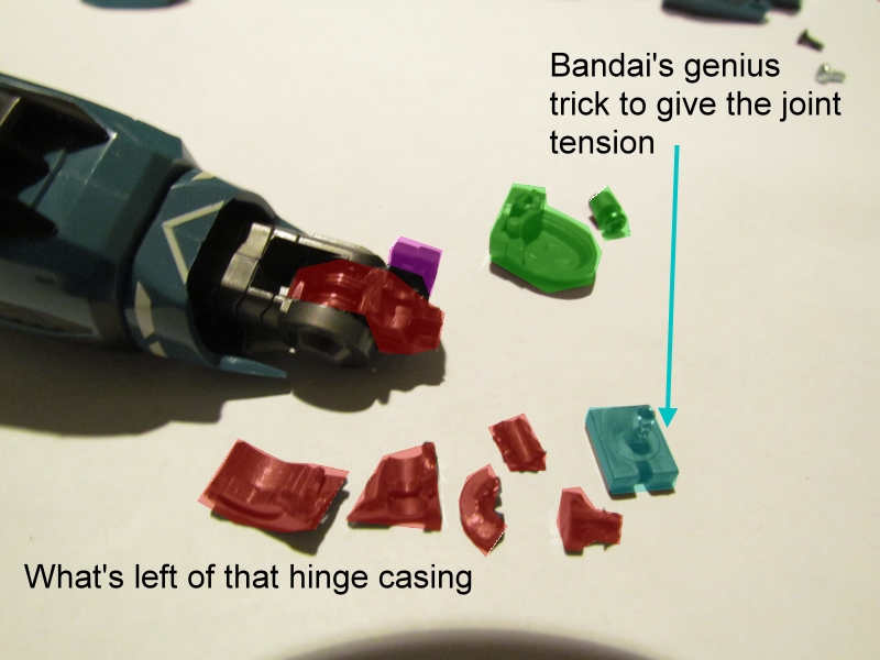

Here's what happened to mine.
I've color coded the parts so you can get an idea of how badly it actually broke. The side cover for the knee had the screw shaft shear off, and the red pieces all used to be the large central knee joint cover. Now, it's broken entirely, and you can see the spring ratchet inside the knee.
That pink screw cover is also a pain in the backside. It was overglued horribly, and was literally the only thing holding the entire knee together.
Now, why did it fail? Good question. I'd go ask Bandai what they were smoking designing this.
So yeah. I seriously doubt there is any hope for this leg at this point, unless I superglue the entire thing permanently into fighter mode (not sounding like a bad option, considering my hate for the 171 transformation).
Part II will be later this weekend. I've taken the shoulder covers and lower triangles off of two 171CFs to compare, and think I know why they break, but that's a long way from learning to fix them.

It probably wouldn't be hard to do, I just need to do a search to find the older posts and pics. Think I've taken at least one of each major type of valk I own apart to some extent, except for any VF-25/29, VF-11, or the new YF/VF-19. VF-1s are by far the most friendly to disassemble, with old VF-0s being close behind.
Anyhow, after mixing and matching parts between my two 171CFs, I was able to come out with one solid one. Makes me glad I ordered 2 RVF-171s :lol:
As far as causes though, that varies. The knee problem above is clearly a materials thing, possibly related to that metallic plastic. The plastic sheared off with obsidian-like edges, right along the flow lines in the plastic. I need to find some way to get the lower leg apart to fix it properly, but the darn thing is screwed and glued together like Fort Knox.
The shoulder triangles though..both the upper and lower halves of the NUNS pieces... after seeing how they break I'm convinced Bandai just hired hamfisted gorillas for their assembly line. The pieces are fragile, but not overly so. The problem looks like a combination of overtightening the screws that hold the pieces together (the cracks on my broken ones all originate from the screw) and the assembly monkies just being prone to jamming the shoulder triangles over the top of the metal shoulder joints with all the finesse of a 400 lb linebacker.
If that screw is too tight, there's no room for the NUNS pieces to flex to fit around the shoulder nubs. Due to the structure of those parts, overtightening the screw will visibly deform those pieces, pinching them in the middle, because of the way they're built almost hollow to leave room for the outer flap. So, jamming them over the shoulders is just stressing them further, by spreading them along an already stressed direction. If the people building them had the sense to tighten the screws in the triangles after slipping them over the metal shoulder blocks, this probably would be a non-issue.
