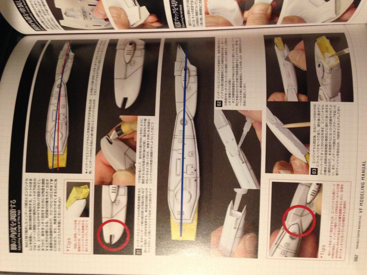

The SoftBank VF Modeling Manual shows this mod, too. But your thread is in English ^_^ .

Does it really? I was looking all over the place for tips on what I should do and after failing to find anything, figured I needed to think outside the box and come up with something on my own. I'll have to look into that modelling manual - I recall seeing it a few years back and thought it was a very nice thing to have for builds in the future.

That looks like pretty much what I did. I don't know what they used to fill in the old notch but I'm glad I'm not the only one who considered the leg alignment to be a bit of an eyesore.
