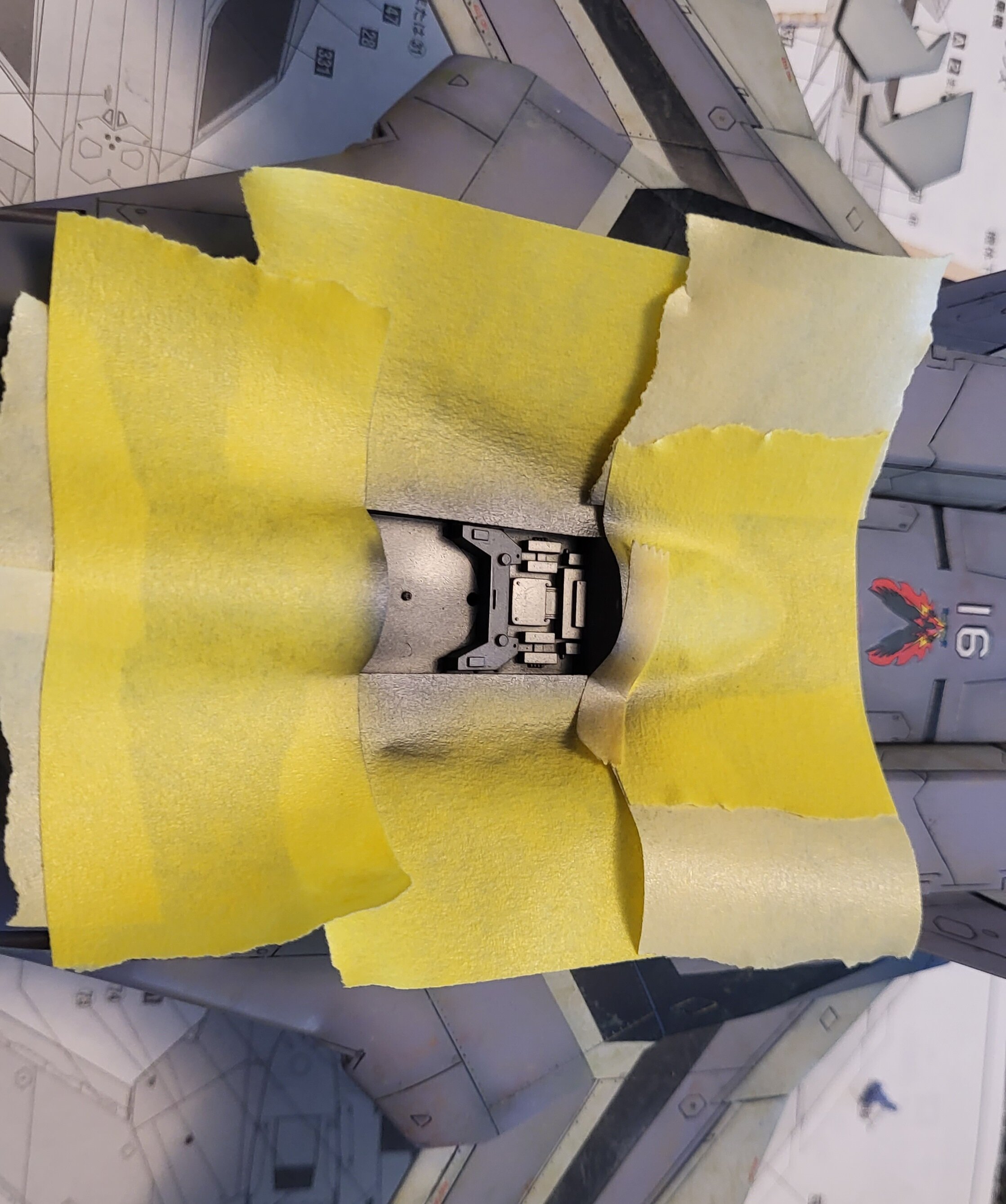

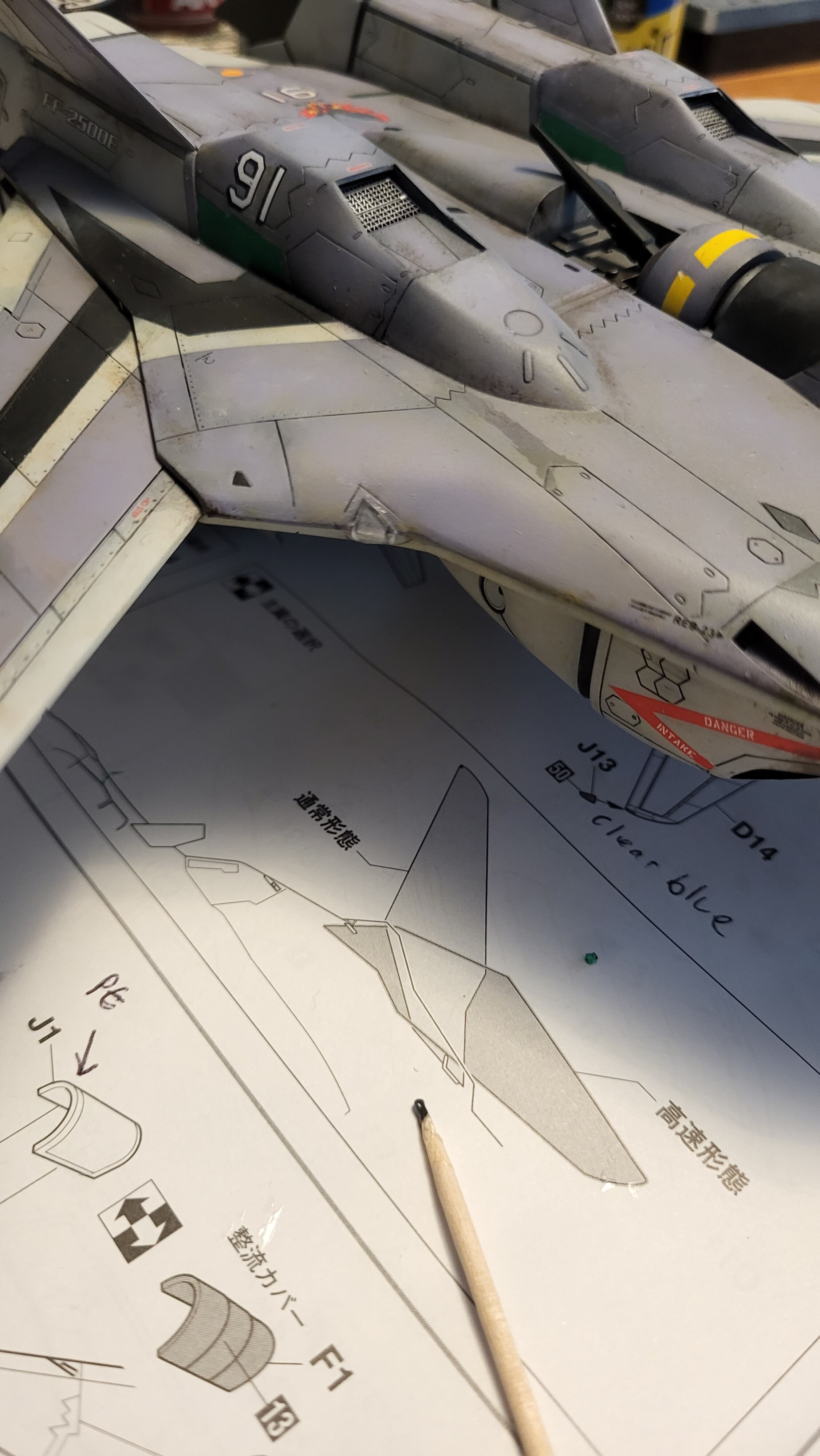

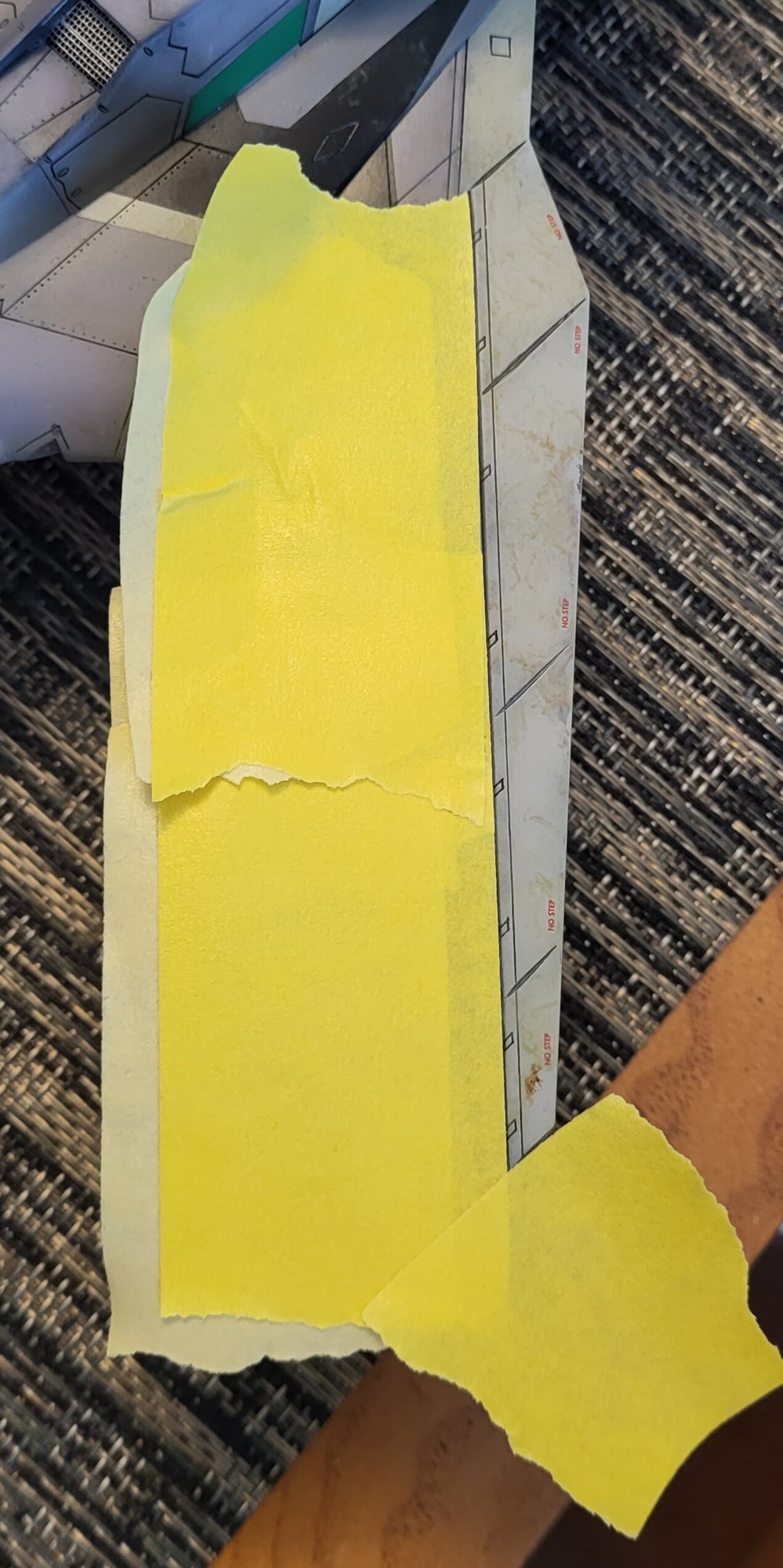

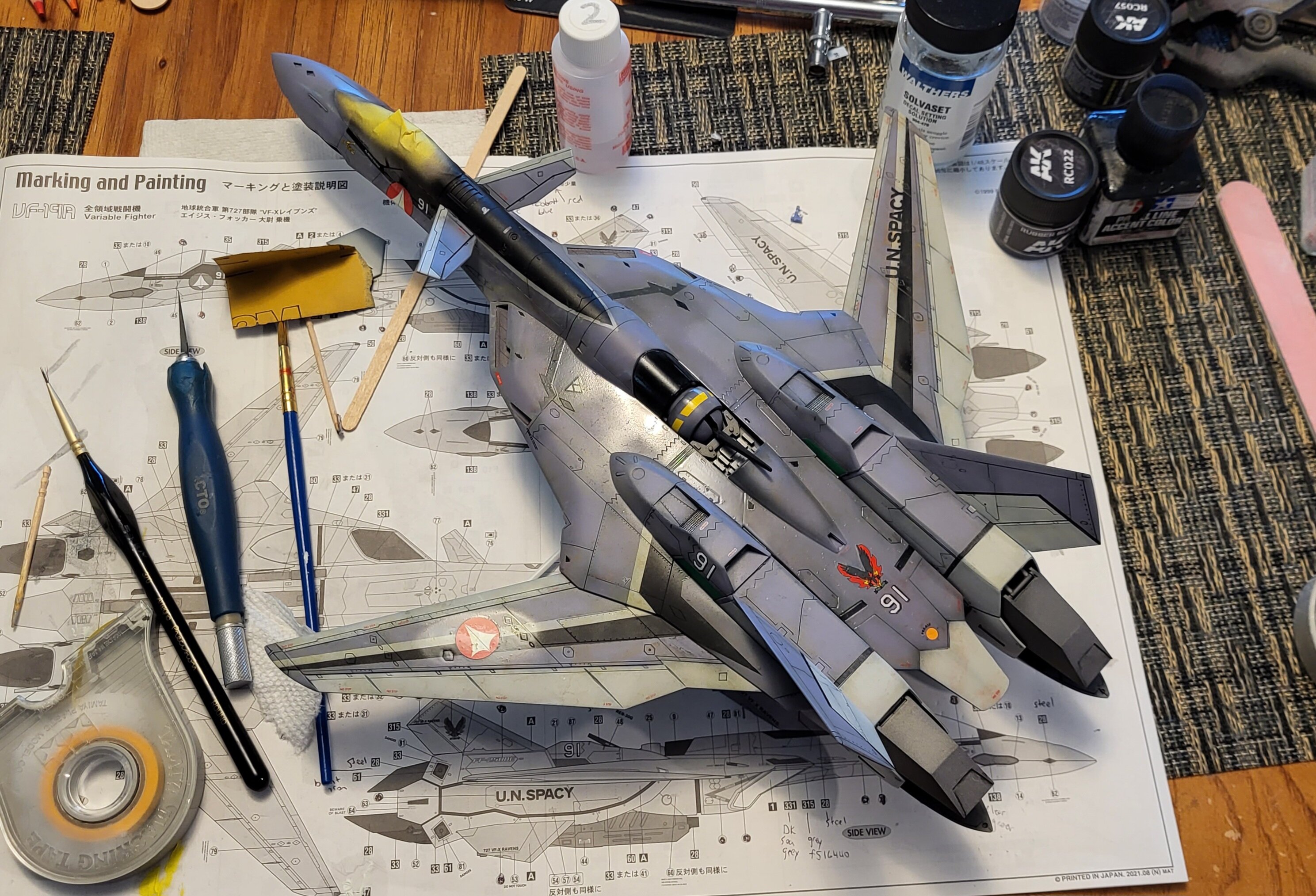

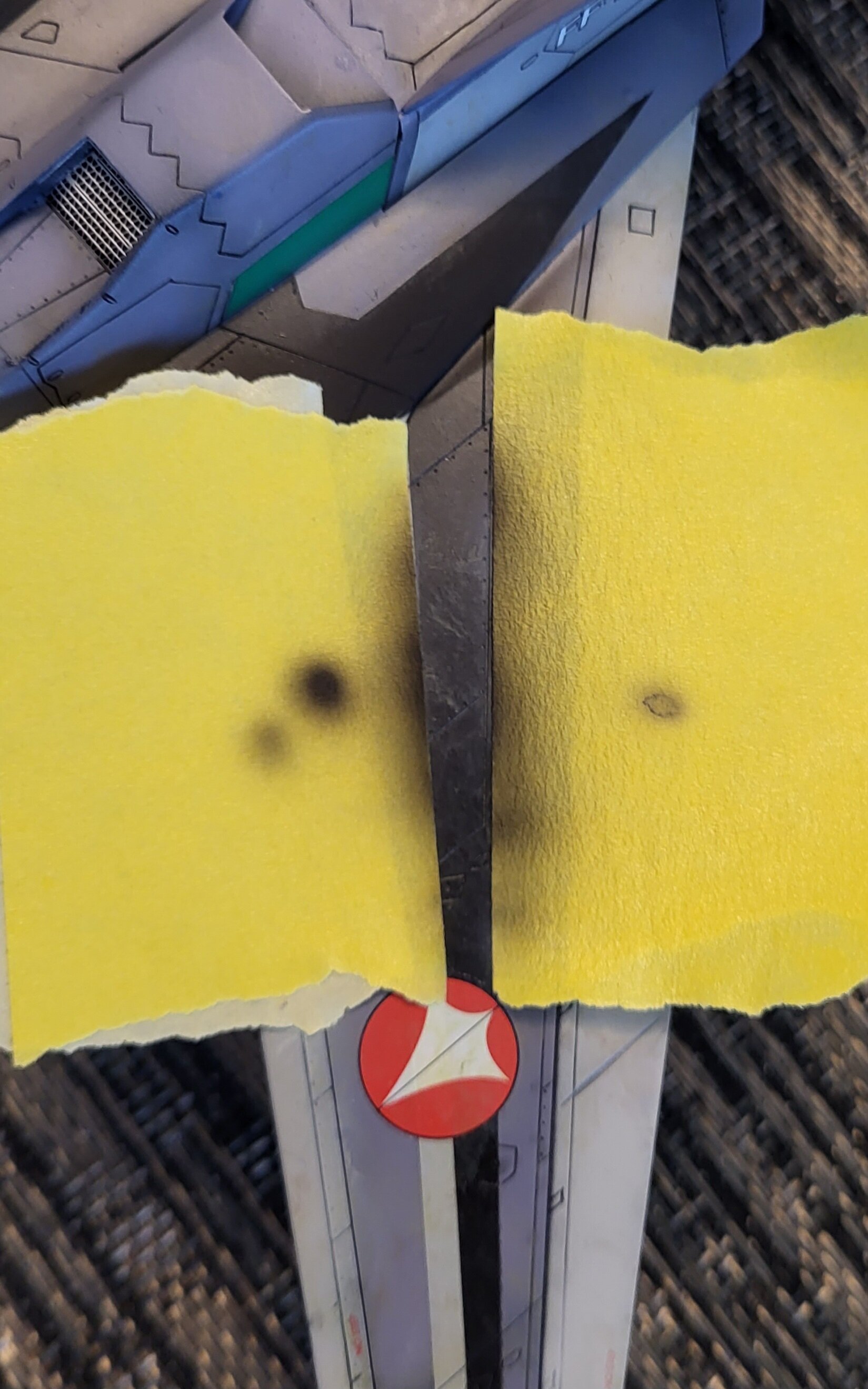

Getting touch ups done. Quick masking and sone over thined colors are being freehanded onto the surface to further tone down my oil work. I'm fairly happy with the result. Also painting in a few areas such as black diamonds all over the body and the inner detail around the head (2nd time now.)
Sadly, decals for this kit continue to plague me. They just keep shredding, some while being dipped in water. At this point it is probably 1 out of every 3 applied ends up being spliced back together. 🙃 However, the top is done! I'm going to steal some other kit's caution markings for the underside going forward.

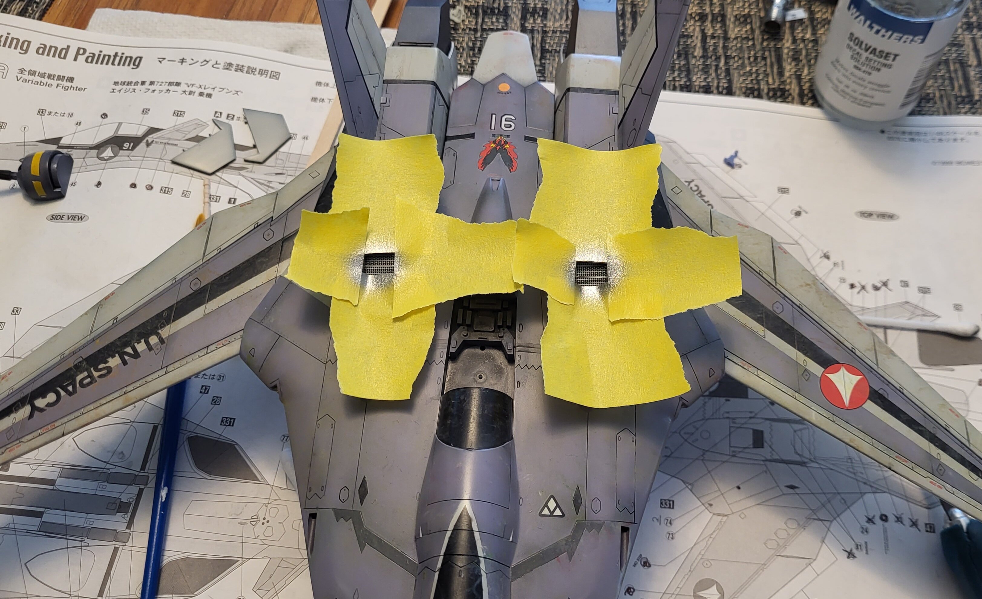

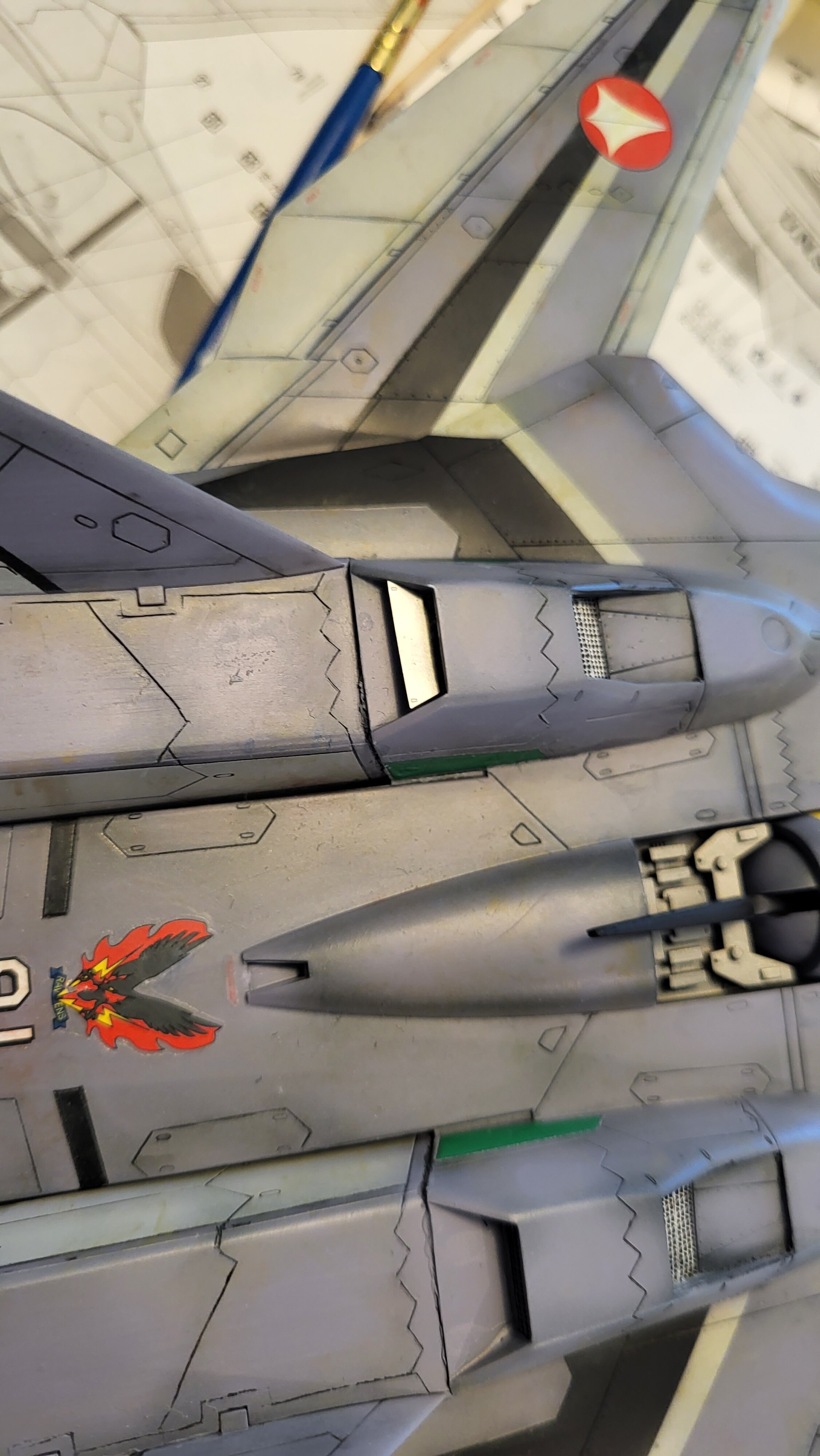

The PE became a nightmare. I didn't apply the fins because I wanted to paint them, and the mesh different tones. This was a huge mistake as they fit super tight during my initial fitment and not at all after paint. After breaking the grilles off a few times and trying to save them, I'm throwing in the towel here. I may just glue some plastic plate in or leave it as is. Maybe... just say it is different than the YF-19's design. So, afterwards I painted the remaining mesh with some aluminum. Lol
With all that done. The topside was hit with some matte topcoat. Next time we will unmask the canopy and 1/2 the bird will be done!

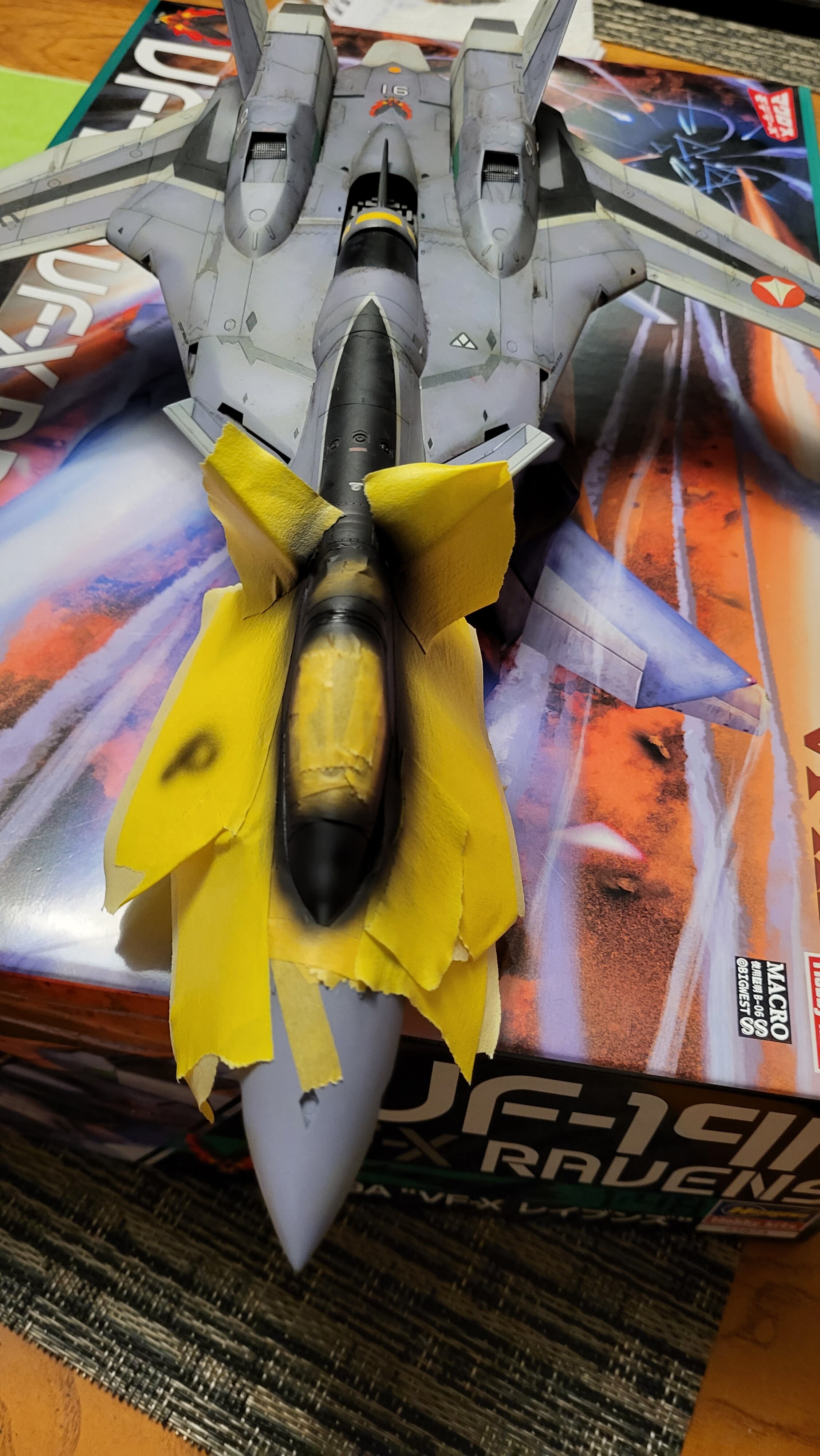

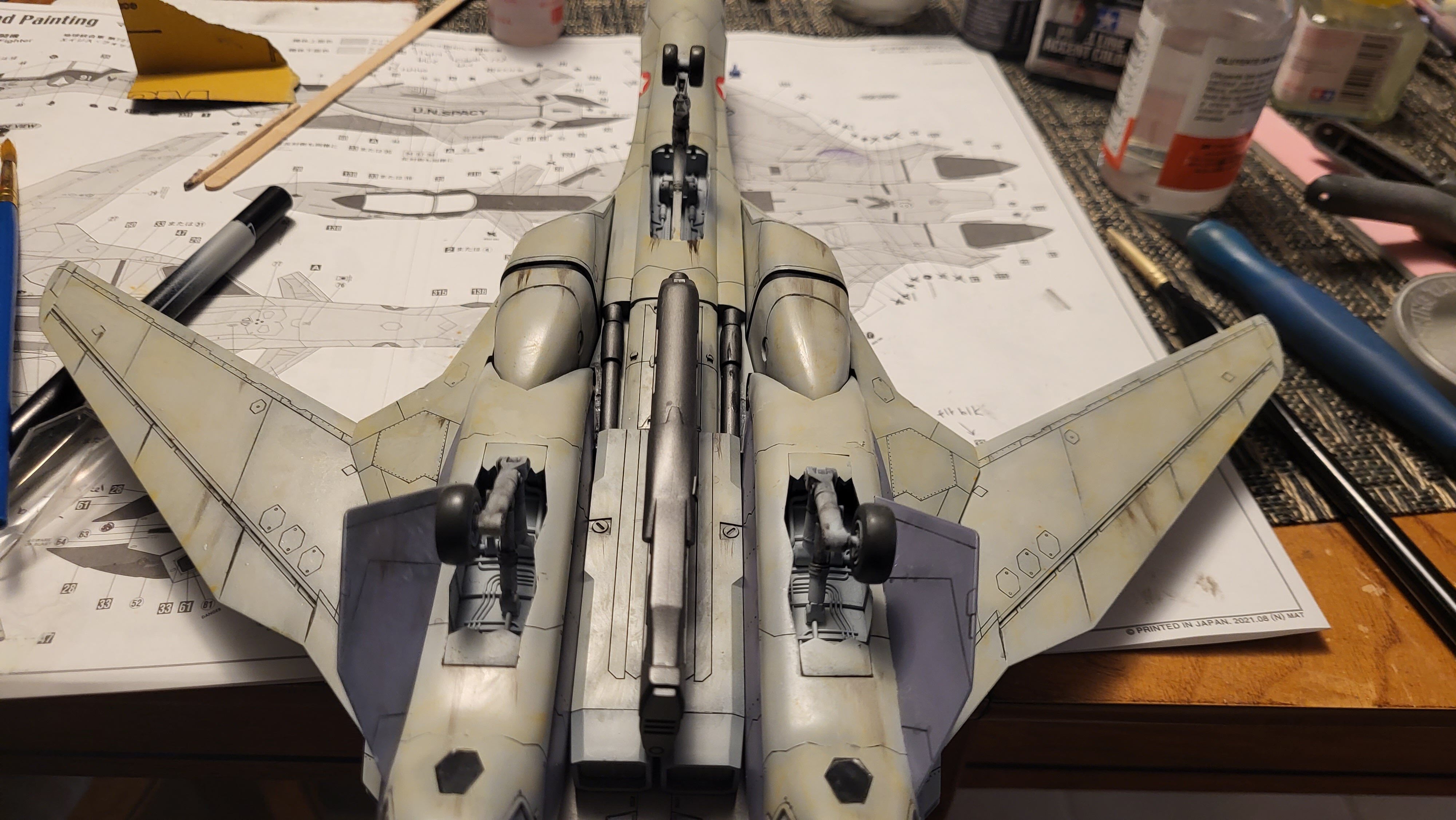

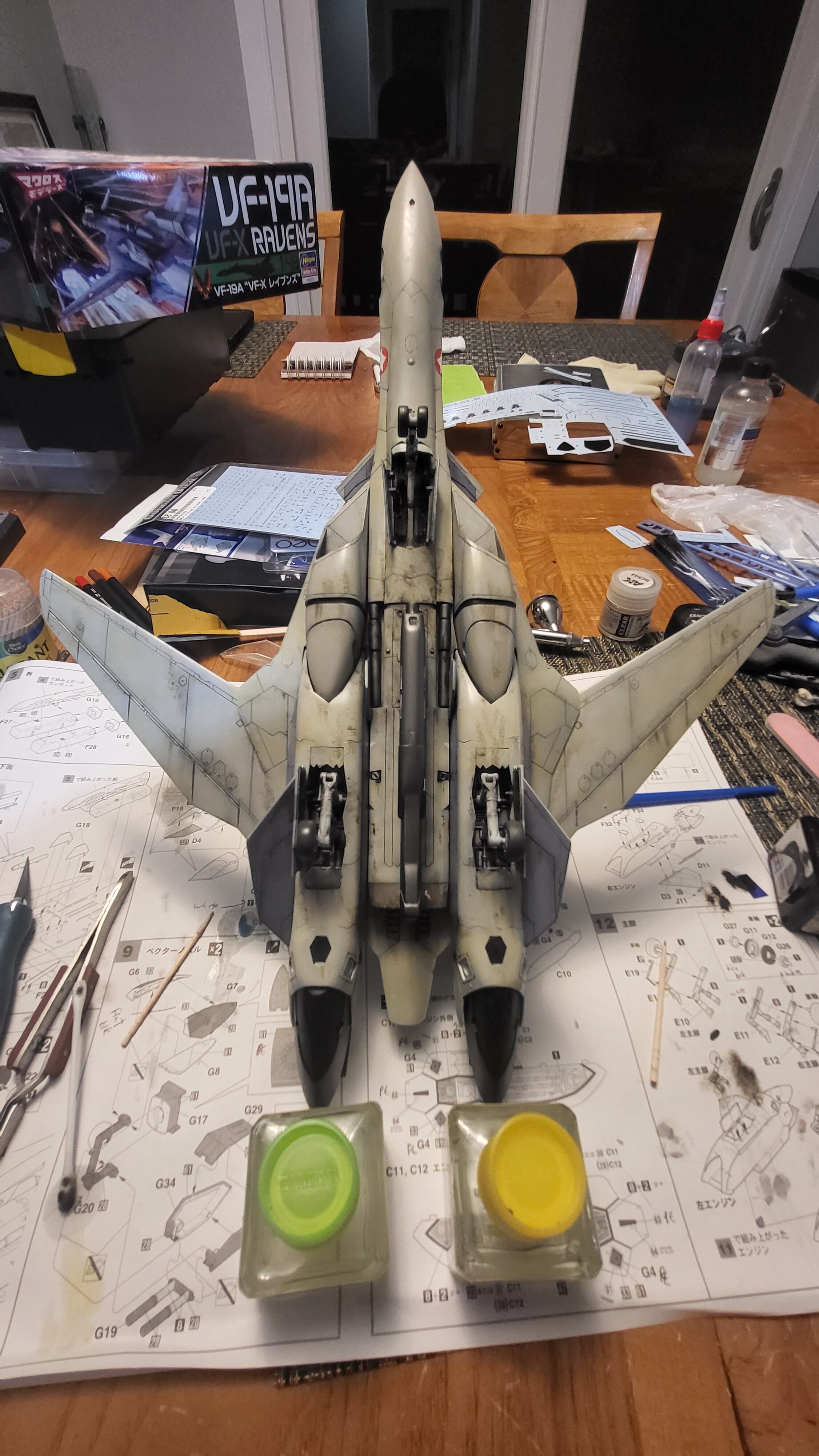

Started off with an oil dot filter of white with just a bit of earthy brown this time. Maybe 1 drip of yellow orchs made its way in (and took over) but, who can tell. Lol

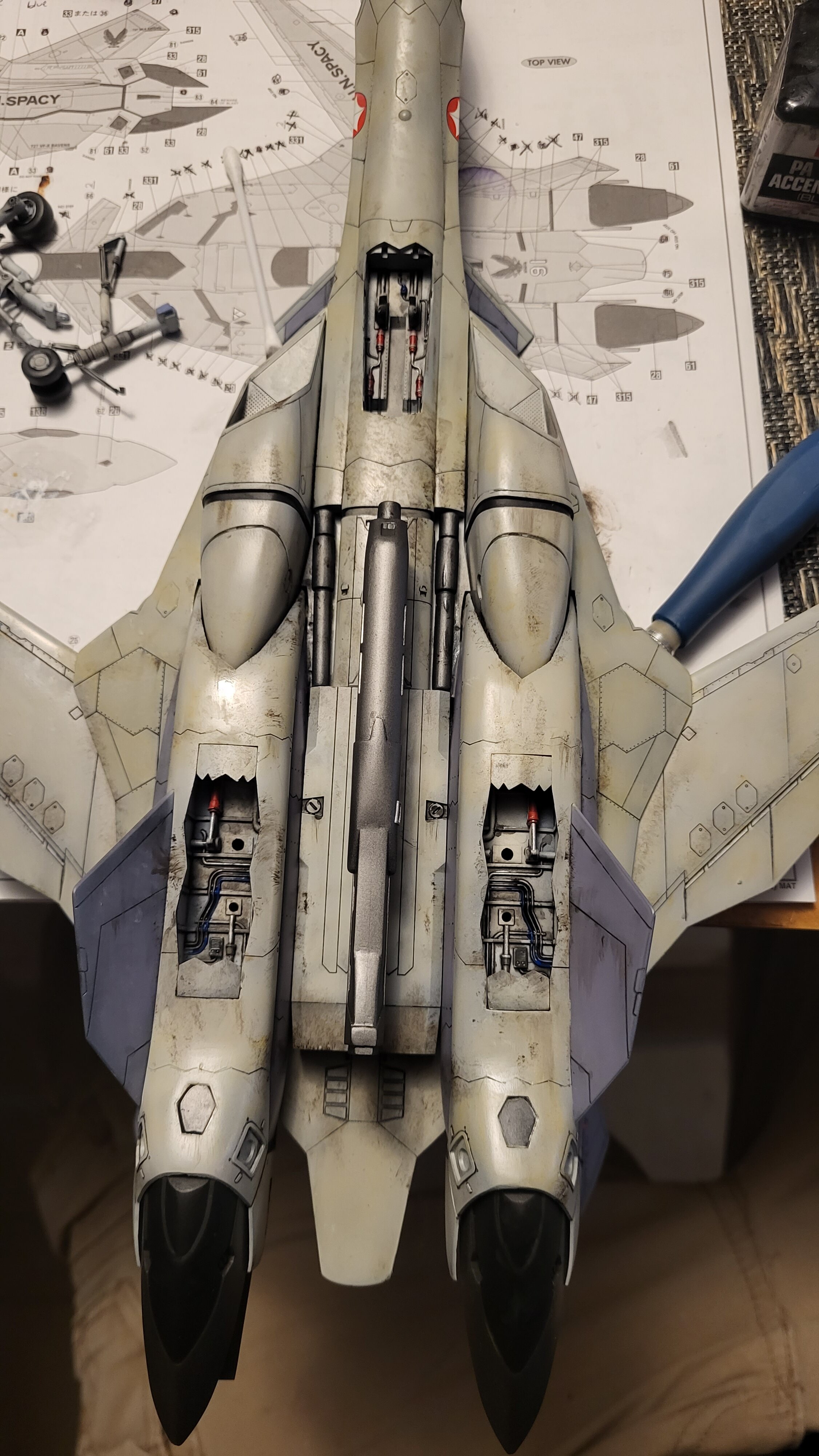

A bit of black liner was used to create some random oilsteaks... before I realized I needed to stop playing it safe. Bottom needs to wear! Oils l, spirits and stabbing the plane a few hundred times oughta do it!
A youch of grime and a bit of spot detail painting was throw into the landing bays to make it interesting and then the doors were washed and installed. I dare think that the bottom is assembeled minus the nose gear's headlamp amd decals (sigh.)

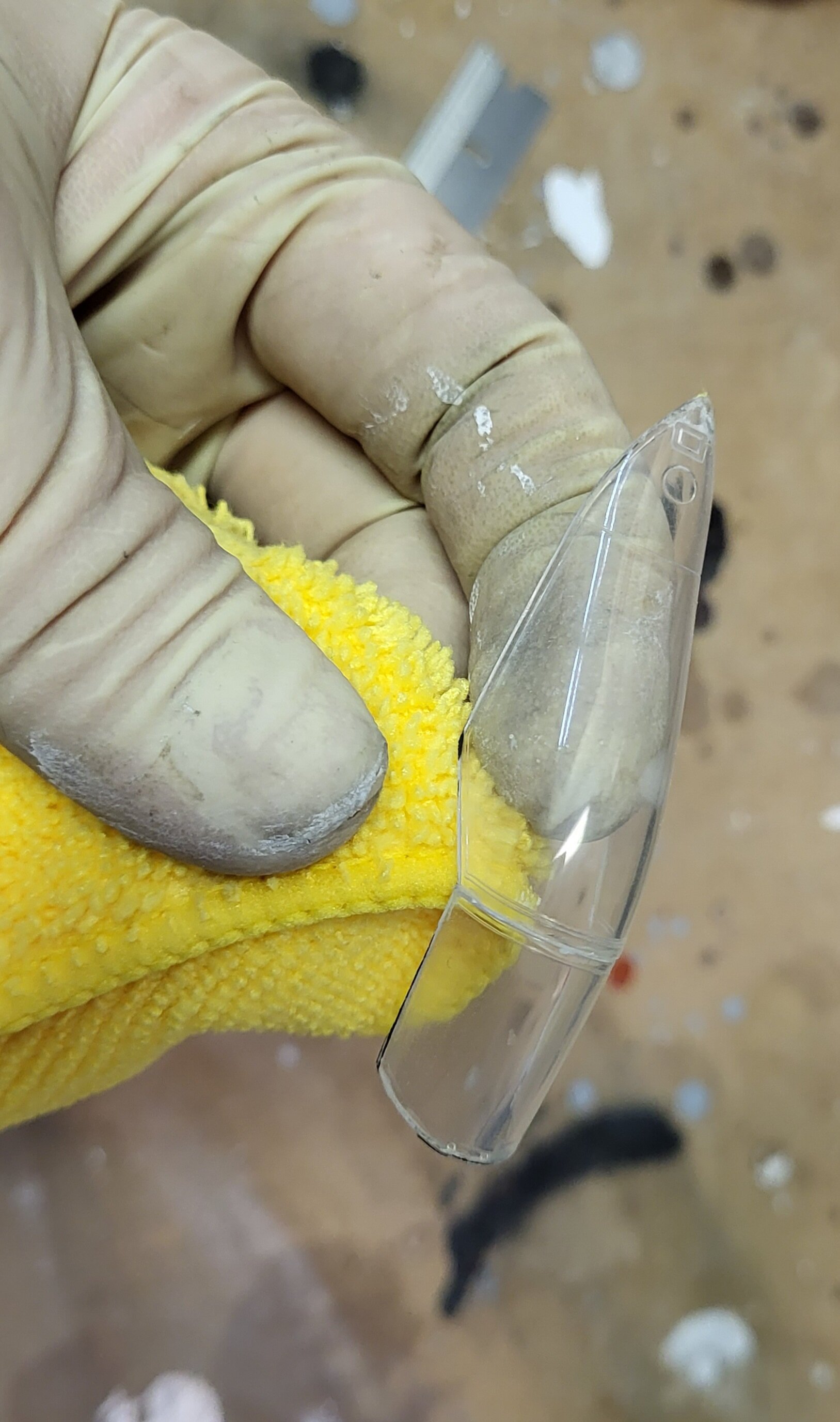

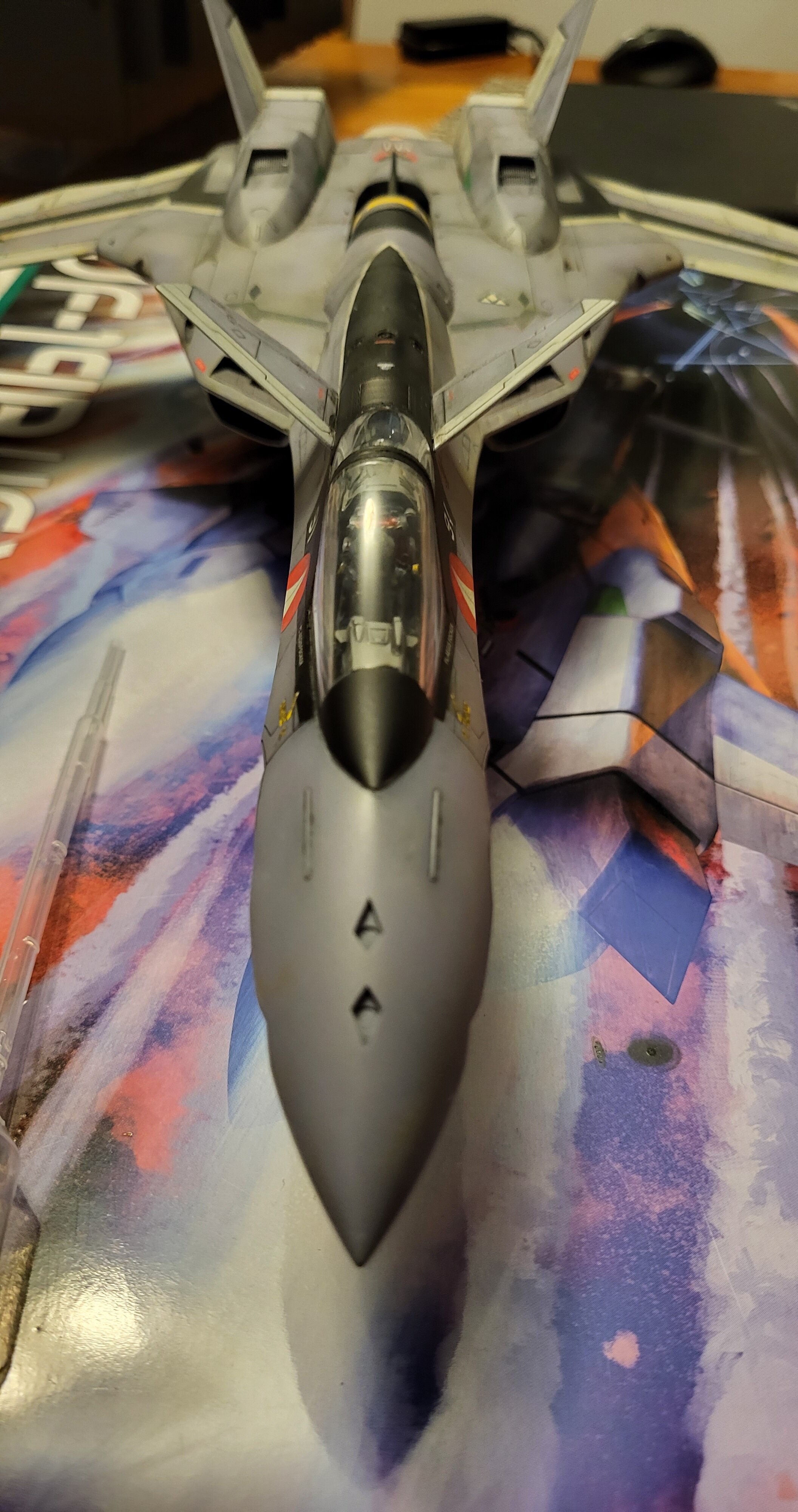

Canopy back under focus. I was suprised MIG ammo Ultra glue held the 2 clear parts together during revoval the finishing process! Anyways a quick sand with 3000 and 5000g sandpapers followed up by some compund, ultra fine polish and a glaze.
All buffed painstaking by hand using a 2-sided micro fiber towel. With the cockout/pilot work done, it had to be crystal clear to show it off.

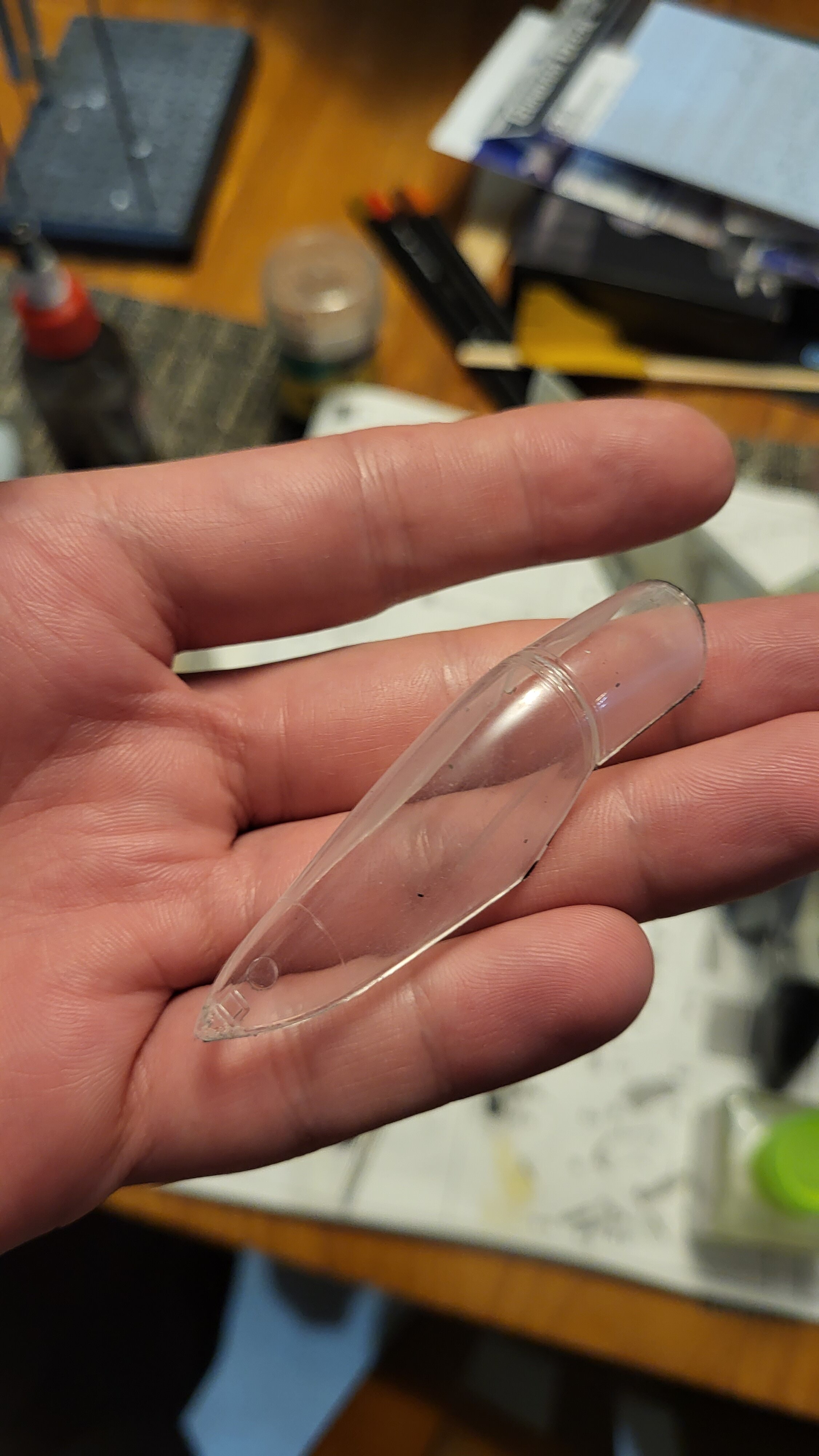

Next up a mask and quick sand over the exposed areas. The part was the sprayed with some black Mr. Surfacer 1500, and then sea gray mixed with some left over mix used from the cockpit's interior. I however did not like to look contrasting the anti gkar around the canopy.  a bit of Tamiya x1 to the rescue. Evrything sealed with Alcladd matte clear before being revealed...

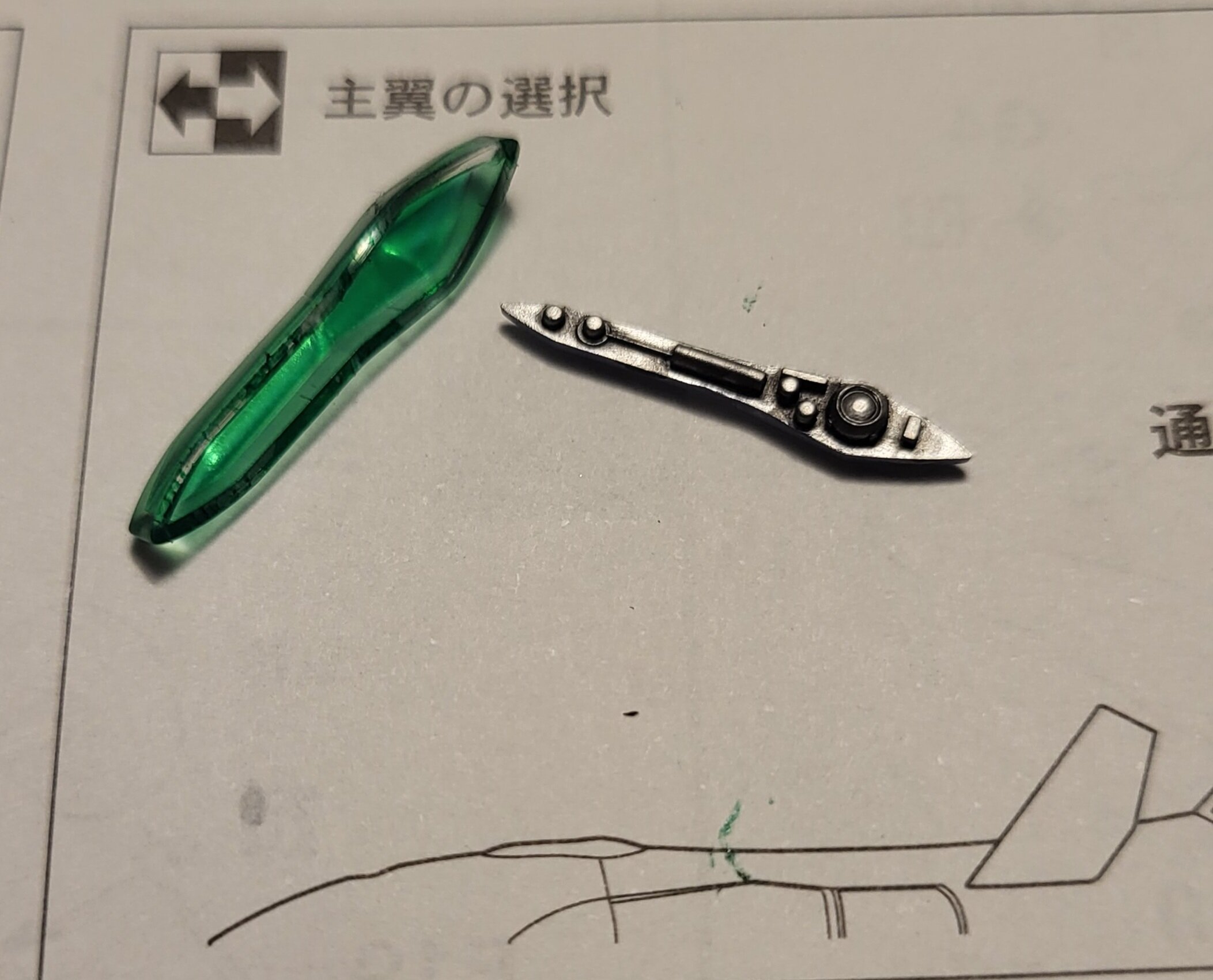

Anyways, thr clear parts. AK Aliminum, black wash followed by Tamiya clear geen and Testors Silver on the backside of the lenses.
I should have done the lens on the body sooner, so I could have done a better job making them flusher with the body. A bit of Ultra Glue to secure them.

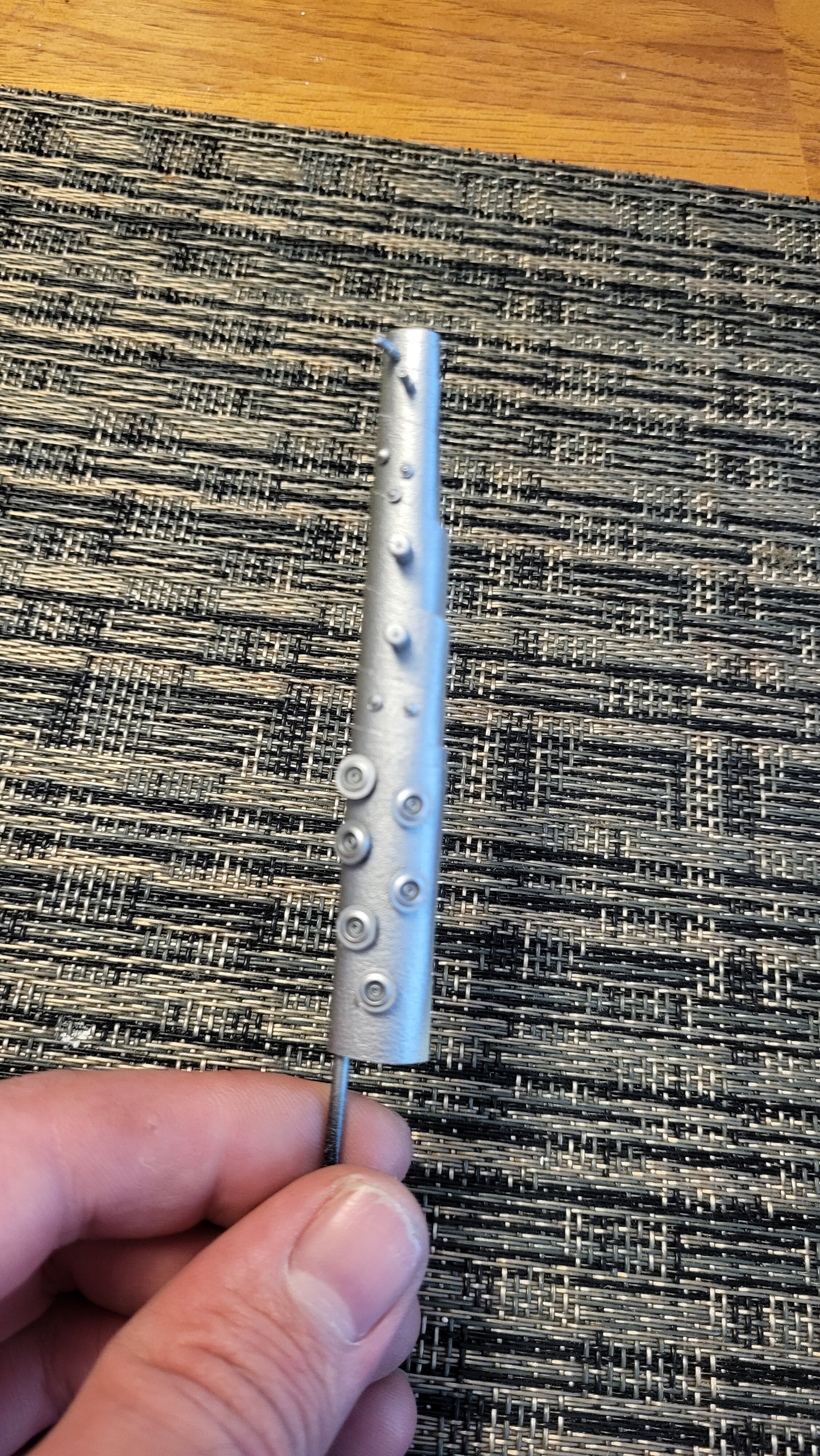

The last batch of metallic bits, nozels, and gun barrels painted. Gloss black and polished aluminum for the base. I wanted a bit of contrast with the flat paints without them being too stand-off-ish.

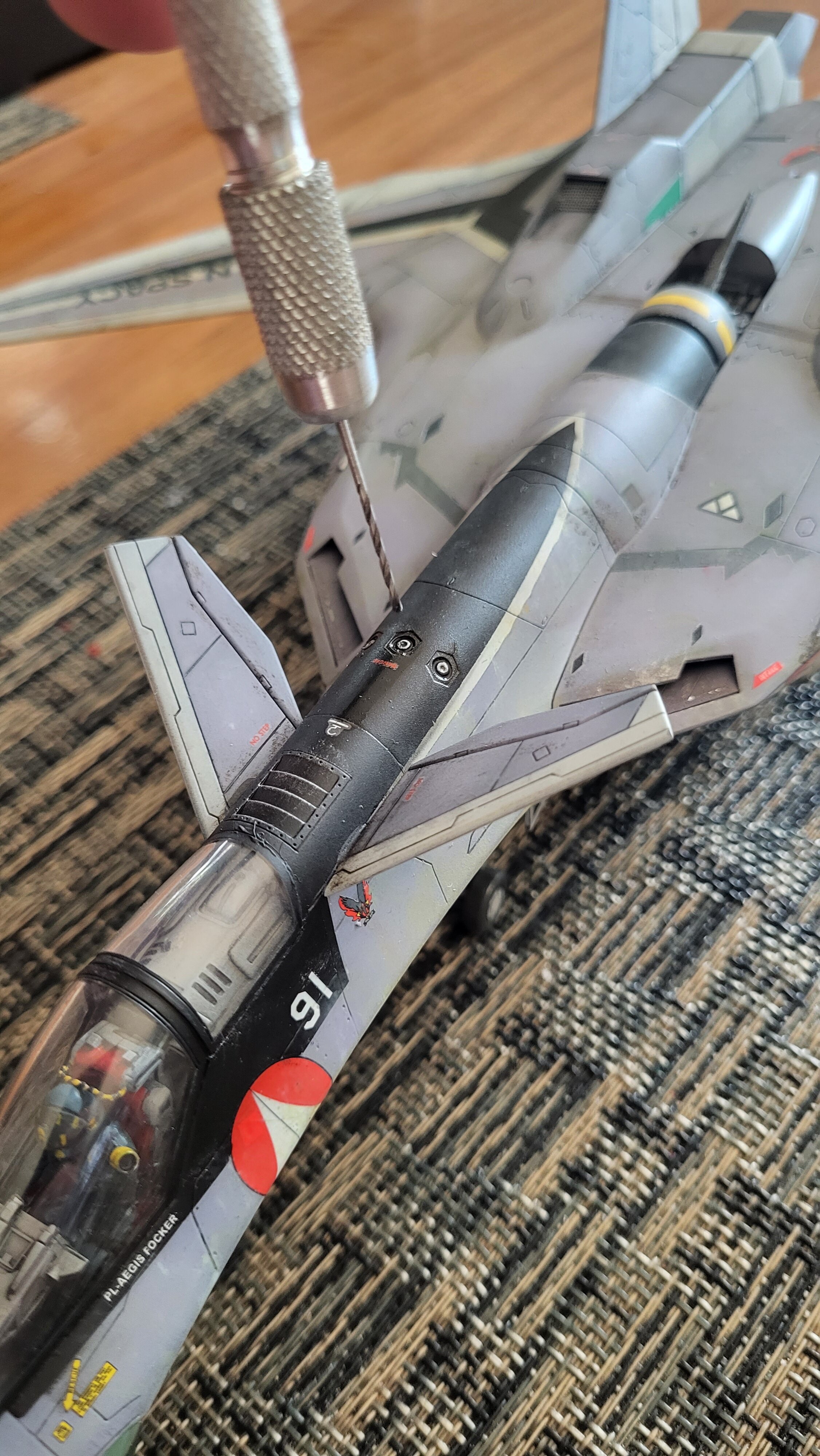

A bit of accent handpainting all over. Here, I highlighted the 3 details behind the canopy with some aluminum, a wash and then used a 1/64" pen vice drill to deepen the center nozel details.bit of chipping and dry brushing followed.

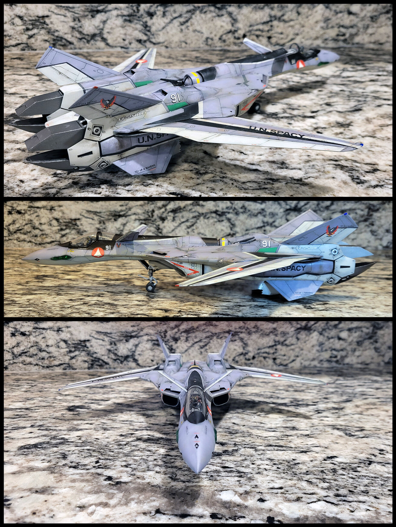

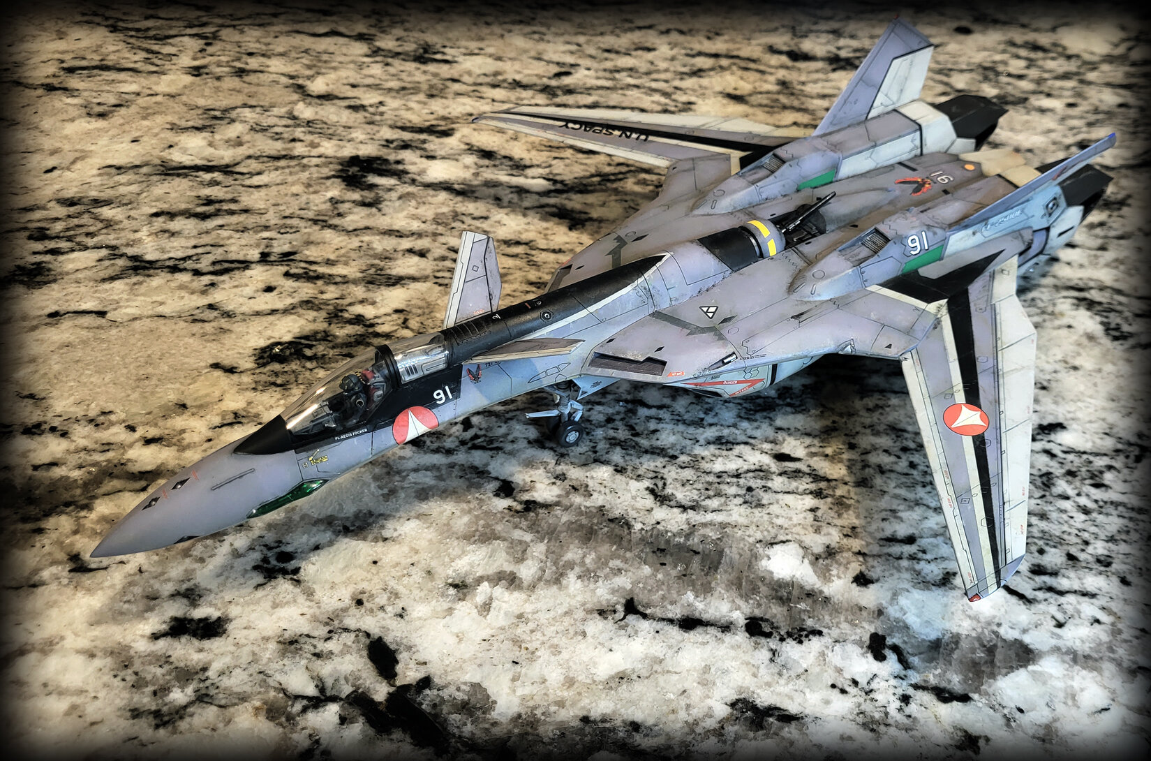

At this point the final caution markings applied, the marker lights painted and a matte clear was finalized. A bit of touchup, panel line correction and contrasting gloss on the lights/lenses and she will be ready to sortie!

On 10/5/2023 at 10:36 AM, Thom said:
How did I miss these completed shots?! Truly, a great looking plane with an awesome paint job!
Same here; truly nice piece of work there @Rock
