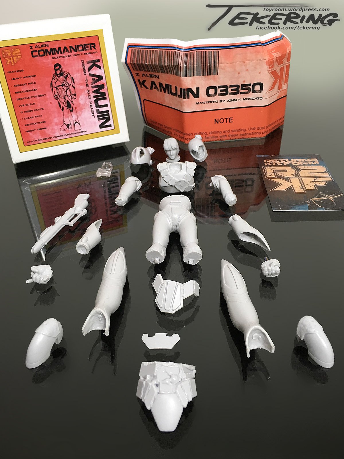

The second is another Moscato Hobby kit, "Z Alien Commander Kamujin."  This one I'll be making into an action figure, with articulated joints.

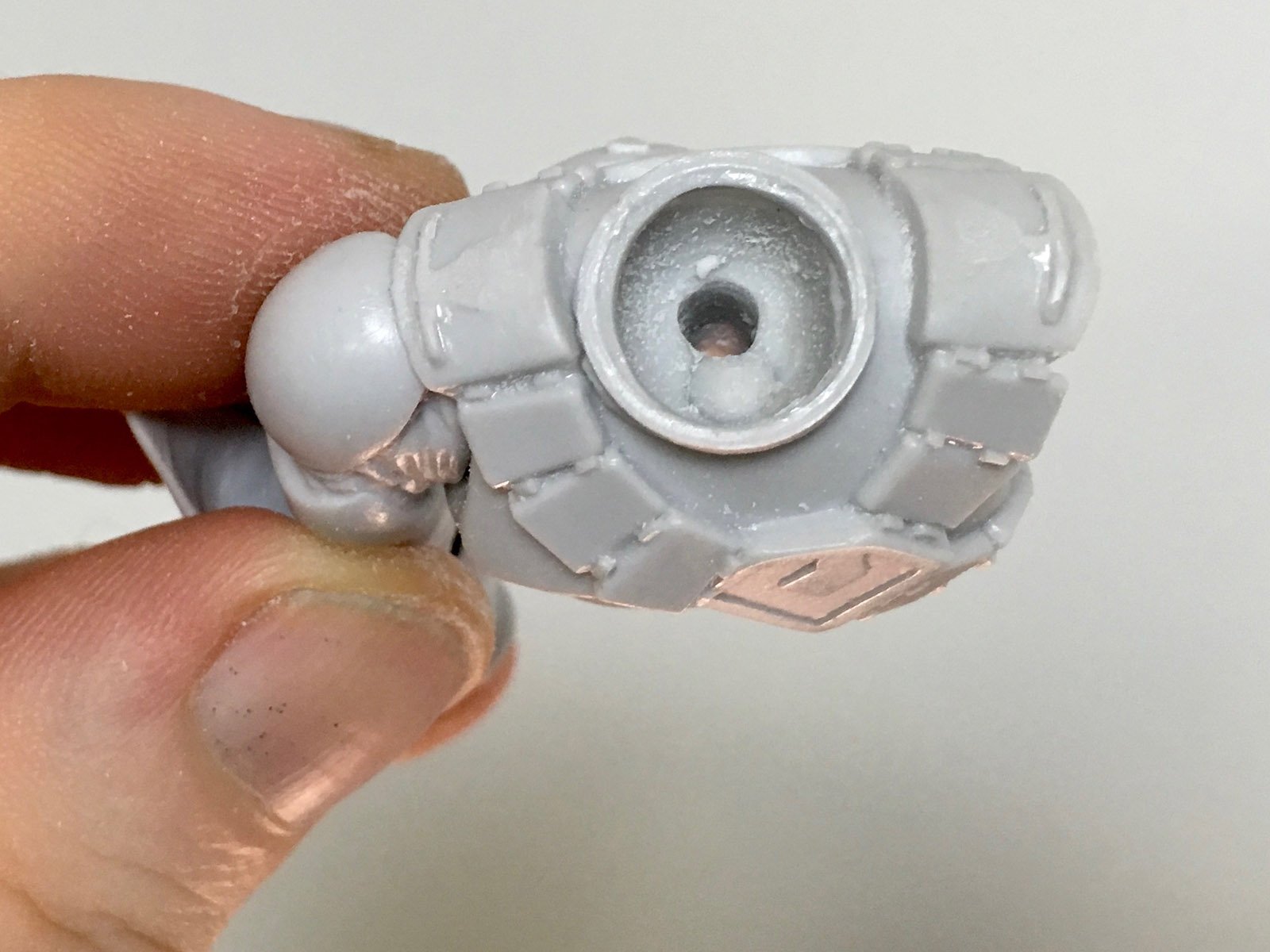

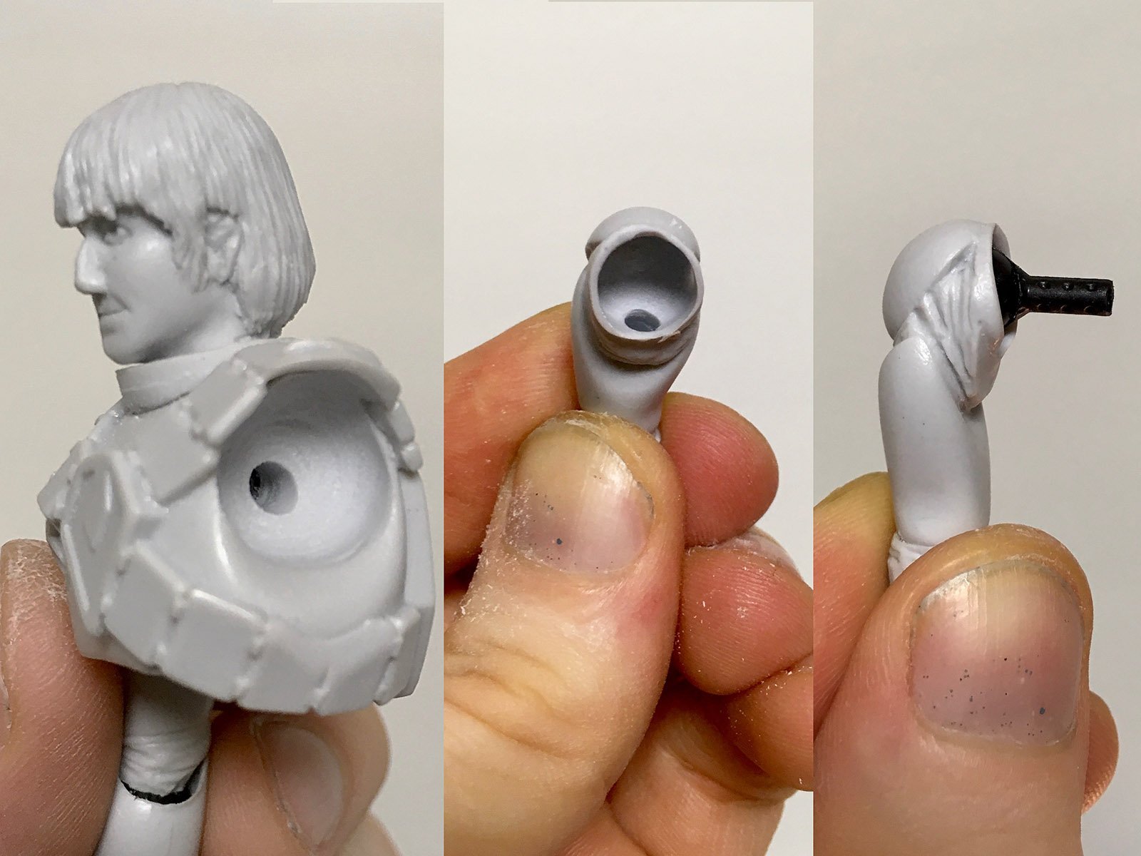

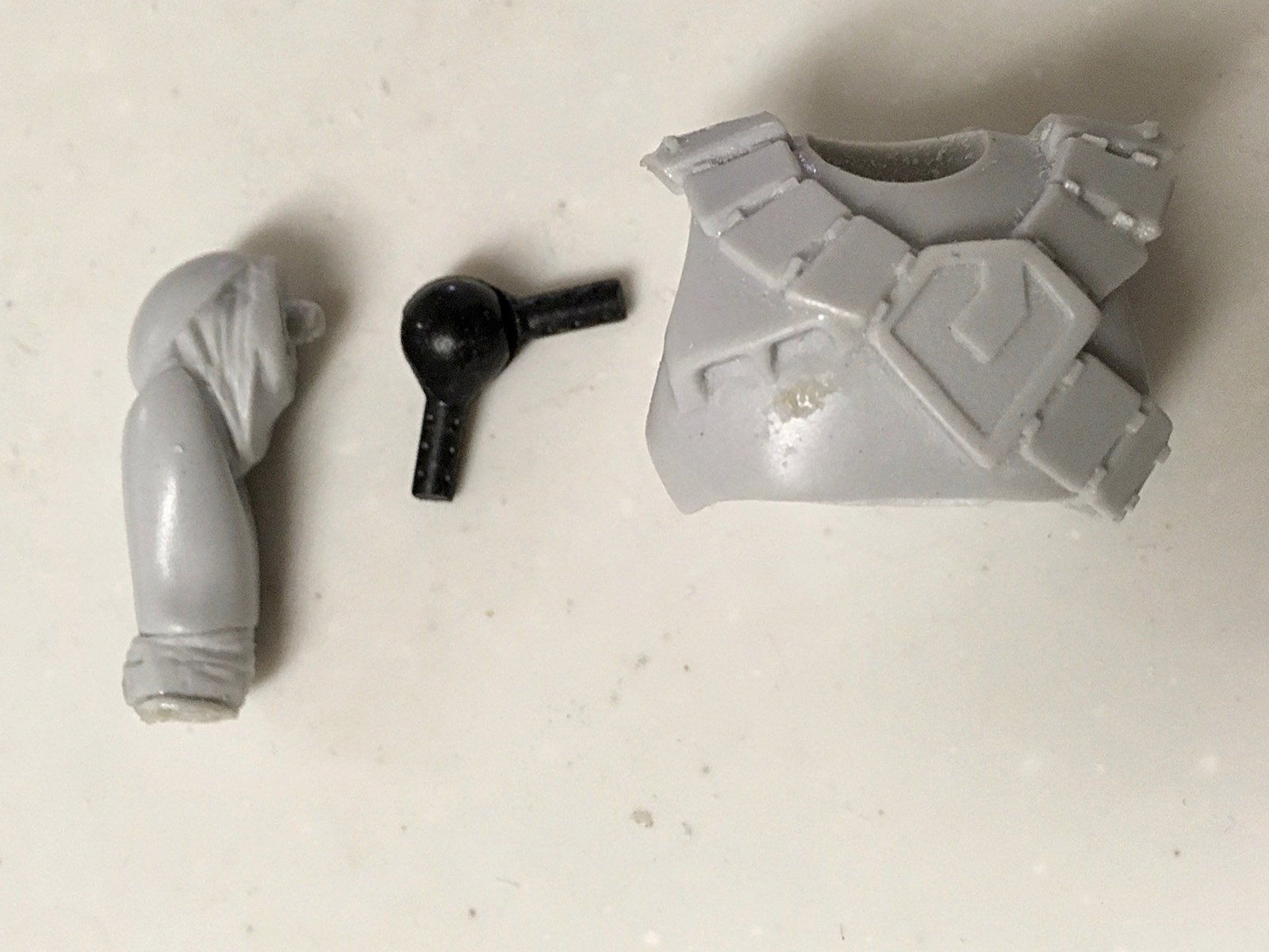

First, I decided where to install the Revoltech ball-joints; I figured they'd be needed in the shoulders, the elbows, the knees, and the neck as well.
It's not enough to just drill holes for the pegs; you've gotta hollow out sockets for those ball-joints to fit into.
If you've done a decent job, the joints should not be visible at all:
...at least, not unless you want Quamzin making grand, theatrical gestures.  :p
I then drilled similar sockets into the elbows, the gauntlets, the thighs, the legs, the neck, and the torso.
It's messy work, and resin dust gets everywhere.  I recommend a mask and goggles for this sort of thing, especially when using power tools.

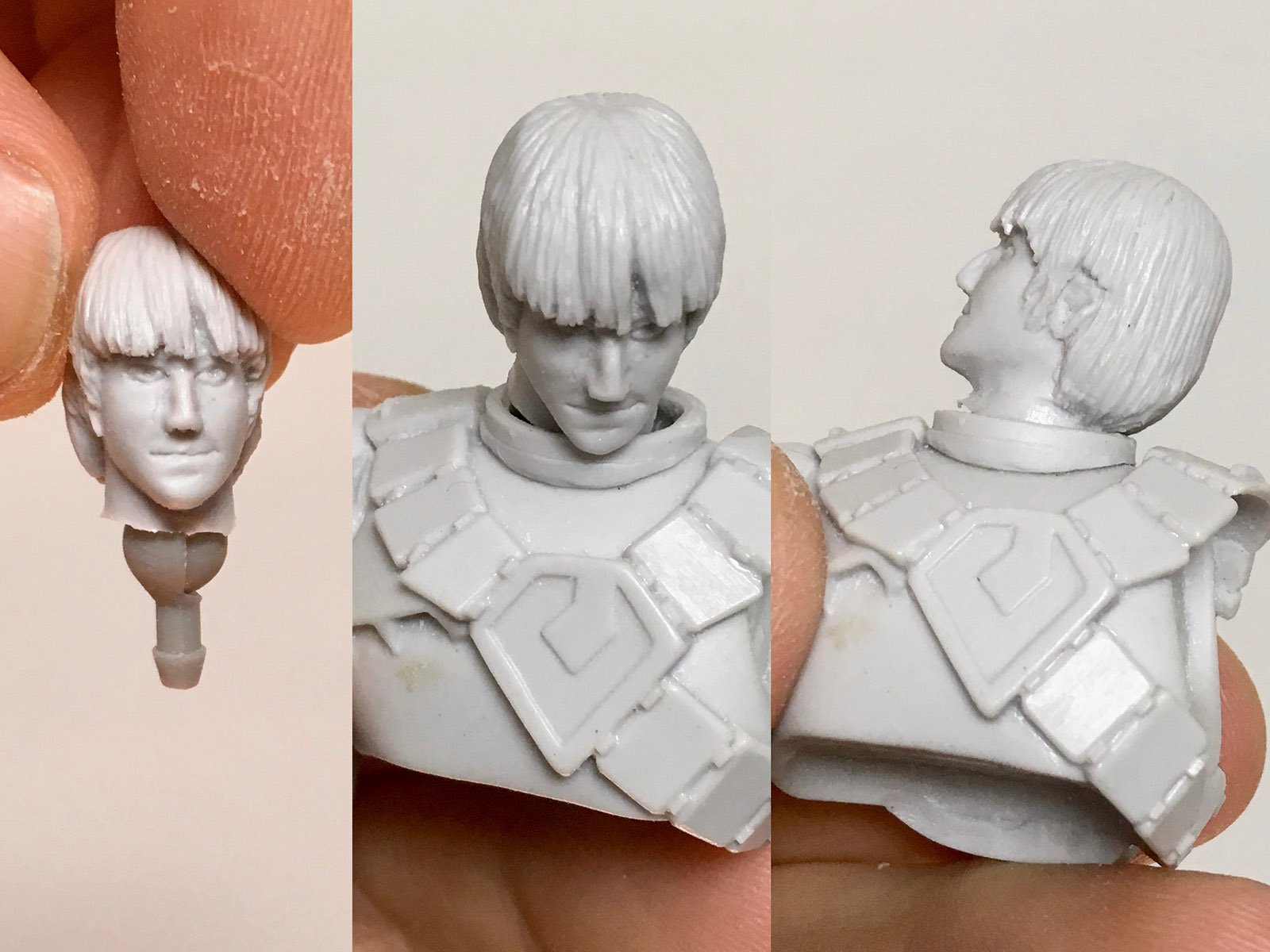

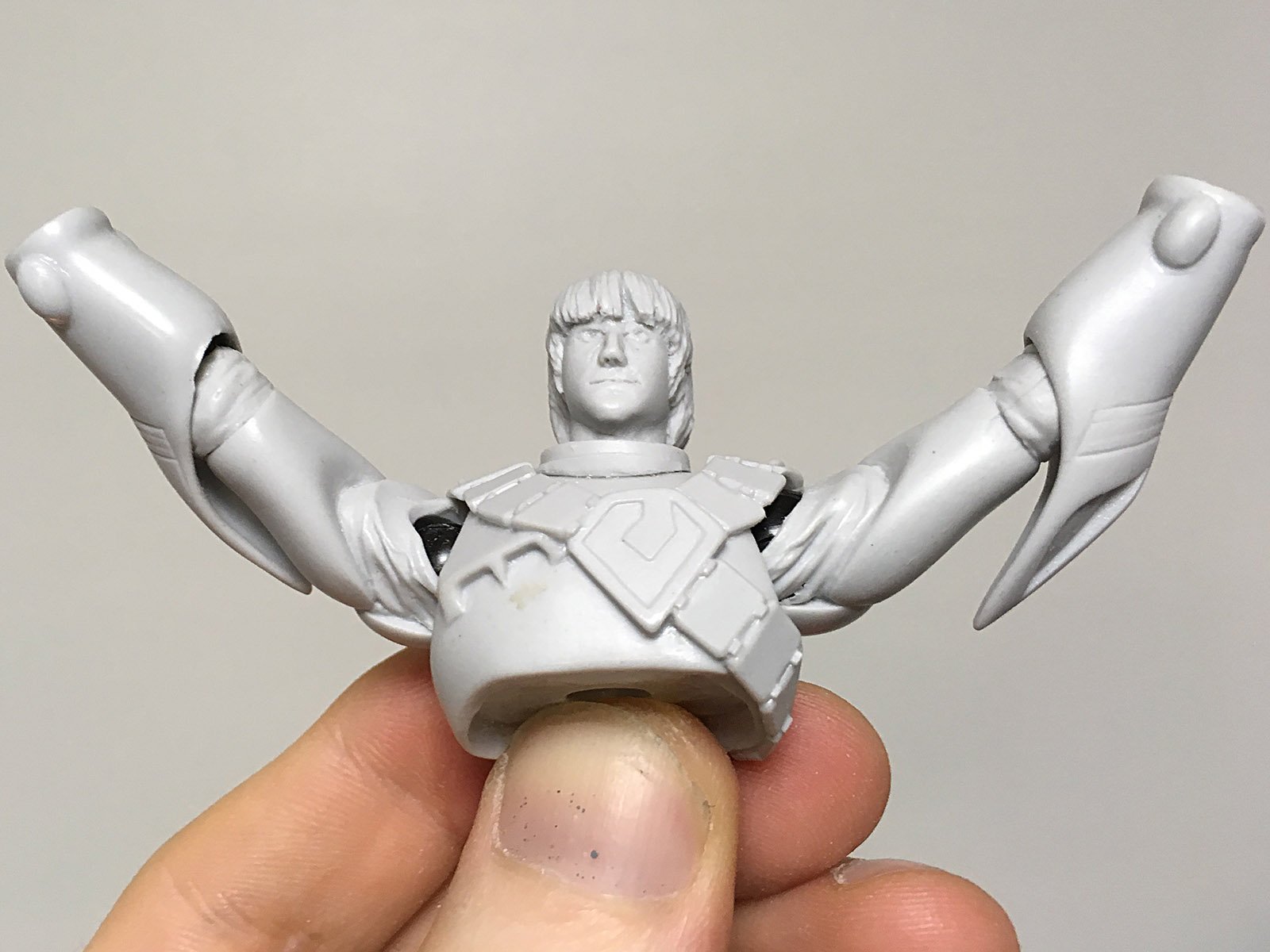

With a joint installed in the neck, Quamzin can now look up and down, left and right, even glance over his shoulder.  ^_^

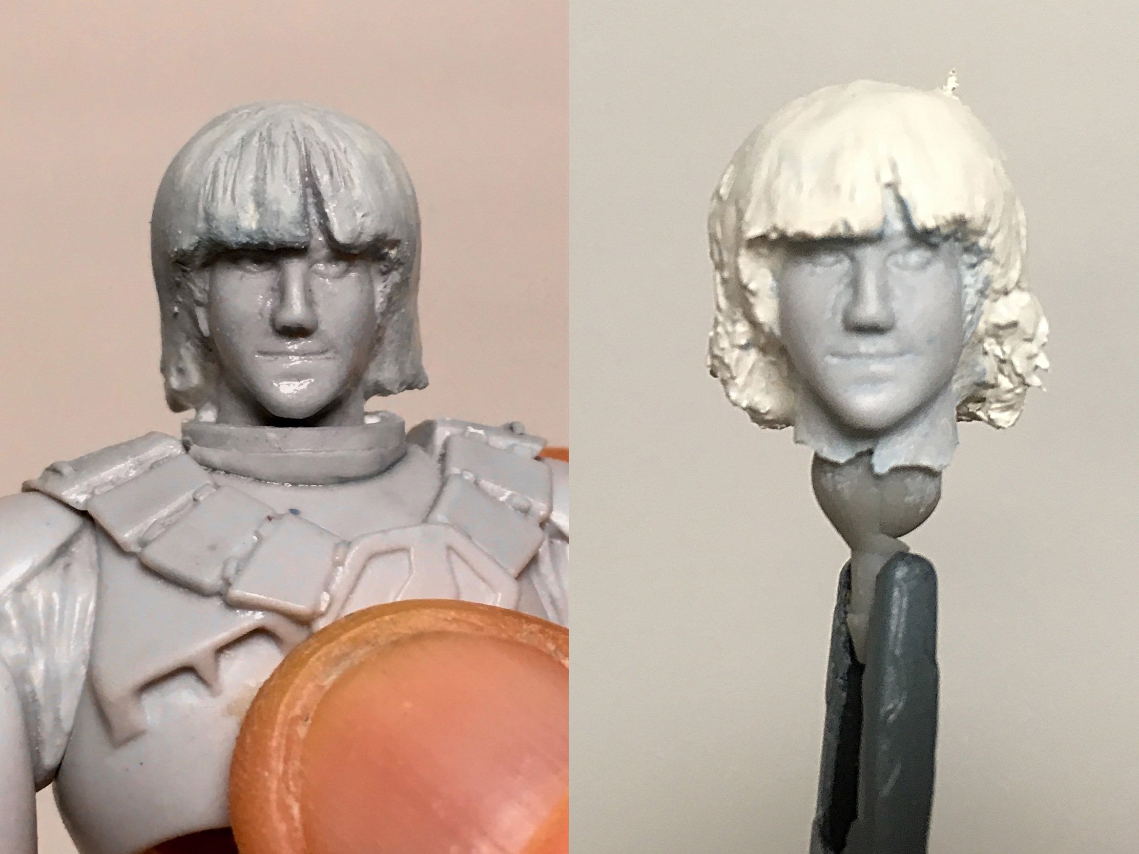

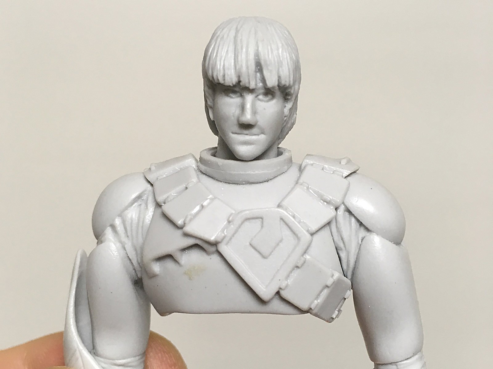

The next step was to fix that Beatles hairdo...
Easier said than done, I'm afraid.  :unsure:

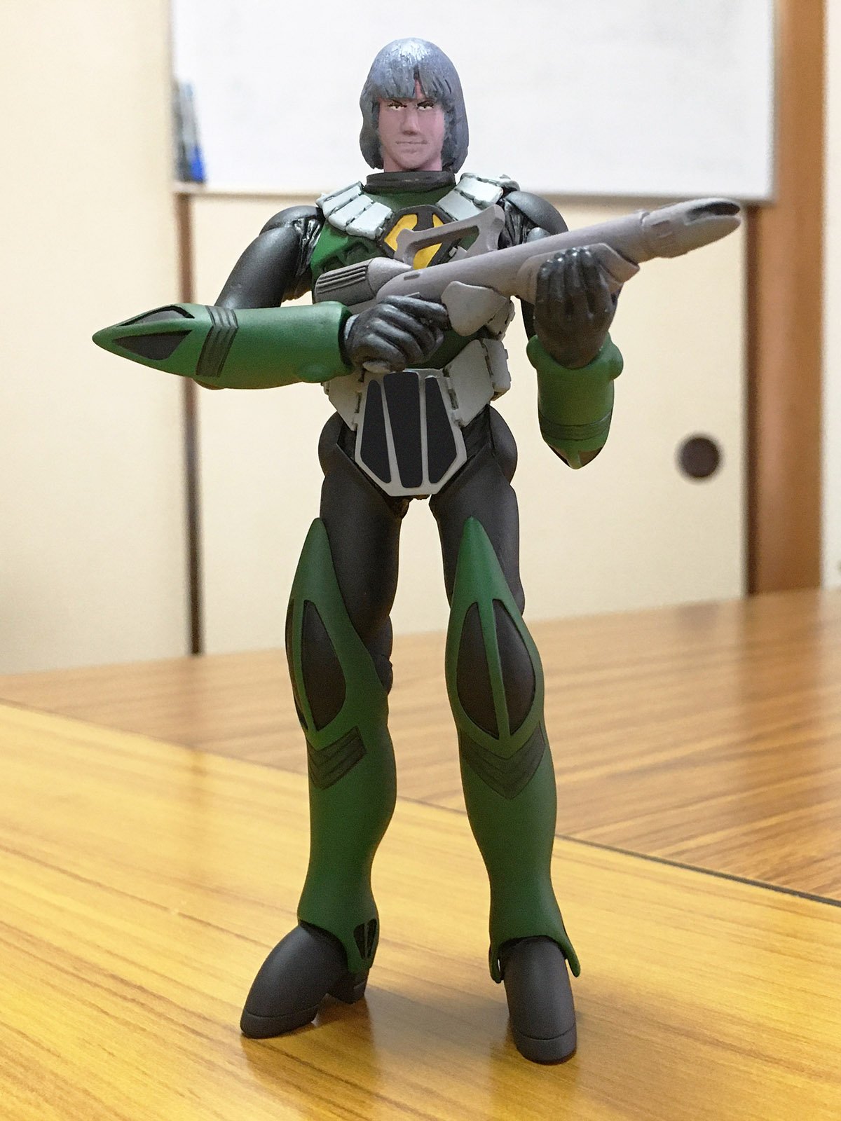

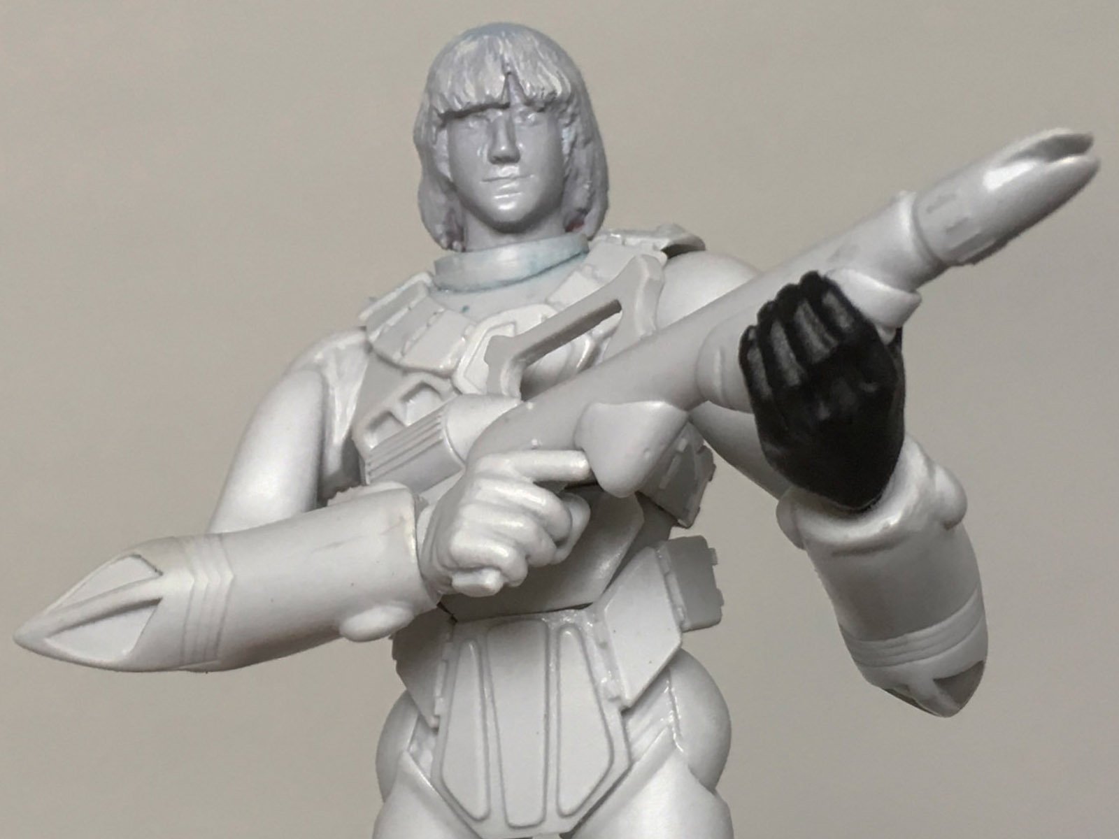

First attempt was too feminine, and still too short; second attempt looked like an unruly teenager.  <_<
Okay, now it's looking more like Quamzin.  The left hand (stolen from a Marvel Legends Thor: Ragnarok figure) allows him to hoist the rifle in a more threatening two-handed manner.  :good:

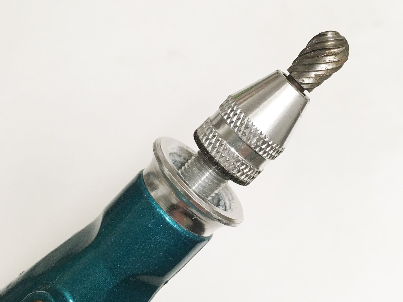

Curious, what tool did you use to get such nice rounded sockets for the revoltech joints? Any specifics would be appreciated as I have been considering modifications of this kind on a few projects and already have a batch of revoltech joints.

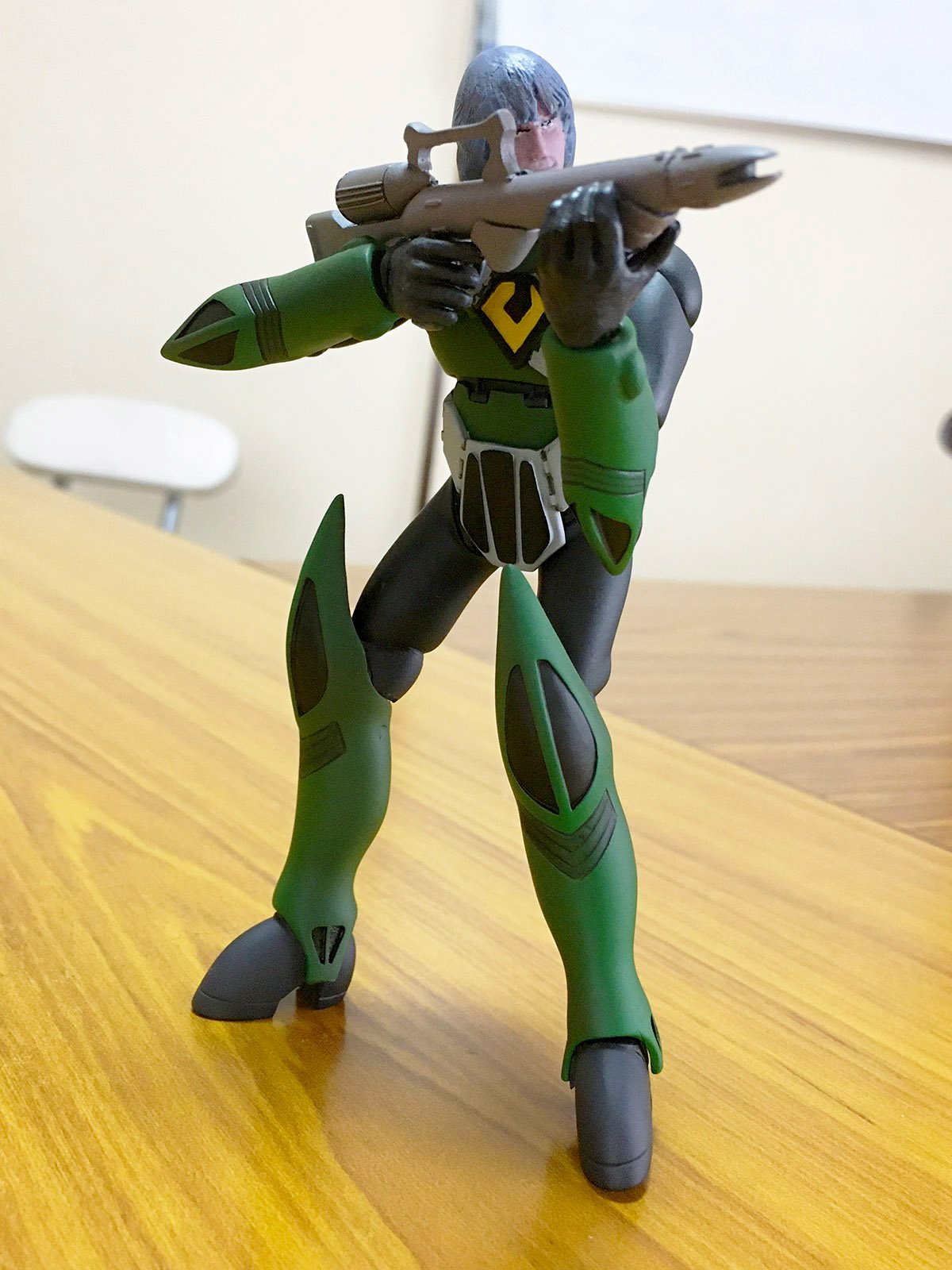

Even getting the figure into this nigh-impossible pose!
I realize he wasn't wielding a rifle when he rode the Monster, but wedging his gun in between the cannons was the most secure way of keeping him from falling off...  :unsure:
...and seriously, you've gotta go out of your way to keep a resin figure from falling, 'cause the painted surfaces are so easily damaged.  Paint rubs required me to remove and repaint his thighs several times while trying to get the right pose for him to straddle the HMR Monster.

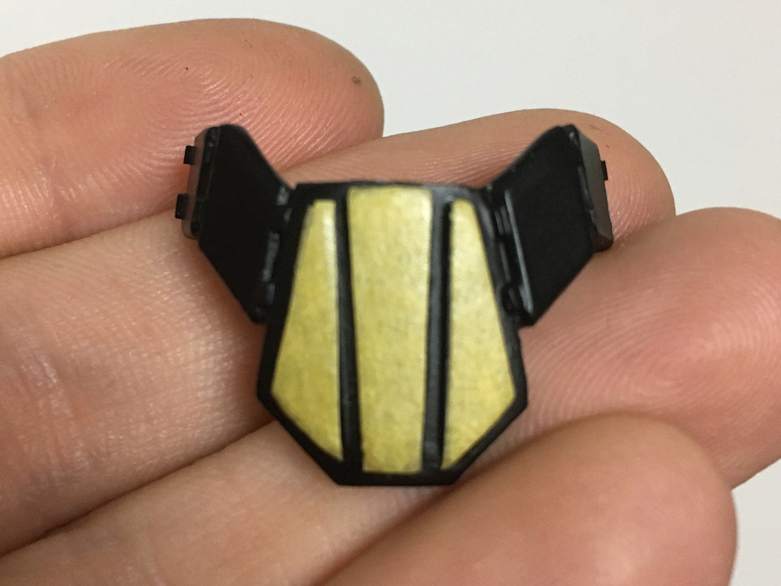

I'm still painting the codpiece, using masking tape to isolate the areas that will remain black.

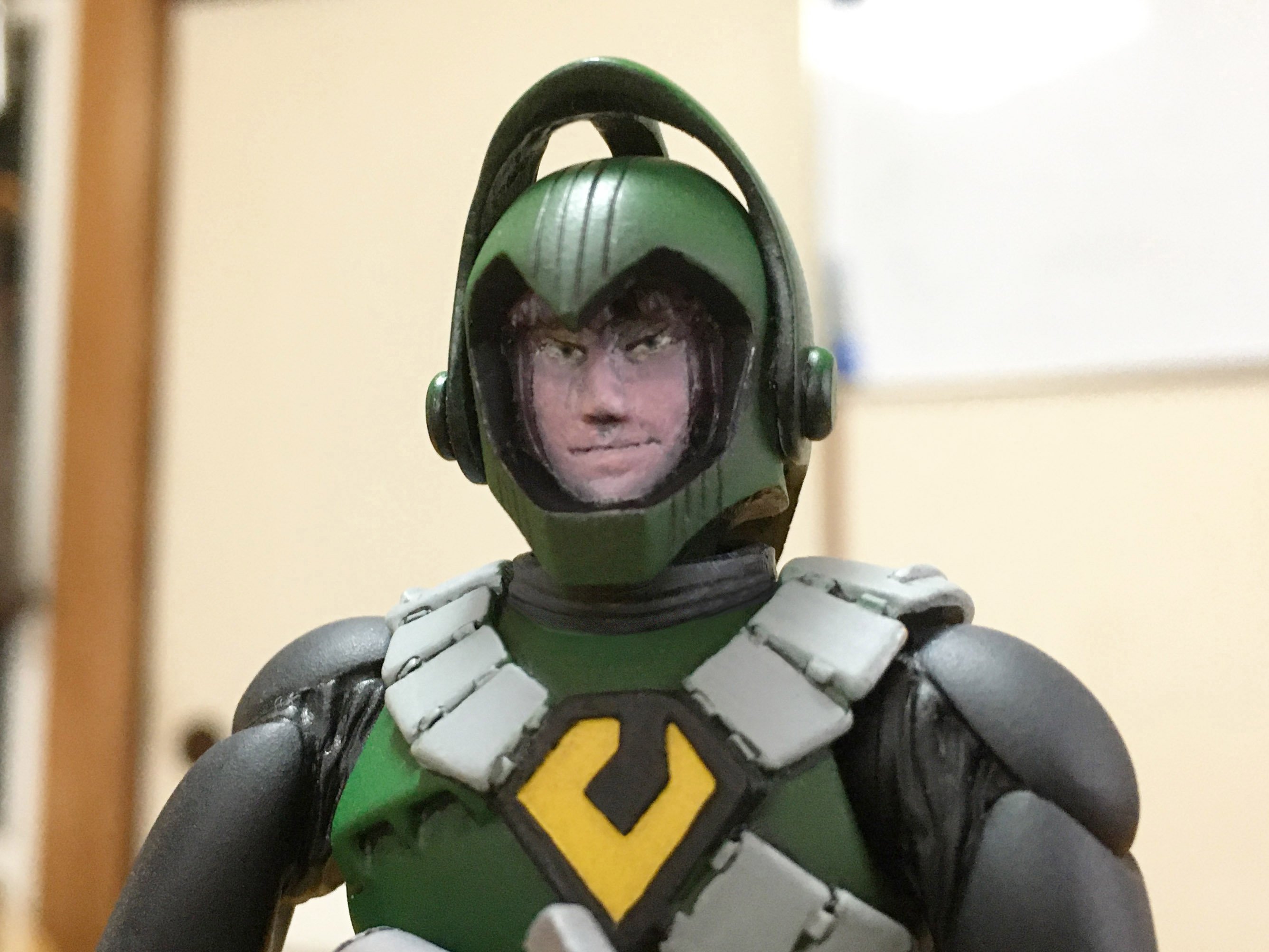

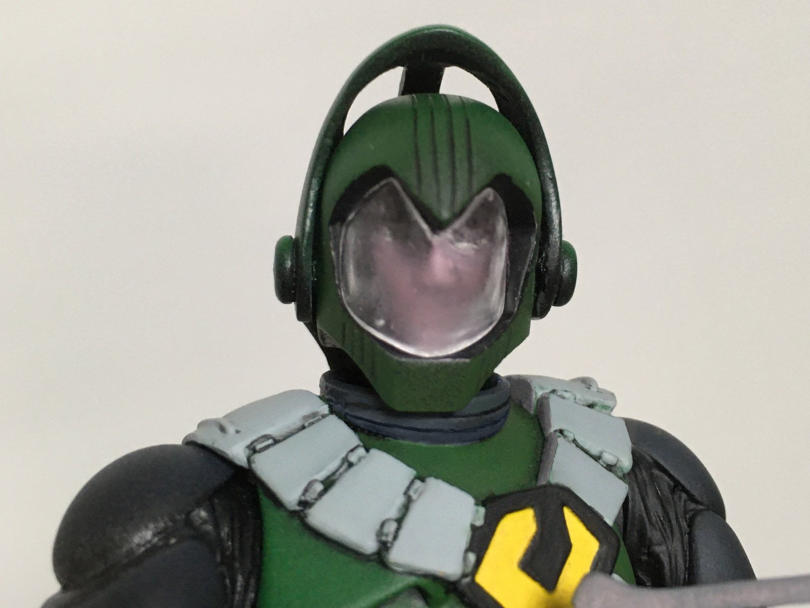

I'm fairly pleased with how the helmeted face turned out.  He looks like an evil bastard, doesn't he?  ^_^
Unfortunately, the visor he comes with completely obscures his features, so I won't be using it.  <_<
It's not like he used it on Earth anyway, right?  ;)
I've used this Dremel head for years... it came with it, as I recall.
I'm afraid I can't be any more specific than that.  :unknw:
This is fantastic. The rifle actually makes sense, it looks llke he is threatening the Monster's crew to get their act together - or else!

MMM A vac formed visor upgrade item is needed I think. I'll need to send them out to customers of course but if that visor isn't usable even after cleaning up and polishing then there is nothing else for it.
- Brett
Your commitment to quality is unparalleled!  :hi:
I tried 2000-grit sandpaper, buffing, and polishing compound, but that's as clear as I could get it.

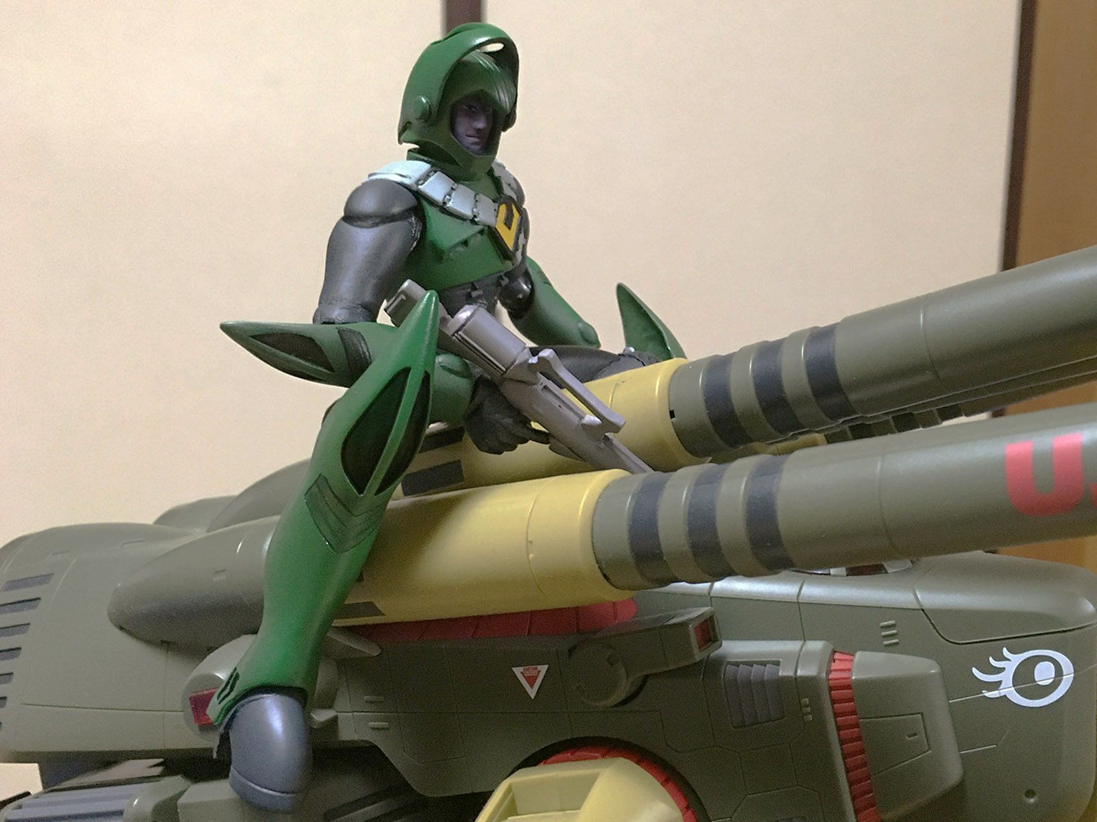

I'm still not completely satisfied with the hair, but I'm very pleased with how Quamzin's eyes turned out...

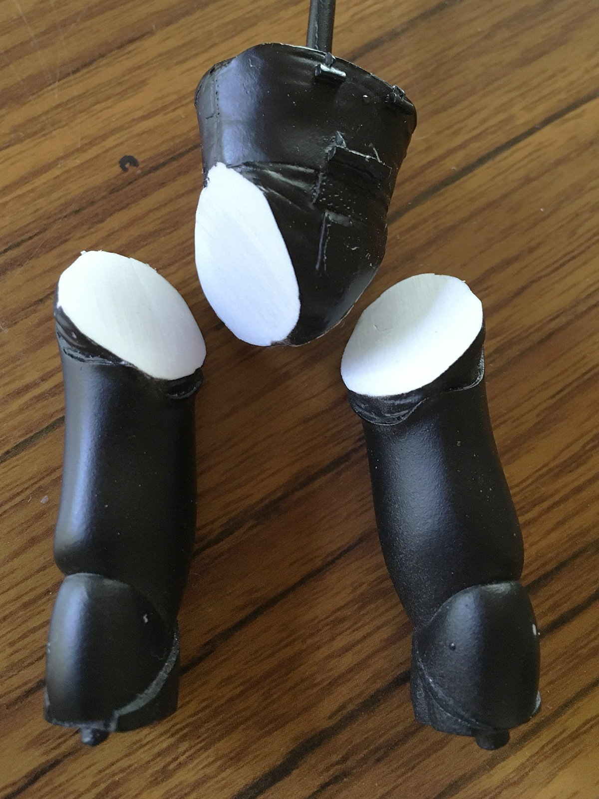

...and the cut-joints I added to the thighs (in combination with the ball-jointed knees) allow for some more dynamic standing poses.

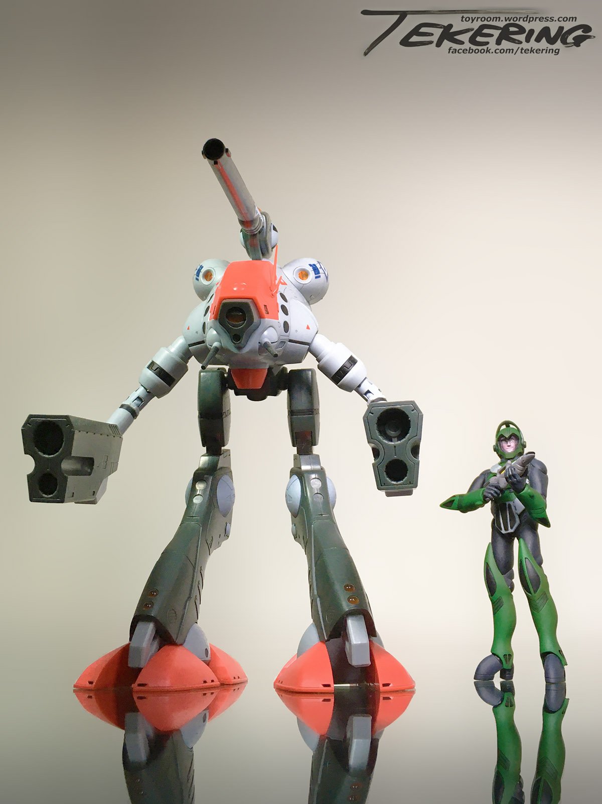

Here's the completed Quamzin with his iconic Glaug:
Even with a little forced perspective, the Hi-Metal R toy still doesn't quite scale.  :huh:
