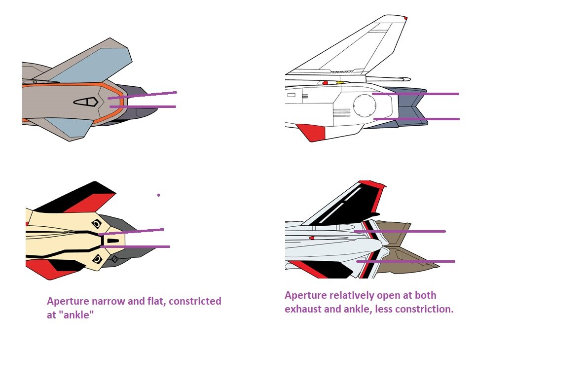

aurance Posted February 10, 2022 Posted February 10, 2022 So what’s the deal with the very narrow exhausts (feet) in majority of the valks from -4 to -19 when they’re folded up for fighter mode? Wouldn’t that cause a lot of turbulence and compression of exhaust gases? Is that a thing you would want for some reason?

Seto Kaiba Posted February 10, 2022 Posted February 10, 2022 52 minutes ago, aurance said: So what’s the deal with the very narrow exhausts (feet) in majority of the valks from -4 to -19 when they’re folded up for fighter mode? Wouldn’t that cause a lot of turbulence and compression of exhaust gases? Is that a thing you would want for some reason? I'll have to look into it and get back to you, since my brain is a bit fried at the moment due to fatigue... but if it's anything like a normal C-D nozzle flow compression is the point. In normal operation, the converging nozzle increases the exhaust velocity and it can diverge to accommodate afterburner operation. 27 minutes ago, Bolt said: I'm seeing a different launch arm set up, I believe it's from the digital mission VFX. Is what I'm seeing the launch or recovery ? I thought the launch was from a long ramp/boom from the stealth cruiser.. So, that appears to be the Valhalla III-type stealth special forces carrier setup... which is a handoff from a hangar gate like that one to a rotating inertial catapult system. The fighter drops out of the body of the ship on an arm (for that purpose, this picture is technically upside-down) and is released after the catapult arm connects to it. Then it's spun like it's on a centrifuge to build up launch speed before being released by the catapult arm.

sketchley Posted February 11, 2022 Posted February 11, 2022 6 hours ago, aurance said: So what’s the deal with the very narrow exhausts (feet) in majority of the valks from -4 to -19 when they’re folded up for fighter mode? Wouldn’t that cause a lot of turbulence and compression of exhaust gases? Is that a thing you would want for some reason? It's for the same reason that real world jet fighters have exhaust vanes: they compress the outflow to get greater speed at lower throttle settings. The Macross era fighters you've mentioned were all designed when the F-22 Raptor was the big hot thing in aerospace news, thus a lot of those Valkyries emulate its thrust vectoring vanes. There is, of course, artistic licence—Macross's fictional Otech allows for more heat resistant materials, thus enabling even more narrowing in the exhaust vanes. However, some of what you're perceiving may just be the distortion caused from the 3/4 views that Kawamor-san tended to draw VFs at. Also keep in mind that the top and bottom of a VF's thrust vectoring (feet) have dissimilar shapes, and that may be skewing our perception of how narrow (or not) the exhaust port may actually be. As for turbulence... narrow, rectangular exhaust nozzles don't appear to negatively affect the F-22 in RL. If there are any downsides to the shape, they appear to be outweighed by all the benefits those types of nozzles provide.
aurance Posted February 11, 2022 Posted February 11, 2022 (edited) 31 minutes ago, sketchley said: It's for the same reason that real world jet fighters have exhaust vanes: they compress the outflow to get greater speed at lower throttle settings. The Macross era fighters you've mentioned were all designed when the F-22 Raptor was the big hot thing in aerospace news, thus a lot of those Valkyries emulate its thrust vectoring vanes. There is, of course, artistic licence—Macross's fictional Otech allows for more heat resistant materials, thus enabling even more narrowing in the exhaust vanes. However, some of what you're perceiving may just be the distortion caused from the 3/4 views that Kawamor-san tended to draw VFs at. Also keep in mind that the top and bottom of a VF's thrust vectoring (feet) have dissimilar shapes, and that may be skewing our perception of how narrow (or not) the exhaust port may actually be. As for turbulence... narrow, rectangular exhaust nozzles don't appear to negatively affect the F-22 in RL. If there are any downsides to the shape, they appear to be outweighed by all the benefits those types of nozzles provide. It's not, it's mainly from me looking at the toys. The -0, -1, and all the -24 derivatives have a much more open design though. So the answer seems to be, just artistic whims. Edited February 11, 2022 by aurance

Knight26 Posted February 11, 2022 Posted February 11, 2022 9 minutes ago, aurance said: It's not, it's mainly from me looking at the toys. The -0, -1, and all the -24 derivatives have a much more open design though. So the answer seems to be, just artistic whims. Incorrect. As with real world aircraft that have 2-D thrust vectoring certain design concessions have to be made. A slight constricting of the exhaust, using more thermally resistant materials, allows the thrust vector exhaust vanes to more easily, and precisely, maneuver the exhaust flow direction, though at the expense of higher maintenance costs. There is a reason why most countries did not adopt 2-D thrust vectoring IRL. Also, if you watched animation, particularly Macross Plus, there is a scene where the feet/TVC vanes extend during pre flight demonstrating that they do, in fact, open wider for full thrust/afterburner operations, as real world aircraft do. Also, you have to realize that the toys are scale models of the designs, and as a result the thickness of the materials and parts, as well as their full degree of mobility, are not necessarily consistent with the VF's "Real World" design dimensions.
sketchley Posted February 11, 2022 Posted February 11, 2022 (edited) 1 hour ago, Knight26 said: Also, you have to realize that the toys are scale models of the designs, and as a result the thickness of the materials and parts, as well as their full degree of mobility, are not necessarily consistent with the VF's "Real World" design dimensions. I think there is one more thing that has to be addressed: what is the 'flight profile' of the toys/models/etc.? Are they at rest? (E.g. maximum constriction) Full afterburner? (E.g. least constriction) Obviously we can't get inside the head of the designer or the engineering team that forced compromises on the positioning of those parts of the toys/models/etc. in that configuration due to materials limitations. So my question is probably impossible to answer... Edited February 11, 2022 by sketchley

aurance Posted February 11, 2022 Posted February 11, 2022 (edited) 2 hours ago, Knight26 said: Incorrect. As with real world aircraft that have 2-D thrust vectoring certain design concessions have to be made. A slight constricting of the exhaust, using more thermally resistant materials, allows the thrust vector exhaust vanes to more easily, and precisely, maneuver the exhaust flow direction, though at the expense of higher maintenance costs. There is a reason why most countries did not adopt 2-D thrust vectoring IRL. Also, if you watched animation, particularly Macross Plus, there is a scene where the feet/TVC vanes extend during pre flight demonstrating that they do, in fact, open wider for full thrust/afterburner operations, as real world aircraft do. Also, you have to realize that the toys are scale models of the designs, and as a result the thickness of the materials and parts, as well as their full degree of mobility, are not necessarily consistent with the VF's "Real World" design dimensions. Okay. I don’t think either of you are understanding what I’m saying. I’m already aware of the facts you two mentioned. And 'toys vary from real thing? Come on man, of course they do but that's not what I'm referring to. Let me try to add a drawing. Seems like a deliberate change in design but my question was whether this was an in-world thing or just style. I guess we don't know. I should have clarified what I was pointing out. Edited February 11, 2022 by aurance
sketchley Posted February 11, 2022 Posted February 11, 2022 We get what you're saying (refer to my comments on the F-22 above). Those side on images are also a bit misleading. Inside, the thrust vectoring vanes (foot assembly) open up, and it's really only where the vanes meet the fuselage (what becomes the ankle armour) is where it's at its narrowest. There's an excellent picture of that in the Variable Fighter Master File book in the VF-19, but it's not readily available on the net. Making do... these two should describe what I'm referring to (the VF-19 cutaway does a better job of showing it): http://www.macross2.net/m3/macross7/vf-19custom/vf-19custom-handandfoot.gif
camk4evr Posted February 11, 2022 Posted February 11, 2022 The VF-1 (and, presuumably, the VF-25) have additional structures (vanes maybe) inthe 'foot' section that would, likely, further constrict the exhaust. The other two nacelle/leg designs (-11 and -19?) probably removed or reduced those interior structures to reduce complexity/ make maintence easier.
aurance Posted February 11, 2022 Posted February 11, 2022 22 minutes ago, sketchley said: We get what you're saying (refer to my comments on the F-22 above). Those side on images are also a bit misleading. Inside, the thrust vectoring vanes (foot assembly) open up, and it's really only where the vanes meet the fuselage (what becomes the ankle armour) is where it's at its narrowest. Yes I know that too, but such a choke point does not seem to exist, or is much wider on the fighters on the right.
aurance Posted February 11, 2022 Posted February 11, 2022 (edited) 5 minutes ago, camk4evr said: The VF-1 (and, presuumably, the VF-25) have additional structures (vanes maybe) inthe 'foot' section that would, likely, further constrict the exhaust. The other two nacelle/leg designs (-11 and -19?) probably removed or reduced those interior structures to reduce complexity/ make maintence easier. This is the first reply that actually addressed my question. Thanks.😋 Edited February 11, 2022 by aurance
sketchley Posted February 11, 2022 Posted February 11, 2022 (edited) 12 minutes ago, camk4evr said: The VF-1 (and, presuumably, the VF-25) have additional structures (vanes maybe) inthe 'foot' section that would, likely, further constrict the exhaust. The other two nacelle/leg designs (-11 and -19?) probably removed or reduced those interior structures to reduce complexity/ make maintence easier. I was looking through the Variable Fighter Master File books, and if they are considered a trusted source (they self describe themselves as not being part of the official setting), then there is a different mechanism being used inside the nozzle of the VF-25 and VF-31. Specifically: the thrust redirection plates (what "pinch" the flow to increase speed) are separate from the nozzle (foot) assembly itself. So, going back to Aurance's post with the side-diagrams, the Valkyries should be lumped into 2 categories: non-"pinched" nozzles (VF-1) "pinched" nozzles (VF-4, 11, 19, 25, 31) Of the latter, it appears there are 2 versions: foot assembly doubles as "pinching" mechanism (VF-11, 19 style) foot assembly and "pinching mechanism" are separate (VF-25, 31 style) It probably doesn't help that Kawamori-san designed the VF-25 as an homage to the VF-1. 🤷♂️ Edited February 11, 2022 by sketchley
aurance Posted February 11, 2022 Posted February 11, 2022 10 minutes ago, sketchley said: I was looking through the Variable Fighter Master File books, and if they are considered a trusted source (they self describe themselves as not being part of the official setting), then there is a different mechanism being used inside the nozzle of the VF-25 and VF-31. Specifically: the thrust redirection plates (what "pinch" the flow to increase speed) are separate from the nozzle (foot) assembly itself. So, going back to Aurance's post with the side-diagrams, the Valkyries should be lumped into 2 categories: non-"pinched" nozzles (VF-1) "pinched" nozzles (VF-4, 11, 19, 25, 31) Of the latter, it appears there are 2 versions: foot assembly doubles as "pinching" mechanism (VF-11, 19 style) foot assembly and "pinching mechanism" are separate (VF-25, 31 style) It probably doesn't help that Kawamori-san designed the VF-25 as an homage to the VF-1. 🤷♂️ Awesome, thank you!
Seto Kaiba Posted February 11, 2022 Posted February 11, 2022 (edited) 34 minutes ago, camk4evr said: The VF-1 (and, presuumably, the VF-25) have additional structures (vanes maybe) inthe 'foot' section that would, likely, further constrict the exhaust. The other two nacelle/leg designs (-11 and -19?) probably removed or reduced those interior structures to reduce complexity/ make maintence easier. DINGDINGDING We have a winner, ladies and gents! At least, for a number of these designs. 2 hours ago, aurance said: Okay. I don’t think either of you are understanding what I’m saying. I’m already aware of the facts you two mentioned. And 'toys vary from real thing? Come on man, of course they do but that's not what I'm referring to. Let me try to add a drawing. Seems like a deliberate change in design but my question was whether this was an in-world thing or just style. I guess we don't know. I should have clarified what I was pointing out. So, as others have already noted, the point of a variable nozzle is to adjust the compression of the exhaust flow and thus the conversion of exhaust temperature into an increase in exhaust velocity. When using an afterburner or afterburner-like function, you need to increase the mass flow through the nozzle to avoid excess pressure causing exhaust gases to flow upstream and cause unpleasant situations like a compressor stall or a fan surge. There are basically two categories of engine nozzle design here, if you ignore certain extras like thrust reversers and so on: Engines with convergent nozzles Engines with convergent-divergent nozzles You could also sum this up as an awful game of "Where's the de Laval nozzle?". On the VF-0 and VF-1, the thrust-vectoring nozzle functions as a convergent nozzle in its normal position and opens wider at higher thrust levels. The VF-1, however, has a convergent/divergent structure inside the engine body according to Master File and the older Sky Angels manual... though compared to later models of engine their exhaust temperatures and pressures were relatively low, though still VERY high compared to conventional jet engines. On later models, the convergent-divergent (de Laval) nozzle moved downstream of the engine to take up a position between the engine and thrust vectoring nozzle, adopting a more complex design called a variable geometry convergent-divergent nozzle. That vertical line marks the actual end of the engine housing, and you can see just aft of it there's that characteristic convergent-divergent bell shape - a de Laval nozzle - which is used to provide further exhaust velocity increase via flow compression. This can be adjusted via those actuators that are also used to adjust the position of the thrust-vectoring paddles themselves. (The part where it narrows is called the choke.) The current type is just a slightly more complex version of that. Instead of the leading edge of the thrust vectoring nozzle playing the role of the de Laval nozzle's choke, the thrust-vectoring nozzle and the choke are now independent of each other... the choke is farther up in the leg inside the ankle and the thrust-vectoring nozzle is now purely on the divergent end. Essentially, on the VF-1 the de Laval nozzle was inside the engine. After that, it moved to behind the engine with the choke being the leading edge of the thrust vectoring nozzles, until engine size increased enough that they could separate the choke from the thrust-vectoring nozzle. I see @sketchley kind of beat me to the punch there, but I hope these (previously-posted) visual aids help make the point a bit clearer. Edited February 11, 2022 by Seto Kaiba
