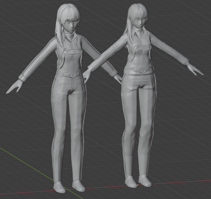

16 hours ago, arbit said:
Milia V2 compared to V1.

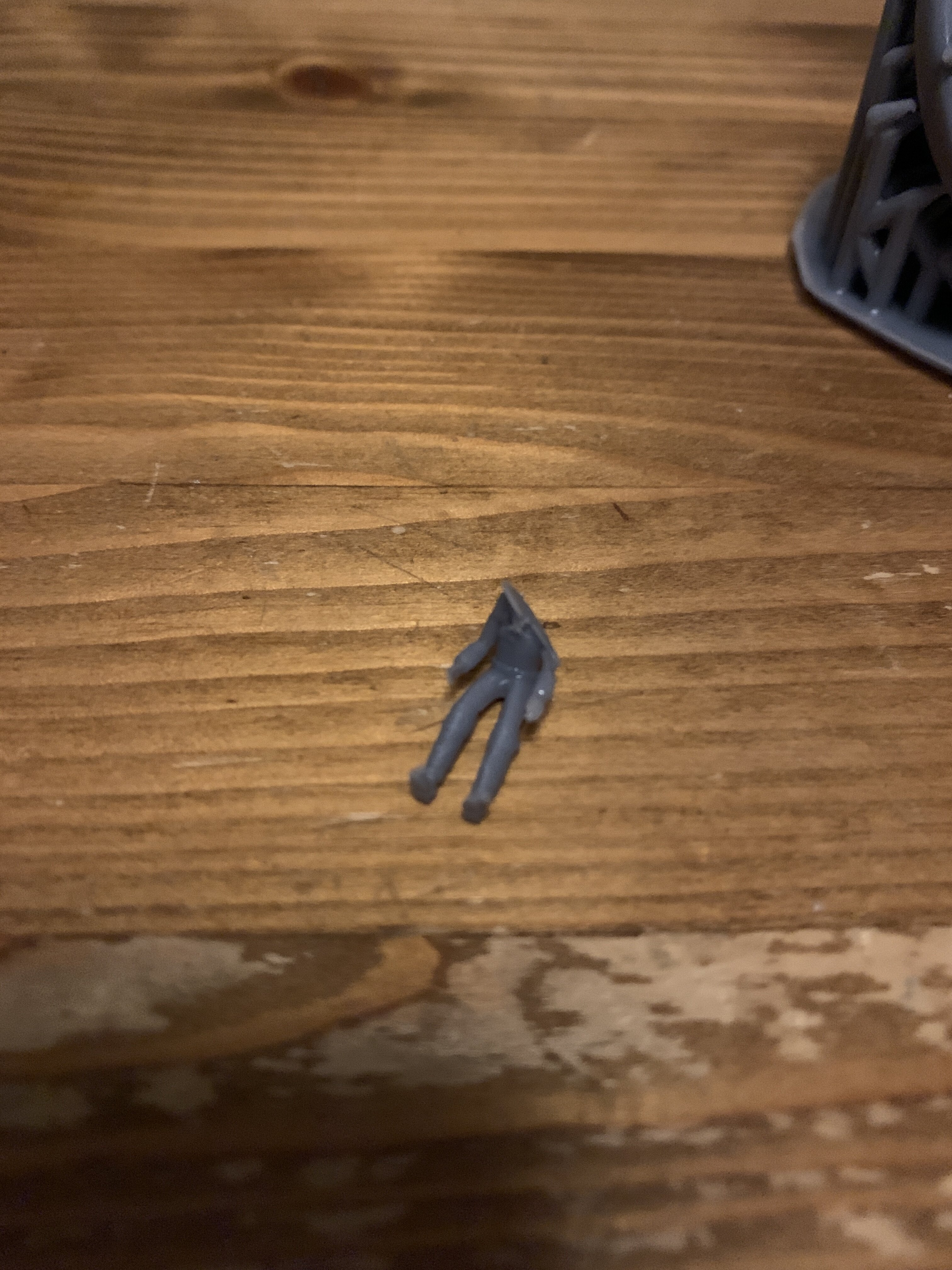

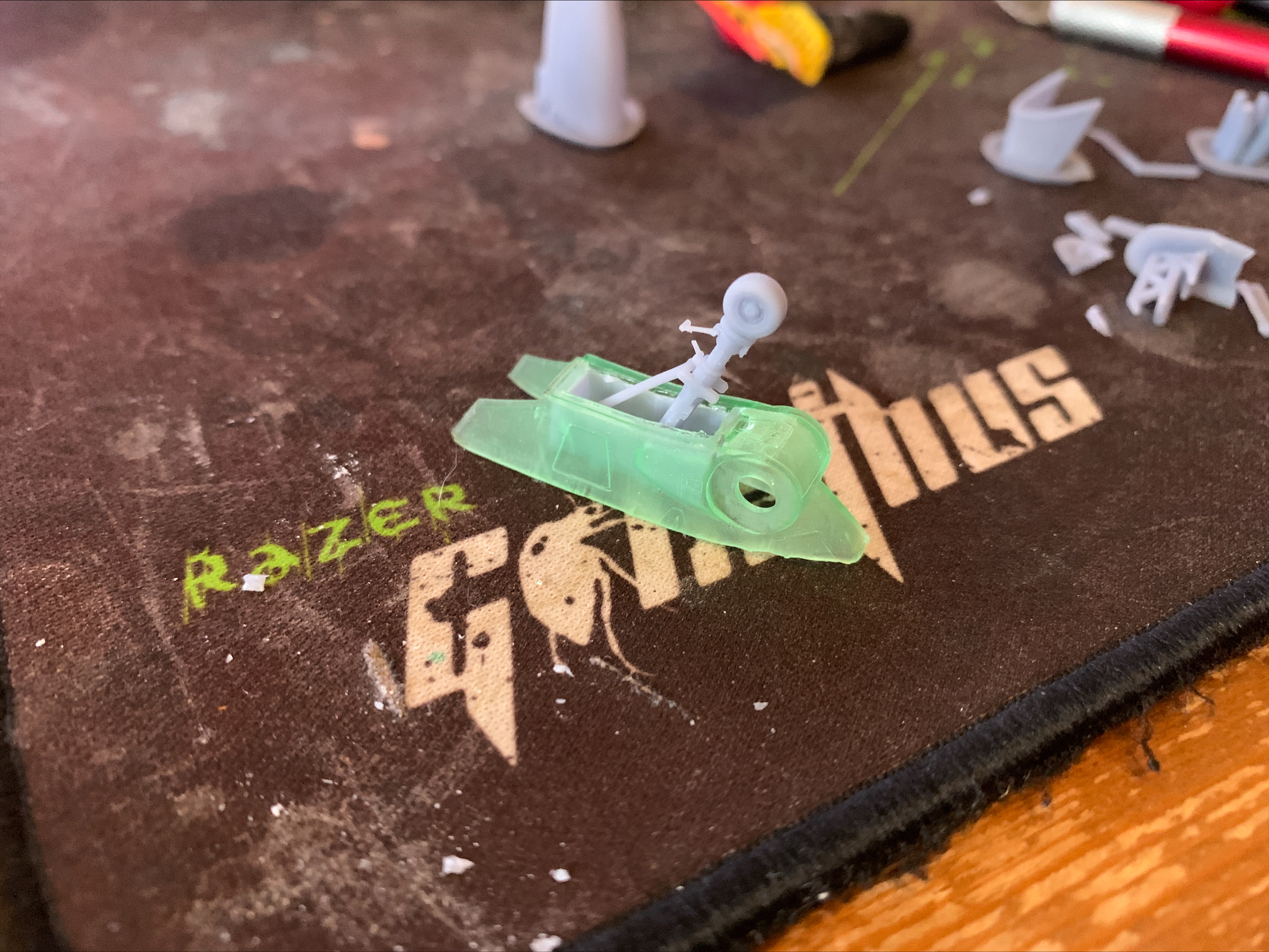

@arbit somehow your 1/72 vf-4 pilot didn’t survive the print. Looks like he smashed against a wall with too many Gs :)
Not a problem my friend. Happens all the time.  This is the easiest fix of all!  Looks like the print failed because your initial supports were not enough to hold him down, so they pulled off.
This is how I error check a print:
There is nothing wrong with your printer, because it looks like the rest of him printed well, your supports printed well, and your raft printed well too.  All systems go!
Your build plate is leveled well, unless you see any a deformation in the part that printed well.
And your printer settings are fine, as long as nothing is sticking to your resin vat.
Minor fails here and there are due to bad orientation or insufficient mini-supports.
I have uploaded my pre-supported file for you. Let me know how that goes.

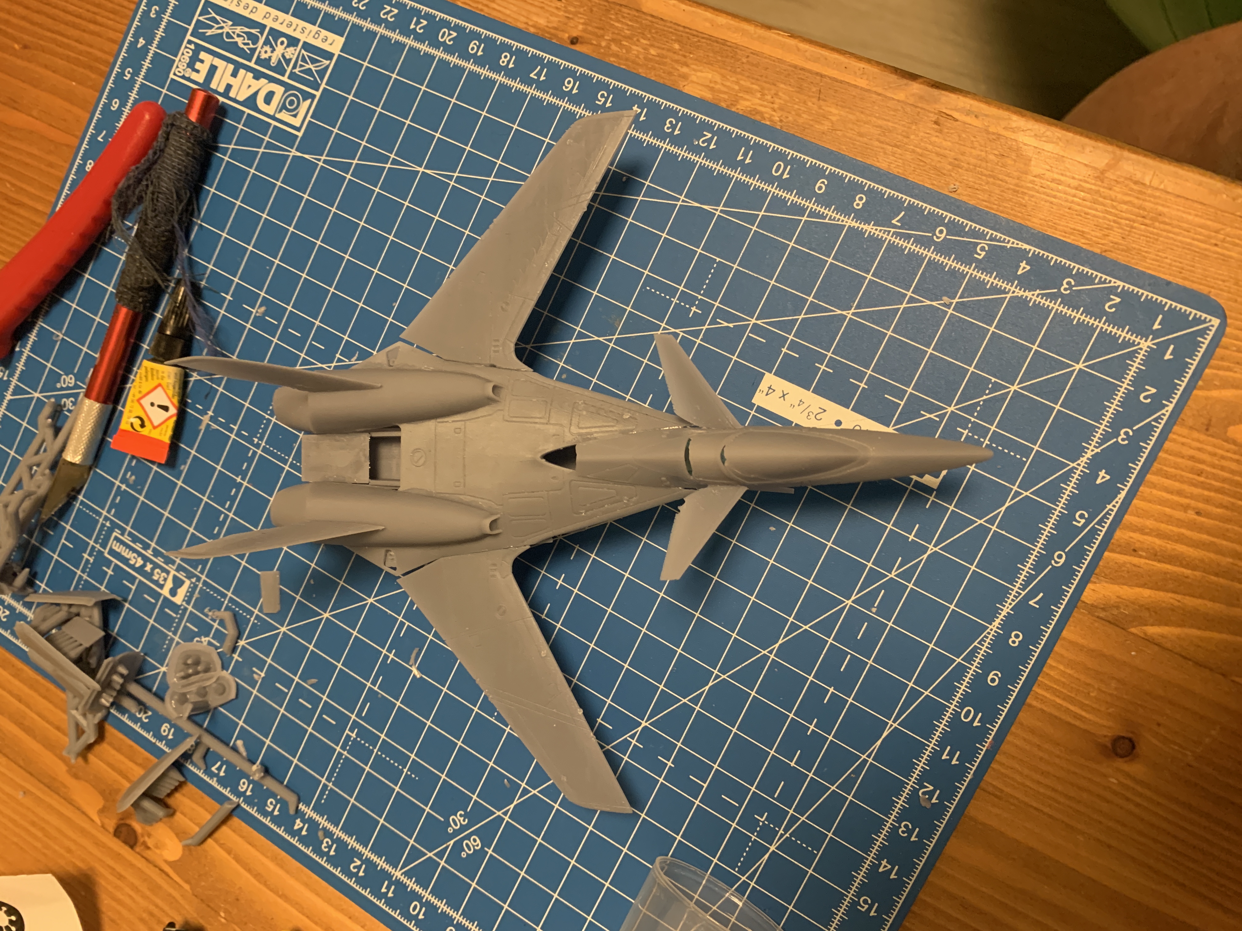

@arbit Thanks a lot! Yeah, the support on the head was too thin. Let me tell you one thing - I won't use the magic support creator in Lychee anymore. Every time is use it, the print fails horribly. Yesterday evening I decided to place the support myself and make sure that everything is supported properly. I decided to print out the VF-9 nose canopy and so on ... the version one I have been working years on, because I just wanted to see how it looks printed out. The walls are super thin. around 0.5mm, but it still managed to print properly. Only when detaching the supports the back broke and the back of the canopy pieces shattered. I glued everything together, just to get a sense of the size the VF-9 has and how much thicker the walls need to be.
I have to go back to the mesh and change wall thickness on everything. I am redoing the nose anyway, so I make sure the wallthickness is increased for that.
It feels so weird and amazing, actually touching the thing that I have been working on for so long, seeing it in the real world. It's just ... wow.
hahaha
But no further printing for me until I fix the wall thickness, so you won't see much prints from me in the next days. :)

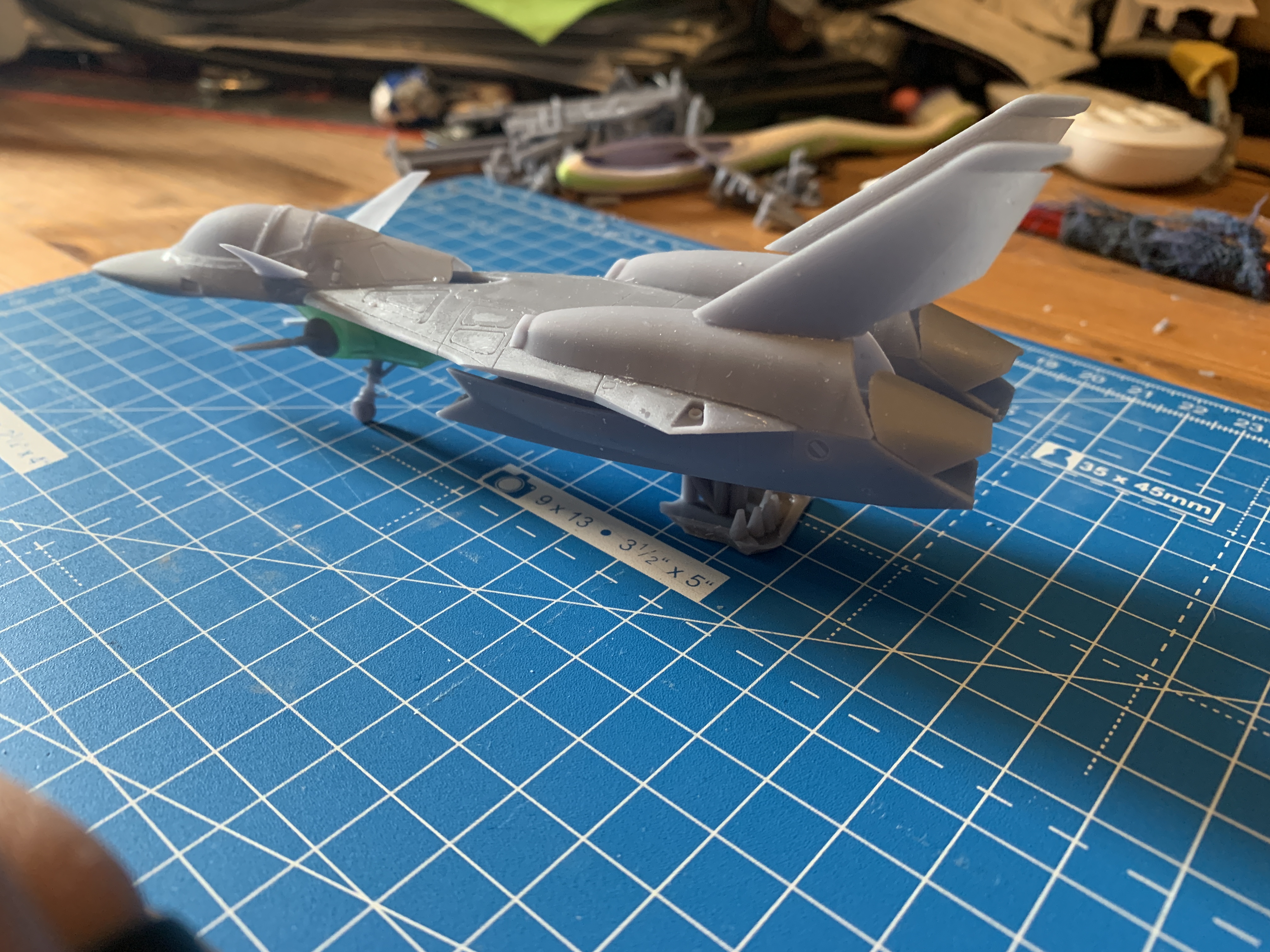

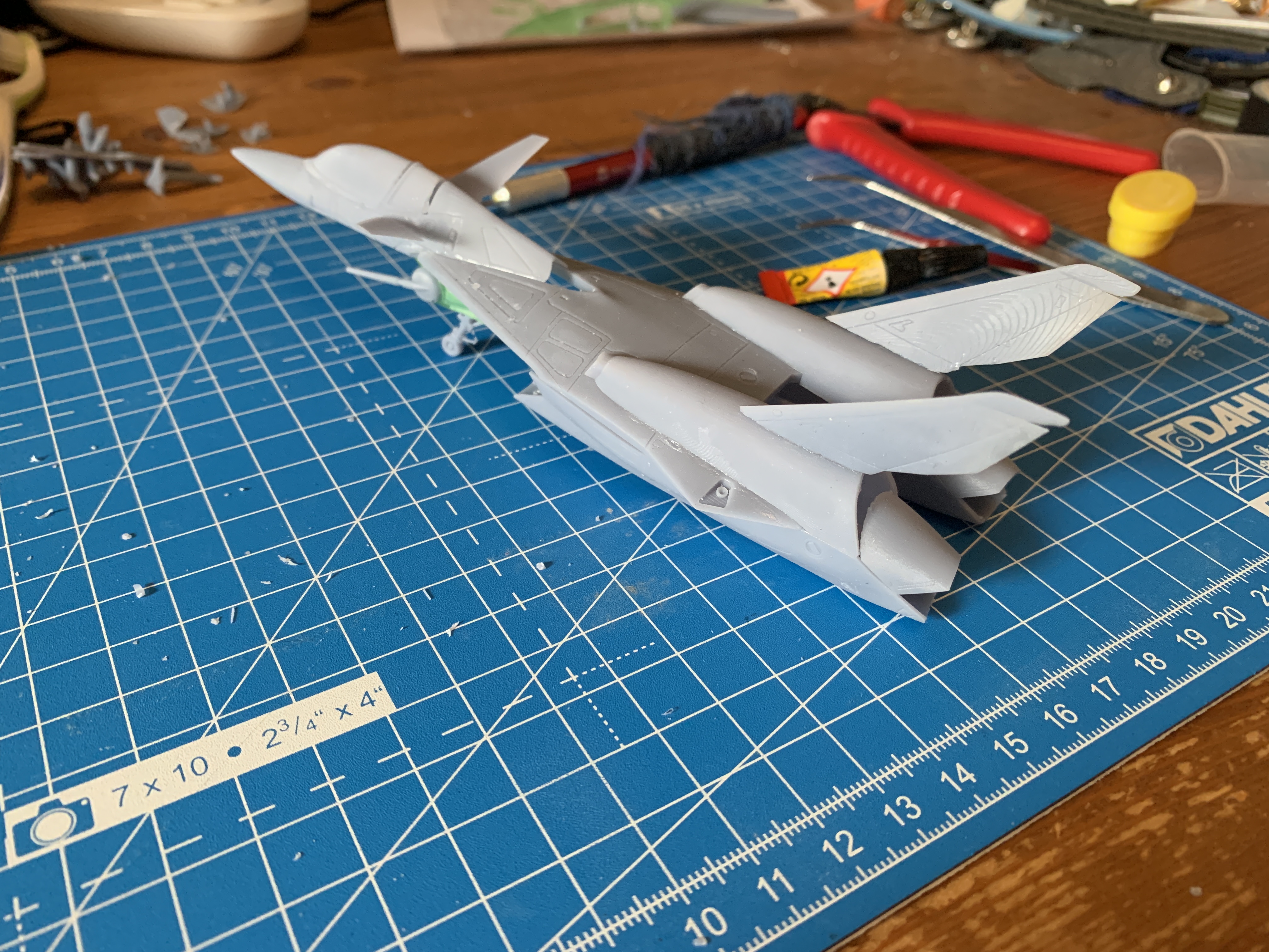

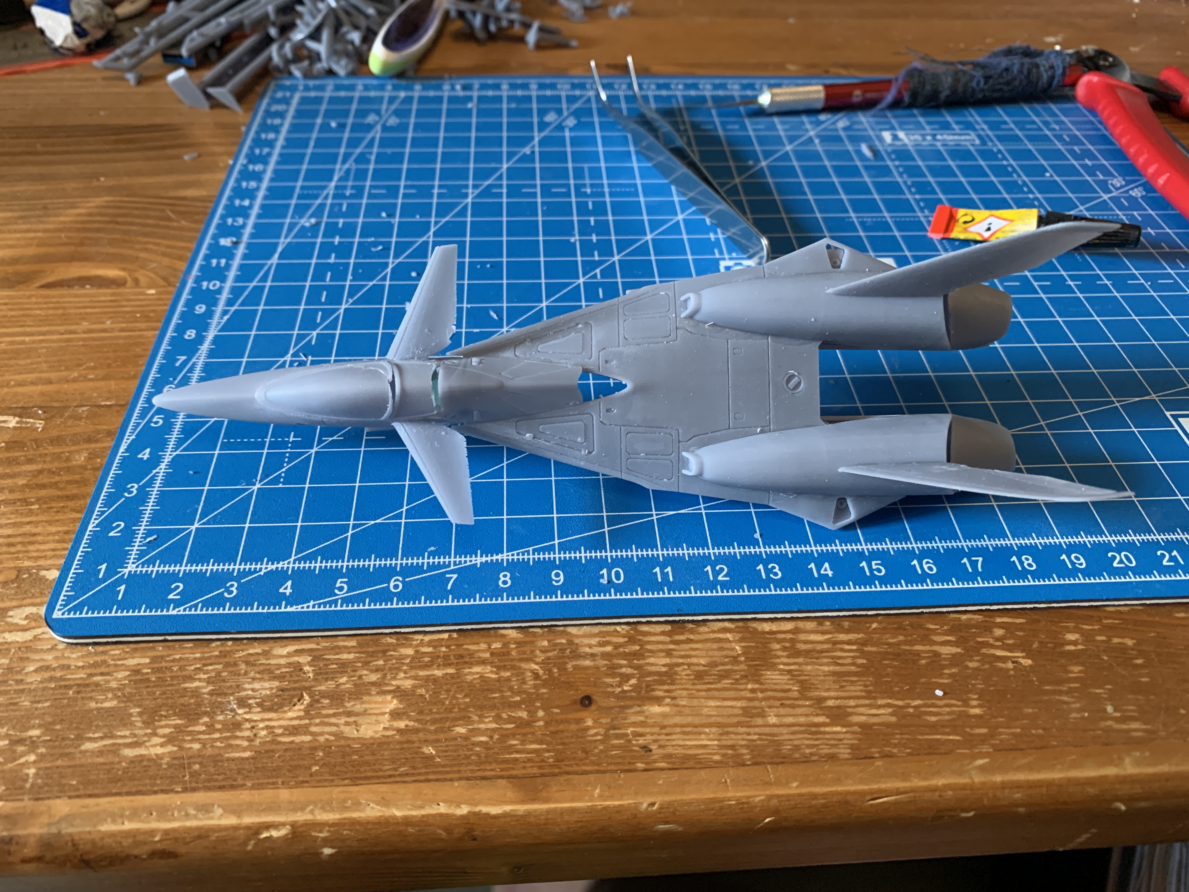

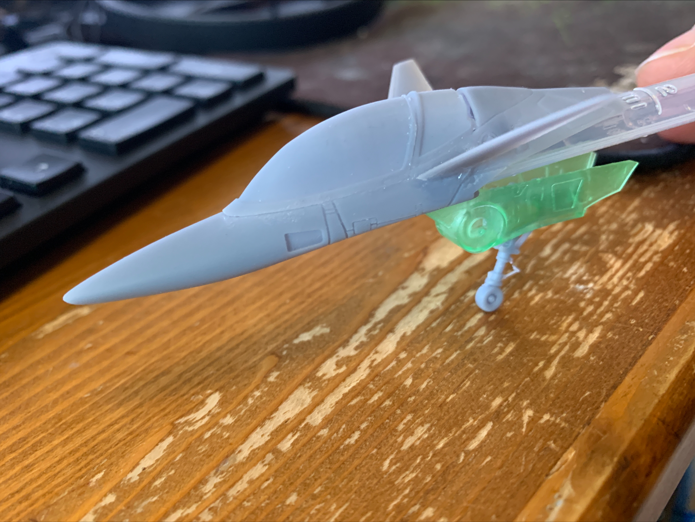

Okay, I could resist. I printed every piece I think was fine, just to check wall thinkness and if it would print good, or not. Behold!
Around 18cm long, it is shorter than a 1/72 VF-1. everything seems fine except for the vertical stabilizers. They are way too thin. It bends like paper. So I have to redo them too. The engine bays and so on work great. They have a nice fit and I am mostly satisfied.

@Urashiman It's looking impressive already with the overall shapes & surface details. Very smooth, too, except for the stabs. There seems to be a bit of warping going on etc, so good luck with the fine-tuning!
@MechTech Thanks for the encouragement. I'm doing a Kuwaiti sand hornet, and they get pretty spotty, too.

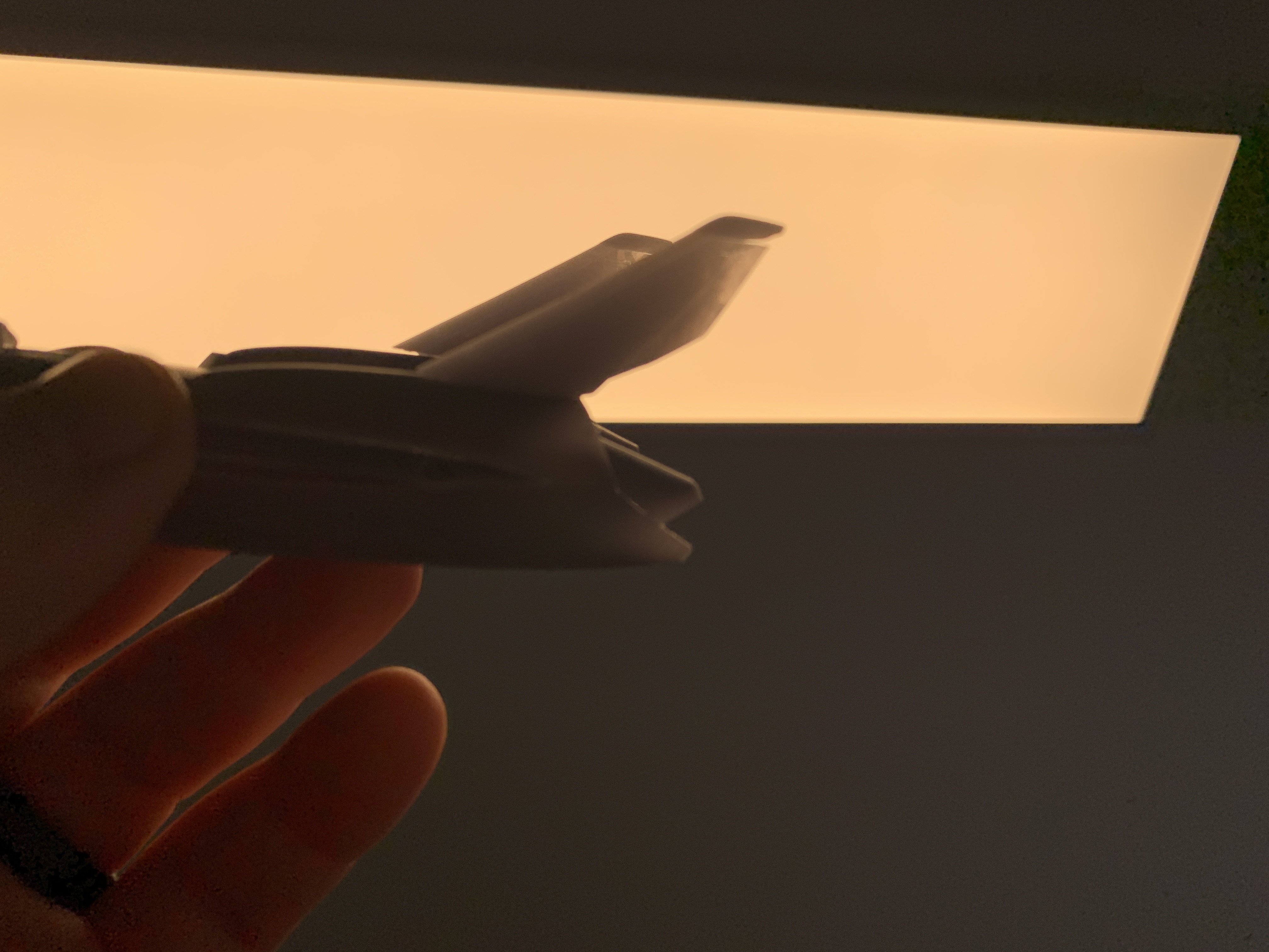

Yeah, they are paper thin and bend around. Light coming through easily. Have to make them thicker to prevent the warping.

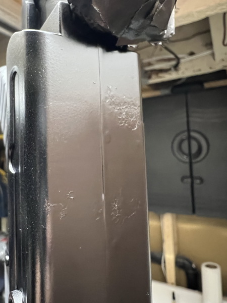

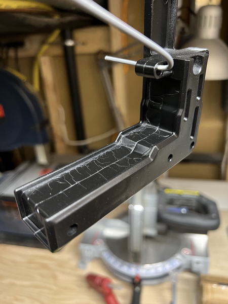

Not much to show for my Nerf gun yet, made the mistake of using Rustoleum lacquer spray paints - I was thinking they'd be more durable than my model stuff.  Well the primer takes ages to dry (says 5-7days on plastic) and you'd think their primer would work well with their topcoat, but not so!  After I let the primer dry for 5-6 days, I sprayed on the top coat of black and there's some areas that started to crackle - WTF?!  This only happened if I were mixing the wrong type of paint on not allowing the undercoat dry in enough time but never with the same type of paint.  Oh well, I guess its back to a lot of sanding it down again to re-spray.  The Tamiya TS-90 brown when on buttery smooth (should have used a semi-gloss black from Tamiya instead) - it was the closest match to Brown Bess I could get in North America - who knew this was a UK specific colour and not available outside?
