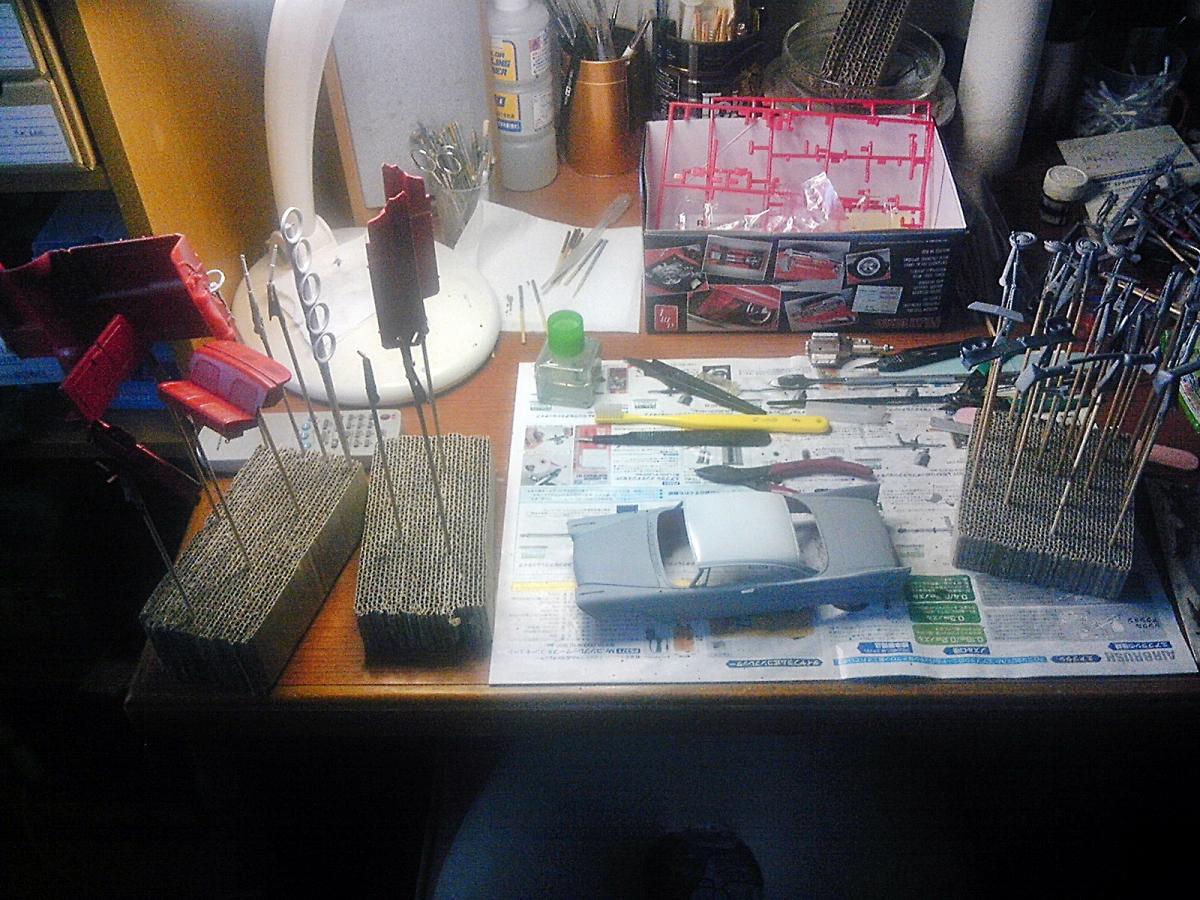

Jefuemon Posted December 6, 2015 Posted December 6, 2015 Taking a little Macross break Will probably be the last kit I build for a few months. Winter in Sapporo is not all that conductive to painting. Got plenty of Nanoblock kits to build, and a papercraft SDF-1 to tide me though till Spring.

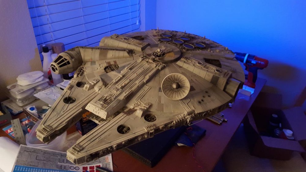

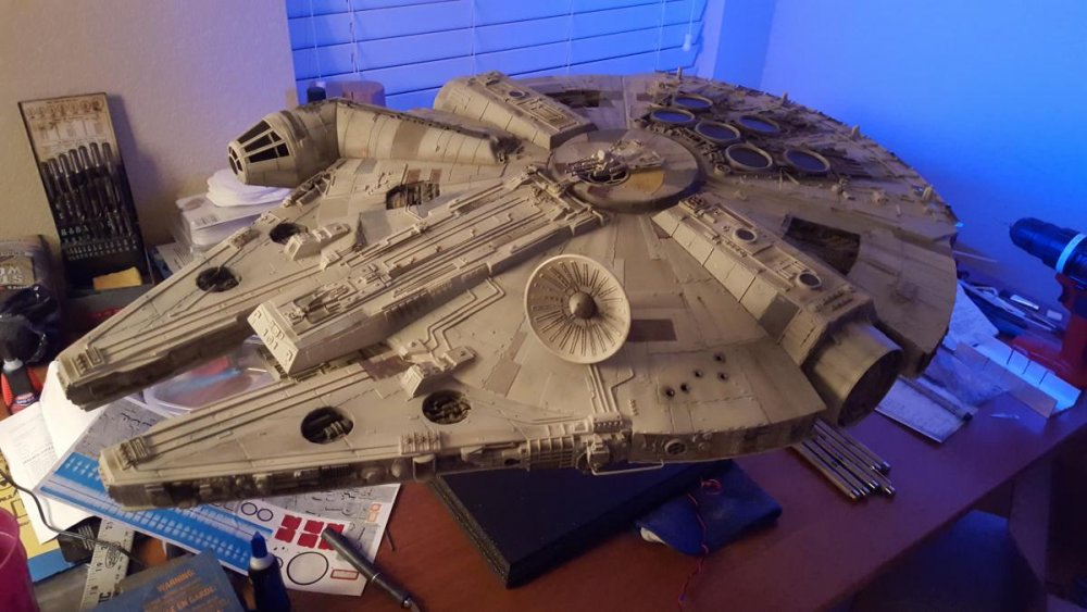

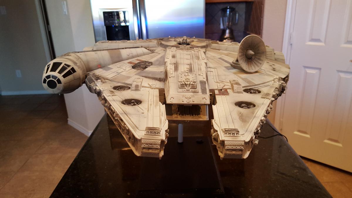

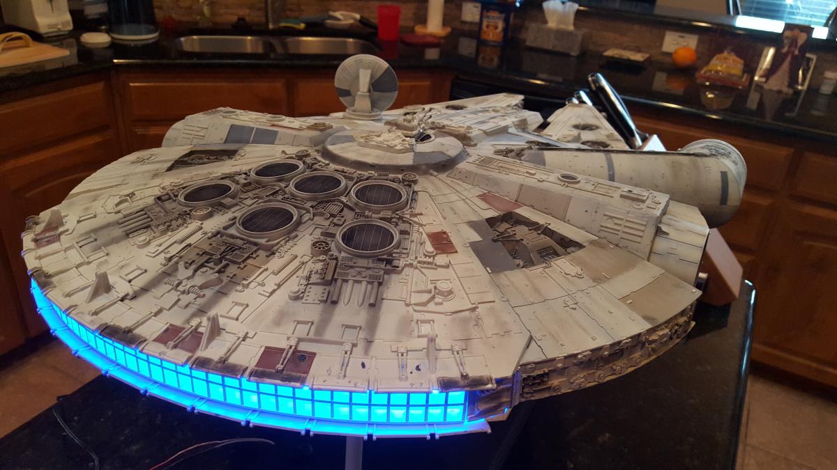

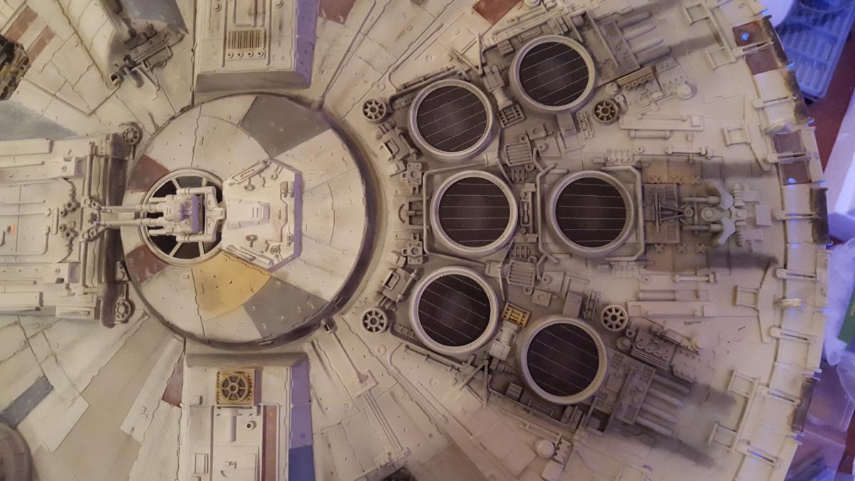

derex3592 Posted December 7, 2015 Posted December 7, 2015 Got almost everything done today. Got a few minor touch ups to make, and I might do a bit more weathering, but at this point it would be free, but whatever. I actually used the stickers that came with the toy for all the grill covers and the cockpit, good quality stickers. Looks pretty good for a big hunk of crap plastic that was at one point on sale for like $35 last year at this time. If it were mine I would have done the Shapeways upgraded radar dish and possibly the entire cockpit assembly, but that would have been a huge job in itself, not to mention pricey.

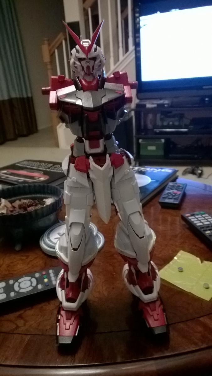

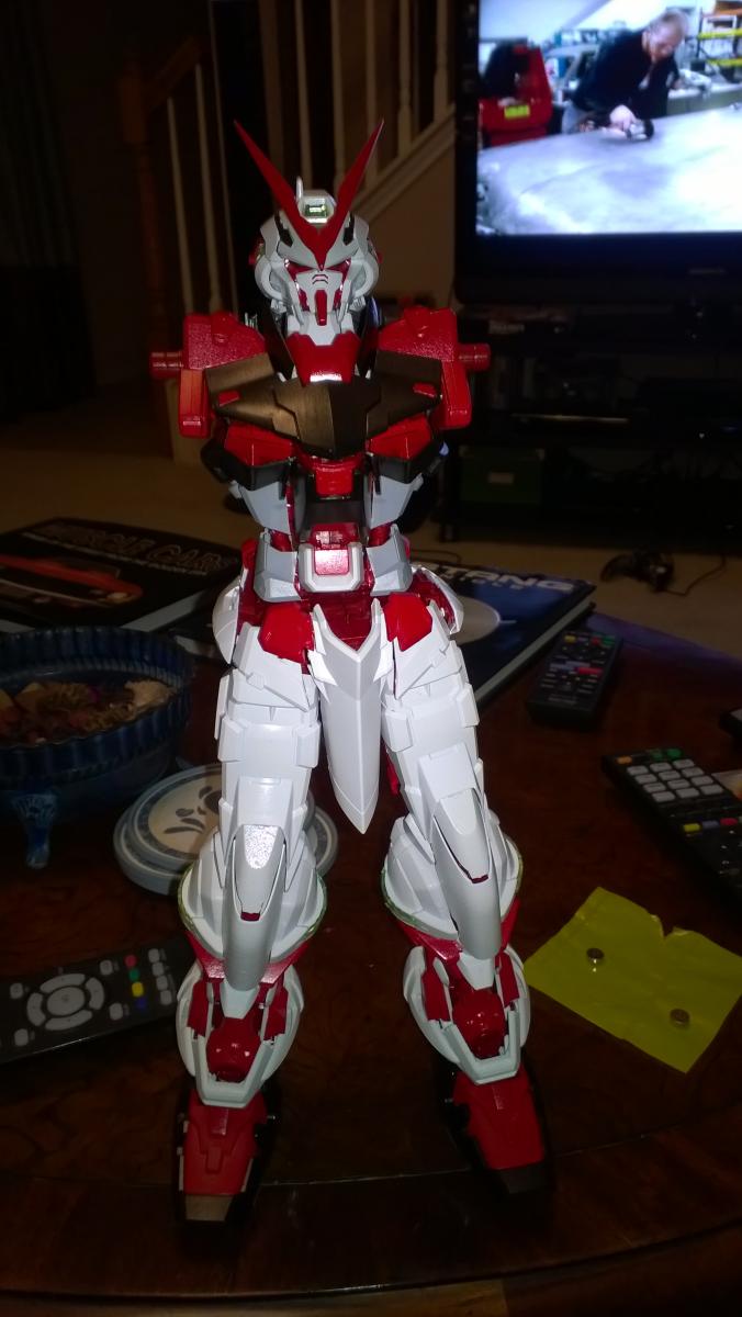

Golden Arms Posted December 7, 2015 Posted December 7, 2015 1/60 pg red astray. After this several Macross kits and finalizing 1/60 Yamato assembly VF-1S custom.

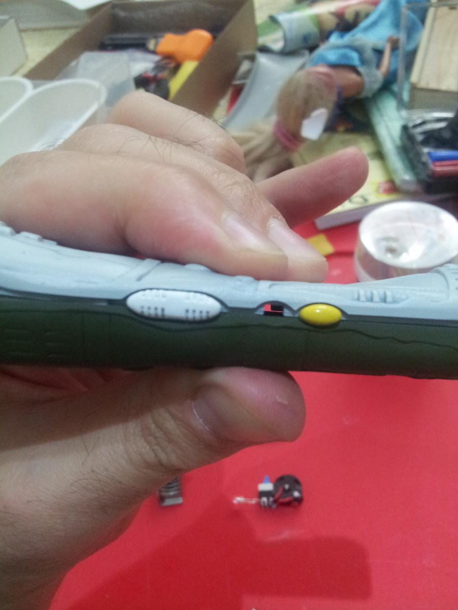

Xigfrid Posted December 7, 2015 Posted December 7, 2015 (edited) Here is some Zentran love. I'm looking for some ideas on how to temporarily seal the hull on a capital ship after electric wiring inside. For smaller scale builds like this 1/20000 Arii kit, if I glue the seam line closed, I wont be able to access the wiring later. Any links or tips appreciated. I have been thinking about a similar setup. First you can't definitively seal the model with the battery inside because sooner or later you will have to replace it. For the switch I thought of making a 3D printed battery cage with a thin and flexible tab where you can glue a micro magnet. To close this flexible tab acting like a switch, you would need to use an outside magnet too, which would be more or less visible. This is how far I went with this idea. Don't know if it can help for your project! Derex, that falcon looks really great! Edited December 7, 2015 by Xigfrid

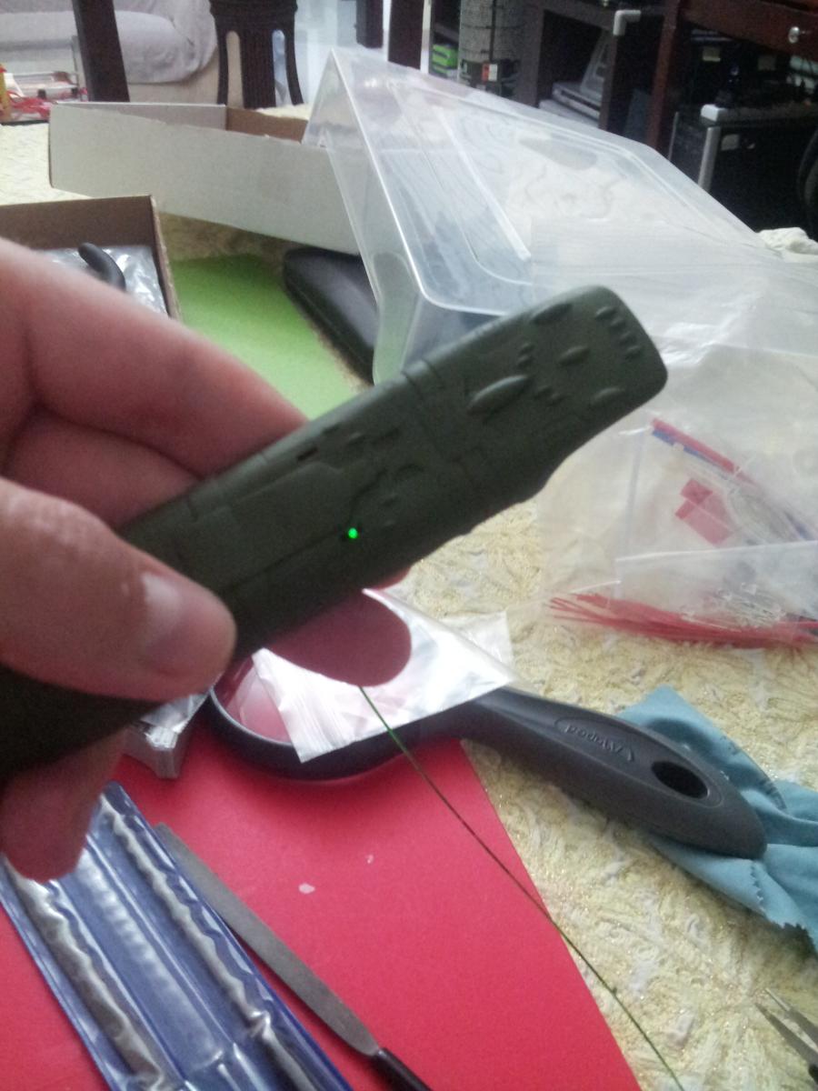

arbit Posted December 7, 2015 Posted December 7, 2015 Testing the lights on this vf-0s hasegawa, old kit. Needs some touch ups for a proper photo shoot. Interested to know about your battery setup inside that kit. I am finding that multiple LEDs really drain batteries fast, especially since we can't fit a 9 volt battery in these kits. I have tried stringing three small 3v batteries. But the drain is very fast, even with resistors.

MechTech Posted December 10, 2015 Posted December 10, 2015 (edited) @Arbit - why not try using strong magents along the seems or micro flat head screws with nuts (I've done both). @Derex - That Falcon came out AWESOME for a $35 piece of plastic! Hopefuilly your boss appreciates it! That sucks about your dad, but cool you have photos of him up. I lost two grandparents to Alzheimers and it was sad to see them slowly not know who I was. The good news is at least you can remember your dad! - MT Edited December 10, 2015 by MechTech

NZEOD Posted December 12, 2015 Posted December 12, 2015 I have been thinking about a similar setup. First you can't definitively seal the model with the battery inside because sooner or later you will have to replace it. For the switch I thought of making a 3D printed battery cage with a thin and flexible tab where you can glue a micro magnet. To close this flexible tab acting like a switch, you would need to use an outside magnet too, which would be more or less visible. This is how far I went with this idea. Don't know if it can help for your project! Derex, that falcon looks really great! Try Induction charging for a battery setup. You'll never need to swap out a battery then. The model just has to be placed on an induction charger to recharge the cells.

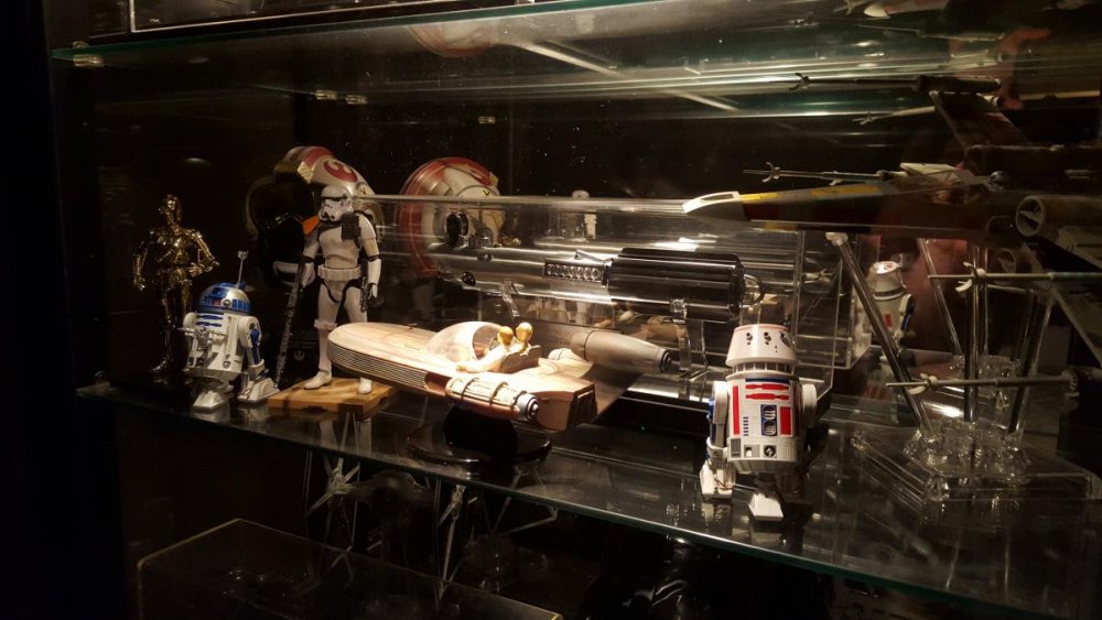

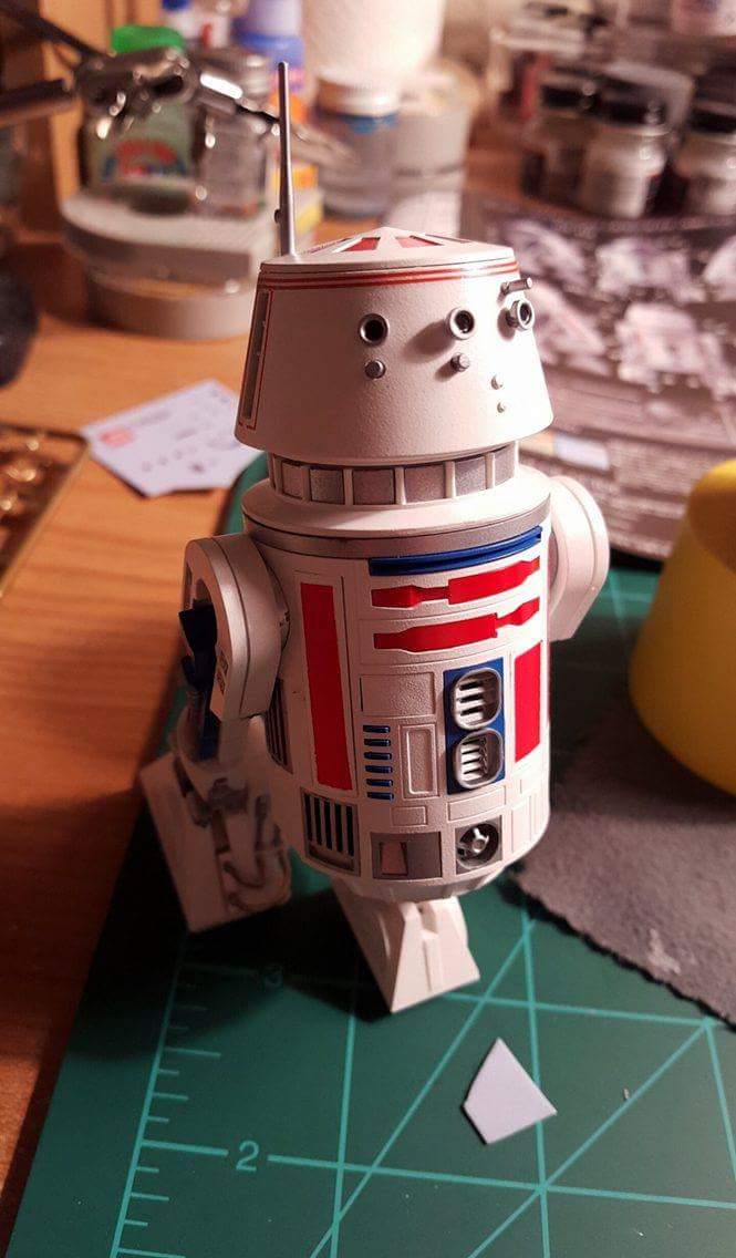

derex3592 Posted December 13, 2015 Posted December 13, 2015 (edited) With the Falcon out of the way, I finished up droid number 1 this morning. R5-D4, 1/12 Bandai. All parts painted on the sprue with Tamiya spray paints then snapped together. No glue used. Need to decal and maybe some wearhering later. Gotta finish R2 next. Sorry for the sideways pics. Edited December 13, 2015 by derex3592
NZEOD Posted December 14, 2015 Posted December 14, 2015 (edited) Thats come up good for a quick job! Just because I'm an idiot and like loading on the work, I had an idea after seeing one of the boys from the unit dual wielding airsoft carbines during the Xmas function shootout at the local Ex Mental Institute Paintball place, Asylum. He was with his back to a wall on a corridor corner, both rifles held upright pointing up at the ceiling grinning like an idiot while the OP force team were hammering rounds down the hallway... Reminded me of the scene from the old activision game Heavy Gear... link below, go to 0.41 to see the moment. I'm working on a dual wielding Fighter mode VF-1 and had the idiotic idea of building a scene with a Battroid version of my Dual wielding VF hugging a street corner wall of a building thats getting shot up. The building will have beam cannon damage and feature flickering room lighting a partially collapsed wall facing. I may include a discarded ruined Super pack in the street likes its been dumped in a hurry by the VF, with exposed wiring and internals and maybe if I can do it, a lighting effect to look like an internal fire or sparking. Xmas project... Link for a diorama building lighting project. Liking the lens angle on the LEDs they use! http://www.instructables.com/id/Creative-diorama-lighting-with-the-Arduino-and-TLC/ Edited December 14, 2015 by NZEOD
spanner Posted December 14, 2015 Posted December 14, 2015 With the Falcon out of the way, I finished up droid number 1 this morning. R5-D4, 1/12 Bandai. All parts painted on the sprue with Tamiya spray paints then snapped together. No glue used. Need to decal and maybe some wearhering later. Gotta finish R2 next. Sorry for the sideways pics. Nice! but are those the droids we're looking for?

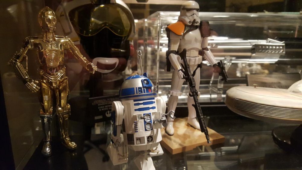

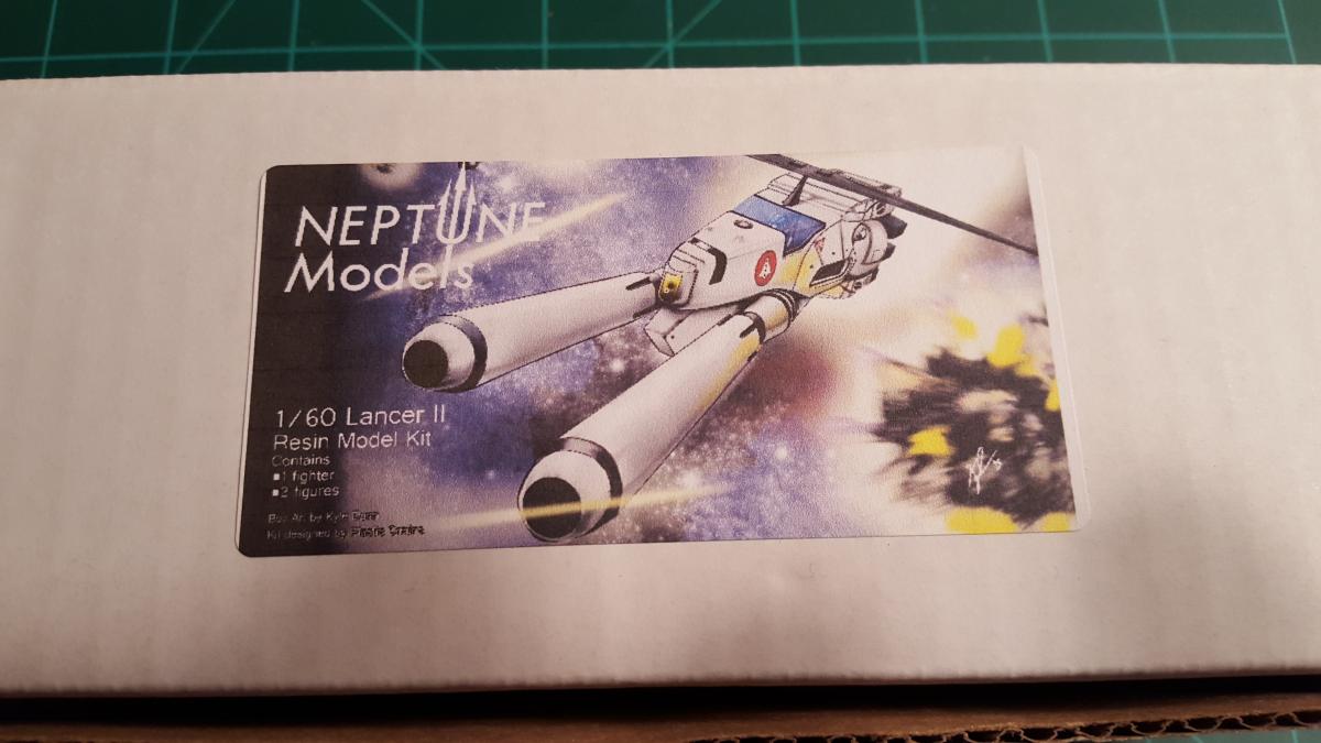

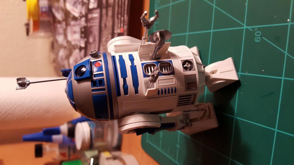

derex3592 Posted December 21, 2015 Posted December 21, 2015 yes! They were! Now I need to get the BB-8 kit, which happens to be coming soon bundled with another R2 which is fine with me, there's a couple of things I want to do different on my next R2. Here's a few pics of the finished product, the BB-8 box front and my next project I think I'm gonna tackle.

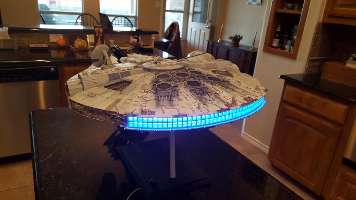

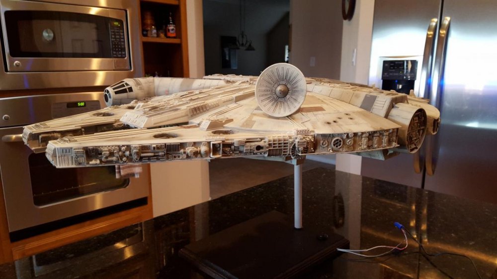

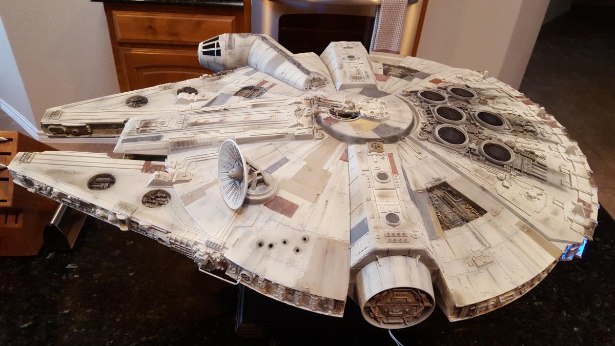

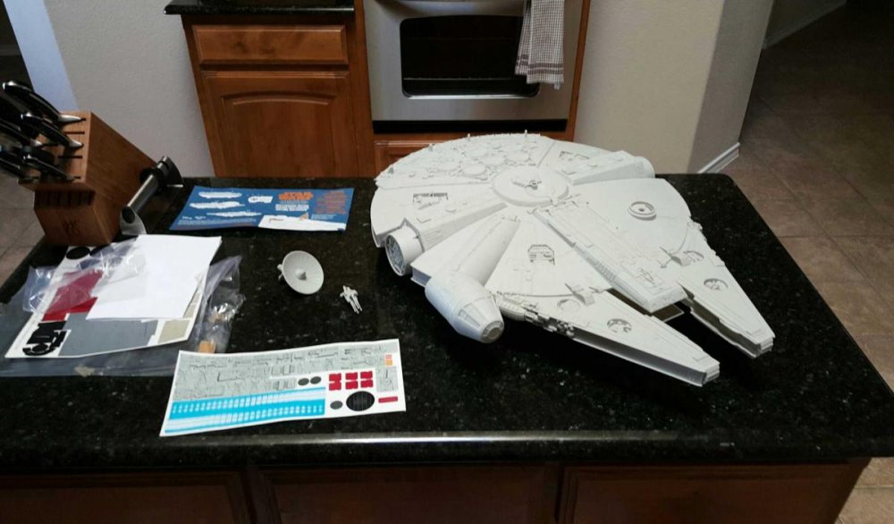

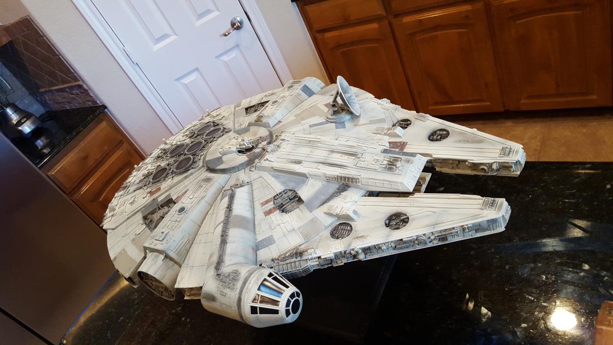

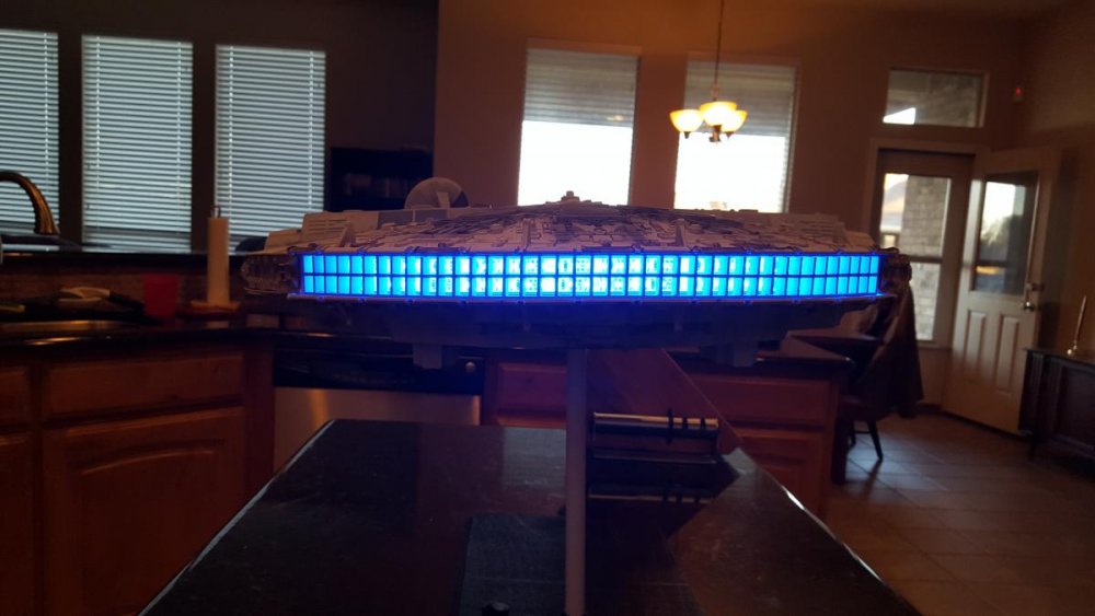

derex3592 Posted December 21, 2015 Posted December 21, 2015 (edited) Final beauty shots before he goes to his new home tomorrow where a very excited 5 and 8 year old boy and girl who are both huge Star Wars fans await! Edit... Final pic of when we started! Edited December 21, 2015 by derex3592
DarkArchon3000 Posted December 22, 2015 Posted December 22, 2015 That Falcon is Beautiful. Awesome Job!
MechTech Posted December 23, 2015 Posted December 23, 2015 That came out GREAT Derex! Beautiful job all around and the lighting really makes it stand out! Congrats to you and to the two children who will receive it! - MT
