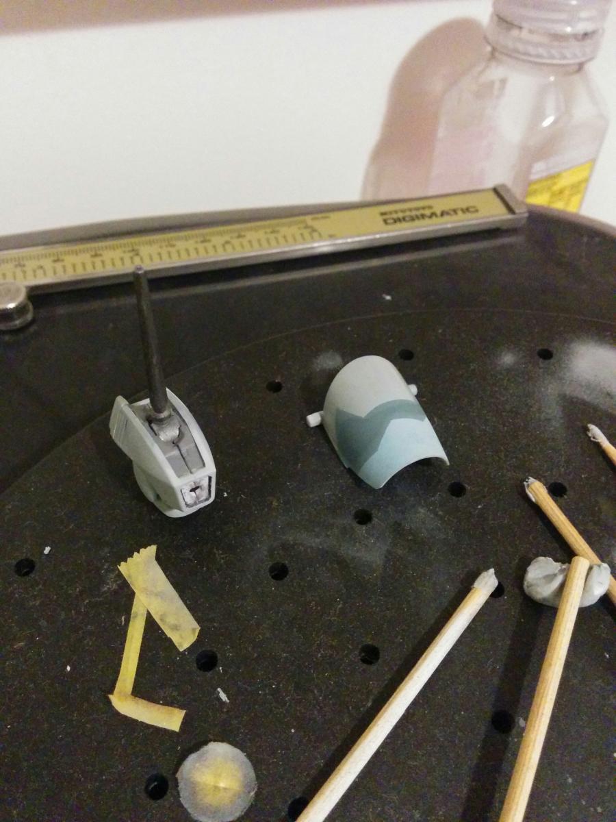

mickyg Posted November 4, 2015 Author Share Posted November 4, 2015 It's been much longer than intended but I'm finally putting a bit of time back into this little project of mine. I've started quite a few things in the last little while and it's about time I returned to the things I started first, in order to get them out of the way. When we last left off, I was debating what colour to paint the intake "trunks" and trying to figure out what would look good. Given the shallowness of the intakes, I have decided white will look way too stark. So I think I'll go with slightly whitened base gray (Light Ghost Gray). But I didn't do that in this session. Instead I focussed on the only change I've made in this project since I started it, painting the VF-1A head unit. Why did I switch out the head? Simple - I'm cheap! I bought a VF-1A kit when they were still mostly available for non-crazy prices and figured I'd swap the heads around and build a Focker VF-1S out of the new kit, and put the 1A head on the NSAWC custom. Of course that means I'll have to revise that little tiny decal on the back end of the legs but that's for another time. So here's the progress: I've been deliberating about the colour scheme for the 1A's head and honestly, I'm not much closer to a decision. The underside is still plenty visible in fighter mode so I'm hesitant to put much on it that'll stick out. I may still do something but it'll need to be subtle. No, the head is not tucked in in this shot. First up, the "eye" on the 1A - Yamato did a really great job with putting some details behind that simple square lens piece and I wanted to do something to bring it out. There are around 7 dots of various sizes and complexities that can be picked out with a bit of work. The most prominent is the center one, which serves as a mounting post for the lens itself. I thought I'd try my luck at making this look like a camera lens. In order to achieve that look, I went with purple around the outside and blue for the inside circle. Getting there. I think I've said that before though... At this point it looks exactly like how I want it to. So on to some other details. Bits picked out with Tamiya Smoke and clear red, here and there. Closeups can be brutal. This one shows the bubbles in the blue paint, as well as the "smeary" quality of the other transparent paints I mixed up. But flipping it over revealed a nice look that I was happy with. So on to the transparent green for the rest of the lens. I decided to paint just the back of the lens and leave the front clear, figuring it'd help as far as durability is concerned. So far, so good. Unfortunately, once I mounted it inside the recess of the head, a lot of that detail looked overly bright. I toned it down some with some smoke and then decided to "enhance" some of the features with a bright metallic gold paint I've got. It's Mr Color Super Gold and it's a lacquer. Lacquers dissolve most anything you apply them too. Oops... It's not all bad and I don't have any pics of the process that led up to the finished result, so I'll come back to that. I wanted some reflectiveness behind the lens so rather than painting the whole back (which might be the right way to go, in hindsight) I just painted the surface of the recess. I used good old Tamiya Silver in a paint marker, as it's still one of the better silvers out there from actually looking like reflective metal paint. Here's the head dry fitted together, with some preshade and the silver applied. For the record, black is one colour I cannot get to spray properly through my airbrush. It almost always dries on the tip and just sputters everywhere when it does spray. I don't seem to have this issue with any other colour. So this was as good as I could achieve as far as line thinness is concerned. And here's the lens fitted: My final task was to get some gray on the head. I went with the Light Ghost Gray of the lower body and did my best not to obliterate the black shading underneath, then followed it up with some lighter gray by mixing white with the base coat. It's far more subtle than I'd intended but I can follow up with it later. The middle part of the top of the head was done with Gunze Gunship Gray (FS36118) but misted on so as not to be too stark. The metal is Mr Color Iron and I drilled out the end of the laser barrel but couldn't quite get it centered properly, so I've sort of left just the tiniest indentation instead of going with progressively larger drill bits, as I'd intended. Quote Link to comment Share on other sites More sharing options...

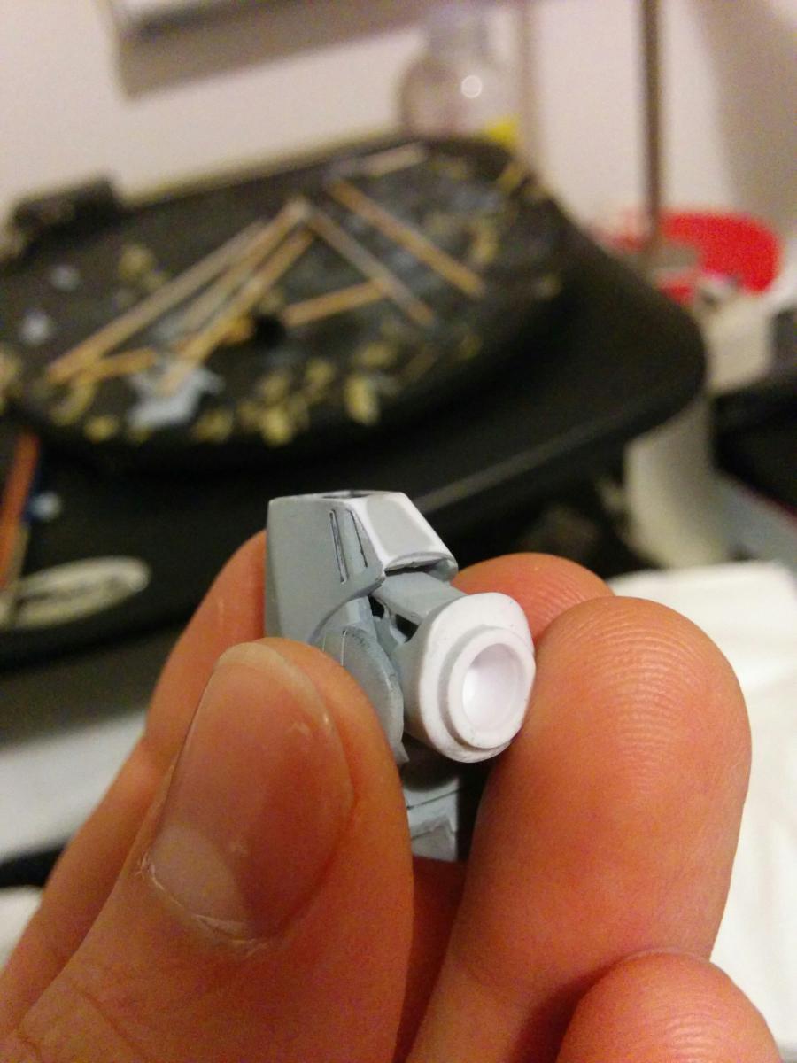

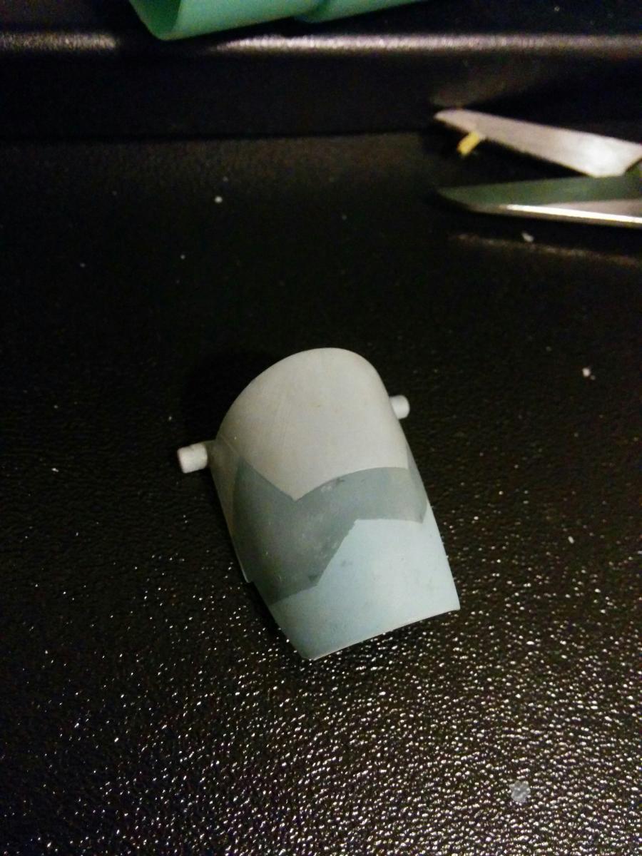

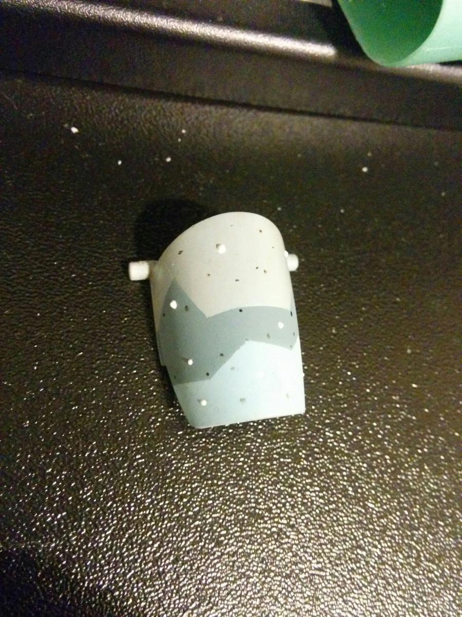

mickyg Posted November 16, 2015 Author Share Posted November 16, 2015 I decided after the last update, that I'd do my best to start spending a minimum of a half hour per day so I could get this thing finished. Unfortunately that didn't happen quite the way I'd planned. Life's been pretty complicated lately and the last week has been no exception. However, Sunday I managed to get a few hours in and I think that might have made up for it in the end. One of the items on any VF-1 that irks me to no end, is how close those silly fan faces are to the front of the intake. There's no good way to sort this out, because the hip joint is so very close to the fan plate on the Yamato toy. It is, what it is in the end. So my thought has always been that if I could "fade" the paint a bit, it might make it look a bit more like a shadow and have the illusion of depth. So, with that in mind, I set to do some things I haven't tried before. Namely with paint. I purchased some Mr Finishing Surfacer 1500 in both black and gray last week and thought I'd try that as a base. In theory, this is lacquer paint that should be a bit more durable than the typical acrylics. Case in point, the gray I'd brush painted on one intake, as an experiment, scraped right off with a toothpick. Here's a shot after I very carefully masked the intake: And yes, those things were a pain to do. And constantly wanted to pull off when I was cutting around the perimeter of the fan. But that's another story. Next up, using the black "primer" as a preshade base. I hate preshading with Tamiya black. It splatters, it seems to clump, and it just never wants to go down properly. So I thought I'd try something different. The Gunze Mr Finishing Surfacer, is as far as I can tell, Tamiya fine surface primer, in a jar. It's pretty thick in consistency and thins with lacquer thinner, or my new personal favourite, "Mr Levelling Thinner" which is a much more mild lacquer based thinner, with a paint retarder in it. The end result, even when heavily thinned (2 parts thinner to 1 part paint) is paint that is easily controllable and it goes down silky smooth. Finally, a black paint I can actually work with! And another item I'd really wanted to spend time on, the intake covers. These have always been something I thought had great potential. They're detailed and there are actual louvres that should be possible to shade. So I started with black preshading, but given how dark these parts are to begin with (sort of a dark bluish gray green colour) the black didn't really stand out. So I tried another new technique - mixing acrylics with lacquers! What is this magic I speak of? Well, all Tamiya and Gunze "water based" paints are compatible with their own thinners, in both alcohol and lacquer based types. So you can thin the Mr Hobby Aquous range with Mr Color thinner, and the same can be done with Tamiya acrylics. So I mixed up a batch of gray Mr Finishing Surfacer 1500 with some Gunship Gray and set to work on preshading, with various levels of primer gray thrown in to lighten it as I went. It's a subtle shade variation but I think it'll do nicely. Same thing done with the fan face, only with heavily thinned gray primer alone (and the effect is almost non-existent on these, which is a little disappointing): Once I'd finished, I mixed up some artist oils (black, brown and a touch of white) and filled in all the crevasses of the intake fan, and louvre lines in the intake covers. I also couldn't resist adding a bit to the back of the valk, as I've been dying to see what a bit of darker fill will add to the panel lines on the top, with all the camo: And after it had dried for a few hours, wiped the excess off with a completely dry tissue: And that's where we're at for the moment. Thanks for reading along! Quote Link to comment Share on other sites More sharing options...

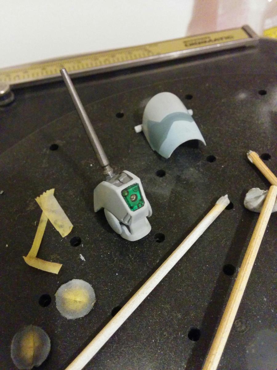

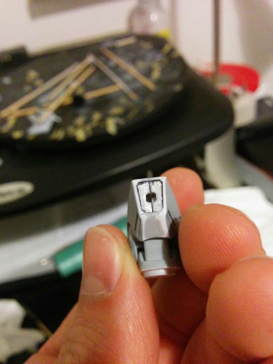

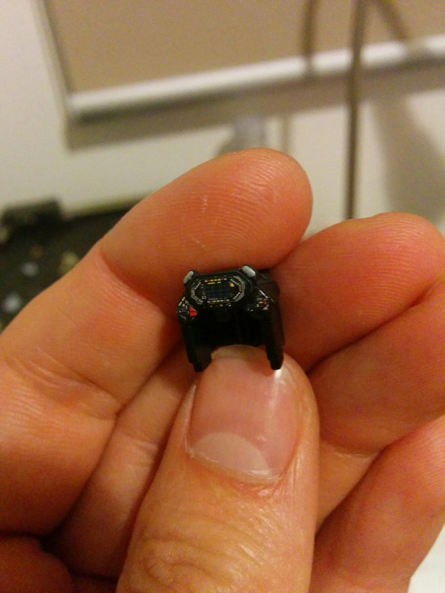

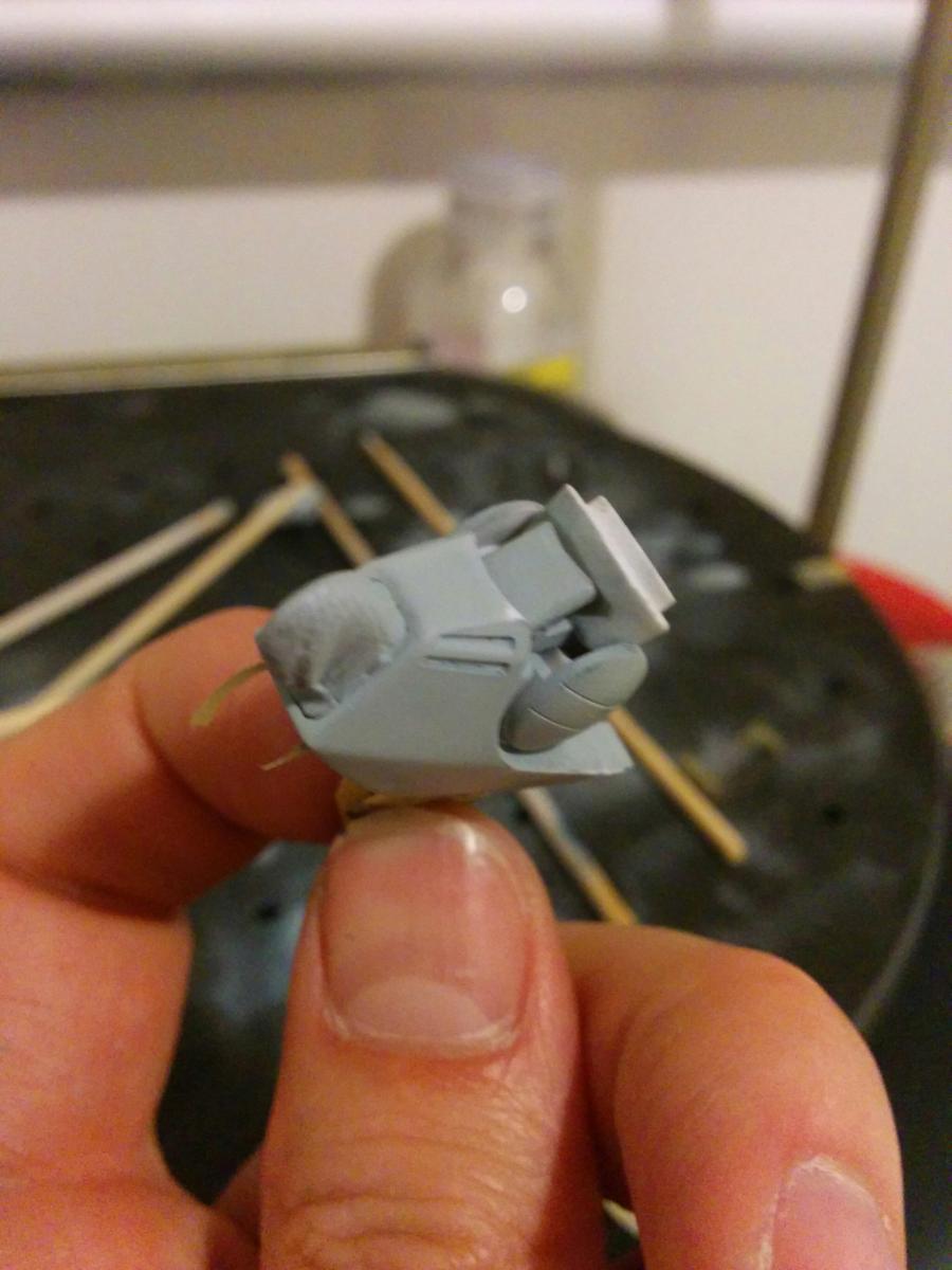

mickyg Posted November 23, 2015 Author Share Posted November 23, 2015 I wasn't satisfied with the seam on the head unit so I spent a bit of time filling that in with Mr Surfacer 500. My bottle is starting to dry up it seems so heavily thinning it with Mr Levelling thinner again, seemed to help a lot.No pics, unfortunately. Spent too much time doing little things and simply forgot to take them.Also back painted the lens assembly with silver. Didn't like the massive seam visible and there was no way I was going to be able to fill that in satisfactorily. It came up pretty nicely and I've got no problems recommending that approach to anyone else making this kit. I also silver painted the instrument faces, so they'll be reflective for the decals when I put them on. In hindsight, this was probably completely unnecessary, as the decals themselves are likely white backed. Lastly, I marked out some spots on the heat shield to dress it up a bit, and make it blend with the camo pattern around the fuselage. I'm still tossing up doing the NSAWC lightning bolt across the shield. It might be too much so I haven't decided yet. Quote Link to comment Share on other sites More sharing options...
MechTech Posted November 29, 2015 Share Posted November 29, 2015 Adding silver to the head clear parts is a great idea. I like to use the same technique myself. - MT Quote Link to comment Share on other sites More sharing options...
mickyg Posted November 30, 2015 Author Share Posted November 30, 2015 It works very well indeed. I'm not sure if it's quite subtle though. I'm thinking the camera/sensor unit now looks a little 2 dimensional. But given how slow everything is going, I'm reluctant to spend more time getting it "right" - whatever that is. Here are a few photos directly from my phone. Usually I upload to my google+ account and link to thumbnails, but again, that takes more time than I seem to have at the moment. Some seam work. The silver peaking out from beneath a freshly applied instrument decal. The extra silver will be painted black to match up to the black outline of the decal. The decals by the way, are terribly shaped and sized for the panels they go on. I had to carefully cut this one into three parts to get all three panels in the right place. Off the sheet, it's all one piece. The "masking" with blue tack inside the edges of the recess for the lens. Why bother? I'd lined it with black and you can still see this with the lens in place. Besides, masking with blue tack is a skill I need to work on. Because it's flexible, it tends to not stay where you want it. I used a toothpick to pull it away after I'd smashed it into place. It worked really well and was much better than trying to put it in place with fingers alone. Heat Shield and Head: And my first attempt at a dot filter. This is all three oils I currently own, brown, black and white. Mostly white was used as the other two are very strong. I used a toothpick and hardly any paint. Before brushing: After: Quote Link to comment Share on other sites More sharing options...
