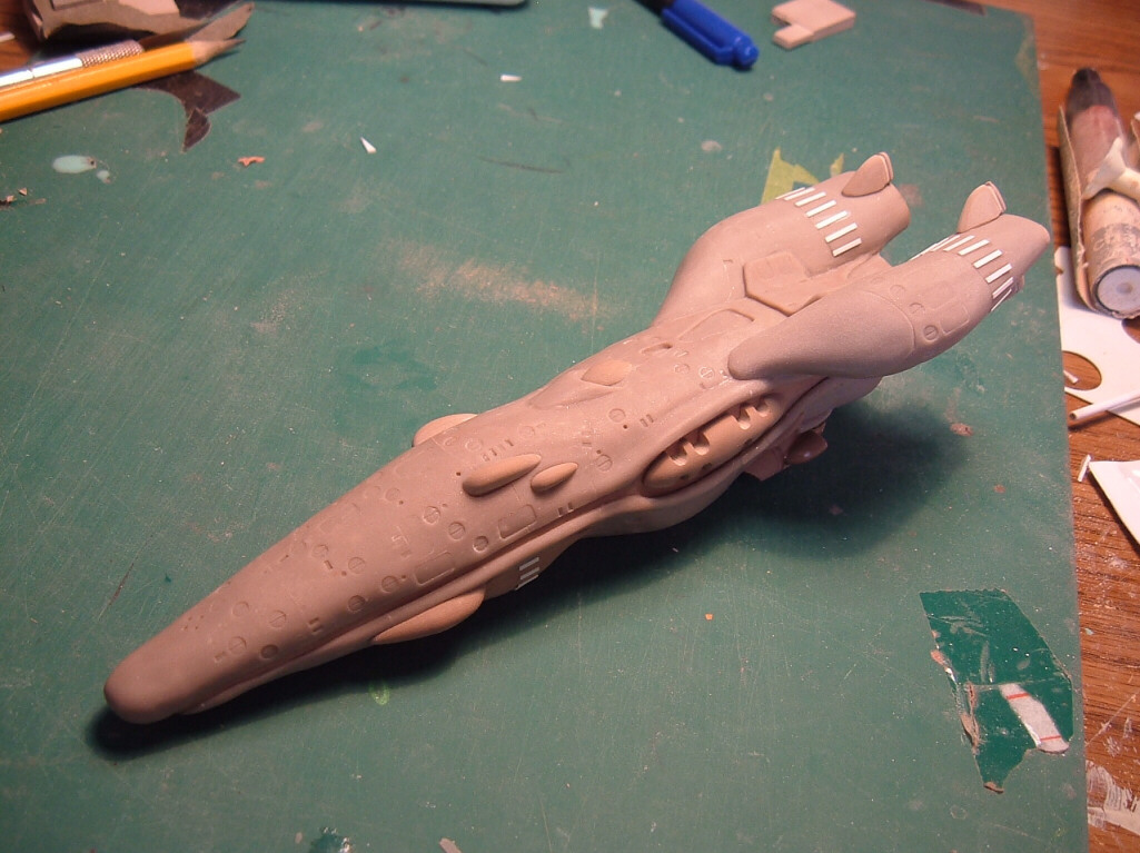

...So I got bored one day...

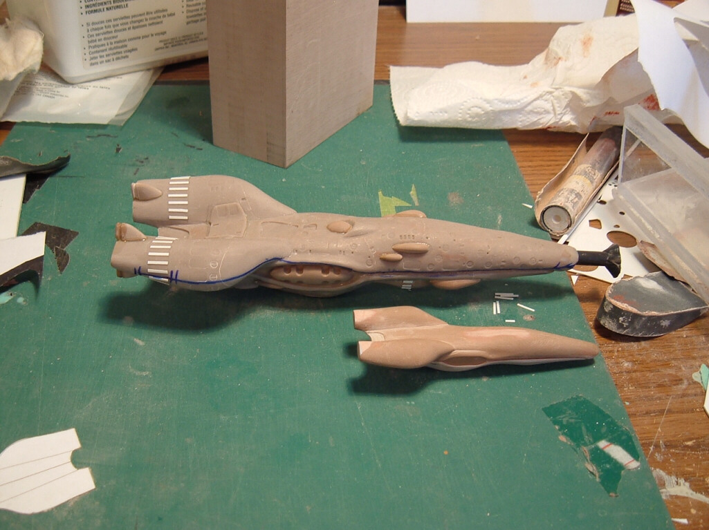

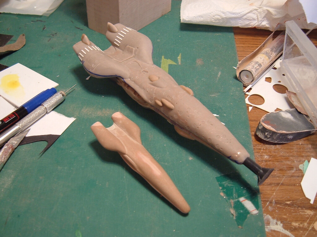

Oh, and here are a couple pics of the Salan Scout: 1/2500 and 1/5000. The latter is not yet done, but you get the idea :p

Hey John the blue line on the large one, I take it that's to be the parting line? Are you planning a single pour two -part mould?
Link to comment
Share on other sites
Yes! I wanted to put the seam lines in places that could allow them to be more easily repaired or camouflaged. It will essentially be a resin dildo :lol: :lol: :lol:
