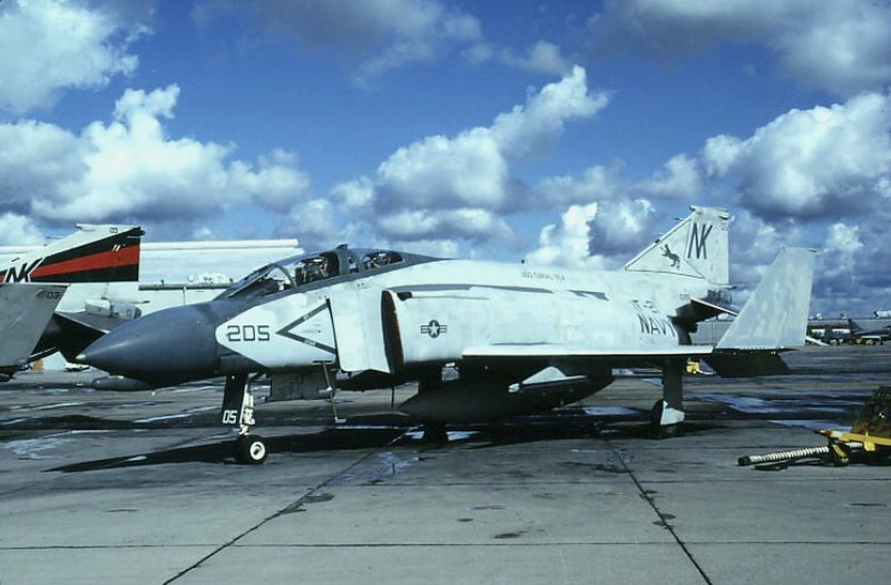

Berttt Posted September 23, 2006 Posted September 23, 2006 Great work there dude, I have some plans for what you are thinking, I have gathered that the boarding ladder might look similar to this:
Maxtype Posted September 24, 2006 Posted September 24, 2006 (edited) Great work there dude, I have some plans for what you are thinking, I have gathered that the boarding ladder might look similar to this: It's more like this-a bit hard to see,sorry. look for the spindly ladder under the intake safety triangles. Edited September 24, 2006 by Maxtype
