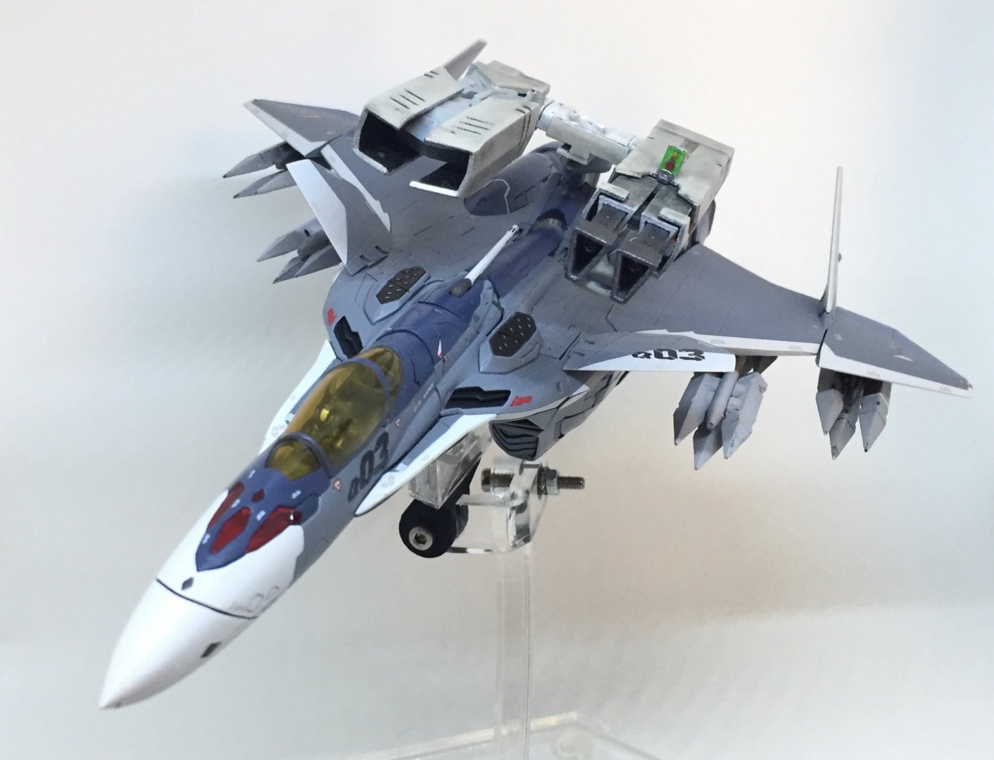

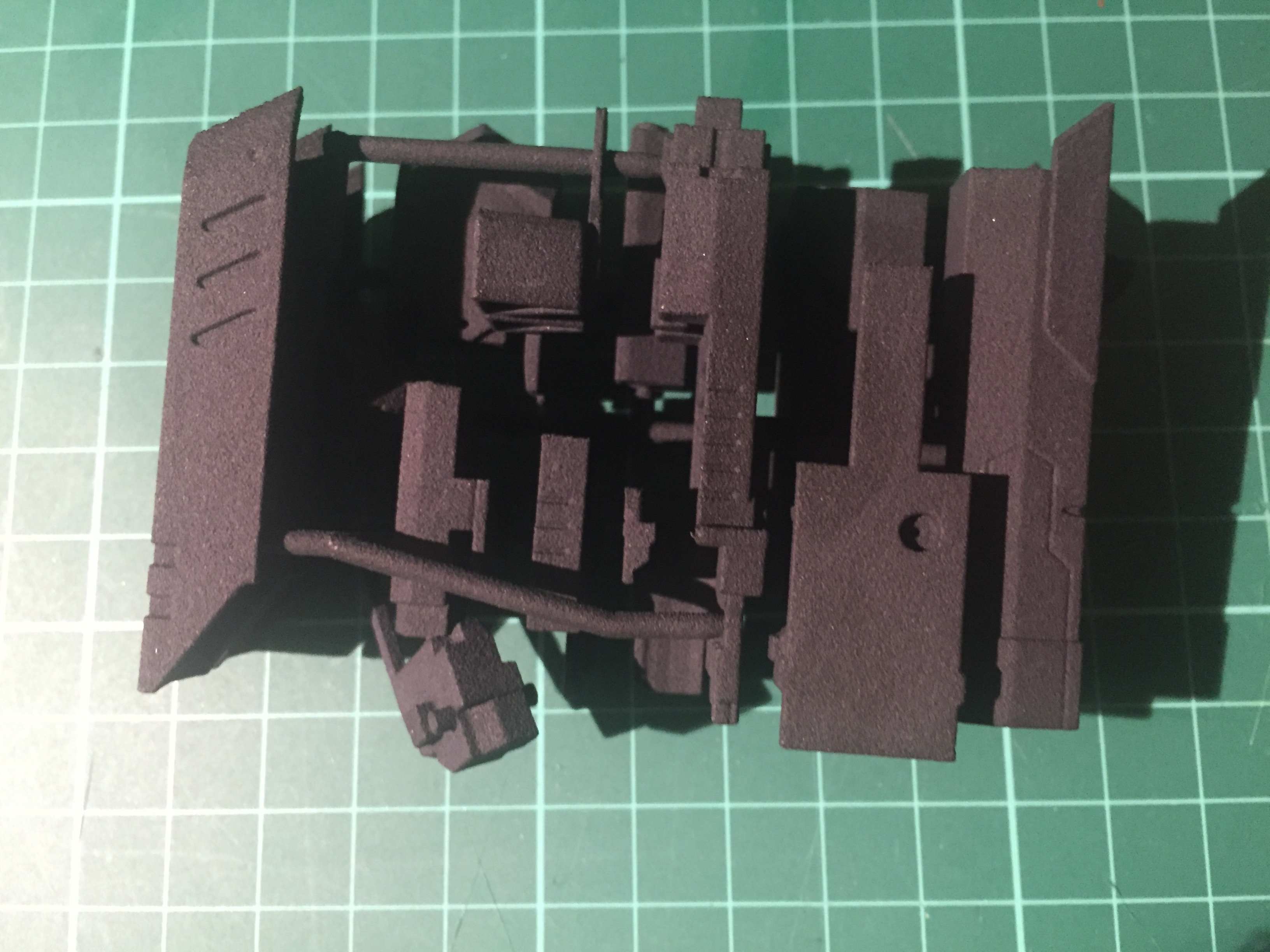

Xigfrid Posted December 6, 2018 Posted December 6, 2018 (edited) Got the “strike canon pod” (I love that name @wmkjr!) today in the smoothed black HP plastic. The quality of the smoothing process is really great compared to shapeways’process and I am very pleased with the whole model. I noticed that in this second copy the dual canons were a tad too tight to slide in and out so I had to sand them a bit, otherwise everything else was perfect fit. Next step would be to put it up at shapeways in standard plastic. I am still undecided for HP plastic, would you guys prefer to pay twice but getting it from shapeways locally or going through longer delays and additional shippings from Europe? Edited December 6, 2018 by Xigfrid

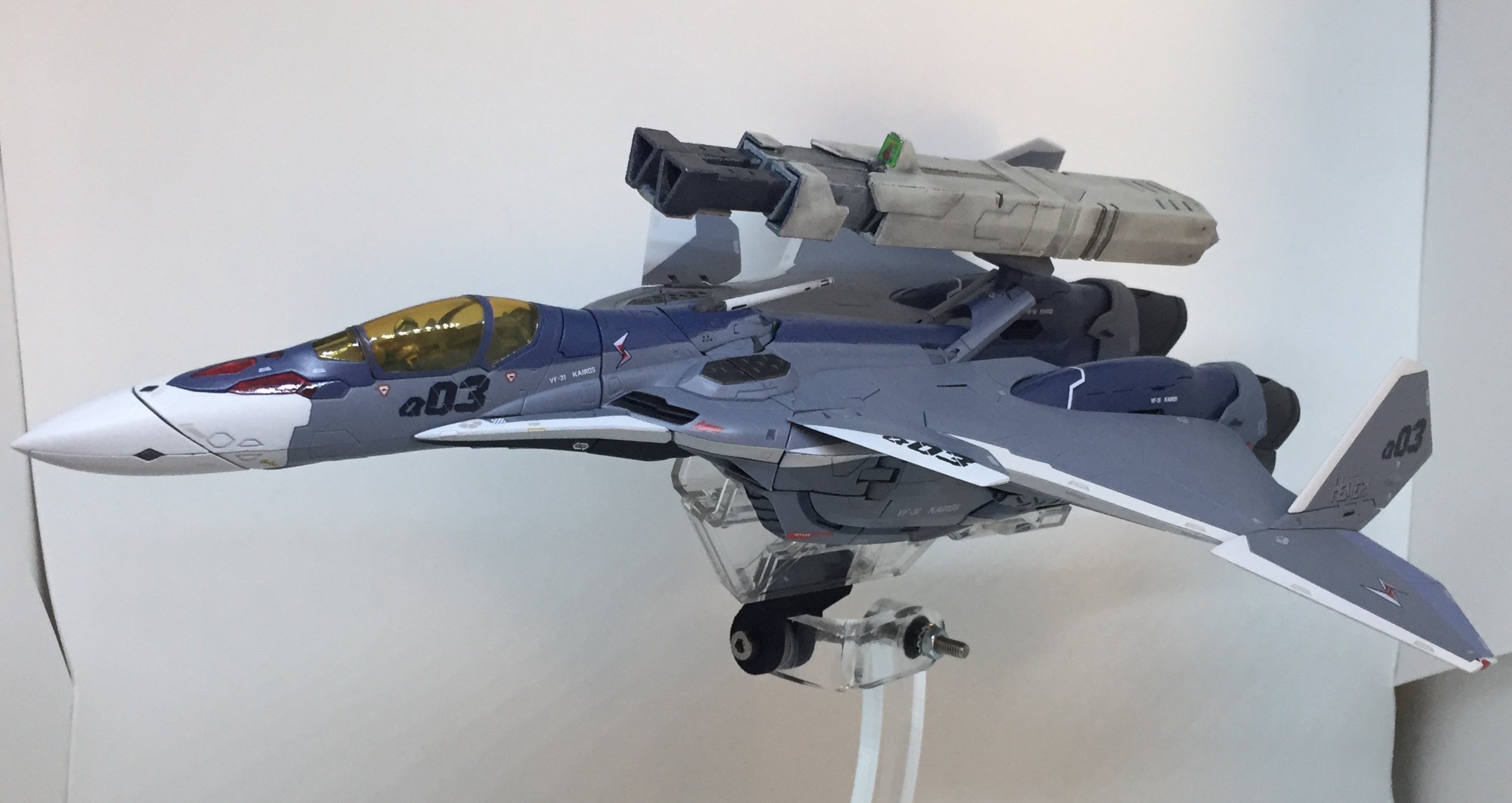

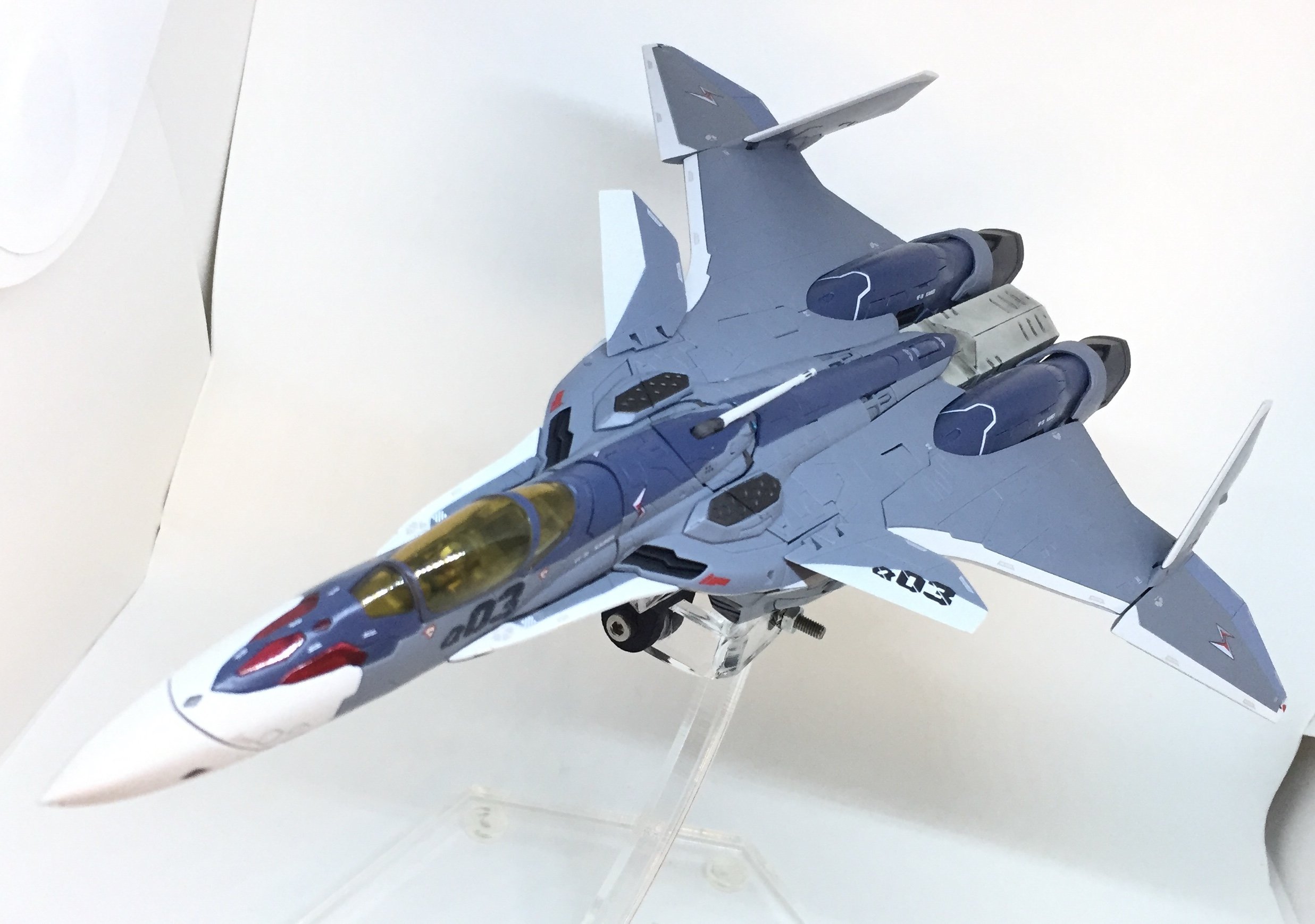

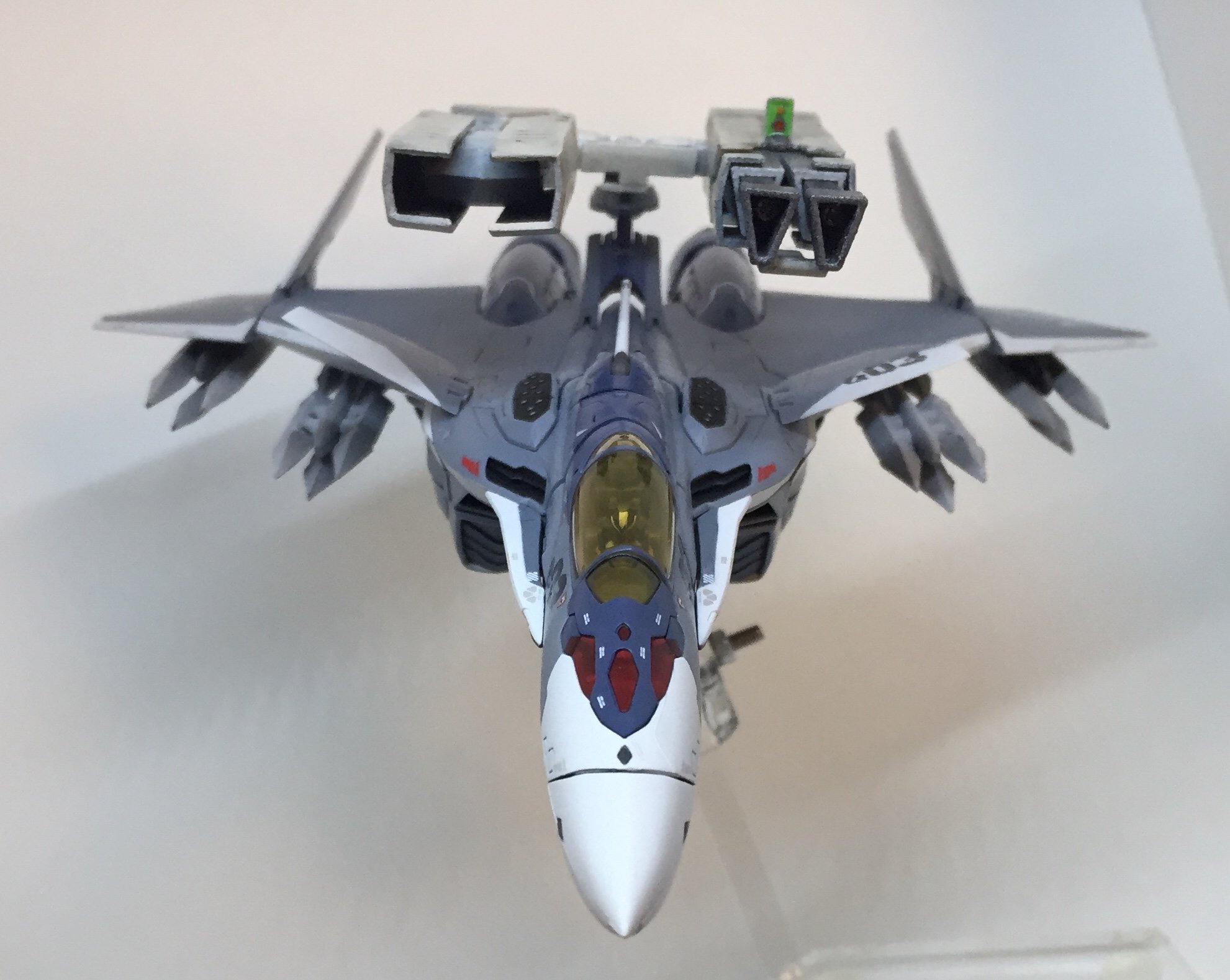

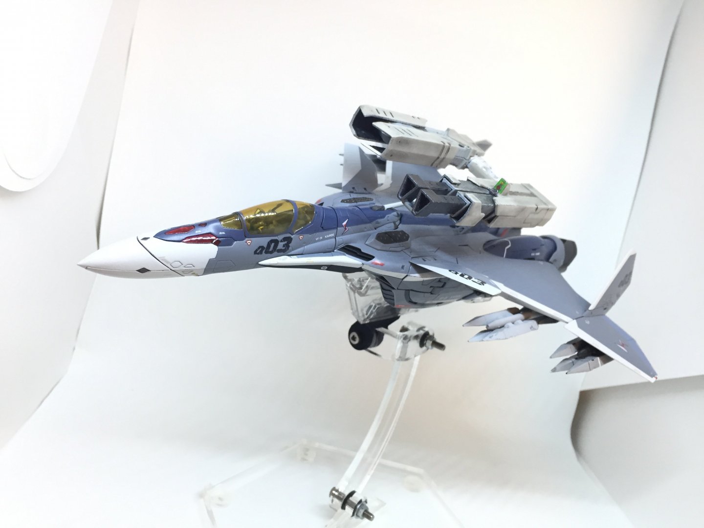

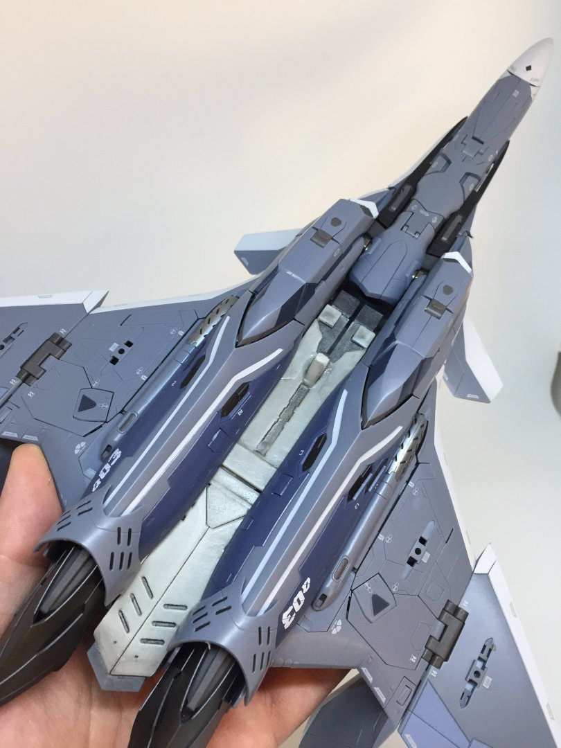

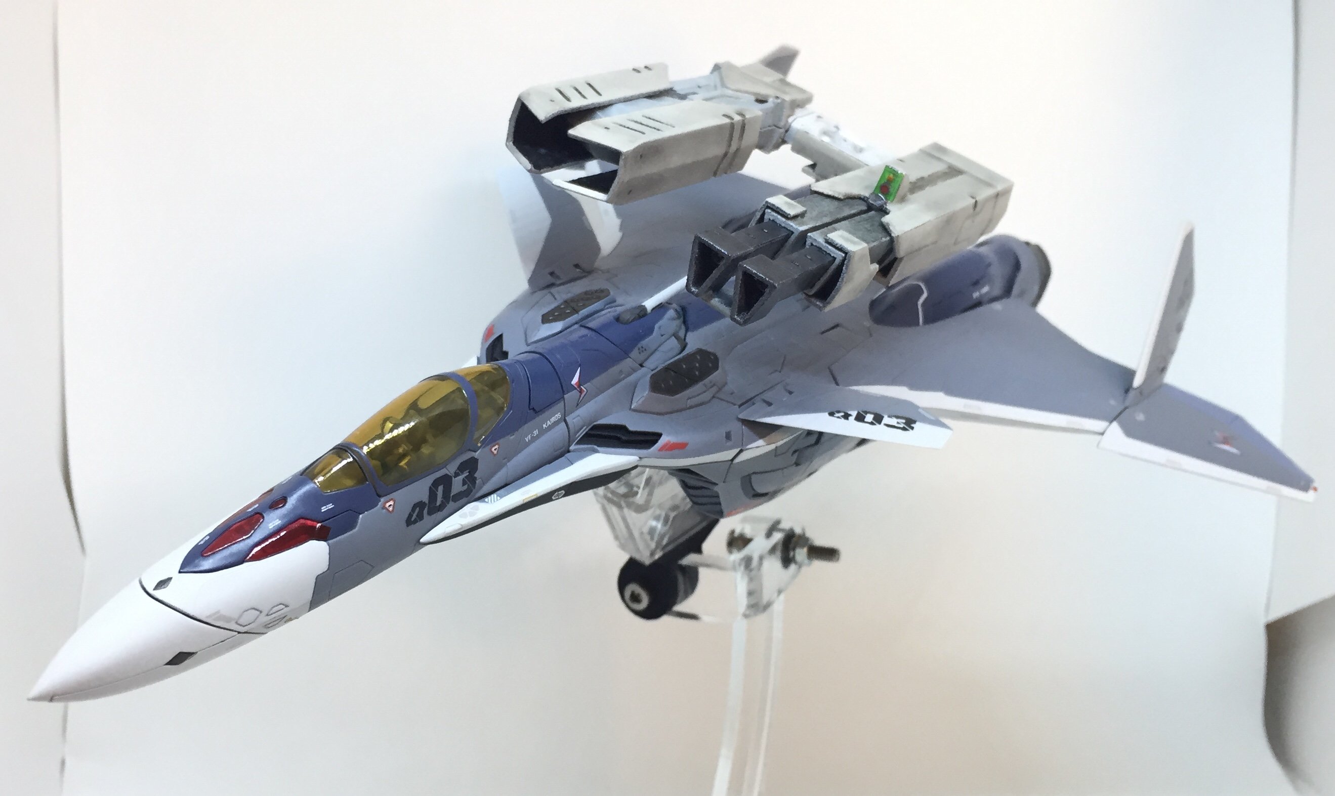

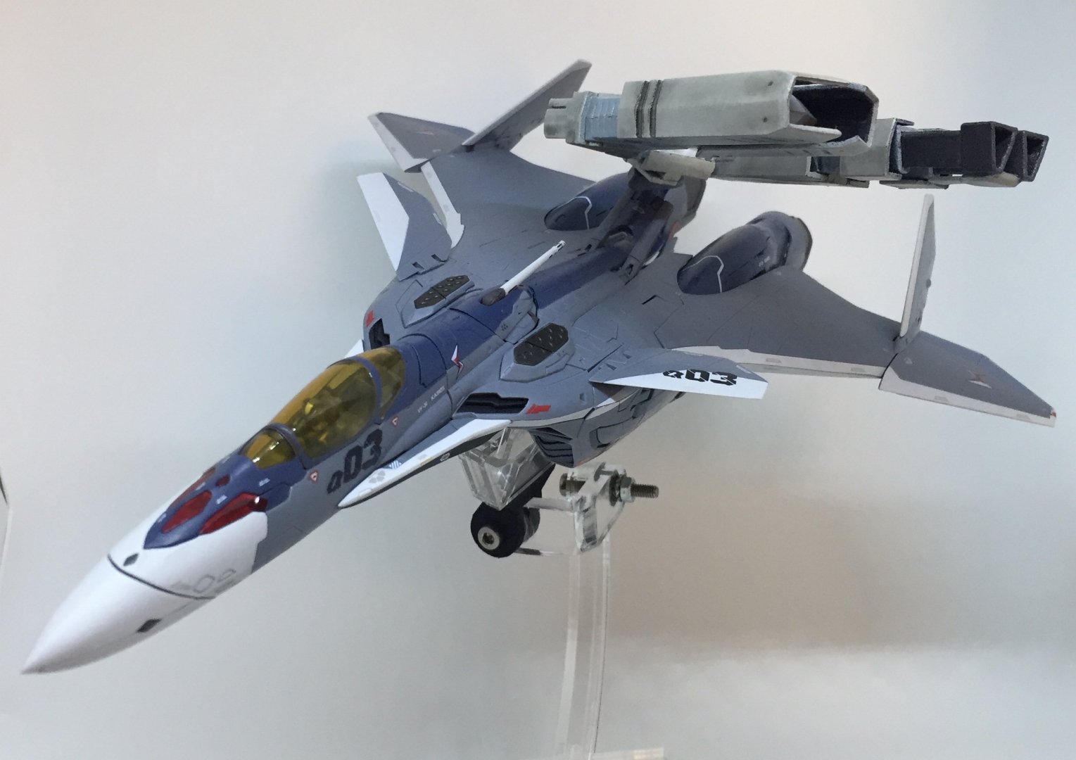

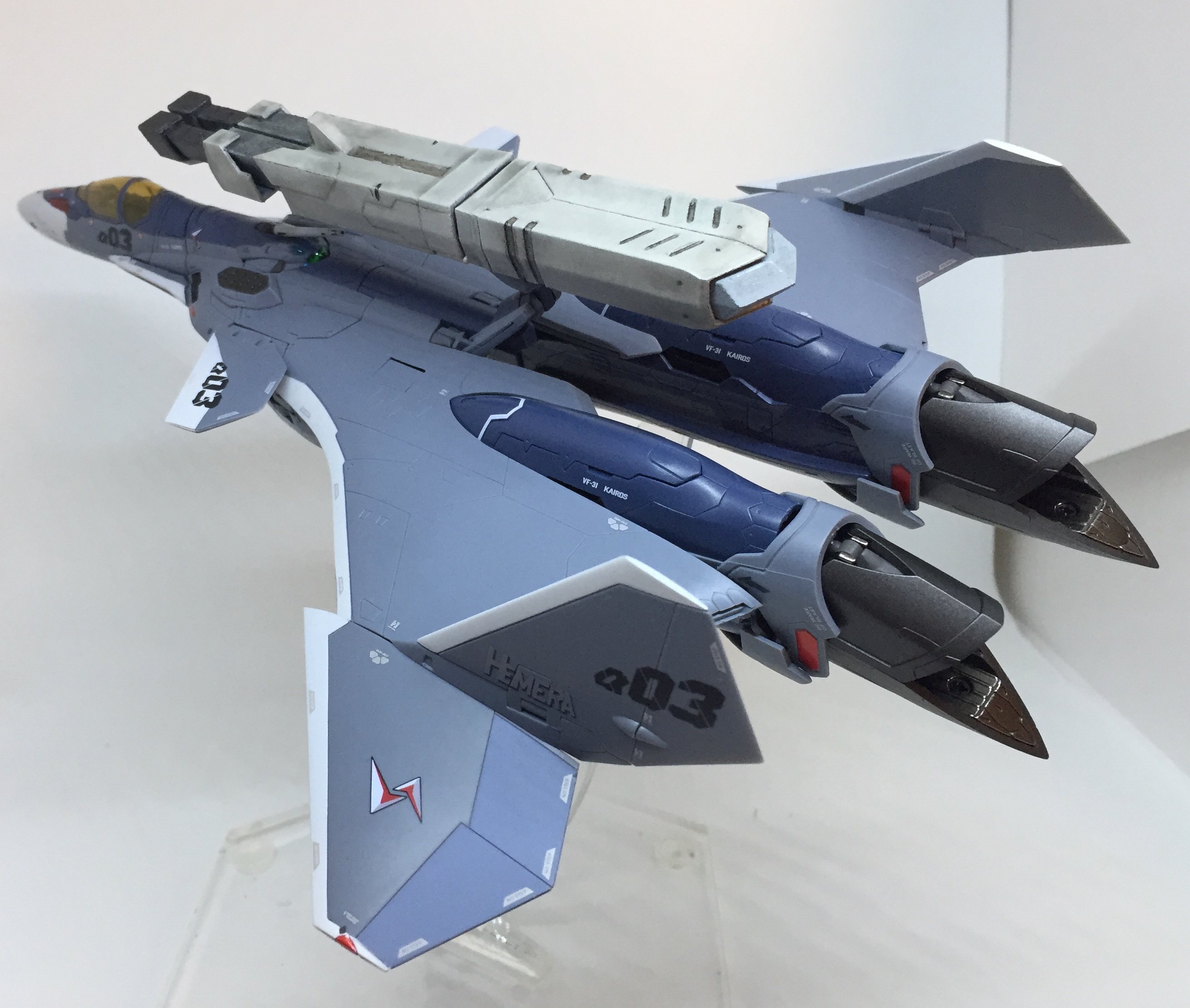

Xigfrid Posted December 12, 2018 Posted December 12, 2018 A few pictures of the Kairos that I finally unwrapped from its shipping carton.

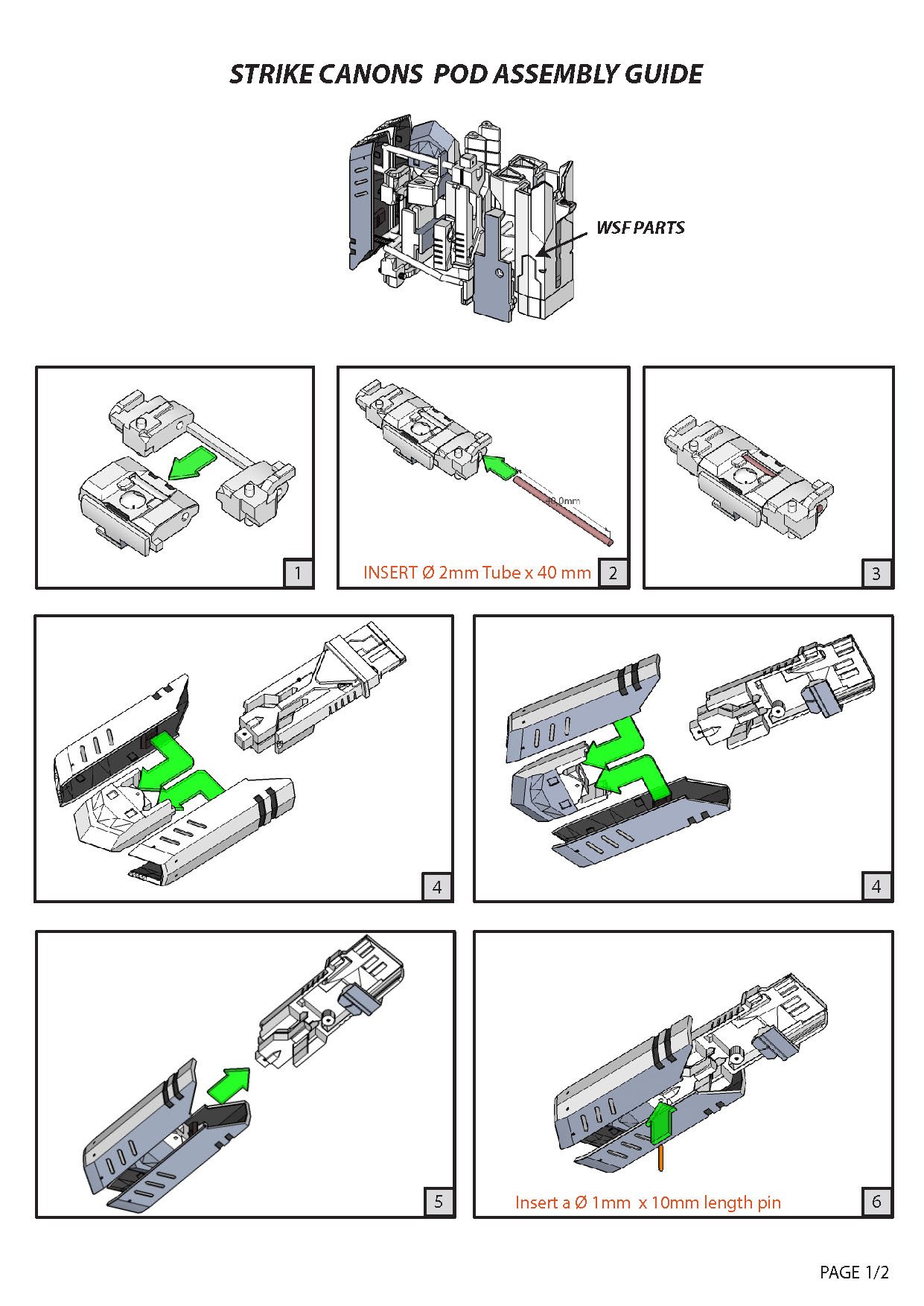

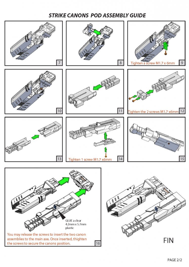

Xigfrid Posted December 14, 2018 Posted December 14, 2018 (edited) Here is the assembly manual for the Strike Canons pod If you can't read the PDF, here are the pictures of the manual Edited December 14, 2018 by Xigfrid

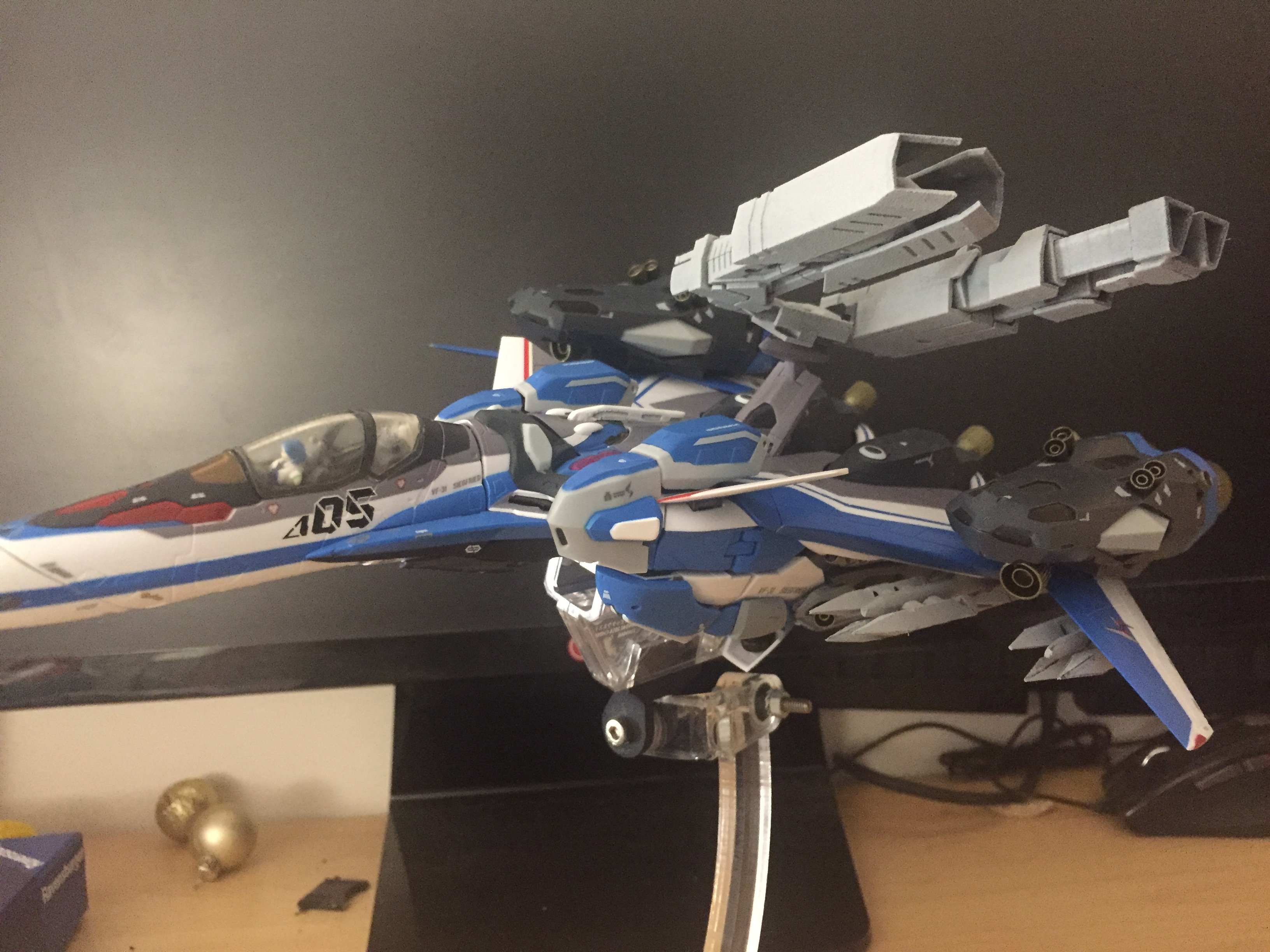

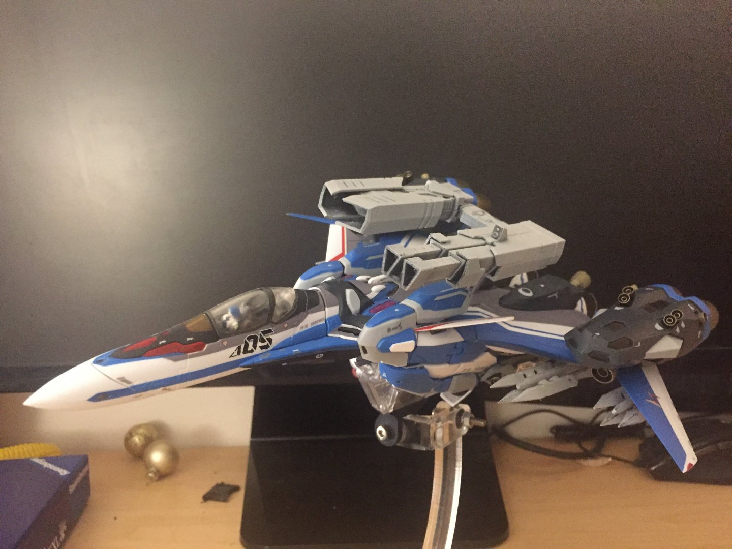

enphily Posted January 23, 2019 Posted January 23, 2019 My work in progress. Need a second layer of paint. I have some floppiness when it's collapsed but maybe that's my fault
Xigfrid Posted January 23, 2019 Posted January 23, 2019 Nice to see pictures of the pods ! @enphily, if it is loose in close position, you probably fix it with a thick semi clear layer. On the opposite, I noticed that a few parts with thicker than expected tabs, like if the parts were melted too much, that would make the guns a bit floppy in the open mode. The fix is to clean (sand) the tabs on the middle axe that lock the plasma gun until they lock in place firmly. Or to clean the edge of the rails where these tabs go.
