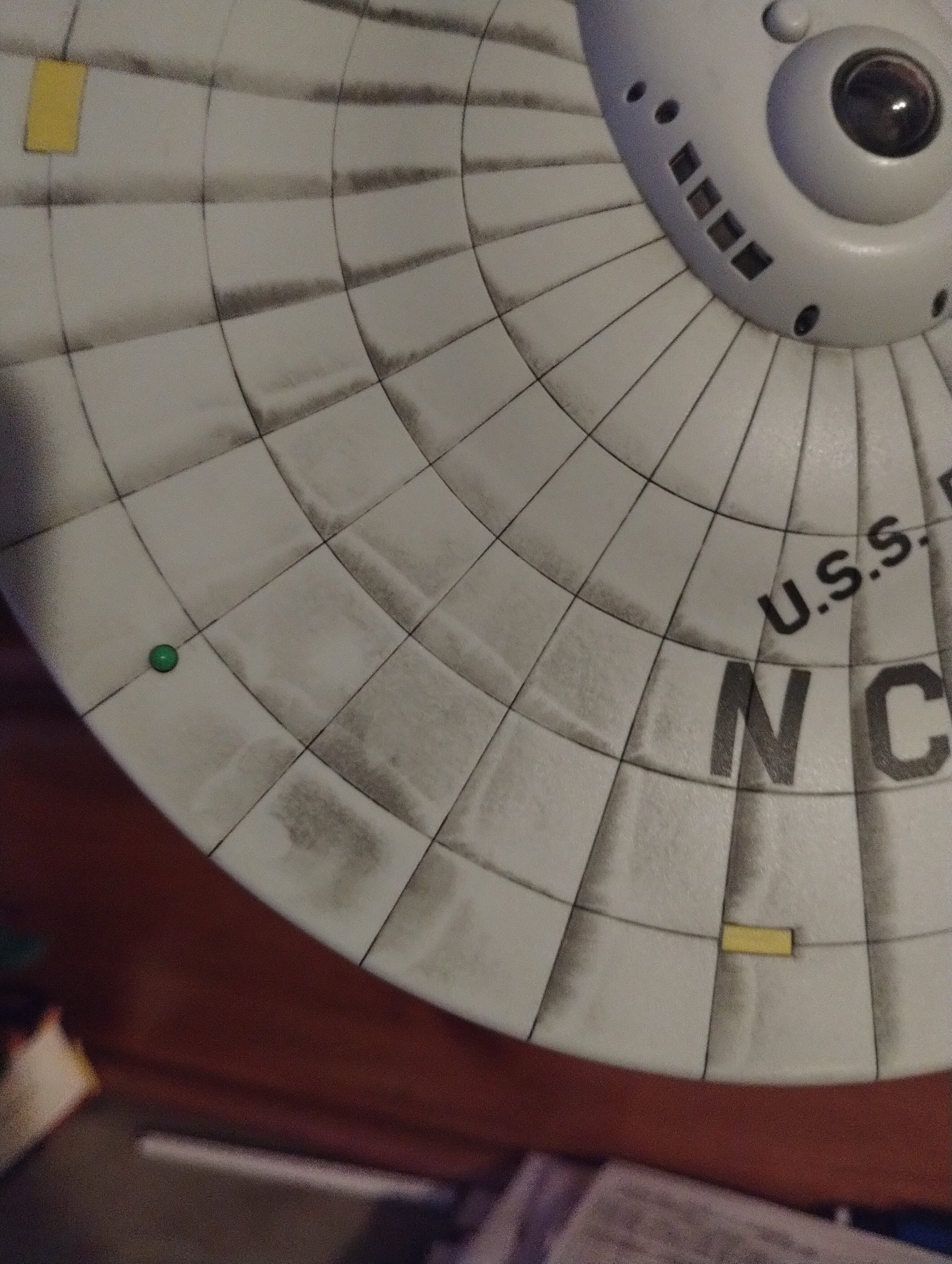

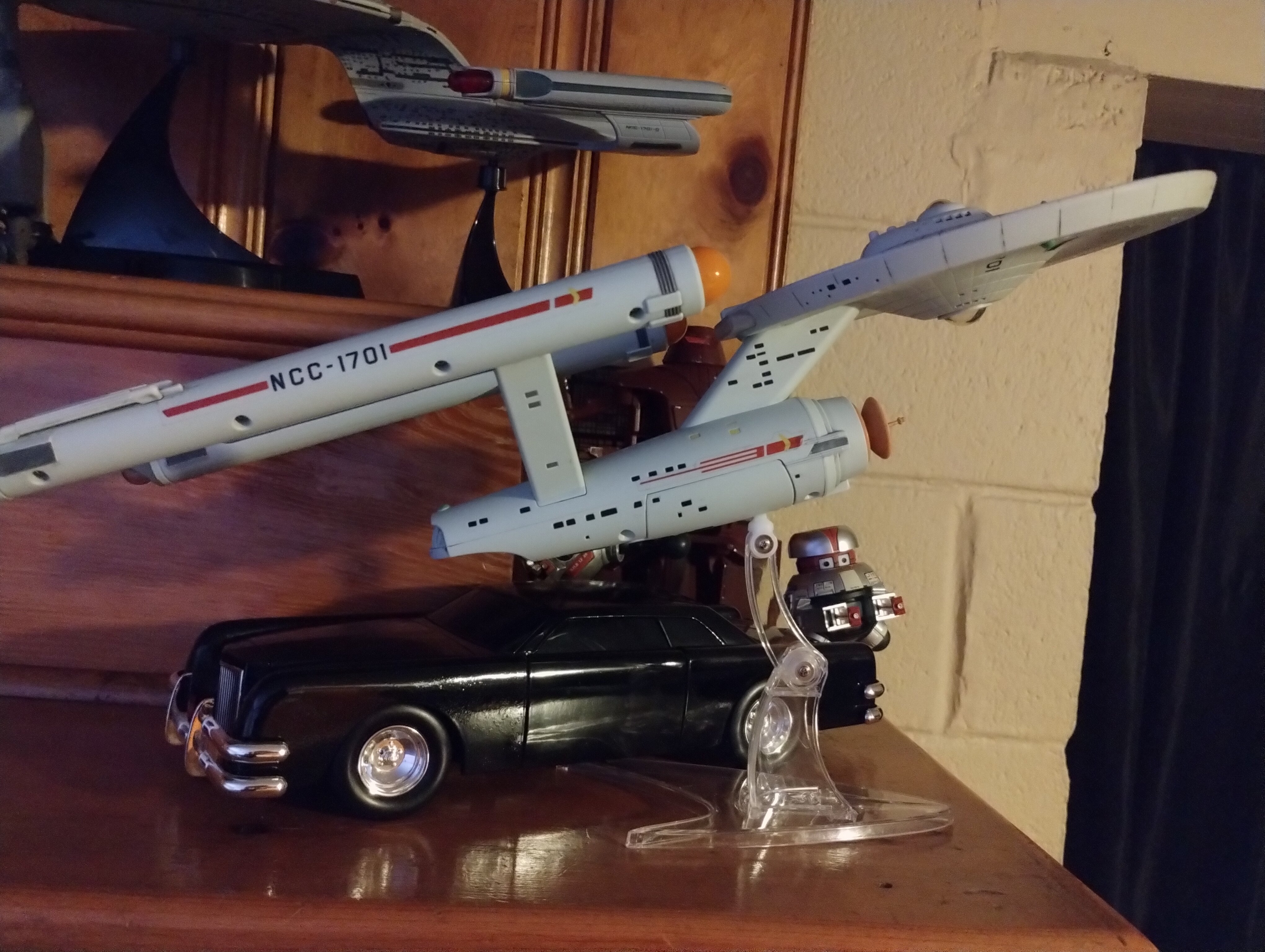

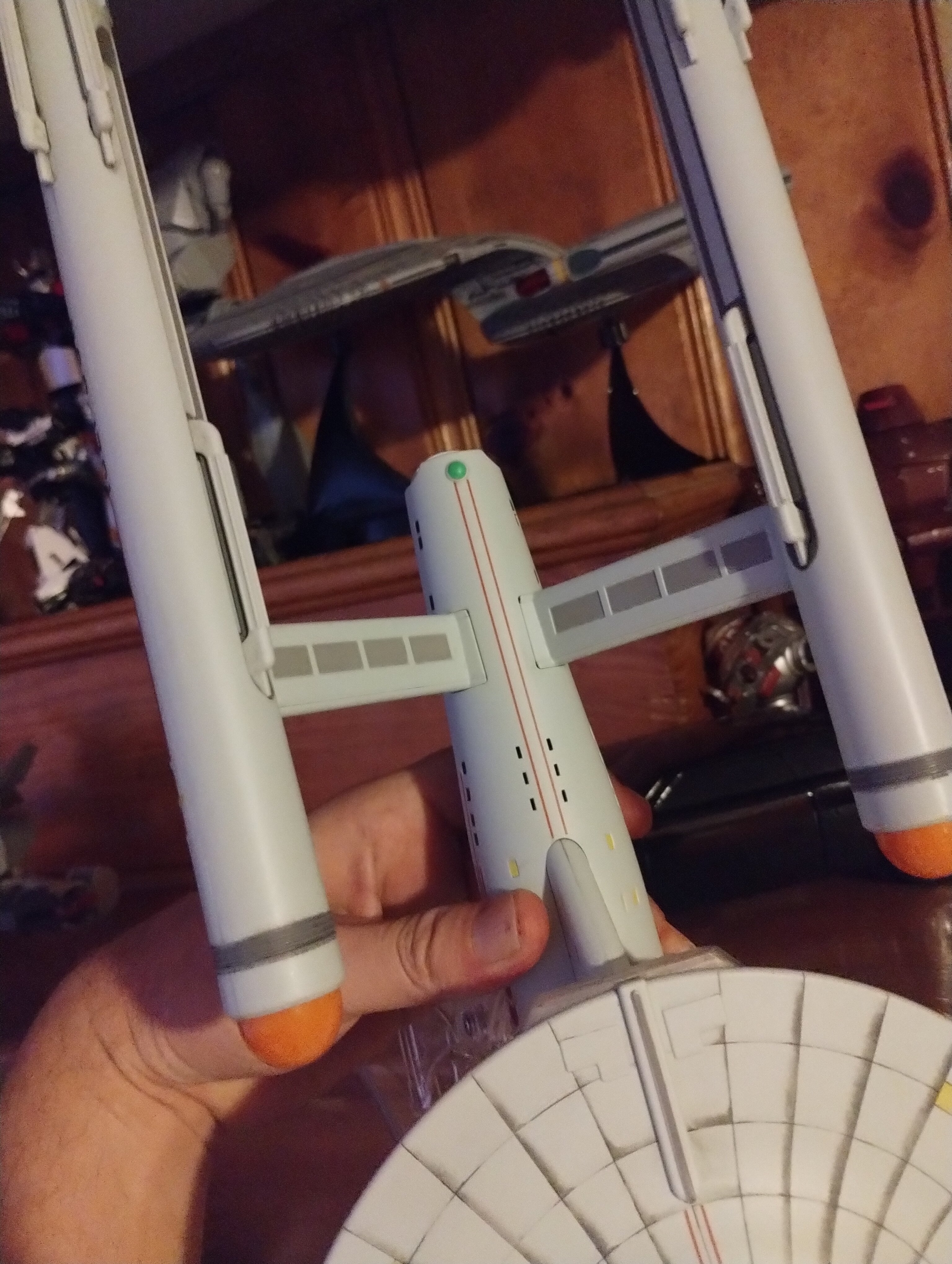

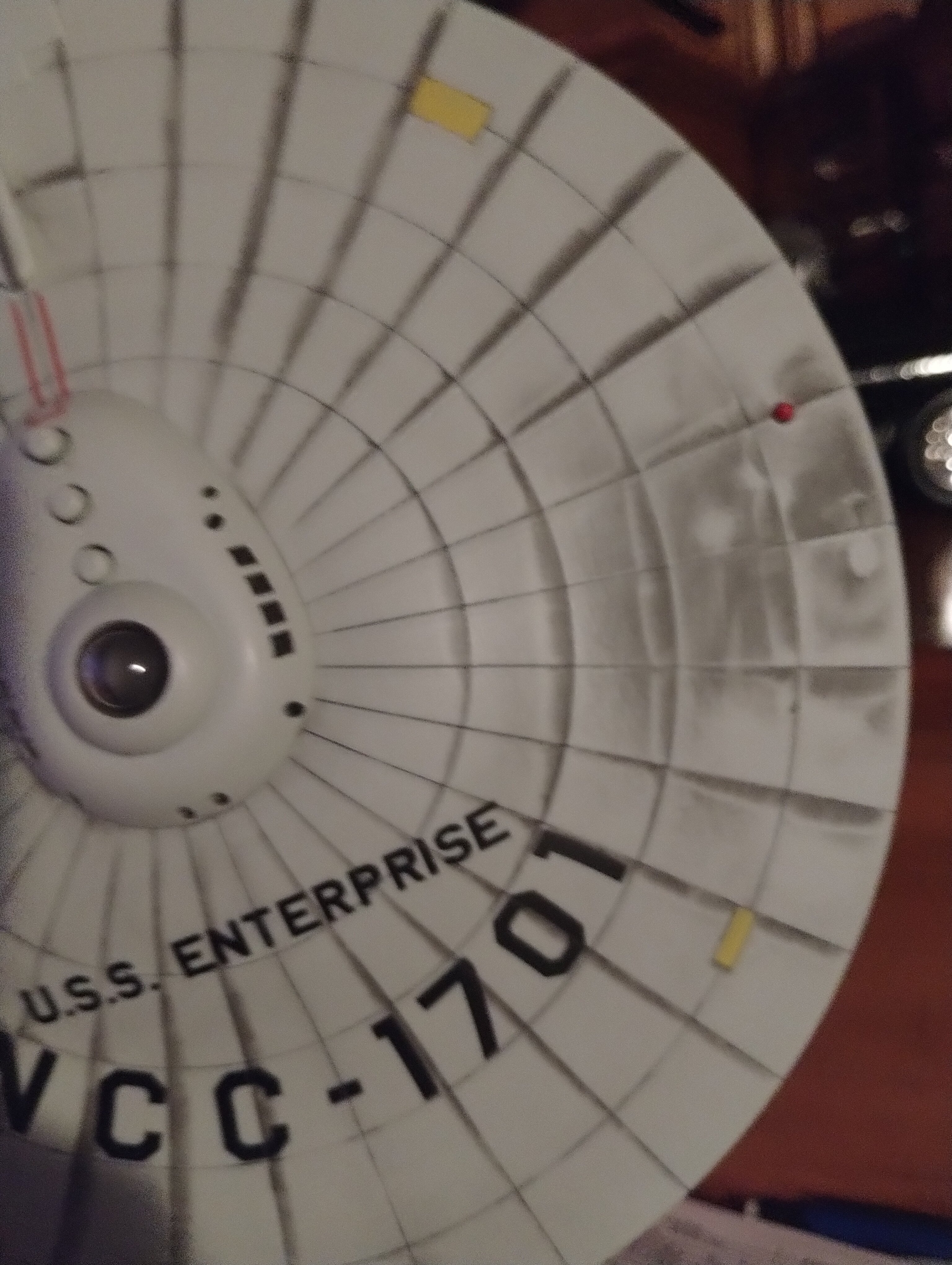

1 hour ago, nonner242 said:
I didn't even clear coat top saucer yet..it was the rest of the ship that was tho. Yup Tamiya is the brand..have not had good luck with it on any models..just toys mostly. I'm about to go back to my ancient way of lining..just dilute my stuff. Lol.
Something different with this plastic..sure it just didn't work with Tamiya..the rest of the ship is totally different originally and shiney. Now I just flat matte the whole thing while I figure out next process.
Don’t blame yourself, that Tamiya is the destroyer of models. It’s just way too hot for a lot of plastics. It’s basically thin solvent glue with a bit of paint. And it’s particularly bad with Abs and some soft plastics. It barely works for styrene under proper conditions. It’s kinda like playing Russian Roulette with your models. You might get god results on a few, then there that one loaded chamber or devastation. And all it leaves in its wake is just heartbreak. The worst part about it is that it usually works great the first time, then that time it doesn’t, you start questioning yourself and your methods, when it’s really just the product itself.
tricks like enamel and oil washes work well as panel lining with thinners that aren’t as hot like mineral spirits or zippo fluid. Acrylic and water based ones work well also and are a bit safer, but take a different method to clean up.
Damn..well I'm never using it again. This is the second time I thought I did something wrong with it..like stated by big s I was questioning myself again. But yeah it does seem like Russian roulette. I'll be doing a non abrasive was for sure now. Prob should throw out all my Gundam marker too. I don't like the pigment ..look dark blue to me not black. And there brushes not marker ones..tend to never gravity feed like they are supposed to. Oh and the cleanup on them is questionable. Most times I still get pigment left that never wants to erase. Its finished at time but bug the crap out of me.
Homemade is were I started and where I should stay🤔😆

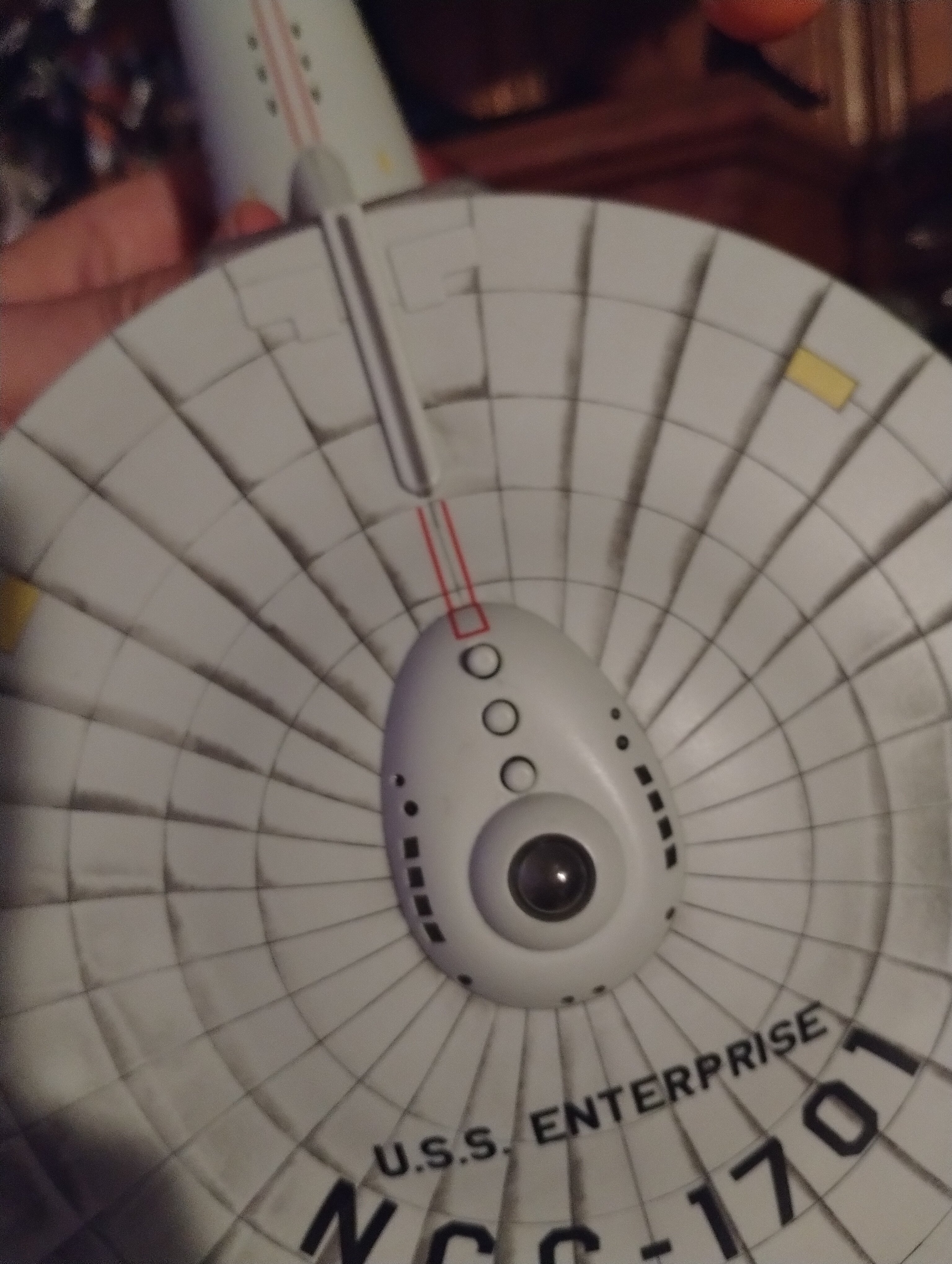

The rest is fine and matte coated again..but that dirty blurred saucer🤮
Looks a little toasty, but I kinda like it. Maybe do a light grey or white wash to tone it down a little.
@sketchley If its not too late (just saw the post), plain ole' Acetone is perfect for ABS. It WILL cement it together.
@nonner242 WOW! That sucks about the panel lining. I think I only use it on bare plastic. The ingredients are part of the same formulation for glue! I guess the Flory stuff would be MUCH safer. It's only a clay. - MT
Flory's ALL the way for panel liners. The Tamiya stuff is just too risky to paint jobs for my liking. It has it's uses but only in very small areas and I've had more failures than successes with it. It cost me an entire Bandai AT-AT kit years back and that was heartbreaking.
I know most would as well, but I wouldn't use Tamiya panel line without a good, solid clear coat under it. That being said, Flory's is great stuff!
 I remember that story from a while back. I felt really bad for you. If I remember, it melted the joints or something. It made me more cautious about my own work. And I’ve also had issues with the stuff. It’s really sad to see so much work go into a project just to have it destroyed by the #1 recommended product at the hobby shops for panel lining
2 hours ago, Big s said:
Even with the clear coat cured for a couple days, the stuff is iffy. I’ve seen more than a few do the proper steps and have it work fine on most of their kits and then randomly accidentally have a masterpiece turned into a wreck diorama or just plain garbage.
Yeah; they need to pull this crap from the market. Talking heads on Reddit claim "you're doing it wrong, only use it on unassembled models", but the entire point of finishing  is to weather it at the end.

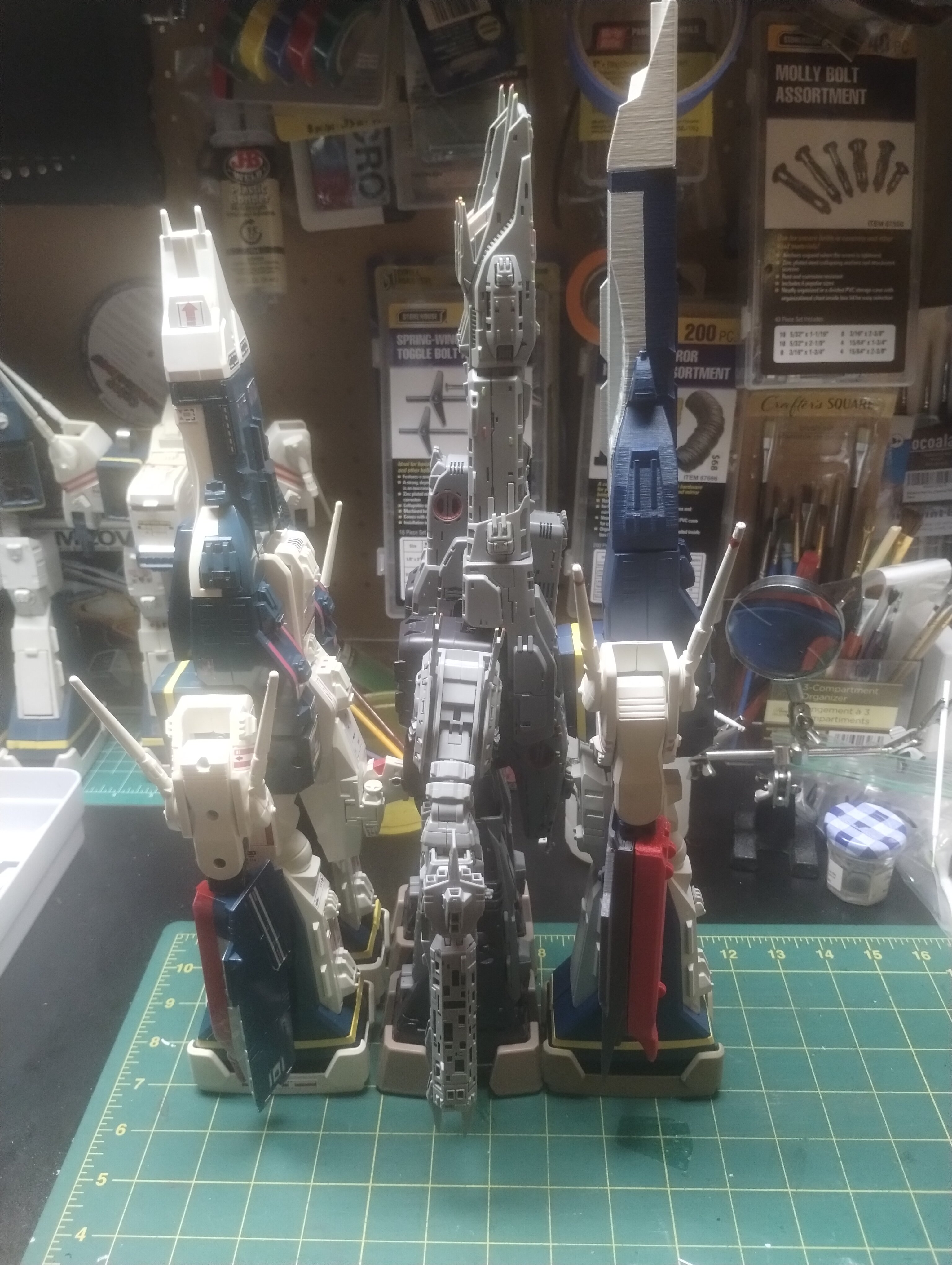

@sketchley Wow! Lots on your bench! It is COOL haw they designed the Gundam kit for beginners and then said, "For experts only" and added instructions for advanced articulation! The advantages of living in Japan... I couldn't live there. I'd be broke or lose too much weight from blowing my money on hobby stuff instead of food!😁 - MT
Moving past the Star Trek issue for a bit.

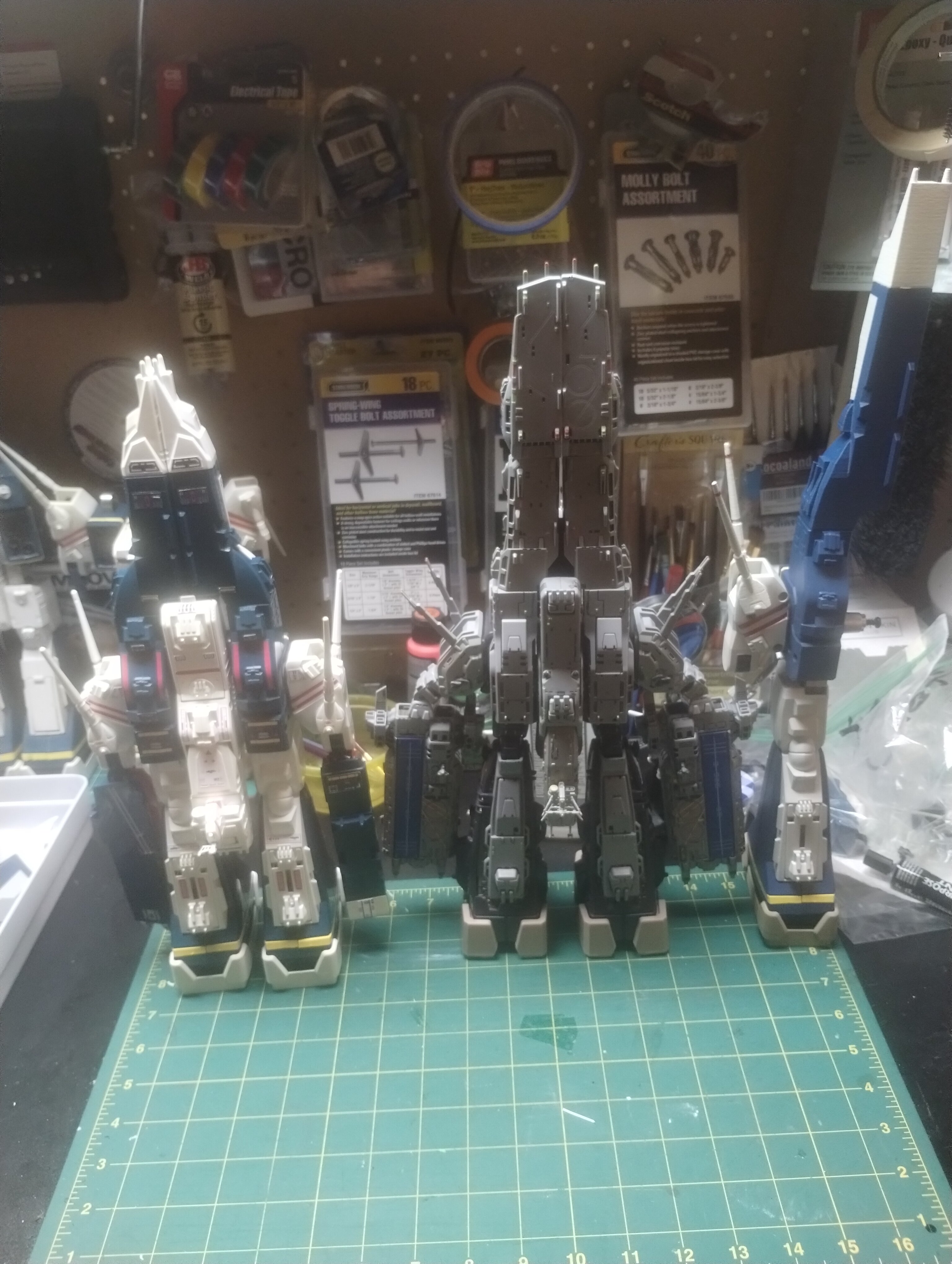

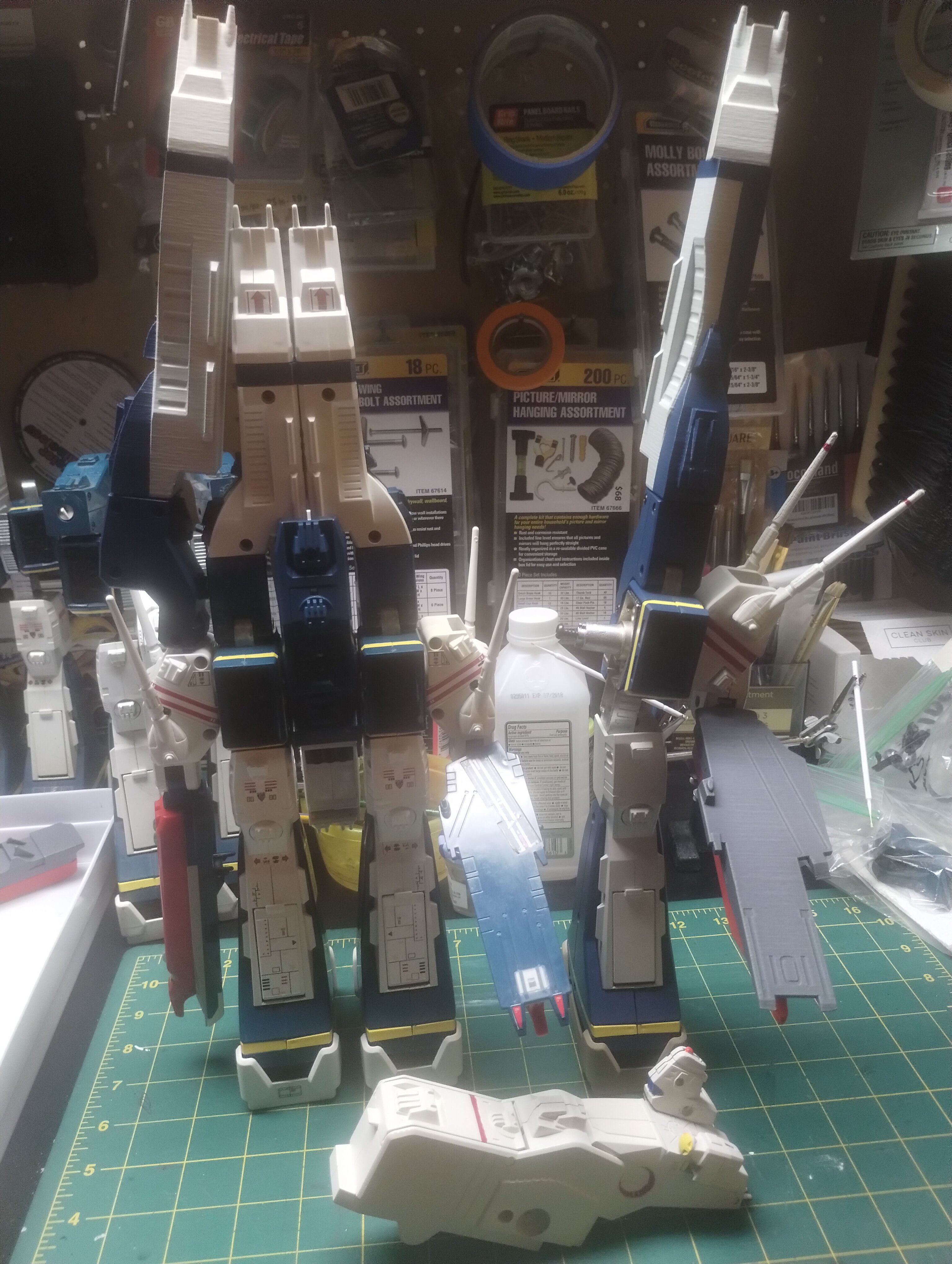

Im going back to the multiple SDF1 builds and got the old matchbox legs modded to do the splits and a little more painting and rebuilding.
I really like the height difference that the 3D printed parts bring on to the old boy.
Made new antennas out of some paperclips and painted them.
Mostly just have to paint more red stripes..
Oh I'm going to go forward and paint florescent lights on him too. I already did bridge and light on head and they look great under blacklight or without. The bridge is bright!

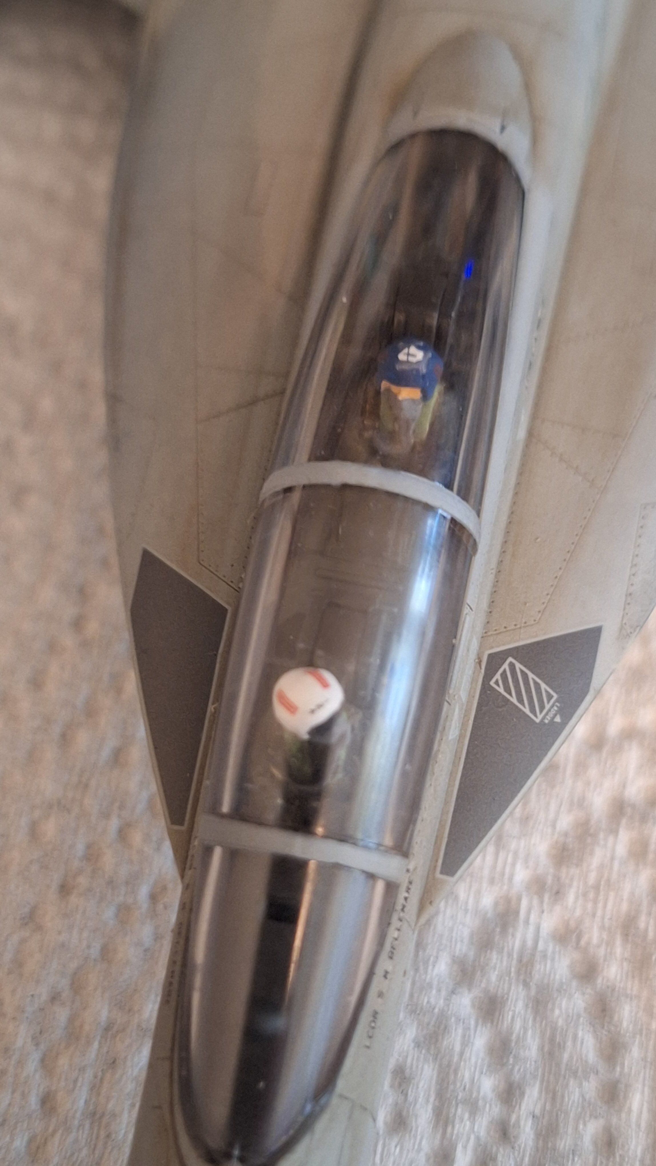

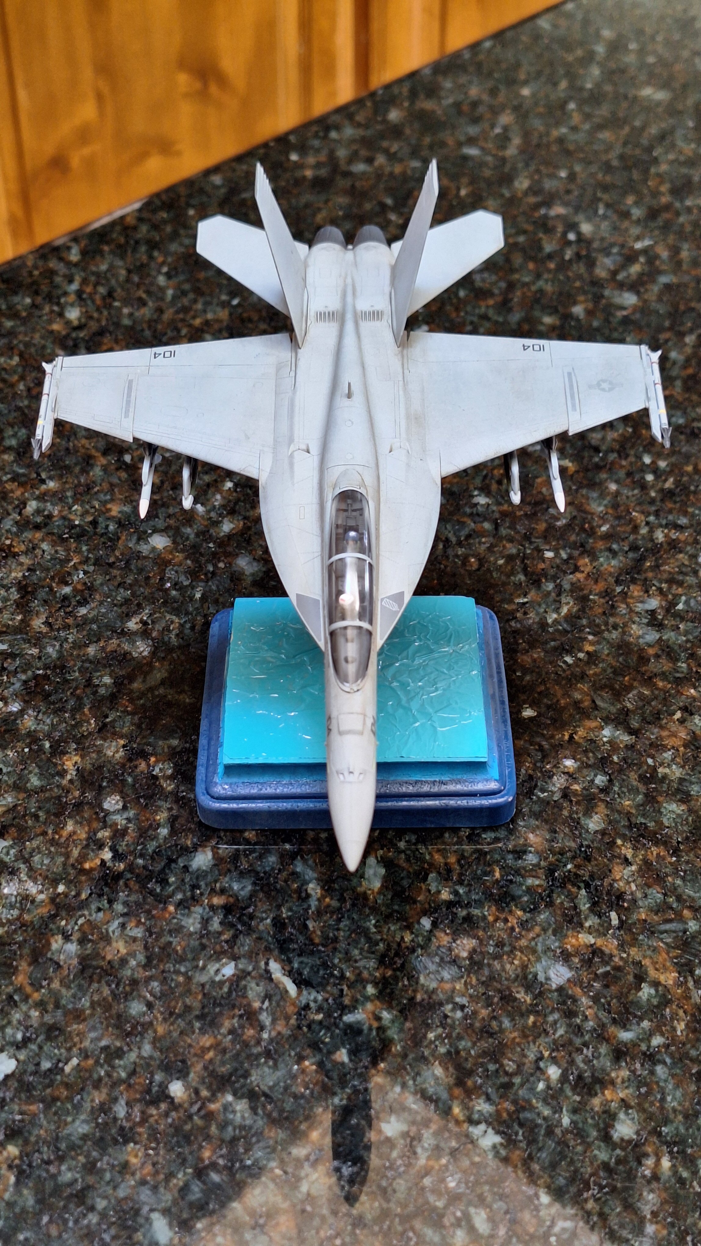

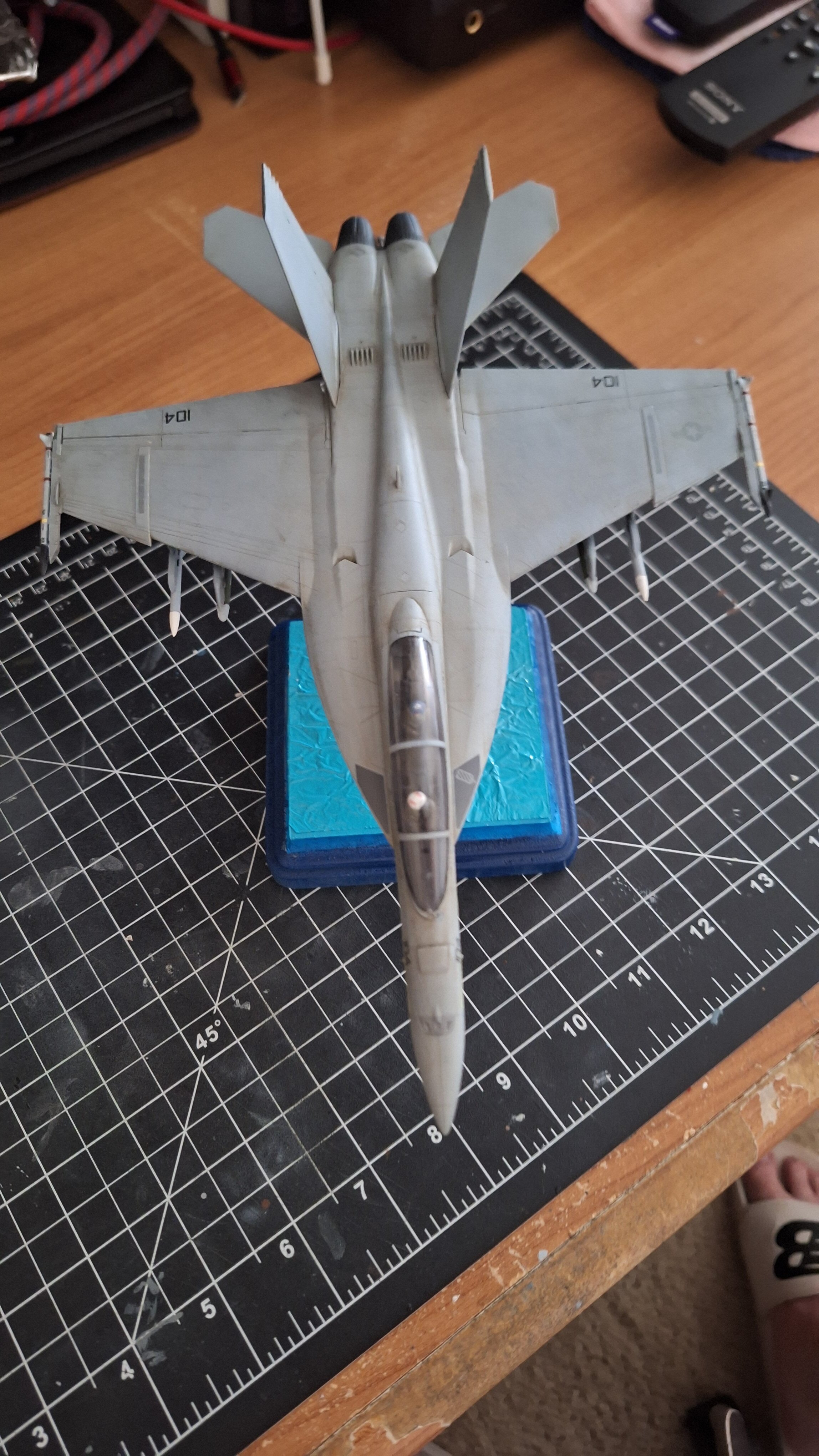

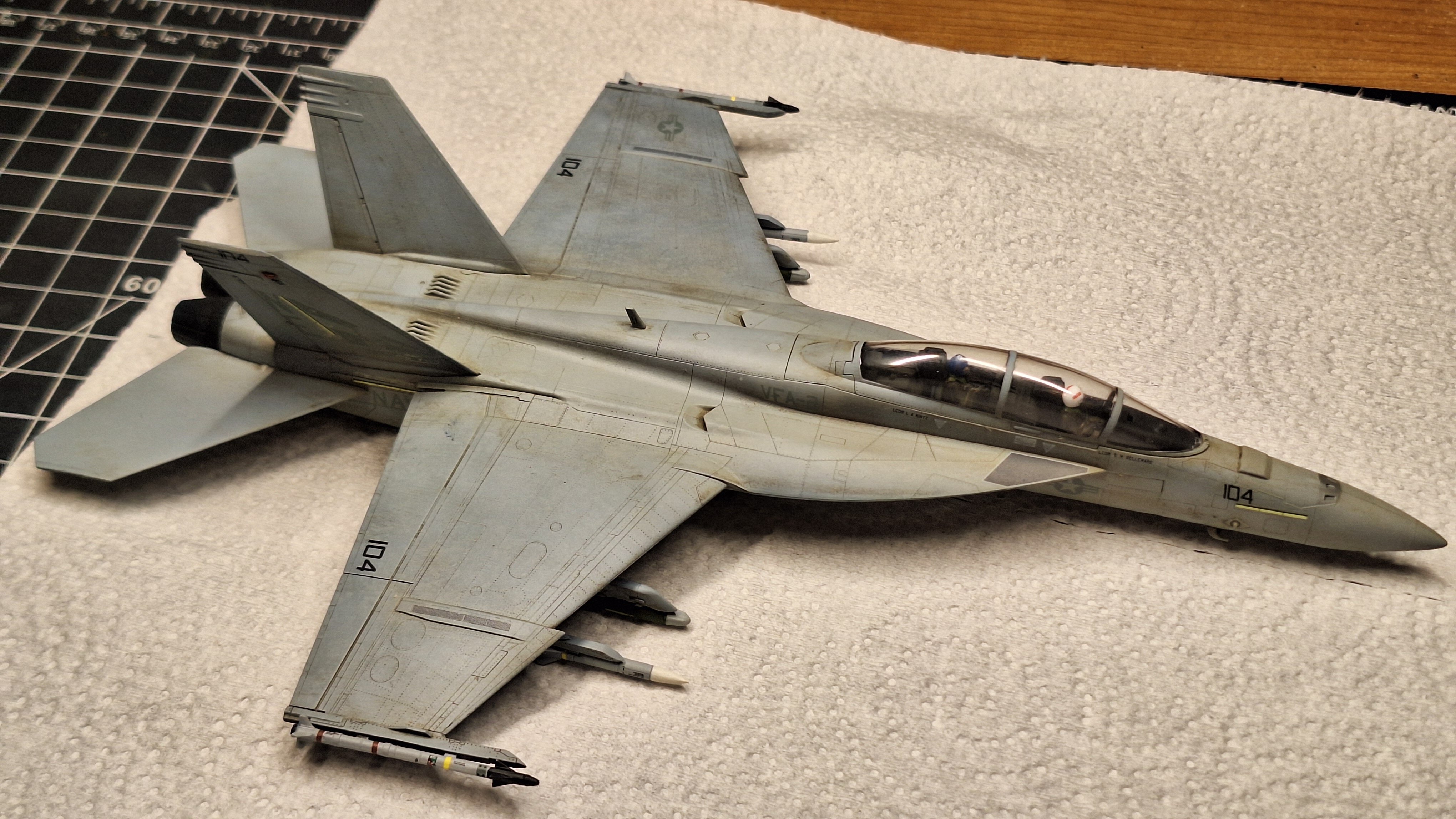

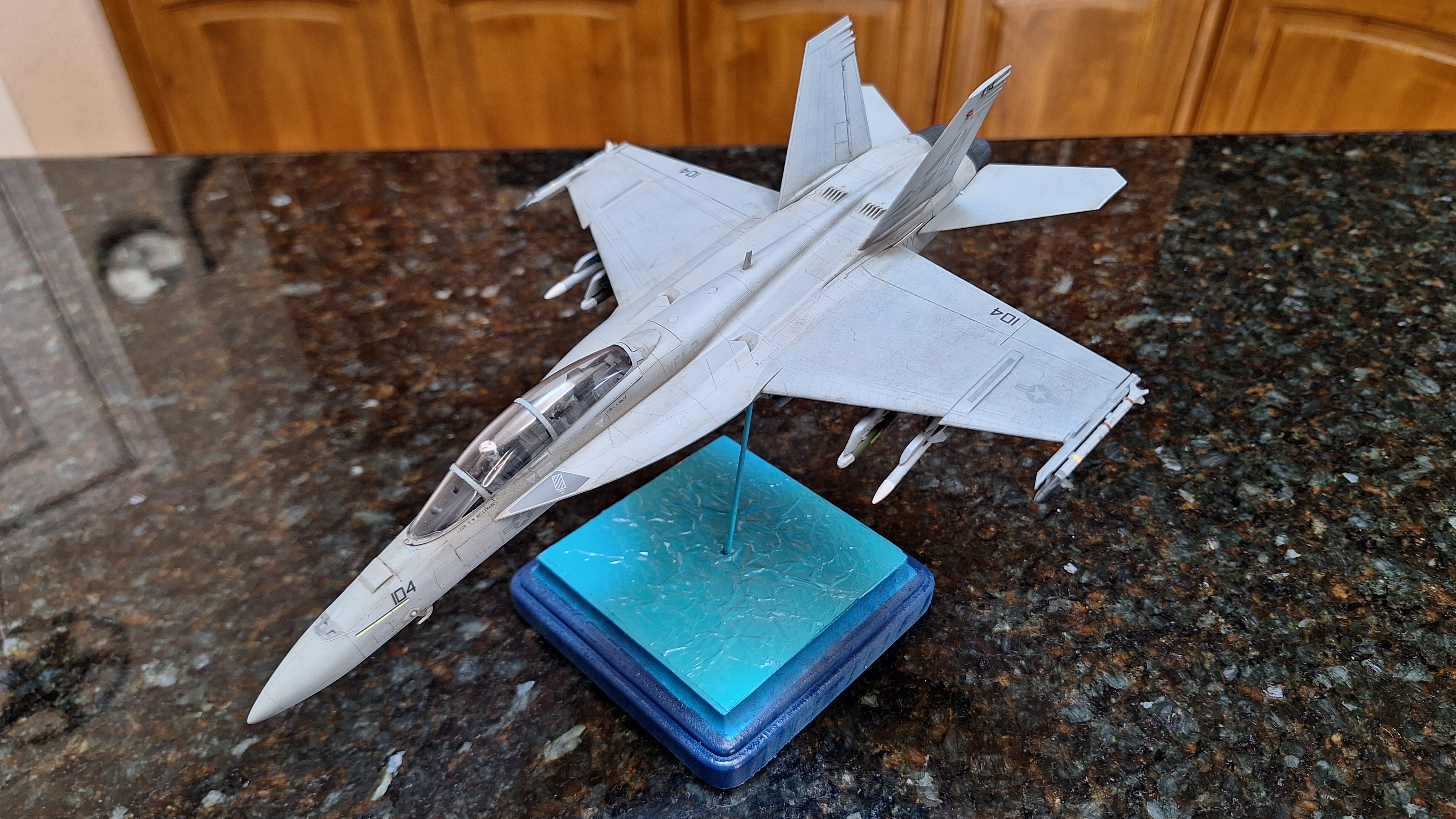

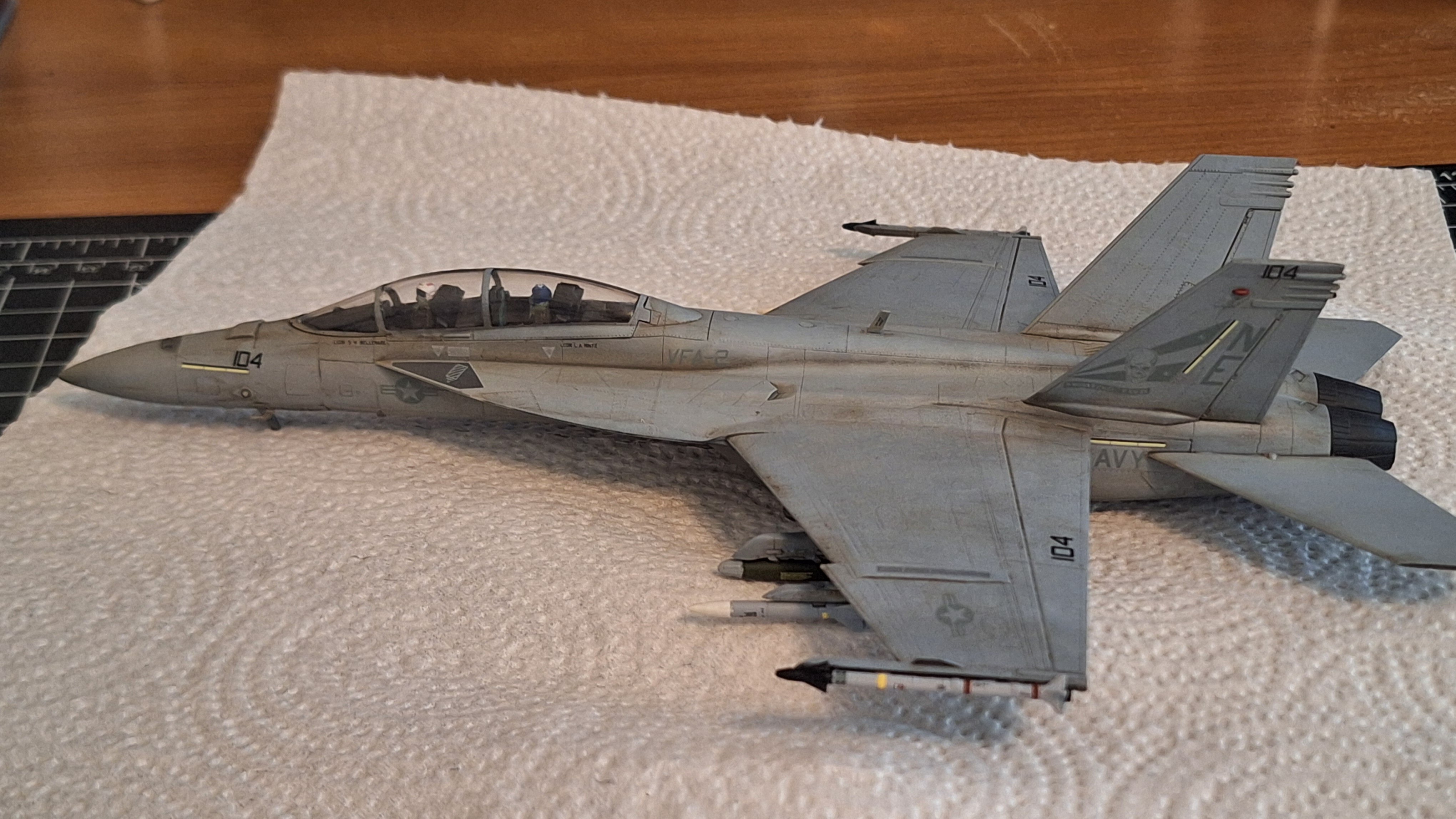

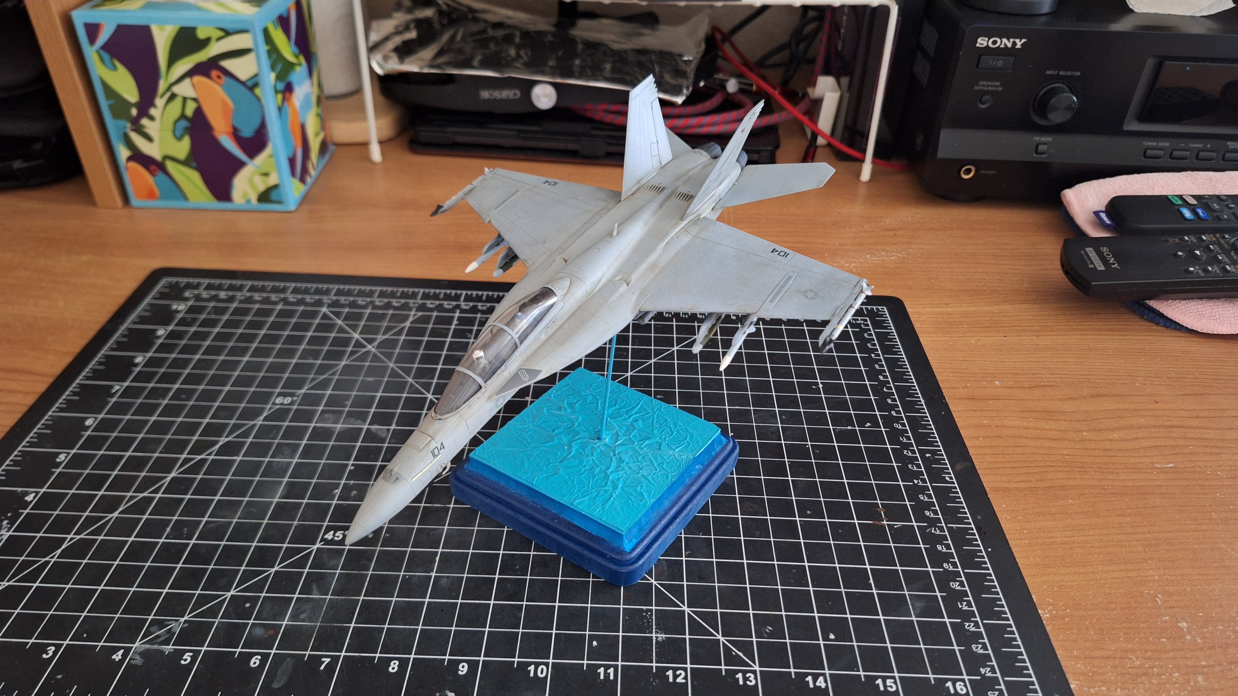

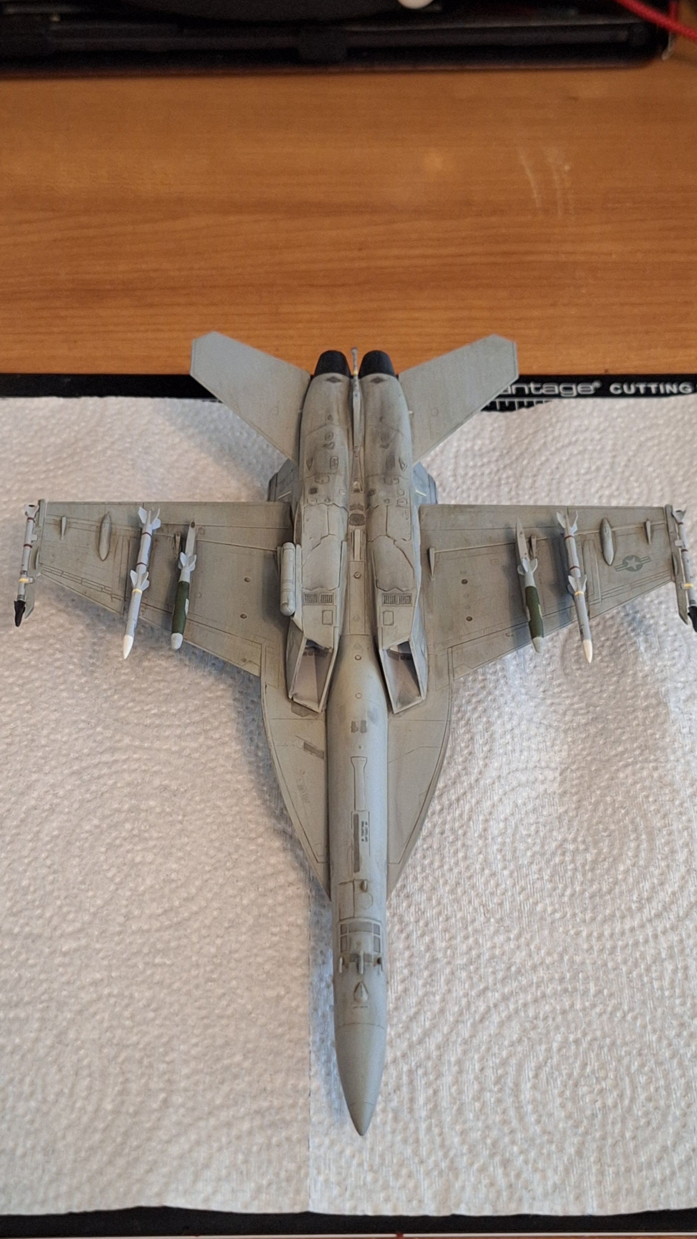

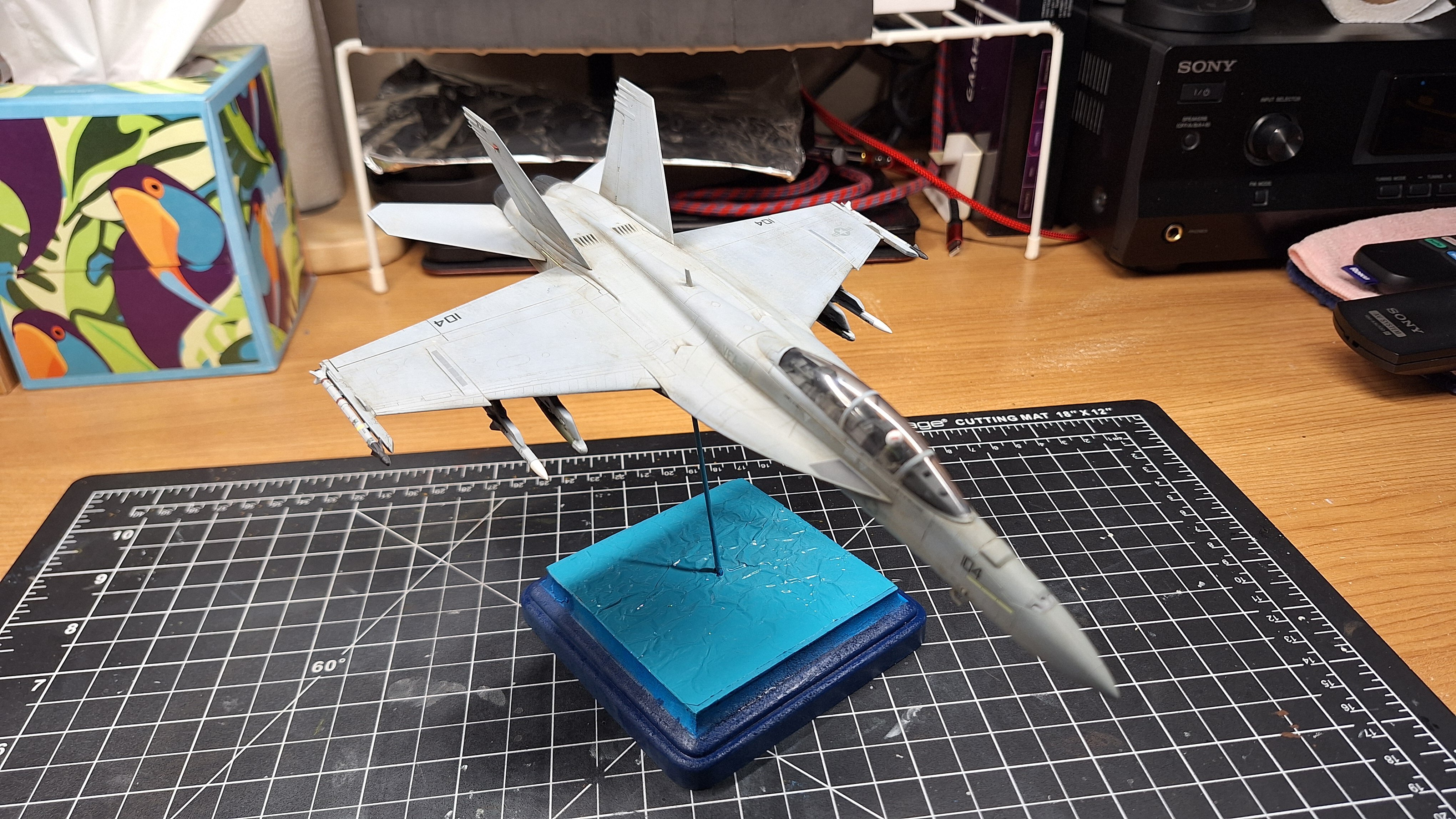

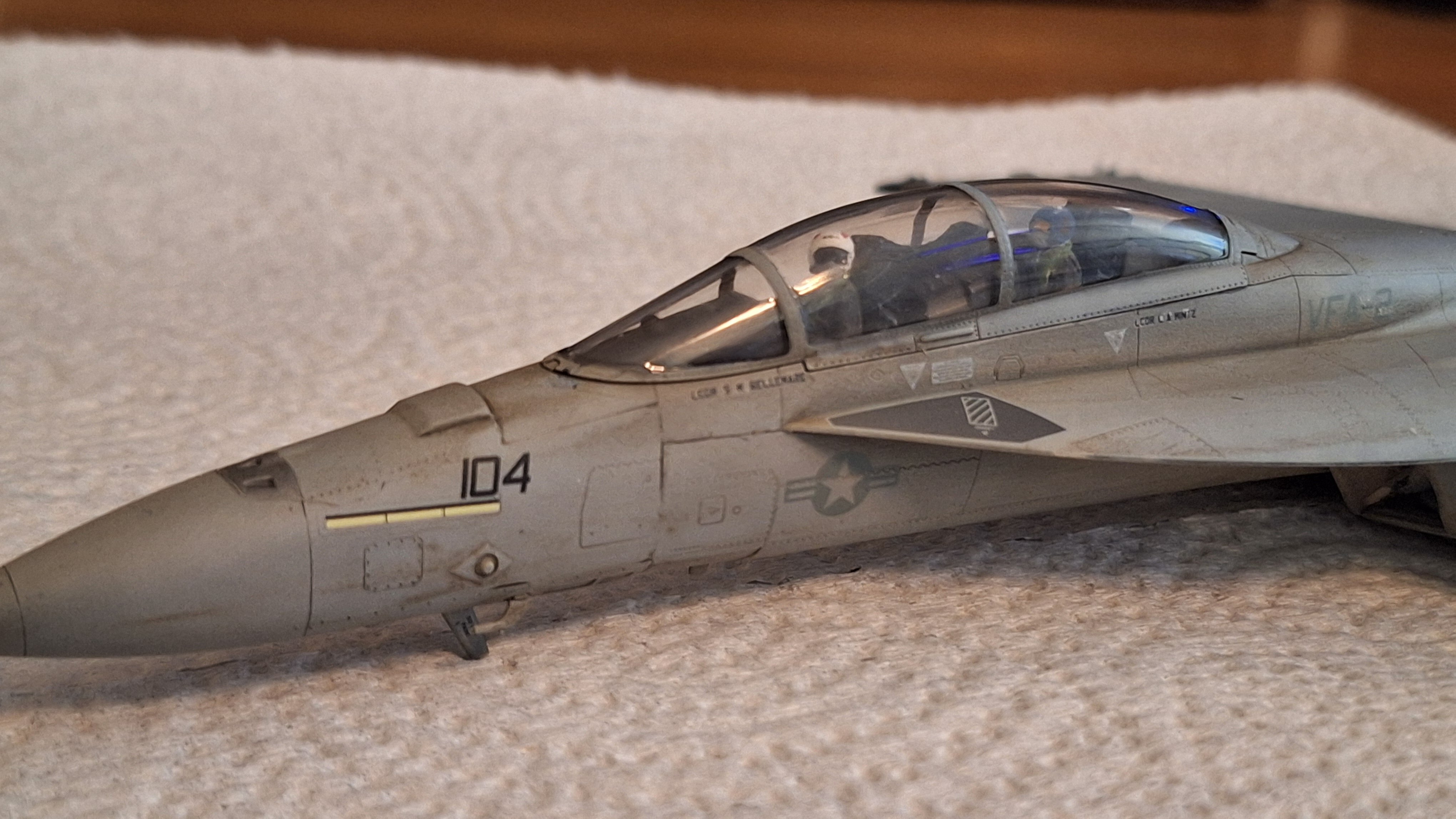

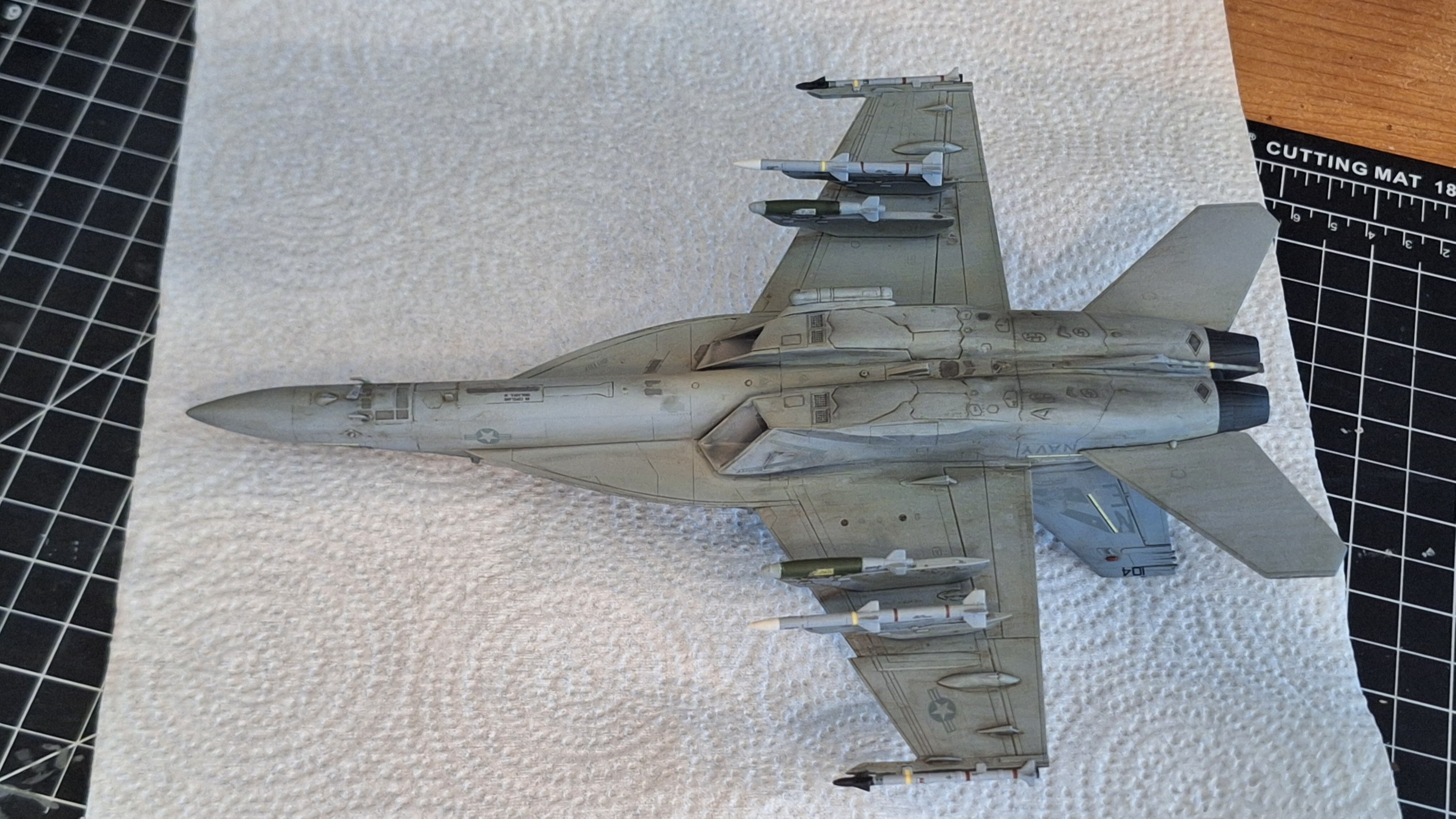

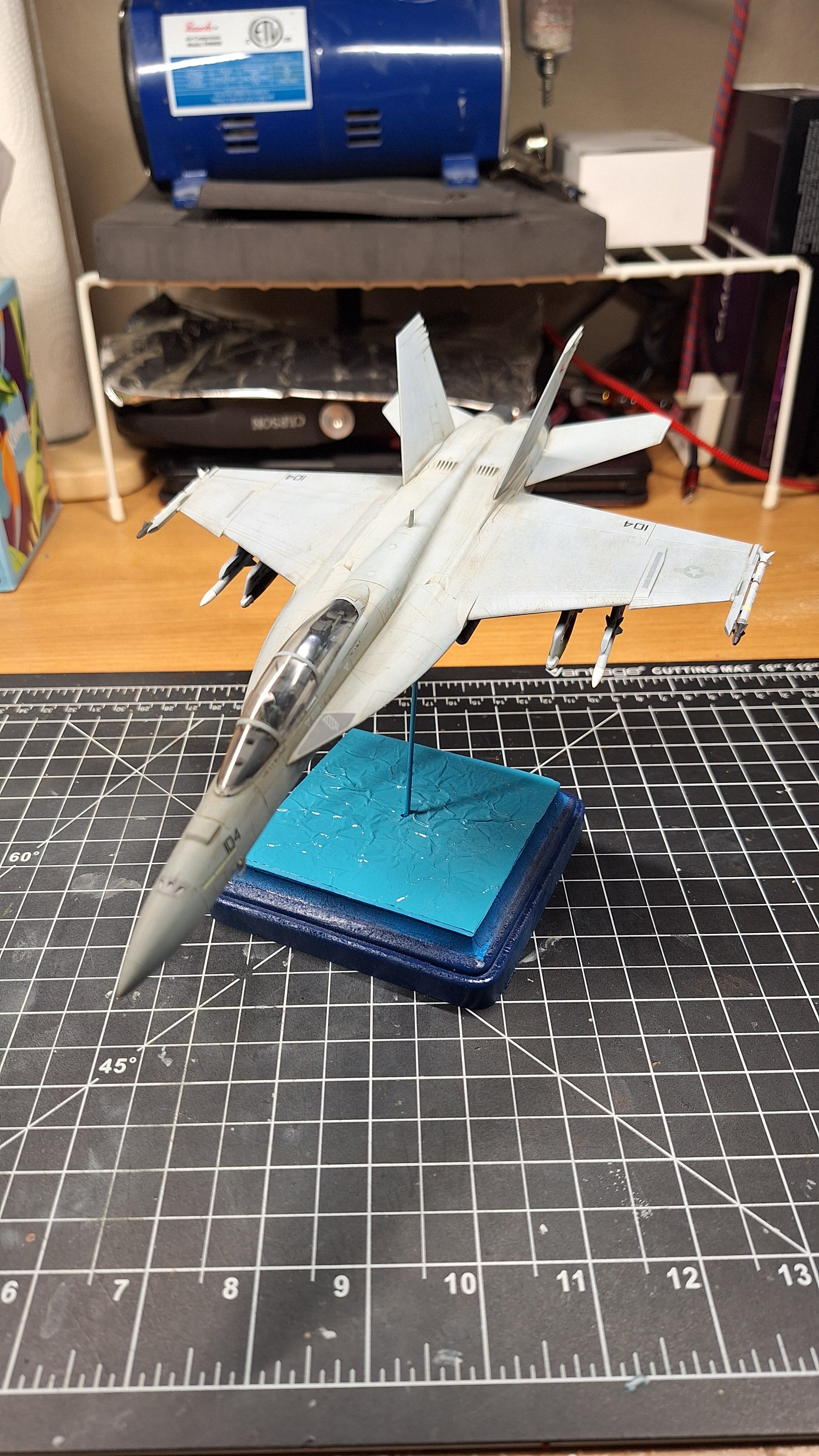

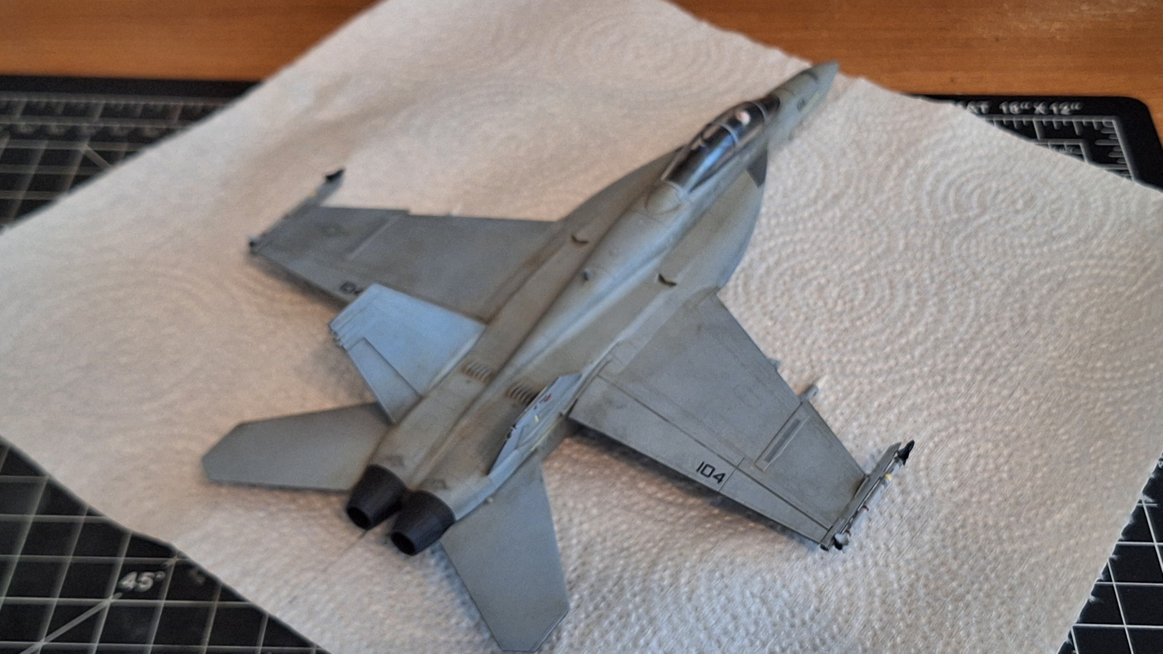

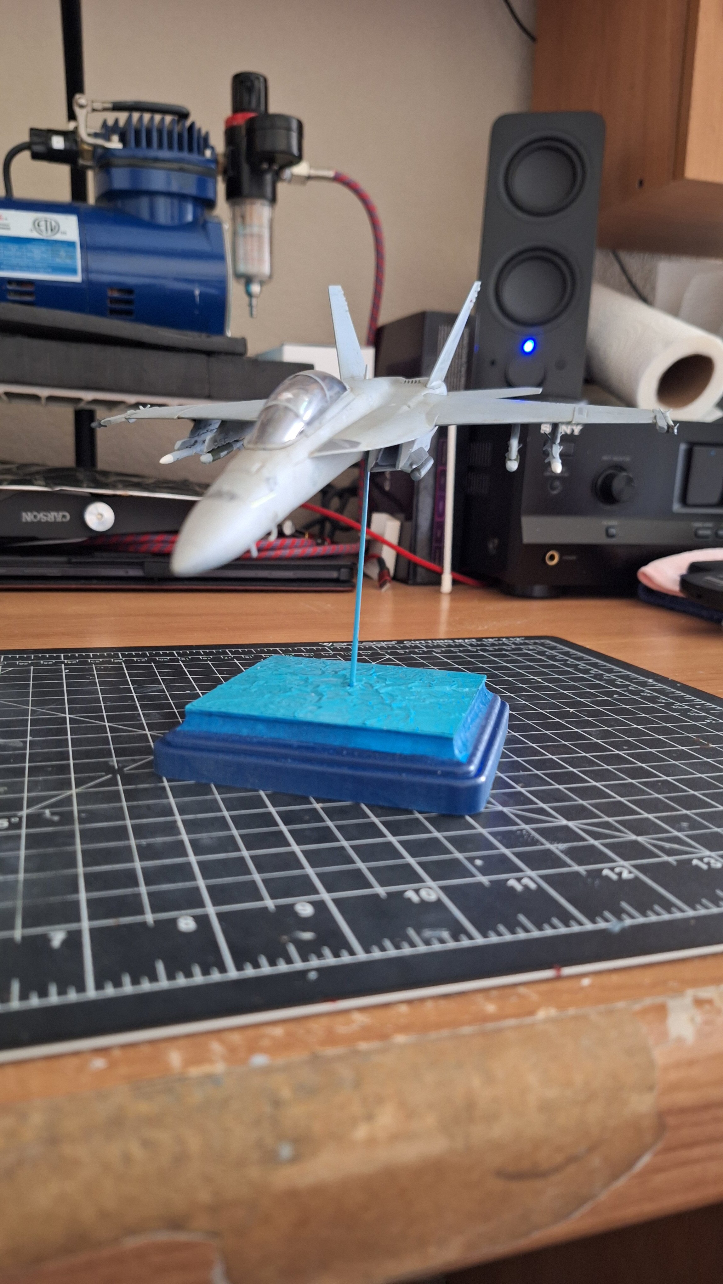

Hi guys, reporting in with the Academy 1/72 FA-18F finally done. Nice kit, no pilots included, these are PJ Productions resin pilots. My first time scraping and polishing the center canopy seam, but it turned out great. Also closed up the gear for an in flight look. Kit did not offer that option. Wanted this one to look like a carrier based very used and abused aircraft. Long time finishing up this one due to life struggles but I'm proud of myself for finishing it up and on my 49th BDay today. Now on to the Bradley, SR-71, and other unfinished kits. Slowly but surely. One day at a time. 🙂 Hope you enjoy the pics.
Edited by derex3592
Looks awesome
@derex3592 She looks really good! Building the kit gear up is tricky sometimes but you nailed it. Keep building! I'd love to see more of your finished projects.

Update on the Lego repair:
The top side came out as well as expected.  The bottom leaves a bit to be desired.  Nevertheless, it passed the build test—a little snug removing the bottom brick from the plate that first time, but normal thereafter.
Incidentally, after seeing the horror show search results for 'Lego brittle brown', I'm treating all the brown parts in my Lego collection a lot more gingerly... 😅
