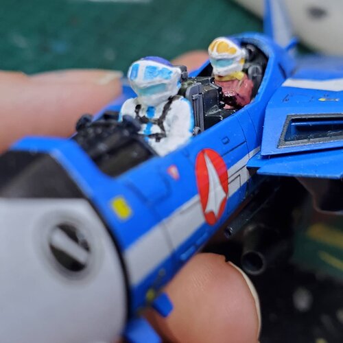

best i could do with my re-casting skills, but they look fine under the canopy glass.
Its just tacked on with white glue so if better options come along, i can replace them.
Your painting is GREAT at that scale. Come out a bit with the camera so we can get a fuller look of the two at a better scale.

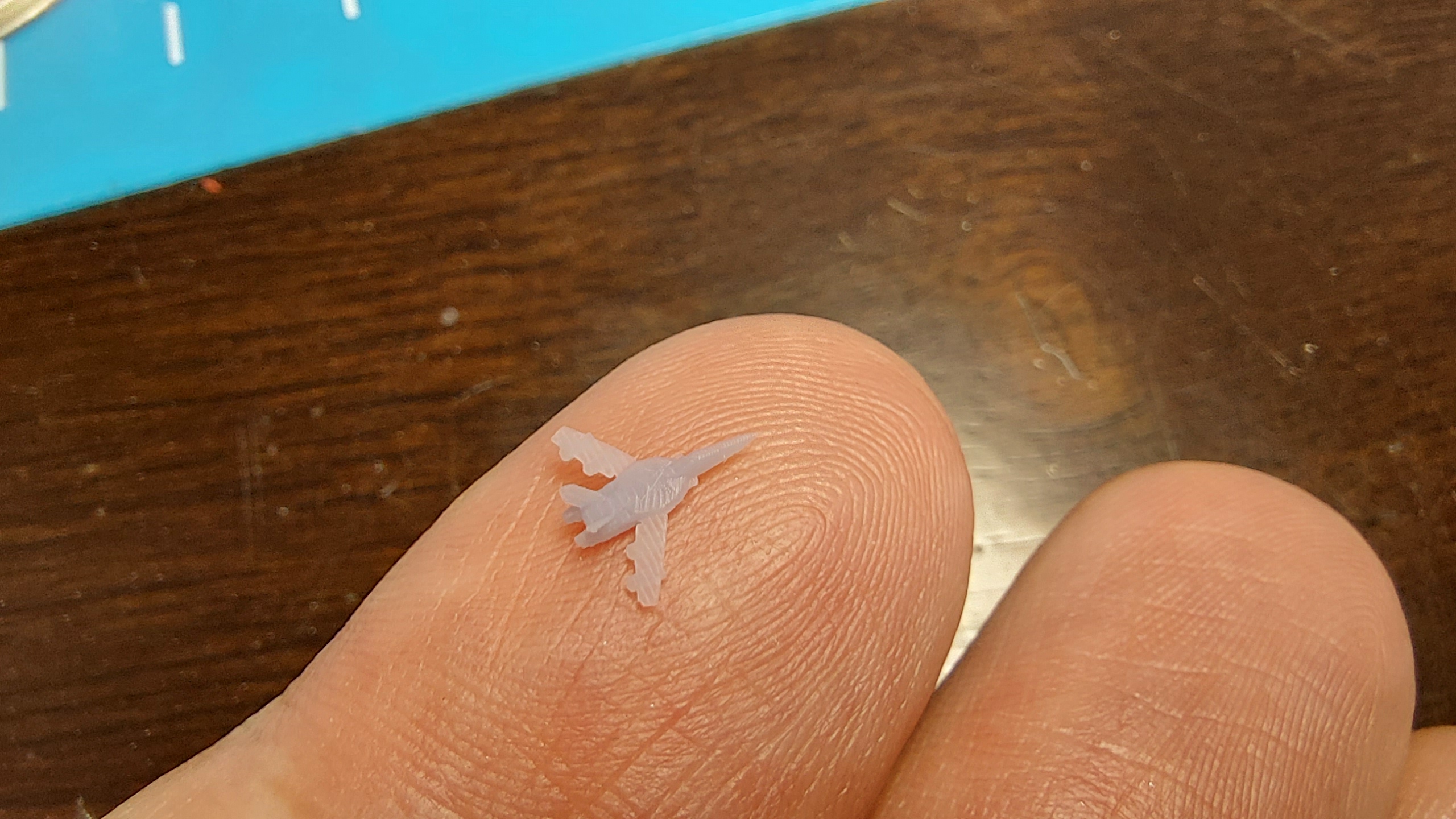

I always wanted 1/3000 valks for my SDF-1. A whole fleet on the way!

And @arbit wow, that is one tiny little print!
Holy crap!!! That would be well beyond my abilities to paint, even with magnification.
Wouldn't it be easier to print them in white? Then you only have to paint on the details (a few dots of paint I imagine...).
I wonder if you could add a color pigment to the resin? Have it printed in the base color at least.

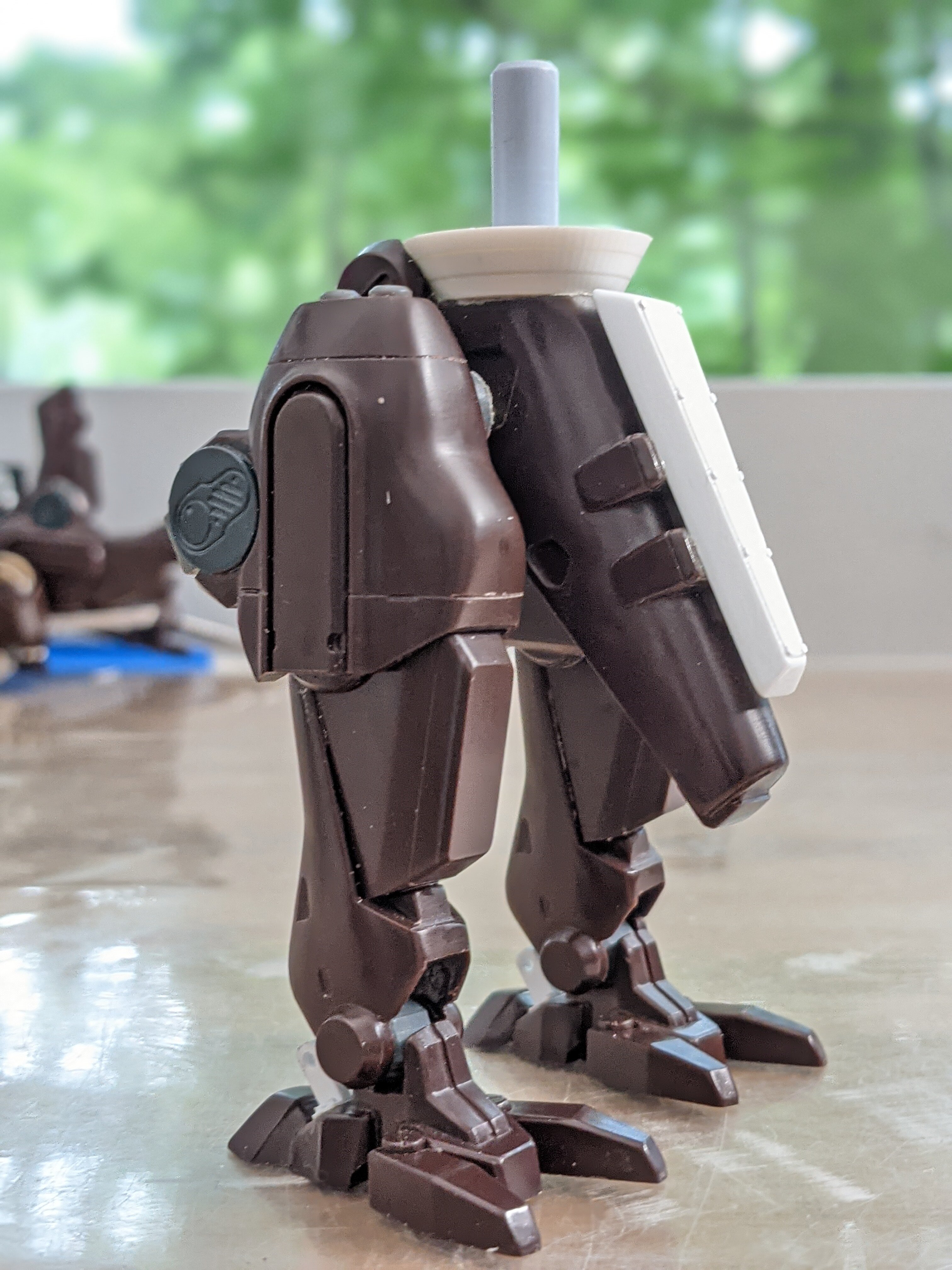

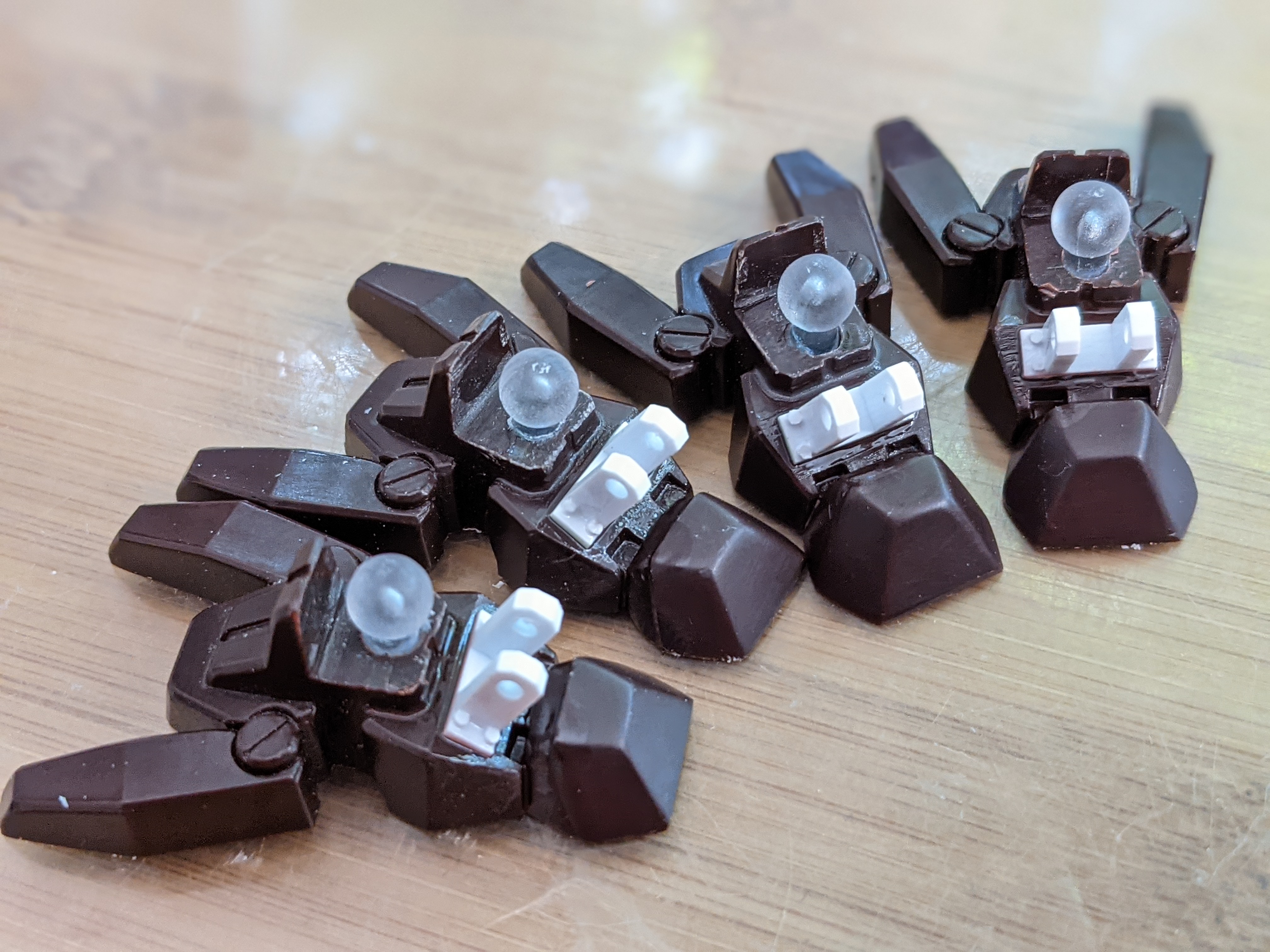

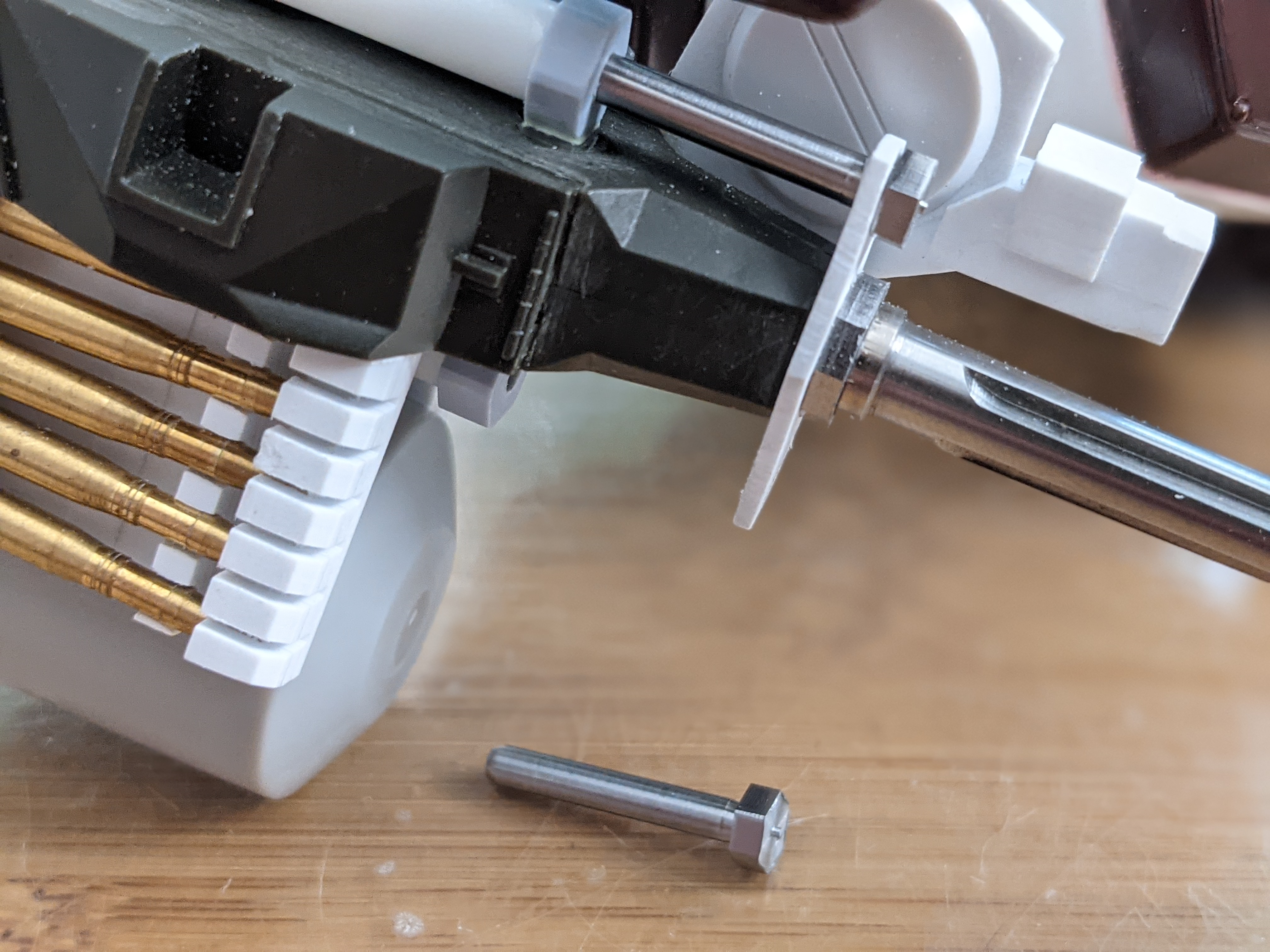

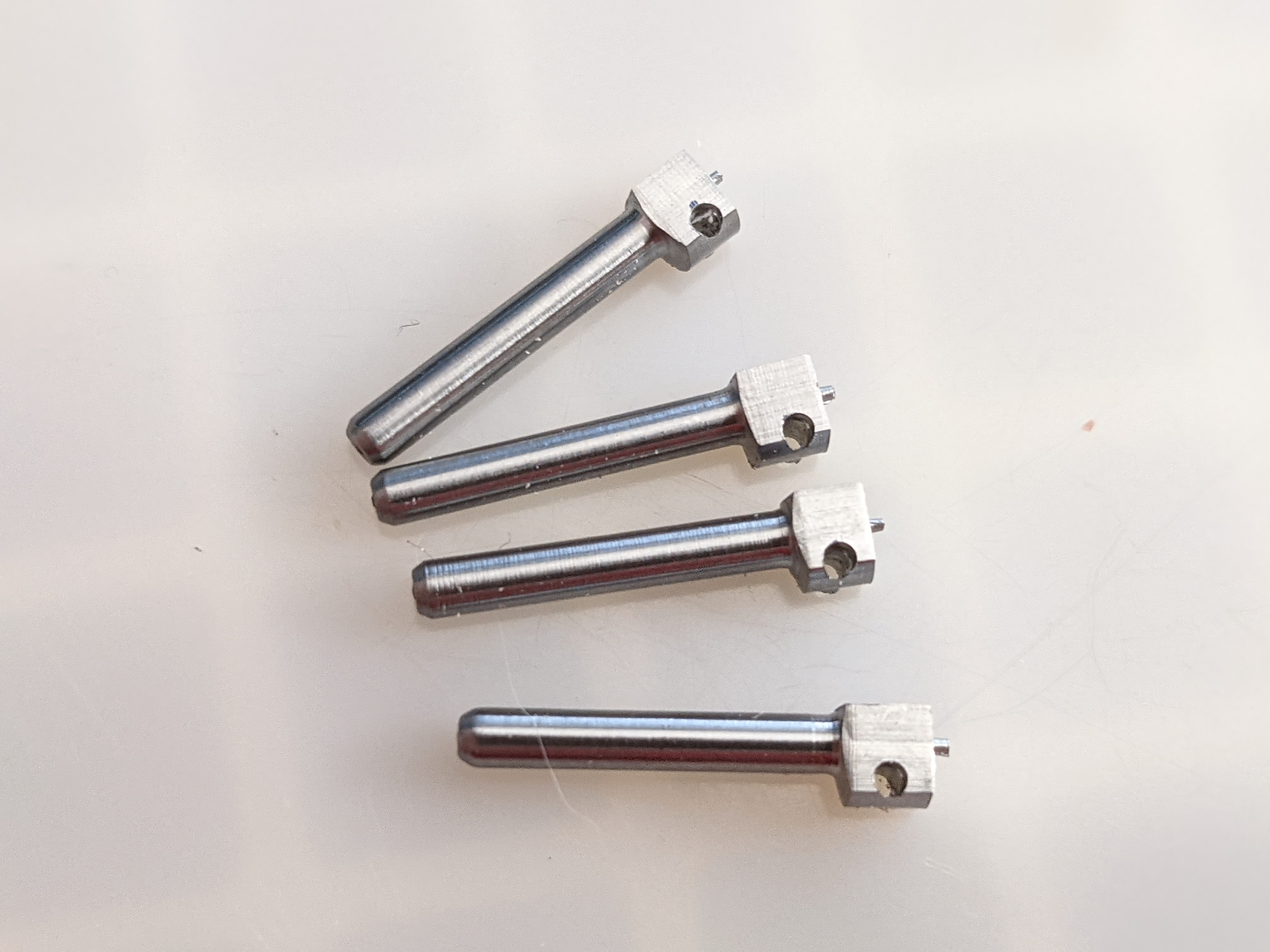

More work done this week on the mecha. The feet will have "achiles" actuators connected to the feet. So I made brackets with detailed bolts to "hold them down" and the hydraulic looking actuators to connect into them.
35-51.thumb.jpg.3633105e712f848b4324b122f25c964a.jpg35-56.thumb.jpg.d395282fbeeae759cdcba360a7c19903.jpg
The gun also needed hydraulic actuators for the absorbers, so those got machined too with bolt heads. The neck joints for the head are so thin, they were cracking. So greeblies like motors got added for strength. The heads are also cleaned up now for clear lenses to be made.
35-52.thumb.jpg.666560e1e5f1b0260aa679ac53a662e5.jpg35-53.thumb.jpg.1fddbdea908fa097fe8759a50bc62155.jpg

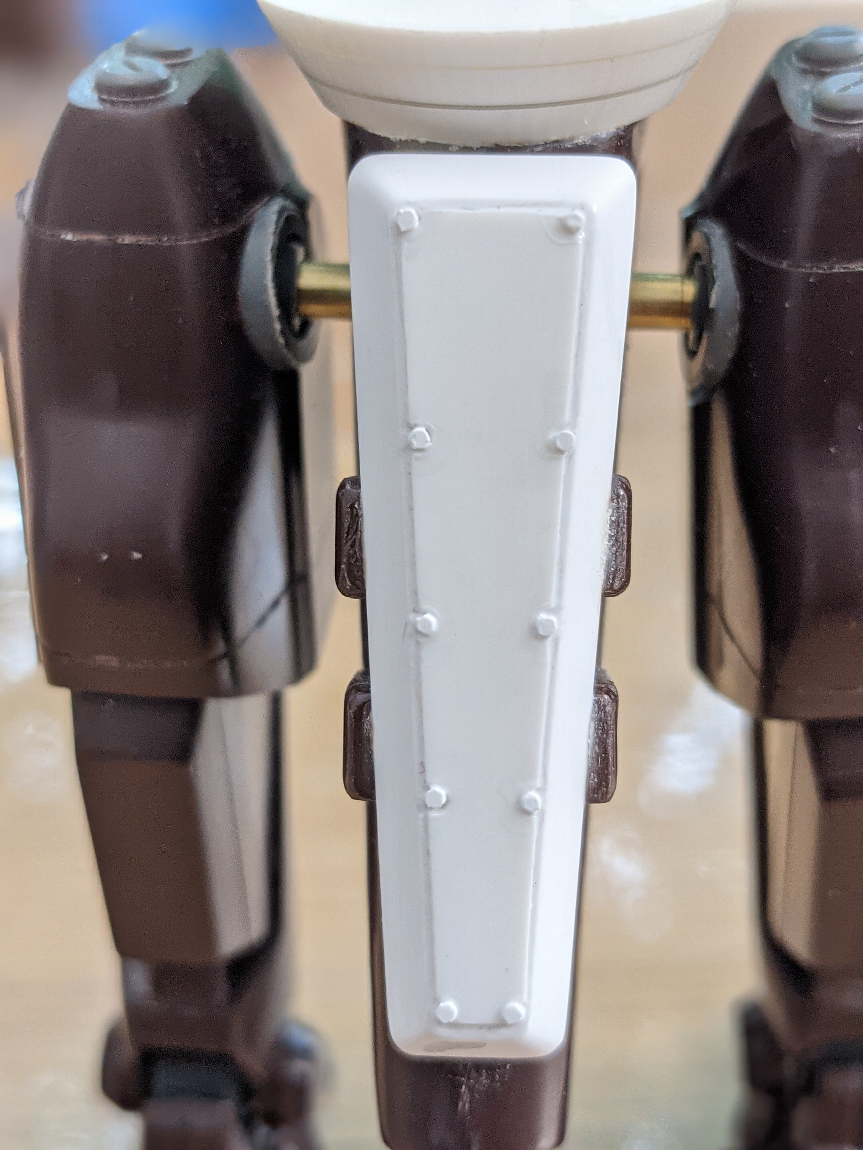

Even mecha need protection for their "lunchbox"! So more armor plating was made, attached and bolted for details.
35-54.thumb.jpg.be90223866194a81710bb29a88dae1ed.jpg35-55.thumb.jpg.c91f0de9d42615e163bf6b50ce65faa9.jpg
That's it for this week. Thanks for checking in everyone! - MT

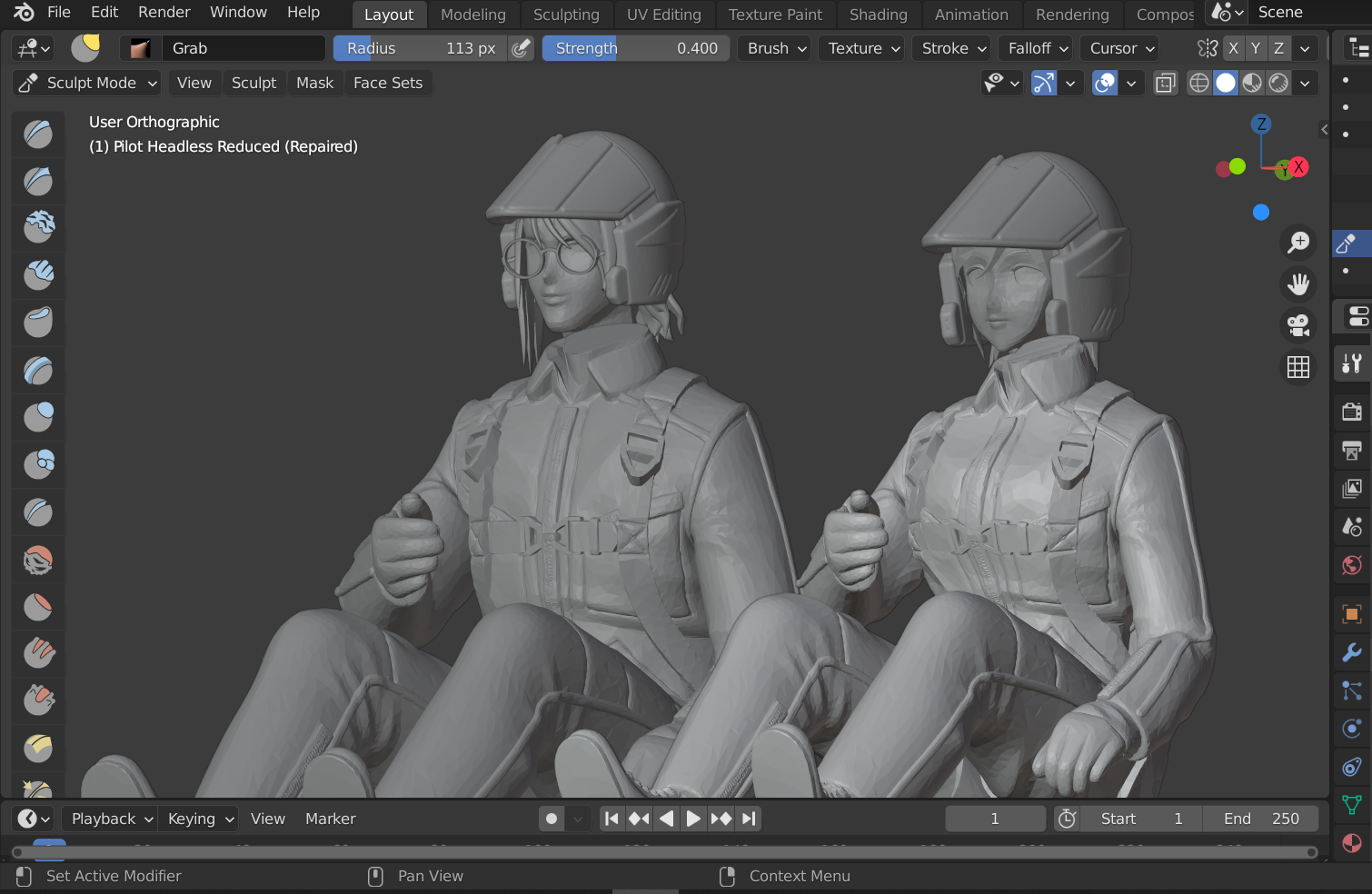

This is where I am with M&M. Comments? Of course we are not going to be perfect, but a nudge here or there can make a difference. (The necks aren't joined to the body yet, so don't worry about that.)

@arbit Great sculpt Arbit! Can you tweak his glasses to have that HUGE 70's, kinda RayBan-ish look? The funny part is I don't believe most military pilots can fly with glasses. Today they have to have Lasik to correct their vision - last I heard for the USAF. - MT

As to his glasses, I imagine they would have waived restrictions, considering the situation they were in. And considering how great he was!

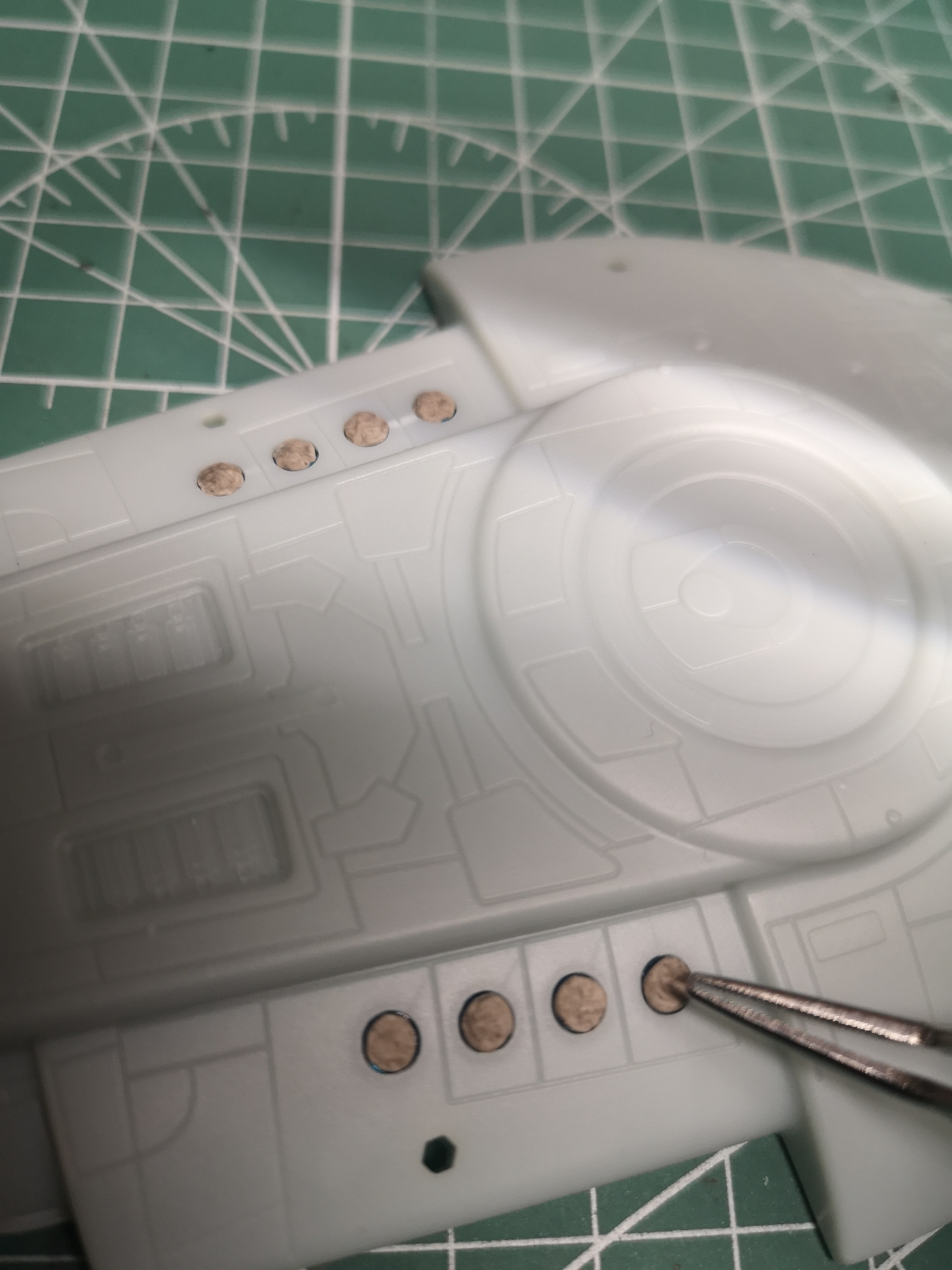

14 hours ago, derex3592 said:

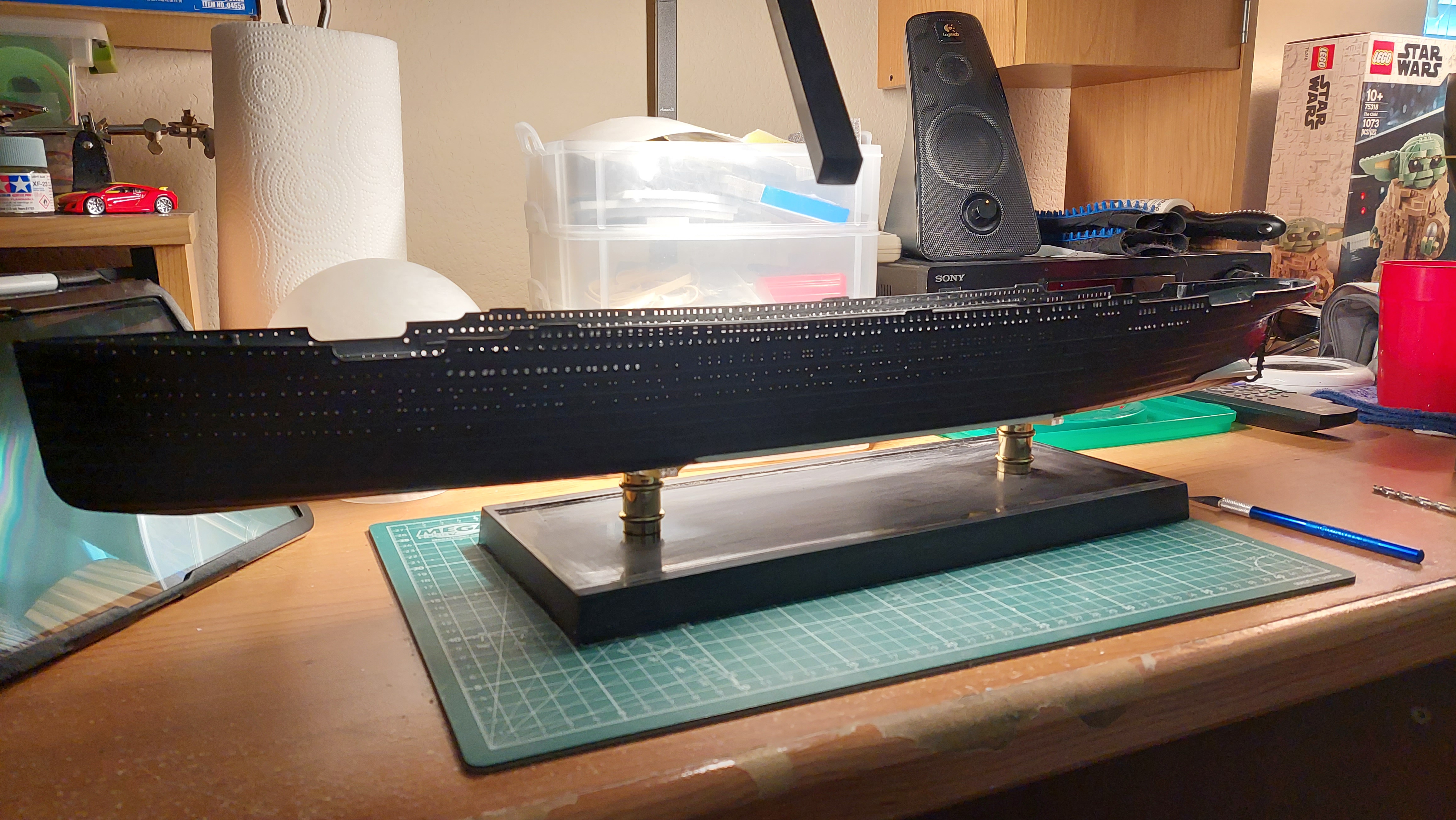

I broke out the TITANIC and have successfully drilled out ALL the portholes (thank GOD for my little WeCheer electric micro drill!!!)

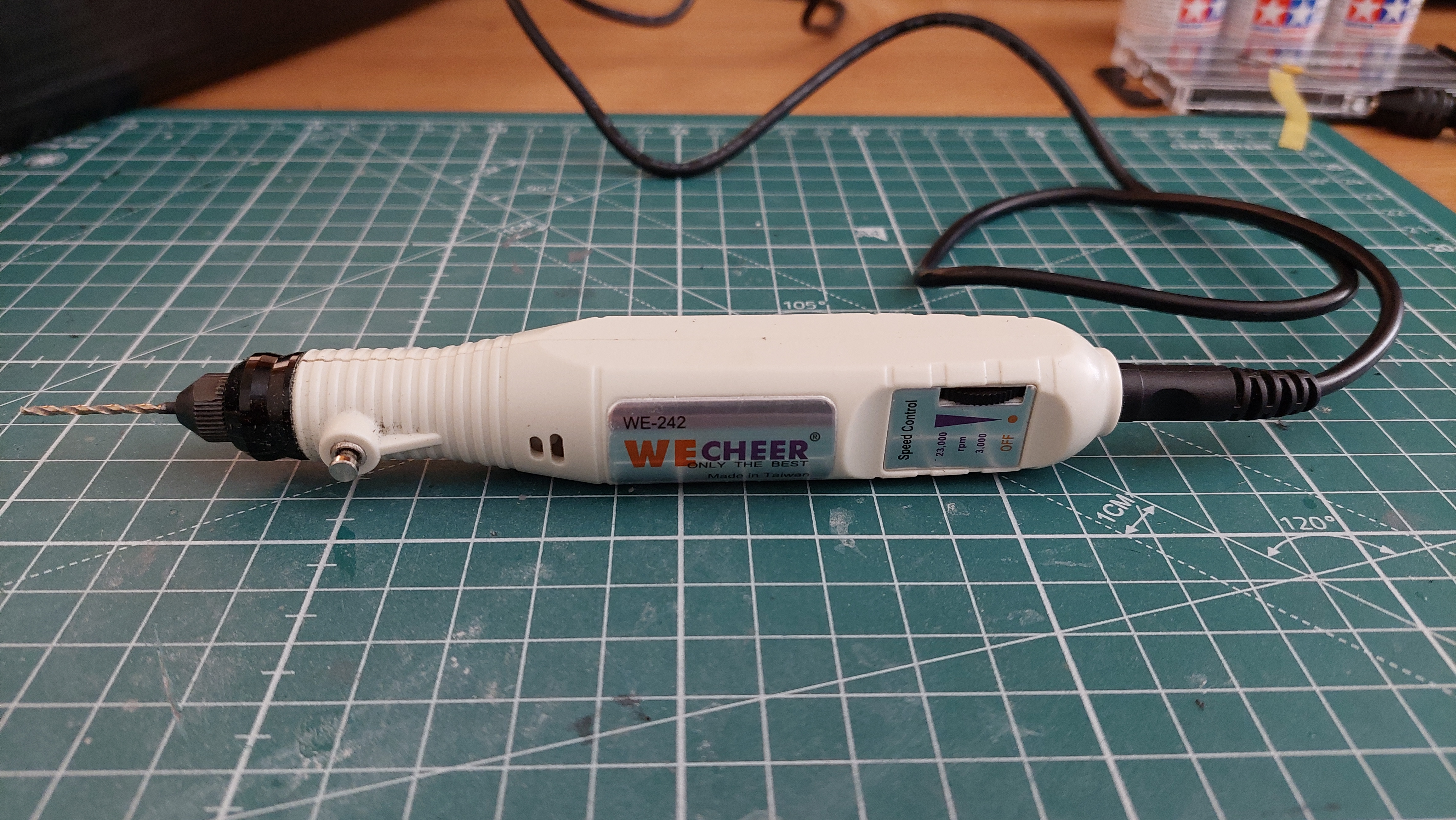

Now where have I seen that before?
Good little drill when you don't want the power of a Dremel.
But the torque can be weak, if it stops and wont start, I plug it into the power cord for it to reset itself.
I also use a Dremel white cotton sanding tip to clean model parts. But very gently.

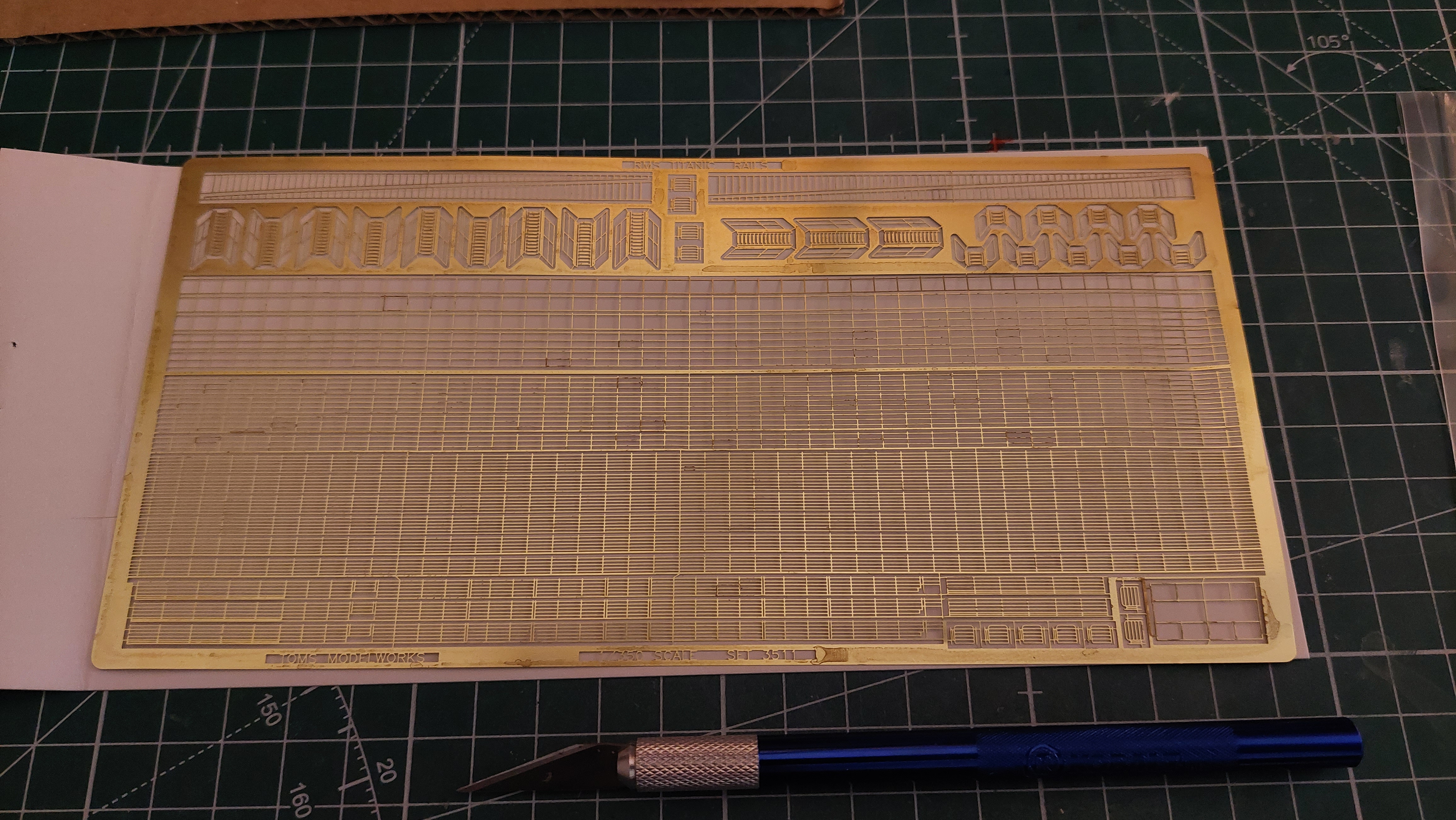

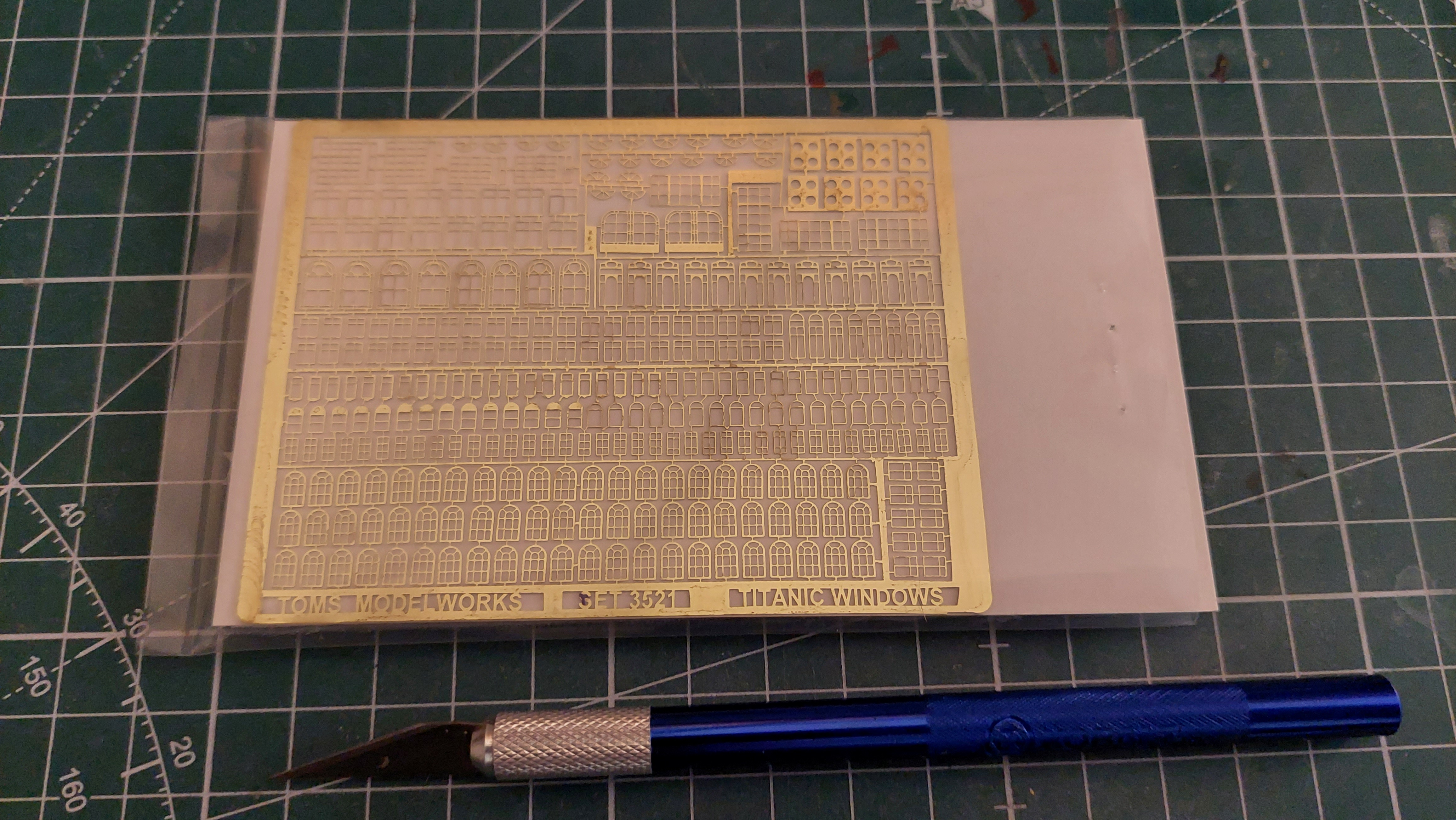

Got PE parts and PE 1/350 people pre-painted!
Oh no, tell me you're not going to add all that PE. You're going to need really small fingers for those. Good luck!

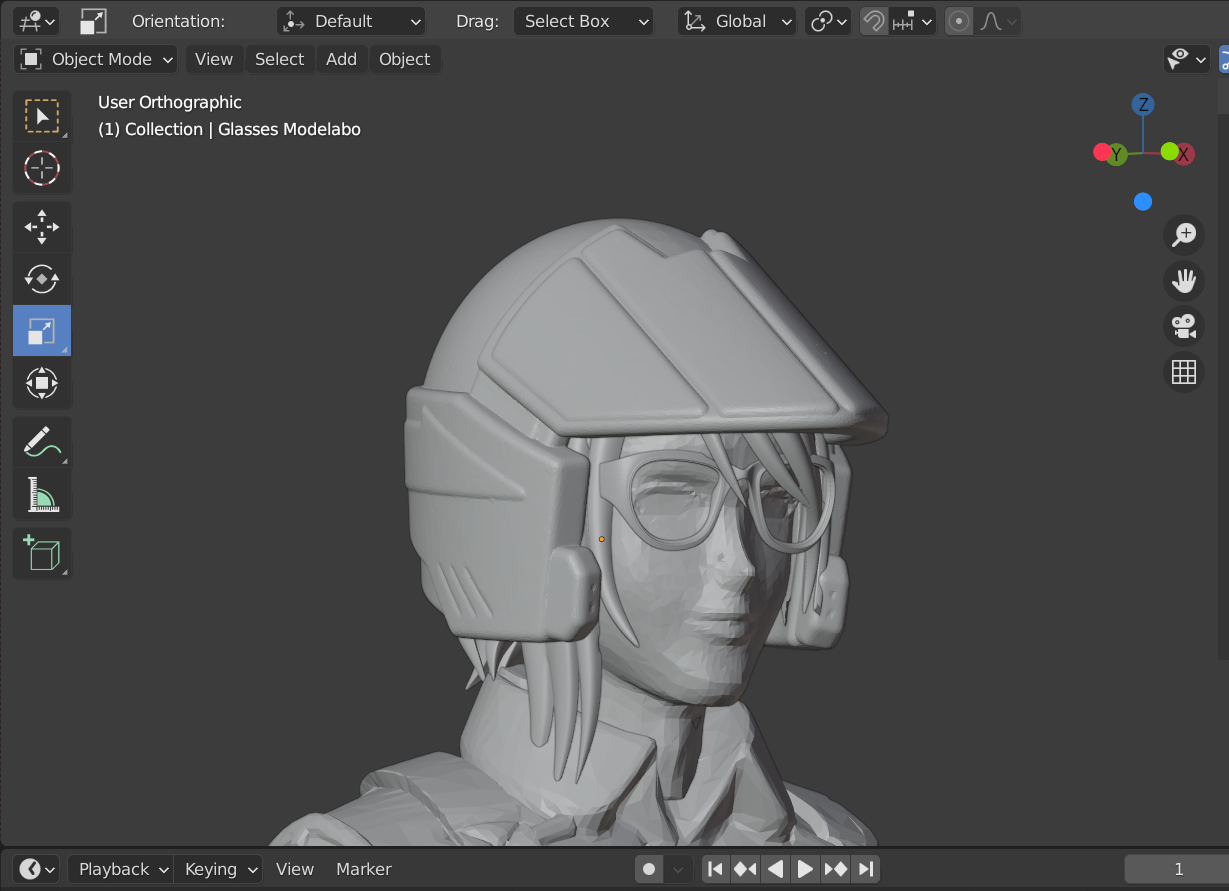

Grumble, grumble, yes I need to do better than those Harry Potter glasses I ripped. Maybe I can pull and stretch them. Here is a different type.
154020020_Screenshot2021-06-2317_08_28.thumb.png.3262b3a602615cf4106c1c61f9ab4e67.png
This 3D printing stuff is a serious addiction. The possibilities are endless, even without experience.
This guy did a Zeta Cockpit for the first time designing anything. I need to learn how to do this with Z-Brush. I'm really struggling with Blender.

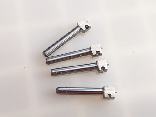

That is the biggest groin protector I have ever seen, hahahaha!

Most militaries wouldn't accept that long hippie-dippy hair either, hahahaha!

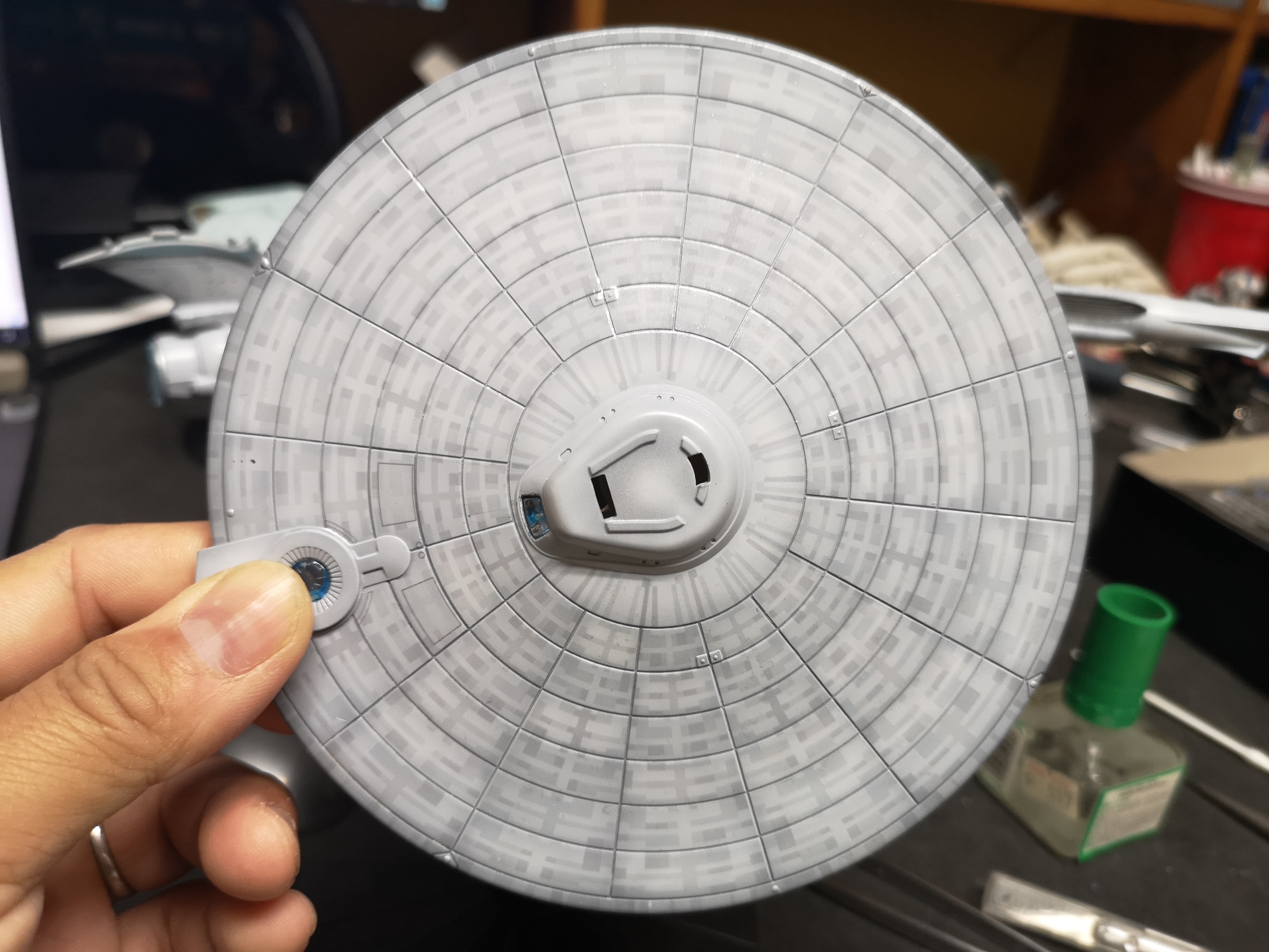

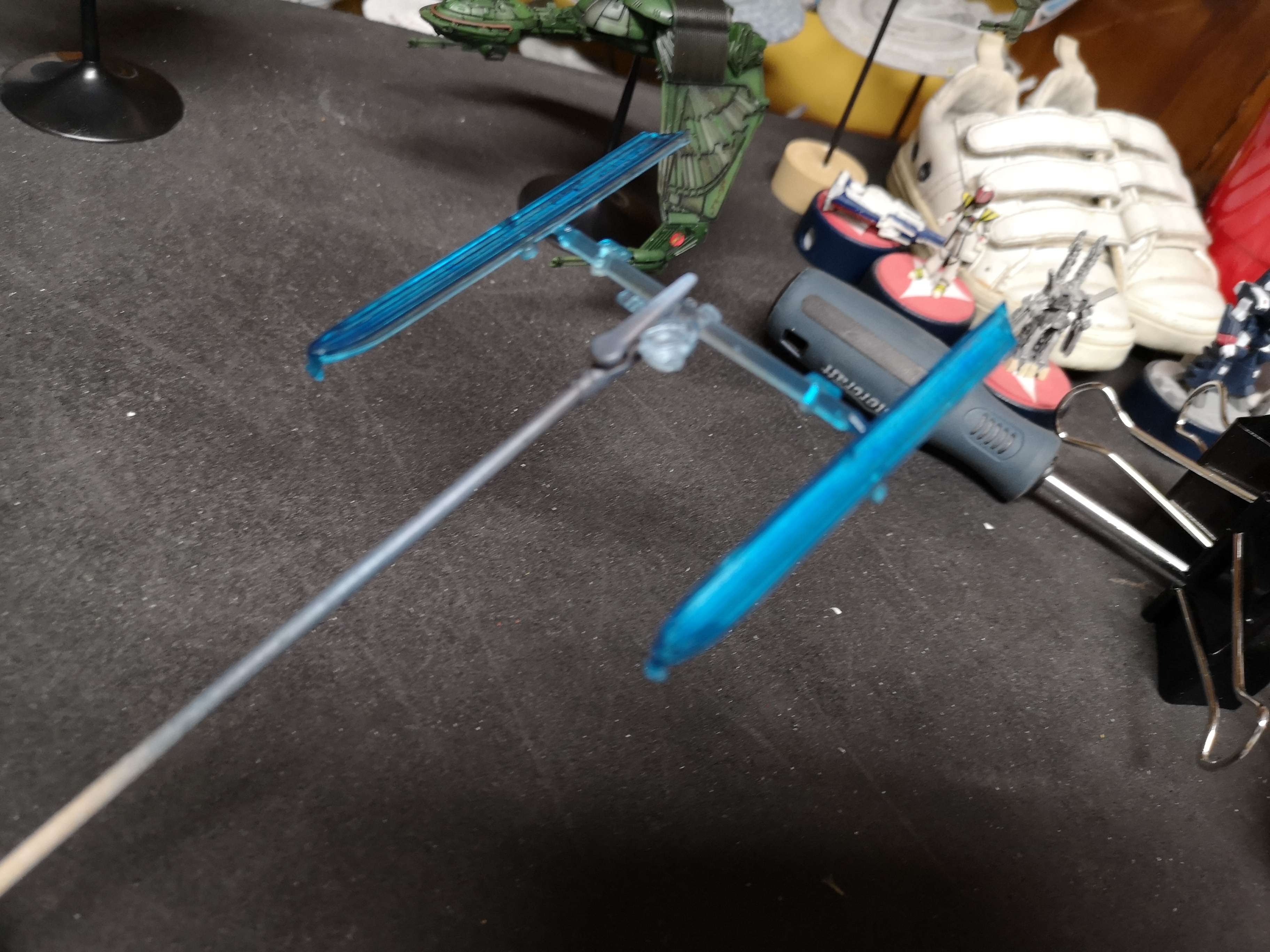

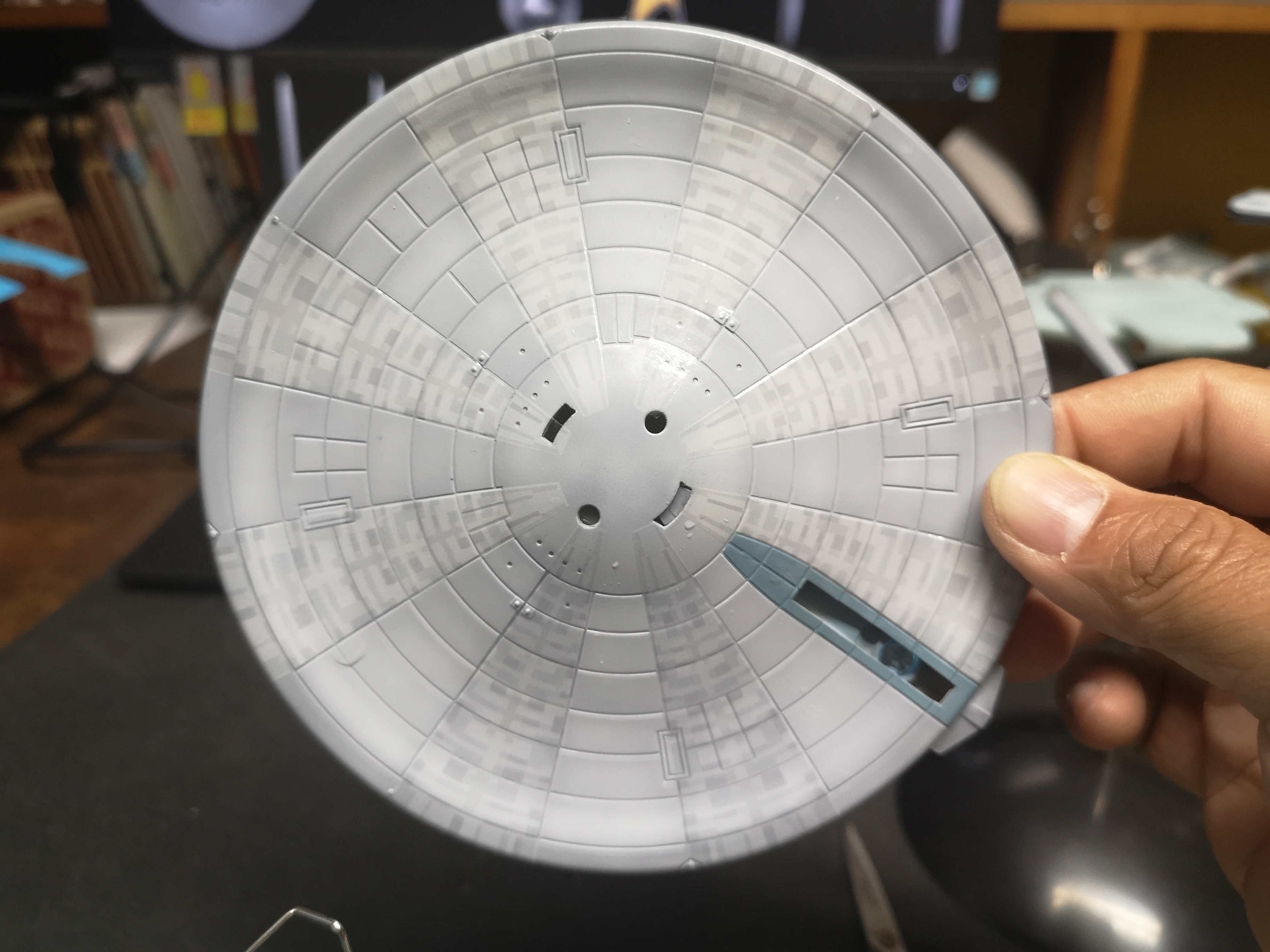

Photo dump:

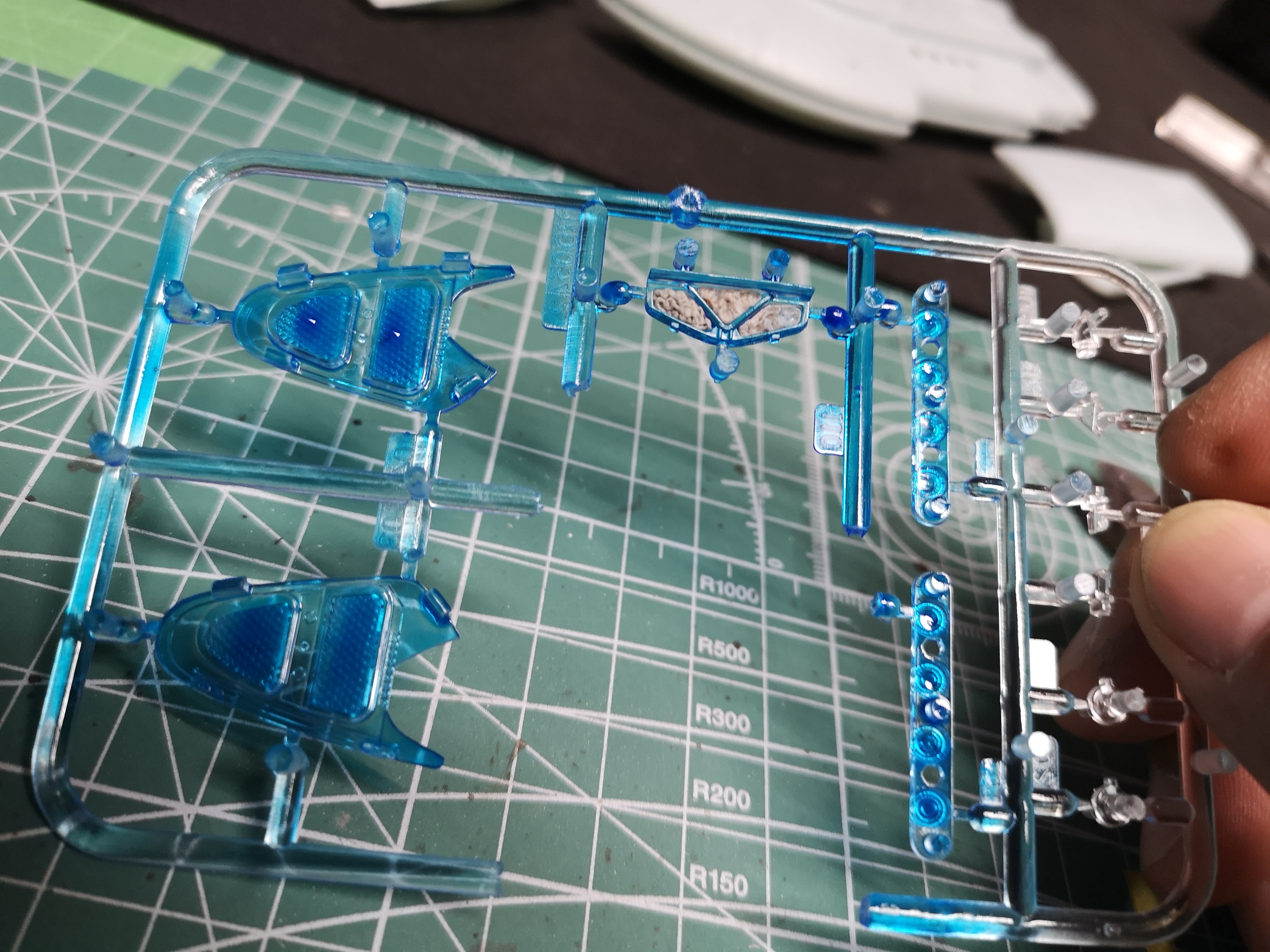

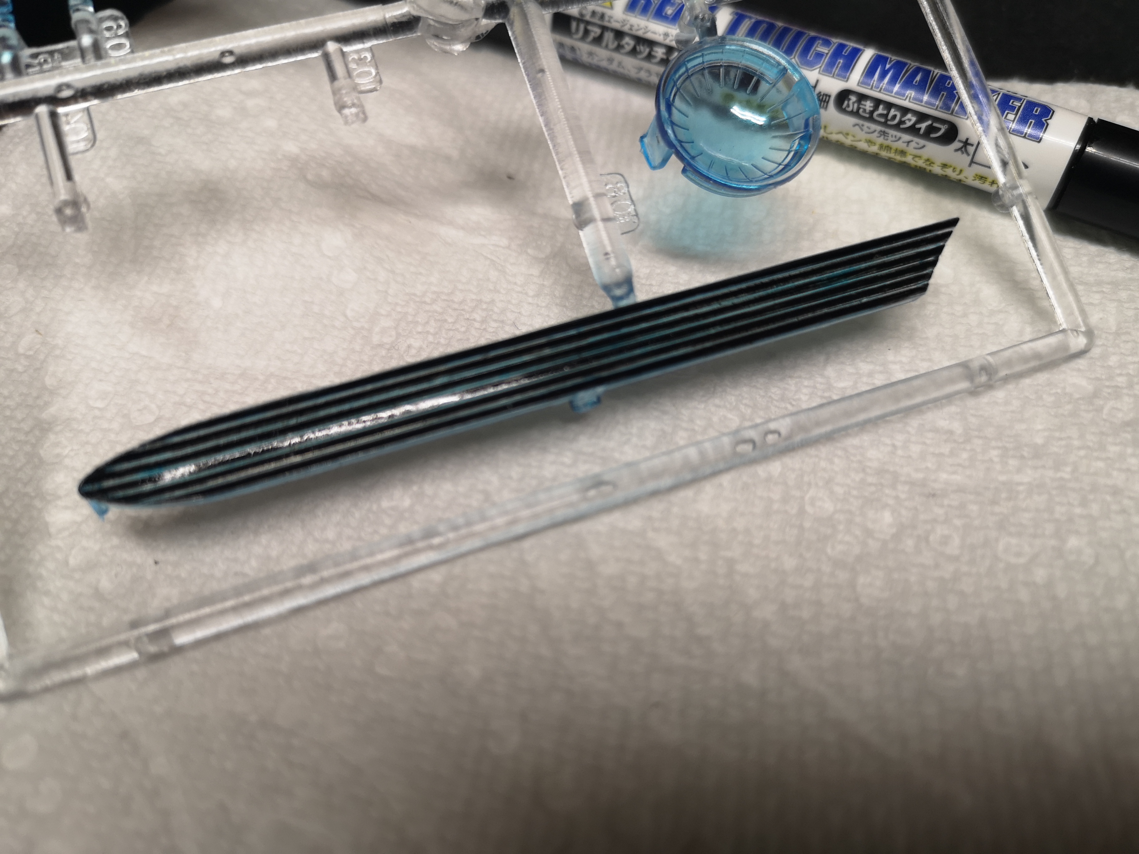

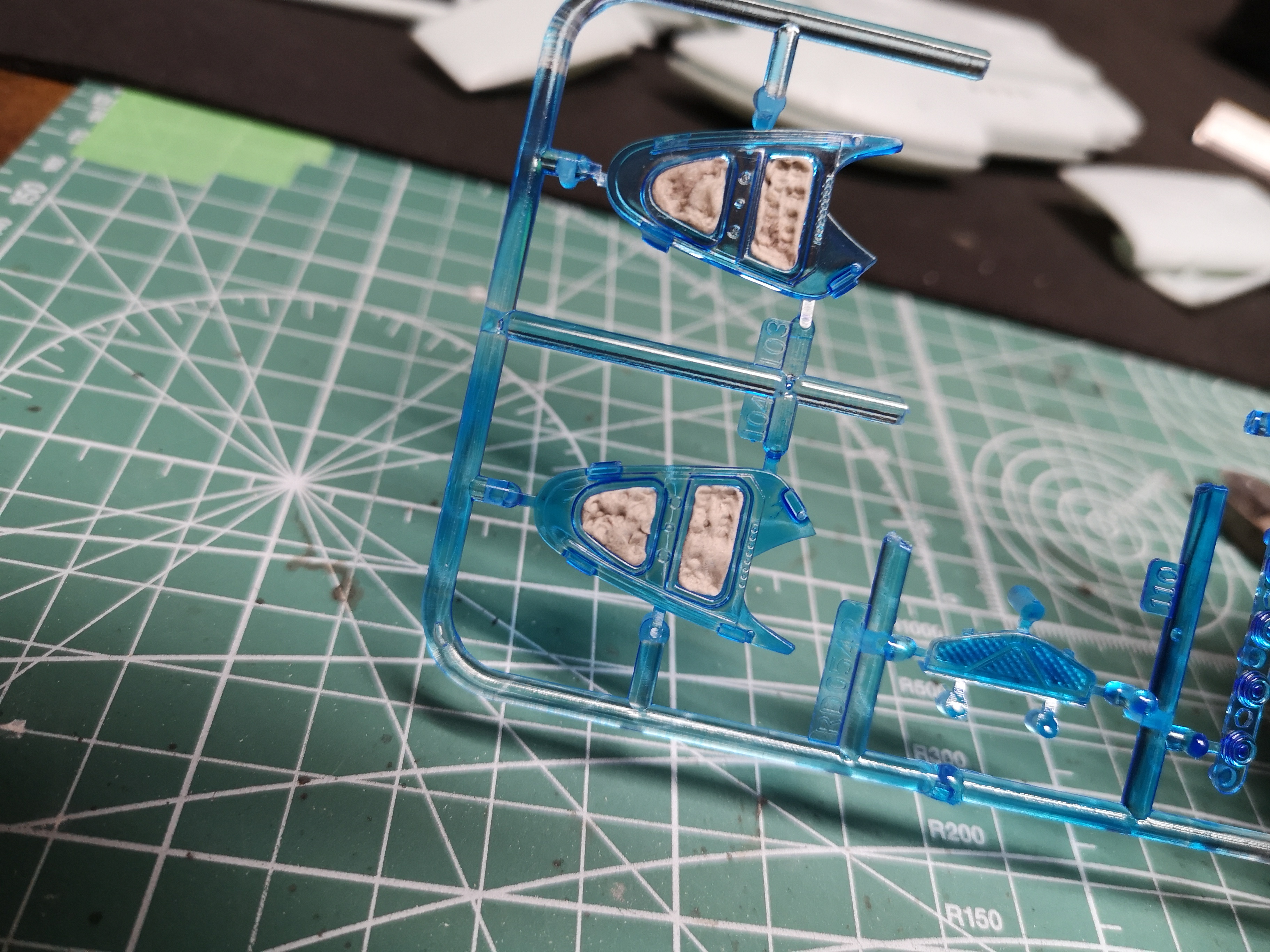

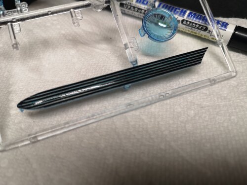

Made a mess of the chillers.  They actually have large flat black surfaces with a slit of light peaking through.  When I was a kid, the whole thing looked blue to me.
Anyway, I tried various ways to simulate the blue behind the black, but without a light source there was no way to see the blue in the thin trenches of the chillers so I just cleaned the black off completely.  Not lighting this one so simulated it is.
The last Refit I built was a 1/2500 and I painted it pure white and it looked pasty, even with the Aztec wallpaper decals.  For this one, I wanted to experiment and see if I could get some unevenness with the panels, so gray primer, white with a drop of gray and then I painted each panel one by one with varying degree of opacity.

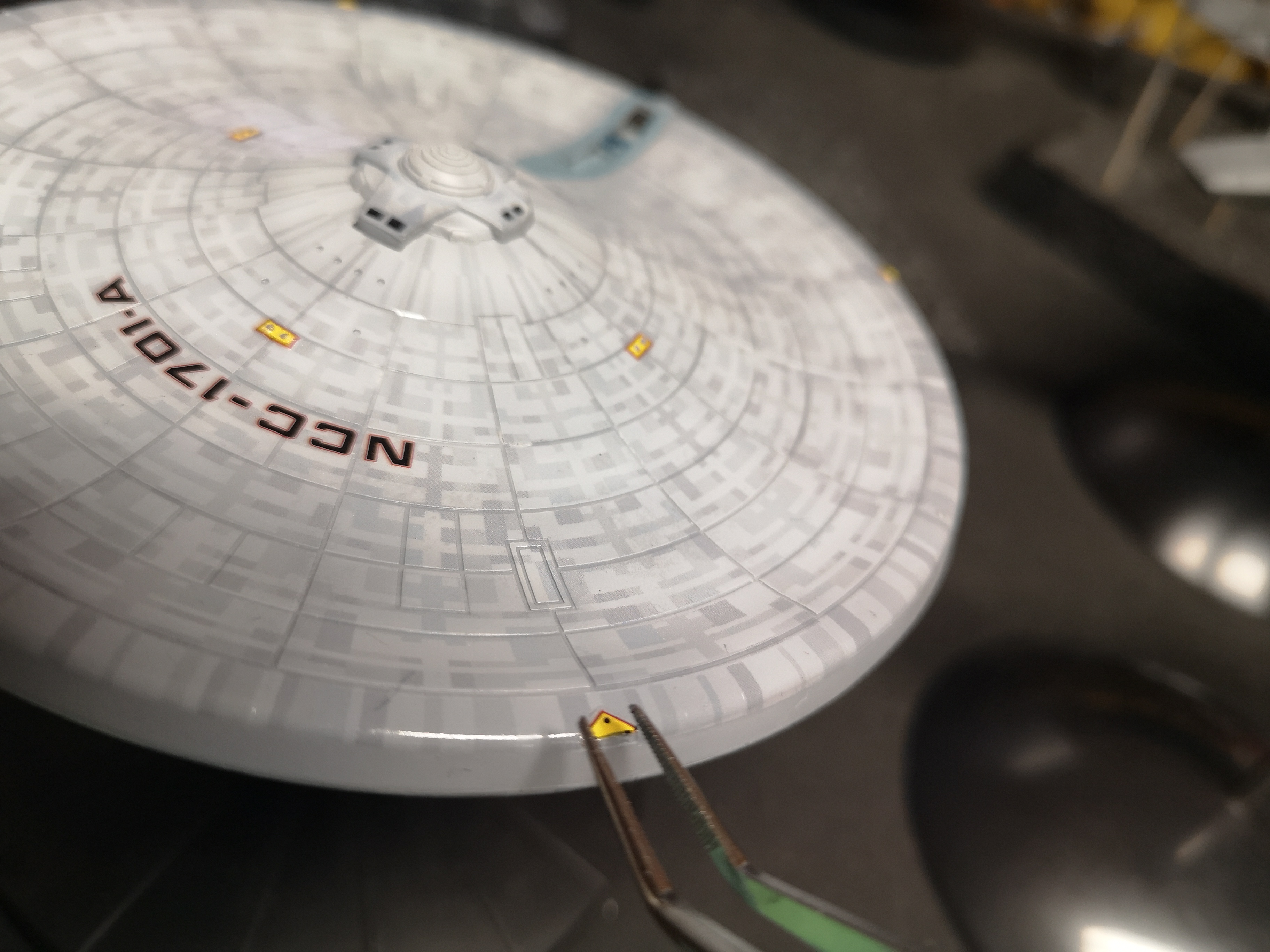

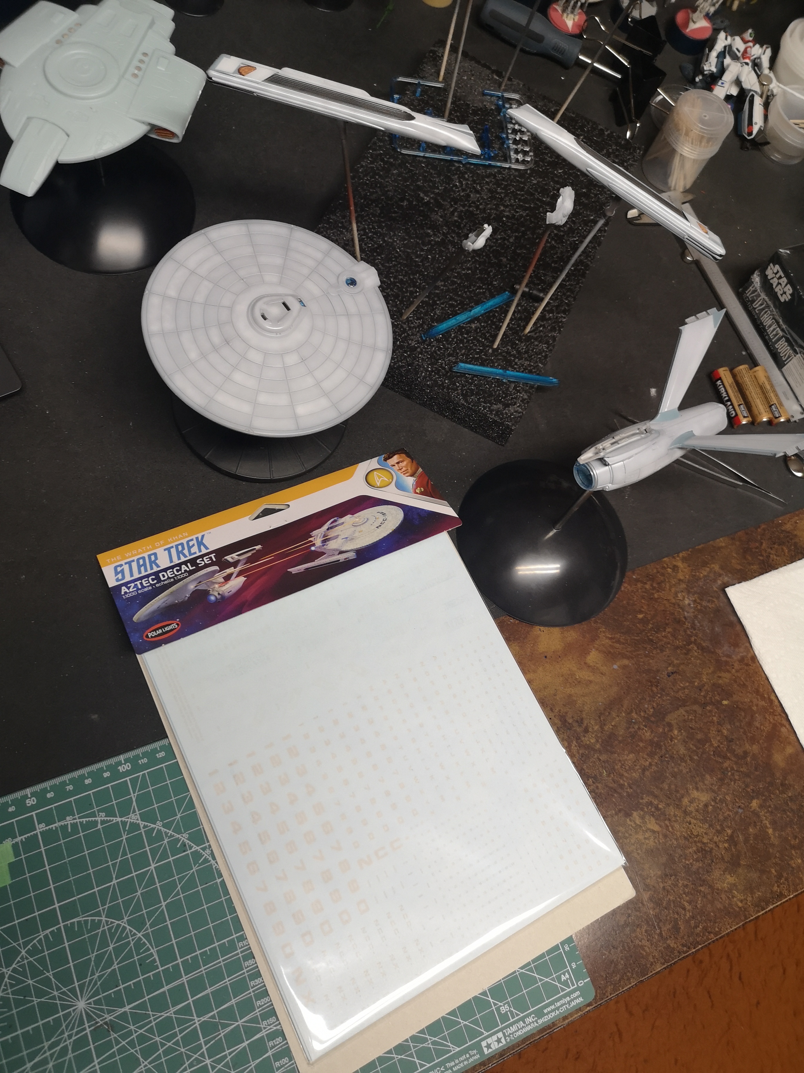

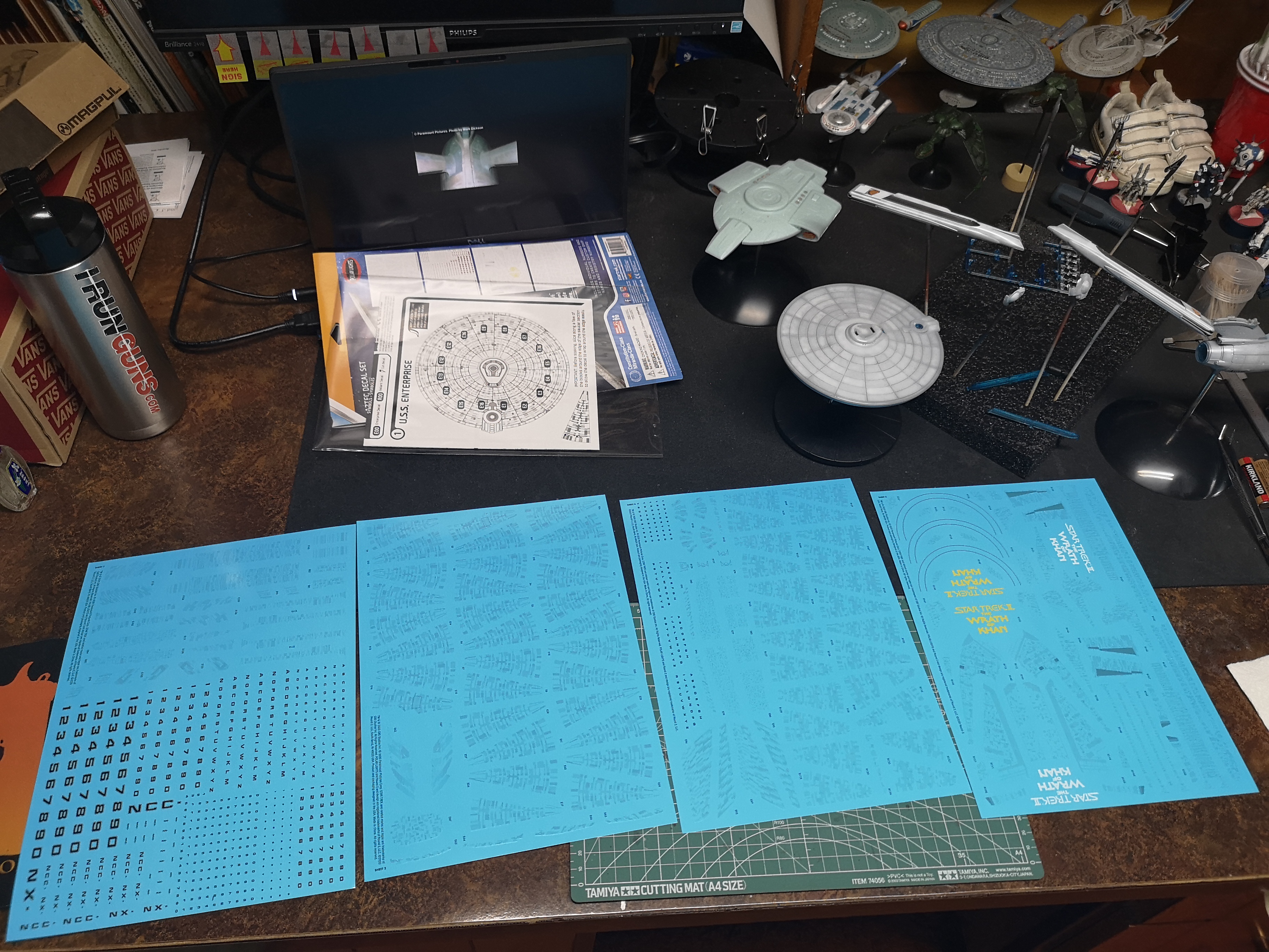

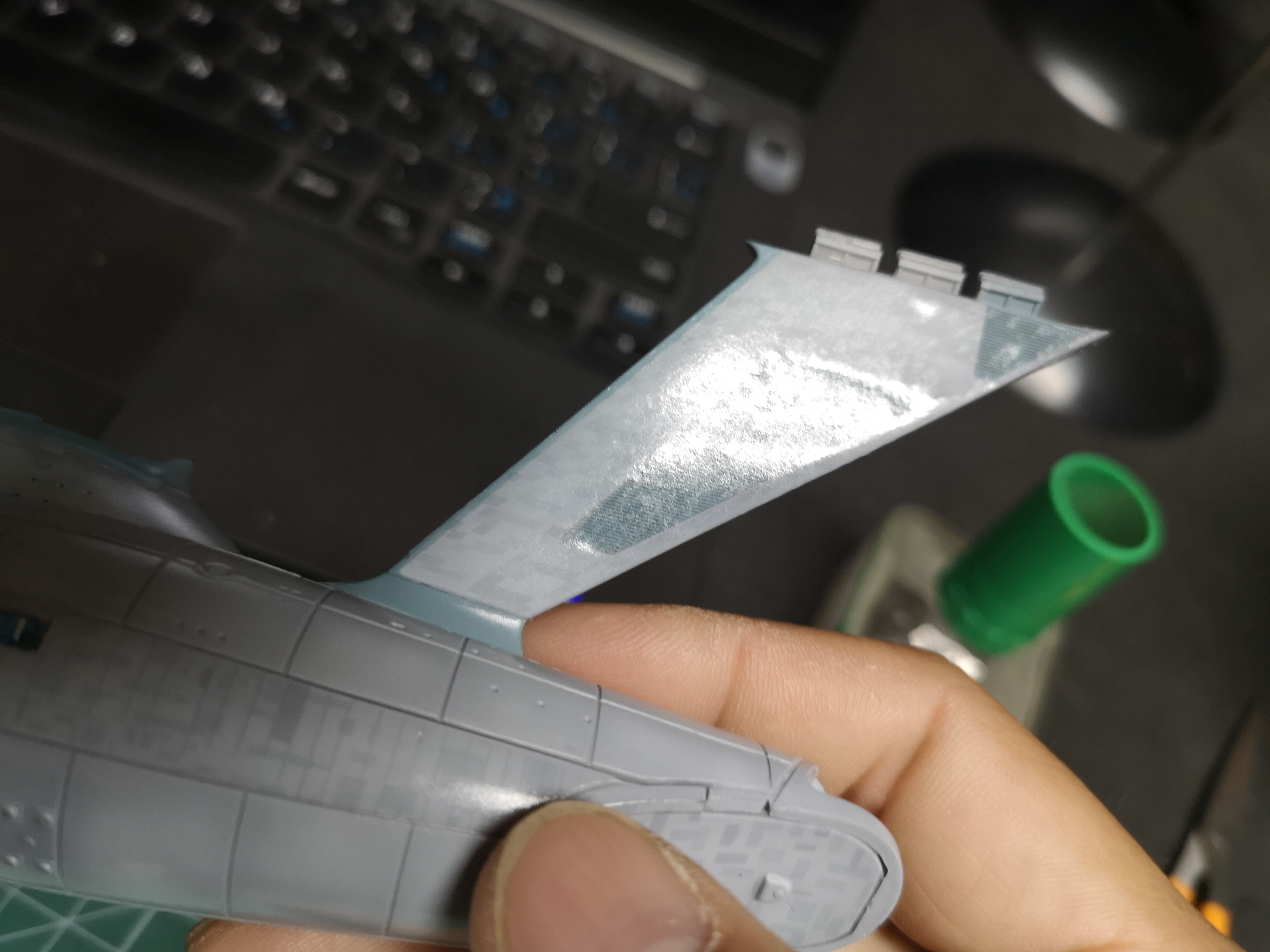

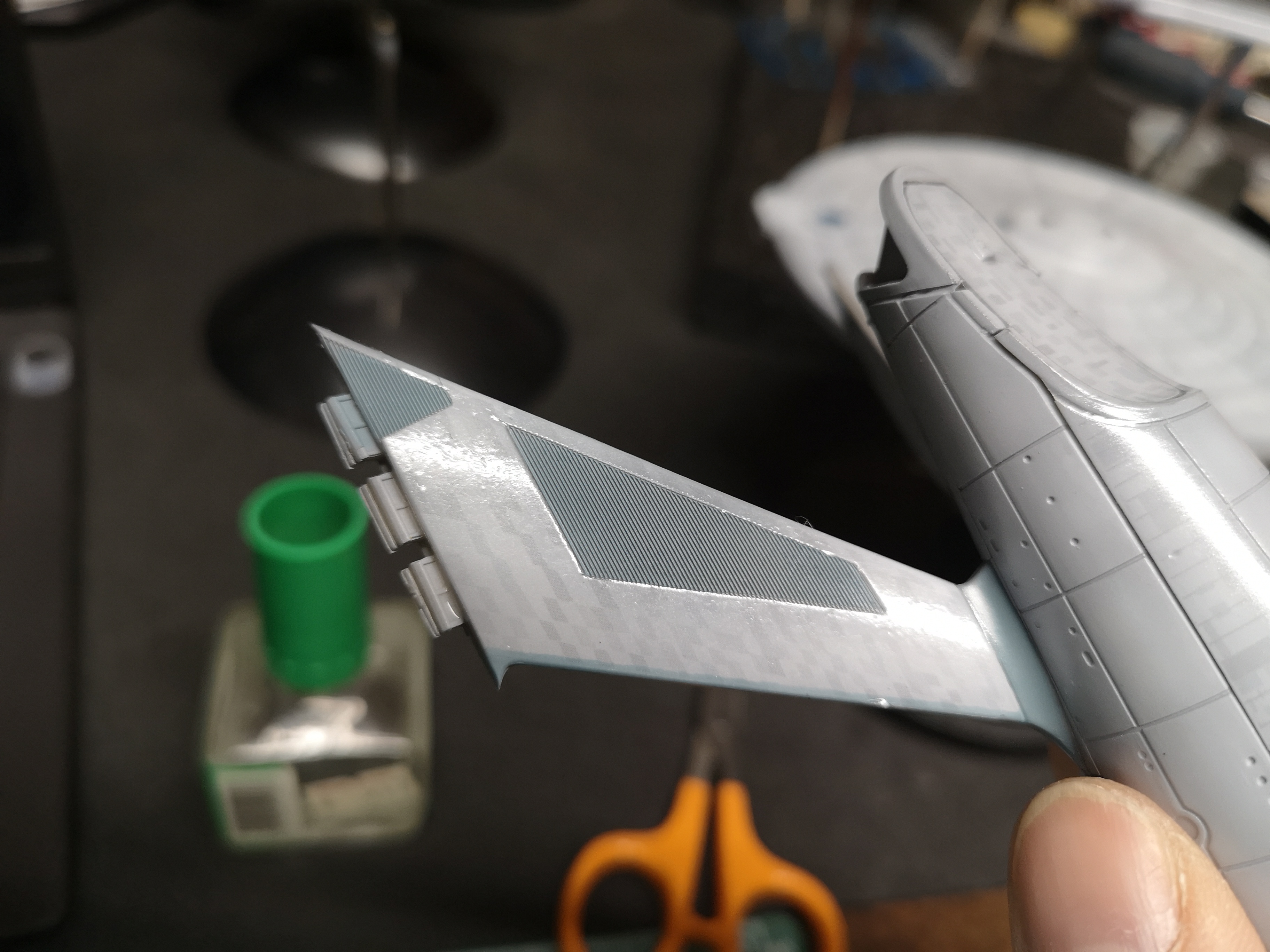

Got the Aztec kit for this and Reliant.
One of the best decals I have ever come across.
They sucked right in, even around odd shapes, bends and edges.  With the wallpaper decals though, you can barely tell the base paint isn't even.
The pylon Aztecs didn't come with the triangles precut.
I found it easier to apply the decal first, let it settle a bit, then cut them out after instead of trying to measure and cut them first.

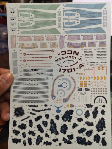

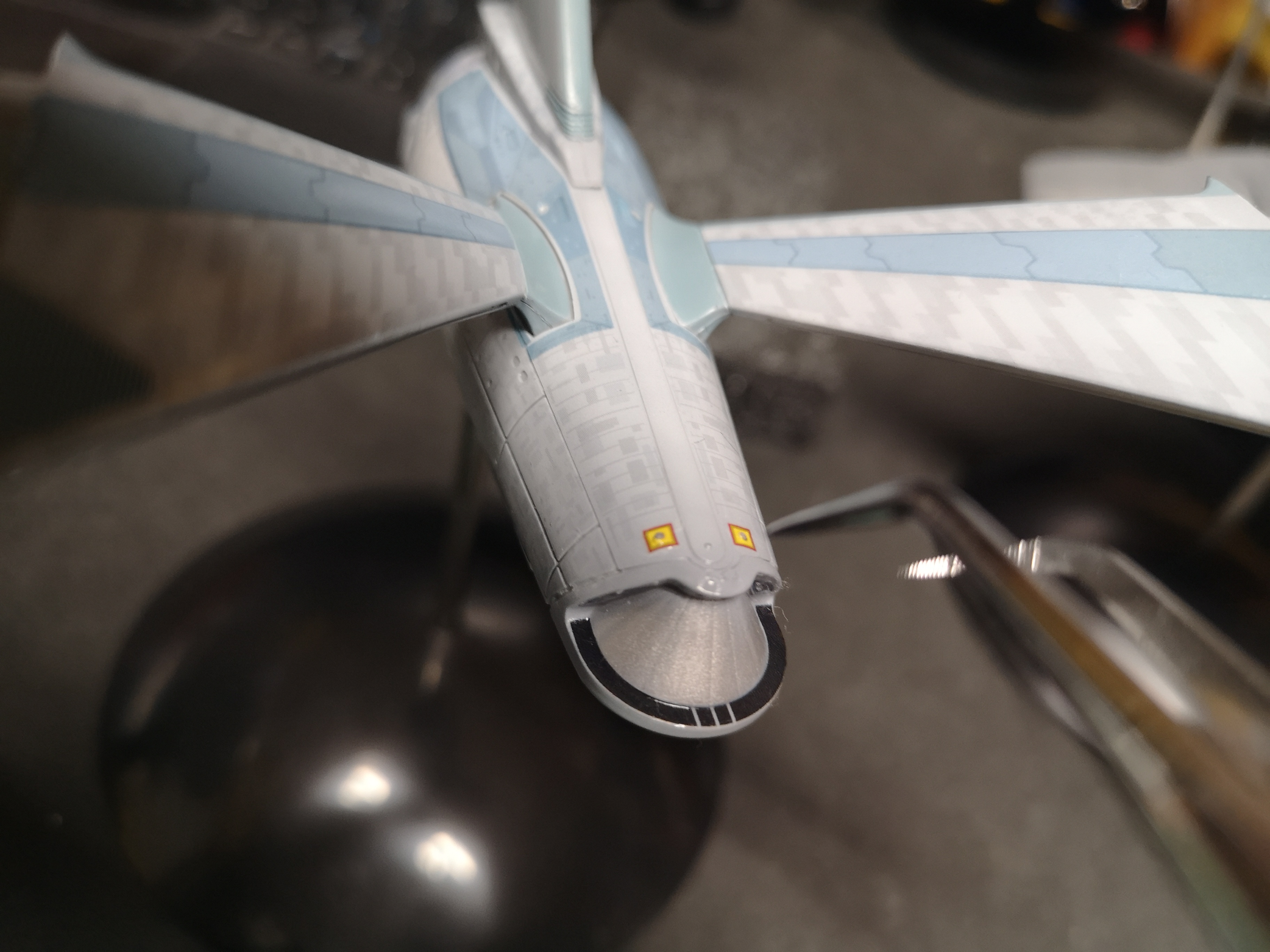

The decals that came with the kit must be a different manufacturer or different batch because although they were ok, they weren't as awesome as the Aztecs.  They just didn't conform around curves and edges as well, though I shouldn't complain as they didn't shatter into a million pieces like some other Round 2 decals.
If I ever build another 1/1000, I'll sand off the nubs on the RCS thrusters so the decal doesn't need to wrap around it.
The phaser emitters on the stern were a bit of a pain too.  Just let them sit on a drop of Mr. Mark Softer and as the liquid evaporates, it sucked the decal down.... With some help of some tweezers.  As you can see, I still have trouble lining up the Strongback decals.  I just hope I don't have this problem when it comes to the 350.

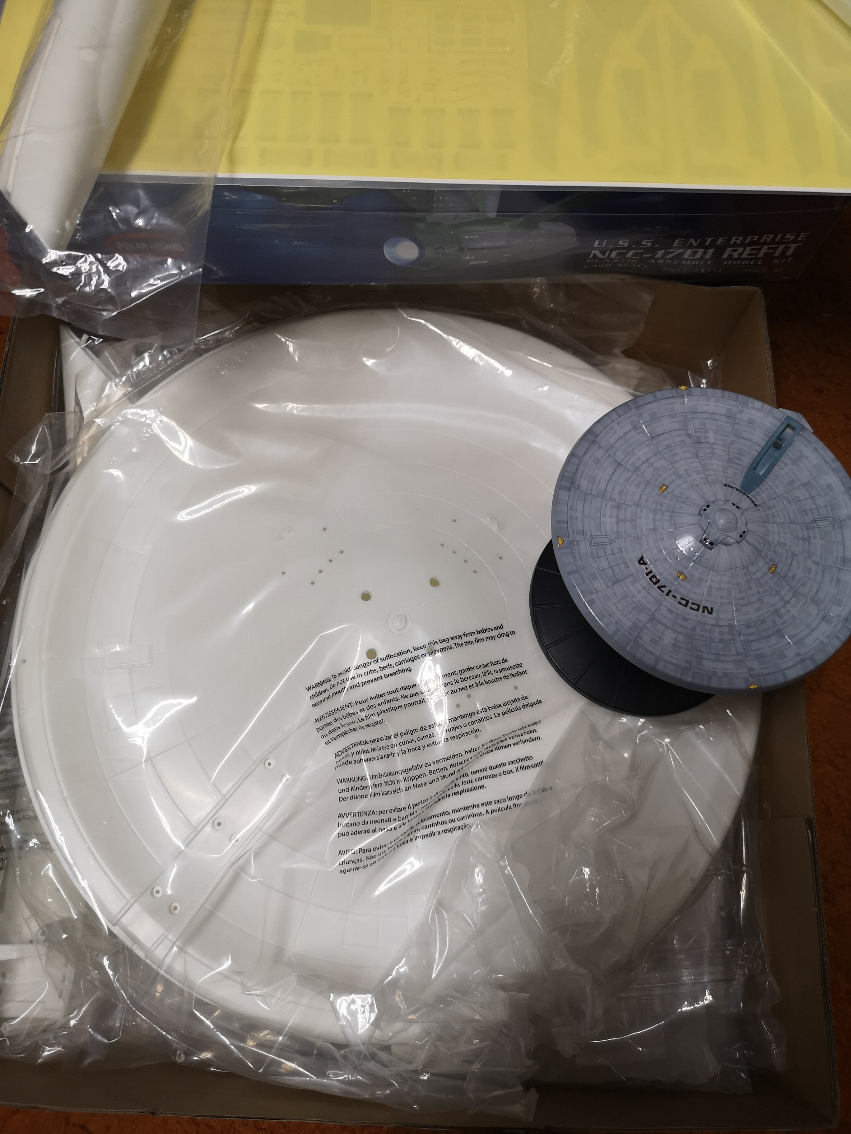

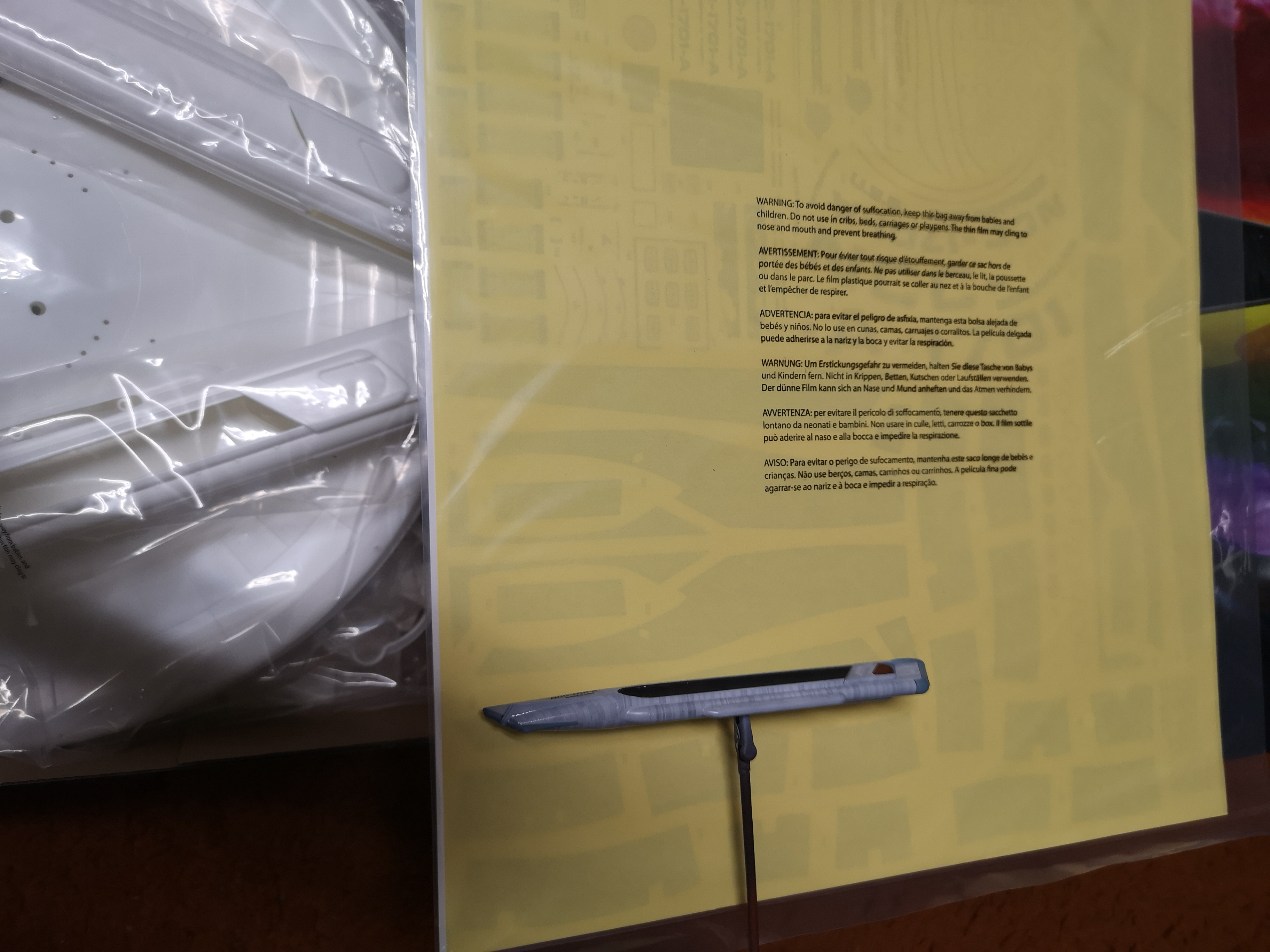

Dug the 350 out for fun.  Sometimes I forget I have this monster.
The strong back decal is as big as a 1/1000 nacelle.

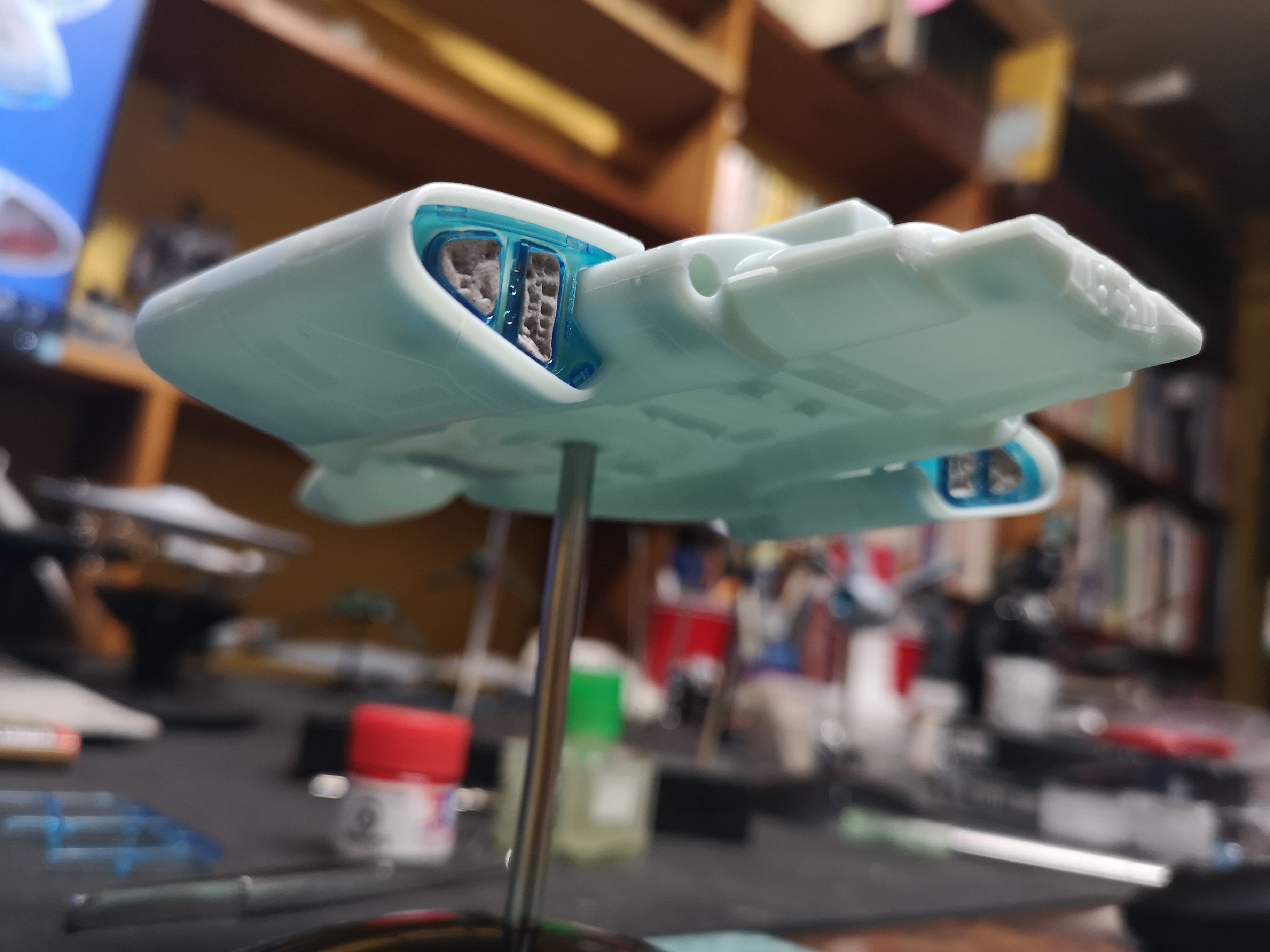

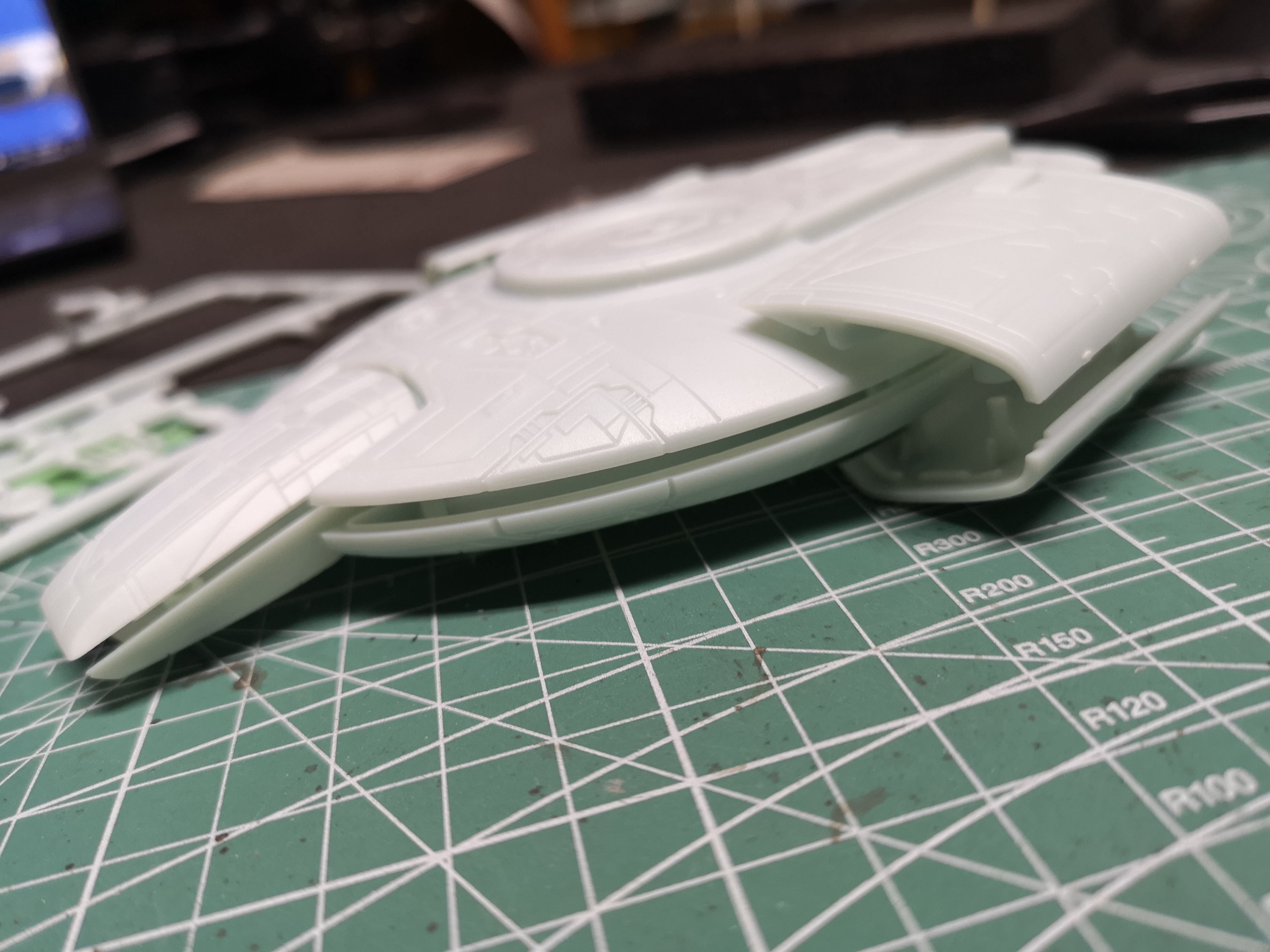

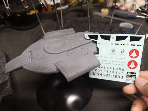

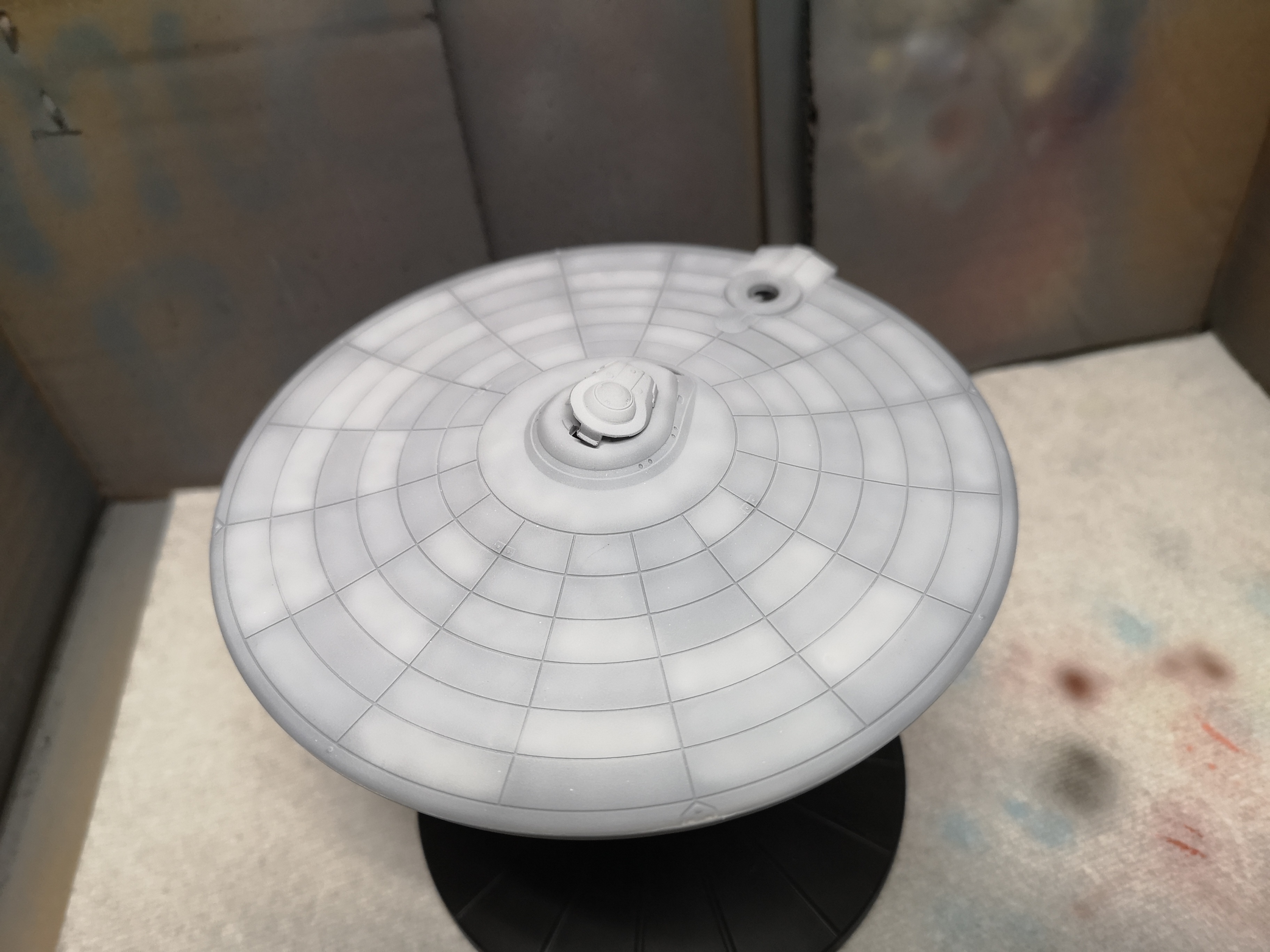

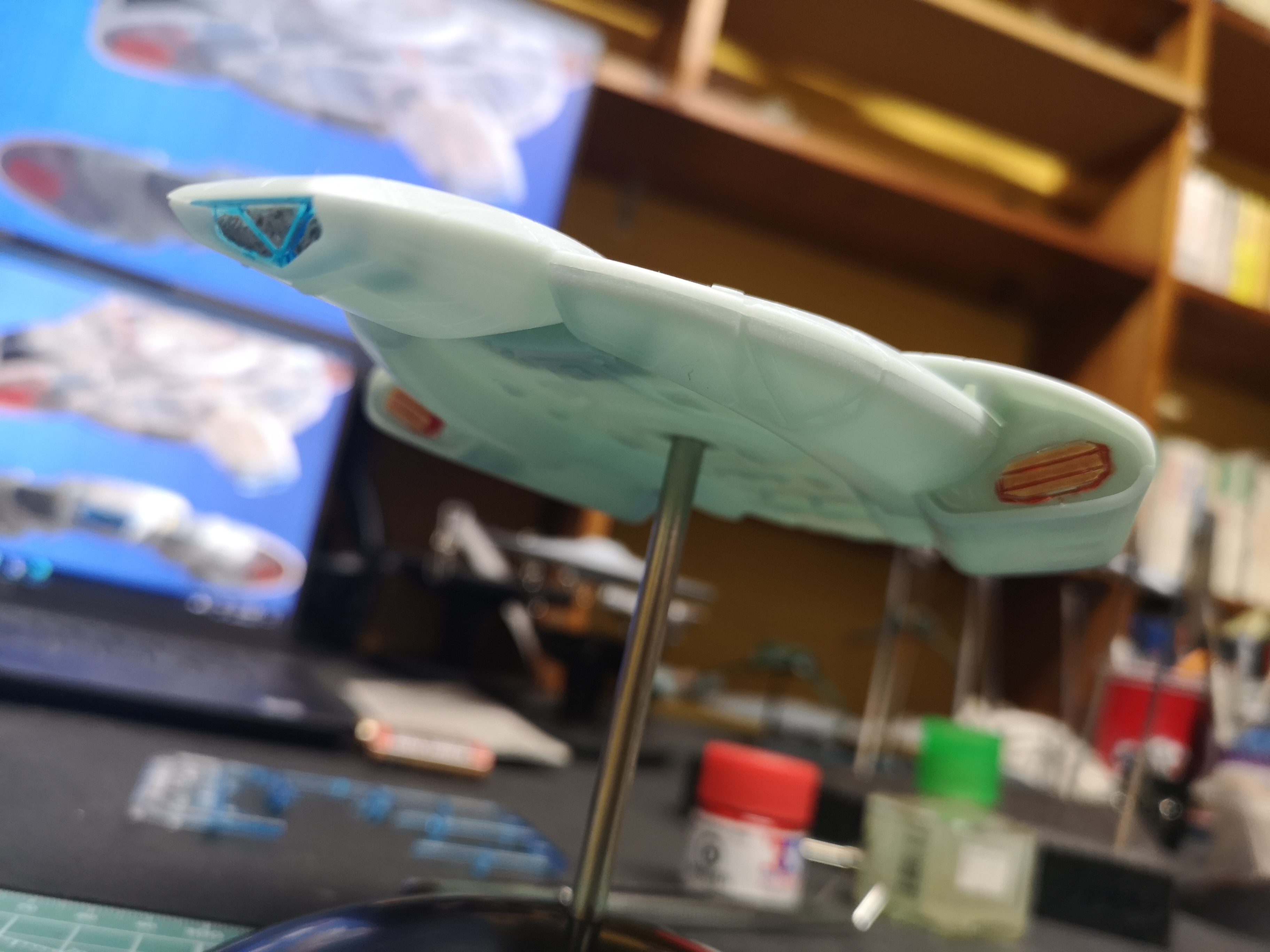

While watching the decals dry on the Refit, I dug my Defiant out. A sandwich within a sandwich, with clear parts captured inside... Yuck.
Lazy masking.
Hope this works, lol!
Not a bad looking ship
I was thinking about experimenting with illumination, but decided I wanted to woosh it around the room more than have it wired to the stand, so no lights.
Should I make it a UN Spacy vessel?  Hahahaha!

Photo dump:
The phased emitters on the stern were a bit of a pain too.  Just let them sit on a drop of Mr. Mark Softer and as the liquid evaporates, it sucked the decal down.... With some help of some tweezers.
Lazy masking.
More to follow :)
The painting and decals on that Refit look excellent!
As to the Defiant, I think those skull and crossbones should find a home somewhere on the nose!
