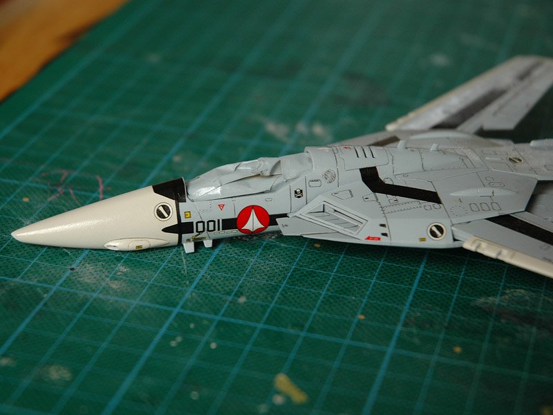

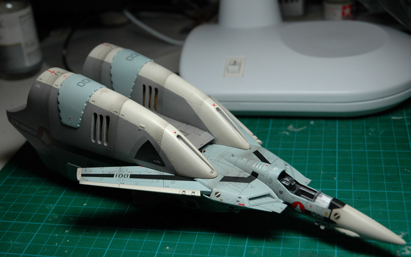

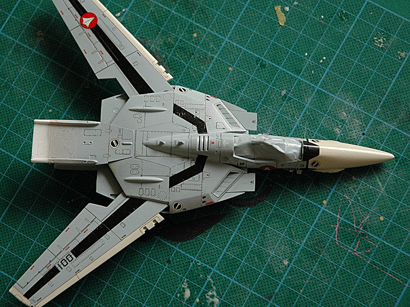

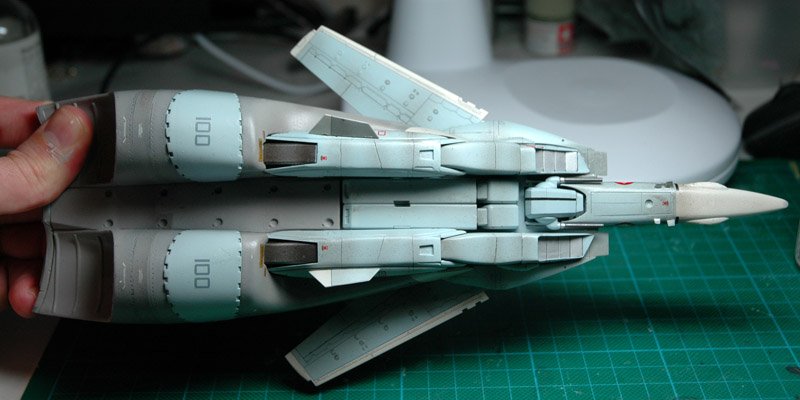

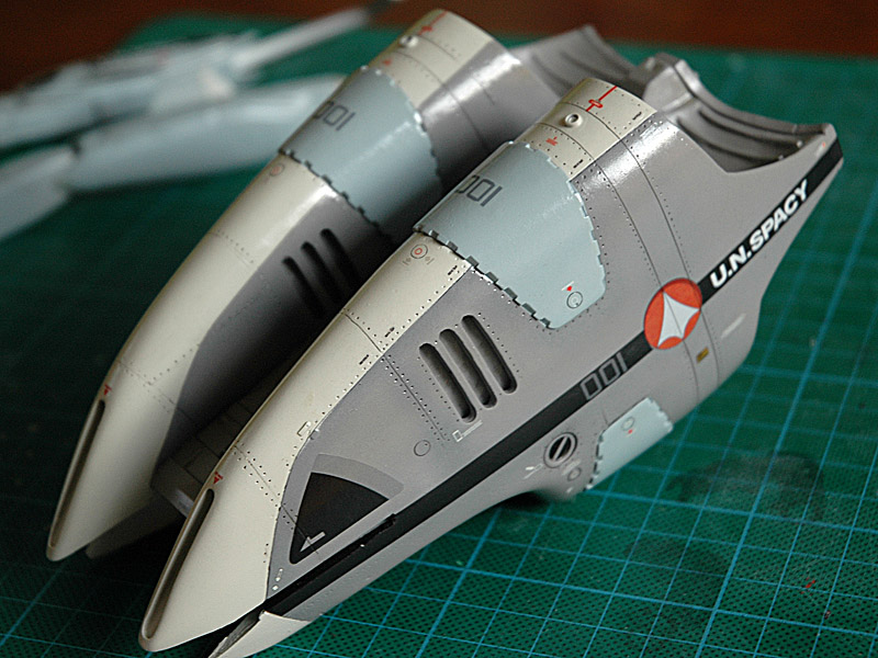

PetarB Posted April 13, 2008 Author Posted April 13, 2008 (edited) Well I spent quite a bit of time panel-lining. Sometimes I use good old odourless solvent + oil wash, but for a lot of this one, I use a technique which I call 'ink & russian roulette'. Basically I use a pigment-marker pen with a tiny nib (very hard to find for me) to line in the panels, and as I go, I have a microfibre cloth which I use a lot. For the type of ink I use, you have around 60 seconds before it sets and is impossible to wipe off. So you mark generously in the panel - like a 'wash' with ink - then wipe off the excess with the microfibre cloth. If you let it set too long you're screwed, so I try and make sure I am not interrupted when I do this. It's the reverse of an oil wash, where you leave it to set for a day (at least I do) before removing the excess. I put grey ink on the white decals, but this hasn't photographed well. This technique has some good applications, but I wont use it on the exhaust bells, for instance. That needs oils for a certain 'look'. Anyway, I just thought I'd post these pics before the next stage - some post shading, mainly on the boosters. The Valkyrie is shortly getting a matte coat and pastels. Hopefully I can post more pics of the results of my airbrushing later today. Edited April 13, 2008 by PetarB

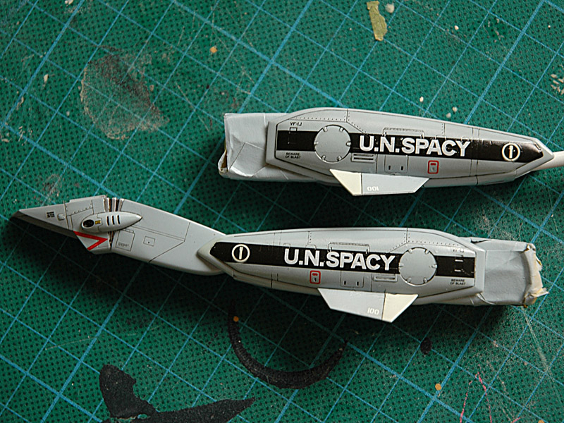

PetarB Posted April 13, 2008 Author Posted April 13, 2008 Okay, back from the airbrushing session. I have three small children, and allocating an hour or so in the daytime for airbrushing on the weekends can be quite a challenge. But I put my new needles in, and got busy with tamiya 'smoke' and gunze 'oil' and started post shading and outlining panel-lines. I overdid it a bit on the booster's cream areas. I may knock them back, but as it's night time now, it's hard to judge. Excuse the quality of these pics too, I won't get a chance to do any photography in daylight until next weekend. After pulling of some masking tape, I simply had to put the valk and the booster together - and then there was nowhere to put them except 'sit' them on the exhaust bells...
PetarB Posted April 13, 2008 Author Posted April 13, 2008 Some further reflections - Firstly, Im really happy because I can now see the light at the end of the tunnel on this one - I should be able to finish it next weekend. I need to because I have to start the masters of a couple of pilot sets before I go on holiday for a couple of weeks, so they are ready for production. I will use the pilot I'm about to paint up as an opportunity to study and see if it's worth putting together a Macross set. Secondly, I think I will have to purchase the stand that John Moscato sculpted to mount this on. Basically there's no way to display this with any justice other than tilting up, aiming at the sky. The whole shape of the Booster + Valkyrie just screams 'upward and onward.' Oh well, there goes my modelling budget for the next couple of months... Finally, thanks for everyone's comments so far. It's fun to be able to show off you work, I wish more people would. I love coming here and seeing new spins on old favourites, and new models too. I can't wait for Bandai's new VF-25...
cowie165 Posted April 13, 2008 Posted April 13, 2008 (edited) Petar, I don't know how you managed to pull off a baby blue Valkyrie, but boy you've done it. It will look great next to the VF-4. Excellent work! Based on the pics, I agree the smoke is a little heavy, but the overall finish is tip top. Hey are you planning on a little pastel on the bells or staying with the high gloss? Edited April 13, 2008 by cowie165
MechTech Posted April 13, 2008 Posted April 13, 2008 Awesome finish man! The colors are mesh together great! - MT

PetarB Posted April 13, 2008 Author Posted April 13, 2008 Based on the pics, I agree the smoke is a little heavy, but the overall finish is tip top. Hey are you planning on a little pastel on the bells or staying with the high gloss? I took another look at the booster this morning in daylight. I'm going to tone down the smoke a bit in the next airbrushing session I do, it's a bit too much at the moment. It should blend it back nicely. As for the engine bells, I love the clean aluminium look to them, but I am going to be airbrushing them a little and putting an oil wash on... let's see what happens!
cowie165 Posted April 13, 2008 Posted April 13, 2008 By the way Petar, which colour did you use for the off-white? Or is it a gloss white with a drop of yellow perhaps? It just has a nice 'faded' white feel to it and I'd love to know how you did it.
PetarB Posted April 14, 2008 Author Posted April 14, 2008 (edited) A few drops of Tamiya XF-55 Desert (or Deck?) Tan was mixed with a few mL of XF-2 Flat White. The gloss was provided by an overcoat of 'Pledge One-Go' here in Australia, or 'Future' in USA. Edited April 14, 2008 by PetarB

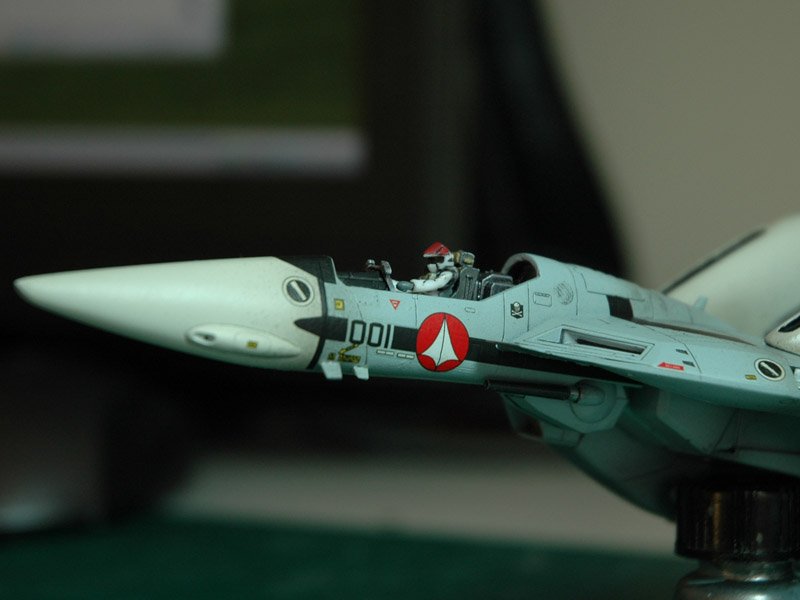

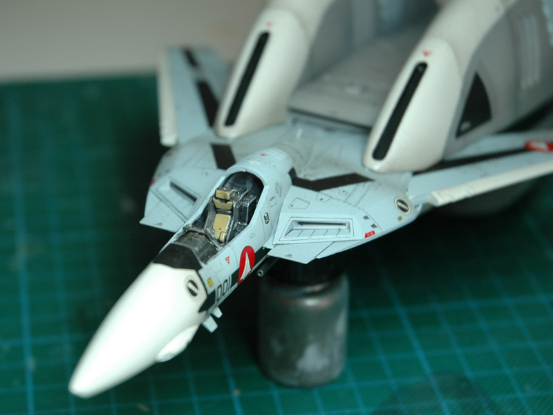

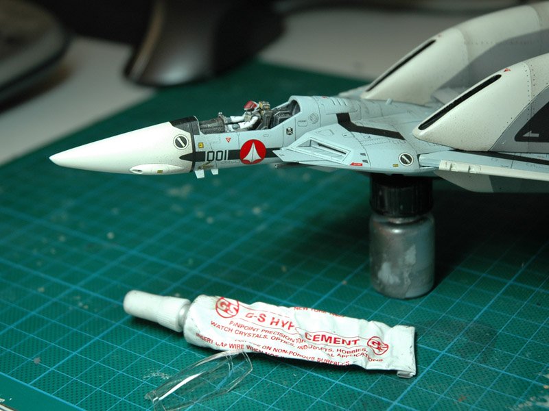

PetarB Posted April 15, 2008 Author Posted April 15, 2008 Canopy time! After removing the seam with sandpaper and polish, it was dunked in Future and left overnight. But before I could put it on, I needed to finish the seat and pilot. The glue shown in the second pic is G-S Hypo Cement. Its a relatively recent invention but and it works superbly for canopies - no residue, invisible, and a fast tight bond. Jewellers use it for setting stones and such. I was very happy to be able to find it at a hobby shop a few years ago, but I have not seen it anywhere since. No pics of the canopy and trim on as yet, I may get to progress a little more later tonight...
azrhino Posted April 15, 2008 Posted April 15, 2008 Check your local craft shop for G-S Hypo Cement. In the United States, it can be found at Michael's and Hobby Lobby. You may have to do some serious searching for it. Sometimes it is in with the glues and adhesives, sometimes it is with the jewelry making stuff.

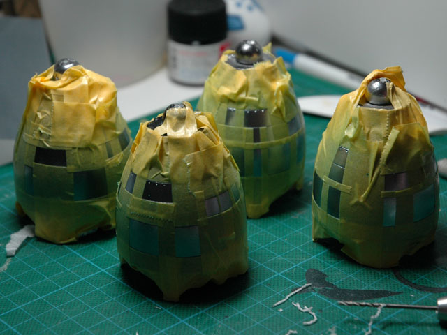

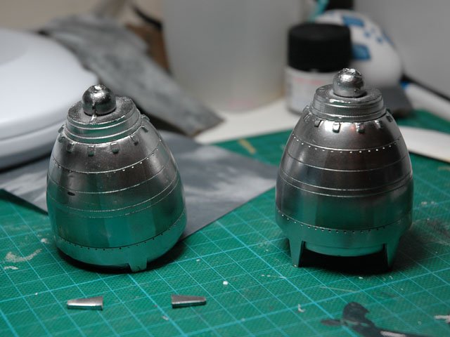

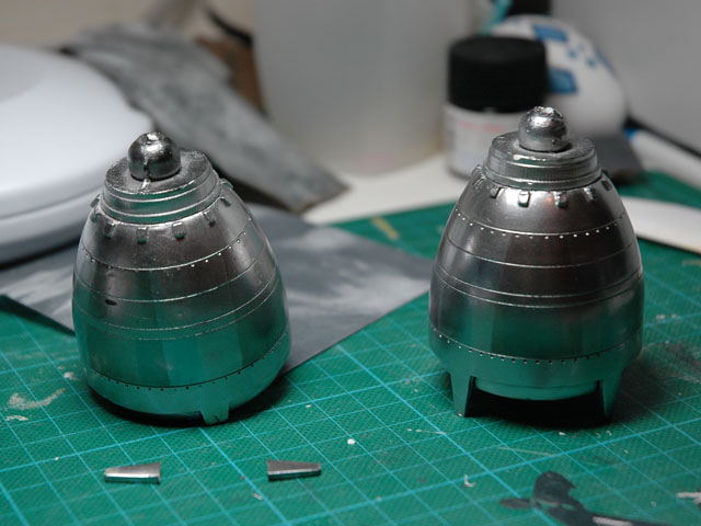

PetarB Posted April 20, 2008 Author Posted April 20, 2008 Not much of an update, except to report a minor disaster.... I decided to emulate MWChengs booster treatment in airbushing panels on to the engine bells - looked good to me. After coating Alclad in Future, which did not change the finish too much, I did a lot of masking. Next I put a mix of Tamiya Clear Blue and Windex, which seemed to work well. Quite hard to photograph though, due to reflections from the green cutting mat their on. Final pics on a white background should show it up better later. I wasn't quite satisfied with this, but I didn't want to put any yellow or orange dusting on yet... wasn't sure how well it would tie in with the booster. So I sealed the blue with Future and re-masked. This time I used a mix of Smoke and a few other bits and pieces, and once done, I put them down. CLUMSY FINGERS! I dropped one a centimeter away from the surface. Three of the 'fins' snapped off, it rolled into another and broke a fin off that one. ARRRGH! Anyway, glueing them on at the moment, although one is lost. I think the original mould of these bells had these all integral to one mould. In the casting I got, they were seperate, and putting them all on... wasn't the most fun thing, and also hasn't really made them very strong. If I ever built one of these again, I would probably go to the effort of pinning each and every one of these (16). They shouldn't have broken off so easily. These pics really dont show the subtle blue and smoky panels well - probably due to the different finishes. Another coat of Future, and an oil wash should bind them together better. Sorry for the small update. Next weekend should be centrefold spread time, I hope!
wm cheng Posted April 20, 2008 Posted April 20, 2008 Sorry to hear about the fins snapping off - a few of mine also snapped off too - a bitch to glue back, fill and sand. I think the resin is a bit brittle, plus its just a delicate protrusion - one of the reasons I "had" to get the launch rail, its the only way to properly display the model once its built so all the delicate parts aren't bearing on anything. Did you say in your post you did a mixture of Tamiya Clear Blue with Windex? Doesn't the windex react with any of the Tamiya acrylics? I use windex to either strip previously painted parts or to clean my airbrush between colours!
PetarB Posted April 20, 2008 Author Posted April 20, 2008 Doesn't the windex react with any of the Tamiya acrylics? I use windex to either strip previously painted parts or to clean my airbrush between colours! Yes. I used Windex because for me, the alcoholic thinner sometimes speeds the drying time so much that I cannot airbrush as finely as I would like too. Windex does a decent job of thinning and seems to retard drying times - which is good for certain applications. I find alcohol thinners speed up drying times dramatically, which is great for flat finishes, but not so good for gloss and clear finishes - for me, at any rate.
wm cheng Posted April 21, 2008 Posted April 21, 2008 I not so sure if its wise to mix something ammonia based such as Windex with an acrylic paint like Tamiya - at least in the long term effects might be questionable. Might I suggest trying to airbrush at different PSI and mixture viscosities to get the paint to dry at a rate you want. I've found that by varying either the pressure or mixture of the paint, you can pretty much get it to do whatever you want. Then again, I'm a play it safe kind of guy... I still pay the extortive prices they charge for the "real" Tamiya thinner - my thinking is... how much is your time and effort worth? I'd hate to find out a few years down the line that I "cheaped out" on a procedure or a few cents here and there and have some finish start crackling or crazing on me. I've had a few models done that to me over the years - and boy am I sorry now.
PetarB Posted April 21, 2008 Author Posted April 21, 2008 I must admit, I've been using small amounts of Windex as a thinner for certain applications of Tamiya paints for many years, and have not found any issues to date. Time will tell though...! I hope there are no longer term effects that are only obvious later on...

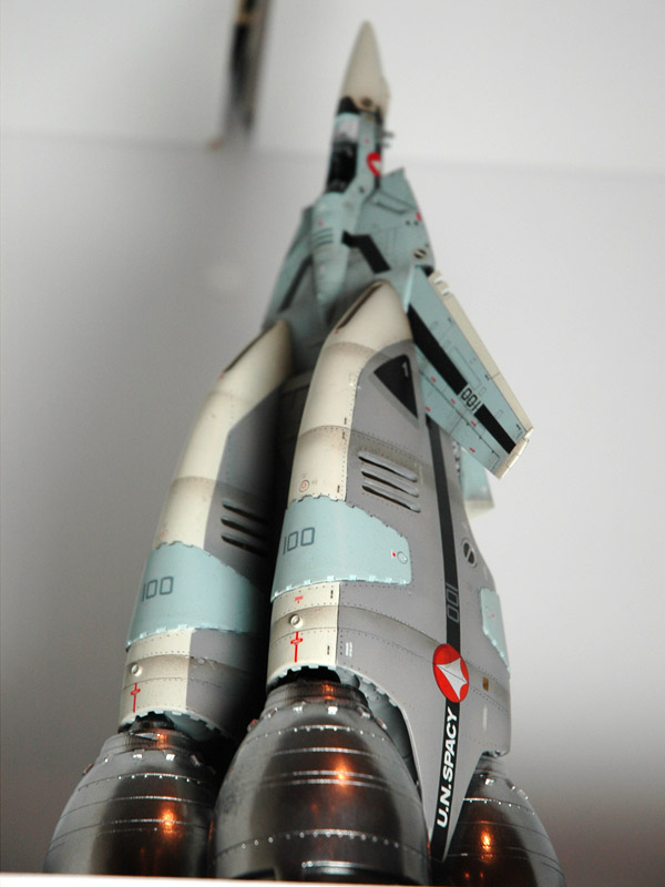

PetarB Posted April 27, 2008 Author Posted April 27, 2008 This old girl is finished for now. A lot more pics can been seen in this thread here http://macrossworld.com/mwf/index.php?showtopic=25896
big F Posted April 27, 2008 Posted April 27, 2008 This old girl is finished for now. A lot more pics can been seen in this thread here http://macrossworld.com/mwf/index.php?showtopic=25896 AWESOME !!! I really think that color works.
nightmareB4macross Posted April 27, 2008 Posted April 27, 2008 The color selected for this piece is beautiful. Wonderful job. Any chance of getting more angles?
