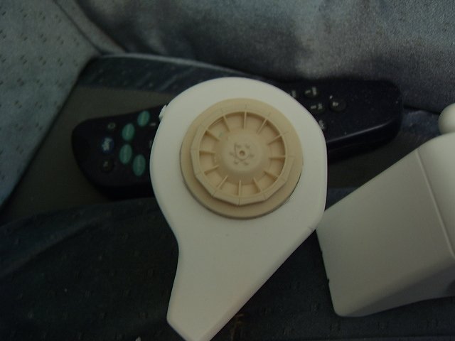

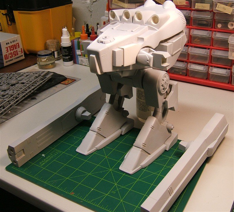

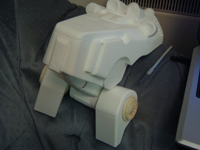

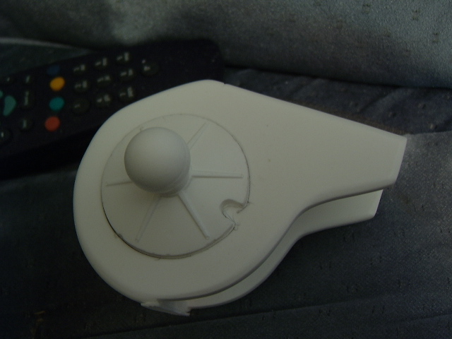

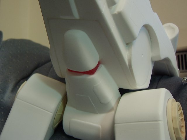

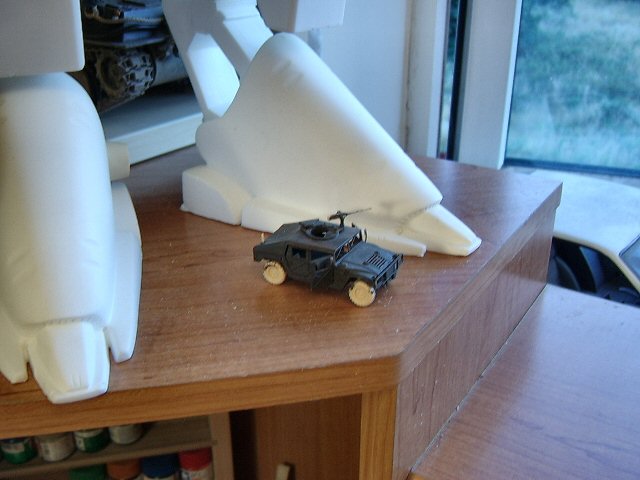

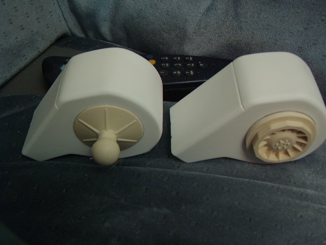

well here is the first nights work. The upper body plates are in and just need to be blended and sanded in place. Need to get some putty/bondo for that. The hip "whistles" are assembled, they fit snugly in their sockets but will not provide enough tension to hold the monster upright when complete. Thats ok for me. They will be held firmly in place using magnets and tension. The magnets will be embedded into the socket of the hip and the ball end will be drilled out and filled with steel BBs. The red fillet on the lower hull is a really tight fit and required extra sanding inside the slot where it goes to get it in. Looks good in place though. I wont be lighting the kit but i will be backing all the red pieces with white r chrome so any light getting in will be bounced and amplified back out. This will give the parts a "glow" that wont distract from the model.
Another thing i will do to extend the overall life of the hips is to drill them through and insert a hardwood dowel into them to keep the weight from warping the resin over the years.
Well Enjoy the first pics of a monster under construction :D

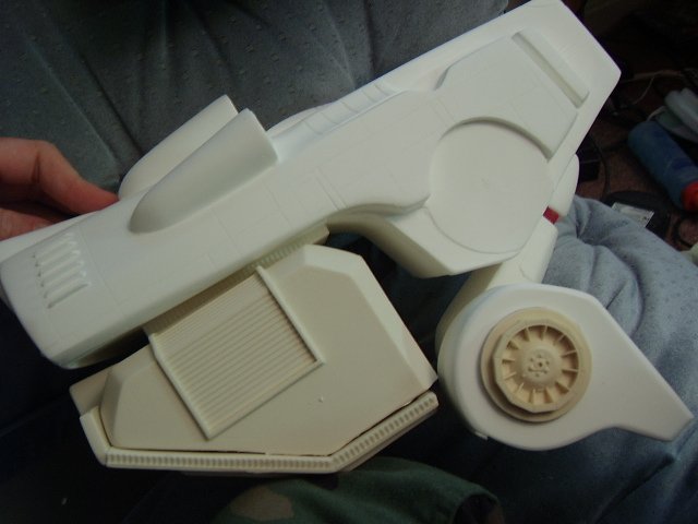

No prob Ignacio. I hope that by seeing one get built it inspires others to build theirs instead of be afraid of something so large. Mike did an excellent job on this kit. Ill be adding or adjusting a few little details just for my own liking but on the whole the kit is great as it is. One note to add though is that the lower plates that fit into the upper body may require some extra sanding and adjusting to get them to fit flush overall. Once thats done its a simple matter to slather on the filler and wetsand away the excess. The most progress will be over the weekend once i can get my filler. I also want to cleanup the inside of the missile ports on the arms or back them off with a cover like modern missile launchers have. The scale and size of this kit will allow alot of options never before afforded to this vehicle. Its only been COMMONLY available in 1/160 and 1/200 scale . There have been limited ones in 1/144 and a bad heavy paperweight of a 1/72 scale a few years back. THIS ONE will look excellent sitting next to the available hasegawas and other 1/72 scale macross kits.

I am planning to start the instructions for the kit most likely on monday or tuesday next week. For the "hip" ball joints i am going to recommend drilling a 1/8 inch hole thru the ball joint and into the upper leg, then inserting a 1/8 inch solid brass rod, i did that for the dry fit and it held it together without any glue...
The body panels will be one of the parts that will need the most tweaking to fit in, the main body shrinks a bit more than the 3 panels that fill the bottom because it is 3lbs of resin, and anything that generates that kind of heat will shrink more than some thing that is only 1/4lb of resin...

The lower body panels didnt take too much tweaking overall. Id rather have a good firm fit in them than a loose fit where weight stresses would cause cracks to develop in that area. I had planned the same fix on the ball joints myself but i glued mine on to facilitate drilling through both parts and having the hole line up. i am going to drive the rod/dowel in fitst then cap it with a steel pin like a push pin. The pin will be countersunk so it will keep the rounded shape. With the strength of the magnet inside, the friction of the fit and the steel cap on the ball i shouldnt have to glue it in. It will allow th joint to retain its movement.

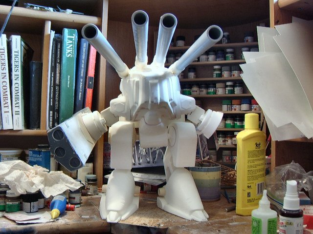

I decided to say frack it and build it with magnets in the design. with that ill be able to take off the arms, legs, and main cannons and pack them in foam seperately in a large footlocker. This way it will get max protection and travel better. I can also ust the footlocker to take it to contests and shows when im back in the world.
More pics coming up. Its on its feet(temporarily) im building all the subassemblies so when i install the magnets ill be able to test if they will hold or of ill need more magnets. .
No offense to mike but i like the look of the 1/100 feet a little more. The sharp edges i dont like but the toe shape and the indentations on the foot match line art a bit better. Not that this really bothers me much the damn thing is almost 2 feet tall :blink:

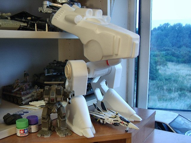

Wow Mike, HWR's pictures really show off the great work you put into this monster! And they show off the size too!

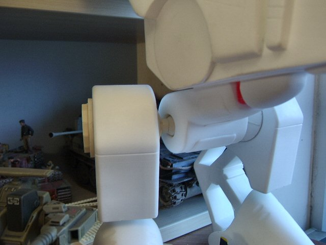

HWR, are the legs holding up the body by friction alone in those pics! :blink: If so, your magnet idea should work great. Will that allow the hip joints to retain some posability? Please post some detailed pics and descriptions, I'm very interested in that part of the construction especially.

Yes with the legs pitched outward at this point it does support itself. It is touchy and still loose but it stands. I dont know how well balanced it will be once the rear portion, arms and cannons are on but the magnets should make up for it. Im going to see if i can source some magnets locally before i go buying them online. There are plenty of hardware stores and such that may carry them. Ill know more tomorow. If i can get the magnets tomorrow expect to see the first rough, unpainted assembly soon.

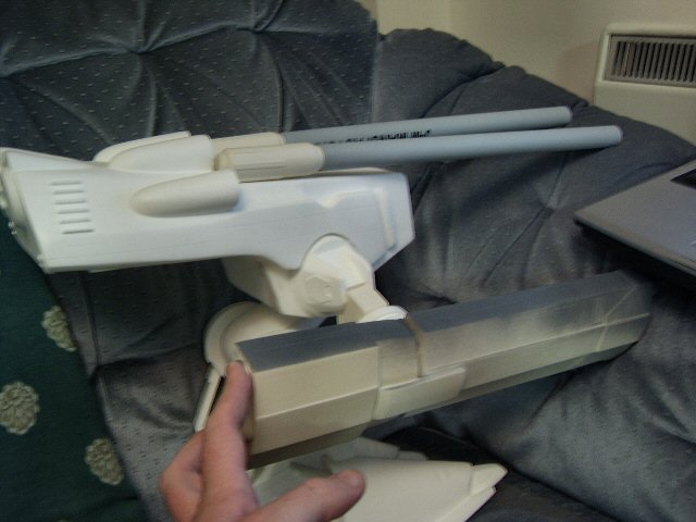

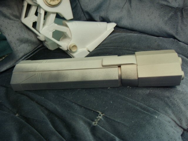

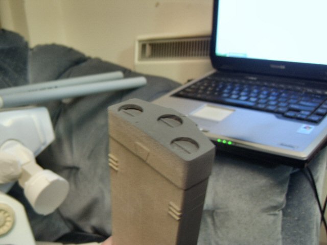

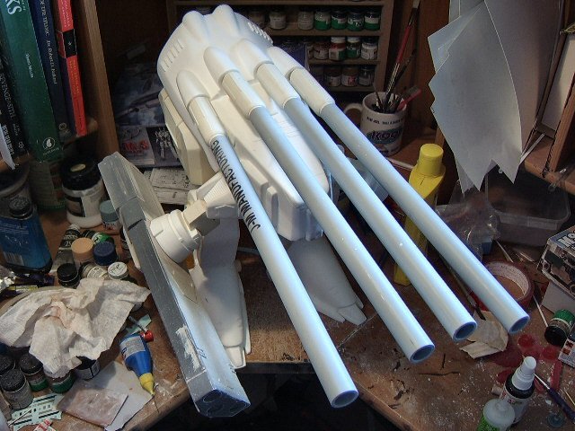

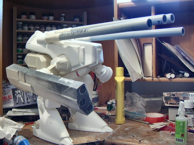

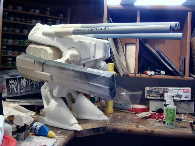

Heres a drool pic f the main and arm cannons temporary placement. I have also included a pic of the debris covers i made to hide the hllow interior of the arms. I know it isnt in the line art but i drew my inspiration from modern missile systems like the patriot and Tow missiles. The covers blow off when the missile fires.

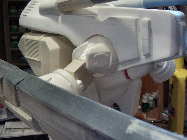

A milestone has been reached. I decided that the main cannons would be fine just using the pin to hold them in place. The fit of the brass tube i used is tight enough. All i have to do is dremel the housings out a little to refine the fit of the barrel mount to the body. The arms are held on by their magnets with a pin below the magnet to assist in holding them up. The magnets are strong but since the arms hang down they want to slide off. Magnets have great pull strength but their shear strenght isnt as strong. This model is also well balanced. In these pics it IS standing on its own. I havnt touched the hips yet but seeing how well balanced it is i may see how they fit after painting. It may be simple as putting some paper behind the ball joint to make the fit tight enough. THIS THING IS MASSIVE, and heavy. Be careful working on it, the weight could easily break a finger if it decides to flip backward of forward on you and scissors your finger between the leg and the body.
