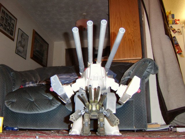

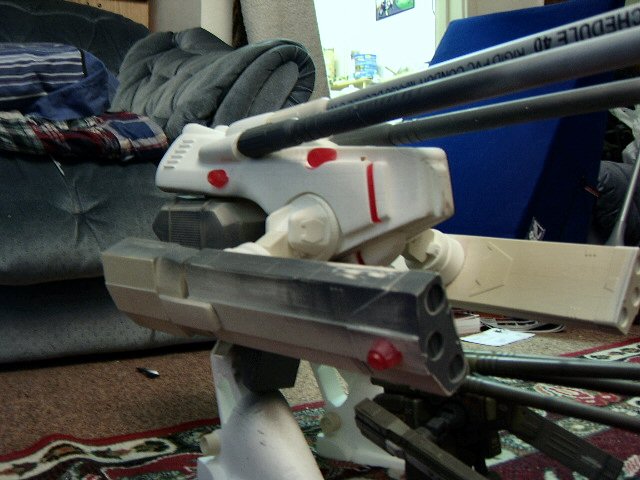

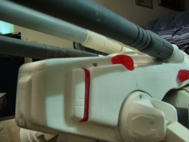

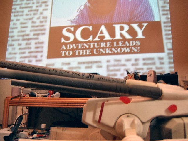

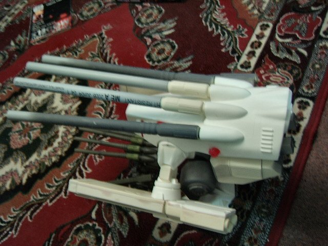

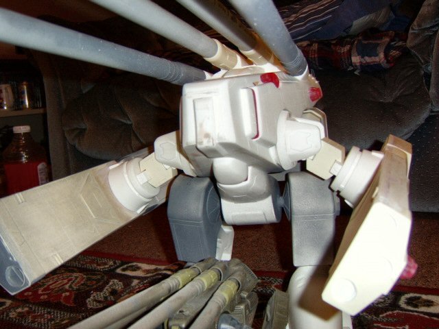

Basic assembly is done. I just have the fine details to do and clean up and its done. Heres a couple pics of mama protecting her baby. In the pic where it says SCARY on the wall that is my TV. Big isnt it :D
That looks good Mech. Is it the IMAI 1/200 scale one? The one in the pics here is the ARII 1/160.

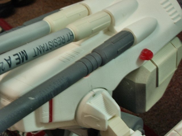

Its a pollyS railroad color i have. I can post the name tomorrow since im heading to bed now. A good copy color would be Tamiya XF-60 dark yellow with a bit of dark green added to green it up a bit. Since the scale is larger i may just paint the yellowish parts straight dark yellow and postshade with some darker green. Did you notice i started to add the 3 rings on each gun barrel too.
I had to go to the ER last night because of that. One of the strips i was gluing on to make the ring sprang back and spattered Crazy glue into my eye. They found 2 dots of glue on my cornea. My eye will be ok it just hurt like crazy. Remember guys the dremel tool isnt the only reason to wear safety goggles while building models.
I should have the final little details done tomorrow. This is the last time you will see the monster whle until it is fully painted and weathered.

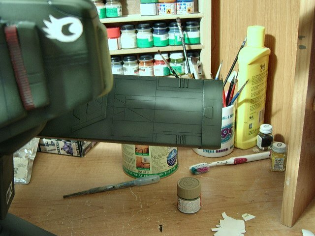

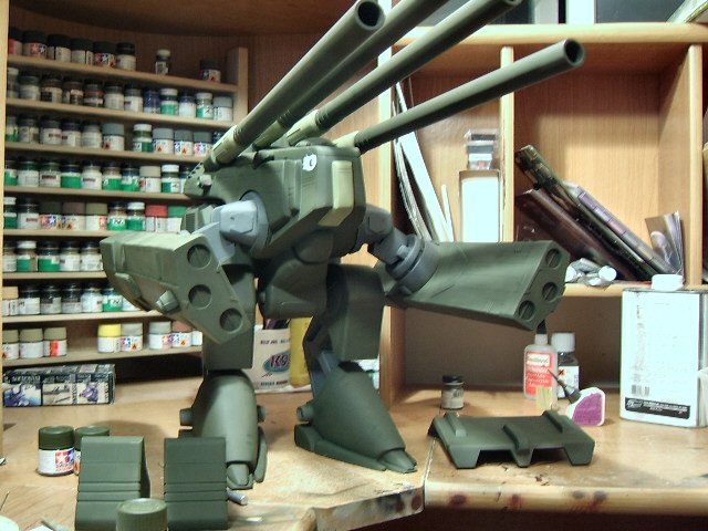

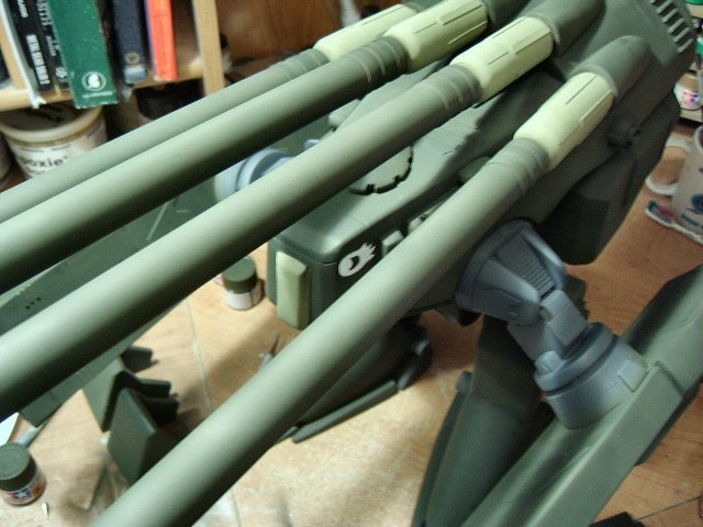

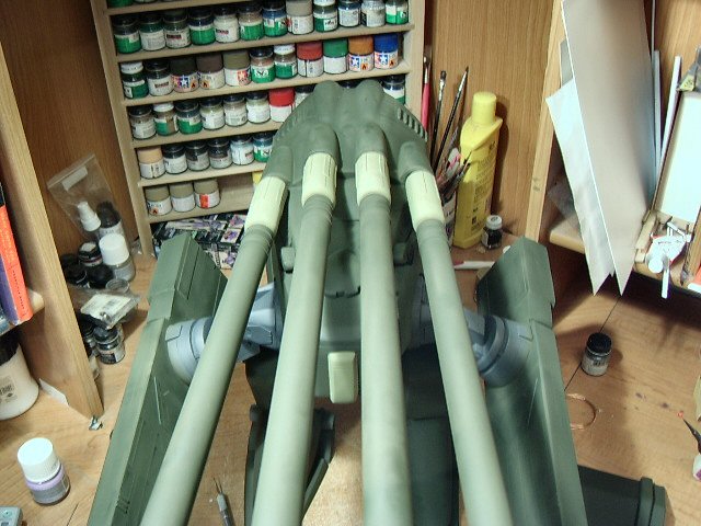

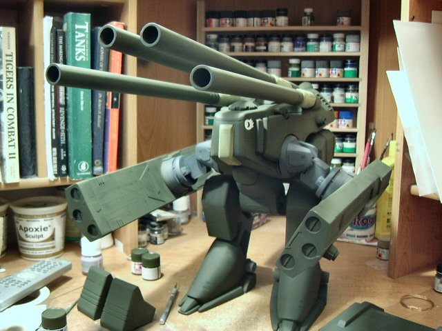

Base paint is done. I just have to go over it with a brush tomorrow and sharpen up some areas. This is 3 and 3/4 bottles of tamiya Olive drab. I didnt use the molded eye pieces and glue them on. Instead i applied a thin layer of liquid mask on them and applied them over a white background before i sprayed the OD. Once the OD was dry i removed the eye piece and rolled away the excess liquid mask. Presto instant painted on eye art. Tomorrow i will finish the smaller details and then get started on the post shading.
BTW after a coat of primer and a layer of paint the hip joints are very tight. With the kit being quite well balanced it will stand fine on its own once painted.

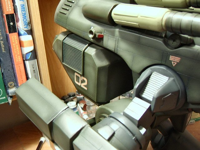

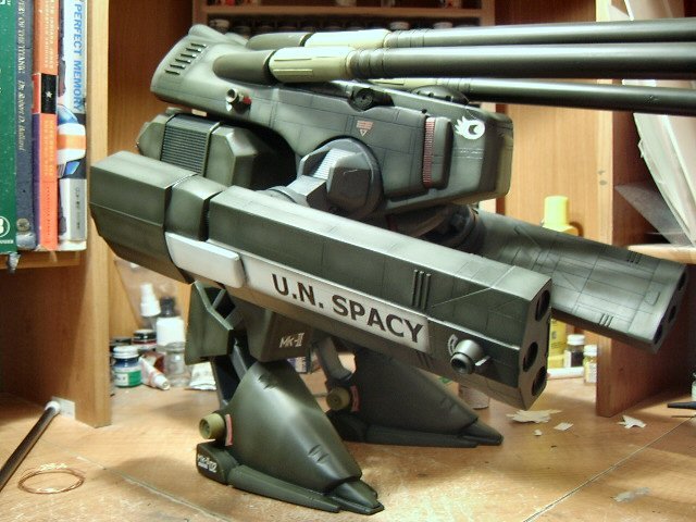

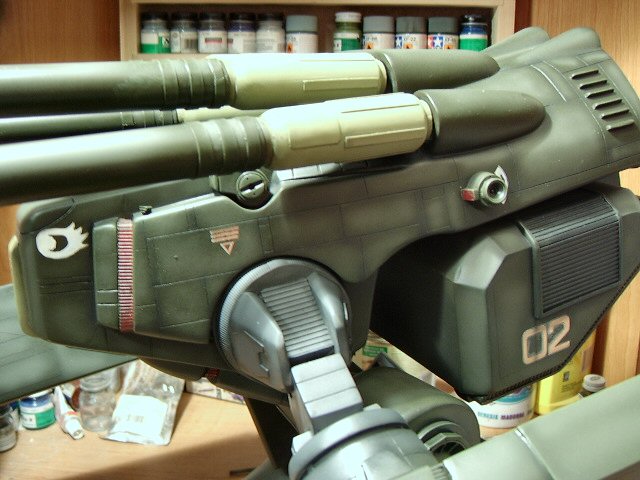

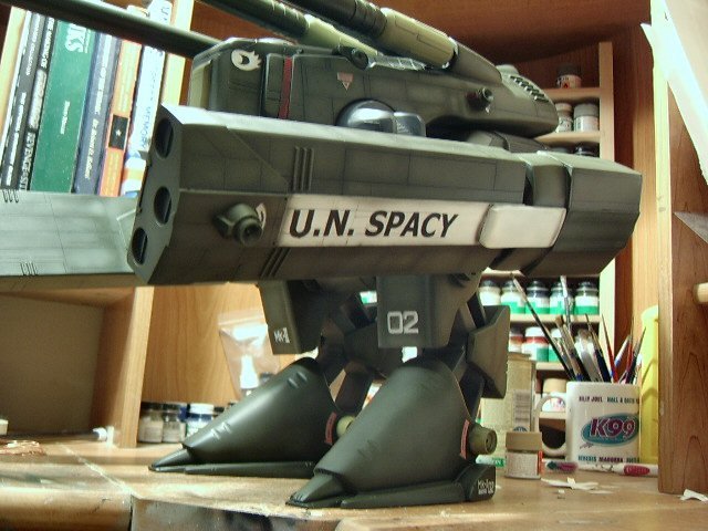

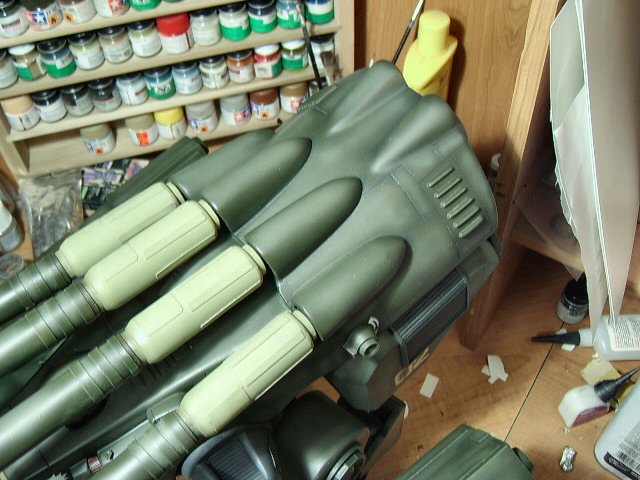

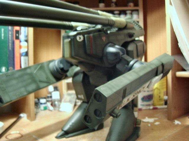

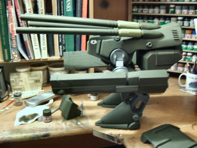

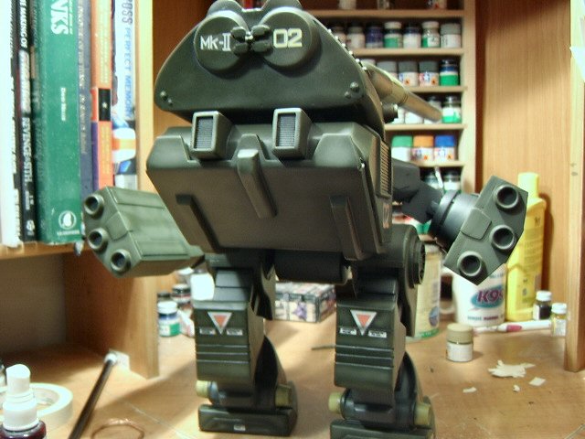

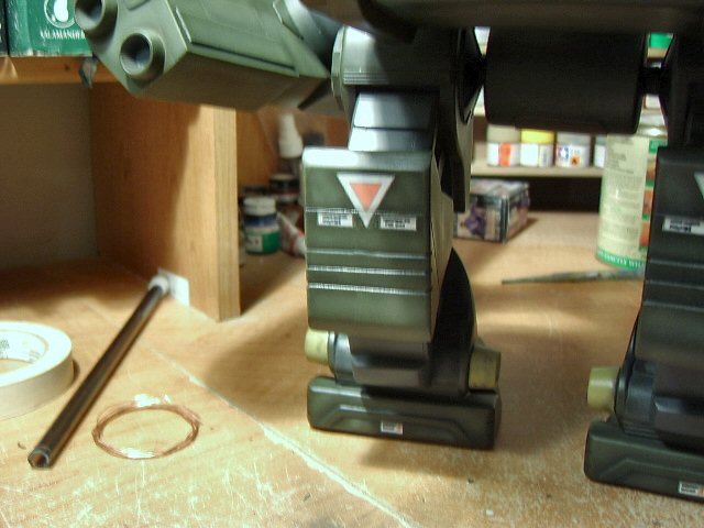

Here she is. Aside from some small details like flowing a darker wash into some of the panel lines she is done. This is a hard kit to take clear pics of since there are so many parts closer to the camera than others. Sorry for the blurry ones. My camera wanted to focus on whatever was closest to it. I will try to get some better ones later.
My one and only complaint on this kit was the fact that it is not possible to show the internals behind the dozer spade, without leaving it off completely. The position the legs have to be at to keep the model stable and the fact they are at the full standing height wont allow it to be posed "accurately" to have it open. I wasnt about to hack the leg struts apart to make it crouch like the line art and Macross Zero show it when it deploys the spade. I fiddled with possibilities on it for a few hours and couldnt come up with a way that was acceptable. Other than that Mike has done an amazing job on this kit, it is well worth the time effort and money.
The overall finish i was going for was a more realistic and toned down texture to the colors with a little inspiration from the dark and moody look of the MK1 Monster seen in Macross zero.
Mike if you have enough reject castings about lets make a deal, i need a 1/72 scale MK1 monster now. Just to make the destroid collection complete.

:) WOW, looks really awesome, great work. You will have another for the MK1, by the end of the run i will get you one from the 2nds pile...... :) To address the engine detail/hindge/ deployment....well I uhhhhhh, I was not able to make the full deploy for a couple of reasons, the formost was the balance of the kit, those legs are pretty much where they need to be , and i did make one tiny mistake when i made the hindge, i planned it out without the rear facing leg armor on over the struts....i will cover a fix for this eventually but my guess is that for most people who want to display it to show off the engine detail, the solution will be a few magnets so they can pop off the rear hatch.....
