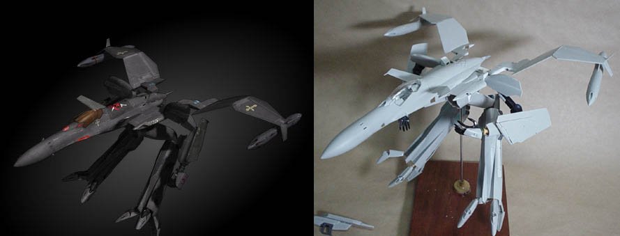

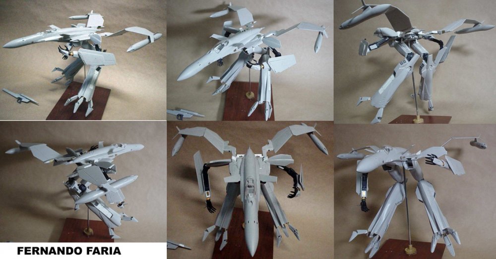

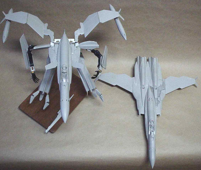

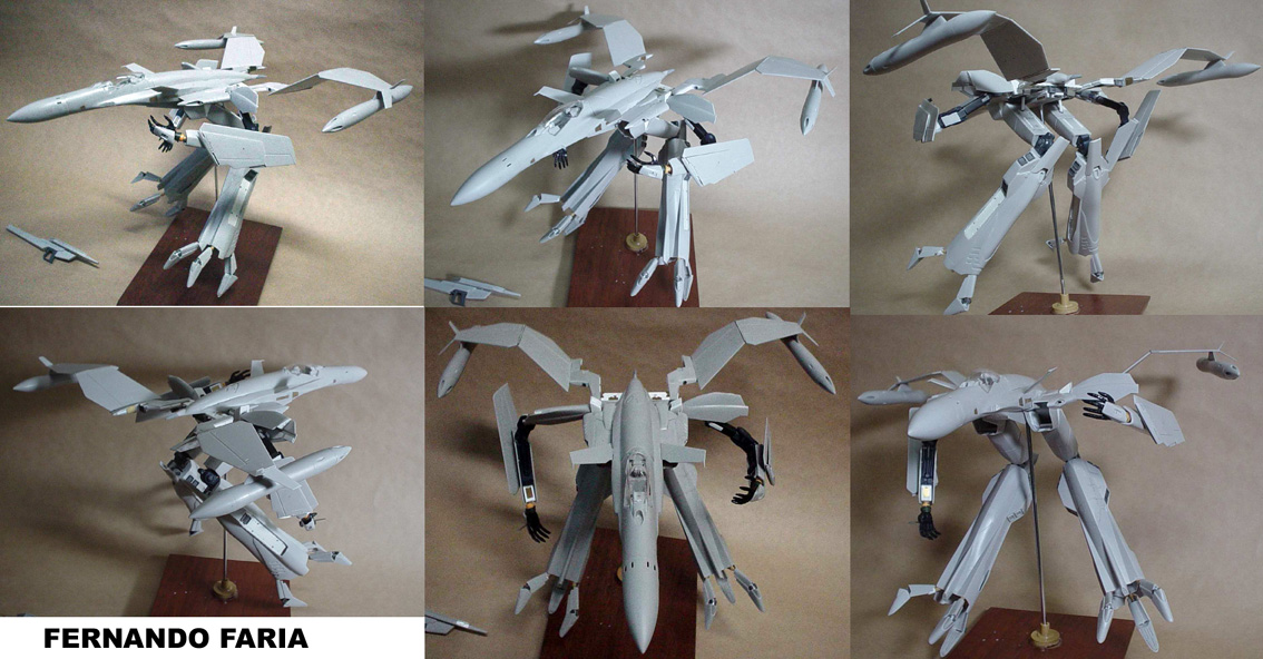

fernandofaria Posted February 3, 2005 Posted February 3, 2005 Hy guys ....this is my wip sv-51 gerwalk . I called it as a Yes -No project , because YES , I had a lot of fun doing it , but NO , I will not do it again ....ha ha ... I am posting the finished parts , all pinned , and ready for the primer . If you want it , I can post detailed images of the conversion . I hope you like .
Stamen0083 Posted February 3, 2005 Posted February 3, 2005 Hah. That's very cool. Very sensible in keeping it mostly fixed posed, which solves the problem of flop and gigantic, ugly exposed polycaps.

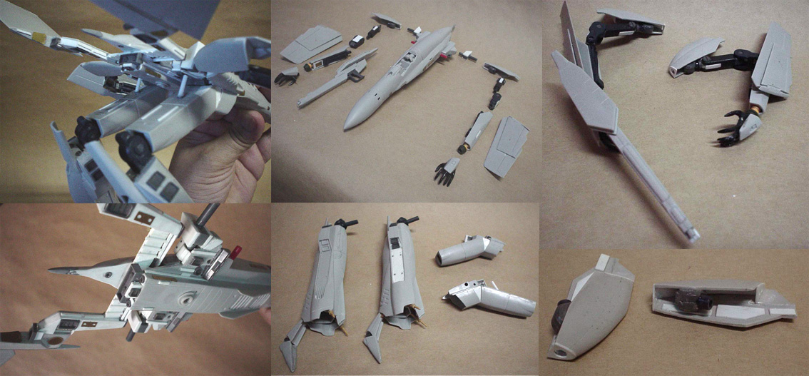

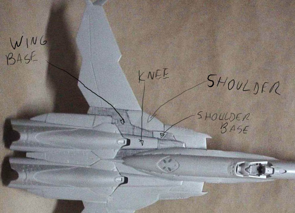

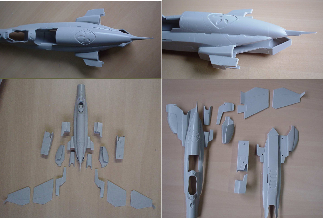

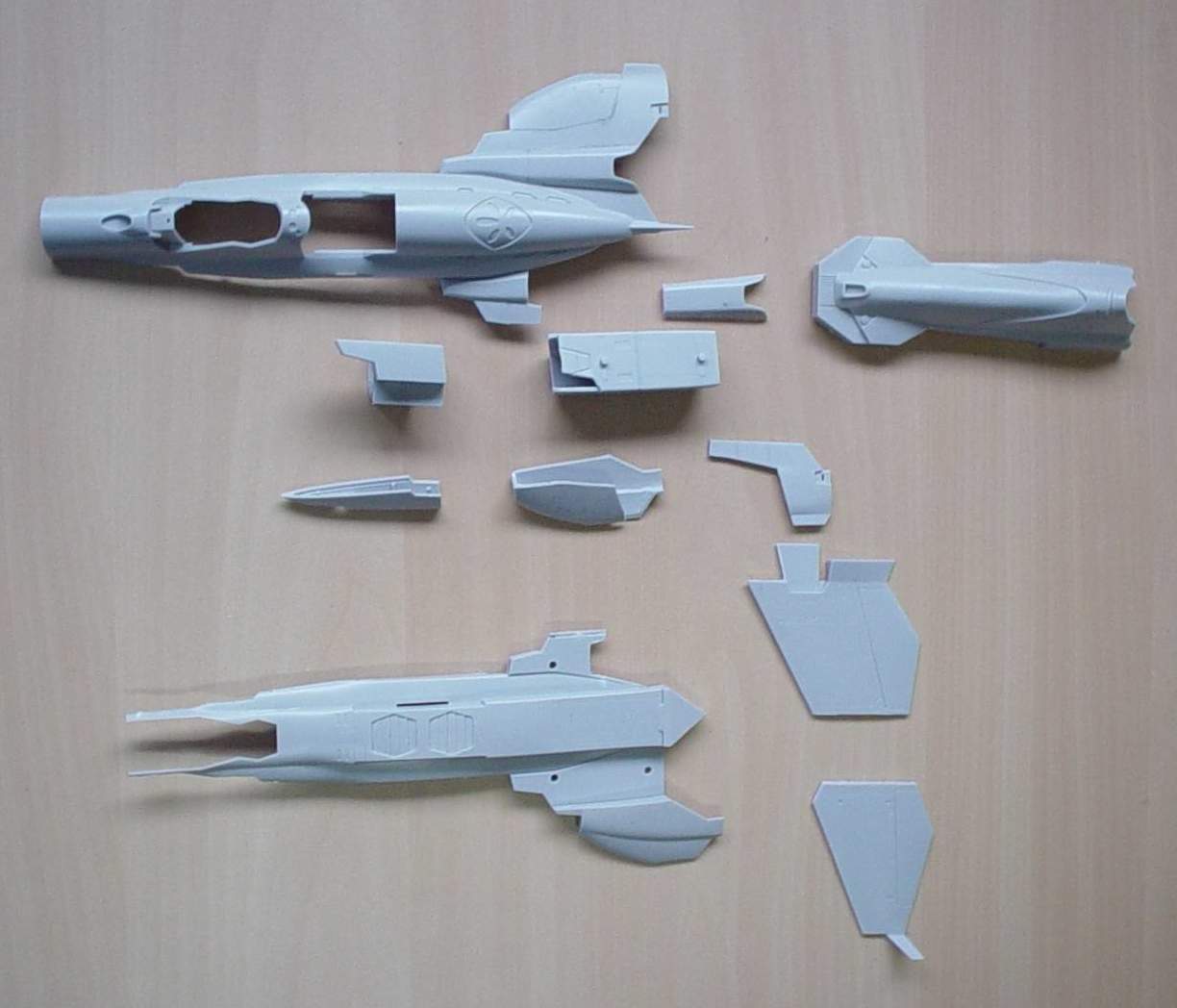

fernandofaria Posted February 3, 2005 Author Posted February 3, 2005 Ok . thank you guys . Here is some images from the fisrt step of the conversion . This is the parts break down . It was the most dificult part , because the shoulder ,the base of the wing , and part of the leg are the same piece . And , of course , every cut had to be done in the up and botton sides of the mais body. For cutting , I basicaly used a tamiya scriber , and a surgical scapel. The arms and Knee , I took from a gundam kit , the HG The O . The hand and elbow , came from and old grifon labor kit . There is lots of wave detail parts , and evergreen plastic too . Oh , and it take me about 50 hours ( in two weeks) to complete the conversion . The only reference material that I had , was the picts from the macros zero web site . So , I hope its acurate enough

fernandofaria Posted February 4, 2005 Author Posted February 4, 2005 Hi Grahan. I will finish it as the ivanov machine . Here is the original image that inspired me to do the conversion.

Less than Super Ostrich Posted February 4, 2005 Posted February 4, 2005 (edited) simply amazing. how did you use the scriber saw to cut the plastic? that seems like it would take forever. thanks for the pics! Edited February 4, 2005 by Less than Super Ostrich
fernandofaria Posted February 4, 2005 Author Posted February 4, 2005 simply amazing. how did you use the scriber saw to cut the plastic? that seems like it would take forever. thanks for the pics! I used the lines on the plastic as a guide for the scriber. Remember that the plastic for this macross zero serie , is Very soft . So , the cuting is very easy . but you have to take care to do not cut to much . After the primary scribing , I used the scapel to do the final cut .... that's it .
