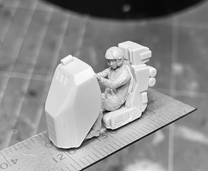

Mintox Posted August 11, 2021 Author Posted August 11, 2021 The Zvedza Hind came today and the pilots didn't disappoint. The actual kit itself is ok, for a 1/72 aircraft kit, but the pilots are something else. Not the normal blobs you normally get in most 1/72 kits, the pilots actually have really defined faces and hands, something sorely missing from the Hasegawa 1/72 kits. The photos below are of the rear pilot. I've used bluetack to help position the pilot and get the arms into the pose I wanted. Much easier than putting it in the cockpit and trying to glue things. Check out the face on the pilot. HE. HAS. A. FACE. In 1/72!
derex3592 Posted August 11, 2021 Posted August 11, 2021 Wow! That's a REALLY good looking pilot for 1/72!
MechTech Posted August 11, 2021 Posted August 11, 2021 That DOES look cool! He actually looks like he's doing something. - MT
Darth Mingus Posted August 11, 2021 Posted August 11, 2021 Wow, that is fantastic. I am so used to the blobs of plastic from Bandai. That looks better than some third party resin kits.

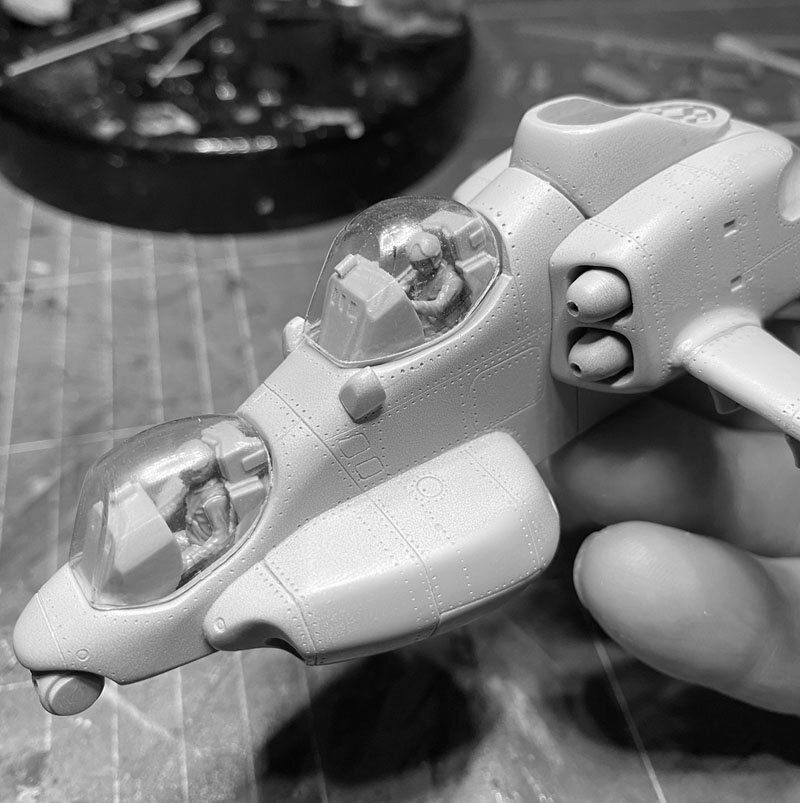

Mintox Posted August 16, 2021 Author Posted August 16, 2021 (edited) Minor progress. Trying to shoehorn the pilots, seats and cockpit dashes was more challenging than I thought it was going to be. These are rough tests of how things will sit. I still need to sand a little here, grind a little off there, but so far they all fit. Edited August 16, 2021 by Mintox
electric indigo Posted August 17, 2021 Posted August 17, 2021 Good job on the canopies. And the pilots bring it to another level.
MechTech Posted August 20, 2021 Posted August 20, 2021 The pilots DO add realism to it. Looking good! - MT

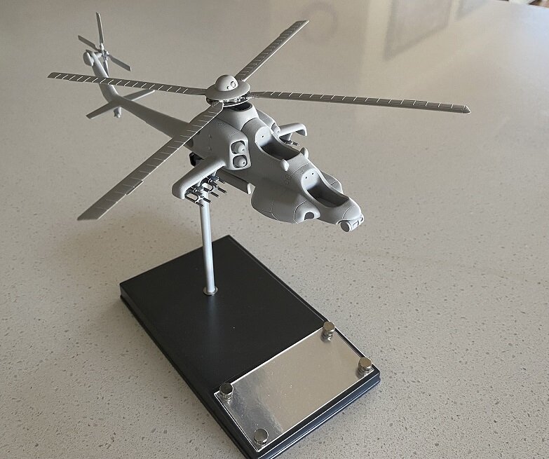

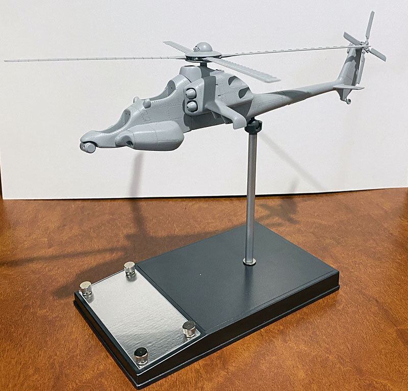

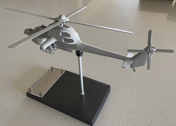

Mintox Posted August 23, 2021 Author Posted August 23, 2021 On 8/21/2021 at 9:37 AM, sketchley said: Books like Variable Fighter Master File claim that the Unified Forces only used NATO weapons. So, if you want to be 'authentic', there's that guideline. However, I'd go with your gut instinct on what makes the Commanchero look more lethal. There's been no material that said the Commanchero wasn't used by the Anti Unification Alliance—not to mention that the Unified Forces have a history of using Anti Unification Alliance weaponry—so anything goes. good advice. I have some 1/72 Bandai VF weapons winging their way to me so I'll do some fit outs and see what I think. Update: Testing the custom stand the client has sent me to mount the Commanchero. This was a bit tricky because of the bomb bays being displayed opened I had little choice of places to mount the stand. Ideally in the exact center (inside the bomb bay) is the exact middle but since that is out I had two choices, immediately forward of the bomb bay or immediately aft of it. I chose aft as the weight tends to nose the model down looking more aggressive. Forward and it would want to tilt back. I may need to use super glue on the stand to set the angle as the weight of the model out strips the resistance of the ball joint on the top of the stand. In this photo the whole model has been sprayed Tamiya Surface Primer Fine.

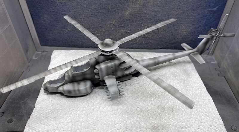

Mintox Posted September 19, 2021 Author Posted September 19, 2021 Its been awhile since my last update but work and life in general have been taking priority. Now the weather is a little warmer Ive been able to start the painting. Here Im adding some shading on all the panel joins. Im using Mr Hobby Tire Black, a very dark grey colour but which looks black. Once this dries I'll start with the lighter grey colour, something similar to the US Marine Corp colours they use on their choppers. The customer has asked for the tail (vertical stabiliser) to be painted black with Skull Squadron livery.

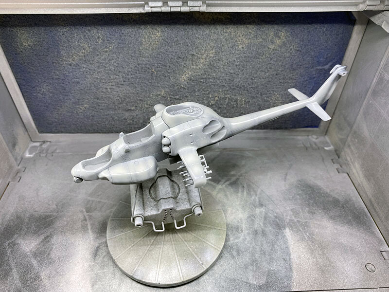

Mintox Posted November 2, 2021 Author Posted November 2, 2021 ok now weather isnt sucking so much in sunny Western Australia Ive been able to get out in to the workshop to continue painting. Here I putting on the final coat (gloss) of a light grey. Weathering and decals etc to come next. The panel shading looks very light but it is darker and more defined than what the images shows.

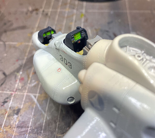

Mintox Posted December 14, 2021 Author Posted December 14, 2021 Making some progress again. Cockpit completed. Nothing here is glued. Ive also started the decal process and once completed Ill move on to weathering.
derex3592 Posted December 14, 2021 Posted December 14, 2021 WOW! Those consoles really POP! Looking fantastic so far!

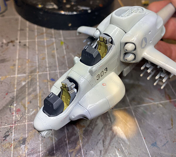

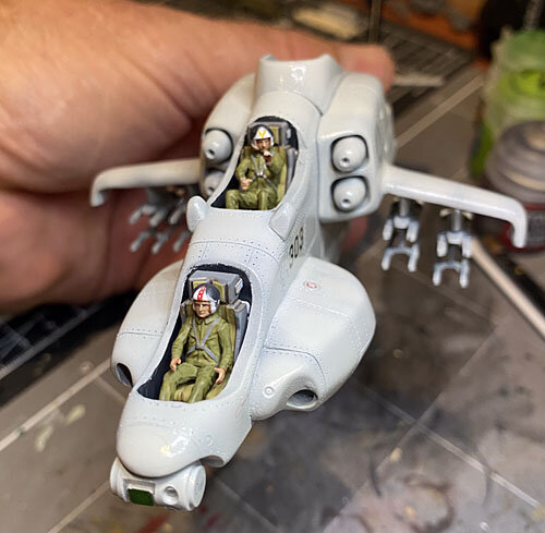

Mintox Posted December 22, 2021 Author Posted December 22, 2021 Pilots now finished. Im just messing around here seeing how they look and trying to get them seated right before I put the consoles in.
derex3592 Posted December 22, 2021 Posted December 22, 2021 Those pilots look great! I suck at figure painting, especially faces.
