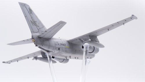

Update to the first post:
* Add S-3 Viking

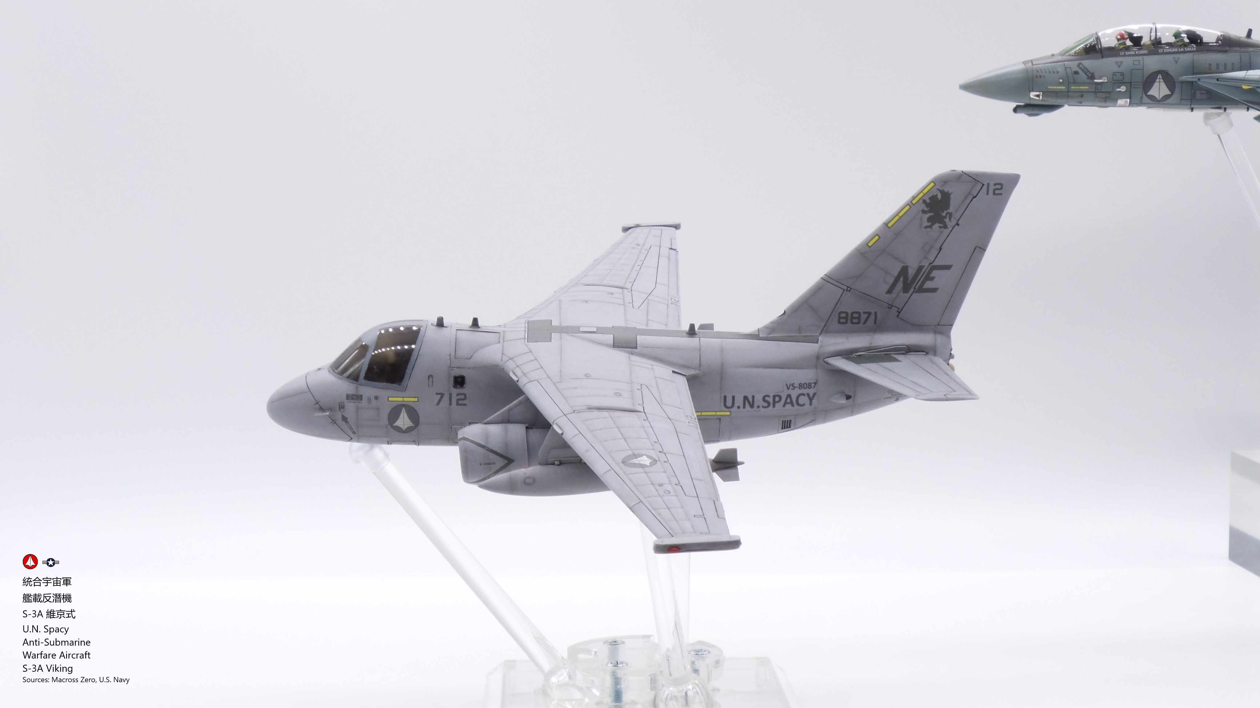

The S-3 Viking was a carrier-based anti-submarine aircraft used by the U.N. in the Unification Wars. The S-3 equipped with advanced electronics and sonar to detect and against the large number of Anti-U.N. submarines. With a buddy-fueling system, the S-3 could increase the range of other aircrafts, especially helpful to the first generation non-thermonuclear engine VF-0 variable fighters.
The S-3 Viking in the real world U.S. Navy. It carries a crew of four.

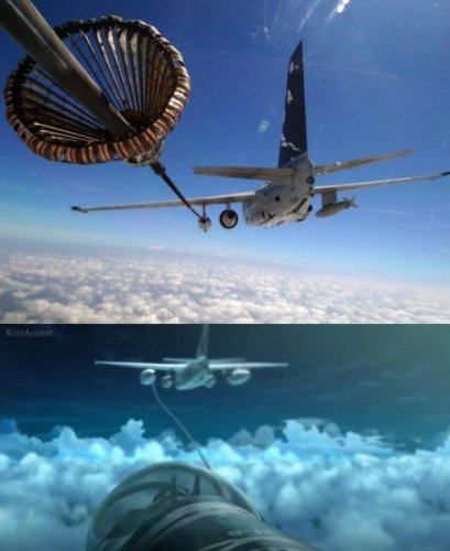

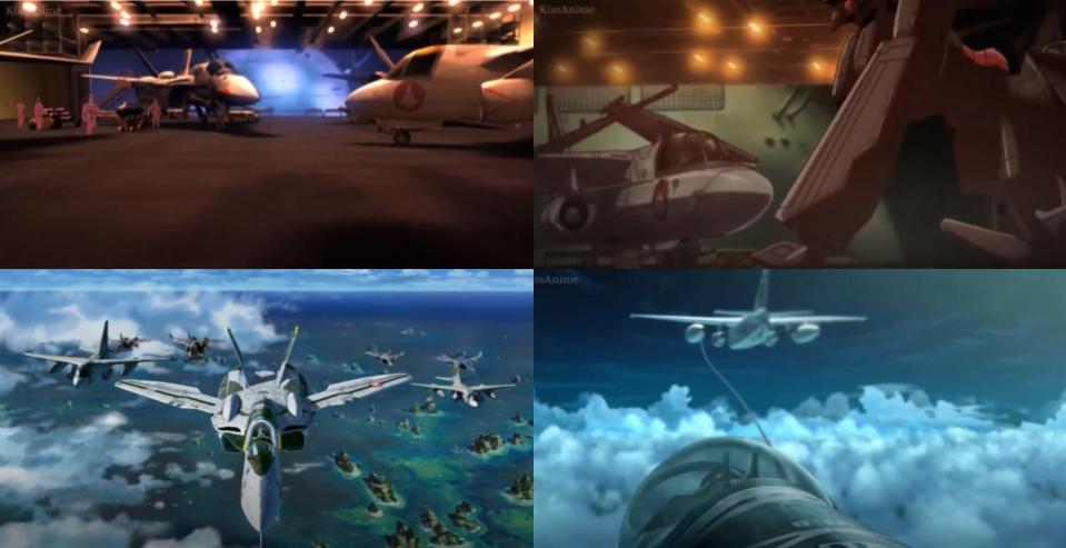

S-3 Viking on screen. Macross Zero episode 2, 3, and 4.

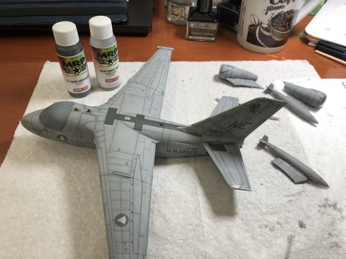

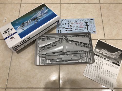

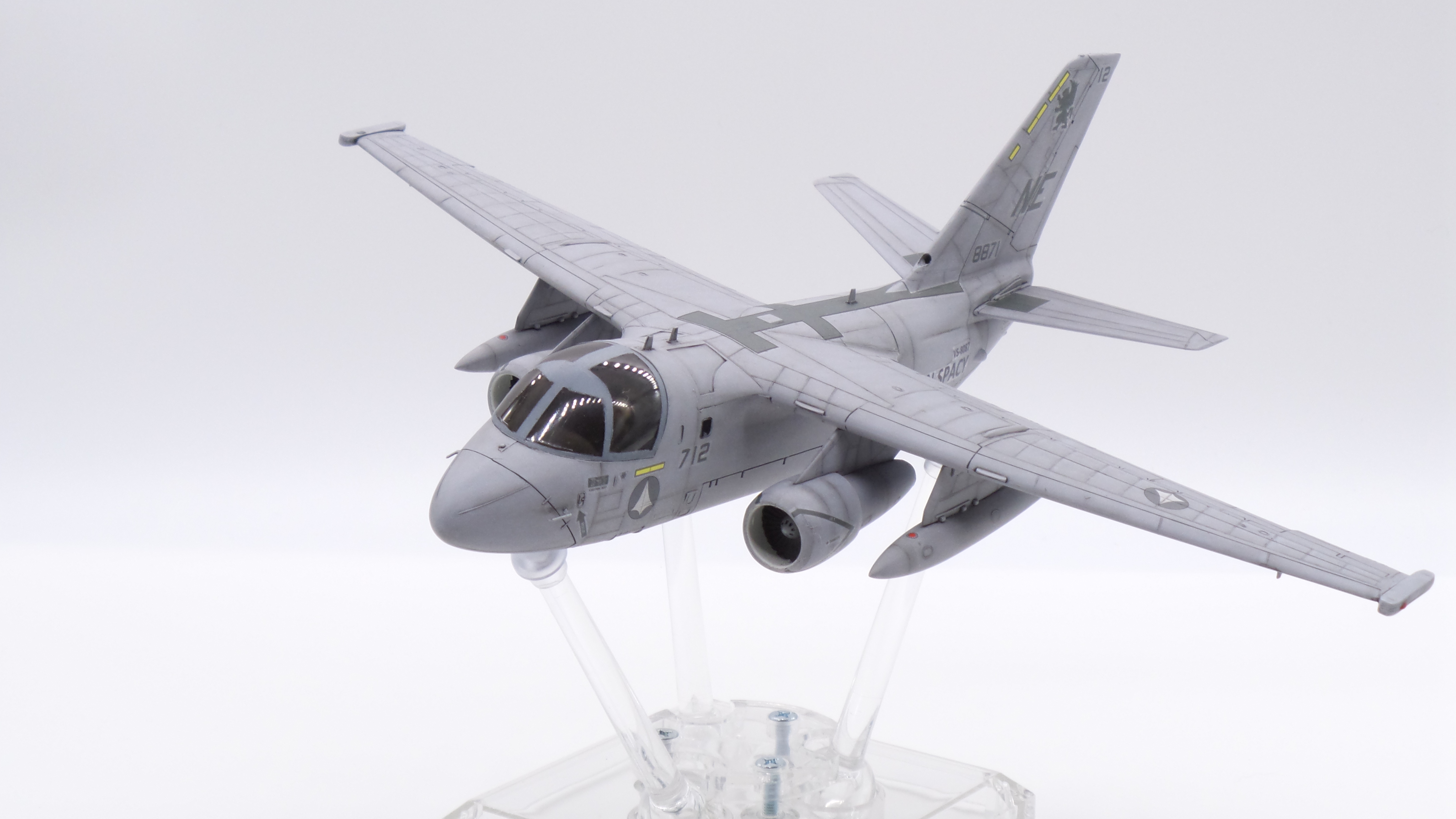

As you can see in this comparison picture that there’s little room and no pylon point between the turbine and fueling tank, so I’m not certain how the S-3 in the anime was able to carry an extra gun pod for Focker. Maybe it was a special mod?

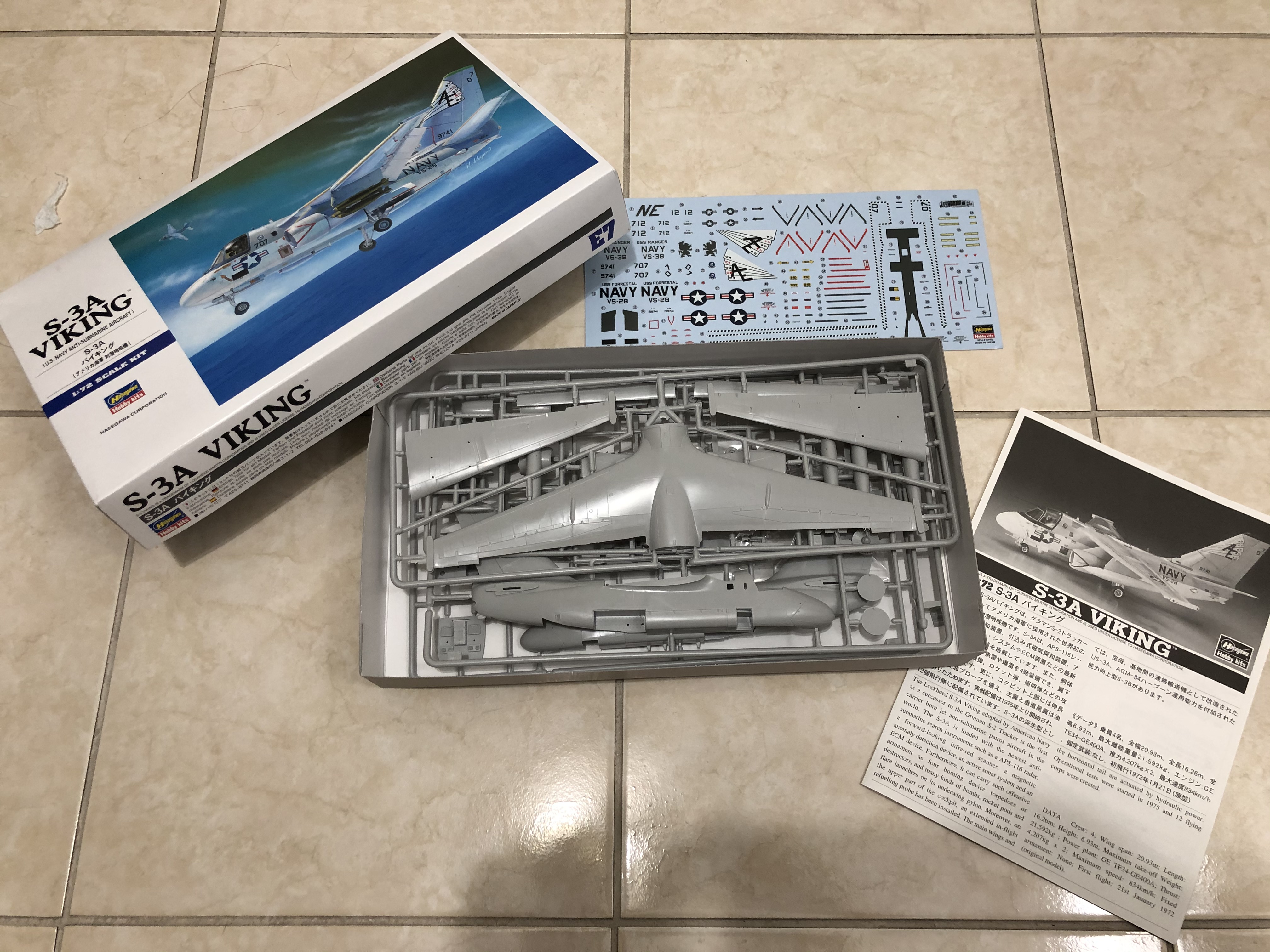

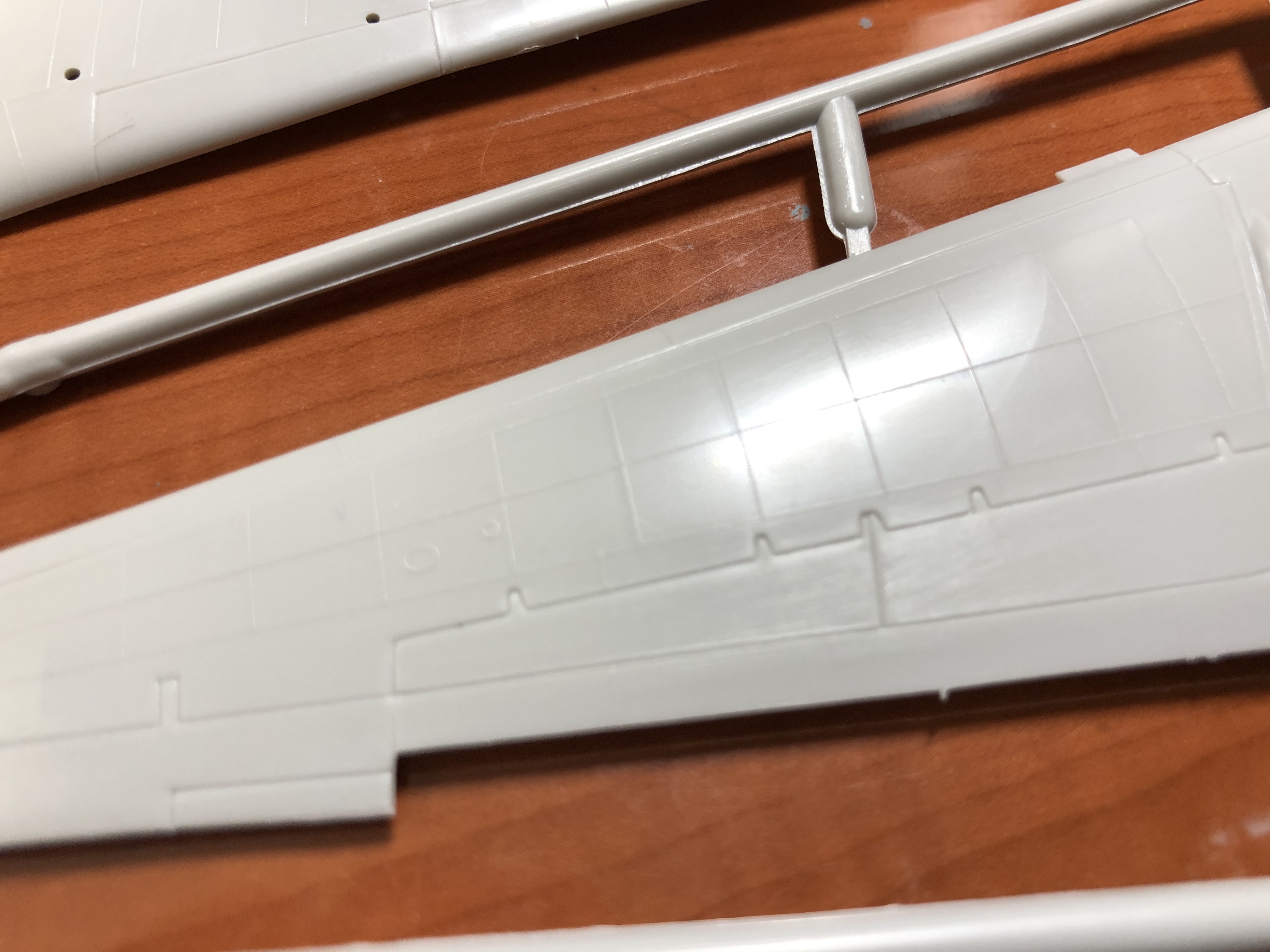

I don't like this Hasegawa kit much, but there is no other 1/72 S-3 to choose from. Also the raised panel line isn’t the easiest to work with when weathering and applying decals.

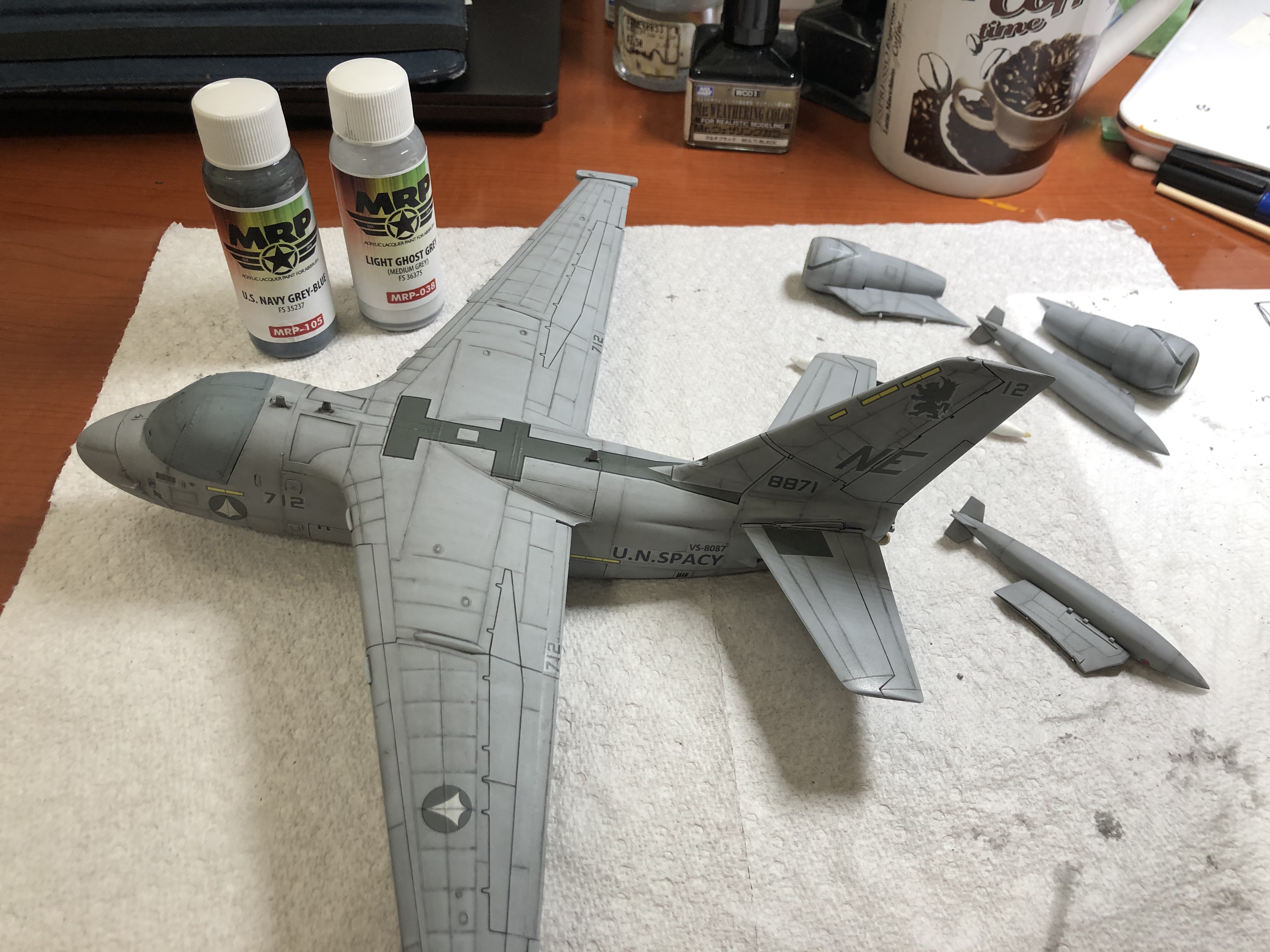

After some research, I chose MRP 038 (light ghost grey) for the body and 105 (U.S. Navy grey blue) for the cockpit. MRP are lacquer based paints for airbrush and they are well known for their color accuracy and quality. Here is a good reference site for the U.S. aircraft colors.
 http://www.theworldwars.net/resources/resource.php?r=camo_usn
Have fun!

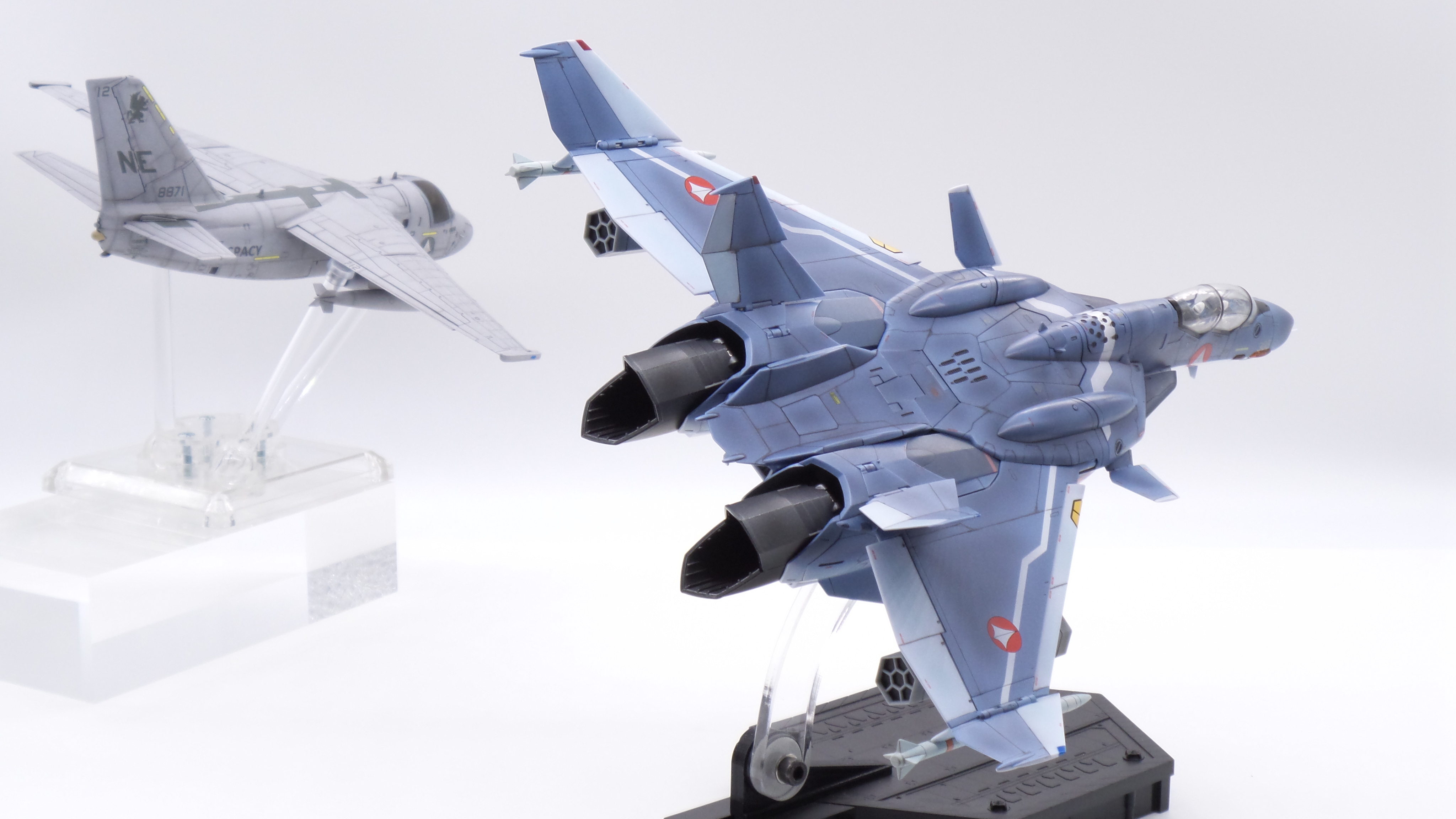

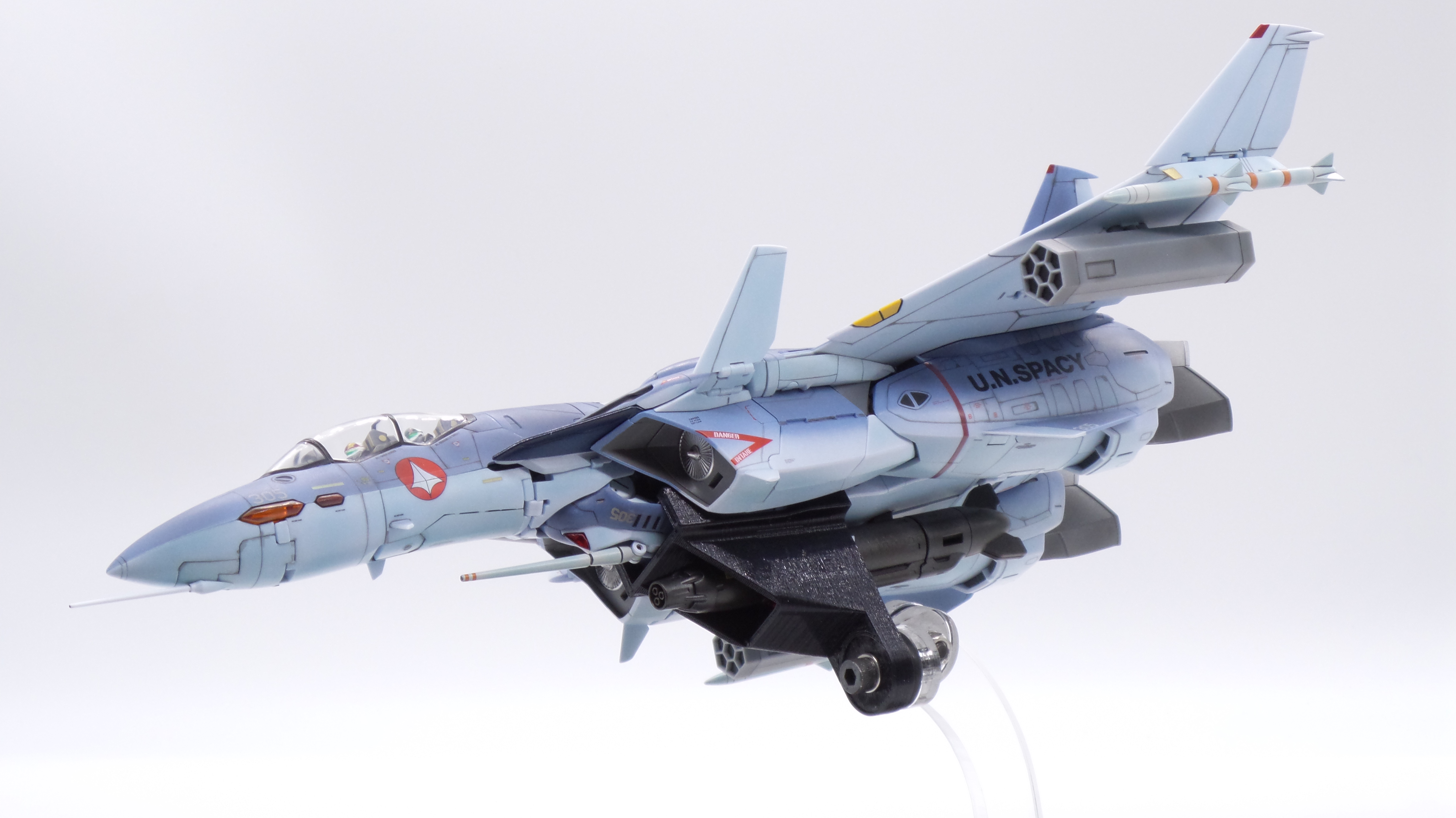

* Add VF-0D Shin Kudo

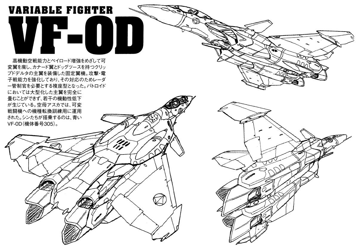

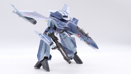

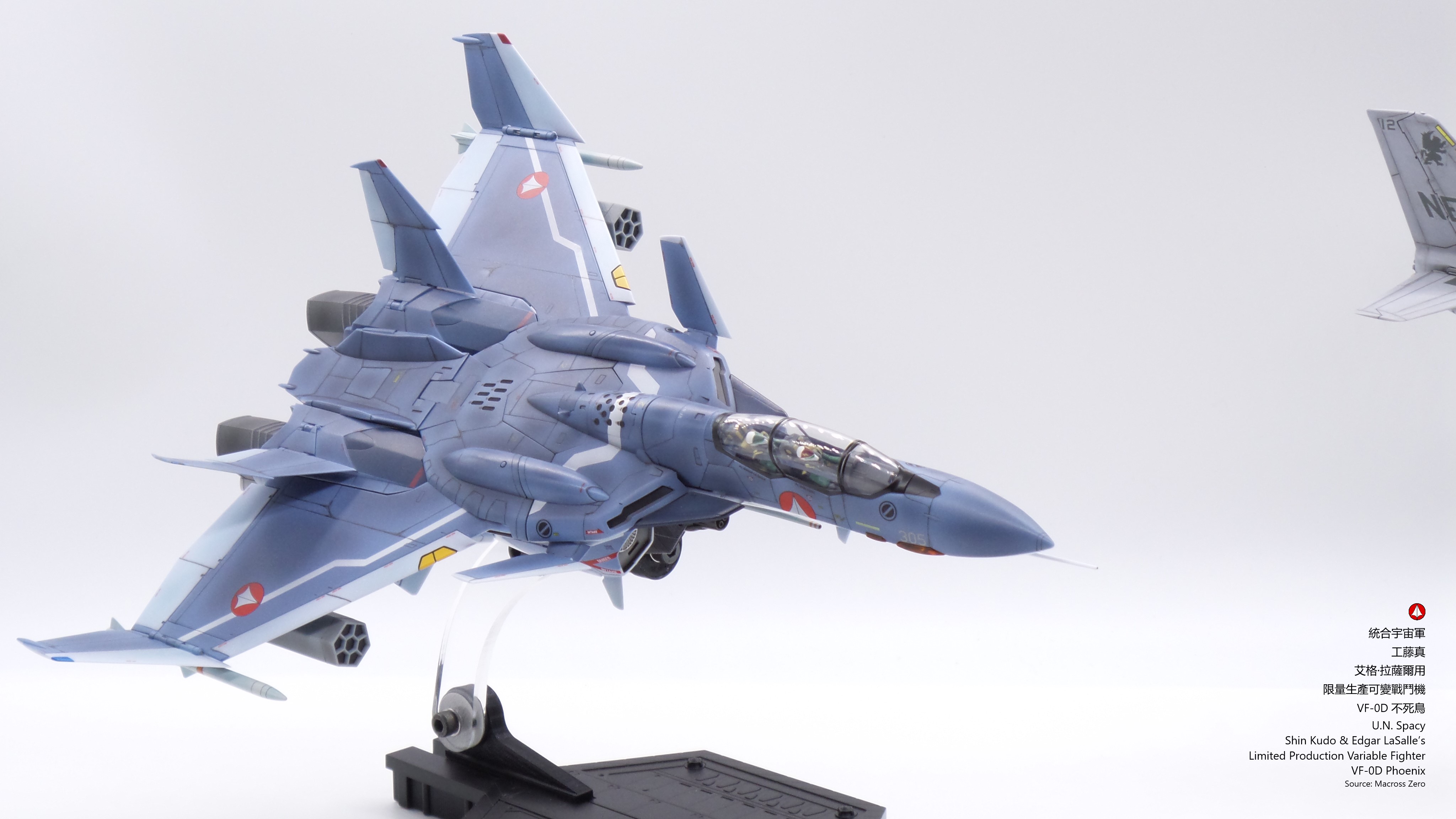

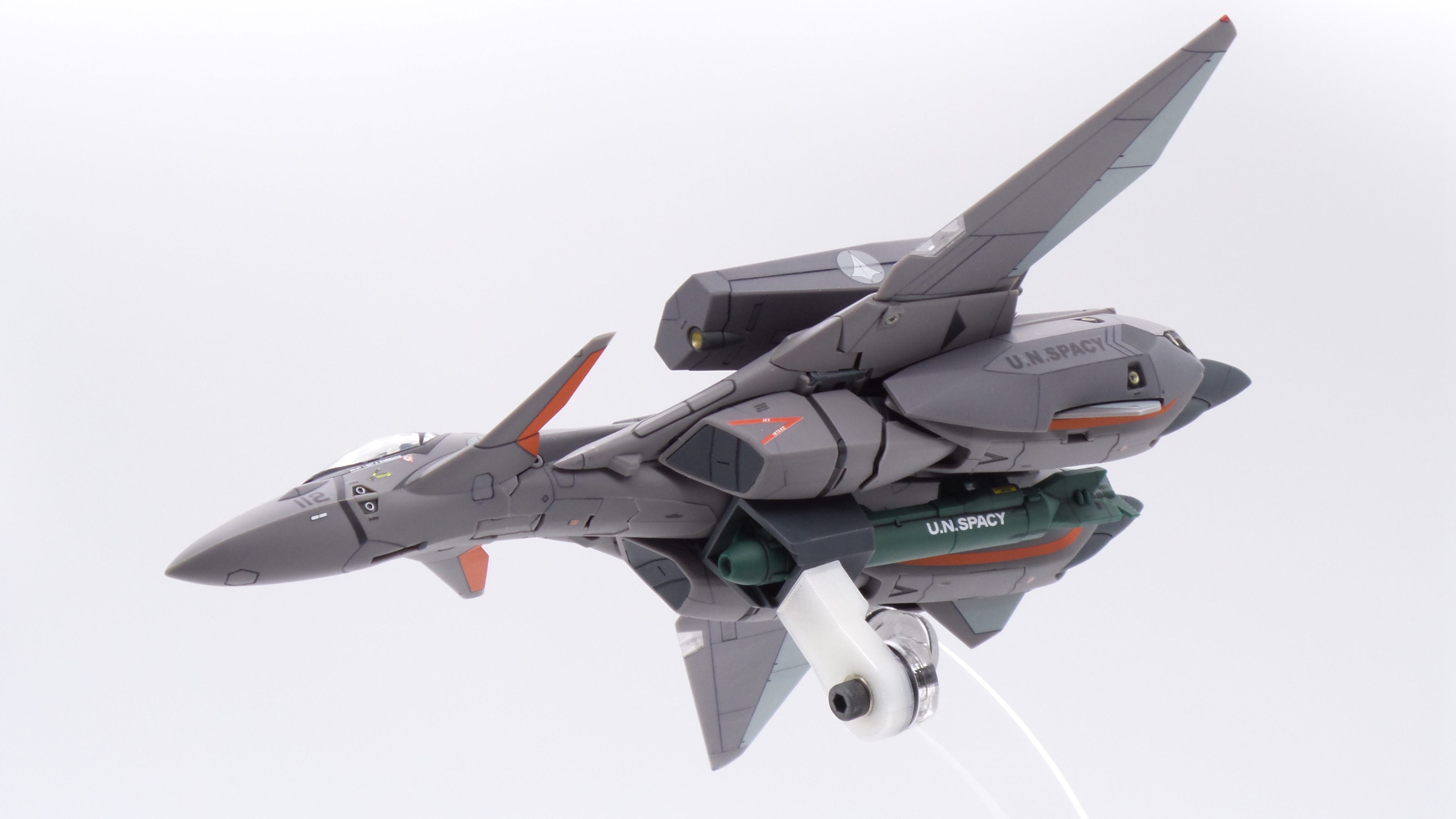

VF-0D is a two-seater version of the VF-0A variable fighter. Compared to the 0A, the 0D has canards and bigger wings for improved performance, but its combat radius was still relatively short because of the conventional EFG-127 turbine engines. The VF-0D can also carry a variety of weaponry, including former NATO spec missiles and bombs. Here is Lt. Shin Kudo and Lt. Edgar LaSalle’s customized blue VF-0D.
This is a great product from Arcadia. Some may dislike the bleeded panel lines and inverted pre-shading colors, but it looks okay to me. Also I felt no need to further work on a product for a first time. Overall this late version VF-0D has beautiful details, tight fitment, and good articulation.

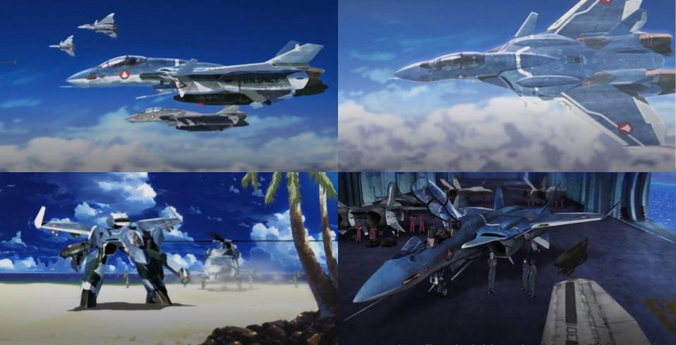

On screen, Macross Zero episode 2 and 3

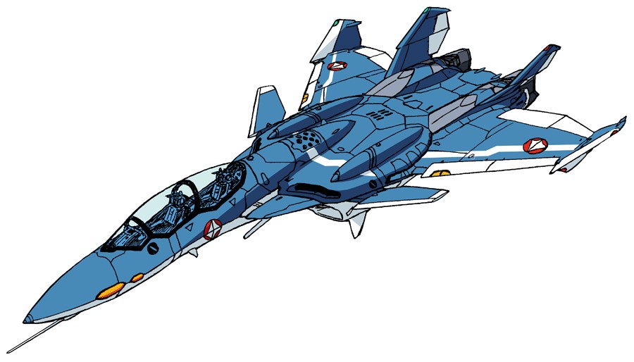

Original art, from Macross Mecha Manual http://www.macross2.net/m3/macrosszero/vf-0d.htm

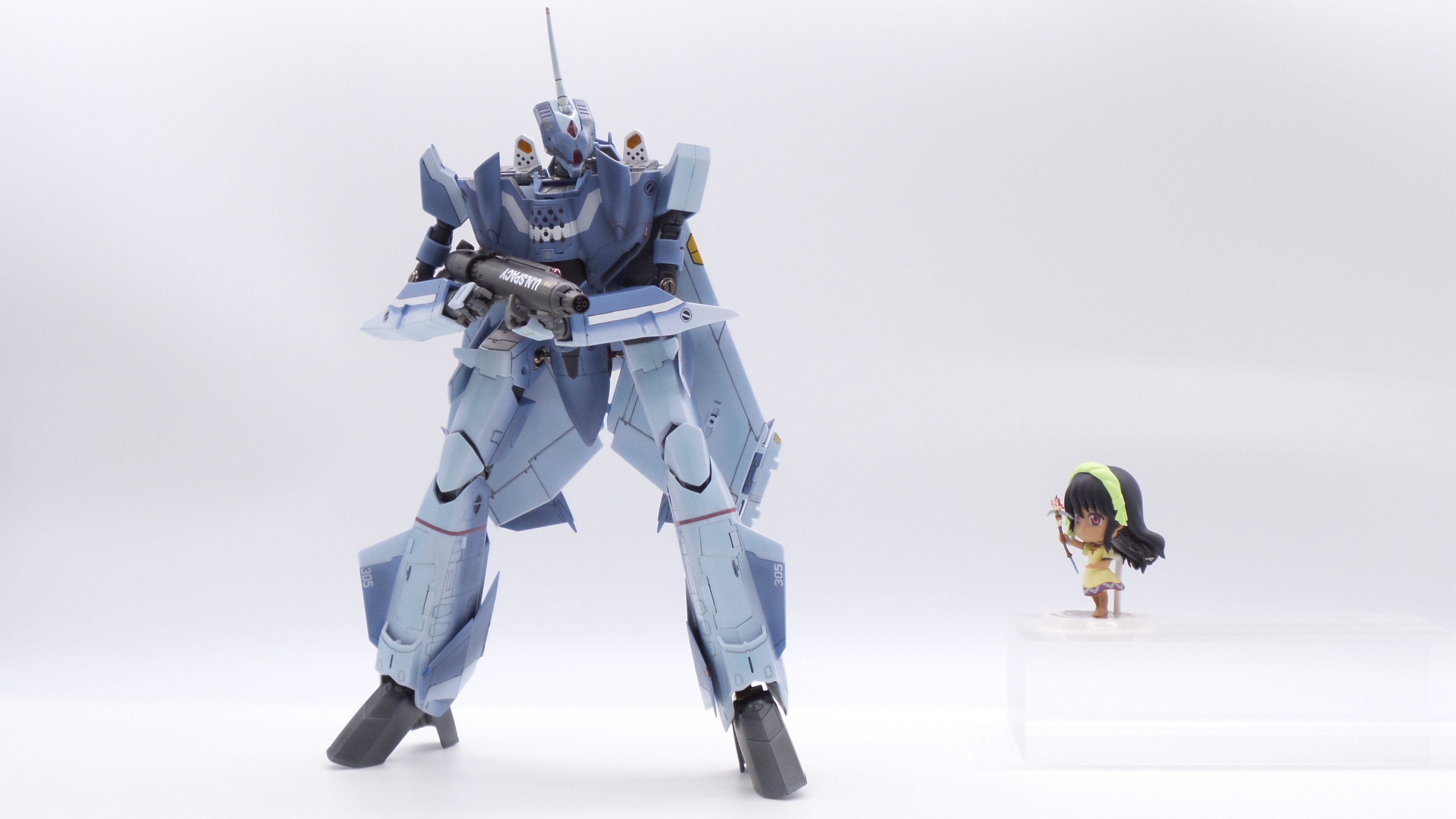

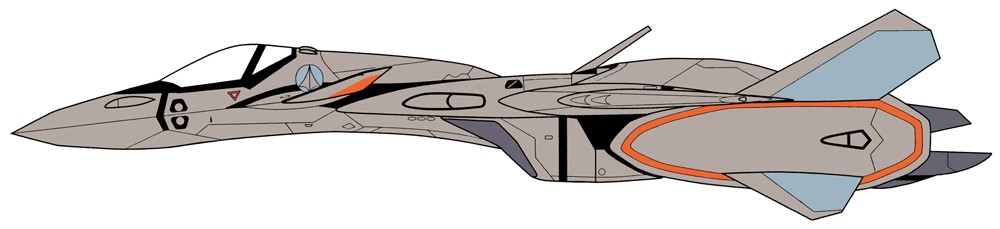

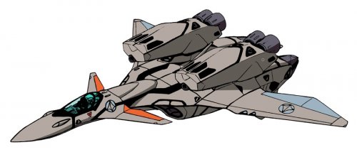

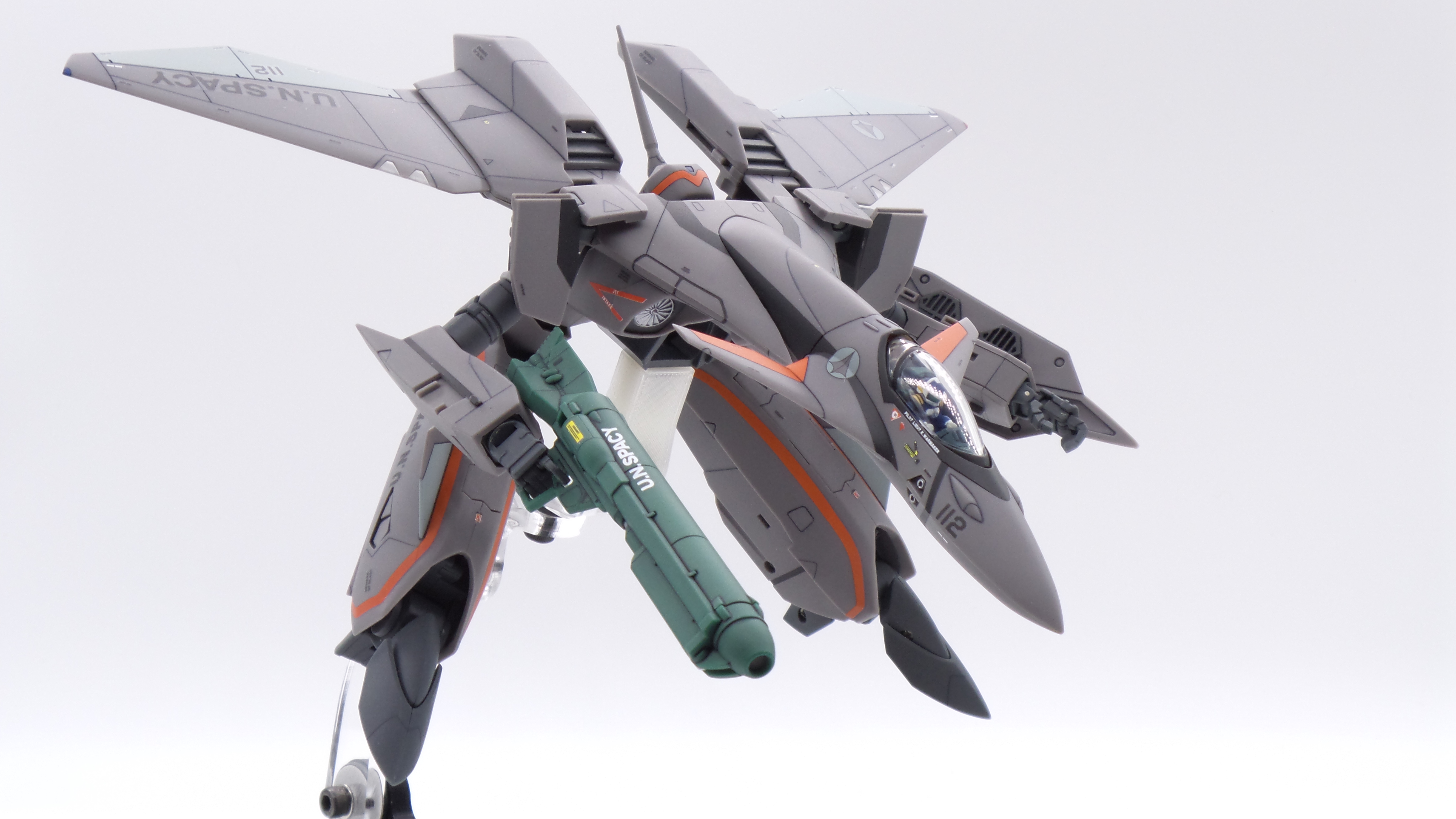

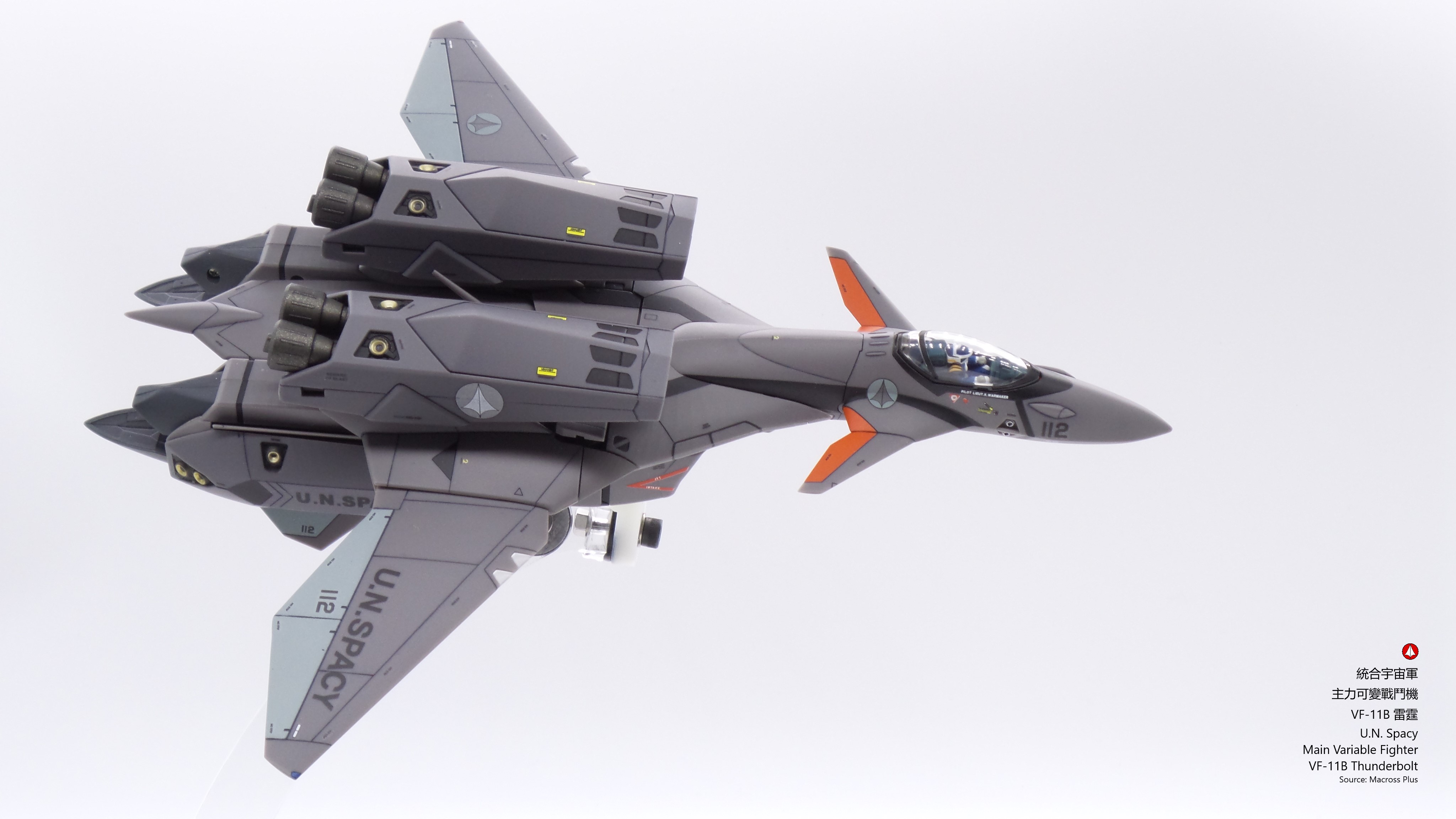

* Add VF-11B Thunderbolt
VF-11 Thunderbolt was the successor to the VF-4 Lightning III variable fighter. VF-11 was versatile for both atmospheric and space missions, therefore it was vastly deployed as fleet escort and planetary defense fighters throughout the 2030s.
The VF-11 has a beautiful design, and it looks suitable as a mass production fighter. I referenced Hasegawa's 1/72 and added some panel lines and water slide decals.
On screen, Macross Plus episode 1
Atmospheric flight mode. By the way this is not Isamu’s Eagle 107 ;)
I have mixed feelings for this old Yamato VF-11B. Its fighter and Gerwalk forms are beautiful and faithfully represent the original design of Shoji Kawamori. Also the details are unexpectedly better than the VF-0s. But this VF-11B doesn't play well, mainly because of the loose hip joints and cockpit shield.
Battroid mode. Its hip joints are so loose that it can barely stand
Original art, from: http://www.macross2.net/m3/macrossplus/vf-11b-super.htm
I wonder what fighters are these?
Have fun and happy Thanksgiving everyone!

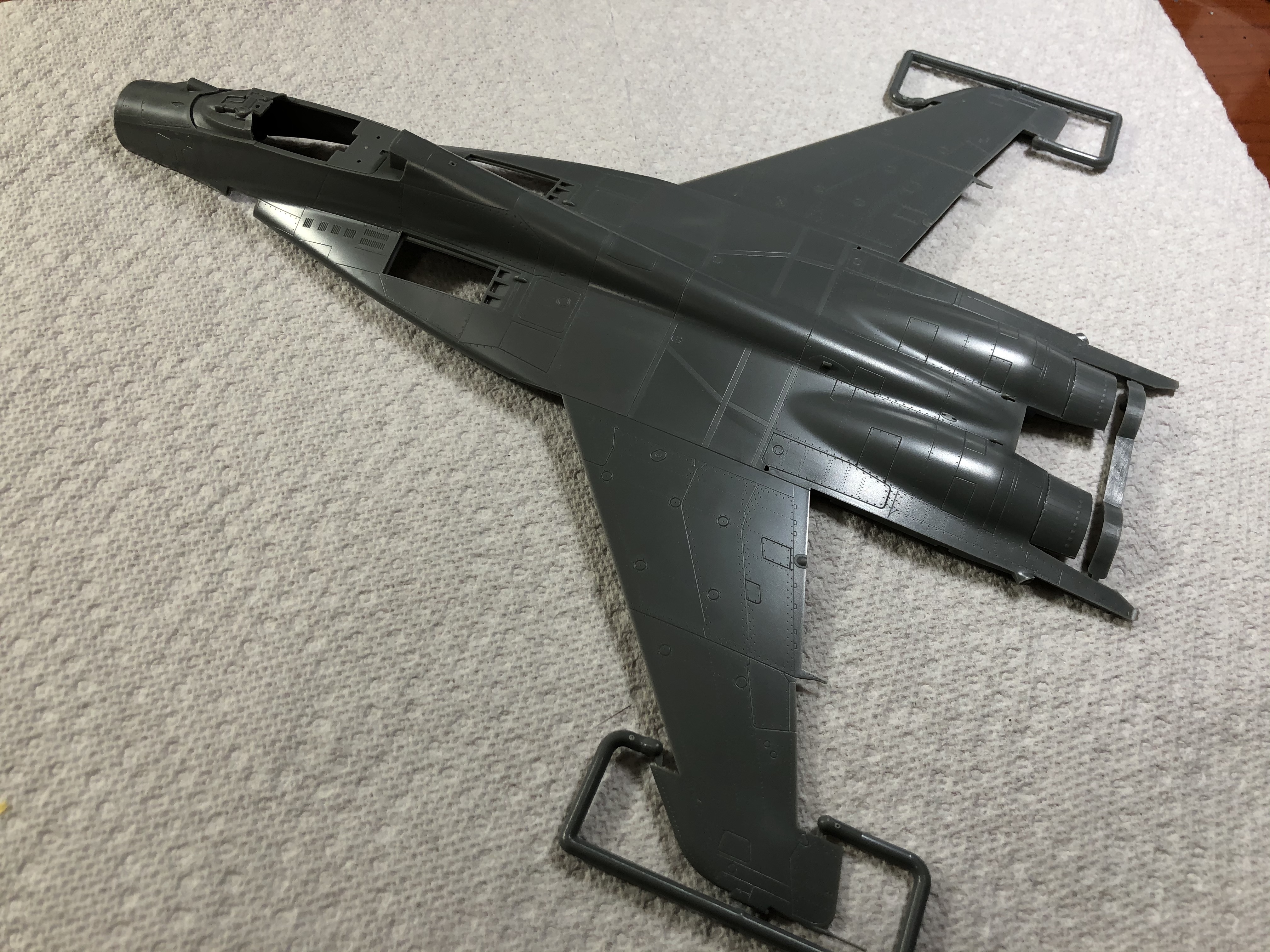

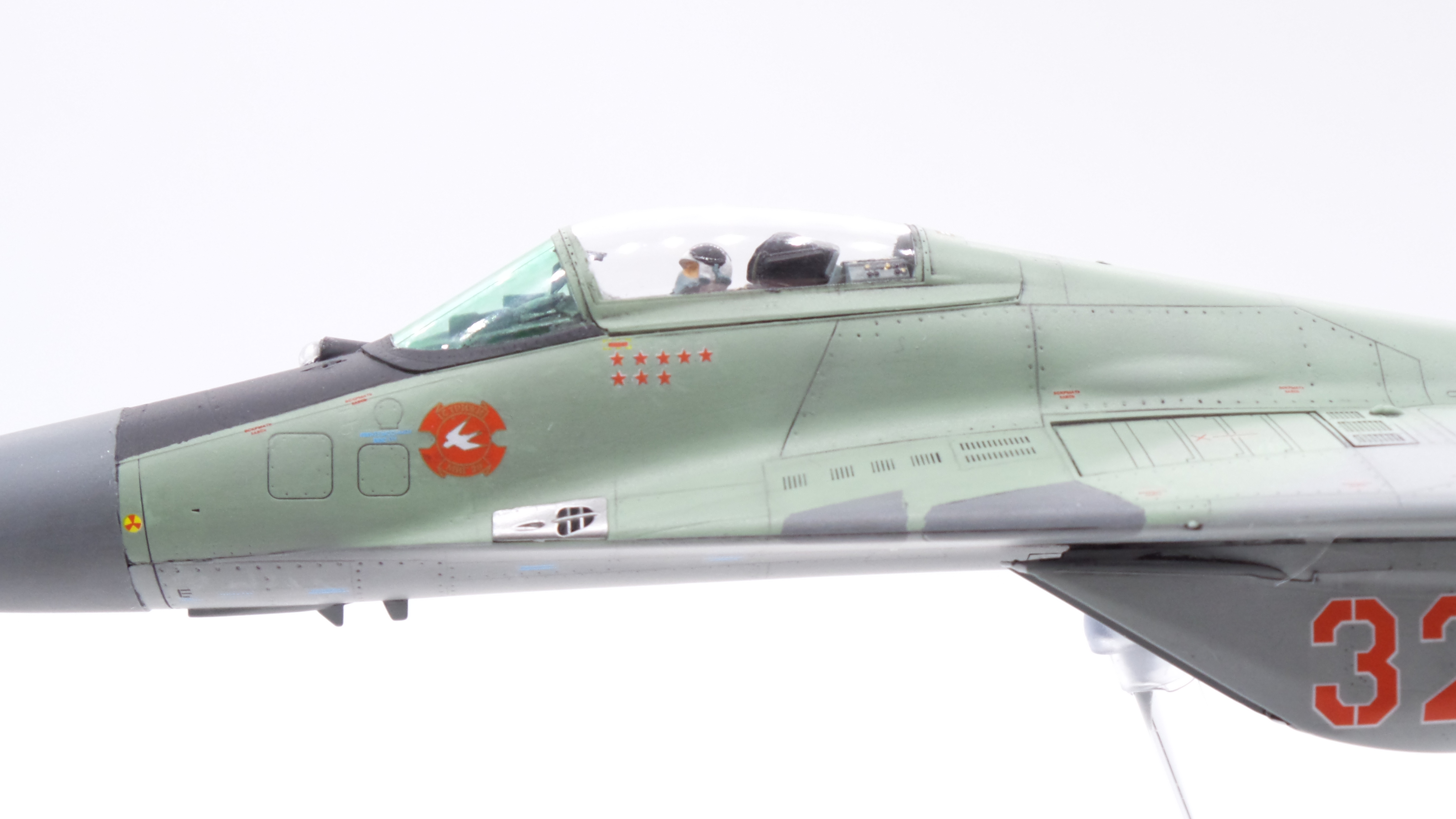

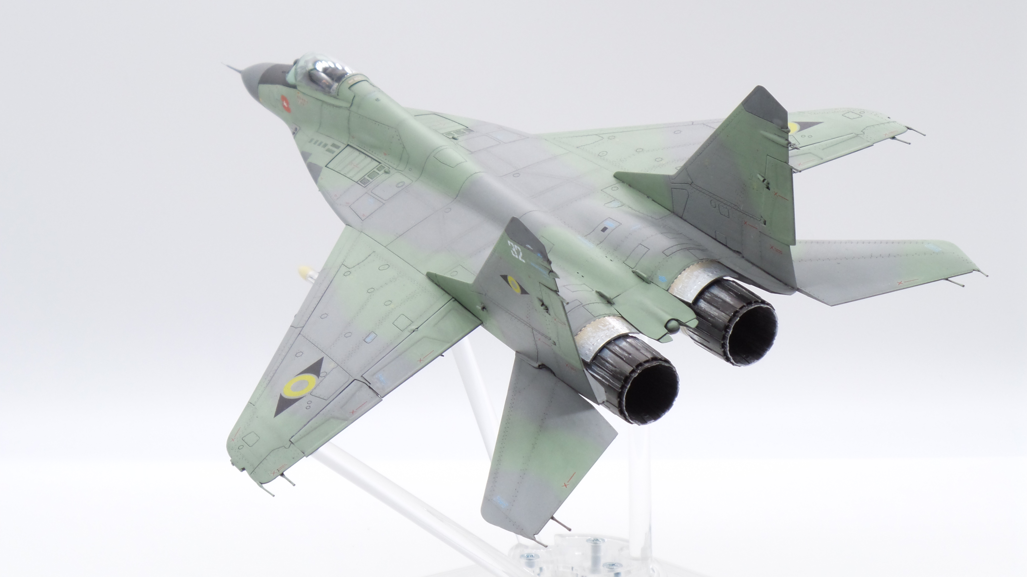

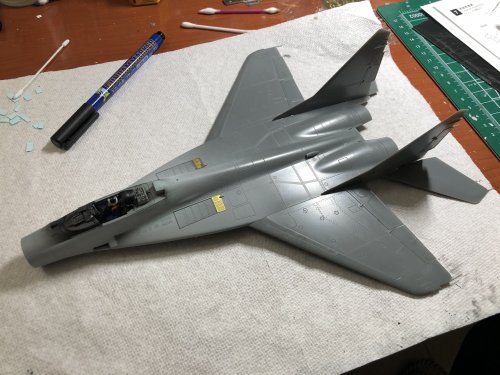

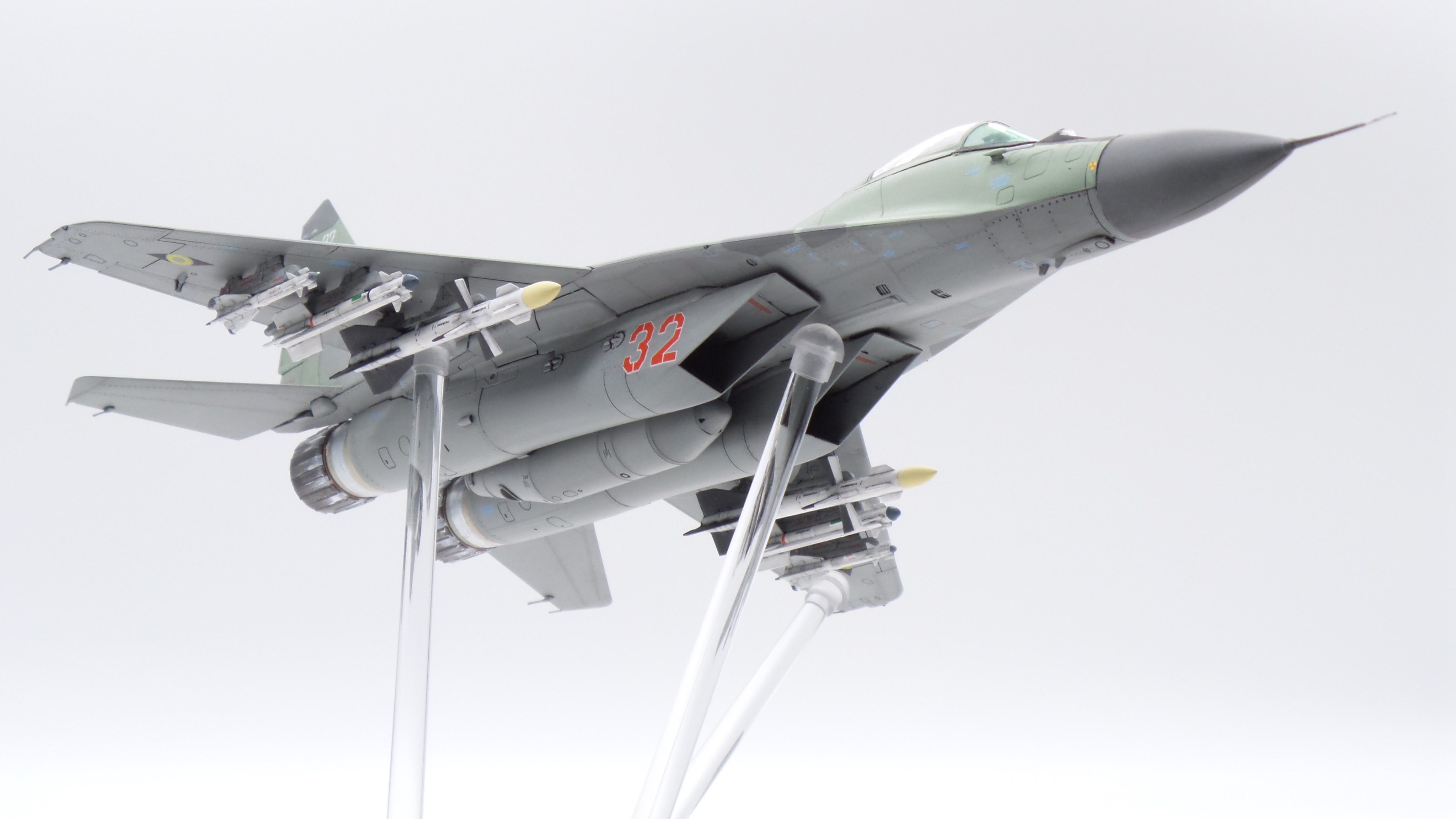

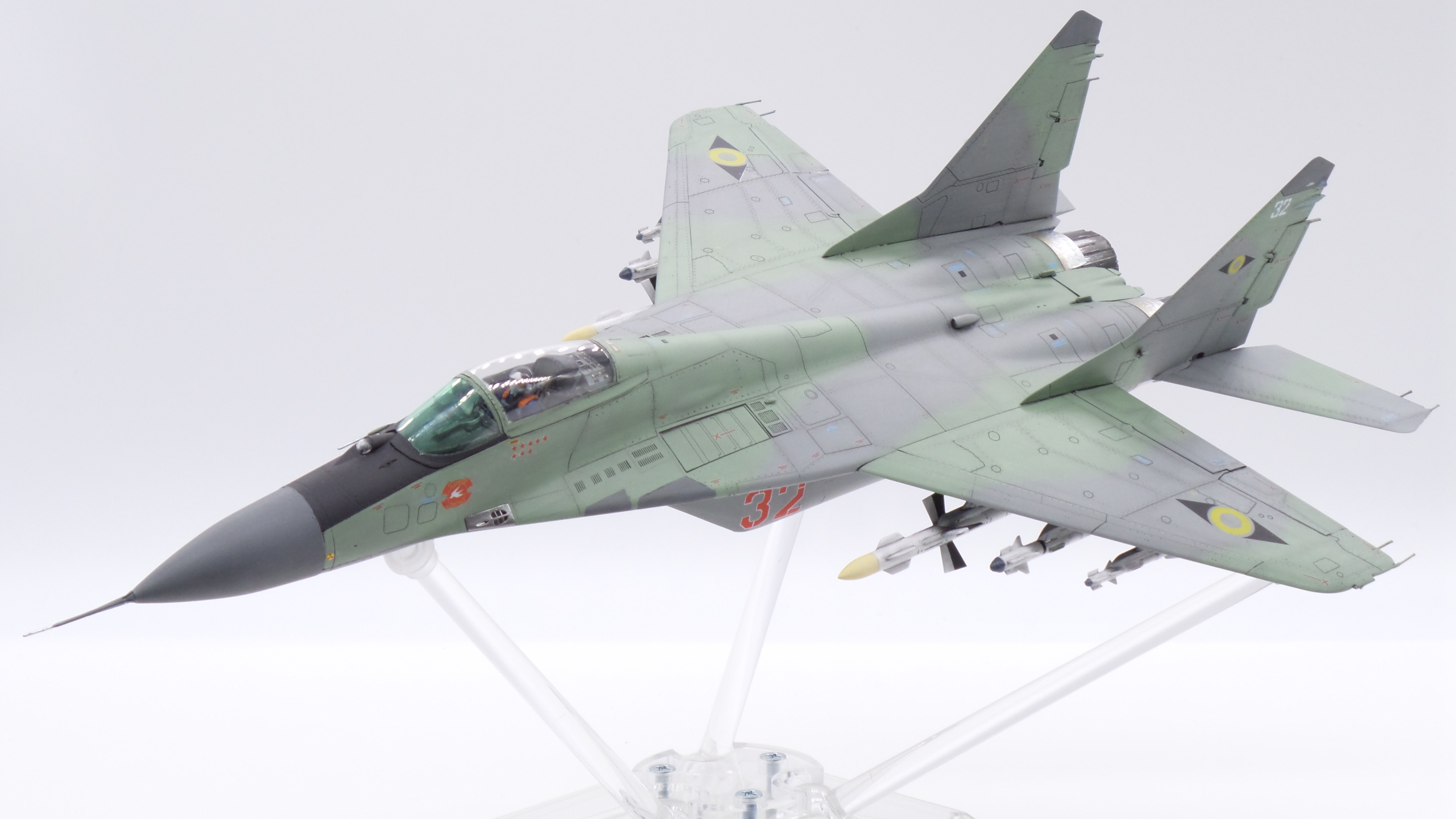

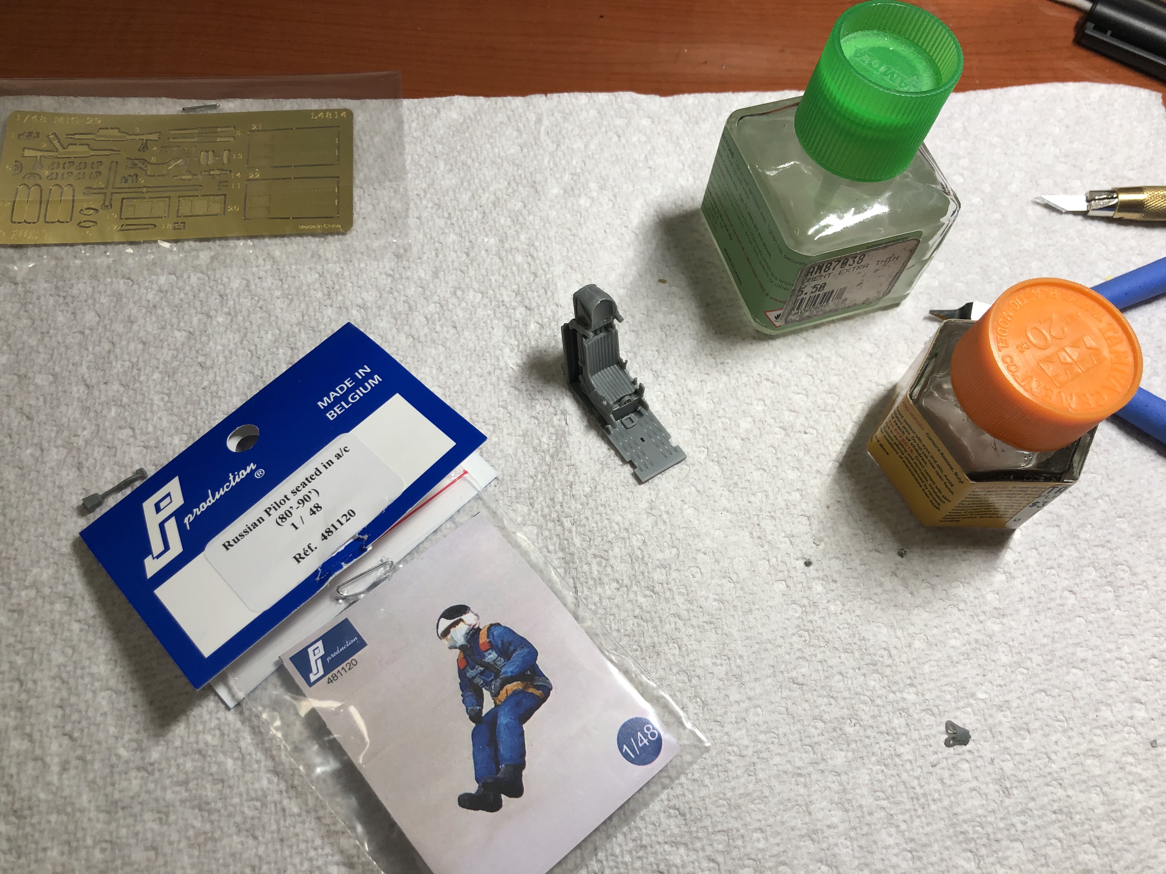

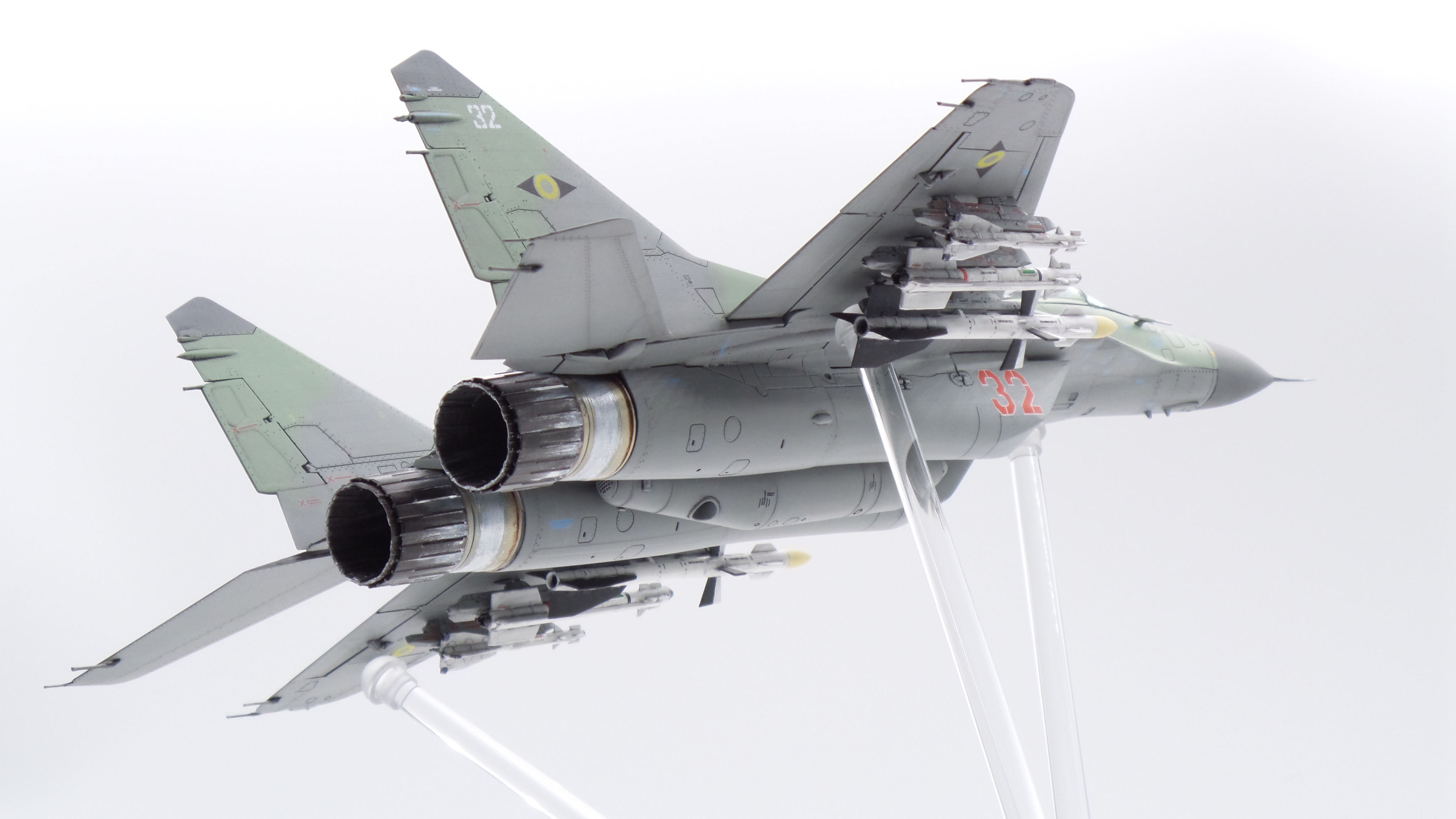

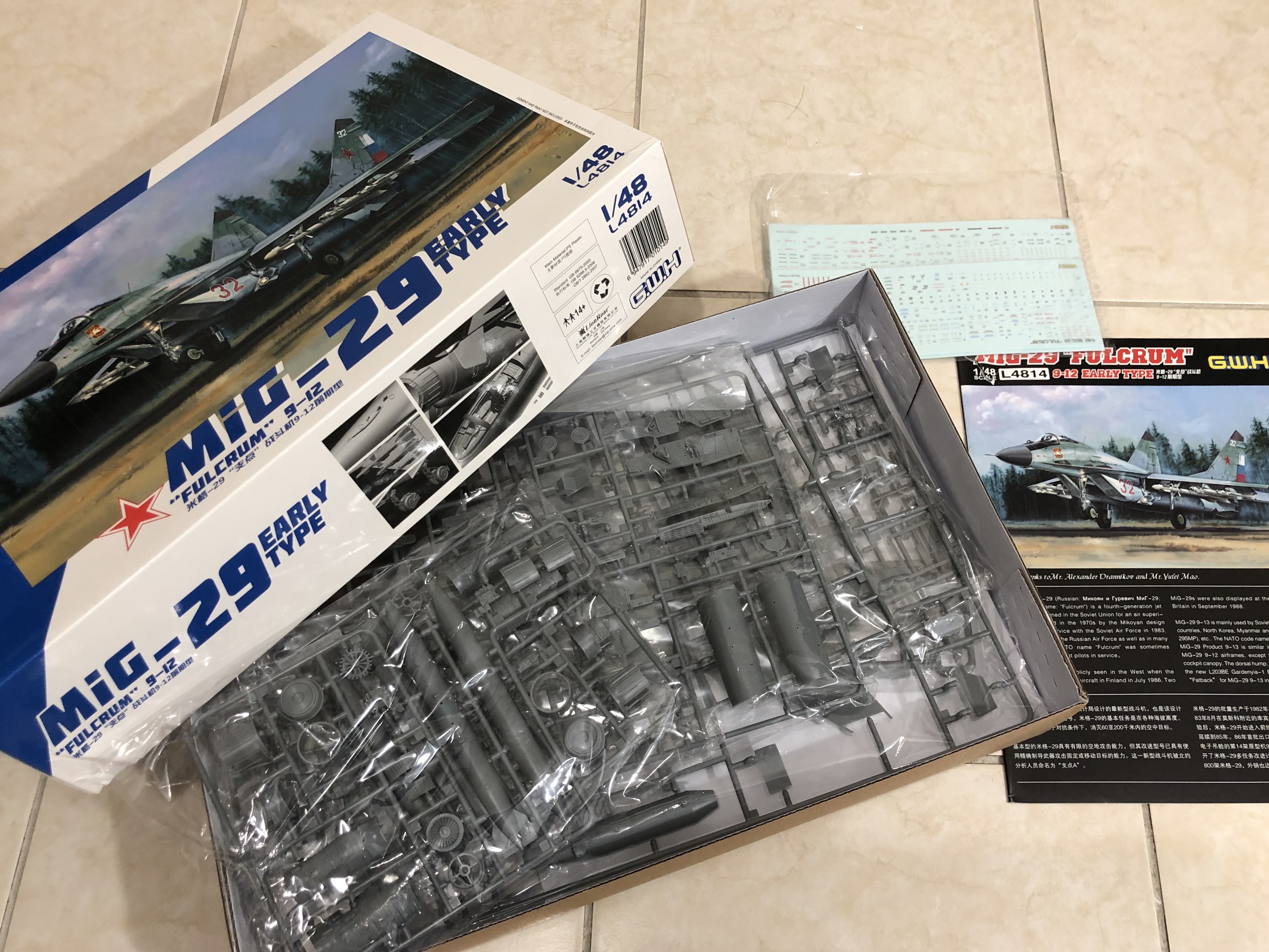

This Great Wall Hobby 1/48 kit impressed me. Though not perfect, it has a one-piece fuselage, beautiful mold and photo etched parts, individual armaments, and fine engine details. In short it’s the best aircraft model I have handled so far.
Bought an extra resin pilot. It fits well with this kit.

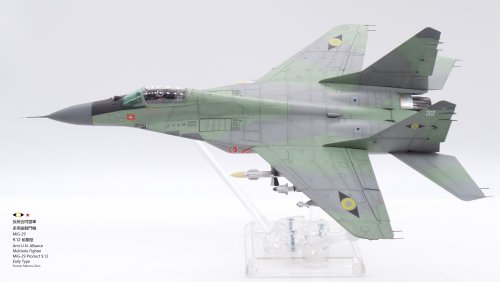

This kit's details are amazing. It would be perfect if the rivets and panel lines were slightly deeper.

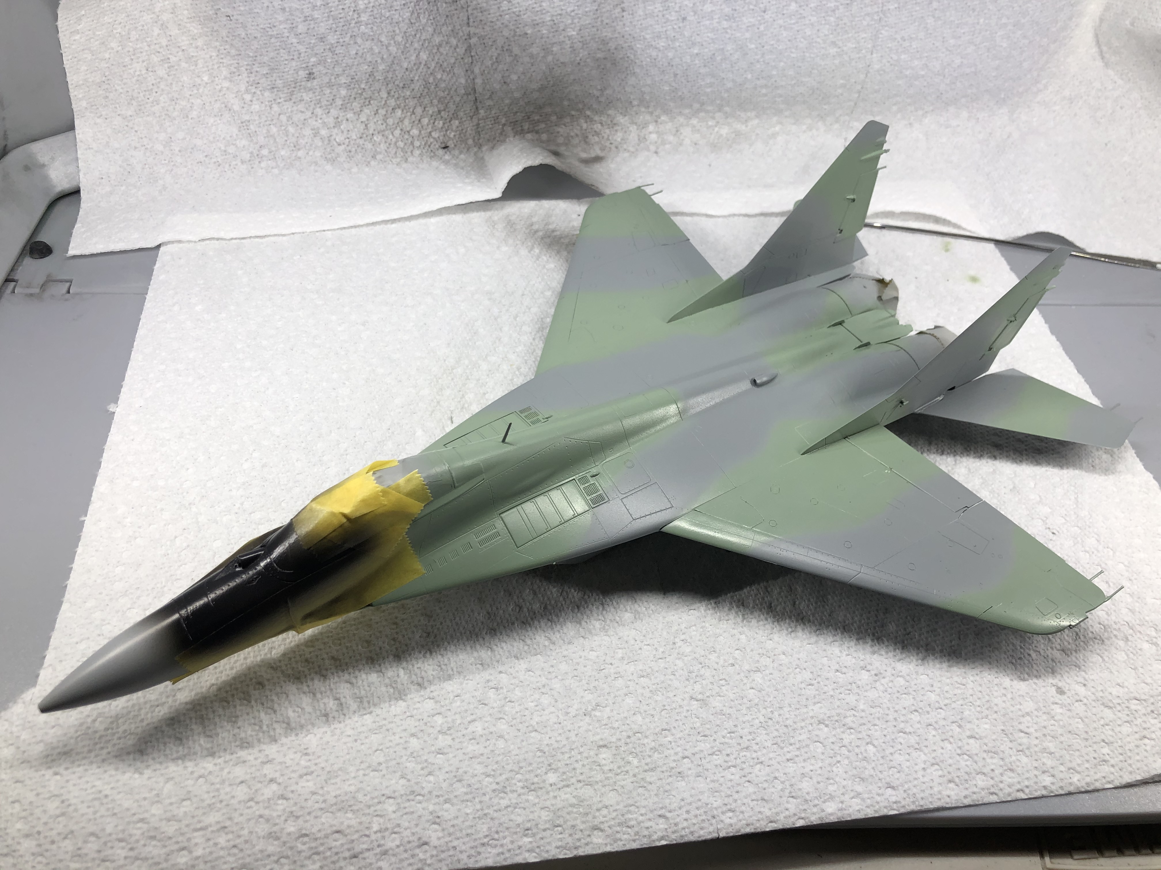

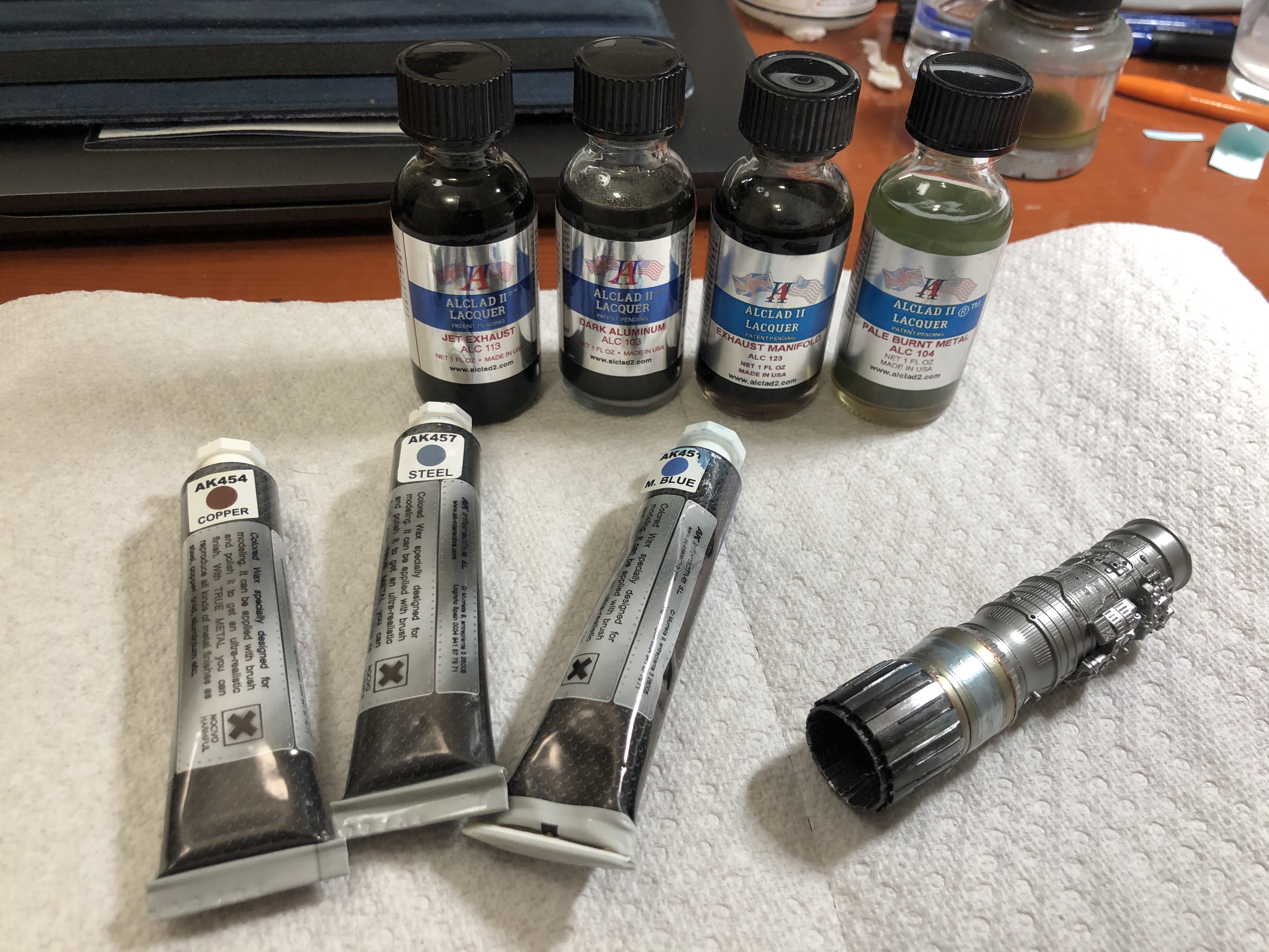

The metallic colors of Alclad II (lacquer) are great. After spraying, polish with True Metal wax (enamel) from AK Interactive. A good thing is the wax can be removed with enamel thinners without removing the base paint.
MRP's MiG 29 special colors (lacquer) are used. Fuselage 091 (light gray) and 092 (light green gray), radome 047 (dark gray).
Soviet aircrafts color reference: http://www.theworldwars.net/resources/resource.php?r=camo_vvsmod
Maybe D.D. Ivanov piloted MiG-29 before? :)

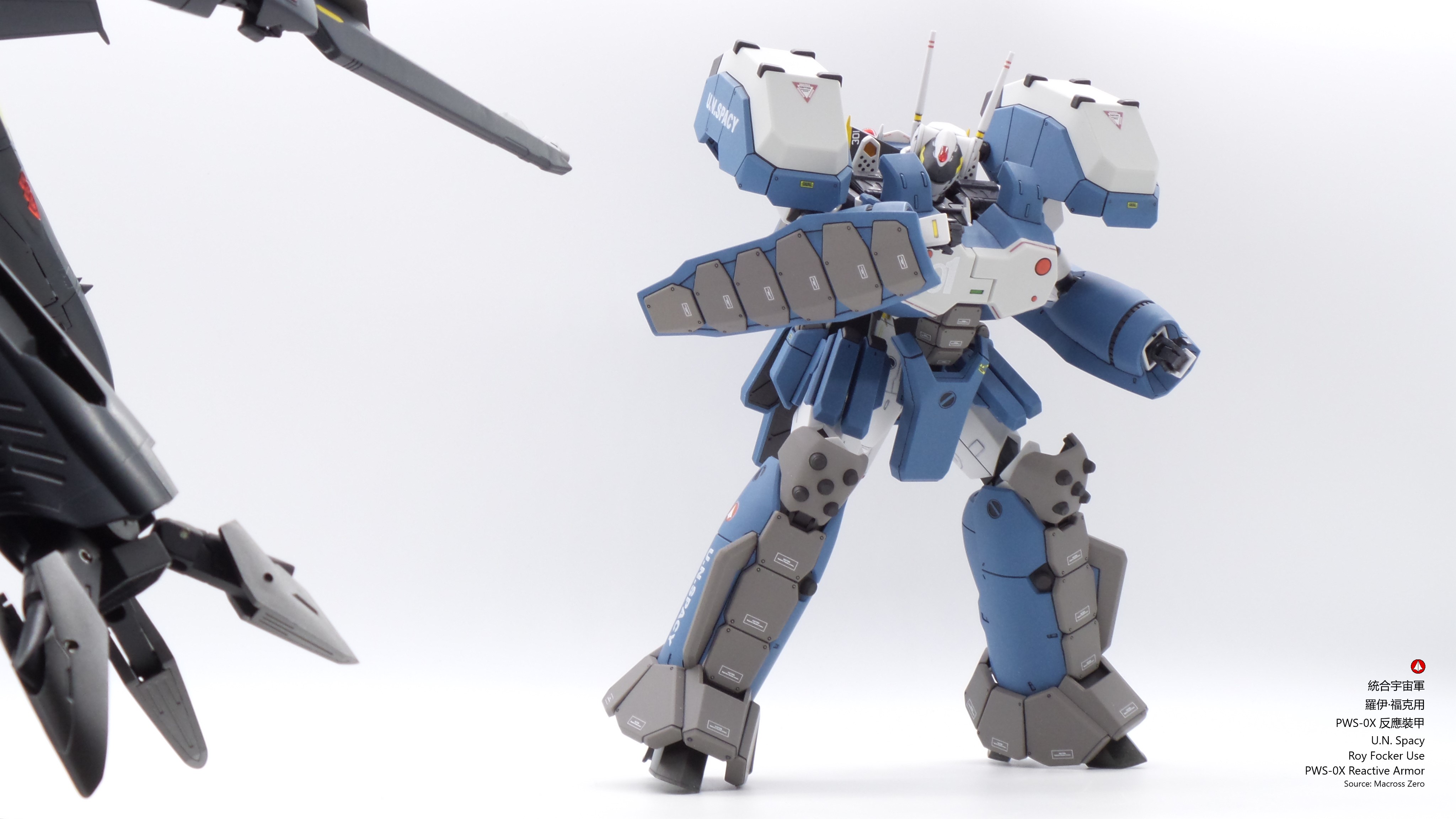

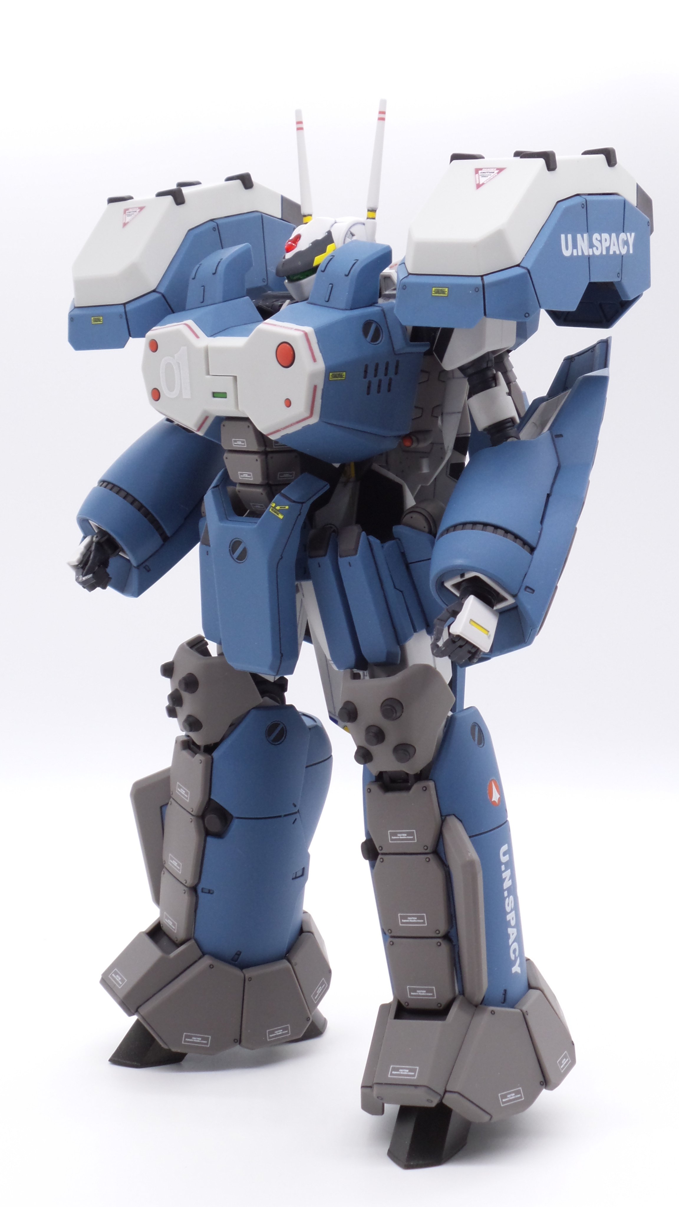

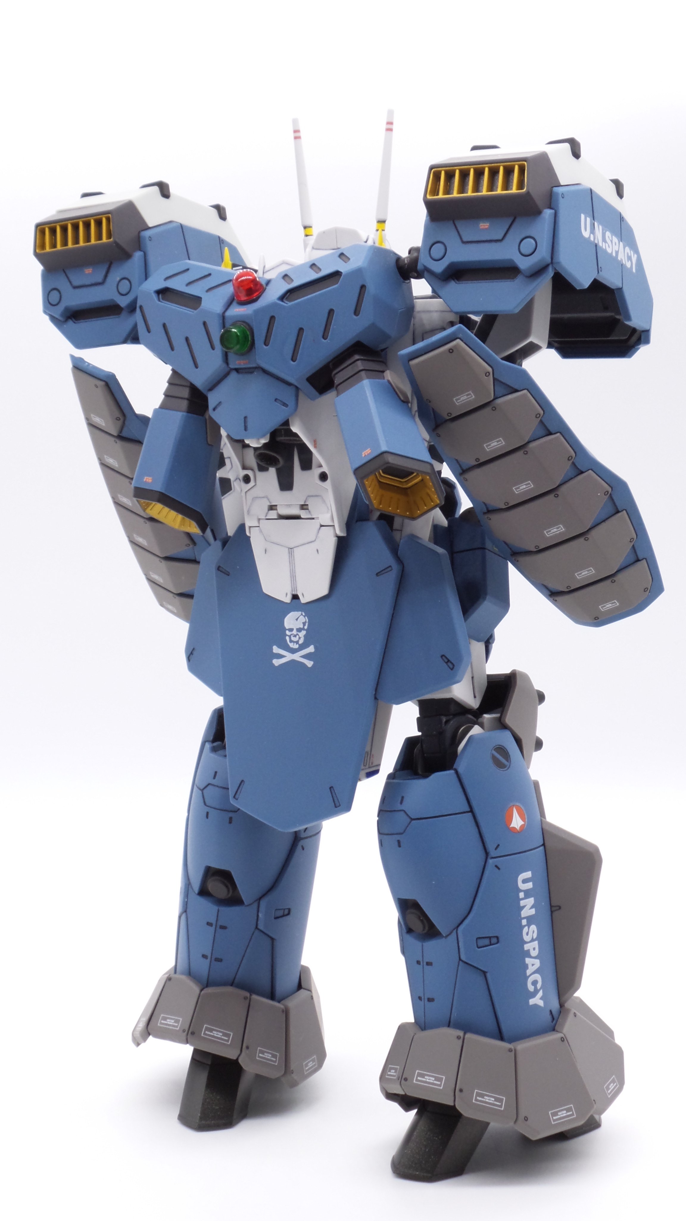

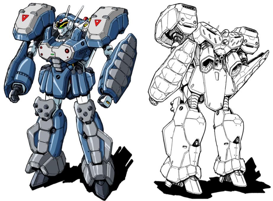

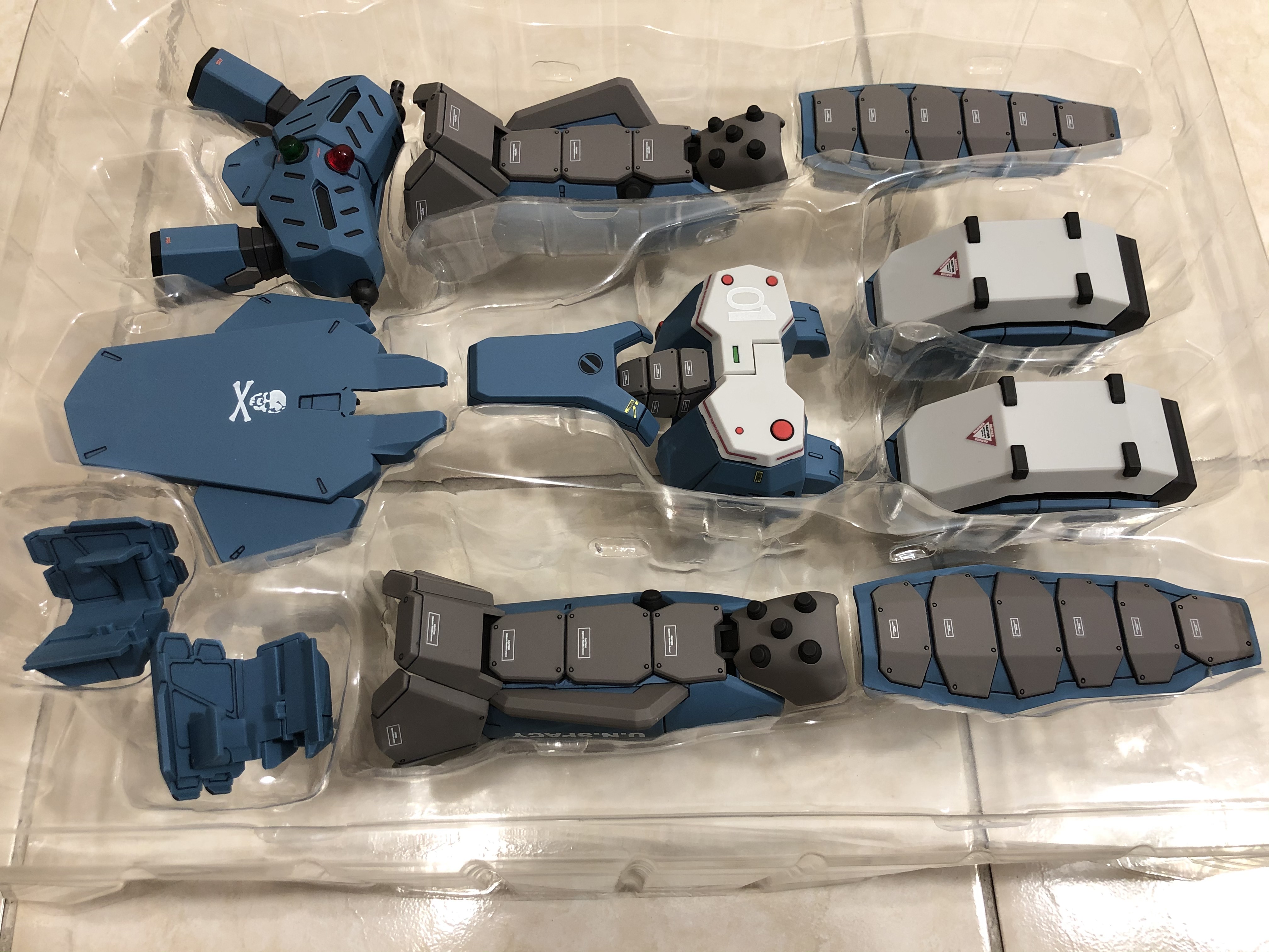

* Add PWS-0S Reactive Armor
20210105_035339.thumb.jpg.74580b35eb30799dff57a6cc91e95c3e.jpg   20210105_035247.thumb.jpg.dfe0486348d4477470df74bc947b3a16.jpg

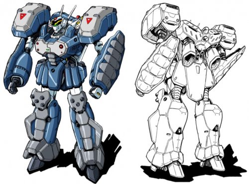

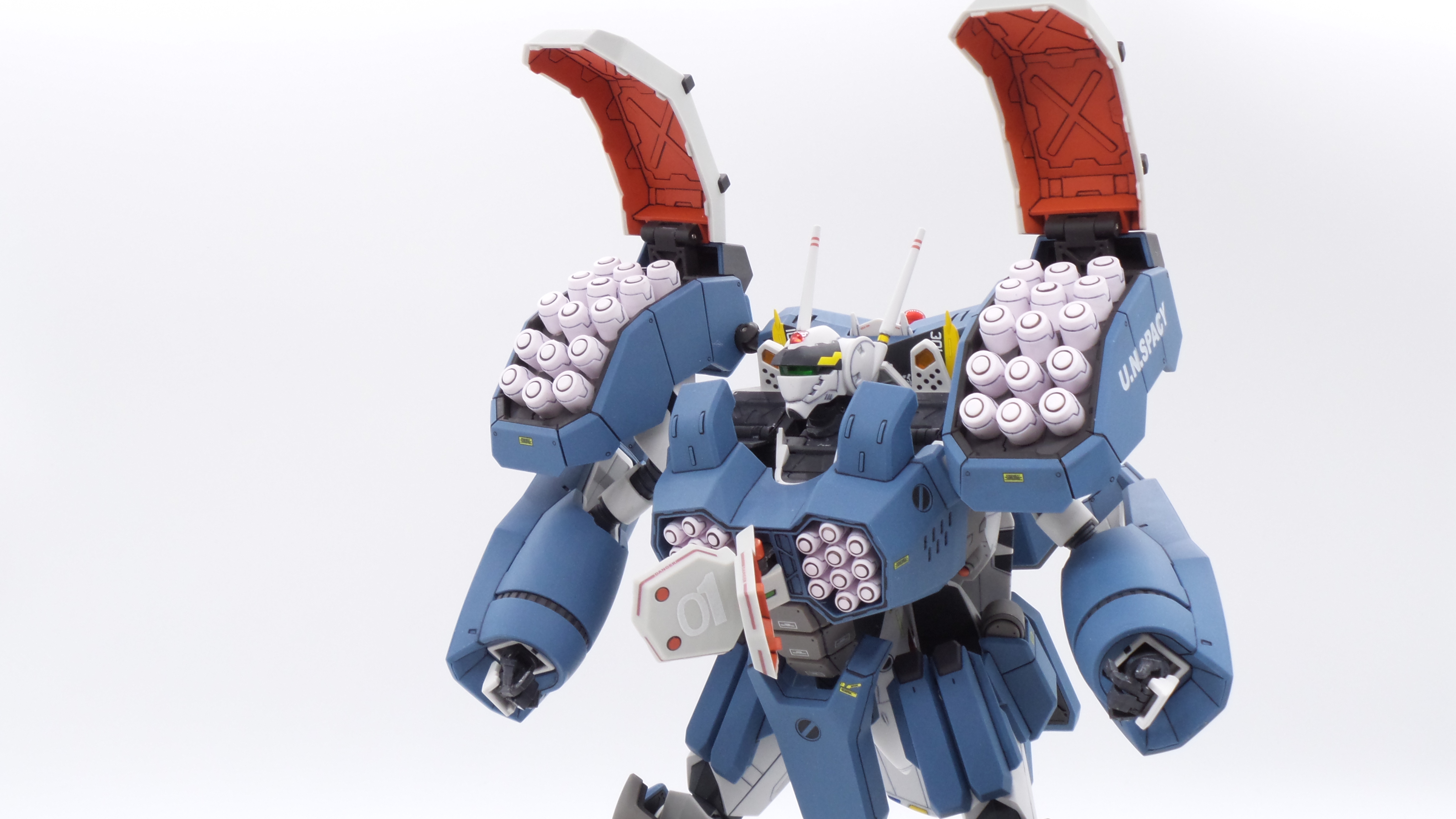

The PWS-0X reactive armor was developed for close-range high-intensity combat. It provides additional protection and firepower for the VF-0 fighters.
With opened missile bays. The armament includes 50 micro missiles and 6 high-explosive grenades.

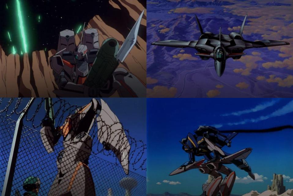

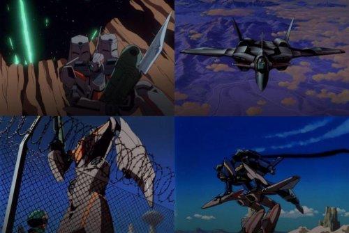

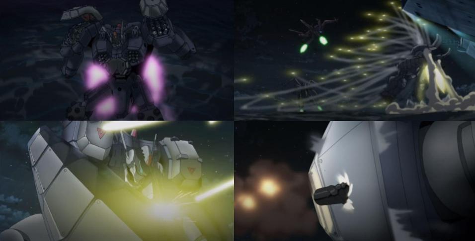

On screen with Roy Focker, Macross Zero episode 3
A quasi premium finished ver. The kit is panel lined and matte coated. Water-slide decals were also used on the manual suggested spots, plus some warning marks.
Original art, from Macross Mecha Manual: http://www.macross2.net/m3/macrosszero/vf-0s-reactivearmor.htm
Have fun!

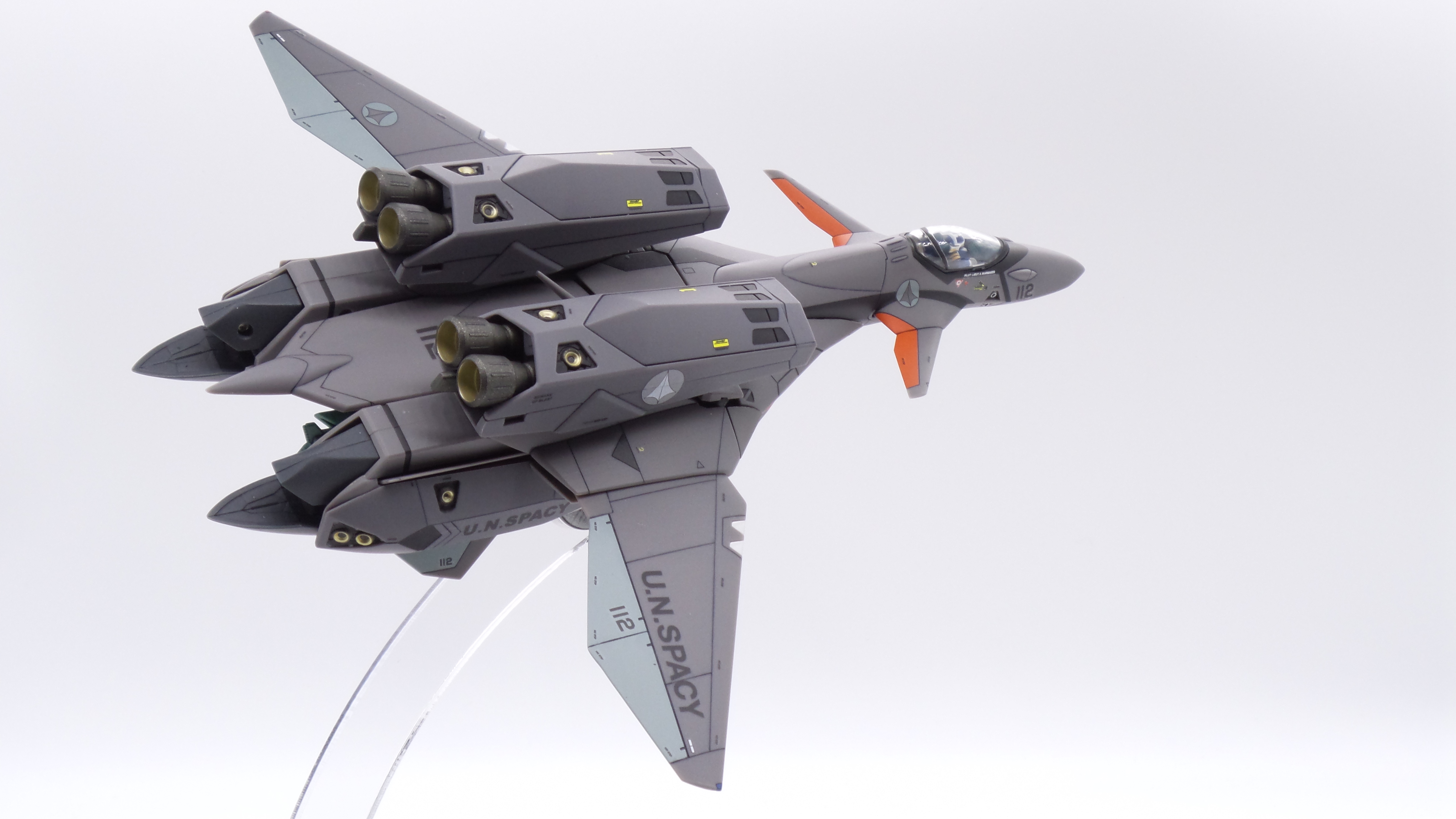

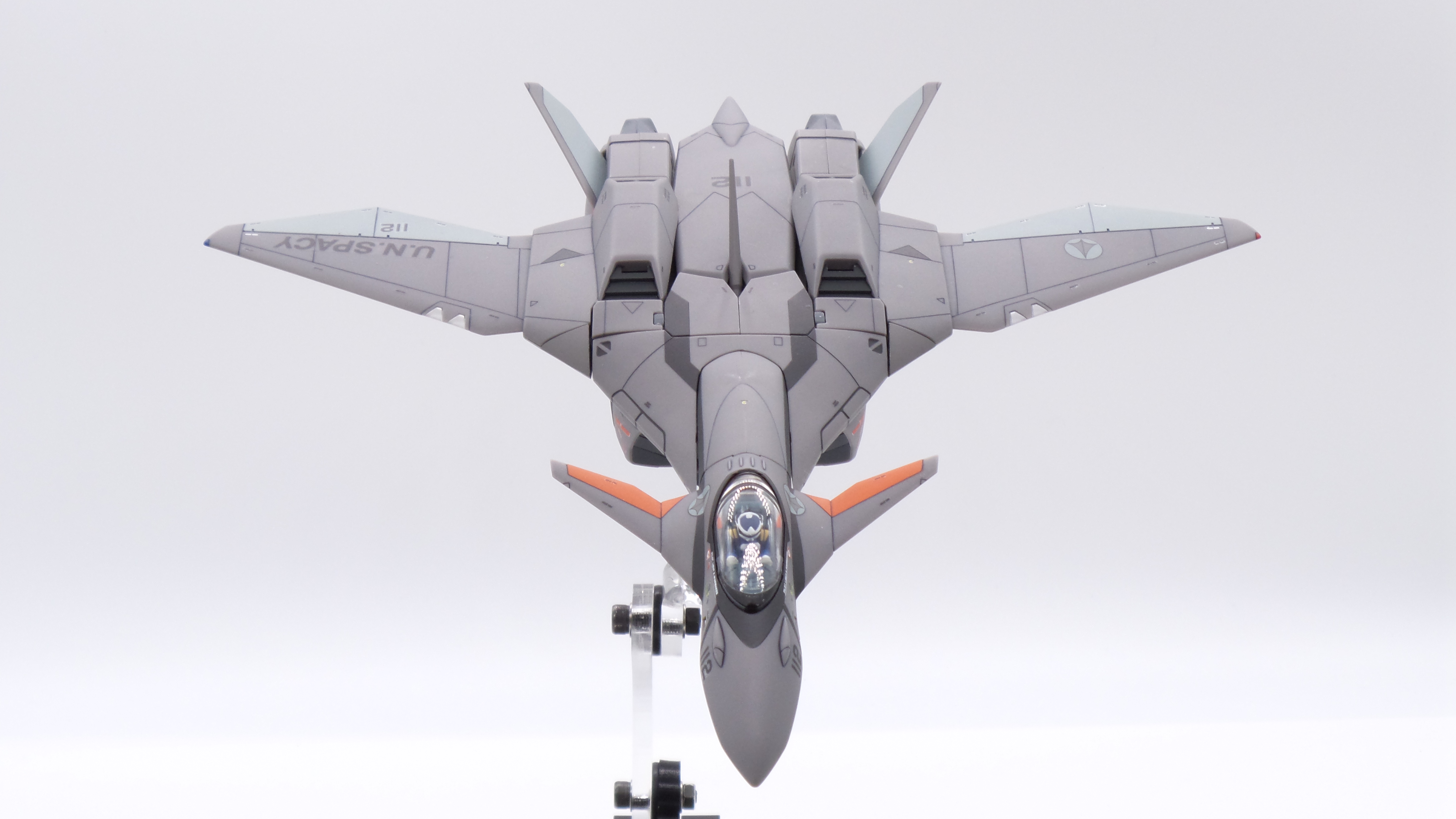

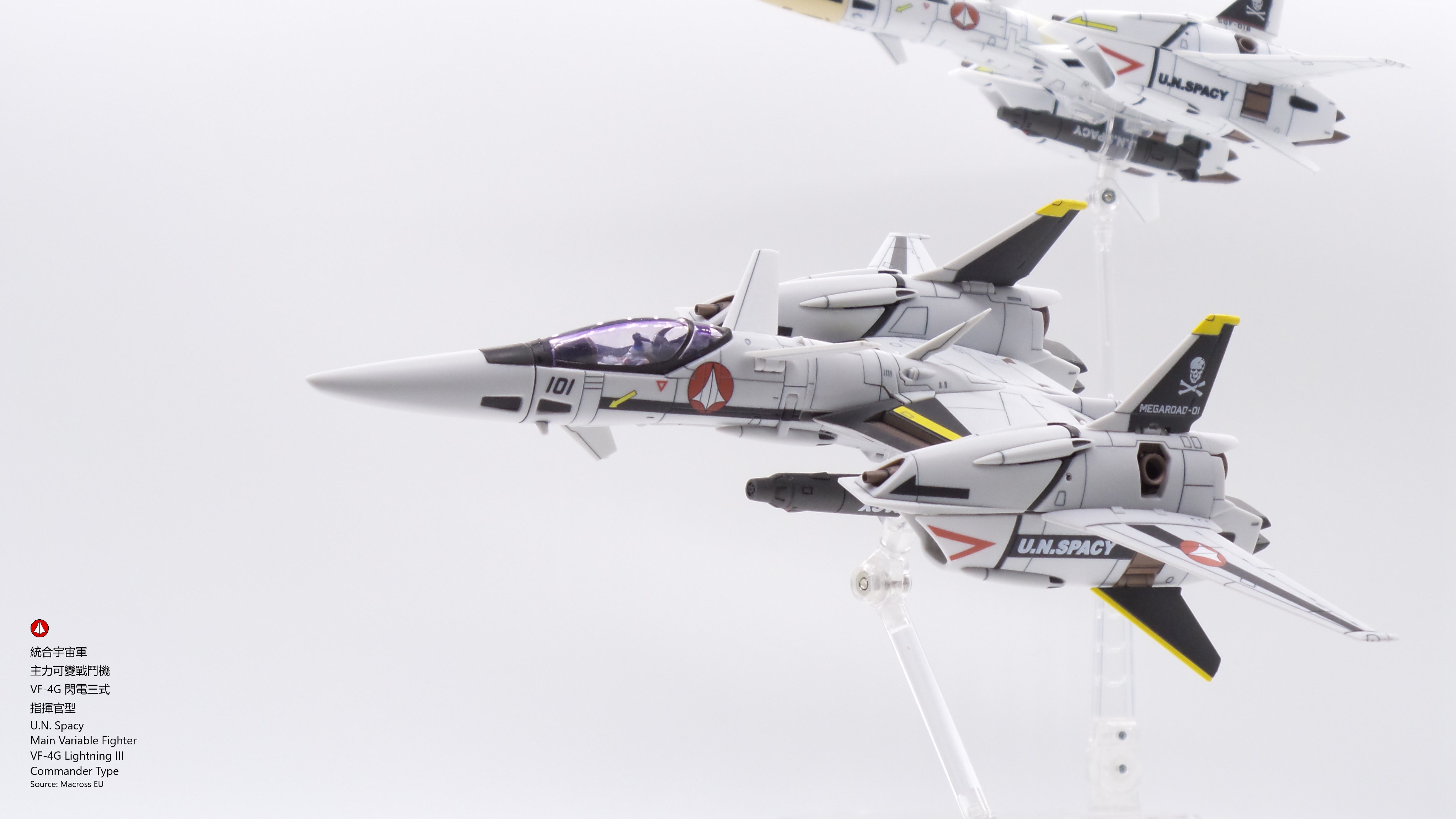

Update on the first post:
* Add VF-4G Commander Type

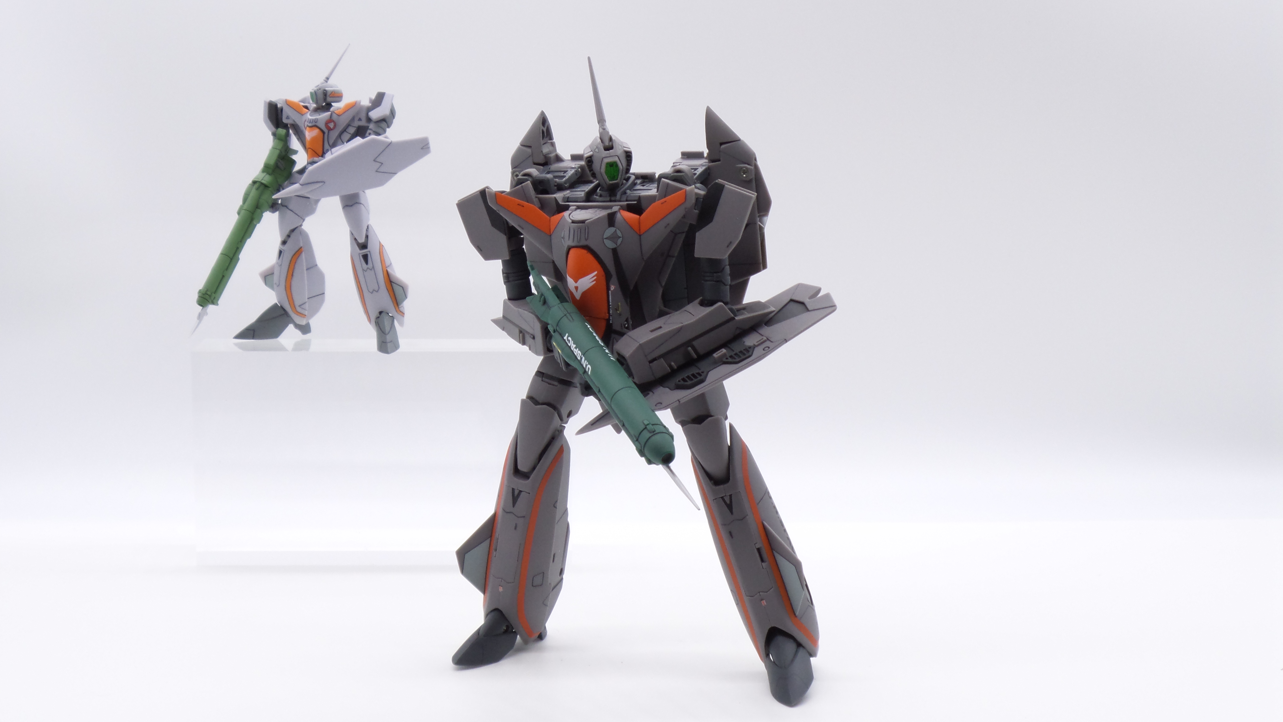

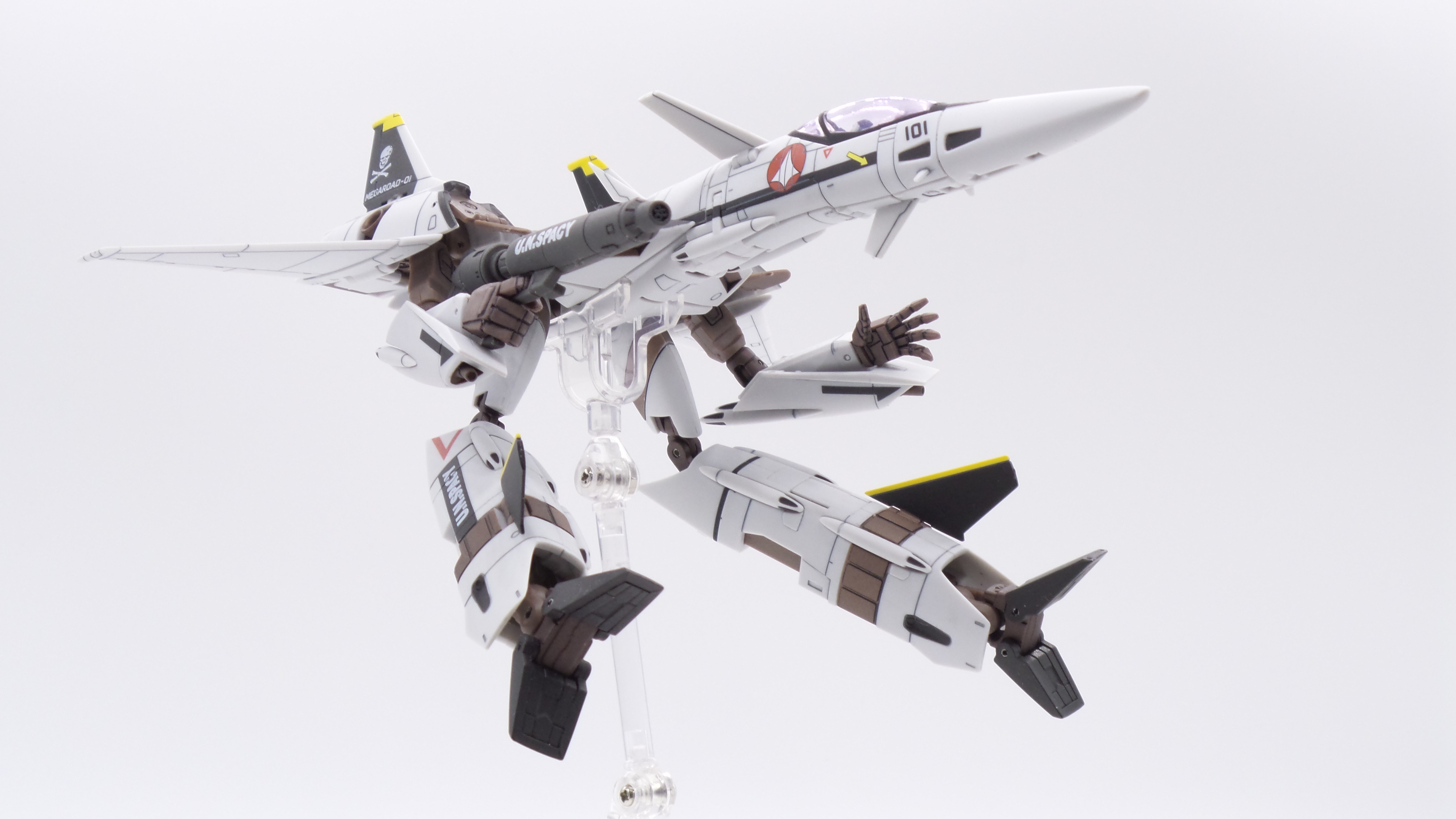

Gerwalk

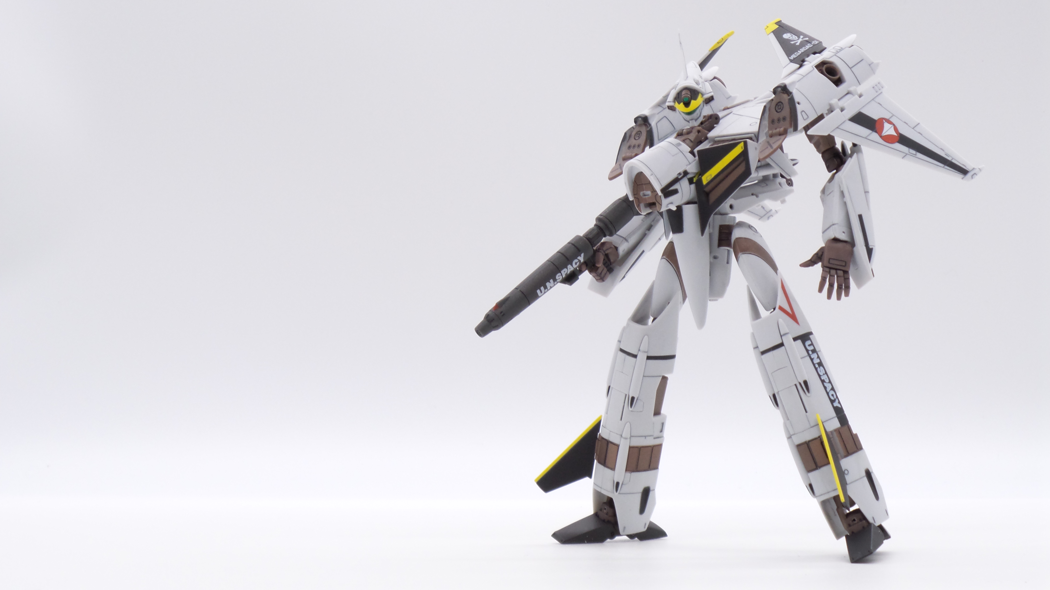

Battroid. Its distinctive head design came from the VF-4 master file.

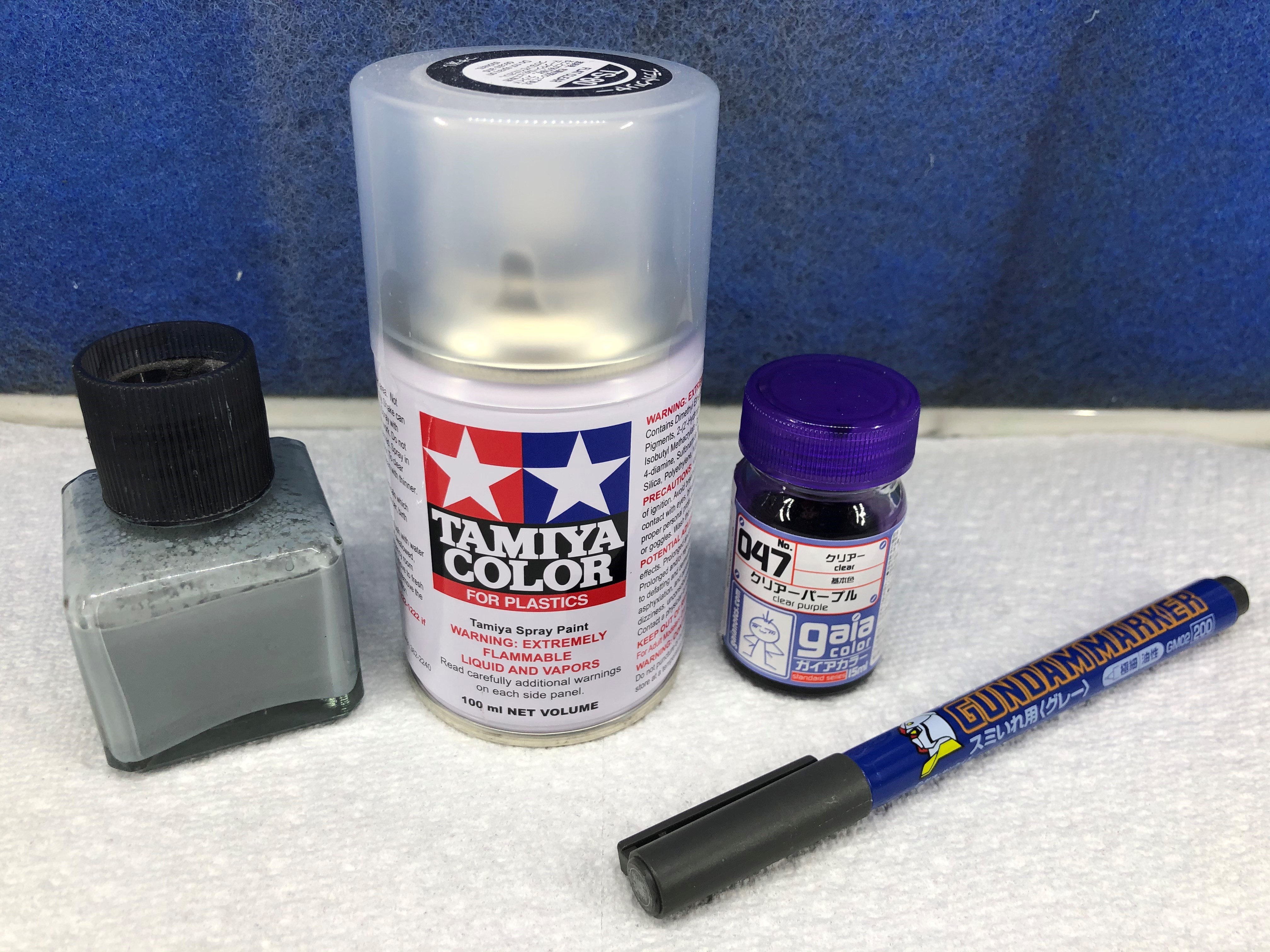

I used Tamiya gray panel liner, TS-80 matte coat, and Gaia 047 for a slight canopy tint.

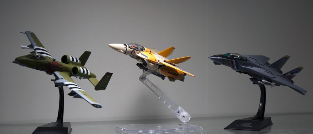

Nice! One of my favorite aircraft. I thought it may be a diecast model at first and was wondering why Hatchette can’t release one with a payload like that (that I know of). A-10s should always be armed to the teeth unless they just unloaded on some poor targets.
15 hours ago, EastwindS2k said:
I just found A-10 on screen, unbelievable! :shok:
Nice find @EastwindS2k.. Its just these little details tying Macross to real world jets that always make me geek out..

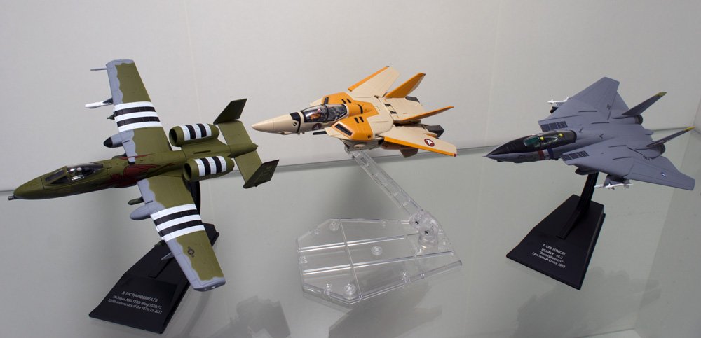

Cool! One of my favorite aircraft and it makes these photos almost canon!
Macross_HMR_VF-1D_A-10_F-14_2.jpg.2dc86041d95a7280d234620852f10354.jpgMacross_HMR_VF-1D_A-10_F-14.jpg.f2d89c02ac2850c83c9ff97637556042.jpg
Now I have to move my 1/100 A-10 to the Macross HMR shelf, and get another A-10 for the real-life jets shelf.. More excuse for doubles! :lol:

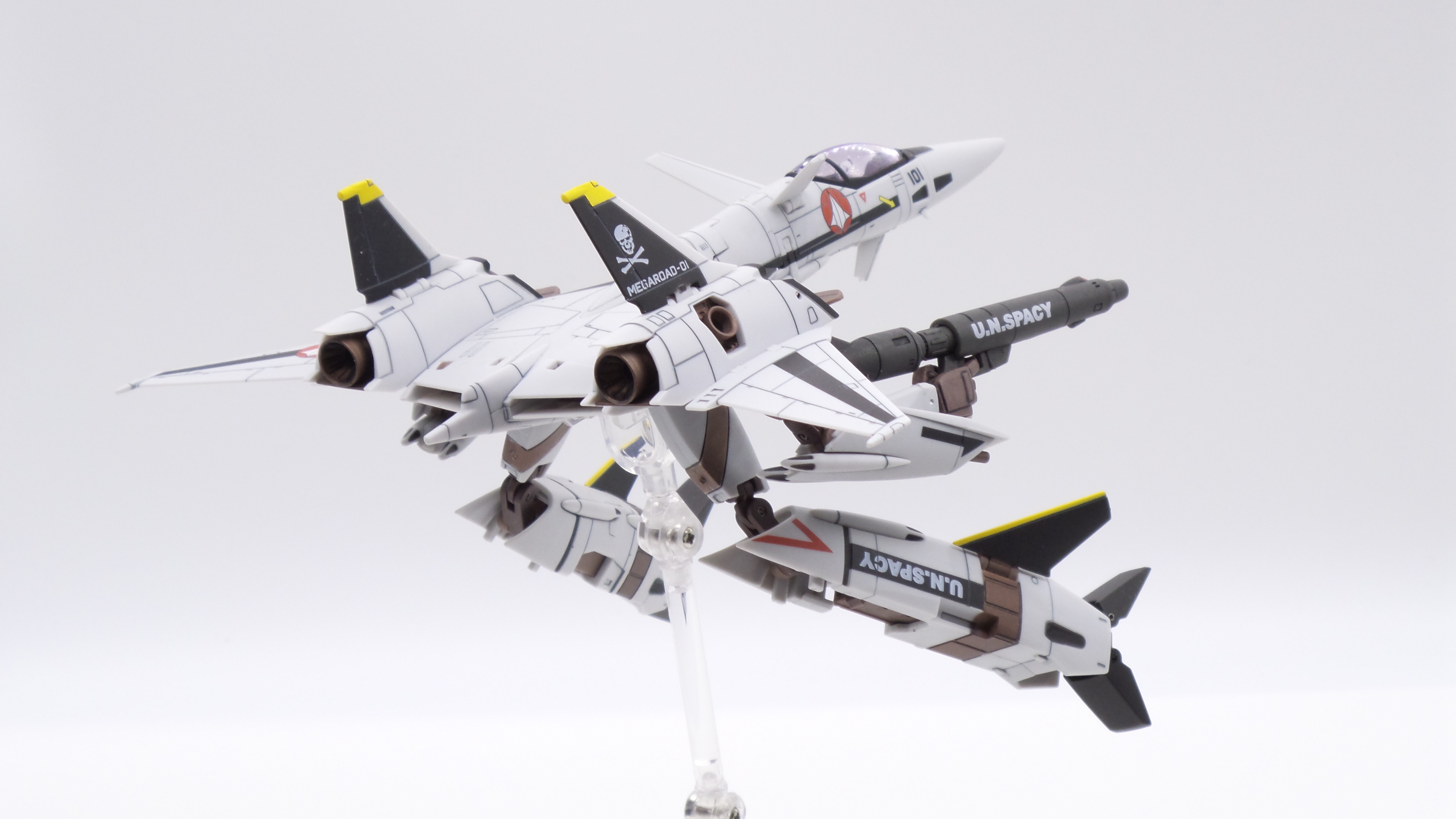

* Add VF-X

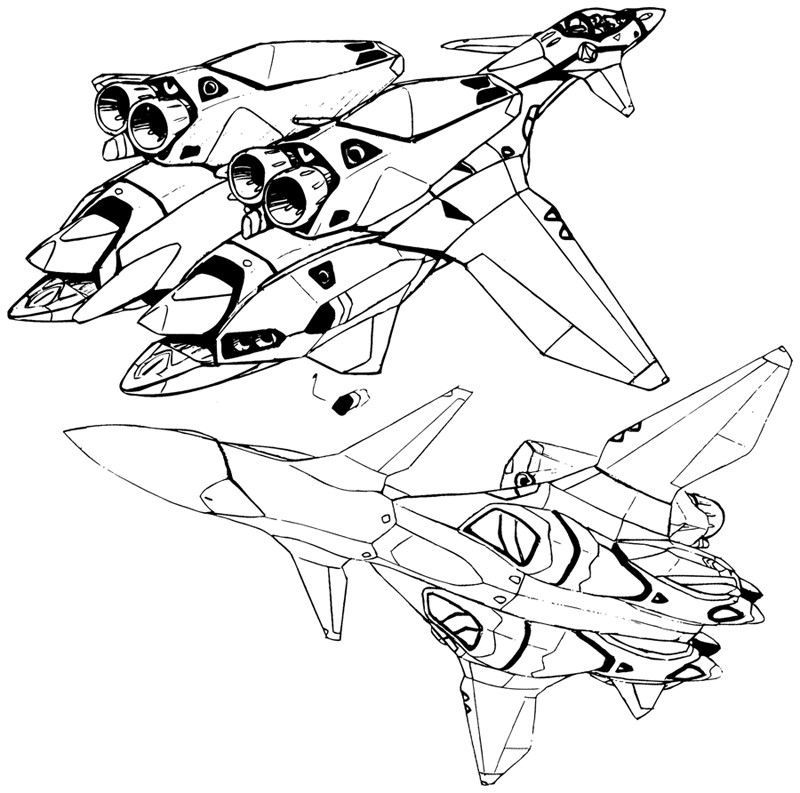

The VF-X was an experimental prototype Valkyrie. It cannot transform but is equipped with thermal-nuclear reaction engines, and that is opposite from the VF-0s. With the success of VF-X, U.N. began mass production of VF-1s as its main variable fighter.
20210422_210914.thumb.jpg.820c7659ea0a37ee81cc188f678b80ba.jpg  20210422_203702.thumb.jpg.302a99a48e46b6b5acc0a05e1ab33b1f.jpg
VF-X has no head and arms, so it can only transform partially. Here is the VF-X in quasi-Gerwalk mode.
1.thumb.JPG.7d77ab26ec68eedb2ce64e2bb970d042.JPG  1125630558_VF-X2.thumb.jpg.9262e912d88eb27b326d5fd245883273.jpg
VF-X in Claudia’s flashback, Macross episode 33
Original art from Macross Mecha Manual:http://www.macross2.net/m3/sdfmacross/vf-x.htm
The Yamato version 2 Valkyries are fine toys. I wish Arcadia and Bandai would release more lesser known Macross products. Here I avoided yellow warning marks to better match the VF-X’s original colors.
