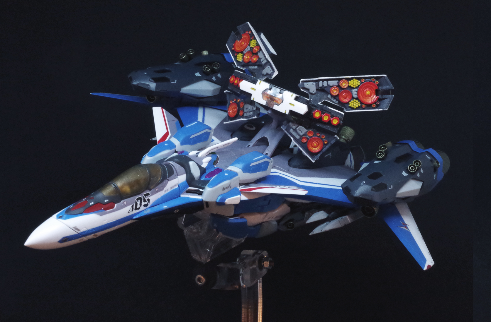

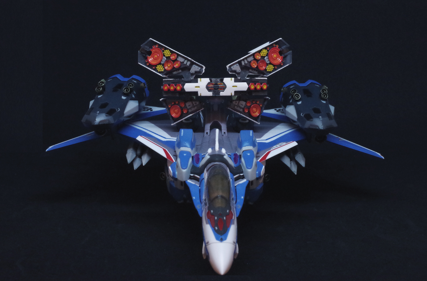

Xigfrid Posted January 15, 2018 Posted January 15, 2018 Second sanding session plus another primer layer. The flat faces are almost done, tomorrow that would be the last sanding session I think.
Xigfrid Posted January 17, 2018 Posted January 17, 2018 Sanding is complete and I am pretty happy with it Now I need to paint it. First step will be to apply the colors on the 3D file so I can make a pdf of the masking patterns I need and print it so I can easily cut the masking and the glass.

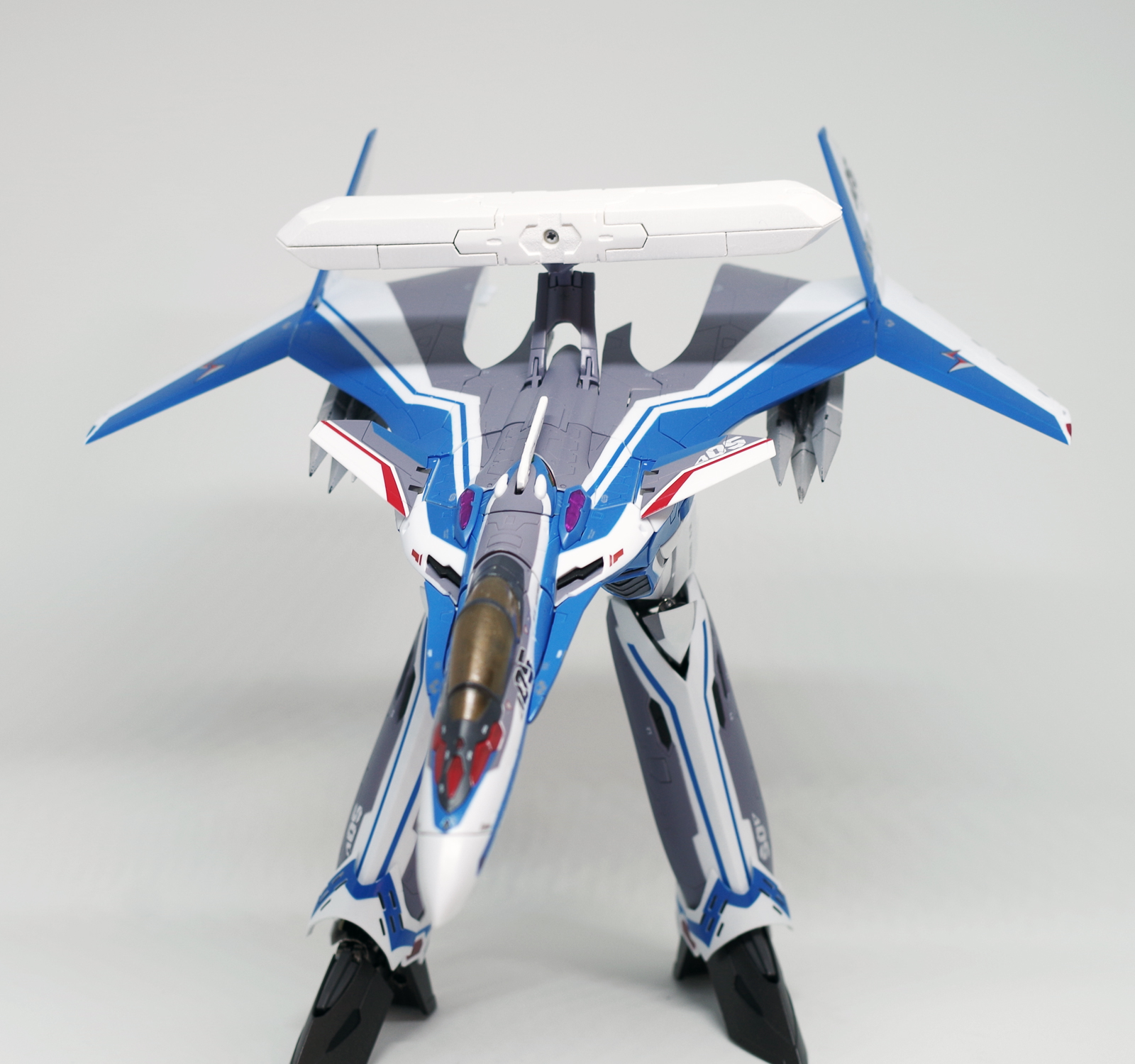

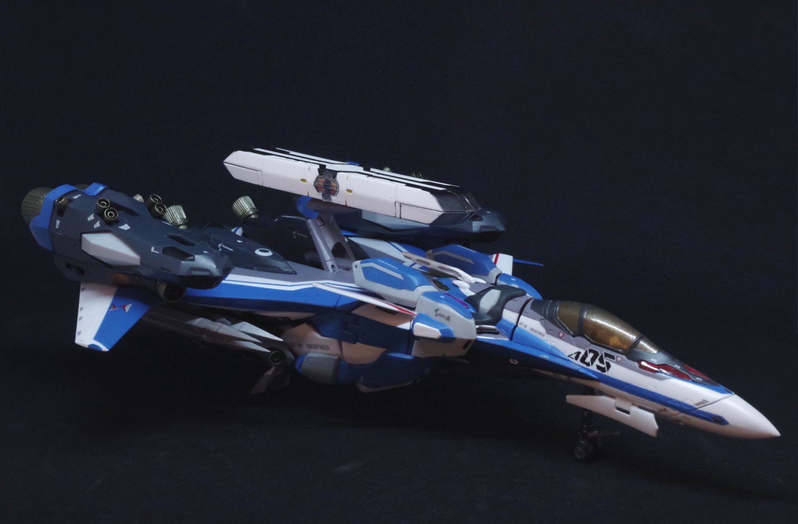

kajnrig Posted January 20, 2018 Posted January 20, 2018 Nice video! Is this an accurate recreation of the in-show speaker pod? I don't doubt it is, but I seem to remember there being extra speaker kibble coming off the top of the largest speaker section. Also, apologies if someone's already asked, but any chance this gets recreated in 1/72?
wmkjr Posted January 21, 2018 Posted January 21, 2018 51 minutes ago, kajnrig said: Nice video! Is this an accurate recreation of the in-show speaker pod? I don't doubt it is, but I seem to remember there being extra speaker kibble coming off the top of the largest speaker section. Also, apologies if someone's already asked, but any chance this gets recreated in 1/72? For what limited space is given to work with, it looks pretty good to me.
Xigfrid Posted January 22, 2018 Posted January 22, 2018 (edited) On 21/01/2018 at 12:14 AM, kajnrig said: Nice video! Is this an accurate recreation of the in-show speaker pod? I don't doubt it is, but I seem to remember there being extra speaker kibble coming off the top of the largest speaker section. Also, apologies if someone's already asked, but any chance this gets recreated in 1/72? @kajnrig I don't think I forgot a noticeable speaker, let me know if one is missing, I can still fix the 3D files 1:72 scale ? It can be done, but fully in FUD and in fixed position: would be that ok ? I just made a quick comparison picture to explain the differences between "my speaker pod" and the one available now on shapeways. The one on shapeways is more anime accurate and would close more firmly. Edited January 22, 2018 by Xigfrid
kajnrig Posted January 22, 2018 Posted January 22, 2018 Ah, I'm sure you've got it down pat; I was just remembering it wrong, as @wmkjr's screenshot made clear. 1/72, closed and open fixed mode, would be great but I'd hate to make you do much more work. What's the risk in a "simple" scale-down of the preexisting model?
Xigfrid Posted January 22, 2018 Posted January 22, 2018 3 hours ago, kajnrig said: Ah, I'm sure you've got it down pat; I was just remembering it wrong, as @wmkjr's screenshot made clear. 1/72, closed and open fixed mode, would be great but I'd hate to make you do much more work. What's the risk in a "simple" scale-down of the preexisting model? I will try to scale down tomorrow and see if it still printable. If it doesn't work that means that only FUD could print and that I have to simplify the model to make it stronger. Speaker pod painted !

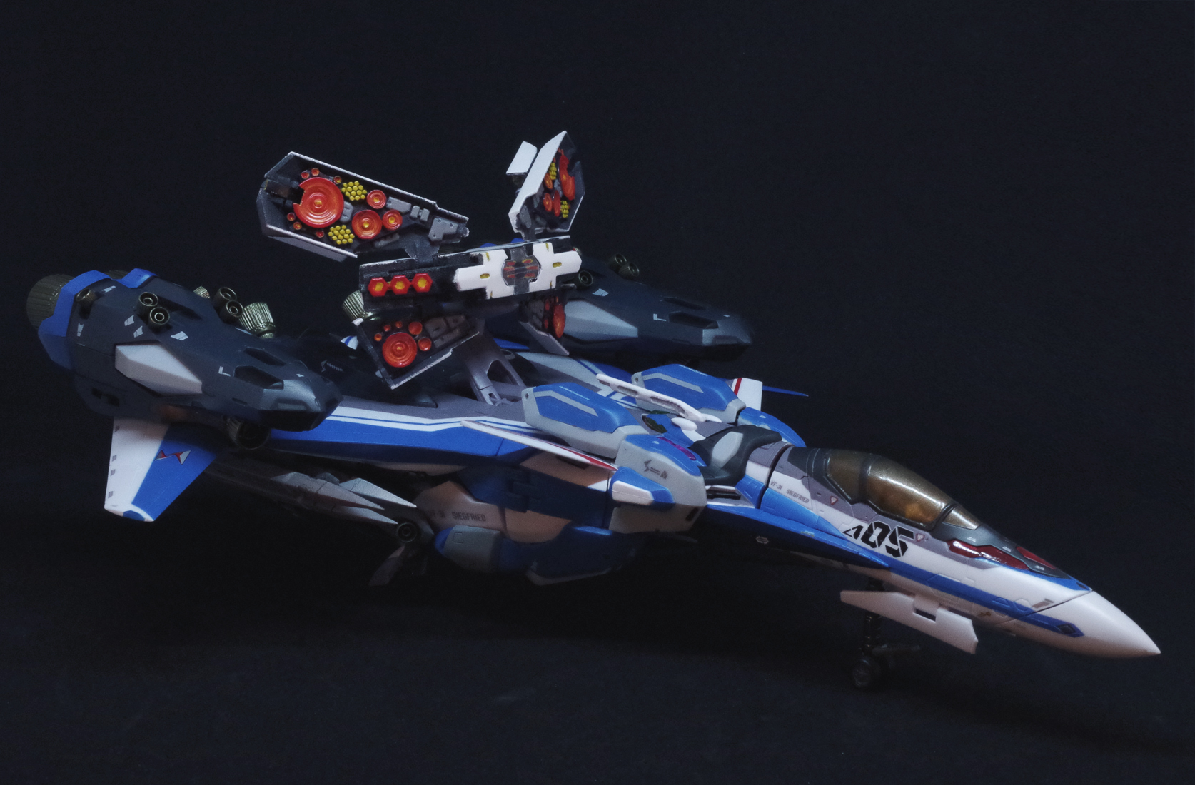

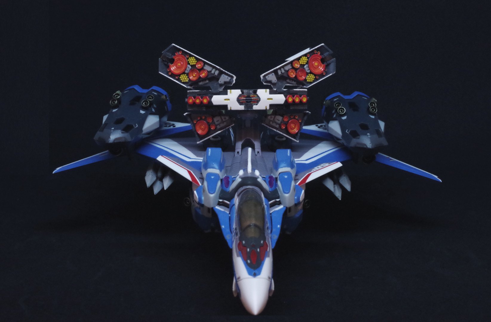

Sanity is Optional Posted January 22, 2018 Author Posted January 22, 2018 That looks amazing, nice work.
valhary Posted January 23, 2018 Posted January 23, 2018 amazing job Xigfrid! like usual you should try the VF 25 version

Sanity is Optional Posted January 30, 2018 Author Posted January 30, 2018 (edited) On 1/24/2018 at 3:46 PM, kajnrig said: Thanks for the confirmation, you two. And thanks Sanity for the head's-up. New models are on Shapeways for the 1/72, ought to cut the cost quite a bit. I'll re-do the 1/60s during the week. [edit] Since the models don't seem to be showing up properly, here's direct links: Body Interior Doors Edited January 30, 2018 by Sanity is Optional

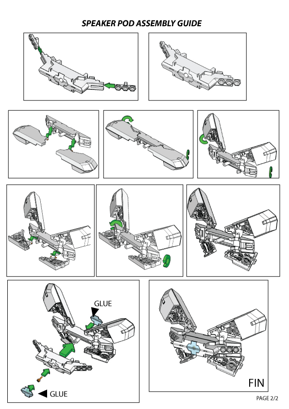

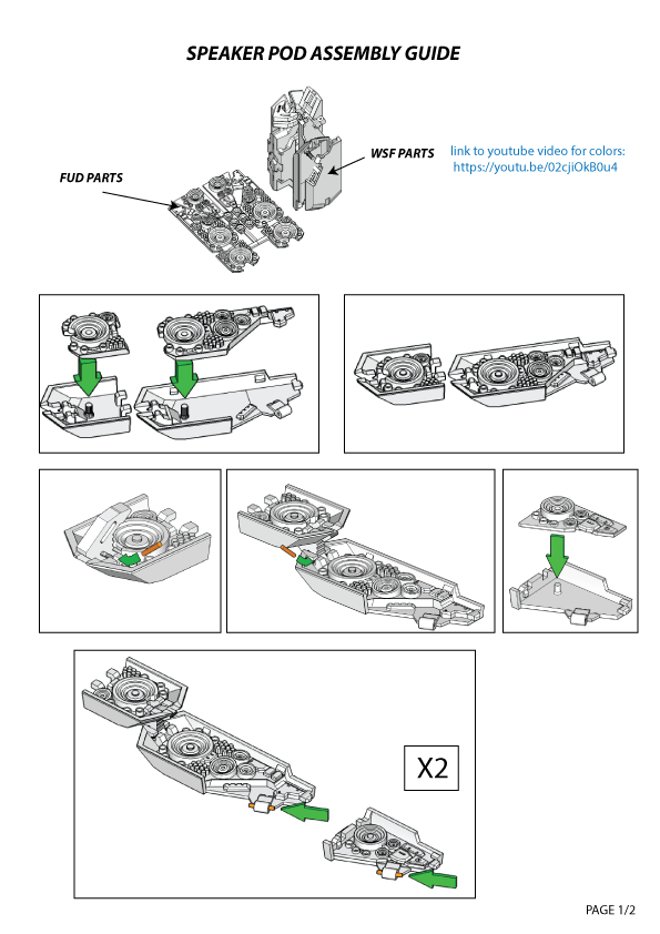

Xigfrid Posted January 30, 2018 Posted January 30, 2018 (edited) Added the Speaker Pod assembly guide Edited January 30, 2018 by Xigfrid

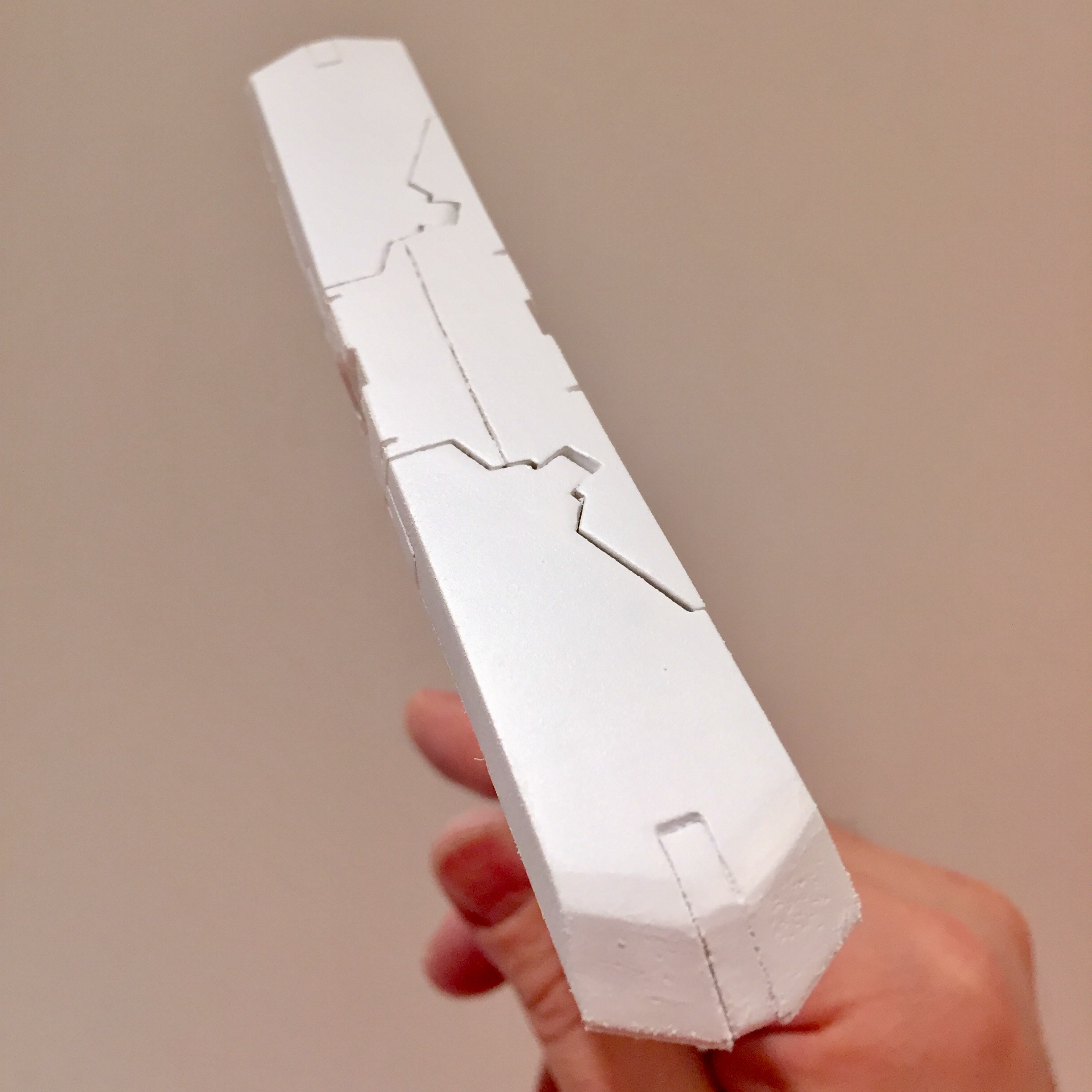

kajnrig Posted February 23, 2018 Posted February 23, 2018 @Sanity is Optional I placed an order for the missile rack earlier today. Shapeways informed me that the shell parts can't be printed as is. Is it a material thing? Maybe I'll try in FUD instead of WSF?
Sanity is Optional Posted February 24, 2018 Author Posted February 24, 2018 1 hour ago, kajnrig said: @Sanity is Optional I placed an order for the missile rack earlier today. Shapeways informed me that the shell parts can't be printed as is. Is it a material thing? Maybe I'll try in FUD instead of WSF? Yeah, I got an email about it. The issue is the front (sharp) end of the two shell pieces. I can either bulk it up, and you'll have to shave it sharp, or you can print in FUD/FED. I personally printed mine in FED, since there's some detail I added to the body, and the cost of FUD vs FED is pretty close.

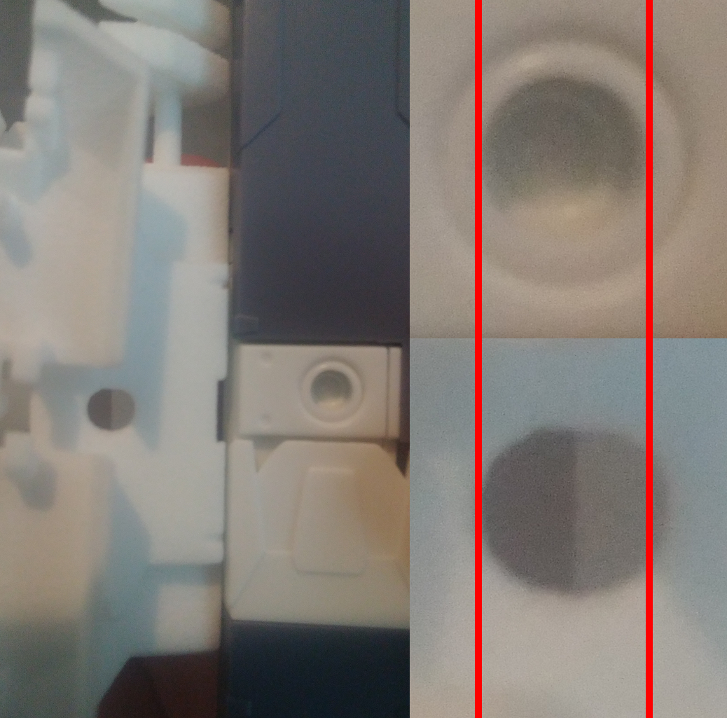

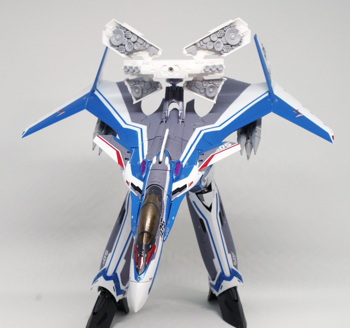

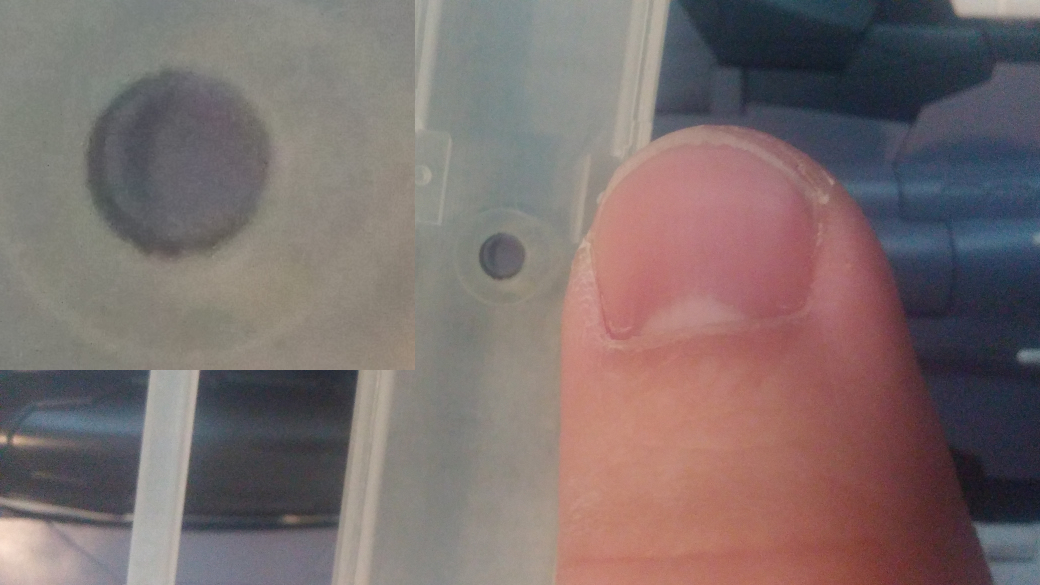

kajnrig Posted March 5, 2018 Posted March 5, 2018 Got my alt pods in the mail today. @Sanity is Optional, you weren't kidding about the fine details on the shell pieces! I'm glad that snafu with them happened that forced me to go with FUD. A head's up for modelers: Both @Sanity is Optional's missile pod and @Xigfrid's speaker pod have holes designed to accept the pegs on the 1/60 DXes' central rotating platform. I think the 3D models were just shrunk down and said hole not redesigned to fit the 1/72 Bandai kits' pegs. If this is the case, you'll probably have to drill the proper size hole for the 1/72 peg. I'd tell you what the correct size is and whether things fit, but I don't have a Bandai kit on me. If I get one in the near future (preferably if Bandai announces an E or A variant), I'll see what the fit is like and get back to you all. On the Hasegawa kit, the default charging pod doesn't actually peg into the central platform at all. Instead it just slides in from the rear of the fighter, with small tabs on either side of the pod that fit into matching slots on the insides of the legs. In order to mod these pods to fit on the Hasegawa kits, you'll either have to add those same tabs to the pod or, probably the simpler route, cut off the slots on the legs and glue the pod into place. Anyway, thanks again for the amazing work you two did.
Sanity is Optional Posted March 5, 2018 Author Posted March 5, 2018 Glad you like it. You are correct that the mounting hole is just a downscaled 1/60 size. Looking forward to the finished product. I'm going to try and get the 1/60 scale mounted up on sprues this week, and start on a clip to mount the gun to the wing hardpoints (on the 1/60).
kajnrig Posted March 6, 2018 Posted March 6, 2018 Turns out I do have a Bandai VF-31F. Huh. Anyway, I took a couple pics illustrating fit issues. As I suspected, the hole in the pod is slightly too big for the 3mm peg. Easy enough to fix with tape, glue, etc. Apologies for the phone camera as always. The speaker pod:
Xigfrid Posted March 7, 2018 Posted March 7, 2018 I doubled checked my model and the hole was 3.4mm, that's a perfect match with your phone pictures so I reduced the hole down to 3mm. Sorry for the inconvenience
