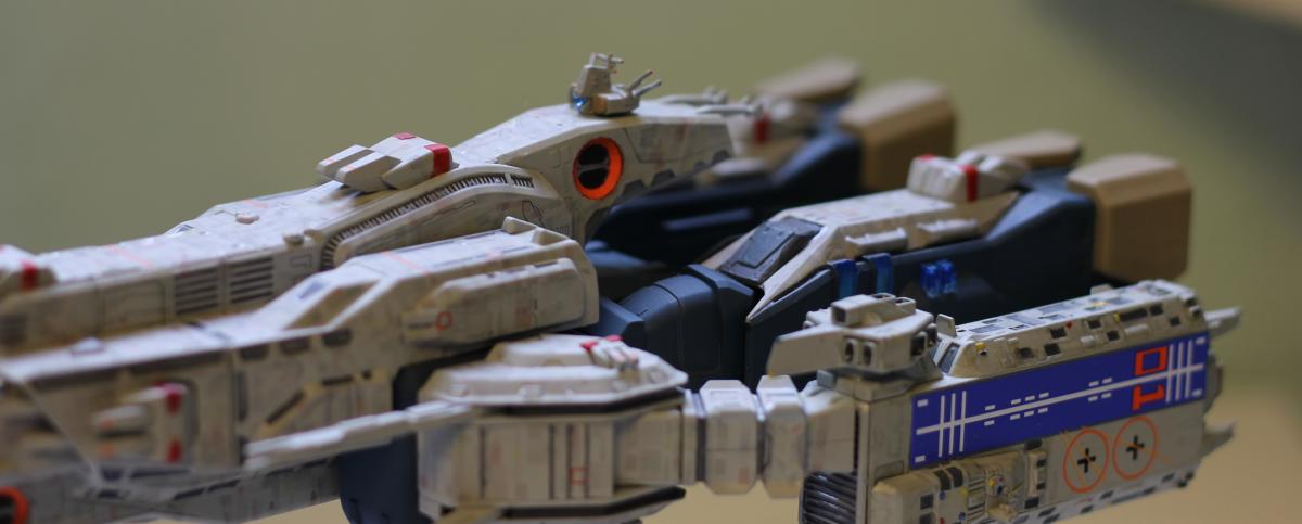

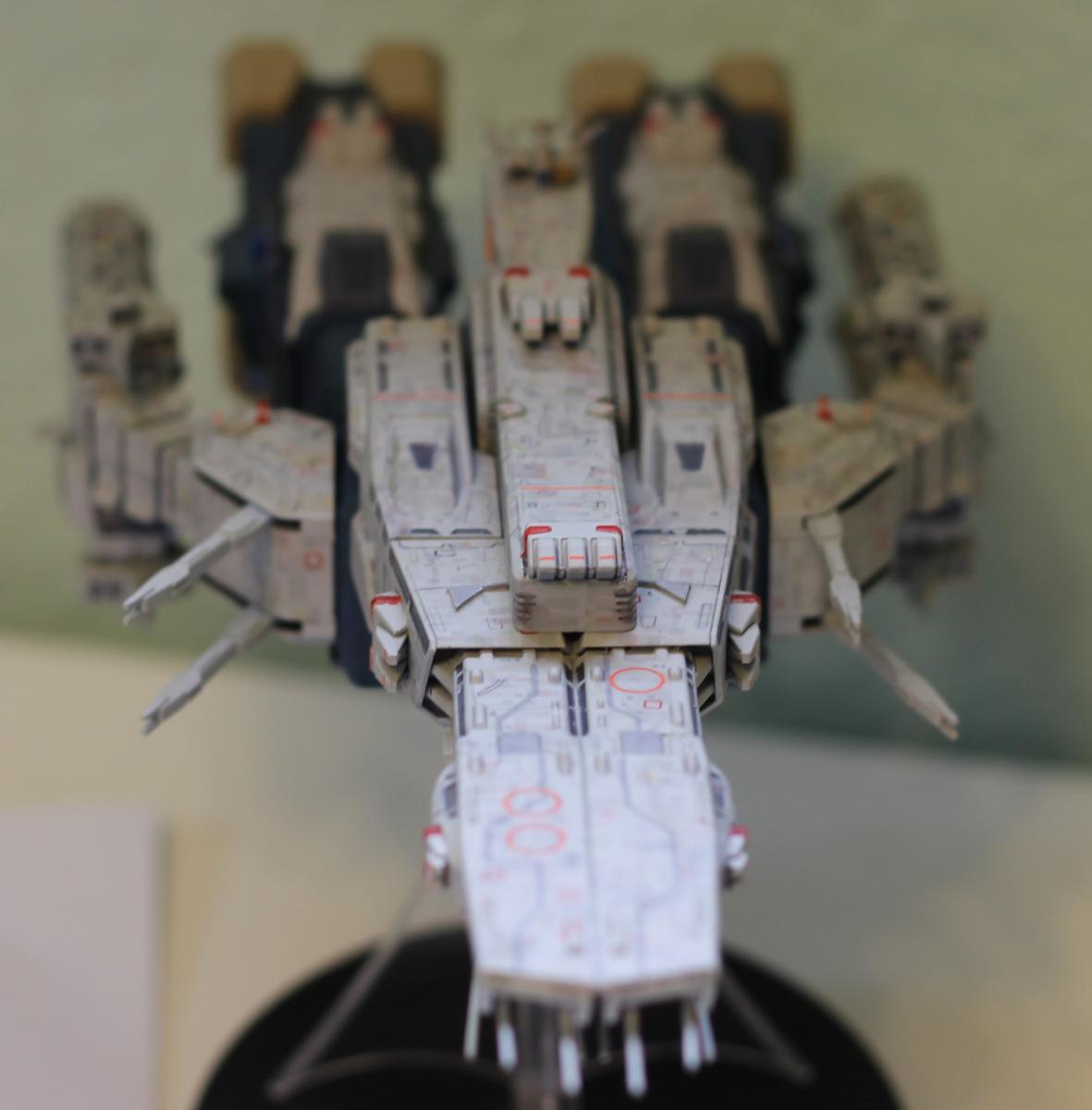

Surcina Posted July 12, 2015 Posted July 12, 2015 A long time lurker here with an attempt on this kit. I had some parts left over but she seems to be all there. Not going to try to do the Monsters though. My hands shake too much.

Zinjo Posted July 14, 2015 Posted July 14, 2015 A long time lurker here with an attempt on this kit. I had some parts left over but she seems to be all there. Not going to try to do the Monsters though. My hands shake too much.Bow-Upper.jpgSDF-1 Port.jpg Love the paint detail, you must upload a zip of hires shots of this beauty!

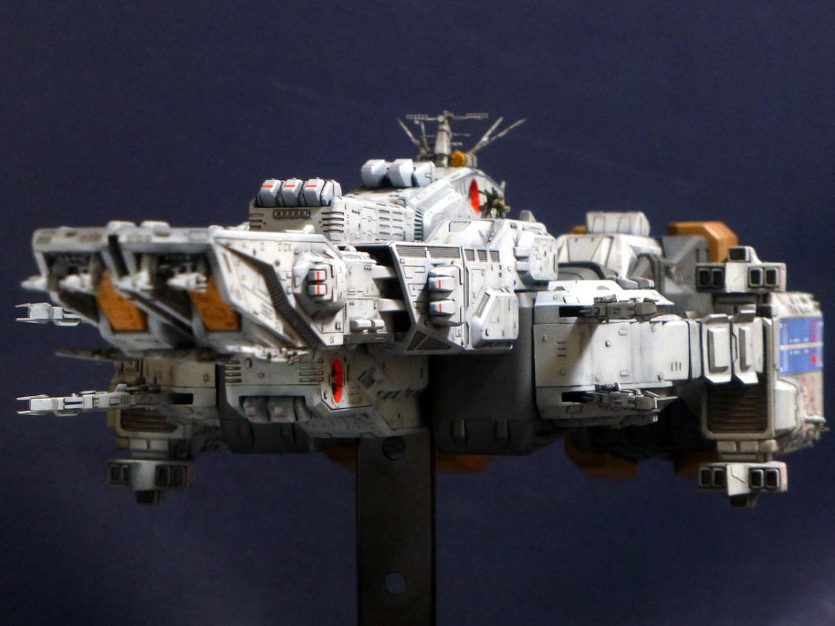

electric indigo Posted January 8, 2016 Posted January 8, 2016 Awesome shot of Dorobou's SDF-1 http://dorobou.blog.so-net.ne.jp/

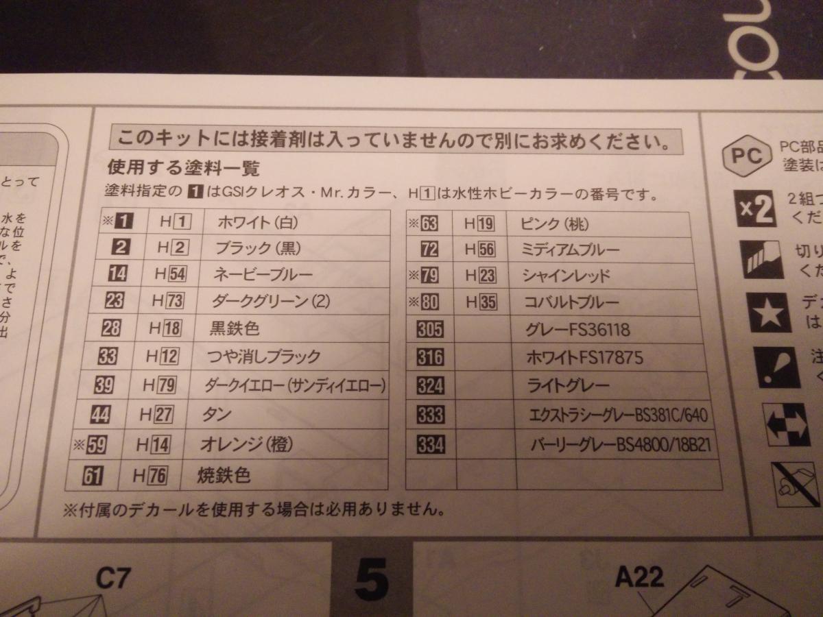

Aradiel Posted March 1, 2016 Posted March 1, 2016 I got this kit as a house-warming present from me, to me, and decided to crack it open tonight.I didn't get very far. In fact I got to the point HannouHeiki was asking about on page 6, realising that I'd need to paint this. I know that the colour scheme is entirely my choice, but I'd like to try and stick to the official one as much as possible. That being said, I don't know what it is. I think this is a list of the colours, but can anyone please tell me what they are in English? I googled around for an English translation on the instructions, which is what lead me here.
VF-1A Grunt Posted March 1, 2016 Posted March 1, 2016 Aradiel, those numbers in the black boxes all refer to Mr. Hobby / Mr. Color brand paints (the "H" with white boxes are their old number system, I believe). There are several places online that have the Mr. Hobby color charts. Here's one example: https://januaryjulian.wordpress.com/2008/12/20/mr-hobby-mr-color-charts/ The first link on that page is the bottle colors that you should reference. You could either buy the actual paints to match the model instructions or try to match another brand to the color chart. Hope that helps!
Aradiel Posted March 2, 2016 Posted March 2, 2016 Awesome, thanks for the prompt response! I'll use my acrylics, but try to colour match as close as possible (for example XV-88 and Tau Light Ochre look like they might be close to the tan colour) I'm now thinking I'll do a grey base coat to start - if I use white, the darker colours should require more coats? Plus if I'm doing colours that are close to white... it's easy to lose track painting white on white.
joscasle Posted March 2, 2016 Posted March 2, 2016 In fact, the black Boxes are for Mr Color paints and the H and white boxes are for the acrylic line. So you have the 2 options, lacquers and acrylic.
VF-1A Grunt Posted March 2, 2016 Posted March 2, 2016 Thanks for that info! I didn't realize they also offered acrylic paints. I just came across a whole box of their paints that must be 30 years old from my trips to Japan as a teenager. I'm guessing I may be able to salvage the dried up lacquer paints but not the acrylics.
