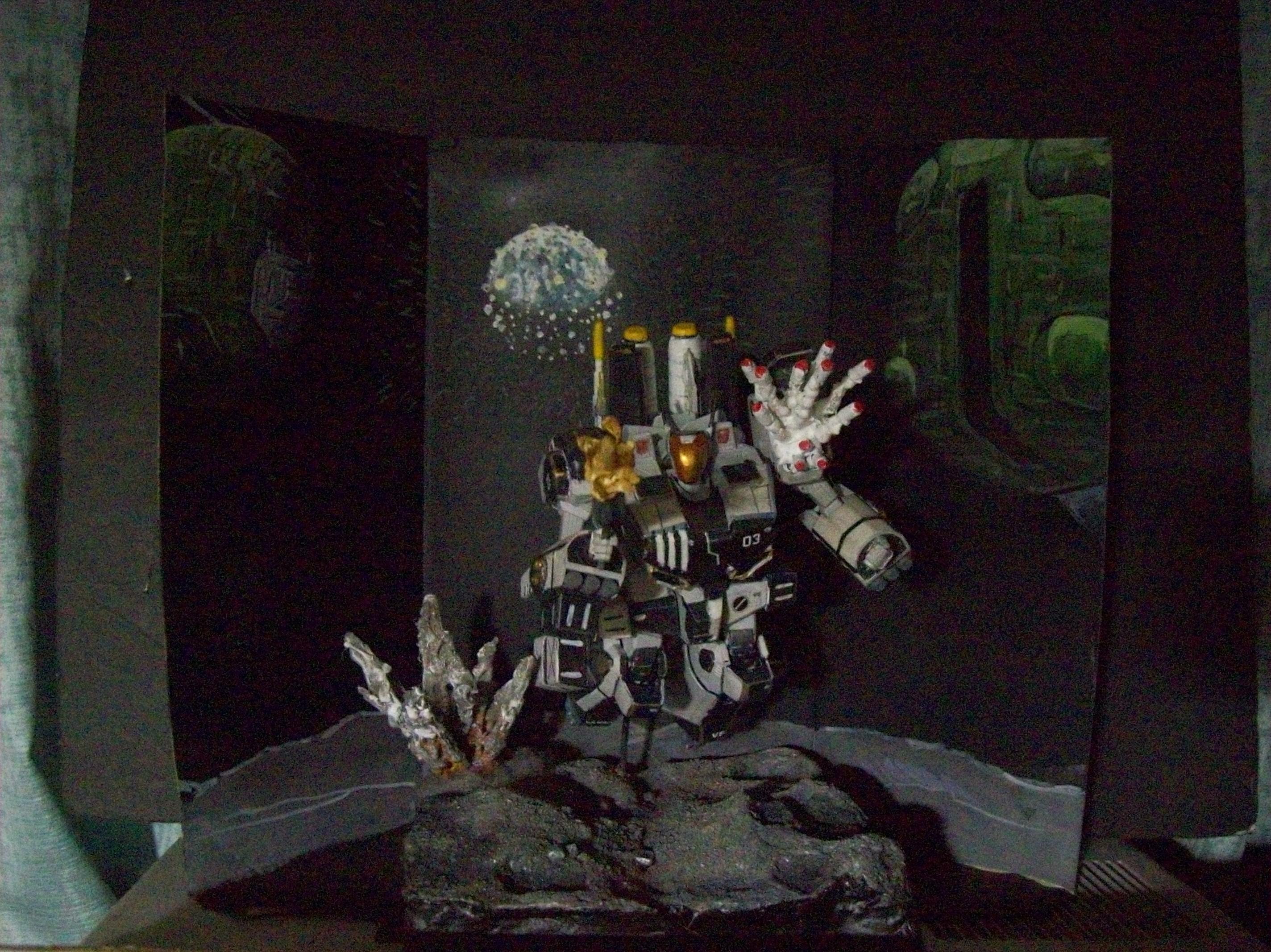

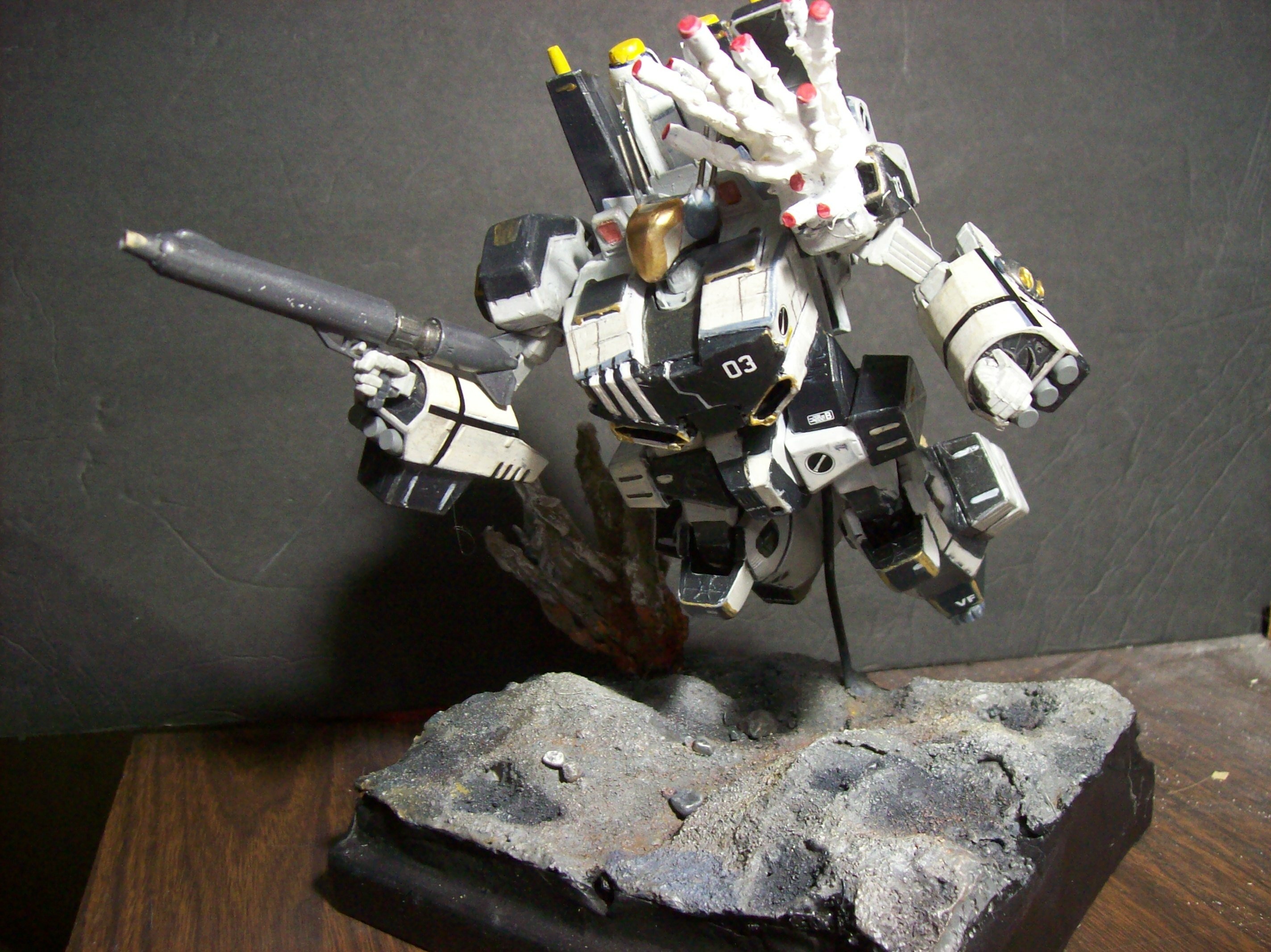

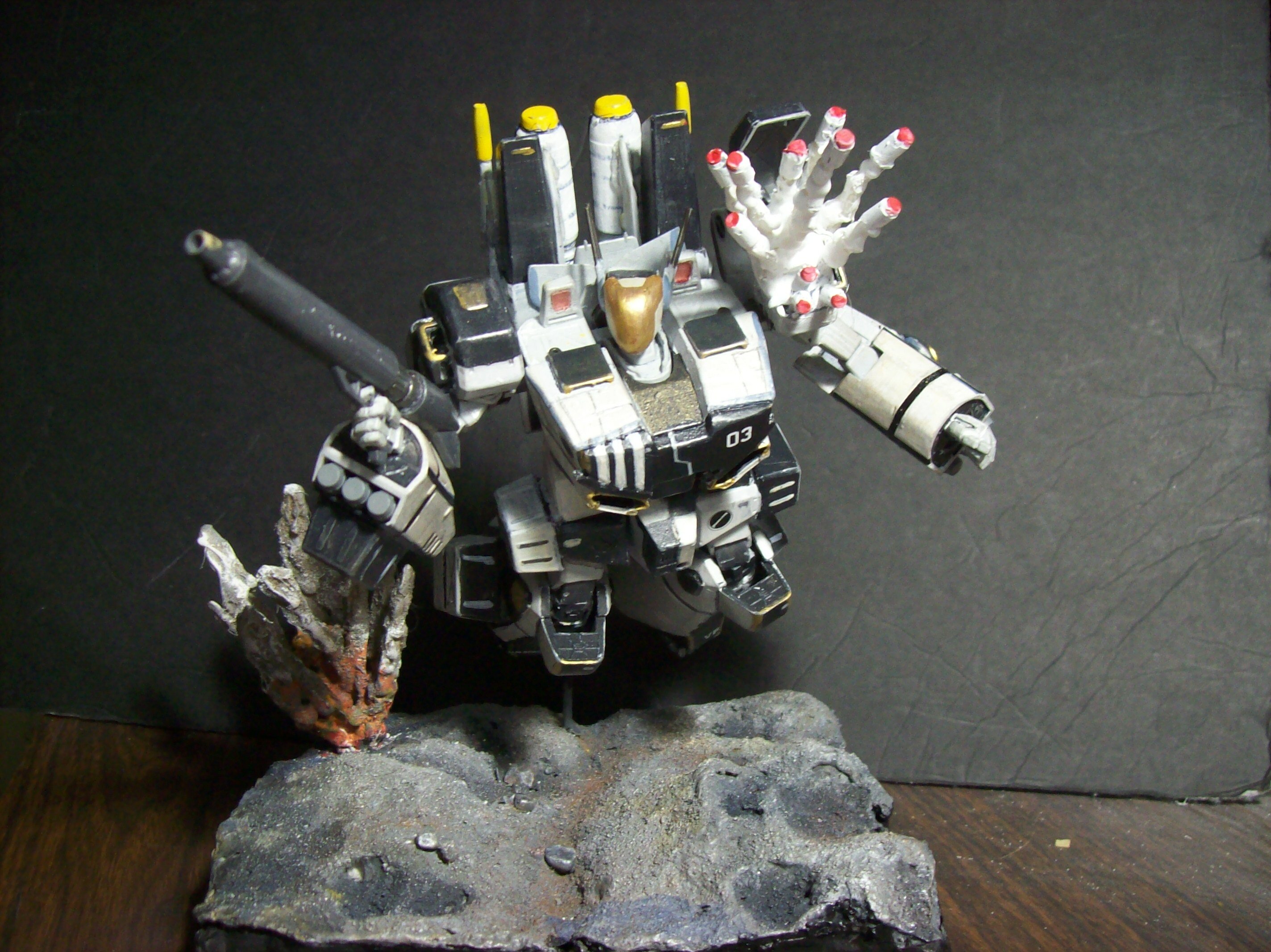

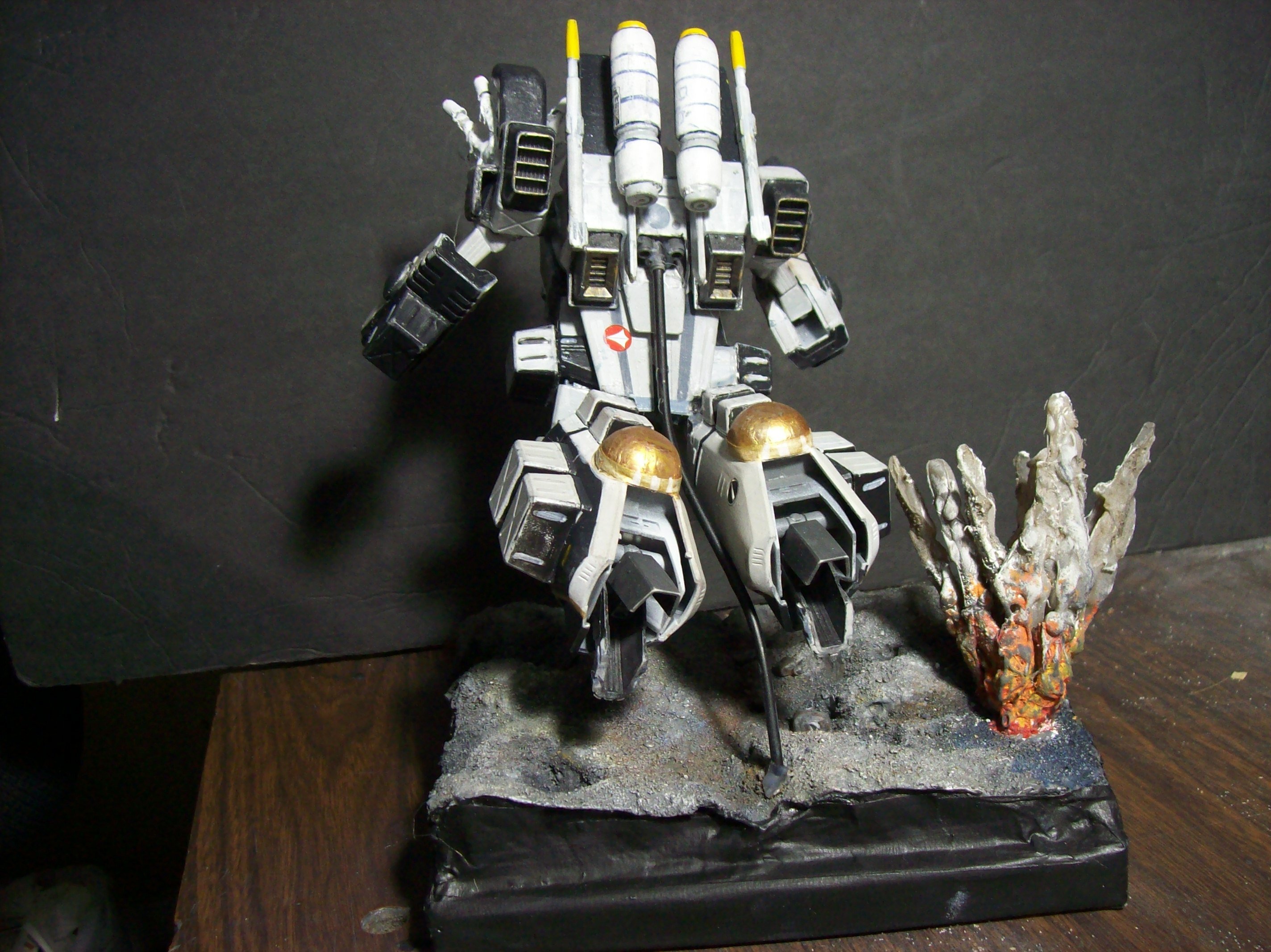

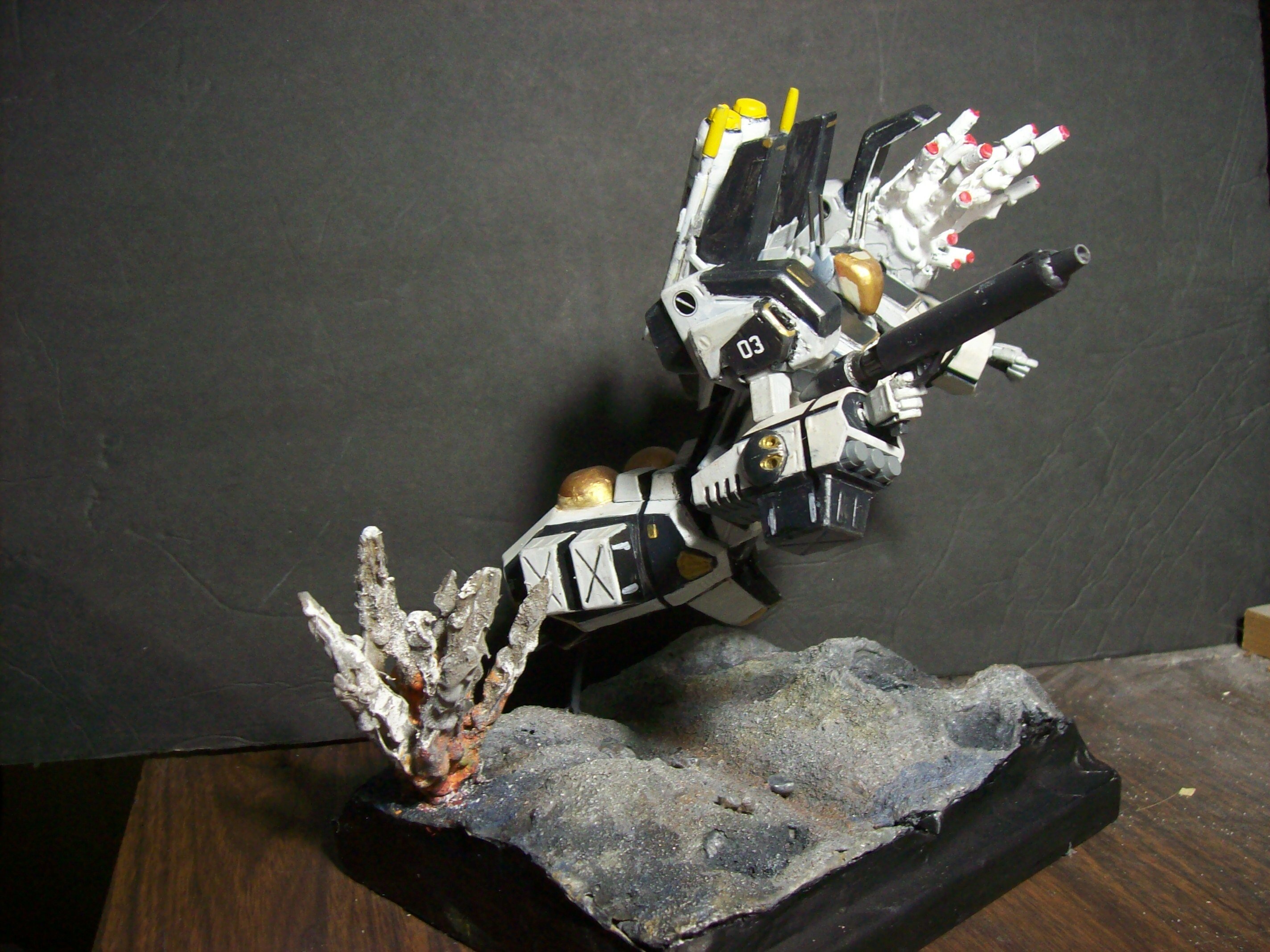

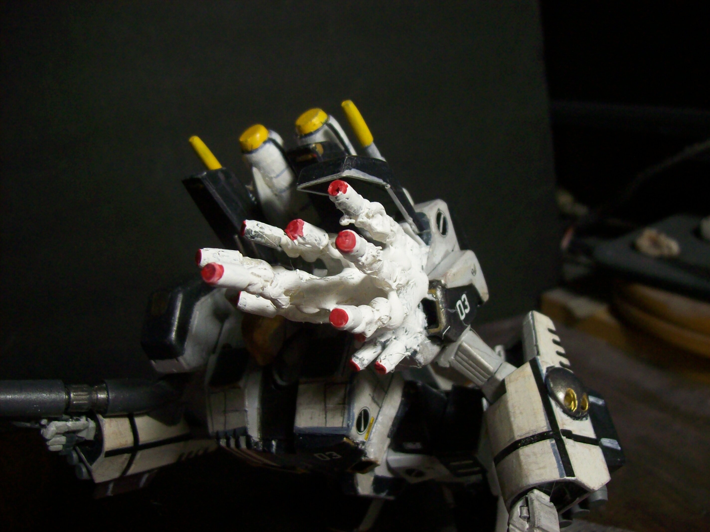

UPDATE: trying for epic level on this one:
101_0441.JPG.27df0e297b59150d29134e2fcd02a874.JPG101_0443.JPG.16dd2adc6c5a0d59bdf45257b5ea85f1.JPG101_0444.JPG.568f434d1d3289a20cb240c8d63c49f4.JPG101_0445.JPG.c5c6823fc1a234146f32ddd39dad2e8f.JPG101_0446.JPG.eb8d8a289fe7e1a1432243082a85003f.JPG101_0447.JPG.ce2393679c9ef08d6538786b37ed9b23.JPG
The explosion on the right side was a little iffy, as it kinda looks like some weird moon rock formation at certain angles. But I wanted more than just a static flight pose; this mech was meant for lunar defense, and that's what I wanted to show here.
Stay tuned... trying to get this one into the "I saw this cool model online" topic...

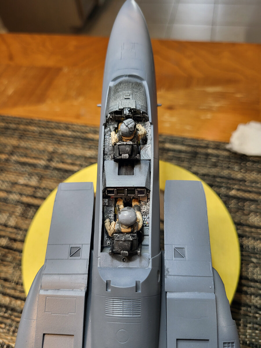

3 hours ago, Thom said:
Real nice work on that cockpit! (He wailed like a baby...)

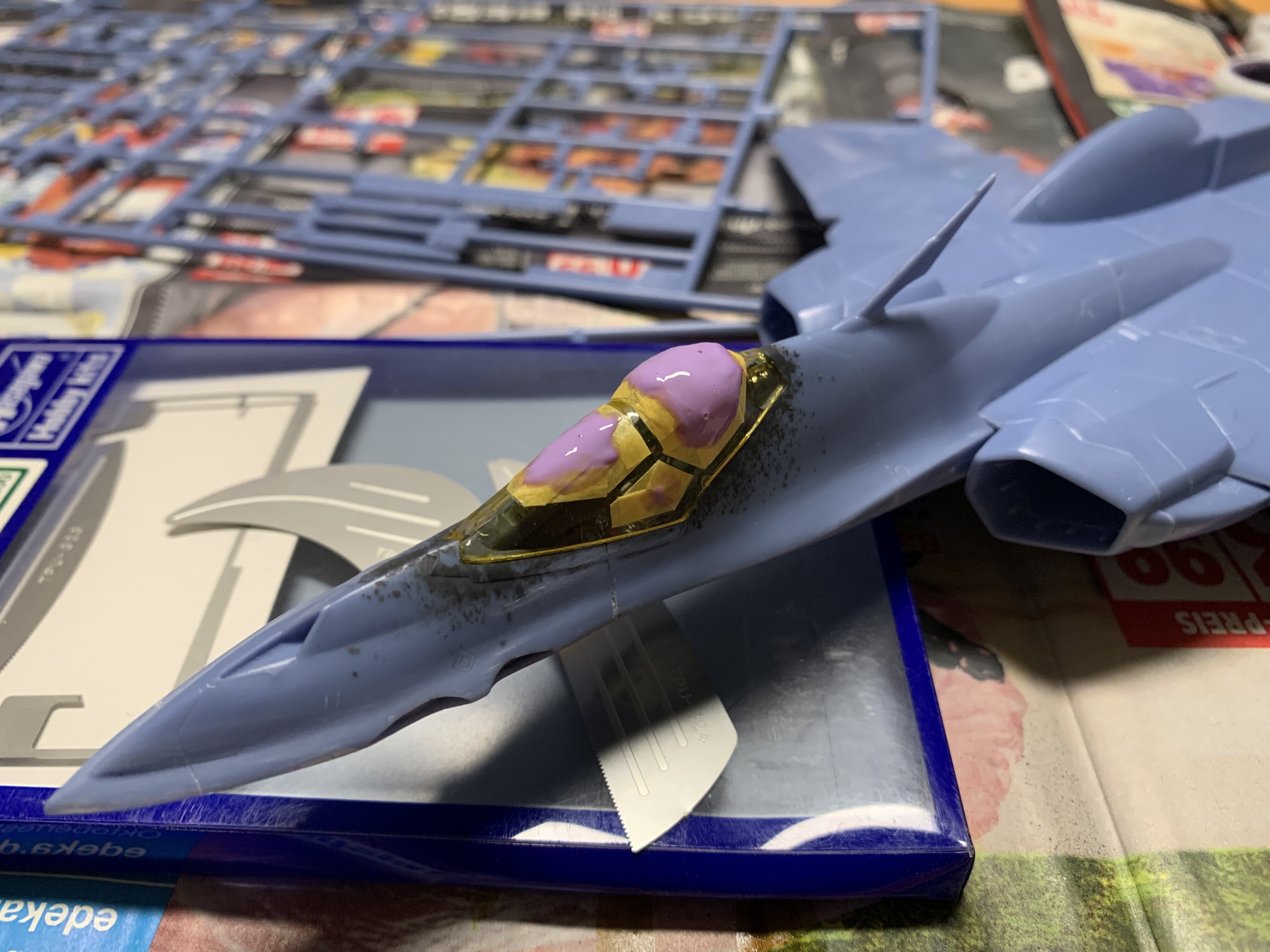

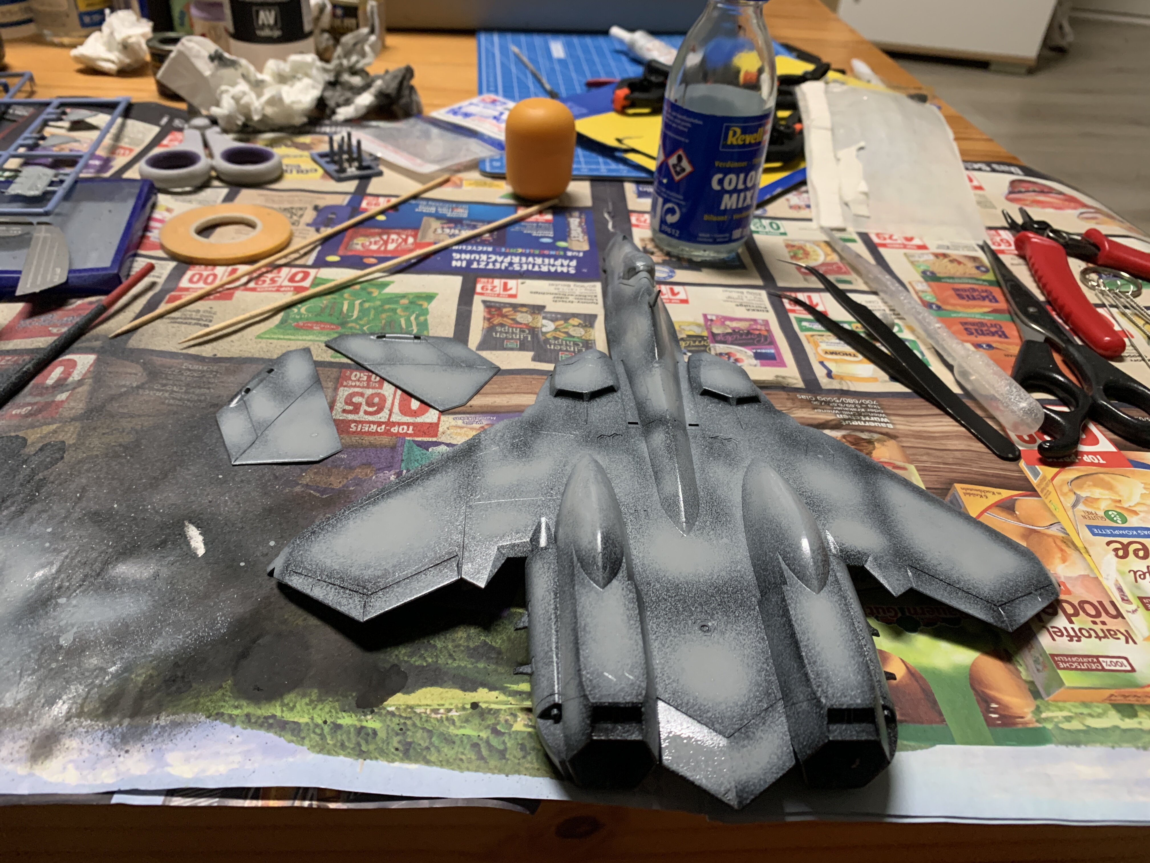

Some work on the VF-22.
canopy masking is fun, especially with canopies this round. Good I got that humbrol liquid mask :)
Prime Time!
some shading (or better, lighting)

Exciting touches for sure. Love the action.

Thanks! Working on more improvements as we speak (gunpod fire, for example); hoping to refine this even more!

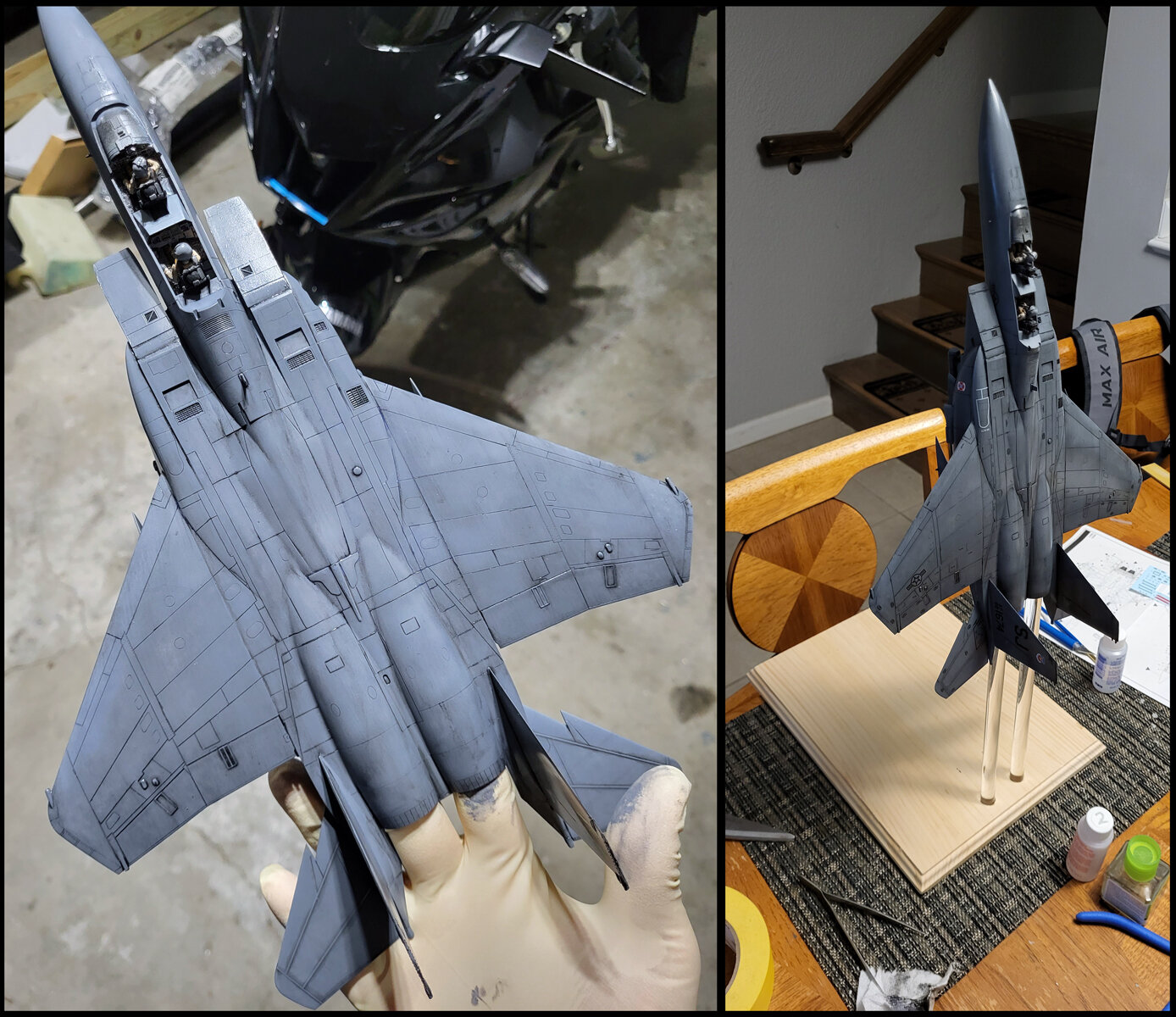

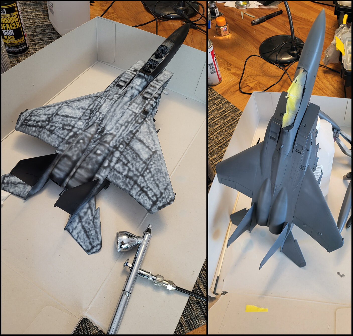

Hope everyone is having a restful holiday. Just got rid of the family and got a good amount of work in.
Using AK's Medium Gunship Grey and their F15 Grey. The F15 grey has a warmer tone while the GGG has a more teal look to the color. I'm not to happy but, kind of expected the result. The grey just hides me pre-work all to well which is why I went for such a high contrast base effect. Hope the darker post work and washes get it where I want it. Live and learn.

Wow...that just reeks about the paint covering your pre-shading! One possibility could be to take a rag dampened slightly with thinner (or 91% isopropyl alcohol) and gently wiping it across the surface to take a little of the coverage away. I've done that with a few models in the past, with more or less successful results.
This one seems to be intent on giving you grief; I'm hoping you can make it shine!

Close. Thinner is a bit hard to control IMO. It doesn't take much for a wet spot to ruin your streaking. I'll let it be for now until washes are complete. If need be I'll try doing similar to your technique but using sandpaper. Lightly wet sanding away the gray with 600-800g. That should be easier to control and do without the risk. It may not even need it. Just important to keep going and learn from it as the amount of aircraft I enjoy in black and dark grey schemes is too damn many! lol

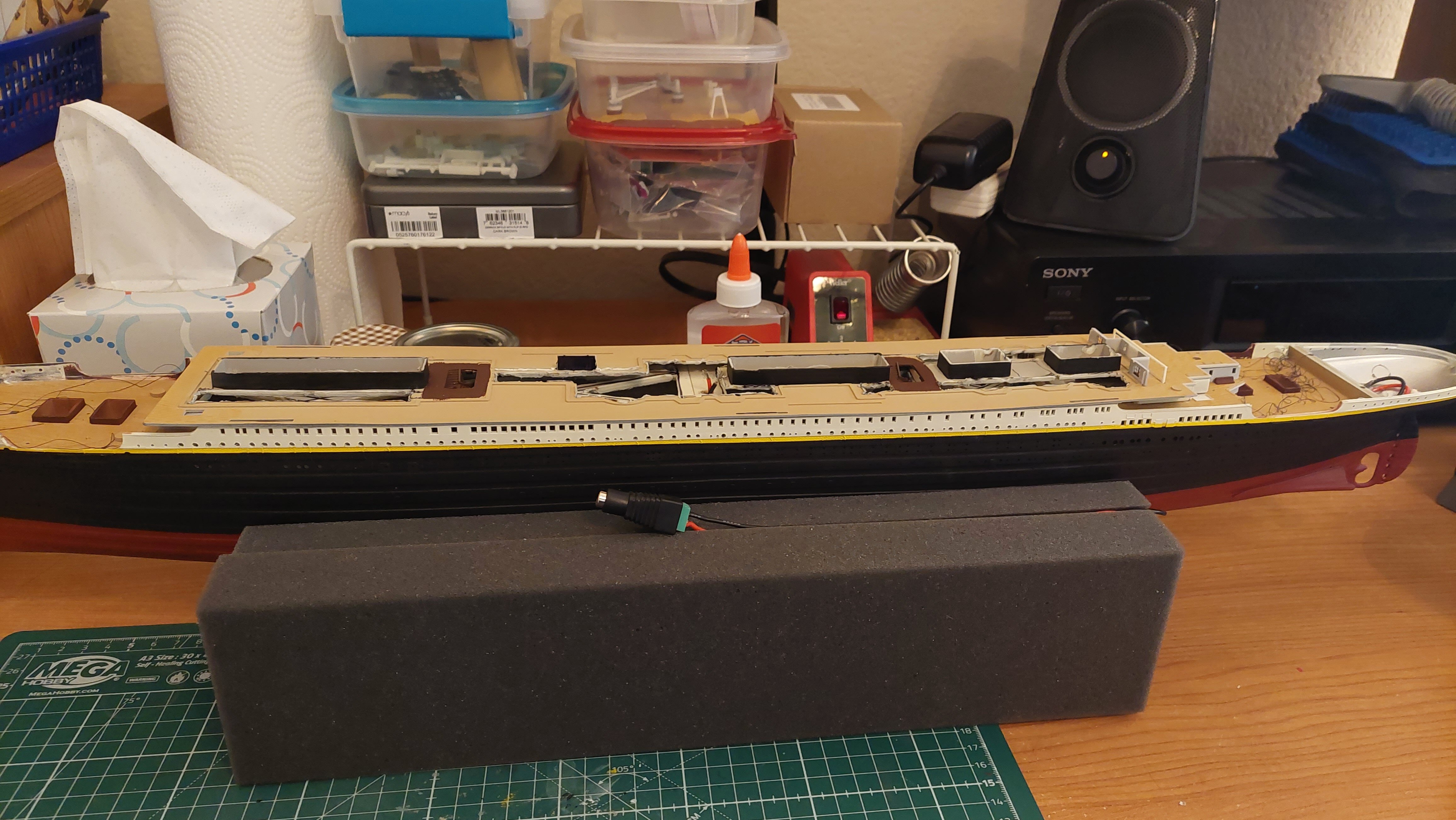

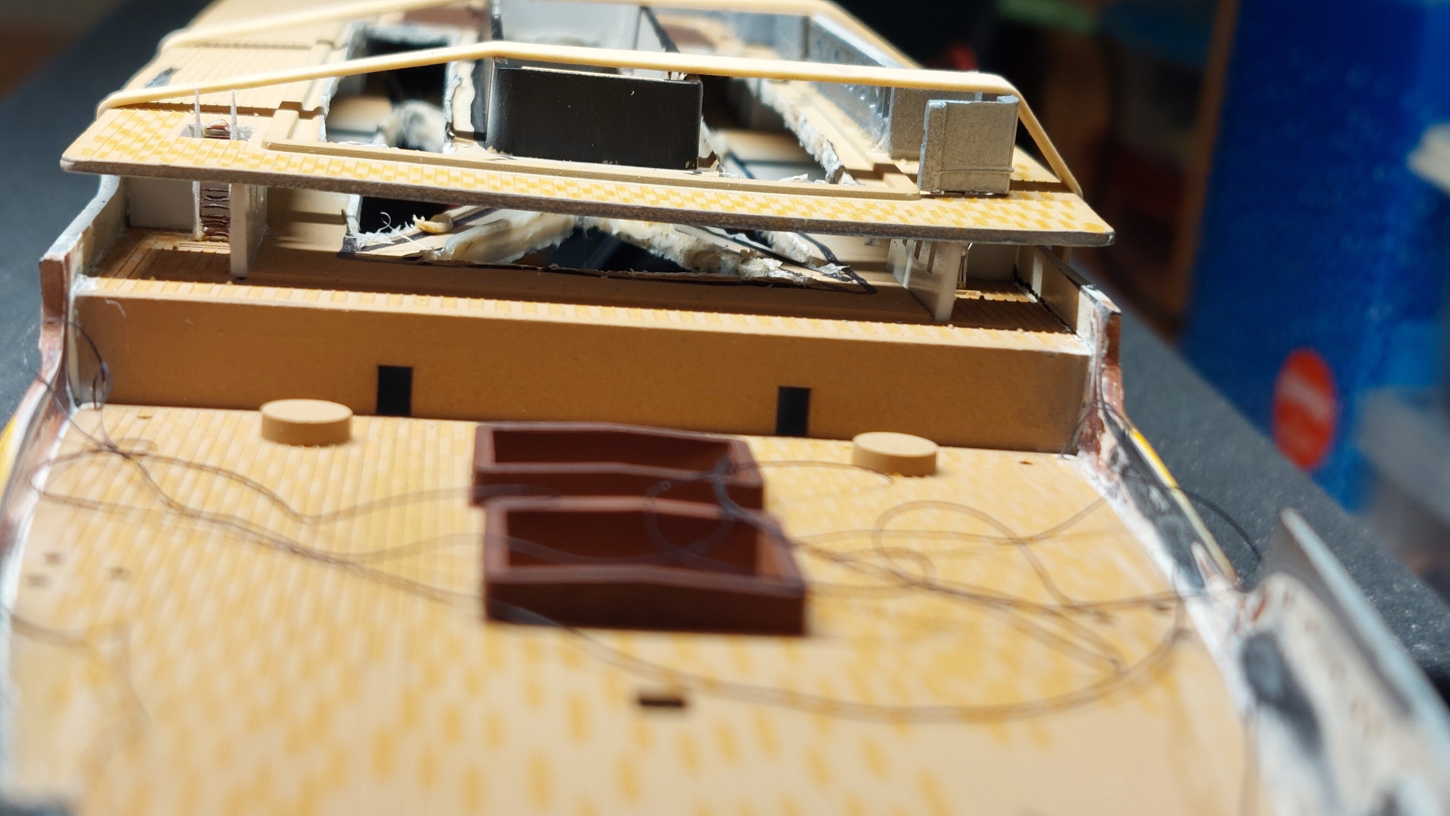

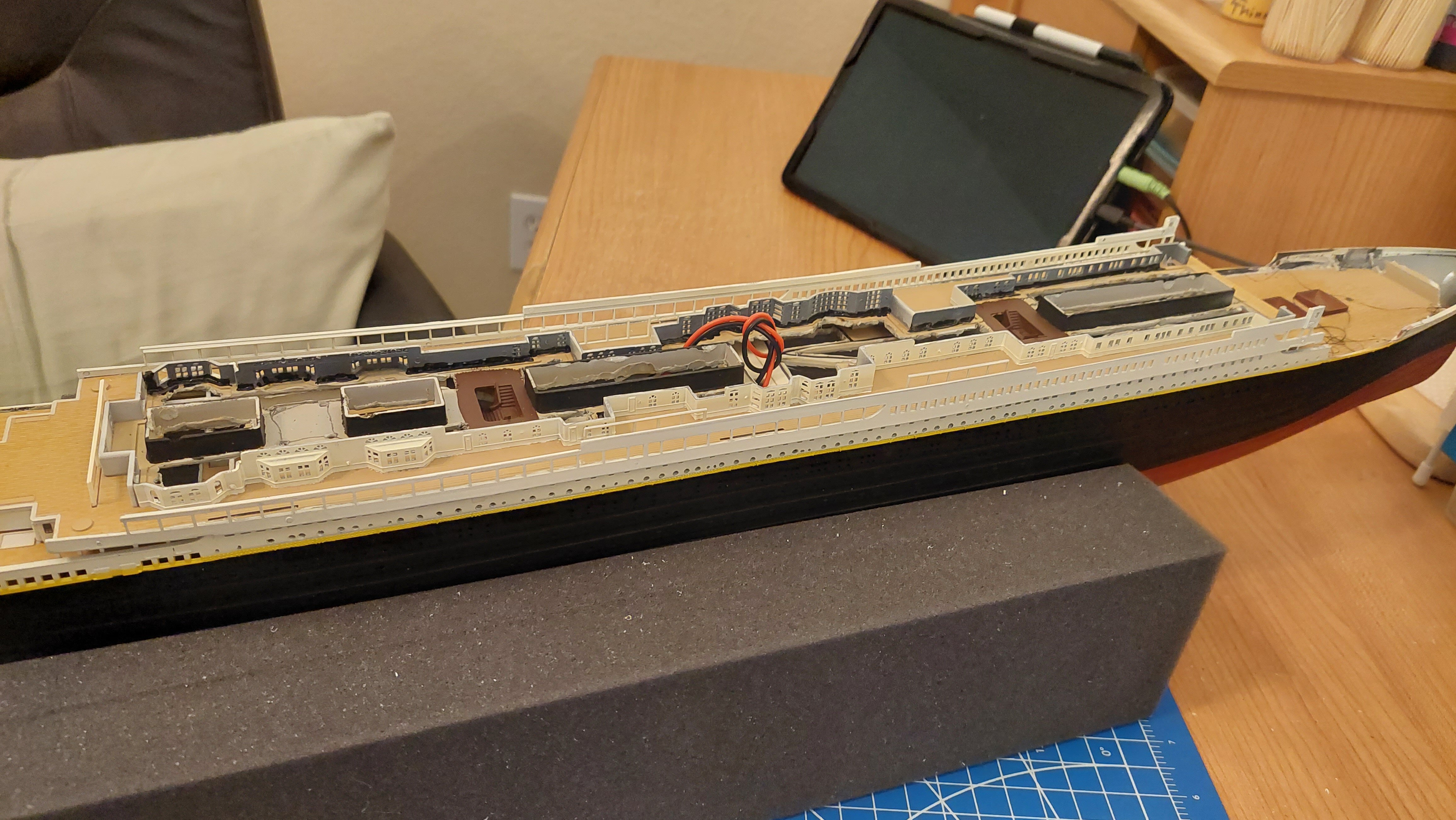

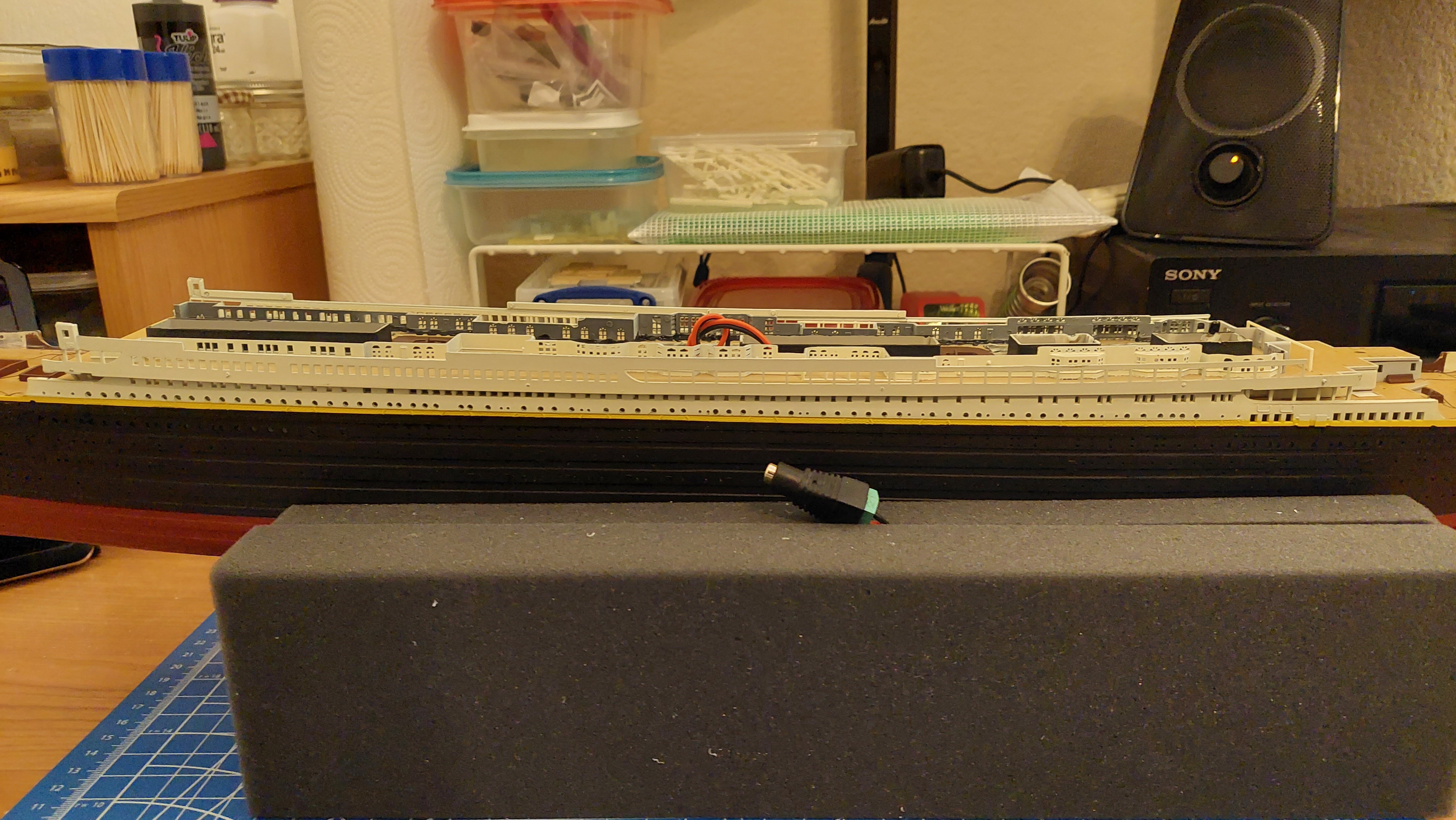

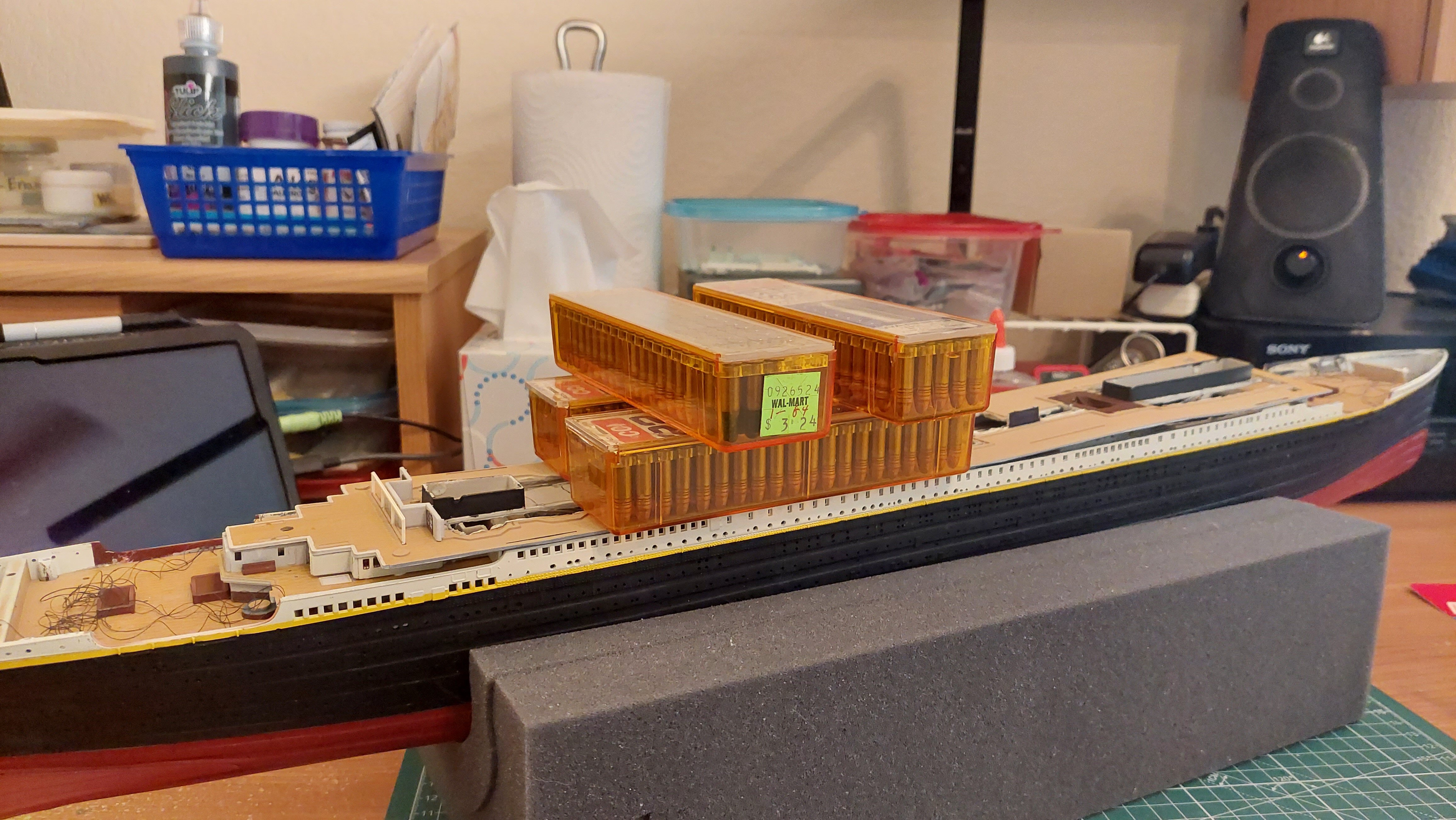

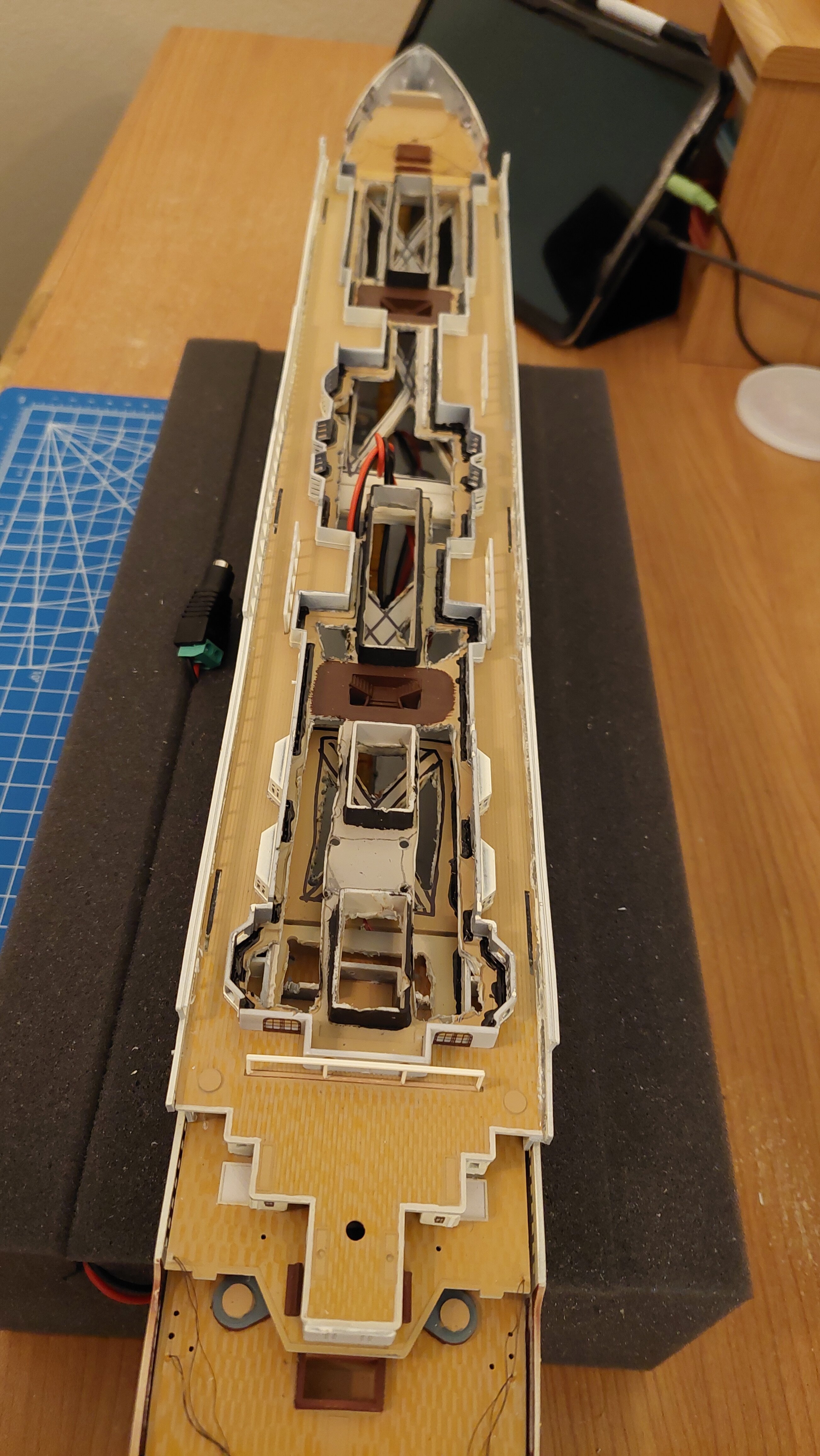

The Titanic and I HAVEN'T gone down with the ship!! LOL..May has been just the very definition of insane with work and home life. Anywhooo...I have some cool WINS to report...1st off.. the 1st warped POS deck is DOWN and almost completely flat (only it's really slightly curved as the ship is actually curved from bow to stern) I weighted each section down as I went with some of granddads old 22 ammo boxes and just worked my way along the length of the ship with CA glue. It's on so whatever, few spots to putty up but not tooo bad all things considered!  Today I got the 1st side wall of the prominade deck on and used big fat rubber bands and did the same method of working my way down the ship length wise. I also had my 1st encounter with a photoetch stair case!  FUN! ... or not in 1/350 scale, however you wanna look at it. Bending the rails, no problem, easy with my PE bending tool, bending the steps at this scale???...yeeeeh...Whatever, the 1st two are painted and installed. Tomorrow I'm going for the other prominade side wall!  Stay tuned!

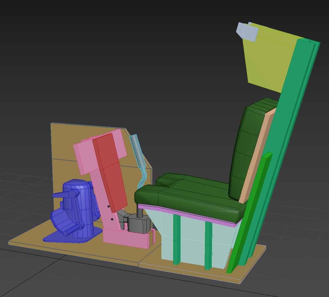

Does it count as lying on your workbench if what you're building is essentially.. a bench? :lol:
I'm finally taking the dive into building a simulator cockpit for DCS, and planning out the wood I'll need to buy to build the seat.  Figure that's a good starting point, since there are no electronics involved, and I can get my head around the types of wood I'll be using for the rest.
Going to be a big project and take a ton of space, but I'm trying to keep it modular.  The whole thing is going to be roughly 4'x5', and I'm going to be spending some time clearing space in the corner of my office.  Just hoping I can run all the necessary cables across to the PC so I don't need to relocate that.

@pengbuzz Your model and diorama are looking great! I LOVE your effects and adding the missiles in there. It has a nice dynamic and dramatic appeal to it!

@Rock It's too bad about your work being covered over. I know that feeling. You can still post shade with grays afterward. The cockpit details are looking good!

@Chronocidal That's cool building a simulator cockpit! Let me know if you have trouble with reference photos. We may have the seat you're building at our local museum. There's a nice collection there. - MT

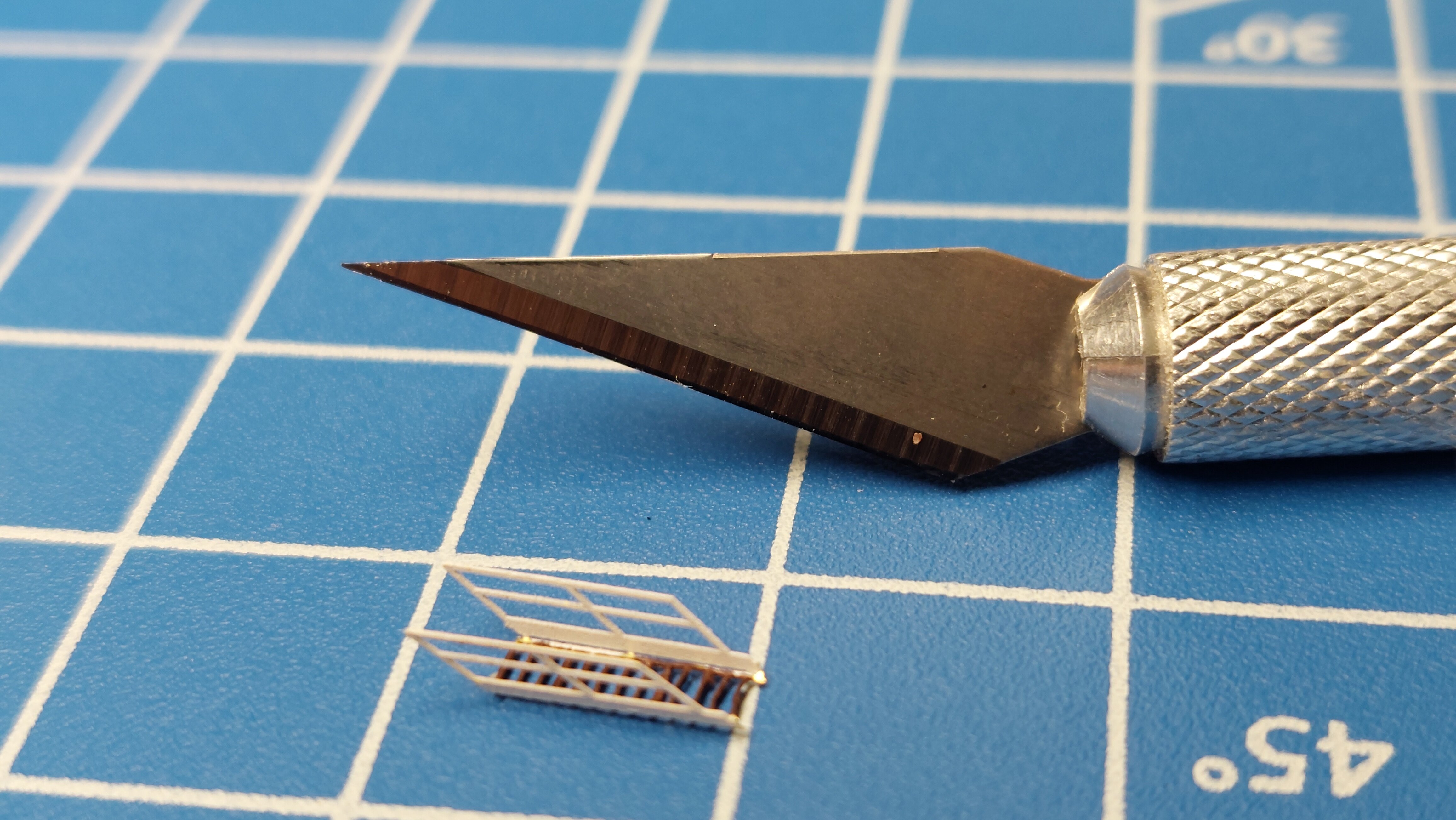

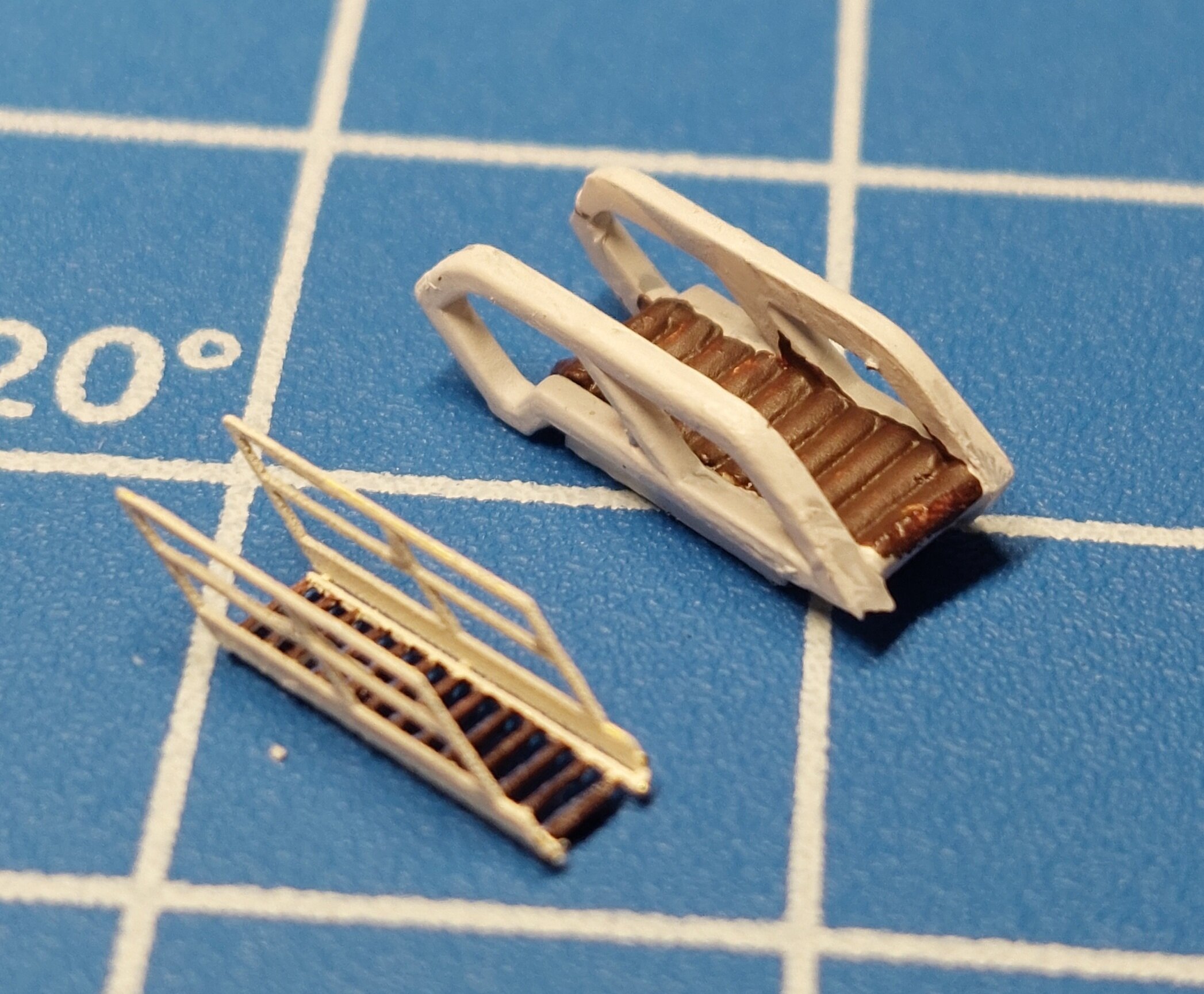

So my 3rd PE staircase came out pretty darn good!  I came up with a better method. However, I have GOT to get some metal primer, the enamel and even Tamiya lacquers just flake right off the brass. I guess that would help??? I primed the PE with normal Tamiya white fine surface primer but same result.   Here's my 3rd PE staircase VS the 70's kit supplied staircase...

The kit staircase looks like it's a part of one of those inflatable bounce houses!  :lol:
Nice job on the PE staircase!
It's not your fault @pengbuzz. Just keep turning and burning, it will all turn out alright. Just about as right as your dio, great work!
@derex3592 Lightly sanding the whole fret may help, letting the paint get something to 'bite' on, as it were. Good looking 'case though. And I agree with Pengbuzz, that is from an inflatable bouncy house!
Also, I recommend acetone to clean the fret and remove any residual oils.

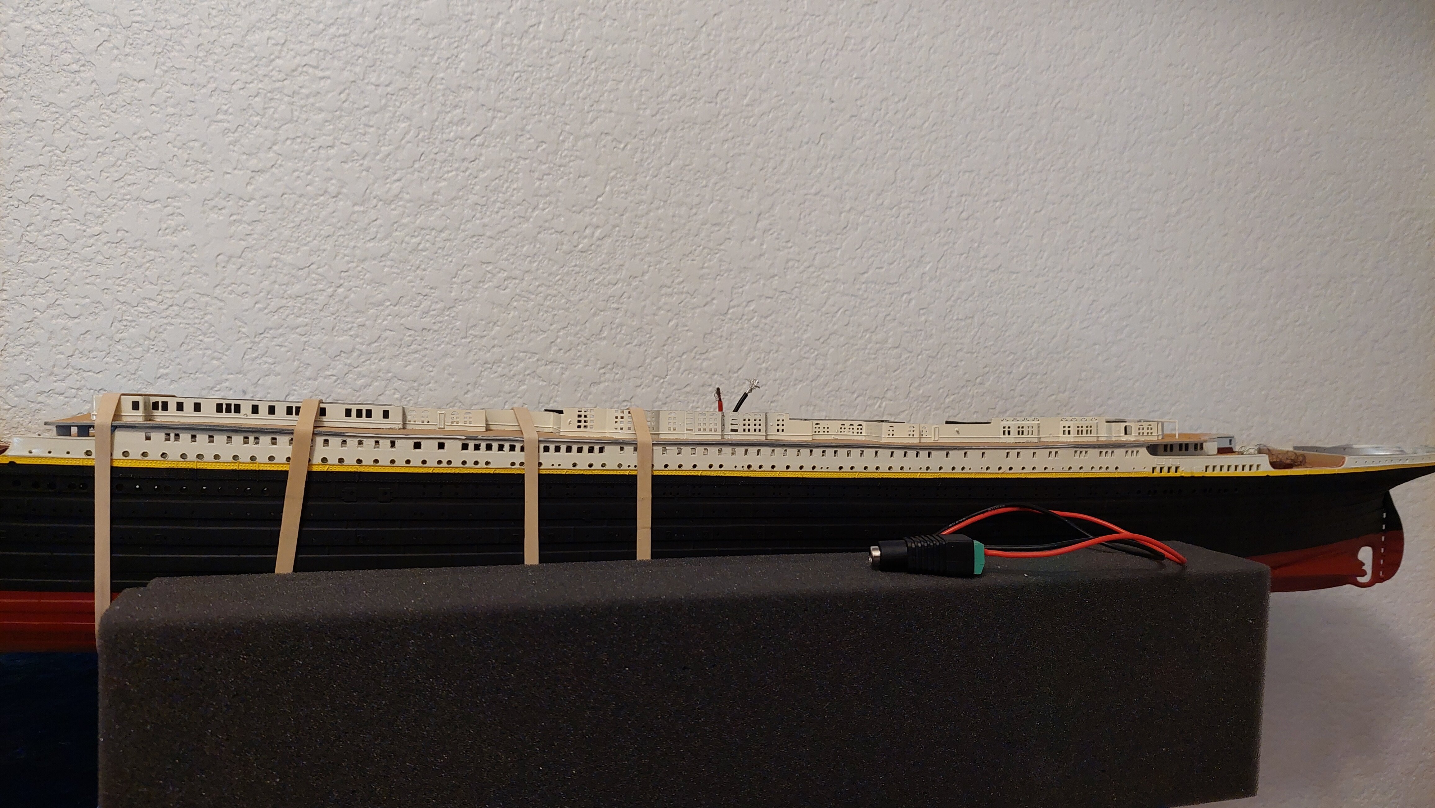

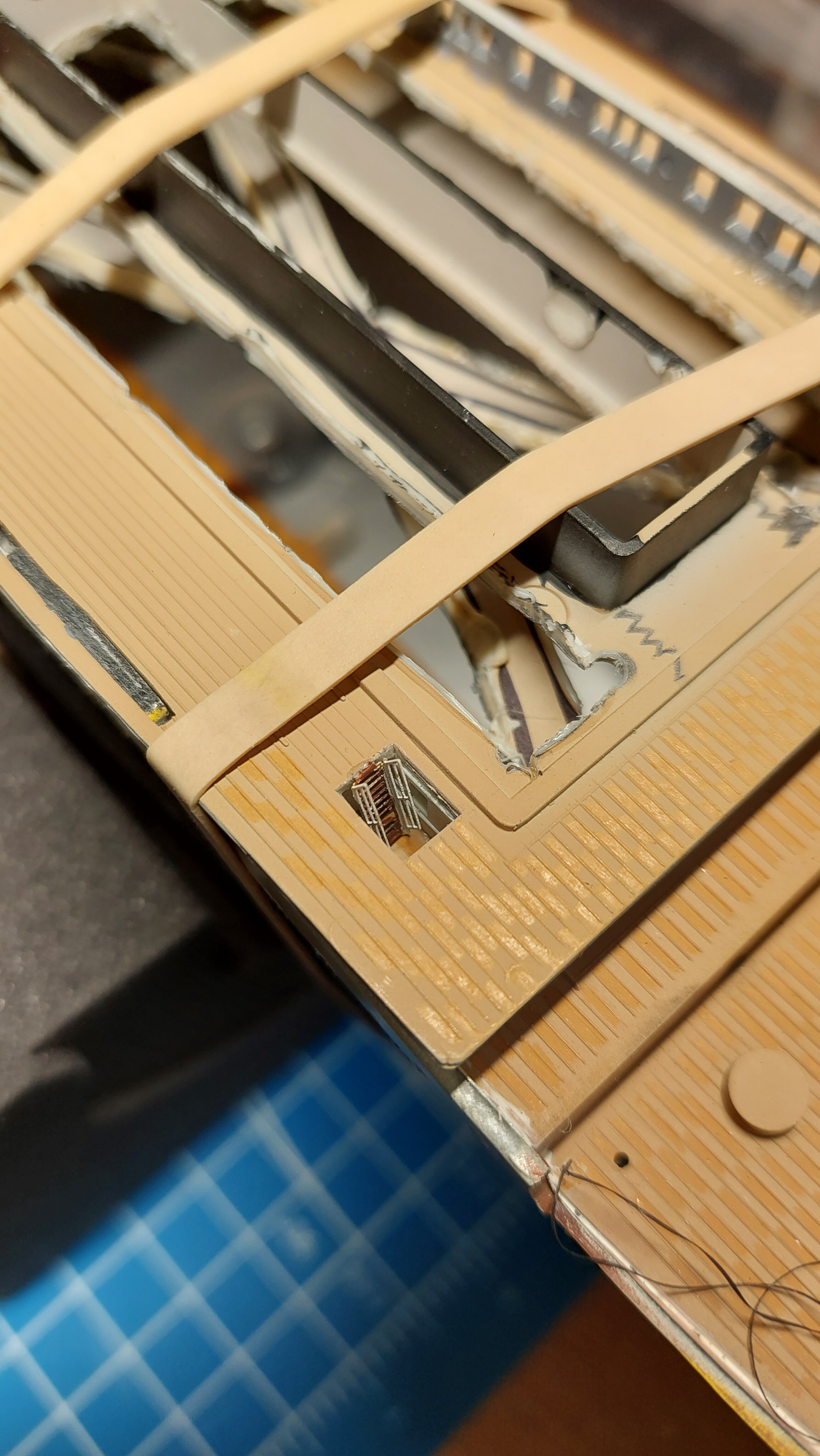

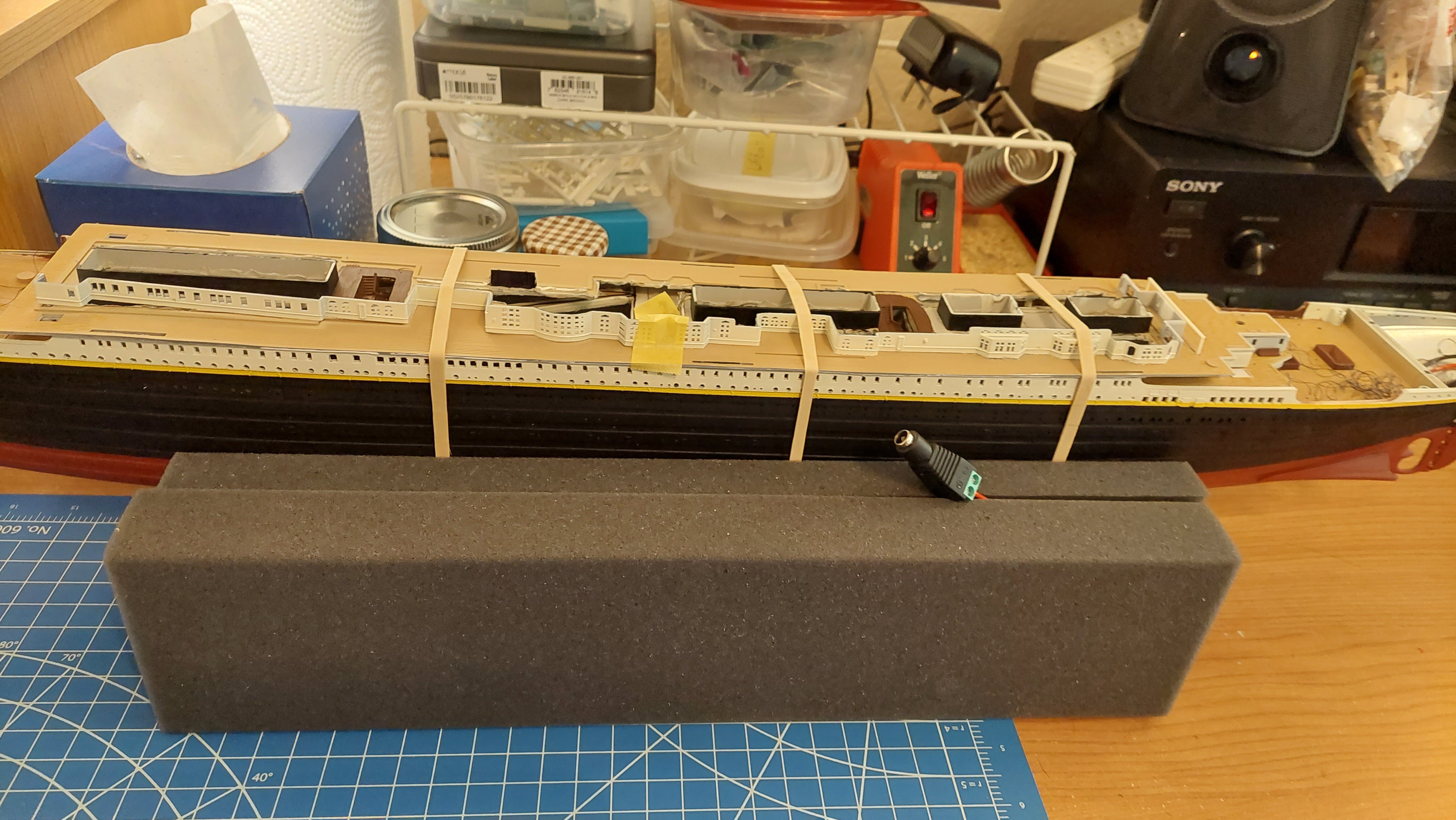

After cleaning up the seam lines along the blisters, I finally got the top deck in place. There's some over spray to clean up from the test paint over the seams, but a little thinner on a Q-tip will clean that up.

Really liking your work on this, Thom! Very clean and an excellent job on filling the seams!

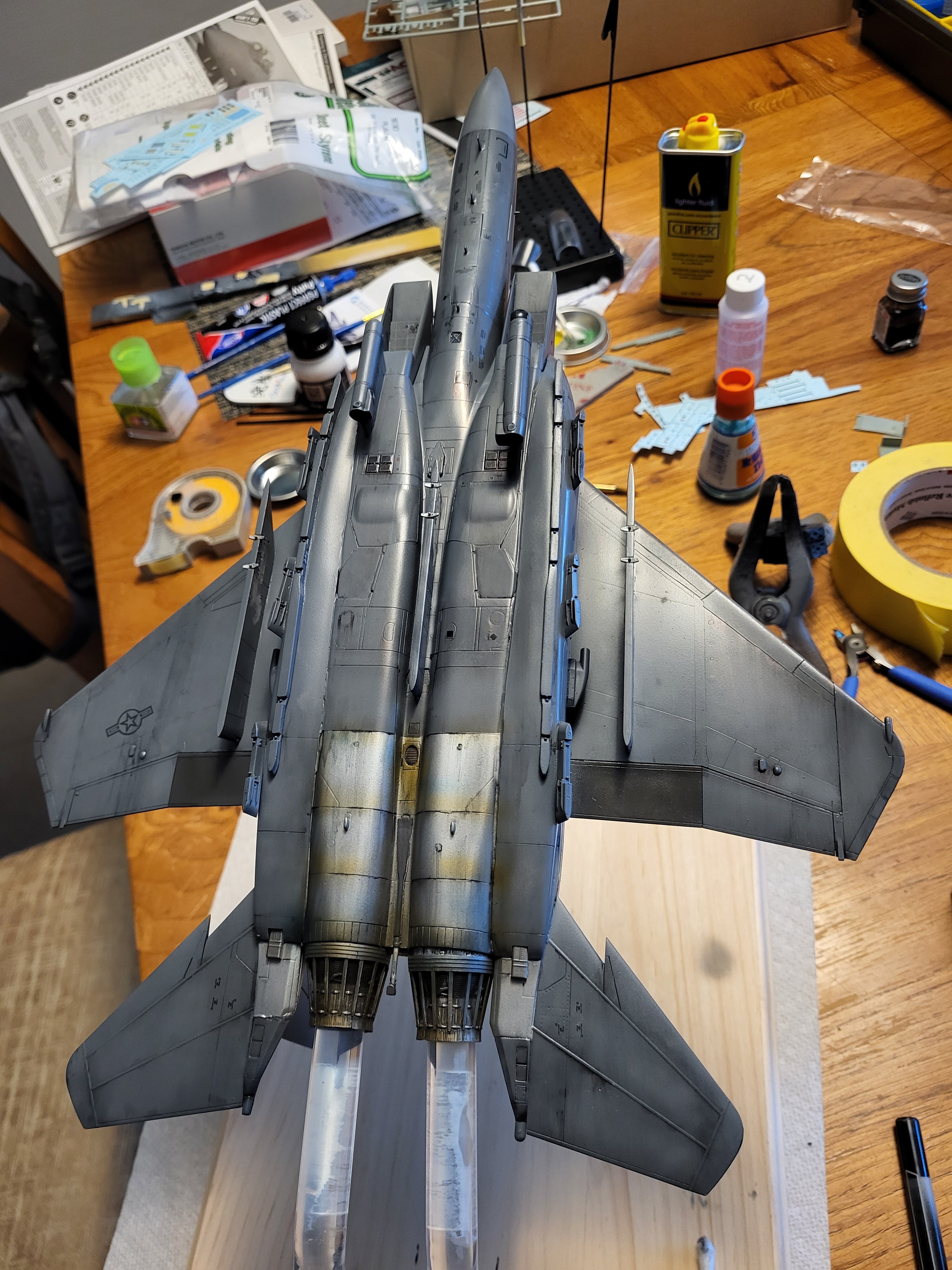

Sanded back with some rescribing to keep some of the detail a little heavier for the next stages following the gunk wash, gloss, decals, gloss, filter and highlight coats. We on the downhill slide boys!

Looking really good for what you had to do at this point! I think you'll pull a showpiece out of this one with some detail work and a bit of post shading. :)

@Rock Your paint looks good, even though you weren't happy with the other coats being hid. One thing, USAF aircraft are kept clean for the most part. Don't get too carried away with the washes. You'll make some crew chiefs upset😁 - MT

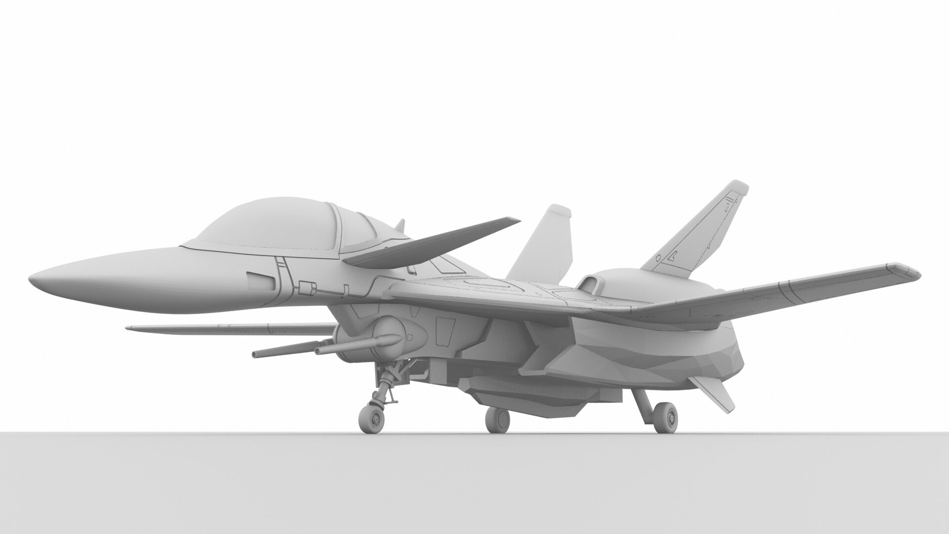

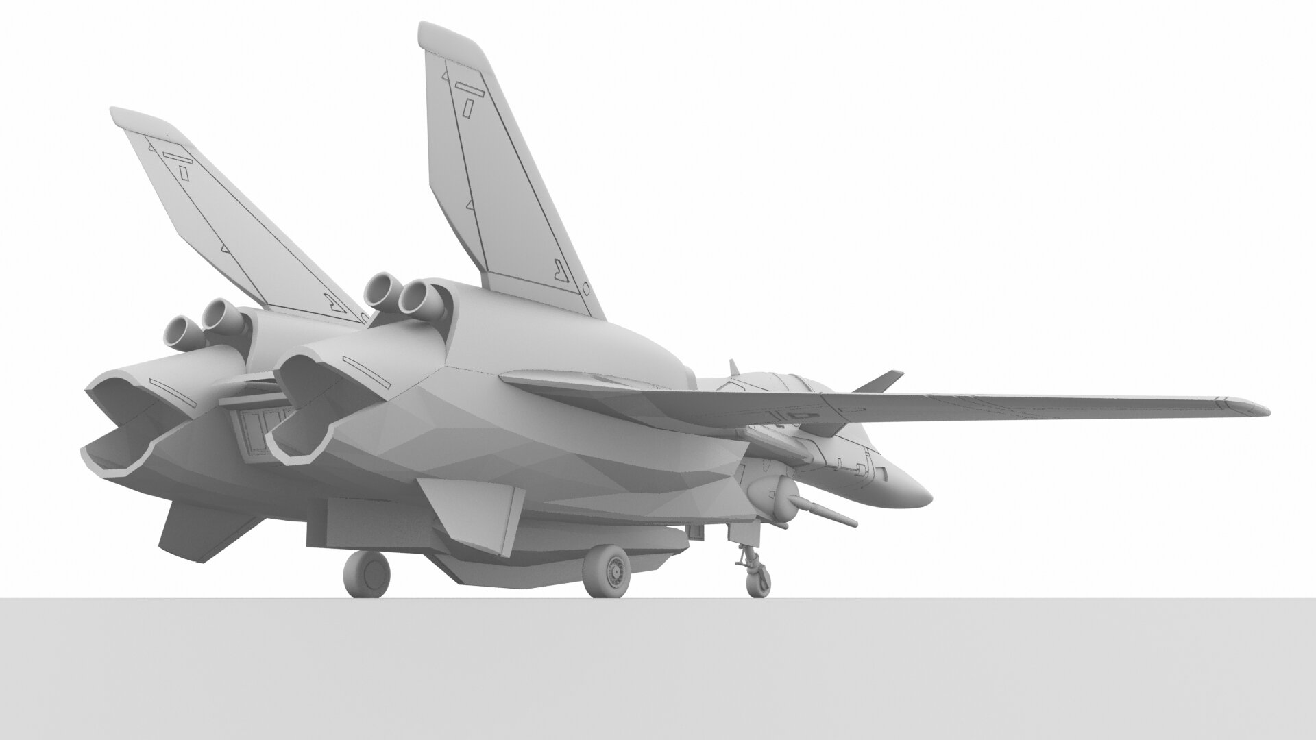

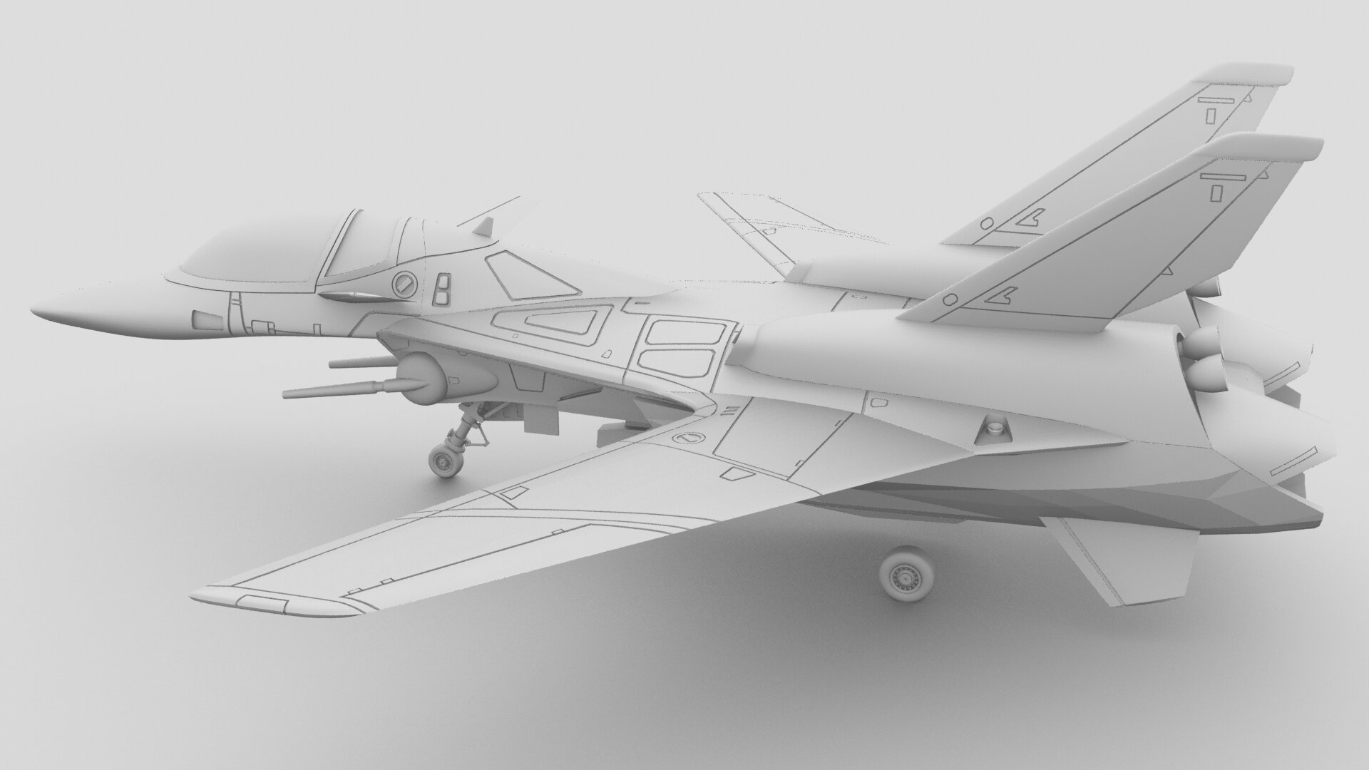

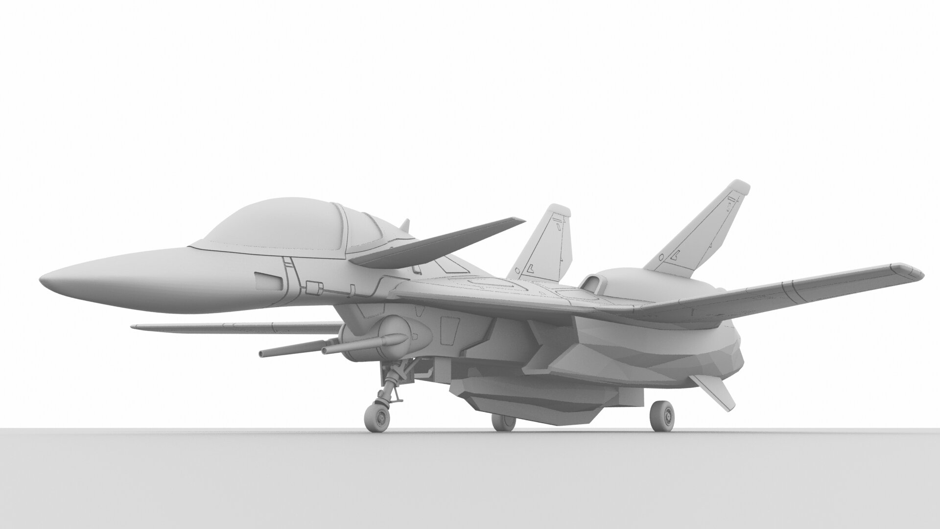

Been tinkering around on my VF-9 again. Getting the gunpod size right hard. I've been trying around and checking with reference material, but I think the size it good now.
Also decided on the basic shape of the back landing gear of the VF-9. I tried the F-18 one, with the "bend knees" but it looked horrible. So this is mostly like the standard stuff one would find in a F-14, F-22 or F-35. Any better recommendations are welcome.

Pushing myself to get the VF-9 done.
Only little parts left. I scrapped the back gear idea again. It didn't look good. Finally got the form of the engine exhaust/foot right.
Let's hope I get this done this year, hahahahah.

@Urashiman That's some real cool 3D work! Good thing it floats there while the main gear are being fixed.

@Urashiman Your rendering is looking line-art accurate! You better hurry, ONLY six months left this year!

22 hours ago, derex3592 said:
Looking good @Thom!!! Can't wait to build my 1/500 eventually!  Speaking of ships.... the Prominade Deck side walls ARE ON THE SHIP!!!
Looking really sweet!! Loving the detail you're putting into this derex!
BTW: are you going to make a tiny Leo DiCaprio and Kate Winslet for the bow? 🤣
*ducks*
31 minutes ago, Rock said:
Ordnance on deck.
Wow!! Nice job with the weathering so far! That bird is really starting to shine! Also liking the job you did with the heat discoloration on the metal!
