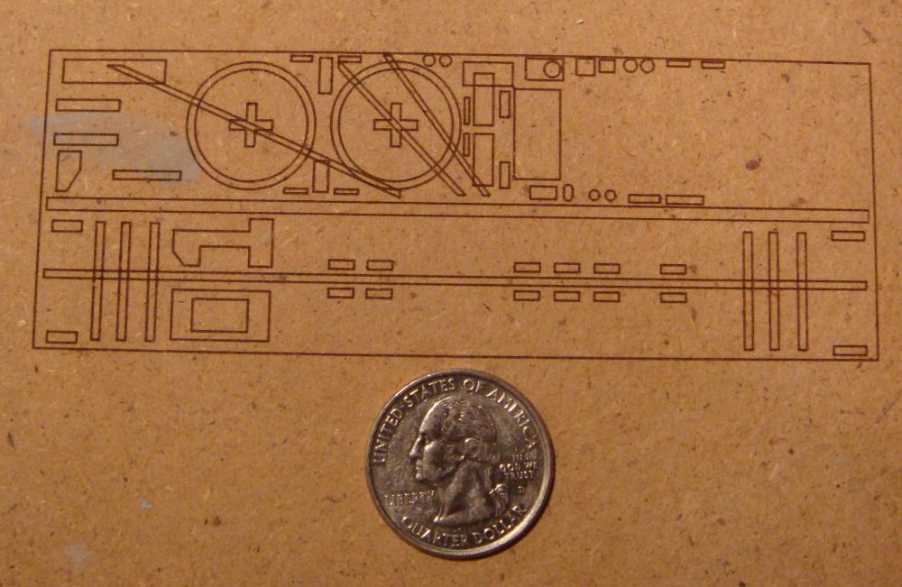

Valkyrie Posted May 19, 2011 Author Posted May 19, 2011 Alright, first build update! Sort of, anyway. So, on the way home from Wonderfest, I met up with some family in Indiana, and to make a long story short, my cousin ended up giving me his laser engraving machine! It's kind of a beast, and the work area isn't quite as big as I'd like, but it's looking like this thing is going to be extremely useful! It'll let me do a lot more of the project in-house, instead of spending money and calling in favors to get some parts of it done. After spending the night jumping through a lot of hoops getting everything set up, and the CAD files imported into the machine's software, I finally have a test piece to show off. So I give you, the deck plate (at an arbitrary scale of 4.5"), laser etched at low power onto a piece of scrap MDF board. I've also tried etching onto lexan (with decent results) and styrene (with horrible results). So I'm going to have to figure out what the ideal material for the job will be.
Valkyrie Posted May 21, 2011 Author Posted May 21, 2011 Alright, we seem to have a clear winner, so I'm going to call this thing. 1/1000 it is! And I have to say, I'm pretty happy with that result After some research and experimenting, it's looking like most of the laser cut pieces will be acrylic. I've gotten some very good results etching lines in the stuff. They're a tiny bit wider than I can scribe by hand, but a hell of a lot cleaner! I'm going to be working on the CAD drawings for the next few days, but I can't wait to start cutting out parts and building up the basic shape of the ship! The goal is to have this thing ready for sale in 6 months. Wish me luck!
