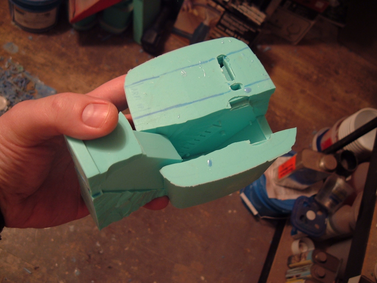

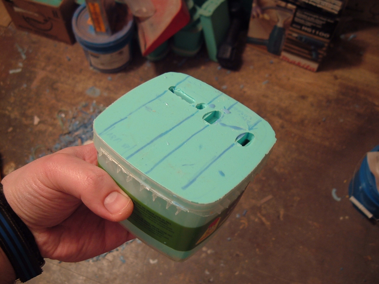

You want to see the mold (hardened rubber) or the casting?

The cut rubber mold block, so we could see how do you cut it in order to extract the casted piece..... :huh:

Here you go. Not rocket science by any stretch, just requires a careful hand and lots of patience.

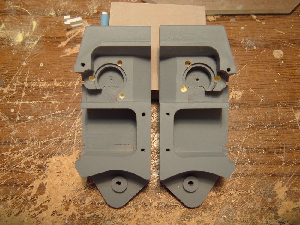

As promised, here's a mini-update for the upcoming third installment of The Beast, which will be the right leg. This will be one of the more intense parts of the project due to not only the number of parts, but also due to the volume of pouring required, as well as the fact that I will be using 2 different resins. The update itself will incorporate 2 different resins, steel screws, custom-made ABS or aluminum ball-joints, and white metal for the main landing gear.

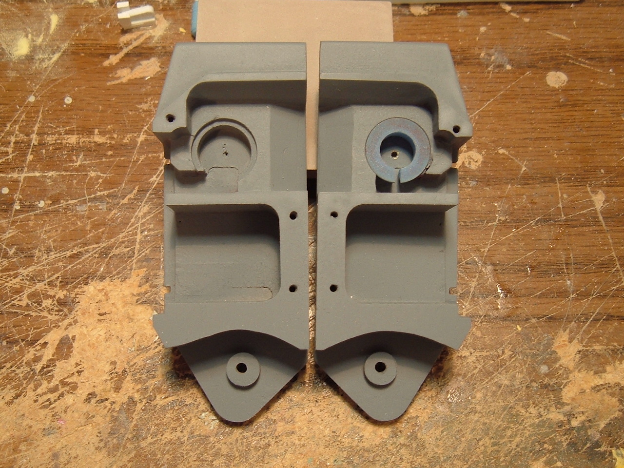

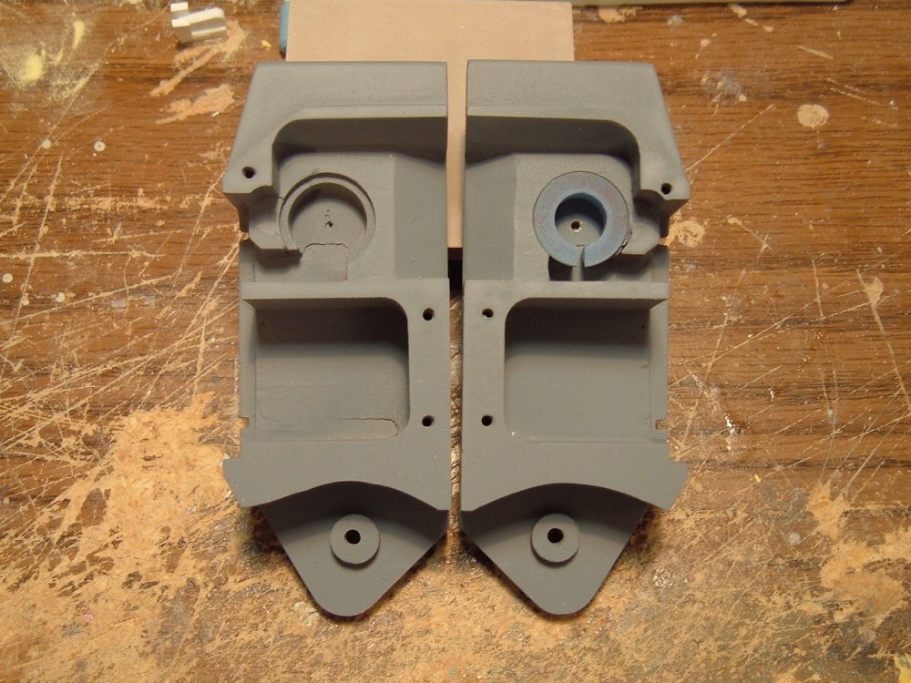

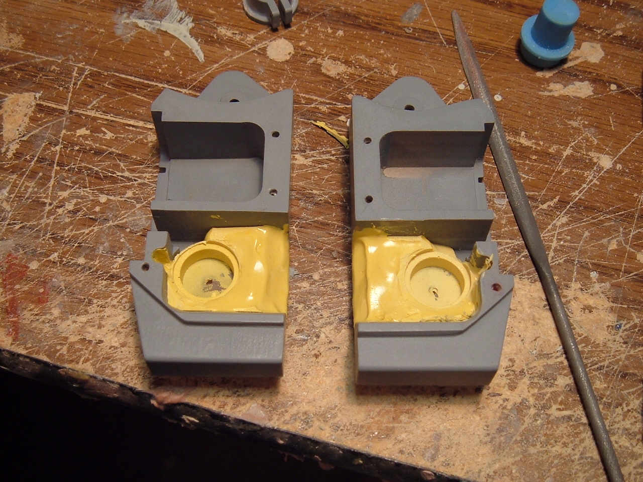

One of the points that needed re-working were the hip joints: back in the day, the hip socket was to be held in place via much smaller WALTHERS brass screws, and I'm happy that it never materialized, as these would have been insufficient. Having then adopted the implementation of beefy steel 3mm hardware, the hips required some obvious re-tooling.
Pic 1: the whole area of the upper thigh/hip that is to house the ball sockets had to be completely redone: enter Mr. Mori-Mori. While it looks messy initially, some clever machining will take care of that.
Pic 2: after a little trip to the milling machine and a coat of primer, things are looking much better: the entire area around the socket has been beefed-up considerably, and whereas in the previous version the socket was just screwed to the flat back of the hip, in this 2.0 version, the socket is 70-75% captured. You can see in the thigh on the right that I've placed a dummy socket for fitting purposes.
Pic 3: More-or-less the same as pic 2, but the drilling locations for the screws are now done. It's designed so that the steel screws tap into the plastic, and the screw head will overlap the socket part to hold it in place; a sturdier joint would be hard to find.

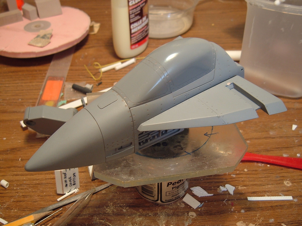

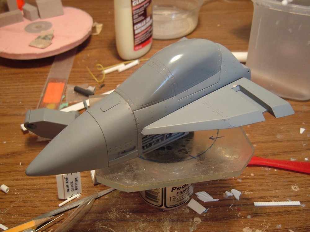

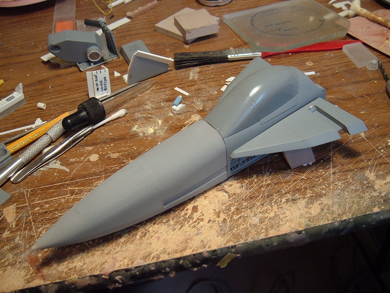

Pic 4: while most of my emphasis was on the legs, I was also taking time to re-work the nose cone, which I felt was somewhat too short as it's shown here.
Pic 5: while it's still in the early stages, the new nosecone/radome assembly will be considerably longer on the 2.0 version. Arguably, it looks a tad awkward in pics, but looks way better with the rest of the aircraft. A work in progress as always.

great work so far cap, keep it up, but isn't that nose a little too long, will have to check the lineart to be sure...
When I designed the whole Legioss, I went with a clean sheet of paper and made so many tweaks that I doubt the line art would be useful for checking proportions. The new nose was made extra long so that I could chisel away at it gradually until I find something I like. Easier to do it that way than to start with a form that's too short and then need to add material.
