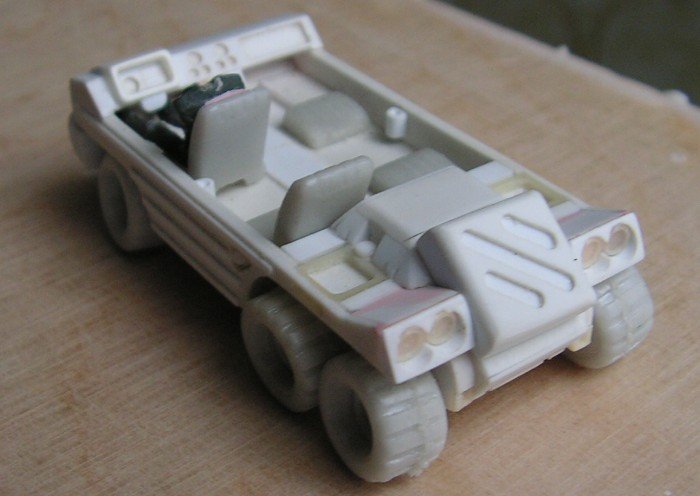

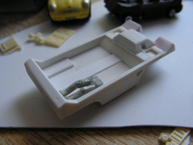

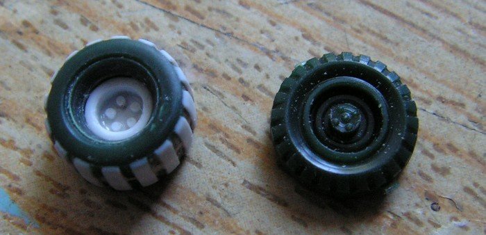

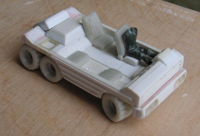

honneamise Posted July 14, 2006 Posted July 14, 2006 More progress, I tried to deepen the driver´s seat compartment a bit, but of course the front wheel wells have to stay... still very shallow. I slaughtered a WW2 pilot and when stretched a bit the legs seem to fit. Just ordered lots of Preiser figures, maybe I try to sculpt Roy as he was the driver in Ep.3 of SDF TV, but for that big guy I need to stretch all the limbs I suppose... I glued two wheels from Takara´s Dougram Jeep (right) together and made a new tread profile and new wheel hub (left). I´m just making a mold to get the other five. Of course I won´t forget the Cola machine, Bromgrev!!

honneamise Posted July 14, 2006 Posted July 14, 2006 Real nice Thorsten. Have yo put any thought into what else besides the 6x6 and cola machine will be in the set? Valkyrie: I have some 1/100 Valk wheels if you need em. Cheers, Berttt 416158[/snapback] Hi Berttt, I thought of the Cherry Picker Truck and the little 6-wheel vehicle, both of which came in the IMAI 1/100 Factory set, and maybe the other 6-wheel all-terrain crew vehicle that was used on mars..

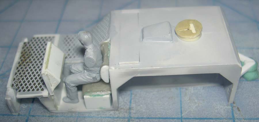

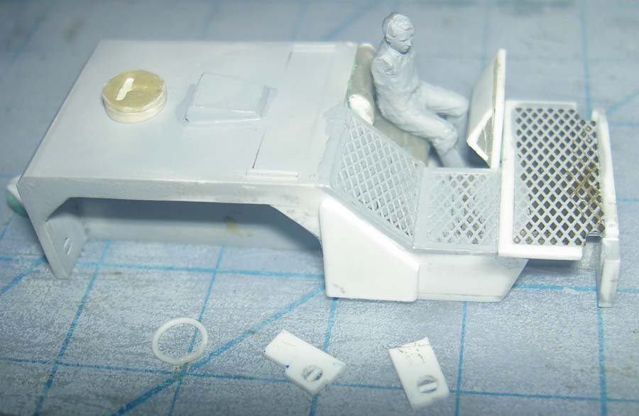

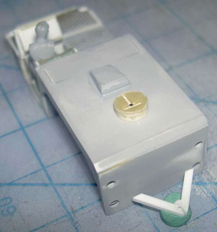

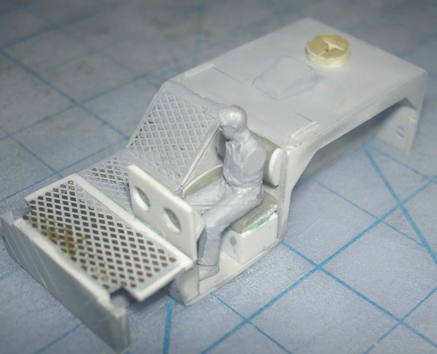

Valkyrie Posted July 30, 2006 Author Posted July 30, 2006 (edited) Well, the sun is rising, and that means once again, that precious time between work and sleep has been used up. And a goodly part of it was spent working on the tow tractor, so I thought I'd post a few pics of my progress. Well, there she is. And there HE is, as I've got a decent start on the figure. But the head is turned, and the torso is twisted slightly. So I'm not sure yet if I'll adjust the head, or replace the upper body entirely. But the legs are just where I want them. Also added are the trailer hitch, the little ramp piece and the '5th wheel', though they both still need some work. And the top piece of the 5th wheel is small, thin, rather fragile, and must be kept seperate, so I'm not sure how well it'll cast. But if that fails, I may be able to have a friend make them out of photo-etch for me. Wouldn't that be something... my first kit including photoetch The other side, with recently added trapezoid piece on the side. I have no idea what it is, but it's in the design art Also in frame are the final front tie-downs and just-started steering wheel. I kept the tie-down panels oversized, to make casting them a lot easier. When building the kit, you'll just have to glue them in place, then trim them flush with the sides of the truck. The steering wheel was an unexpected pain in my ass... I got my hands on four steering wheels that were about 1/72 in size. Then when I finally got around to measuring a real steering wheel and calculating scale, I found that all of them were way off. So I'm stuck scratching one. But I've got a pretty good plan of attack. And it'll make it a lot more accurate to the design art. So it's for the best anyway. And here's the knurled rod of resin that will soon become the rear tires. Unless I decide to re-do it and make treads deeper... That's about it for now. Questions and comments are quite welcome, as always. Edited July 30, 2006 by Valkyrie

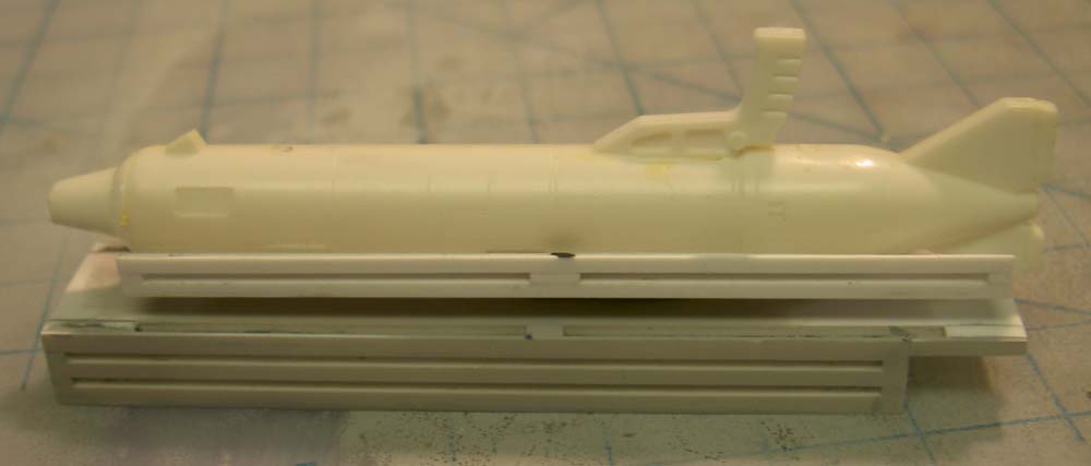

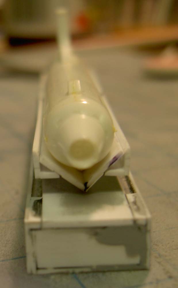

Valkyrie Posted September 11, 2006 Author Posted September 11, 2006 A few quick update pics before I head off to bed (most of which have already been posted elsewhere) The tow tractor's been sitting at that point for a few days now. I've turned my attention to the gunpod loader for a bit. I started on it 3 days ago, and I'm quite happy with how far I've gotten on it And this is my only reference That's it for now. Questions and comments welcome as always.

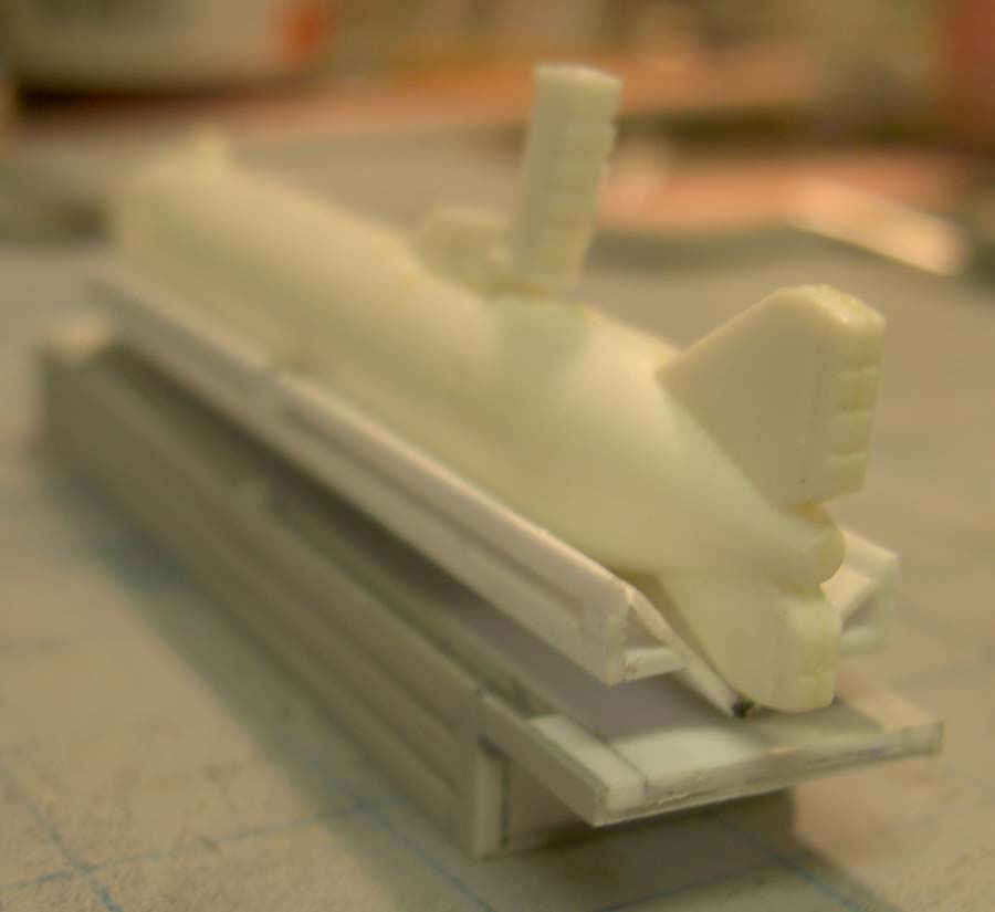

Valkyrie Posted September 15, 2006 Author Posted September 15, 2006 More work on the gunpod loader today. The tray is taking shape pretty well. But I think I may re-do the side walls... I made them too thick. They look a lot thinner in the anime. Which sucks, cause they were a b!tch to work in, even in .03" styrene...
honneamise Posted September 19, 2006 Posted September 19, 2006 Hi guys I´m still here - good to see that MW is finally back, that trouble looked pretty serious. I had a lot of work so I wasn´t able to check back often. I don´t know when I can go back to my vehicles right now.. still, I had made some progress since my last post, I need to get my camera charged. Valkyrie your gunpod looks great!!! Don´t know if you should change anything, looks thin enough for me, and already thin enough for the casting job to become a minor headache ! The car is excellent, very detailed and very accurate.
Kylwell Posted September 19, 2006 Posted September 19, 2006 Maybe he doesn't know the forum is back. I only knew because it was announced on Samuai Monkey's forum. I stopped checking after September started. Just shave the ends to thin the look. Some careful work with an Xacto and you can have them look thinner with the structural advantage of the thicker material.

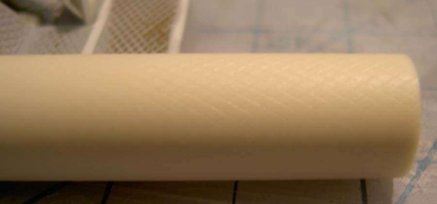

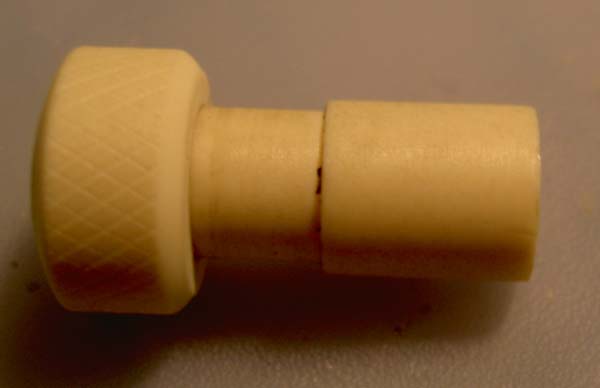

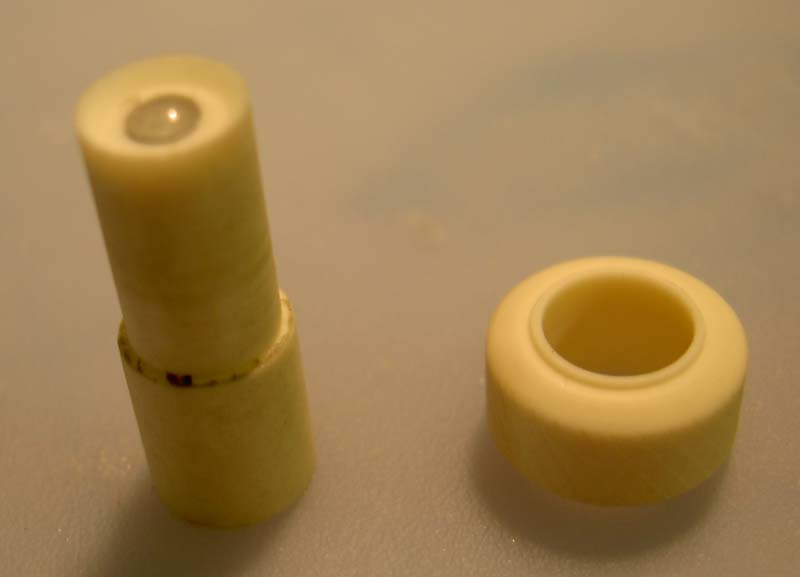

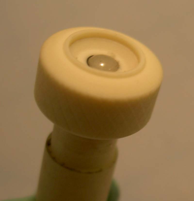

Valkyrie Posted November 23, 2006 Author Posted November 23, 2006 Man, it's been entirely too long since I've posted in this thread! I really want to get this thing finished up, so I went back to work on it last night. Did a quick inventory of what I still need to finish: Driver's compartment: 70% complete Driver figure: 40% complete Rear wheels: 10% complete And that's about all that's keeping me from having this thing finished... So, I got to work on the rear wheels. When I'd last left off, I had a resin rod, machined to a 'close enough' diamater, with a good knurl pattern on it. So I busted out my CAD drawing of the wheel and its rim, and went to work machining it all out. Fortunately, I was able to devise a much simpler approach than my previous attempt (over a year ago), and it came together fairly easily. I ended up with two parts, the tire itself, and the center hub, which slides into the tire quite snugly (they'll be cast as one piece). The small dome in the center is a 3mm lens out of set of Wave's H-Eyes. More soon, I hope!

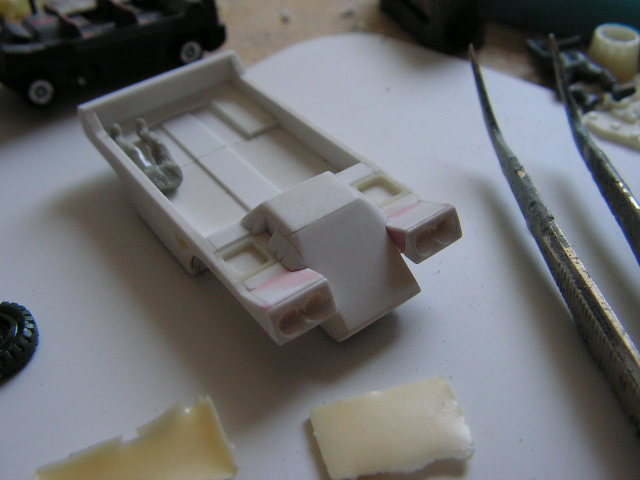

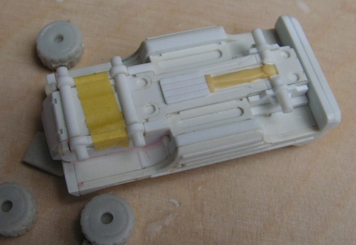

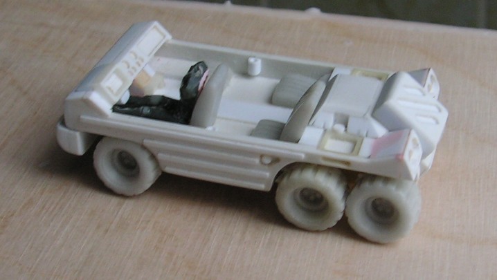

honneamise Posted November 23, 2006 Posted November 23, 2006 Great looking wheels Valkyrie! After a LONG hiatus due to other projects I´ll try to make some progress on my 6-wheel crew vehicle again! The major components are almost there - unfortunately Focker´s head is still missing, I´ll try to sculpt the guy with Tamiya resin but I´m not sure how he will come out in the end... maybe a generic driver will have to do the job ! [attachmentid=38413] [attachmentid=38414] [attachmentid=38415] [attachmentid=38417]
