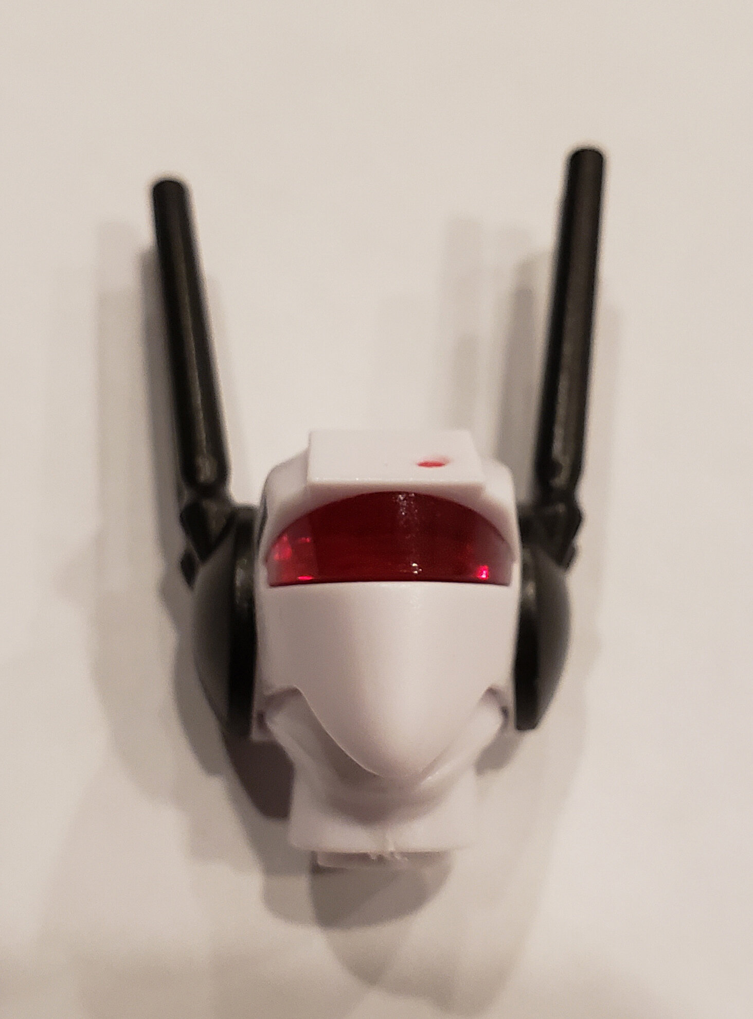

If anyone was curious, I found out the problem. After cutting away at the back of the head with an x-acto blade, I was able to pry the head apart with a thin spudger with good leverage. Anyways, here's what the inside of the head looks like. The culprit was excess flash on the washers. These washers rotate along with the head laser and then get jammed when they hit the bumpers. Thankfully the washers are easily removable and plastic, so filing them down with sandpaper is easy. Now that the excess flash has been filed down, I don't have to worry about snapping the head lasers when rotating them around. Hope this helps anyone who encounters the same problem Fugu FG-01 Jetfire. I don't normally buy bootlegs, but I don't see anyone ever making on official version of this toy since it'd be a licensing nightmare.

Just to give a quick update: Yup, I managed to rotate the head lasers about 5 times by gripping them at their base, hoping that it might break up any excess flash. But no luck, they still require a ton of force to rotate. And I don't want to rotate them by their base every time, because with all the force needed, one slip of the finger and a head laser could snap. I tried freezing them overnight twice, but it didn't break up the glue. Great idea though! Since this is a KO, I really don't want to subject it to boiling water. The plastic feels as good as an Arcadia, but I still don't completely trust it. So I've settled on breaking out a fresh x-acto blade and carefully cutting away at the seam line on the back of the head where the glue is. Very small flakes of plastic are getting removed in the process, which will probably leave a more noticable seam line, but seam lines don't really bother me that much. And I'll take them any day over a broken head laser.
Thanks everyone! I was holding out hope that it wouldn't be glued together, but I guess I've got my work cut out for me now.
Does anyone know how to safely take apart a v2 1/60 VF-1S head? I got the Fugu Model FG-01 and the head lasers barely budge. I want to take apart the head and see what's going on internally, but can't figure out how to.
