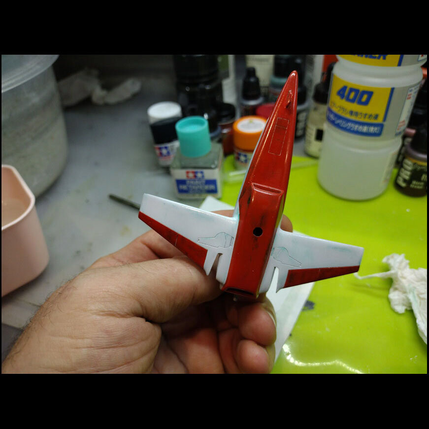

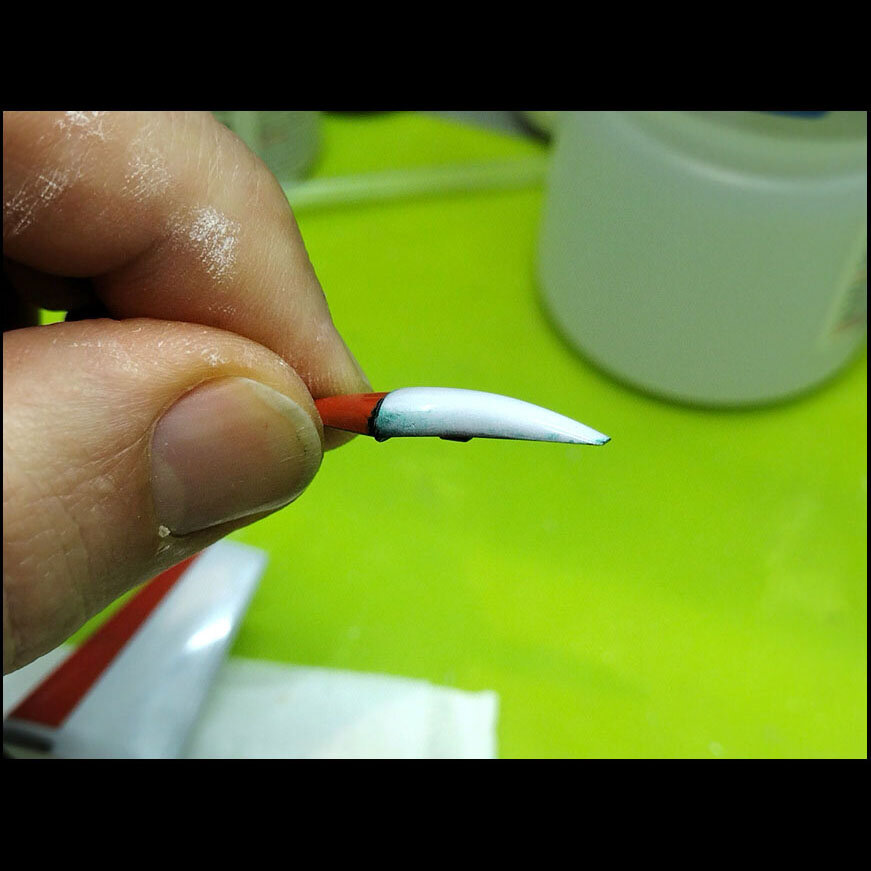

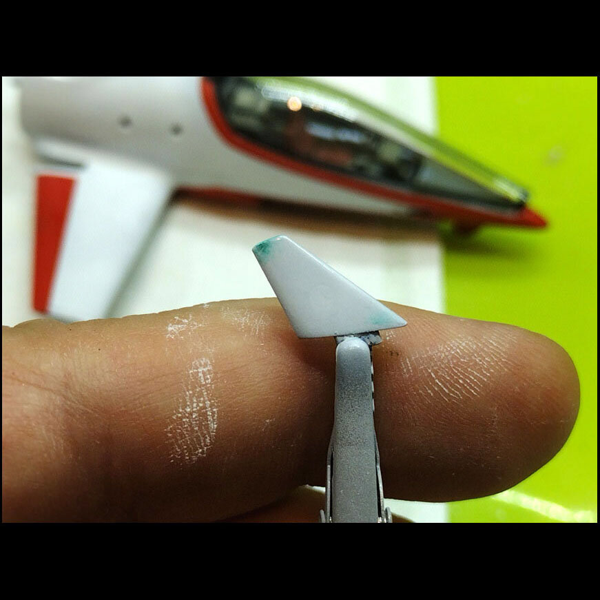

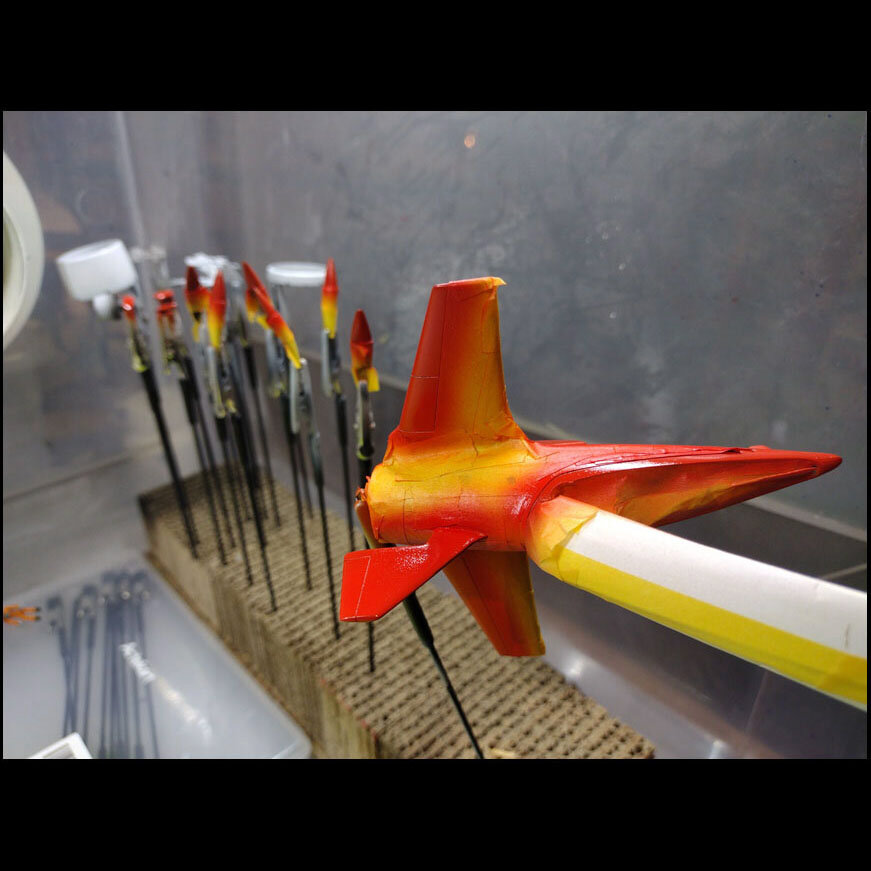

So what now? As they say "It's not a flaw, it's a feature." So I pivoted to implying a story with this kit. Instead of simply being Rick Hunter's Fanracer, this kit will now be Rick Hunter taking a last ride in his previously years-long abandoned Fanracer before embarking on the Pioneer Expedition. If you are a fan of Japanese (particularly WWII) aviation then you know what aotake is. And if not: It's a bright translucent (typically) blue/green laquer primer. My thought was to try to make it look like the aotake was showing through where the paint was worn or cracked. And in a few spots the base material (mostly yellow aramid fiber) would be seen too.

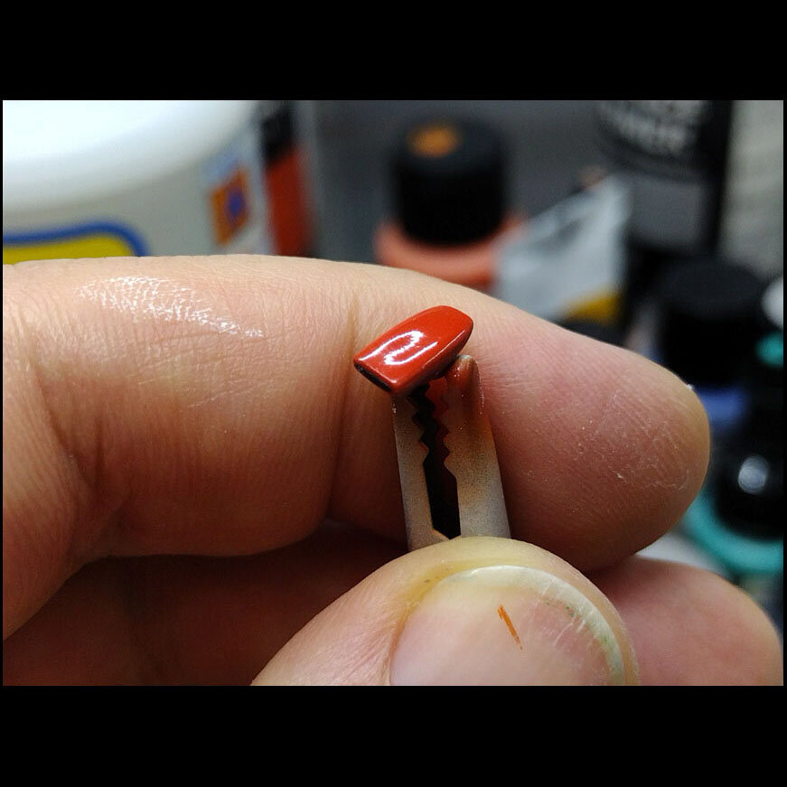

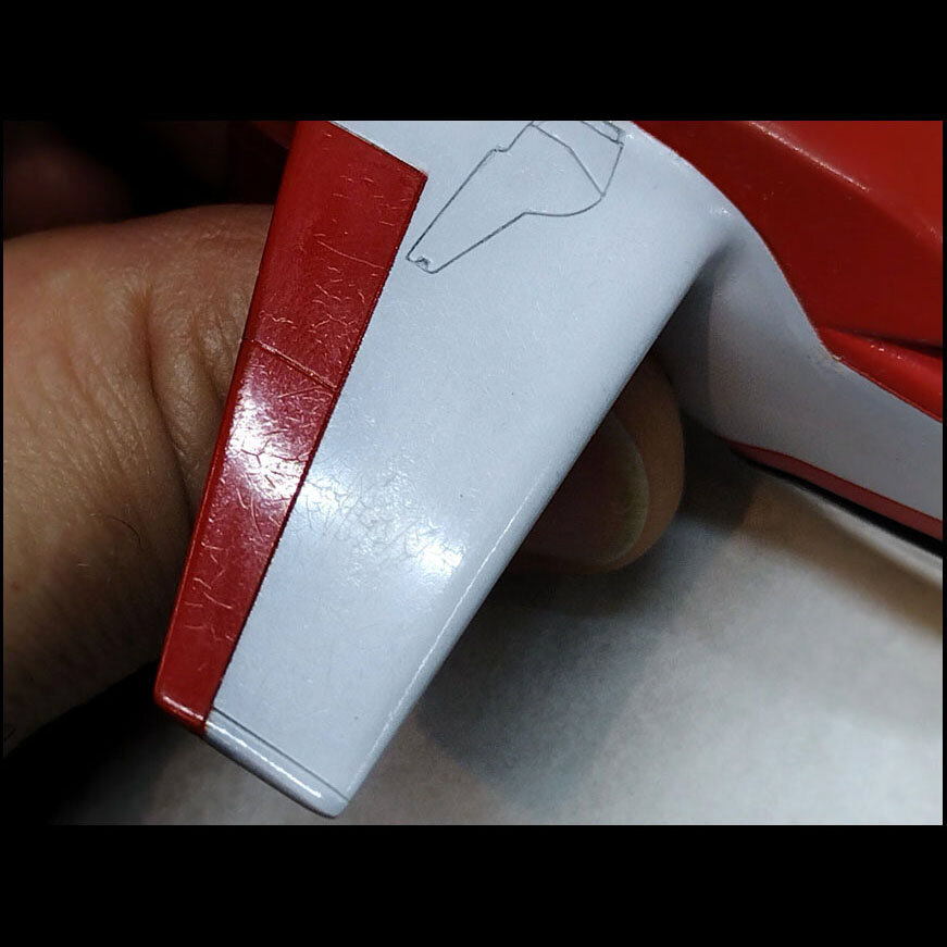

I then wet sanded the small parts with 6k then 10k (note: Japanese grit scale!), and polished with Tamiya's 3-step polishes. Liking the results I started wet sanding the main body... And then this started happening! Micro cracks slowly appeared all over the kit. Looking back I now suspect that my airbrush's water trap was too full and had stopped trapping water, contaminating the Tamiya hybrid acrylic and changing how it cured, which then got trapped under the airtight Future clear and that led to this. I sanded, VERY carefully, through the cracked clearcoat and polished as best I could. Worked fairly well on some of the smaller parts. But not as well on the main body. It was clear that the only way to get rid of the cracks was to sand down the the primer and re-shoot the model. BUT since I didn't know what had caused the reaction that didn't seem like a wise use of time.

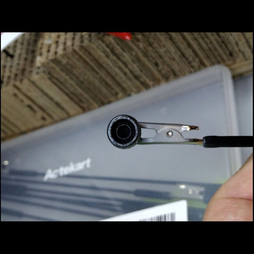

If you don't yet have some Musou Black GET IT. Stupid web stunts aside it is an incredibly unique and valuable modeling tool. Unlike any other black paint it is both dark AND flat. Meaning you can use it to literally paint shadows. So in the case of these little exhaust vents that don't have recessed holes, a little Musou Black makes it very convincing. Similarly the far depths of the thruster now have more depth. I put the model into my dehydrator after clearing but didn't turn it on, just used it as a dust shield. I cleared it twice. Finished base painting Rick. Unmasked after clearing. Test fitting Rick. Then I had to fix the red area behind the canopy that was partially covered by the mask. I did this by brush, thinning the Tamiya a little with Mr, Color leveling thinner. The gap of the canopy hinge will be painted Rubber Black later. Detailing Rick, weathering looks a little heavy up close but reads well at normal viewing distance. More Musou black for the engine and radiatior intakes. Rick is now glued in place.

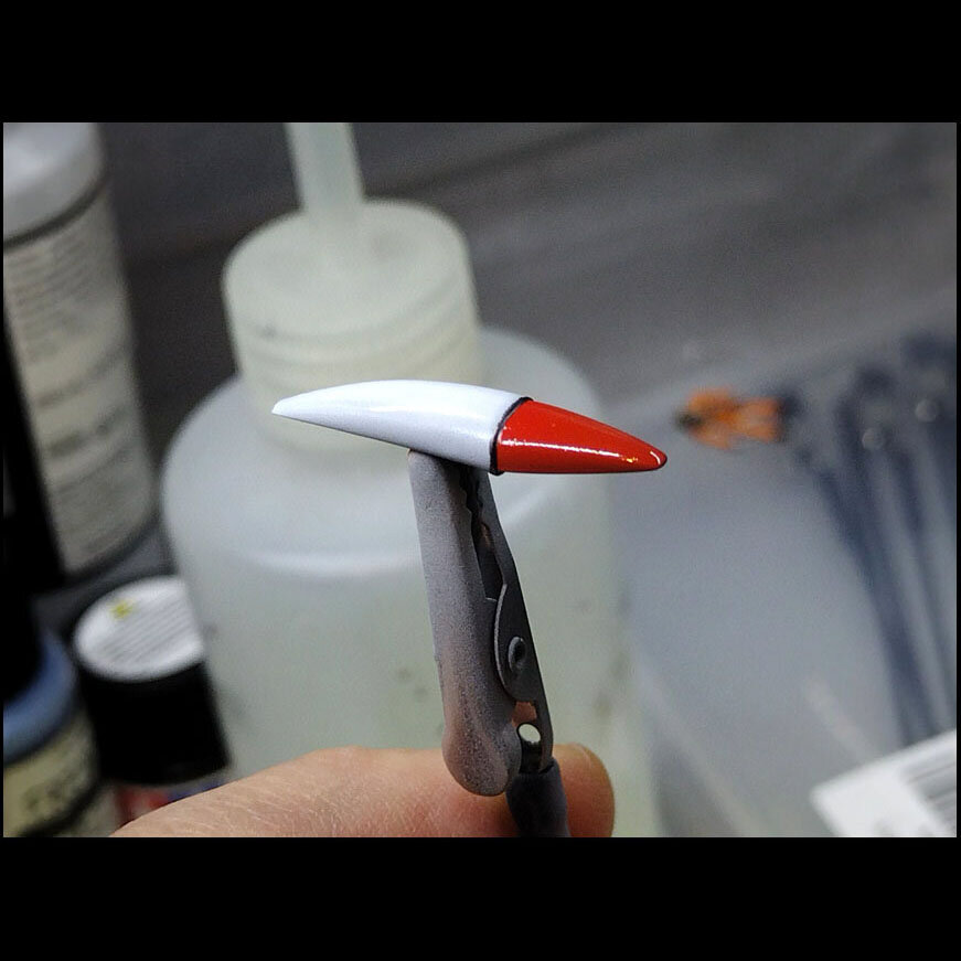

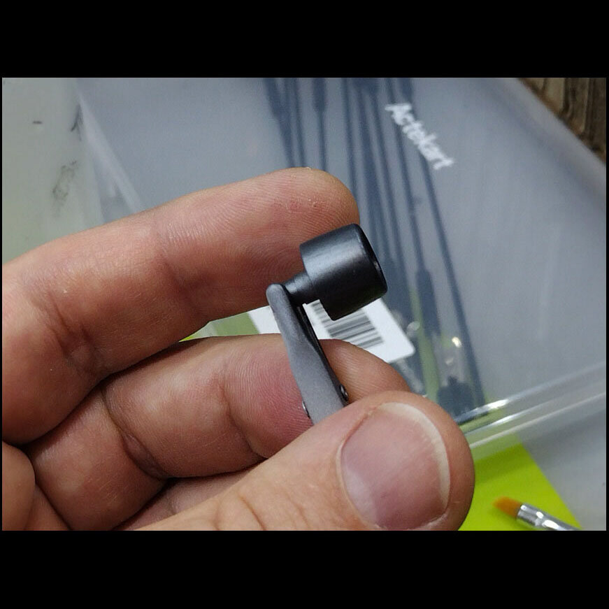

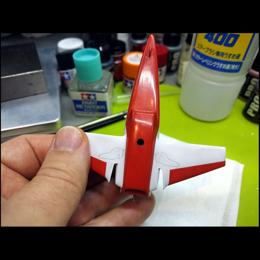

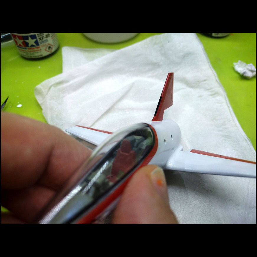

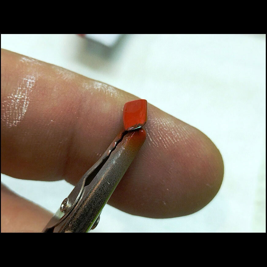

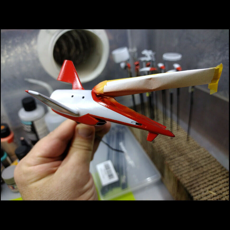

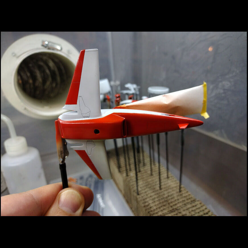

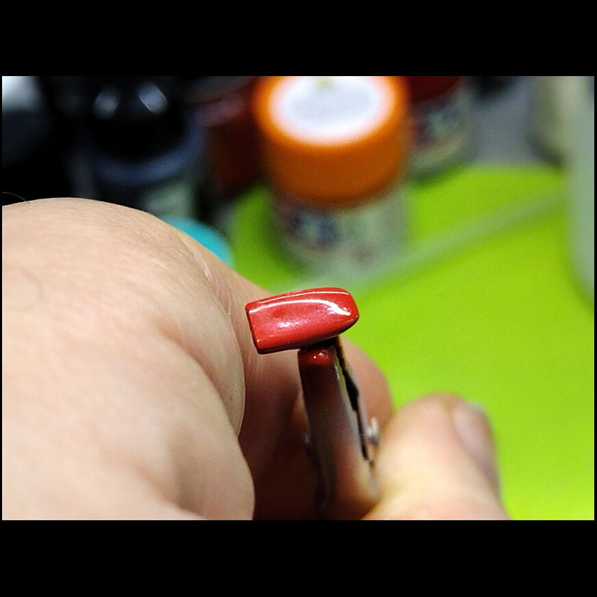

I mixed an orange-red from these Tamiya colors. Unmasking the white, but leaving the canopy mask on for clearcoating. I cleared it, after letting the Tamiya cure a couple days, with Future. I've dipped with it before but not used it as a final clearcoat. It sprays beautifully, mists well and can also go on fairly heavy. On a small model like this I didn't use a retarder, so I can't comment on how it would react. Then I painted the fans a dark metallic gray. NOT a metal color! Even though that would have been prettier. I figured since this was an '80s show that the blades would have been ceramic, as Japanese ceramic knives and such were new and unique then. Granted a ceramic could be any color, but in the show they are dark gray - and not shaded as if they were metal. I added some directional glazes on the thruster, because it was just too plain. And little nicks and streaks to the blades. Then I lined the booster pods with Rubber Black, partly as a heavy panel line accent and partly to represent a buildup of soot over many uses.
I wanted a somewhat heavy and splotchy preshade, closer to black basing, but this went a little overboard. Also, in hindsight I now see a issue here with the spray pattern that I think was the cause of the big issue later. Then the white base coat, using Tamiya acrylic. Then masking for the red color.

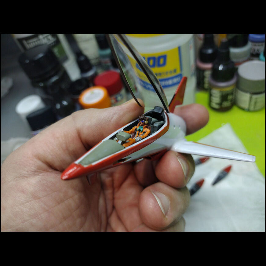

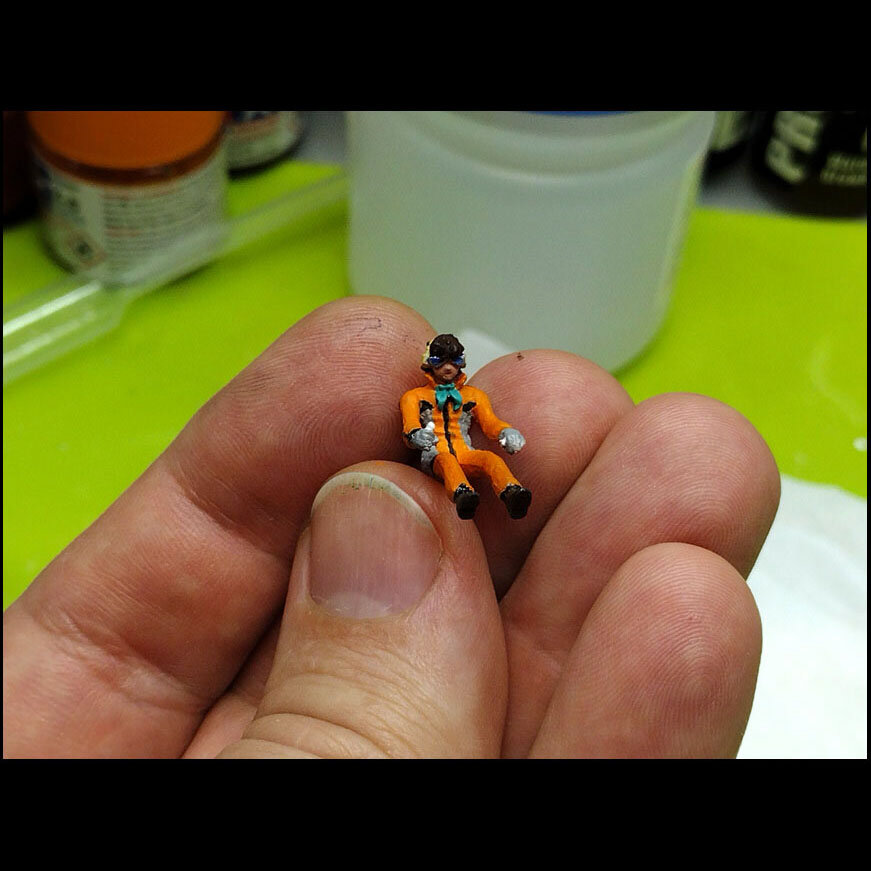

I base painted Rick and the cockpit, based on screen shots from Macross. The colors are not consistent, nor is the lineart, so it's open to interpretation. Then I thought the green was too green and so I desaturated it a bit, lightened the lighter green-gray, and repainted the cockpit. I used Molotow Chrome for the gauge bezels and two details that look like latches behind the seat. Then distressed the leather seat with thinned acrylic glazes. I still through the cockpit looked a little plain. Since the colors changed from shot to shot in the show I thought that maybe a little interference blue over the top of the lighter green would give it a subtle accent to catch the eye.
