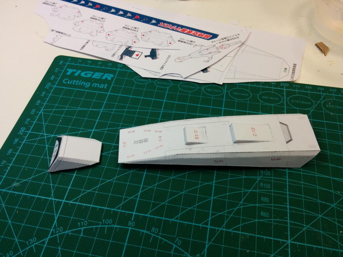

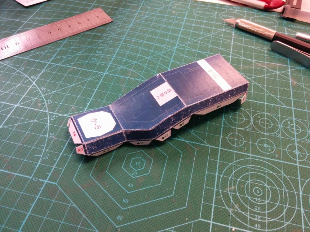

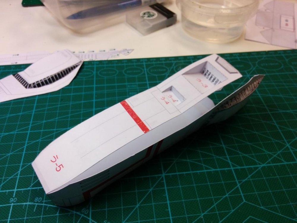

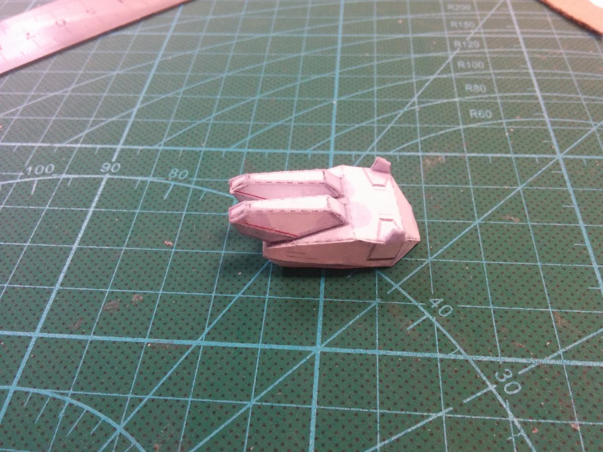

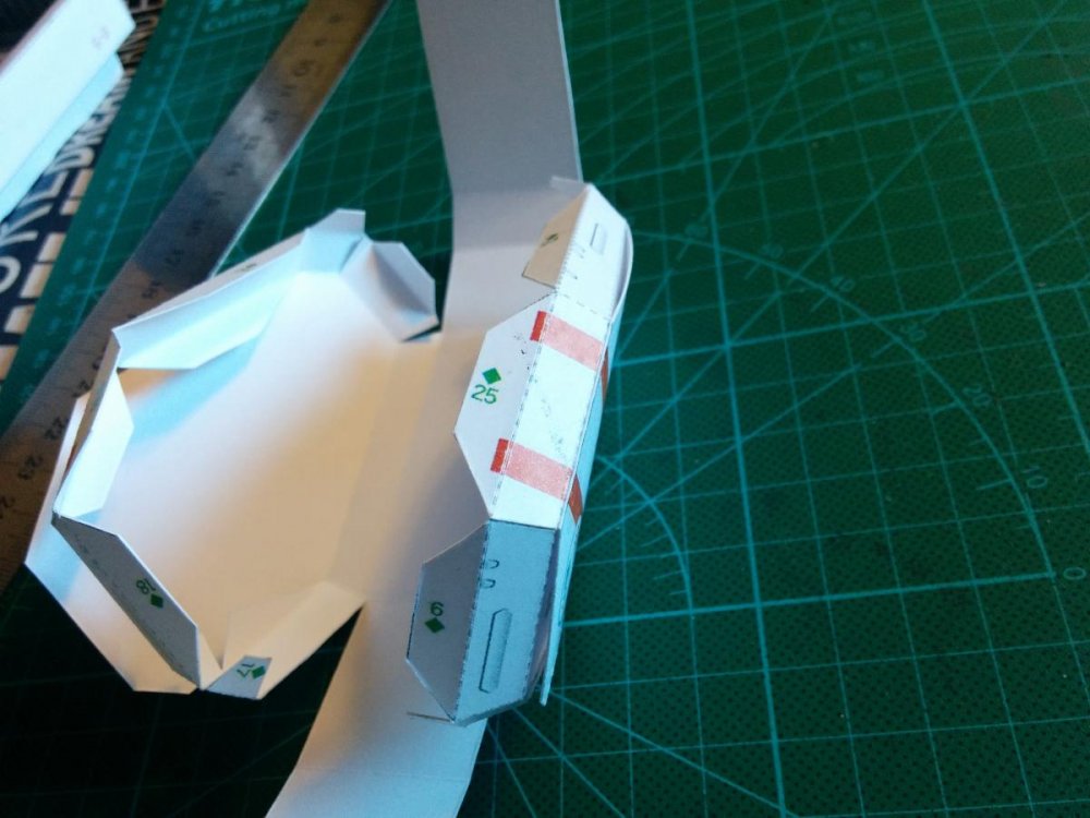

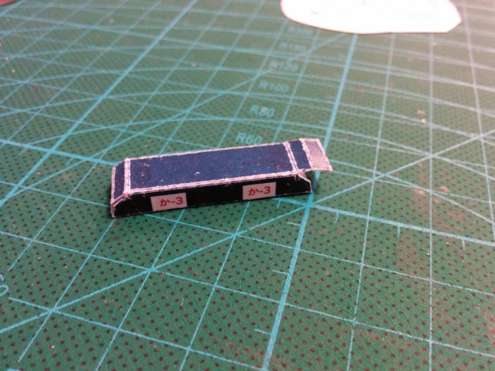

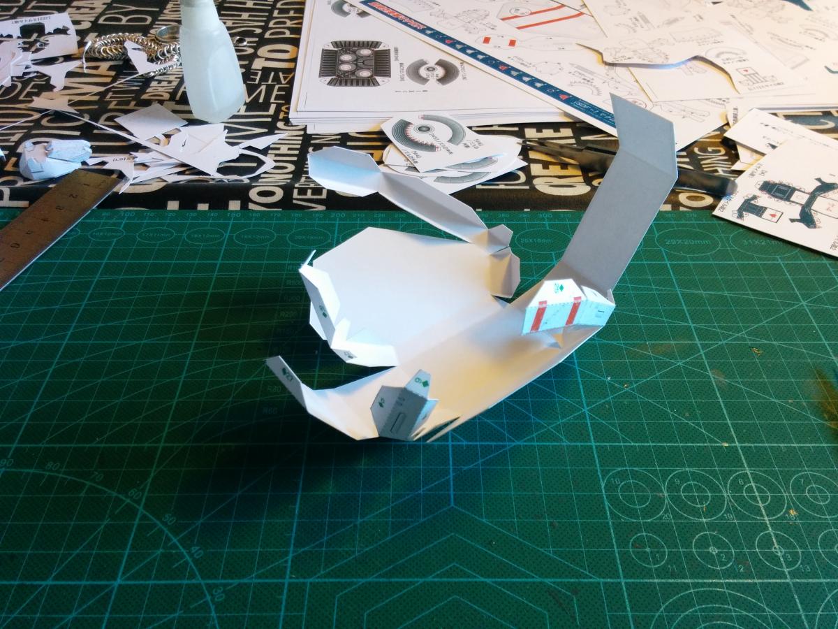

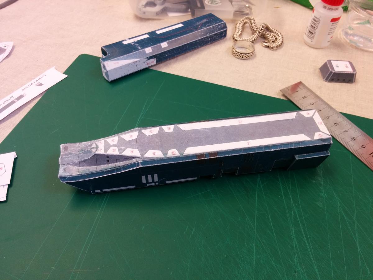

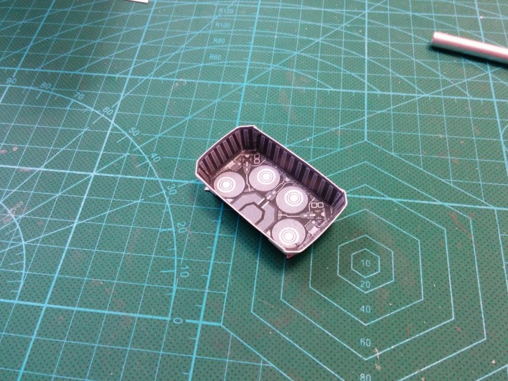

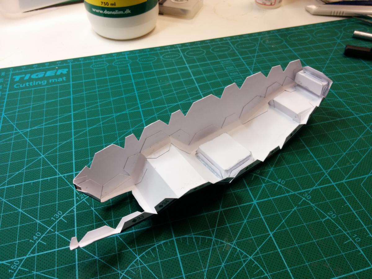

Ok here we go!

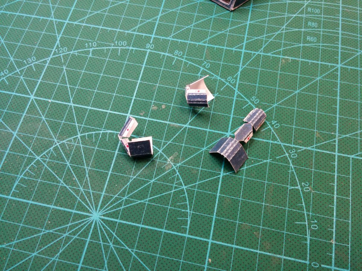

First some simple parts should be straight foreward
post-14728-0-42942500-1427154067_thumb.jpg post-14728-0-81061900-1427154069_thumb.jpg

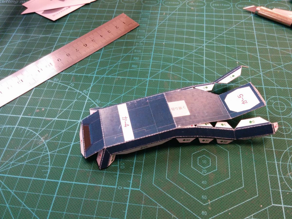

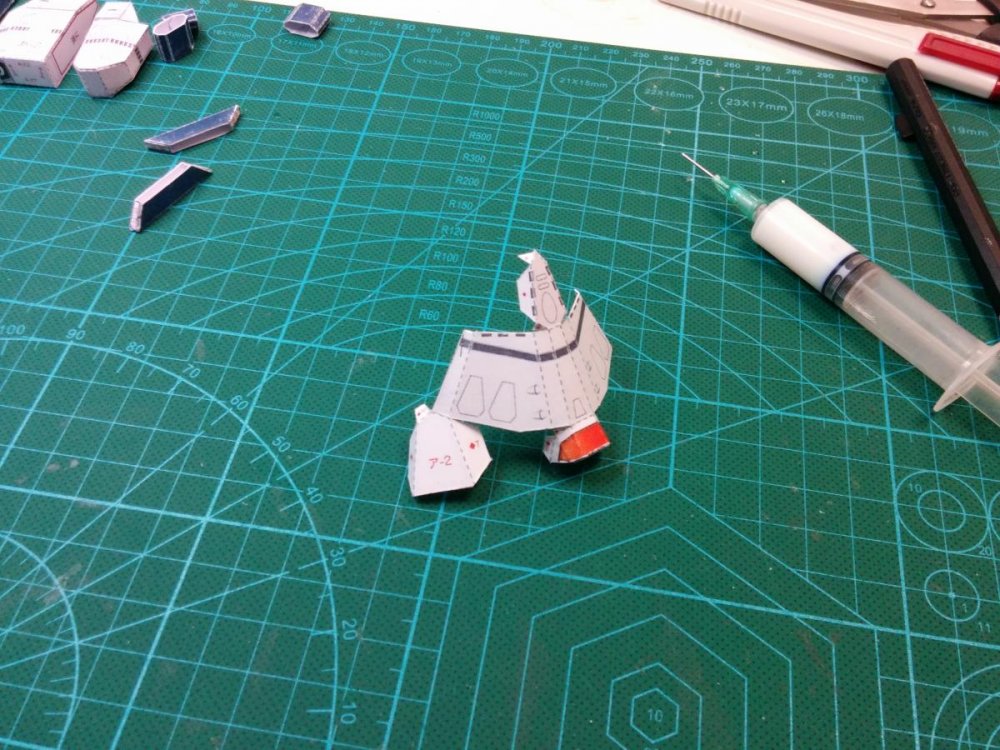

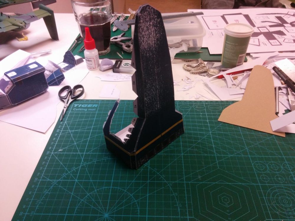

now this bigger piece, its important to start glueing the big flaps first, to make sure they lineup with the panelines.
post-14728-0-85040500-1427154072_thumb.jpg post-14728-0-63310800-1427154074_thumb.jpg
post-14728-0-20517200-1427157801_thumb.jpg post-14728-0-68249300-1427154078_thumb.jpg

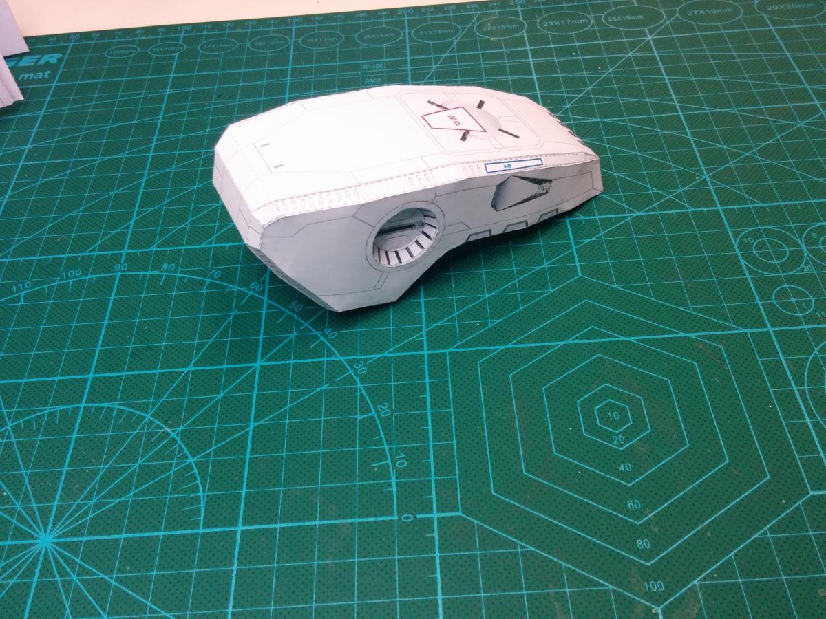

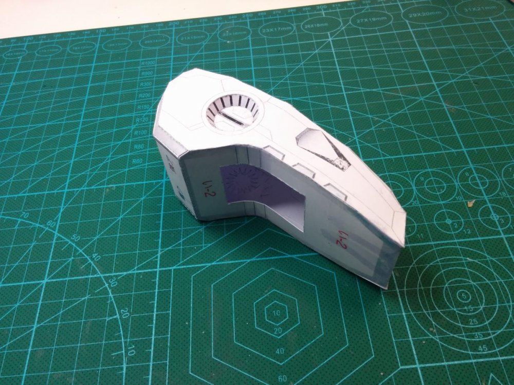

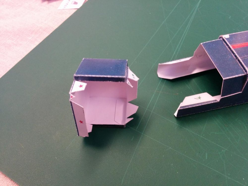

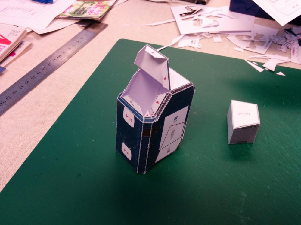

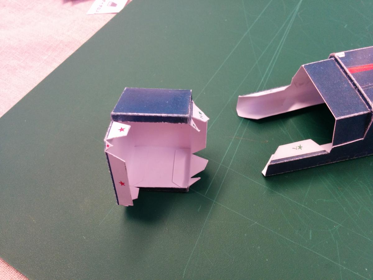

a friend of mine could not figure out how the next big piece would fit together, it actually to me a couple of glances..
the need to be seperated first
post-14728-0-72761300-1427154080_thumb.jpg post-14728-0-74226000-1427154246_thumb.jpg

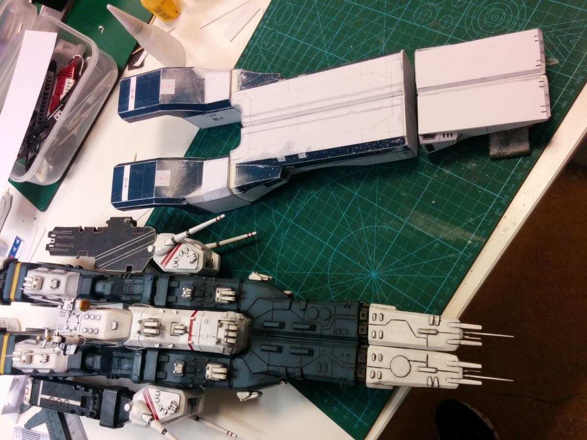

also a size comparison

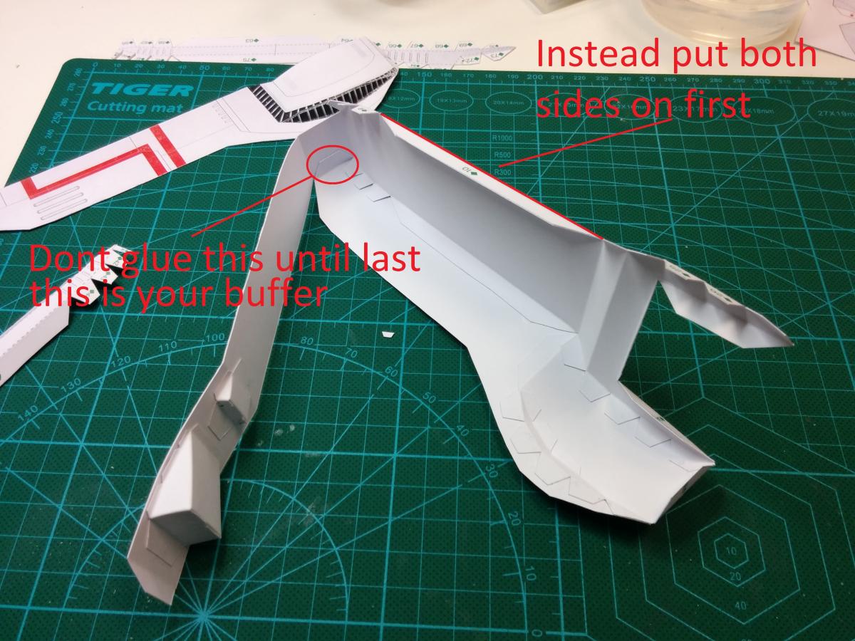

now lets continue!

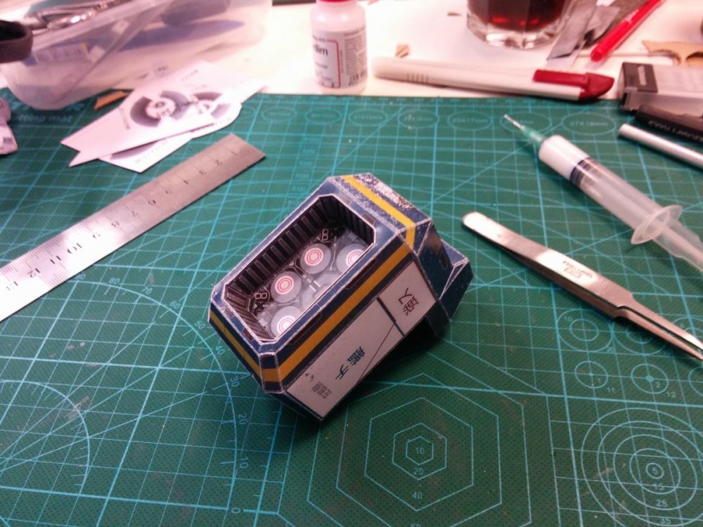

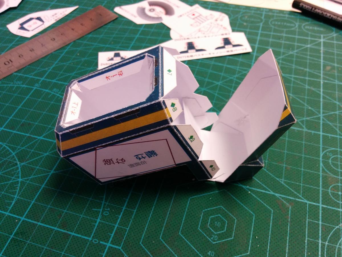

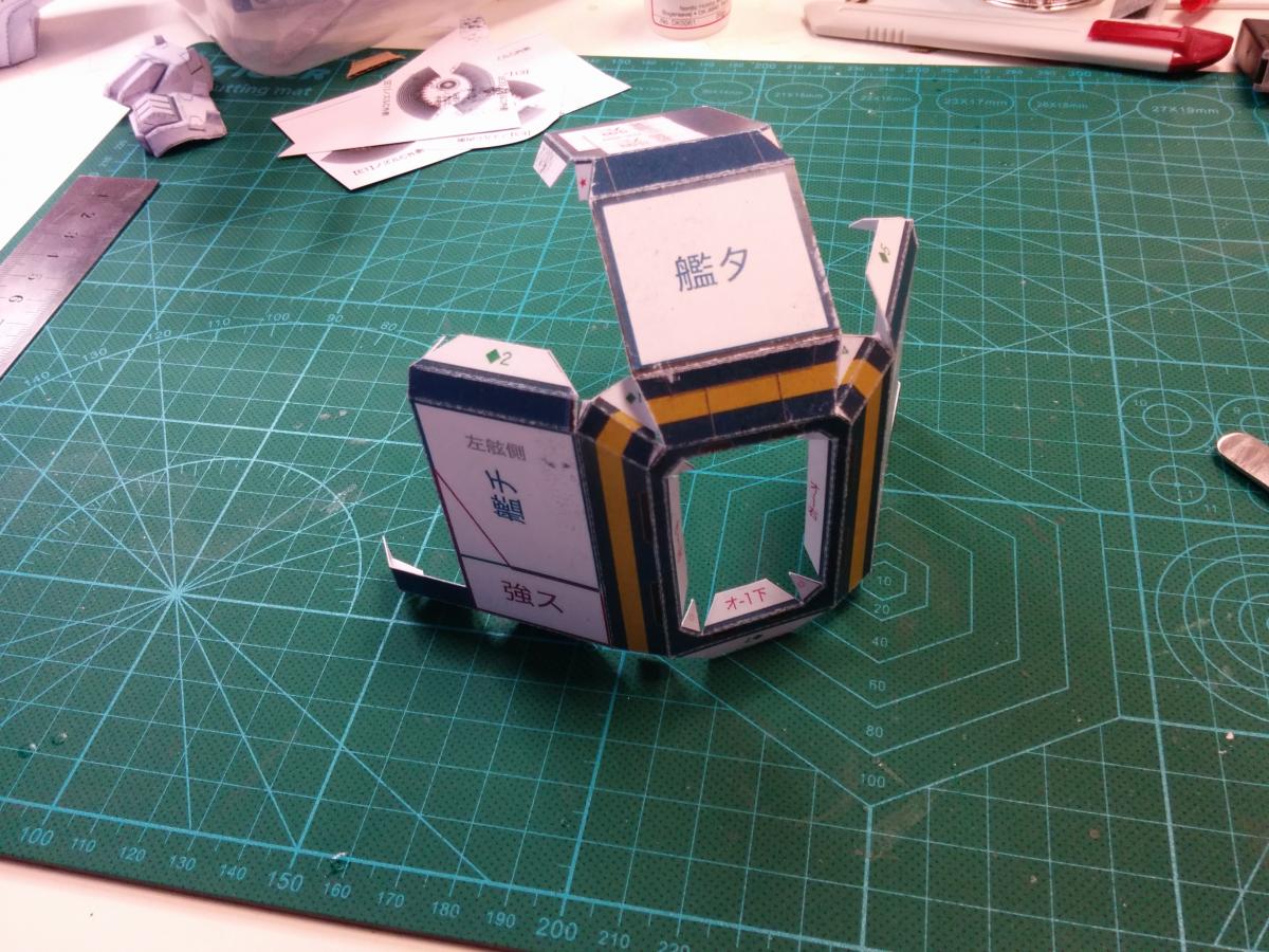

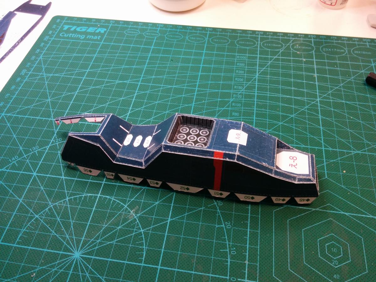

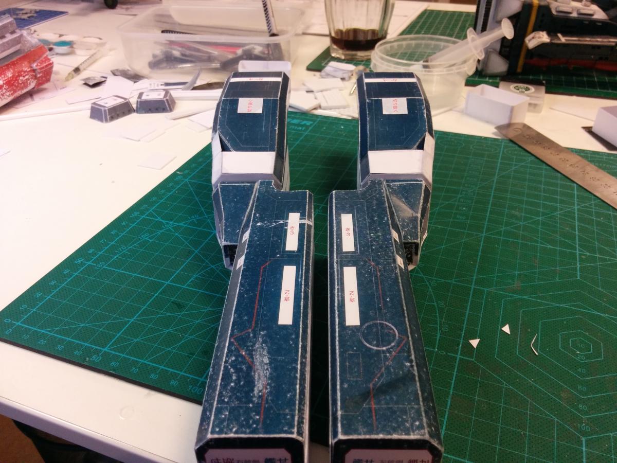

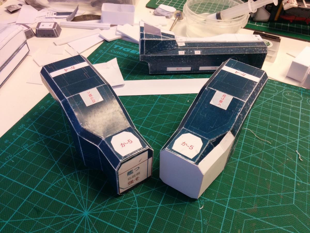

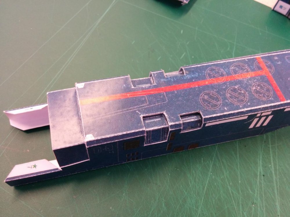

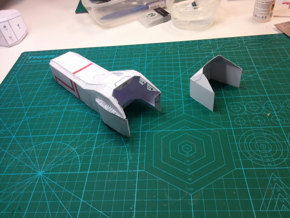

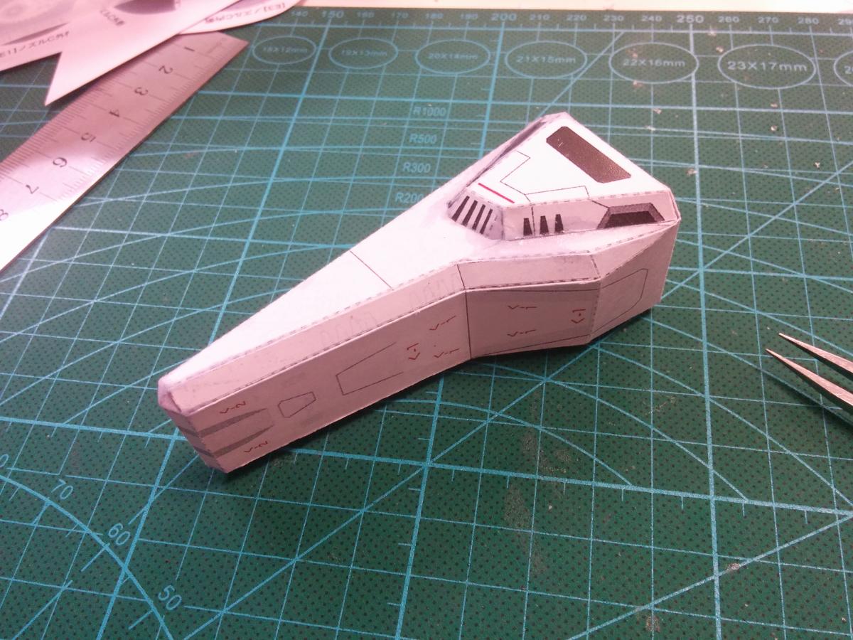

a bit more progress...
what i mean about buffer is having put both sides on first then glue the front last to make sure everything is in level
cause it can easily twist....
post-14728-0-34230400-1427231572_thumb.jpg post-14728-0-32223000-1427231574_thumb.jpg
post-14728-0-60868600-1427231576_thumb.jpg post-14728-0-10253600-1427231579_thumb.jpg
post-14728-0-46462600-1427231581_thumb.jpg post-14728-0-58291400-1427231583_thumb.jpg
i managed to correct my mistake...
cause my front did skew abit... nothing a knife and superglue couldn't fix though :p
but dang this is gonna be big :o

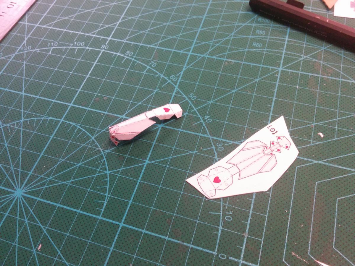

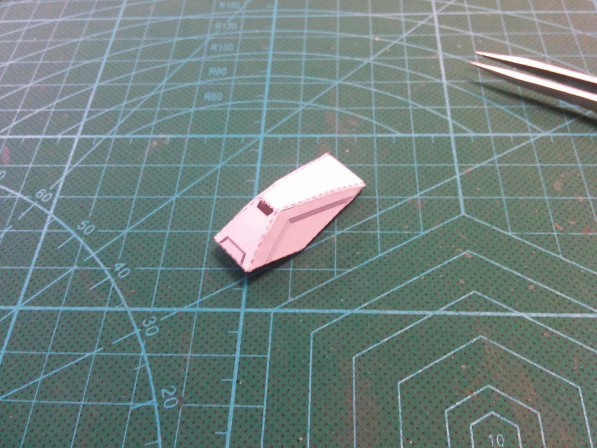

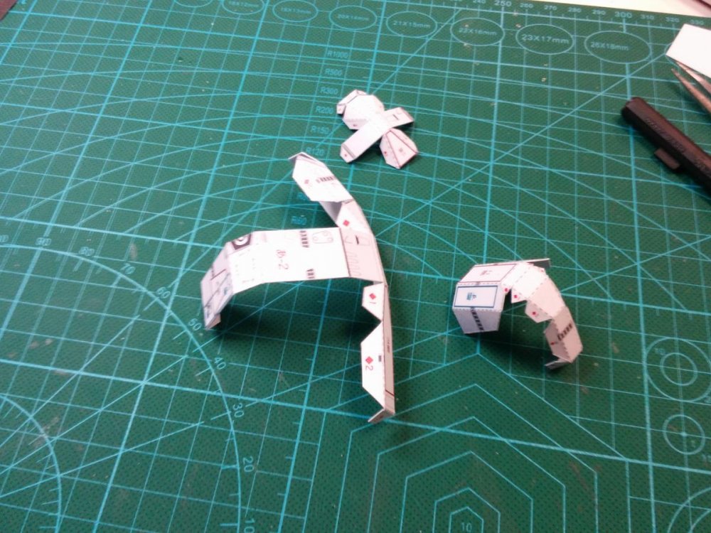

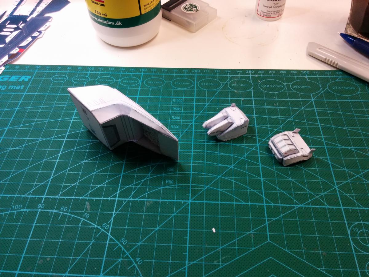

now these are pretty strait forward too...
post-14728-0-33071600-1427494368_thumb.jpg post-14728-0-74489100-1427494370_thumb.jpg
post-14728-0-94432900-1427494364_thumb.jpg post-14728-0-30368800-1427494373_thumb.jpg
post-14728-0-71539600-1427494375_thumb.jpg post-14728-0-33847000-1427494378_thumb.jpg
post-14728-0-62431200-1427494380_thumb.jpg post-14728-0-88887700-1427494382_thumb.jpg
post-14728-0-22499800-1427494385_thumb.jpg post-14728-0-76334100-1427494620_thumb.jpg
post-14728-0-00768300-1427494623_thumb.jpg post-14728-0-38927200-1427494630_thumb.jpg

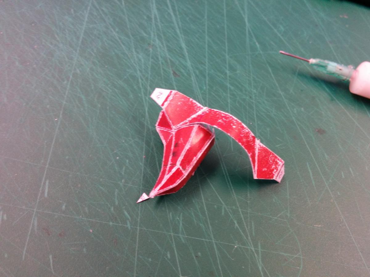

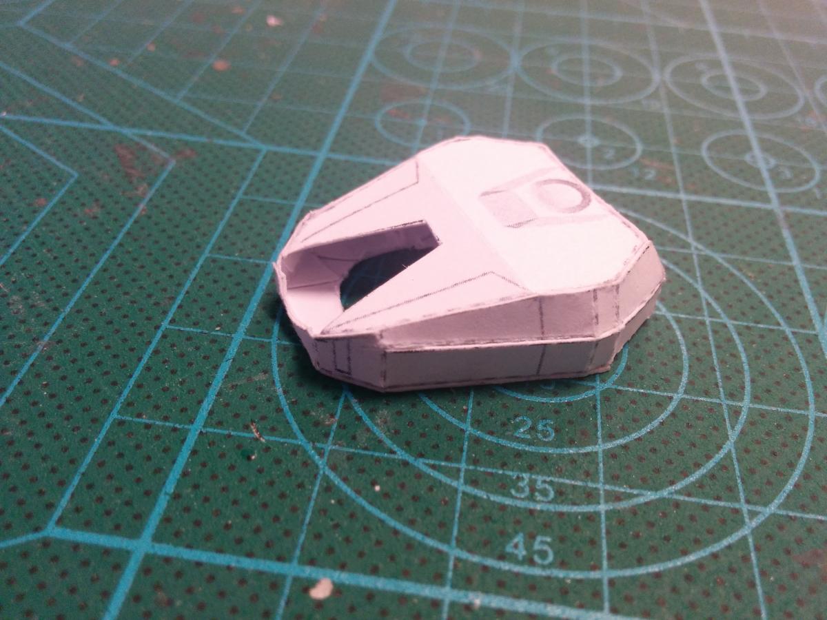

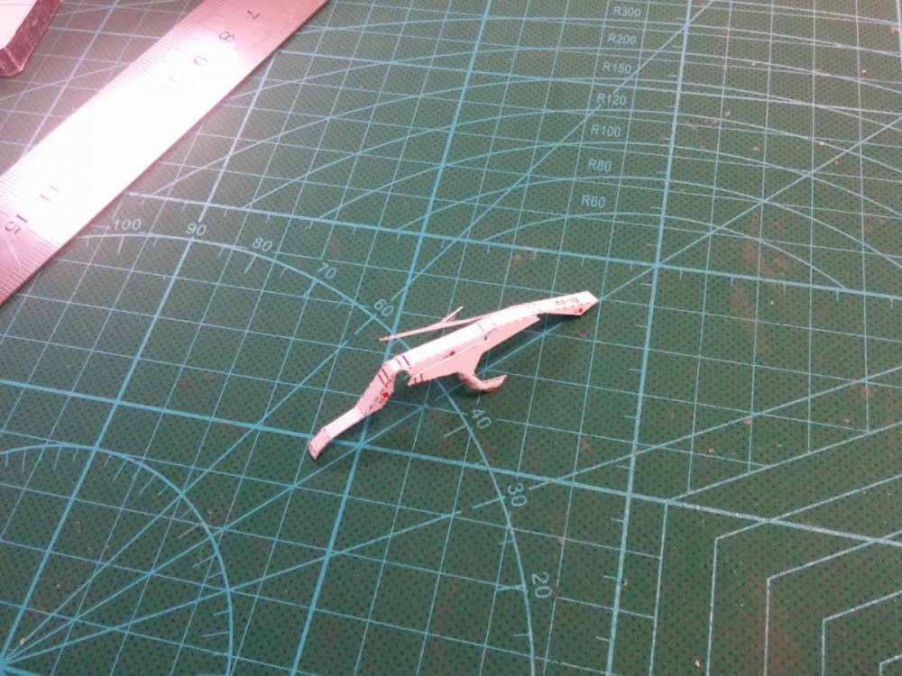

now the Gunsight 1 or Bridge im not to fond of, my preference would be a bit slimmer bridge...
the parts though are pretty easy to assemble...
post-14728-0-01679300-1427494617_thumb.jpg post-14728-0-57543000-1427494625_thumb.jpg
now the Battlefield scanner disc is just easy to add some more "flesh" too just add some cardboard in between the 2 disc pieces...

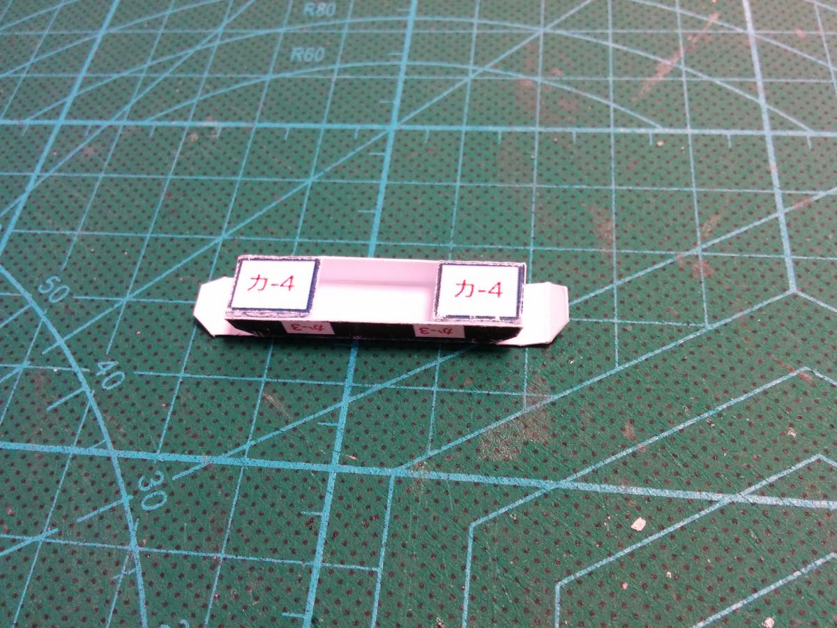

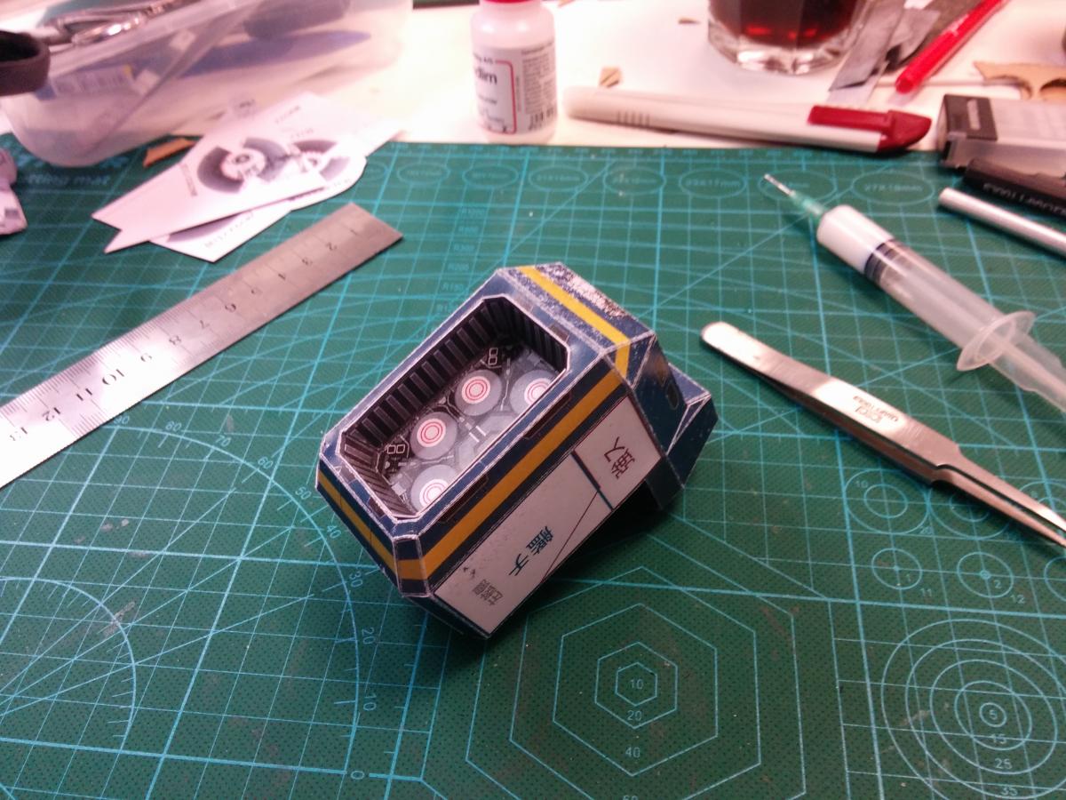

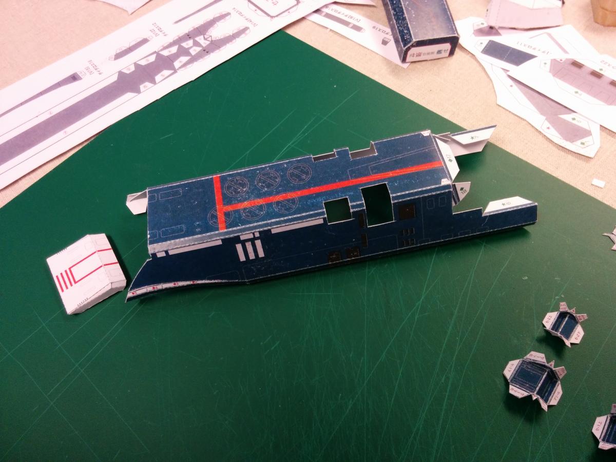

ok yet another update ^_^

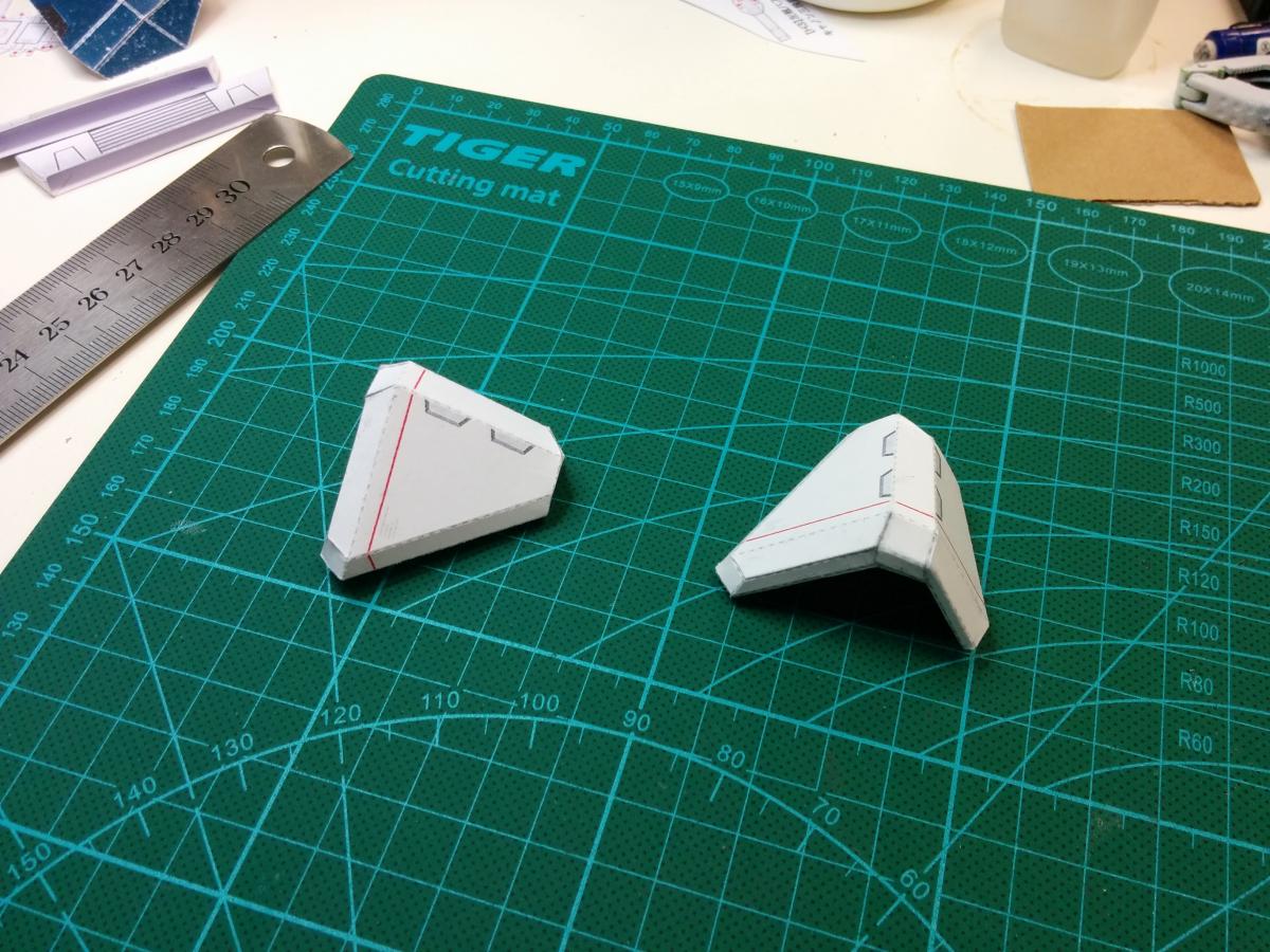

now again these next parts shouldnt pose ant problems...
post-14728-0-15367200-1427752639_thumb.jpg post-14728-0-47342600-1427752642_thumb.jpg
post-14728-0-67820200-1427752644_thumb.jpg post-14728-0-88442400-1427752646_thumb.jpg
post-14728-0-91557900-1427752648_thumb.jpg post-14728-0-14452000-1427752651_thumb.jpg
_______________________________________________________________________________________

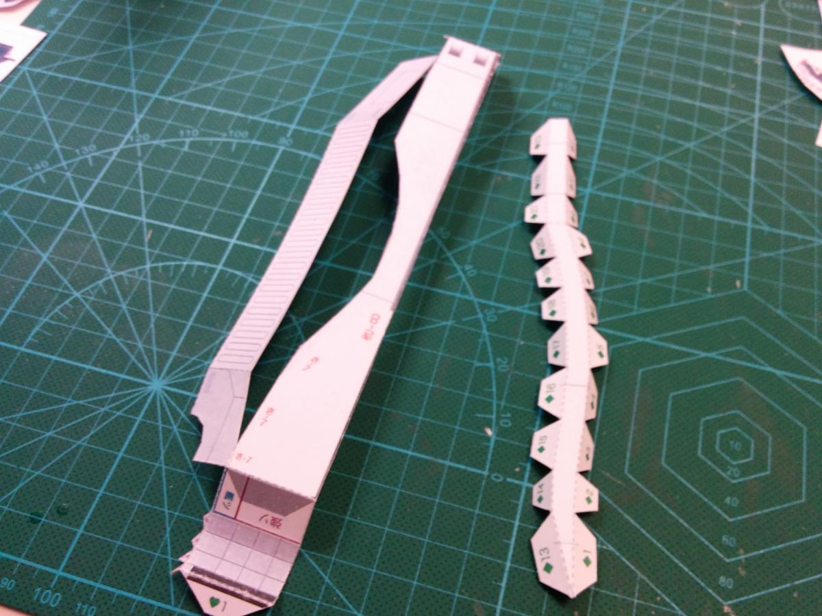

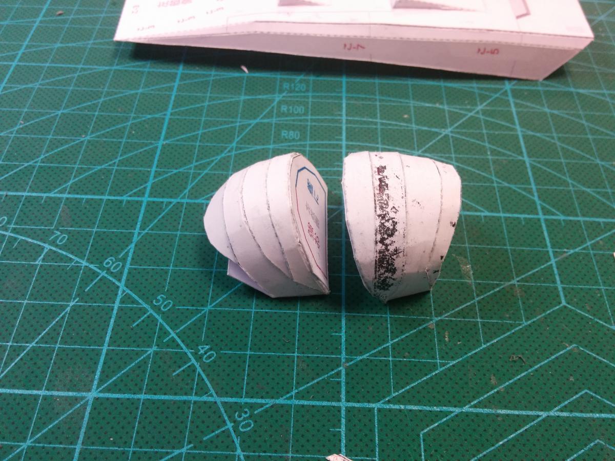

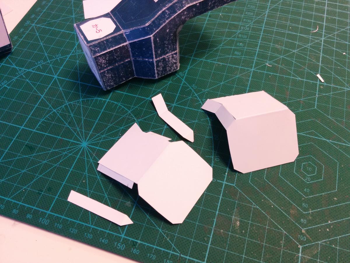

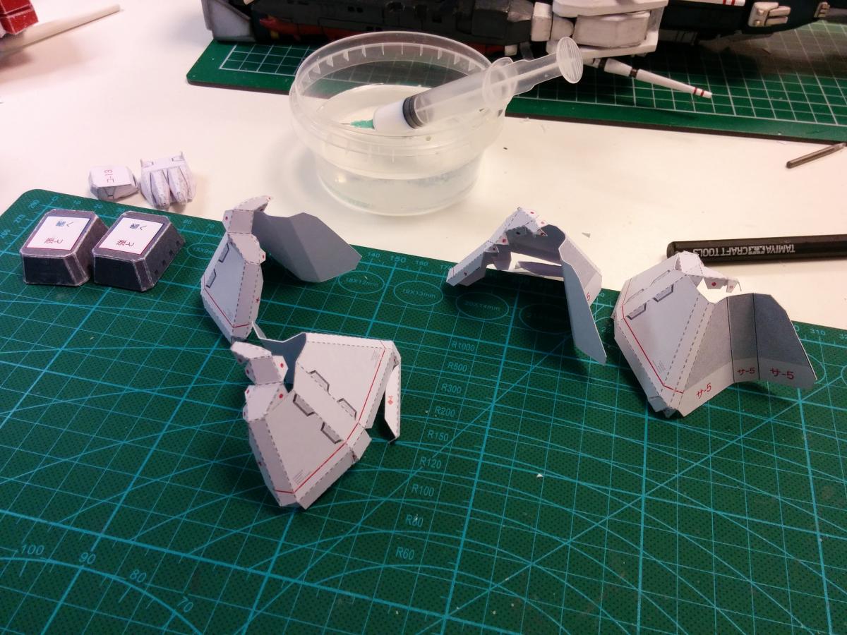

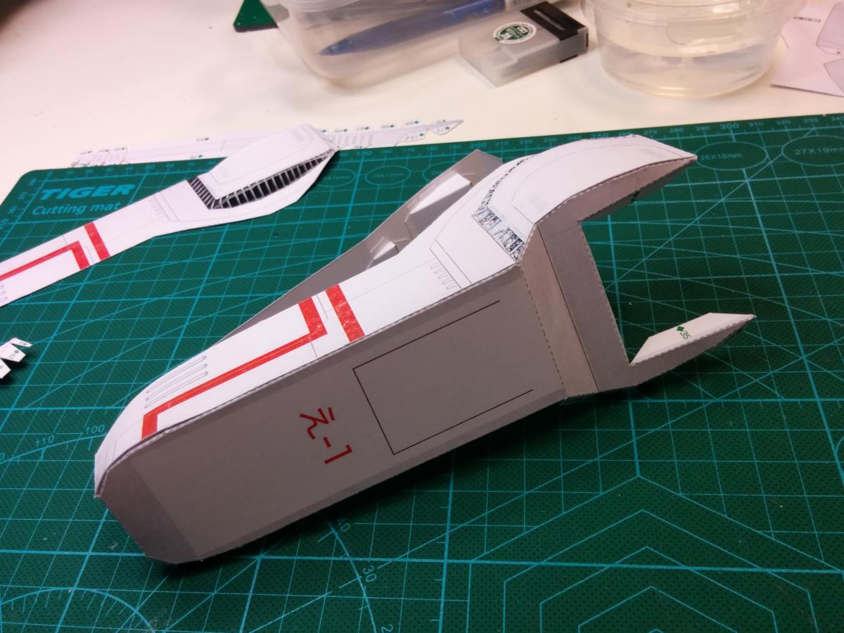

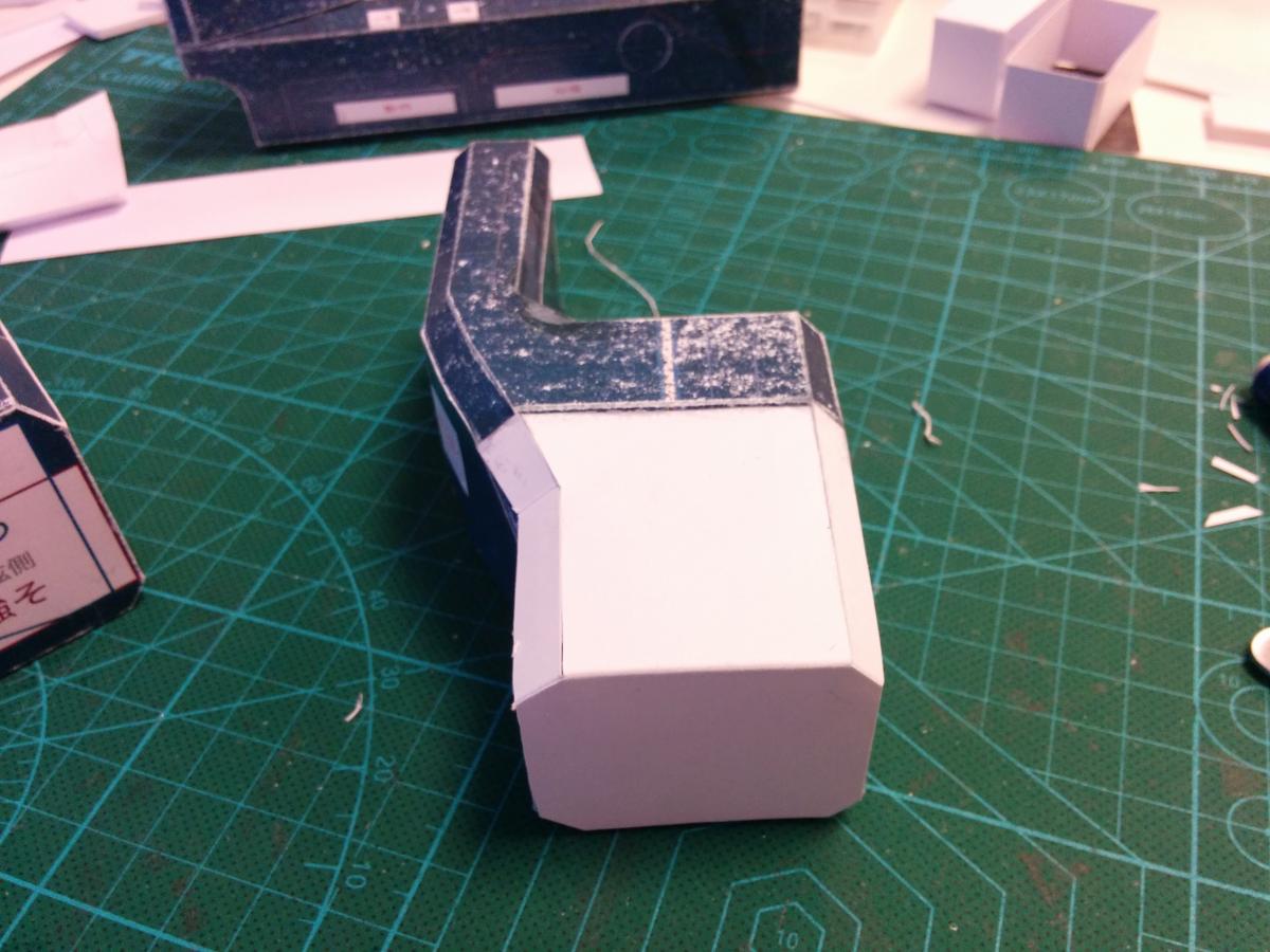

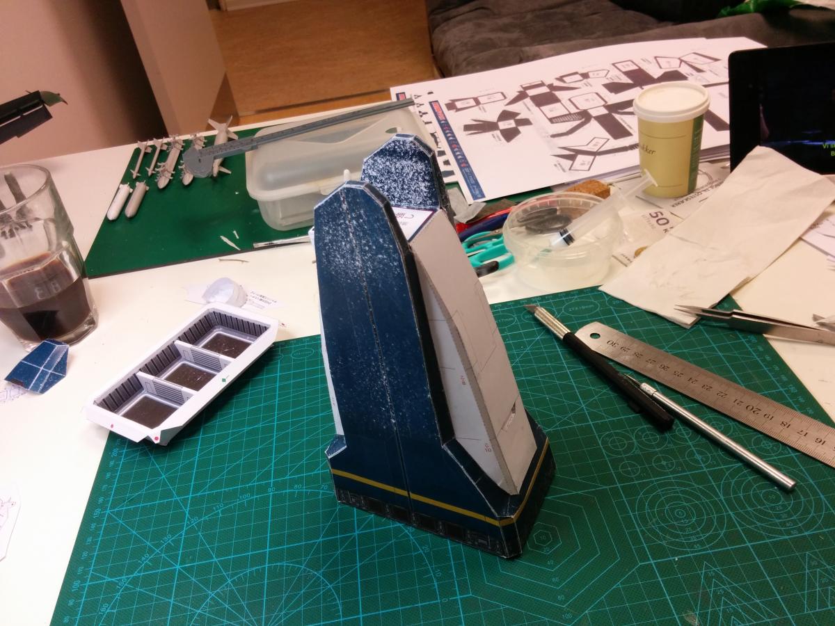

these next parts could be trouble for you guys.... :unsure:
the problem is in the paper.... especially thick paper!
when you bevel the paper before a fold you actually add a little width to the piece you are folding,
and the bottom piece (white part) has more folds and several parts in the width than the top part (blue)
it boils down to the two parts dont fit together in the width!!!
Remember to compensate for that!!! :ph34r:
post-14728-0-55138800-1427752657_thumb.jpg post-14728-0-64168500-1427752659_thumb.jpg
______________________________________________________________________________________________________

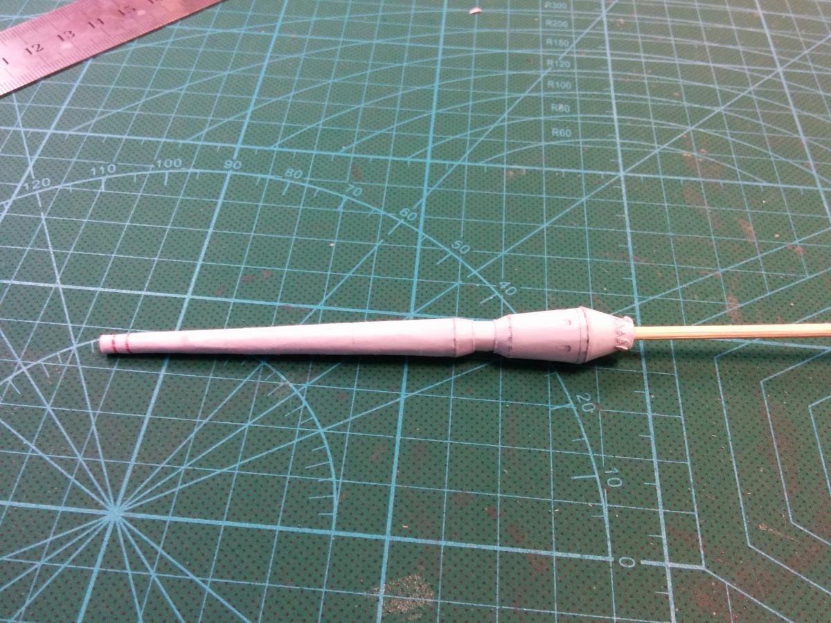

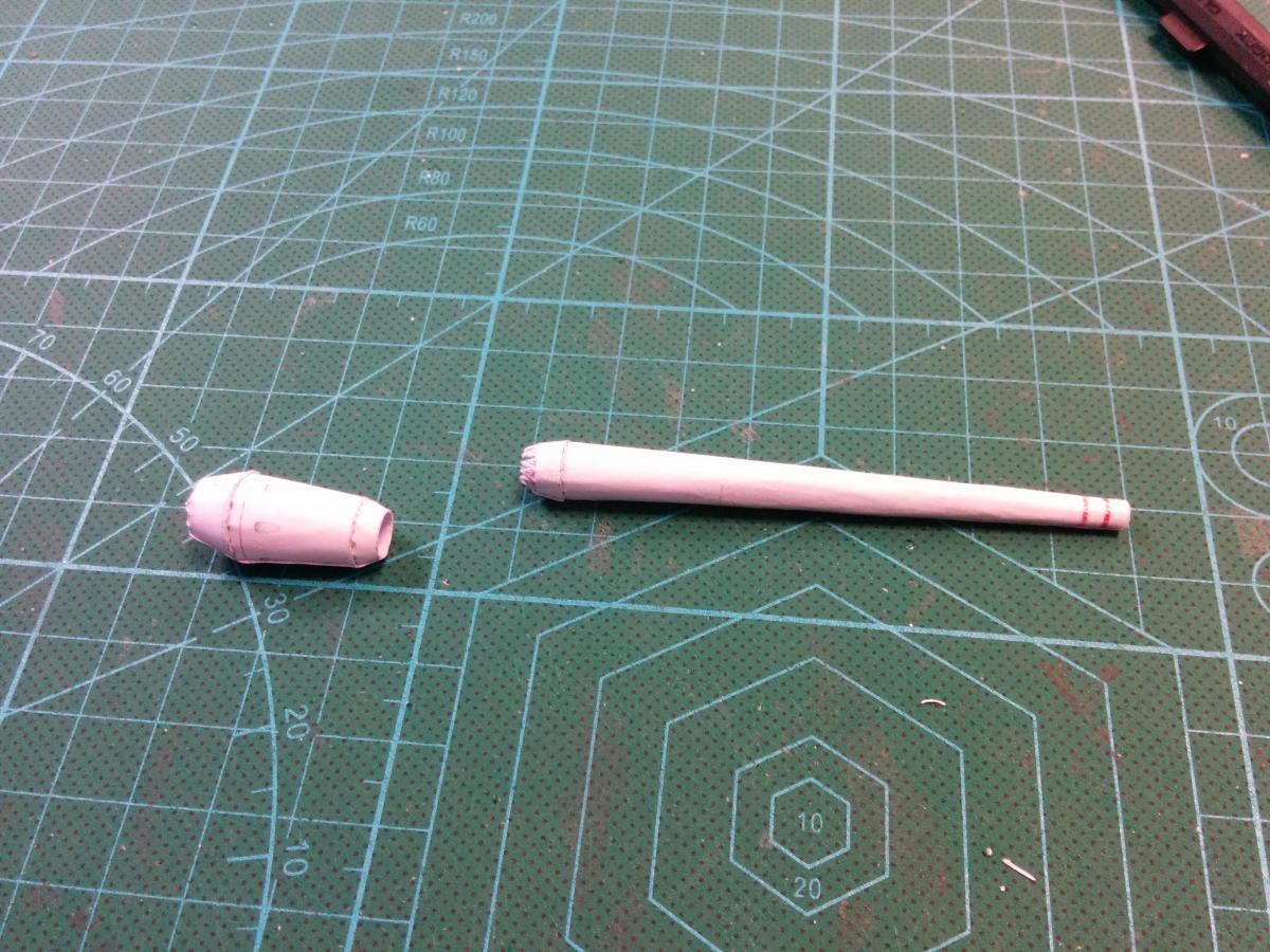

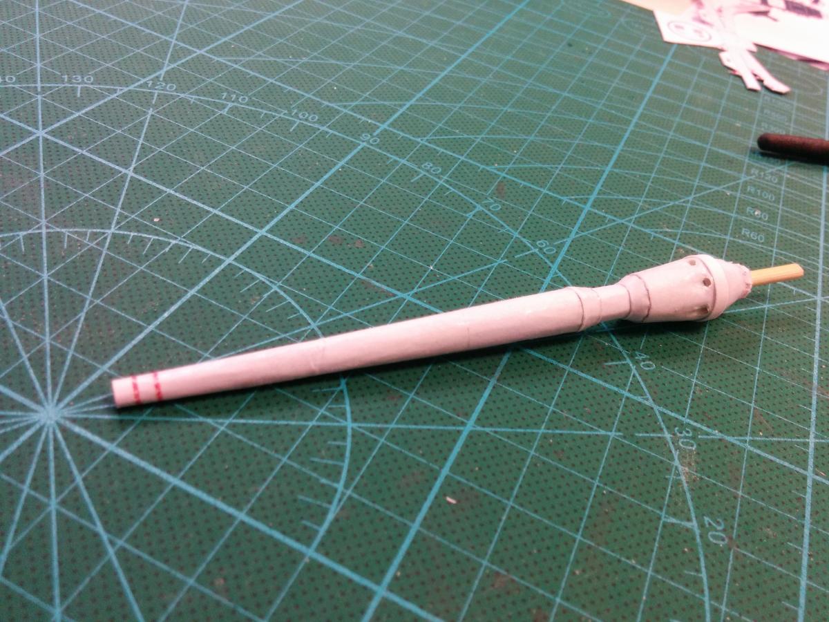

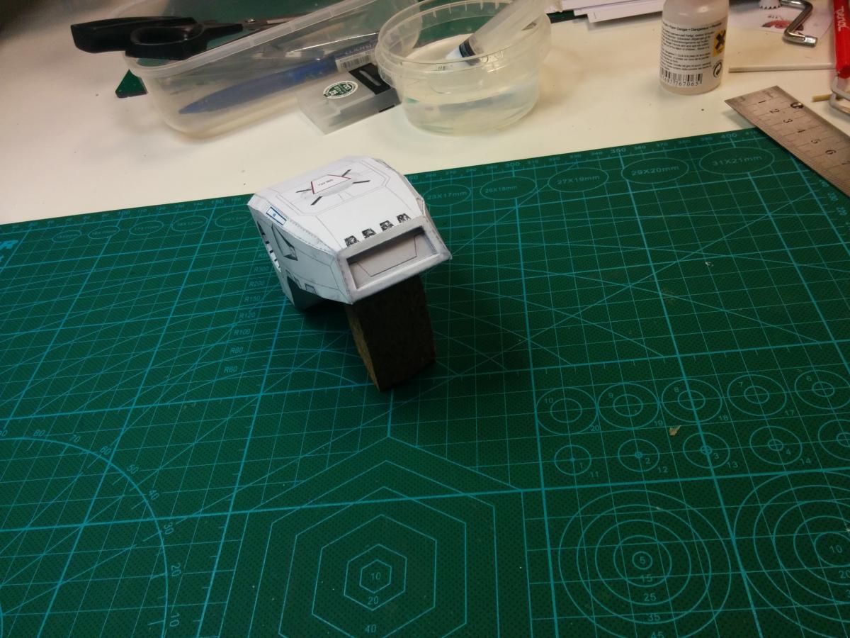

now the front of the macross cannon is pretty straight forward....
post-14728-0-49965400-1427752687_thumb.jpg post-14728-0-06761000-1427752691_thumb.jpg
next ones also shouldnt pose any problems...
post-14728-0-41746300-1427752693_thumb.jpg post-14728-0-79438300-1427752696_thumb.jpg
post-14728-0-42022800-1427752699_thumb.jpg post-14728-0-83852300-1427752701_thumb.jpg
post-14728-0-38793300-1427752704_thumb.jpg post-14728-0-68556700-1427752706_thumb.jpg
post-14728-0-66927900-1427752708_thumb.jpg post-14728-0-80036300-1427752710_thumb.jpg
more to come soon!

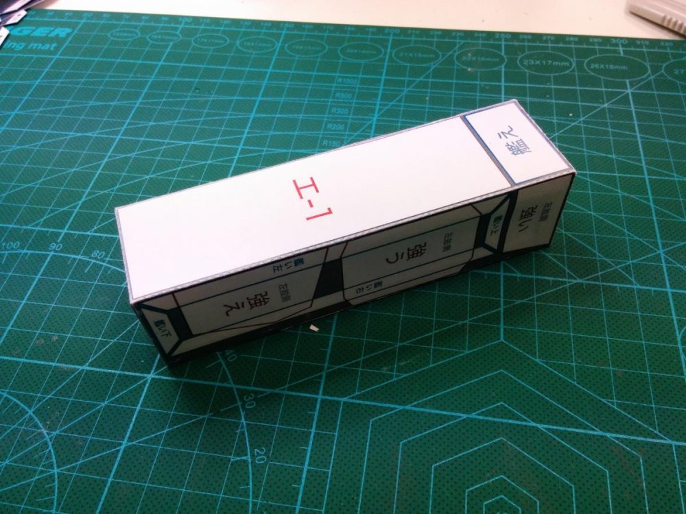

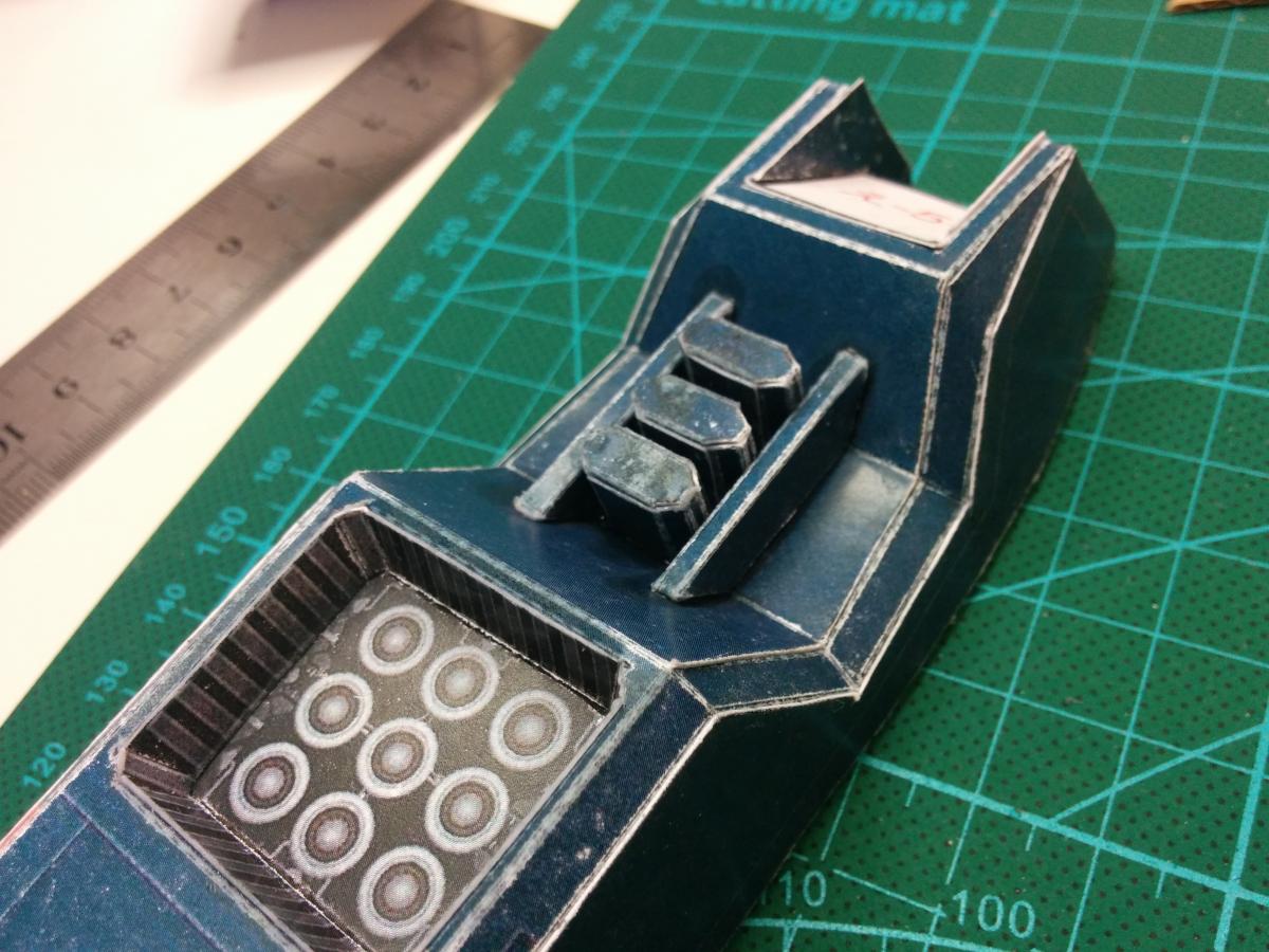

more parts are done...
post-14728-0-77070100-1427836795_thumb.jpg post-14728-0-89110600-1427836798_thumb.jpg
post-14728-0-94427700-1427836800_thumb.jpg post-14728-0-03571300-1427836803_thumb.jpg
post-14728-0-27822600-1427836805_thumb.jpg post-14728-0-44262300-1427836807_thumb.jpg
post-14728-0-64685800-1427836809_thumb.jpg post-14728-0-09647500-1427836813_thumb.jpg
post-14728-0-16873600-1427836815_thumb.jpg post-14728-0-22222000-1427836817_thumb.jpg
post-14728-0-99374000-1427836829_thumb.jpg post-14728-0-12859500-1427836833_thumb.jpg
i can hardly contain myself with all the detail im gonna add to this one.... :ph34r::p

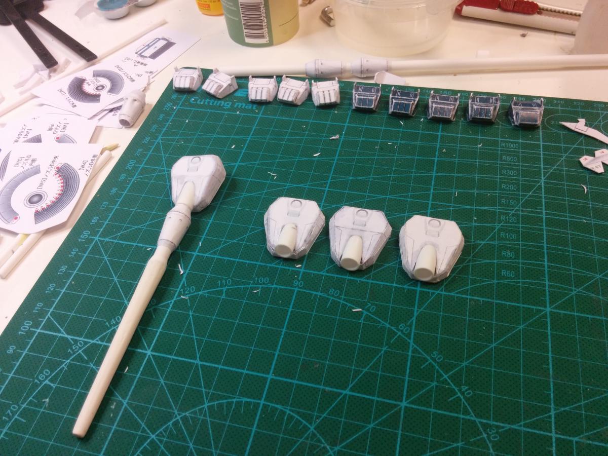

at last i have some more time to work on this....
and a little update!!
post-14728-0-32747900-1429472857_thumb.jpg post-14728-0-60611100-1429472860_thumb.jpg

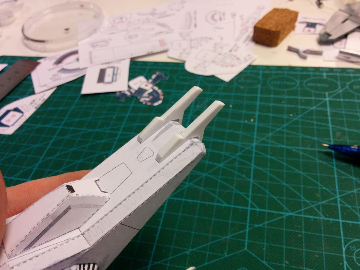

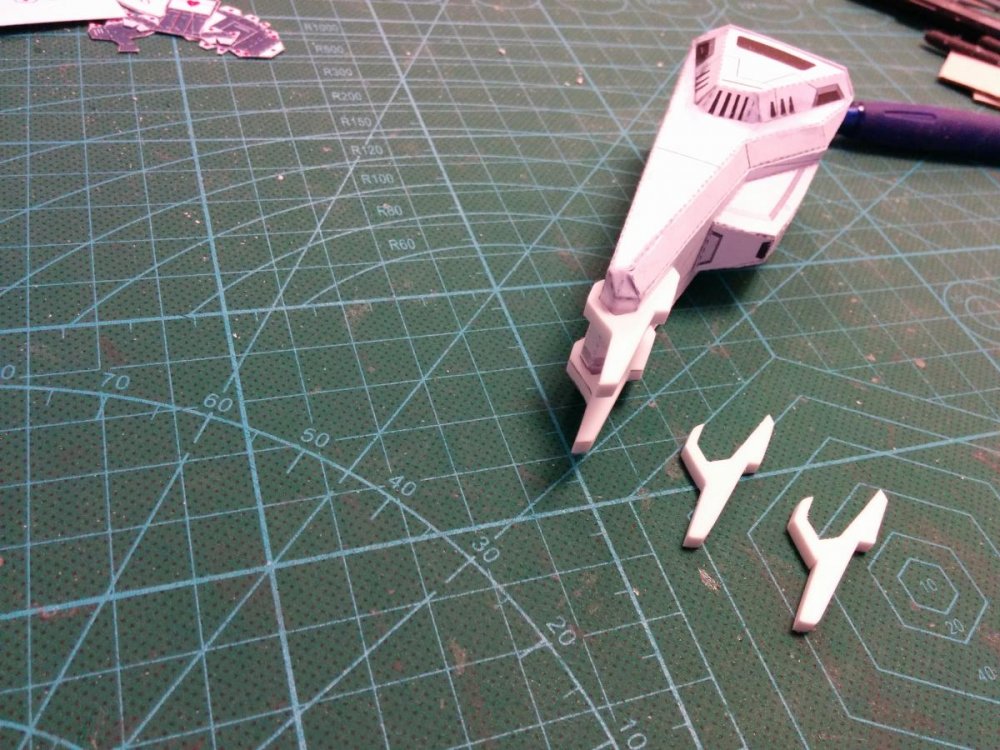

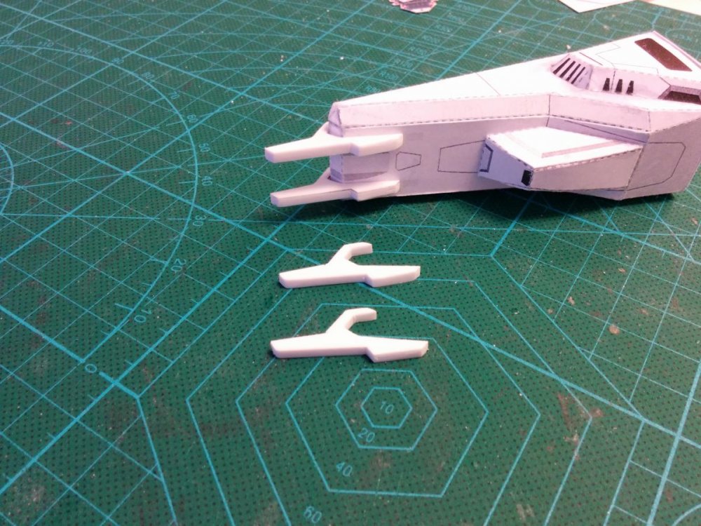

Decided to make the front "spikes" in styrene as part of my "upgrade" for this ship!
post-14728-0-35157900-1429472865_thumb.jpg post-14728-0-85718500-1429472867_thumb.jpg
post-14728-0-12716900-1429472870_thumb.jpg post-14728-0-13333700-1429472872_thumb.jpg

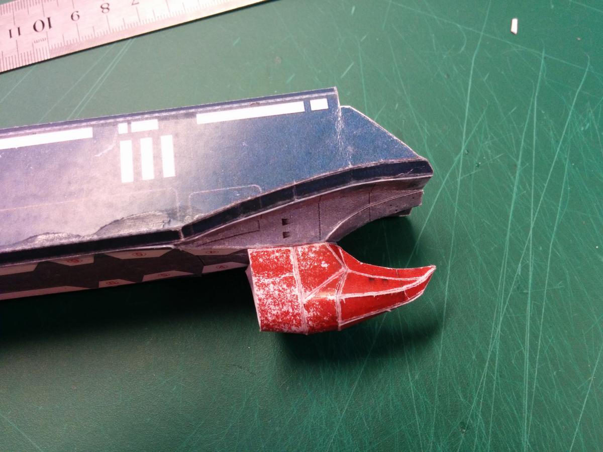

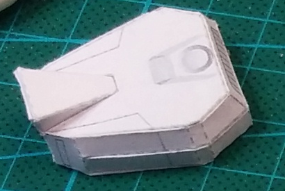

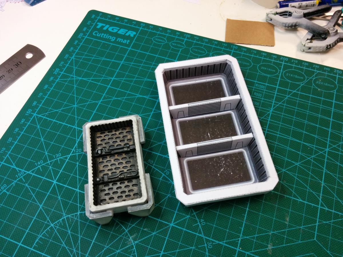

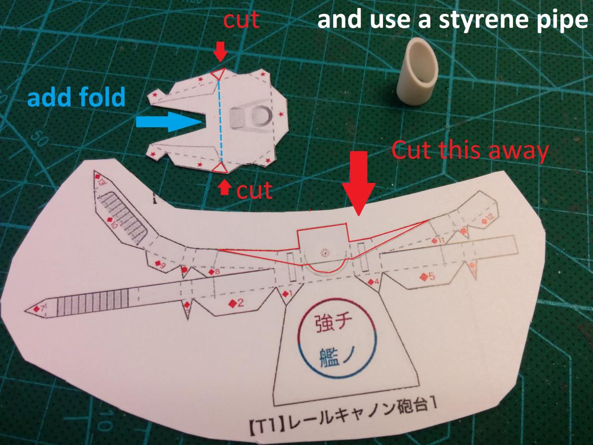

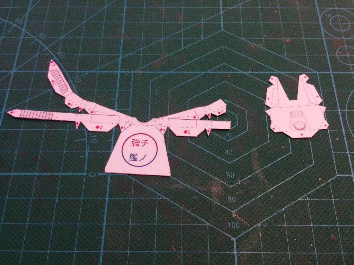

hi again!
this time im gonna show you a simple change!
didnt like the looks on these!!
so this is what i did!!
post-14728-0-09013200-1429735332_thumb.jpg post-14728-0-68220400-1429734218_thumb.jpg
post-14728-0-53410700-1429734214_thumb.jpg post-14728-0-43784800-1429734212_thumb.jpg
those of you who is building this ship or have plans to build it
are welcome to use what changes i make!

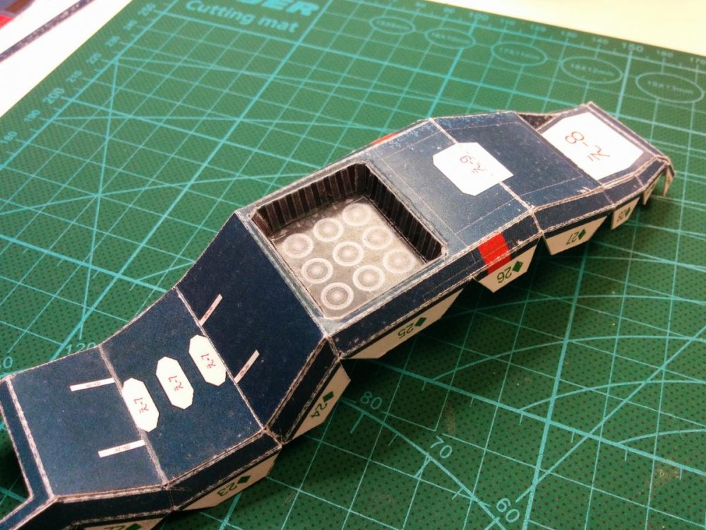

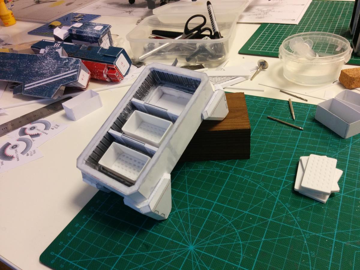

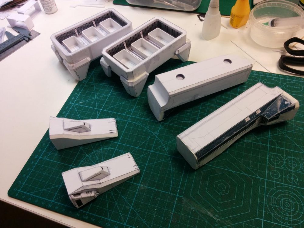

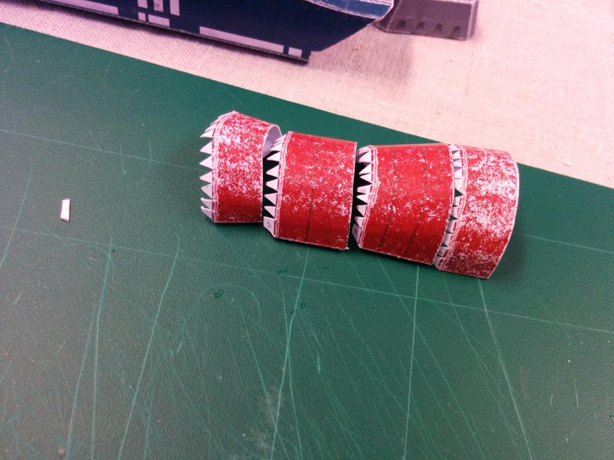

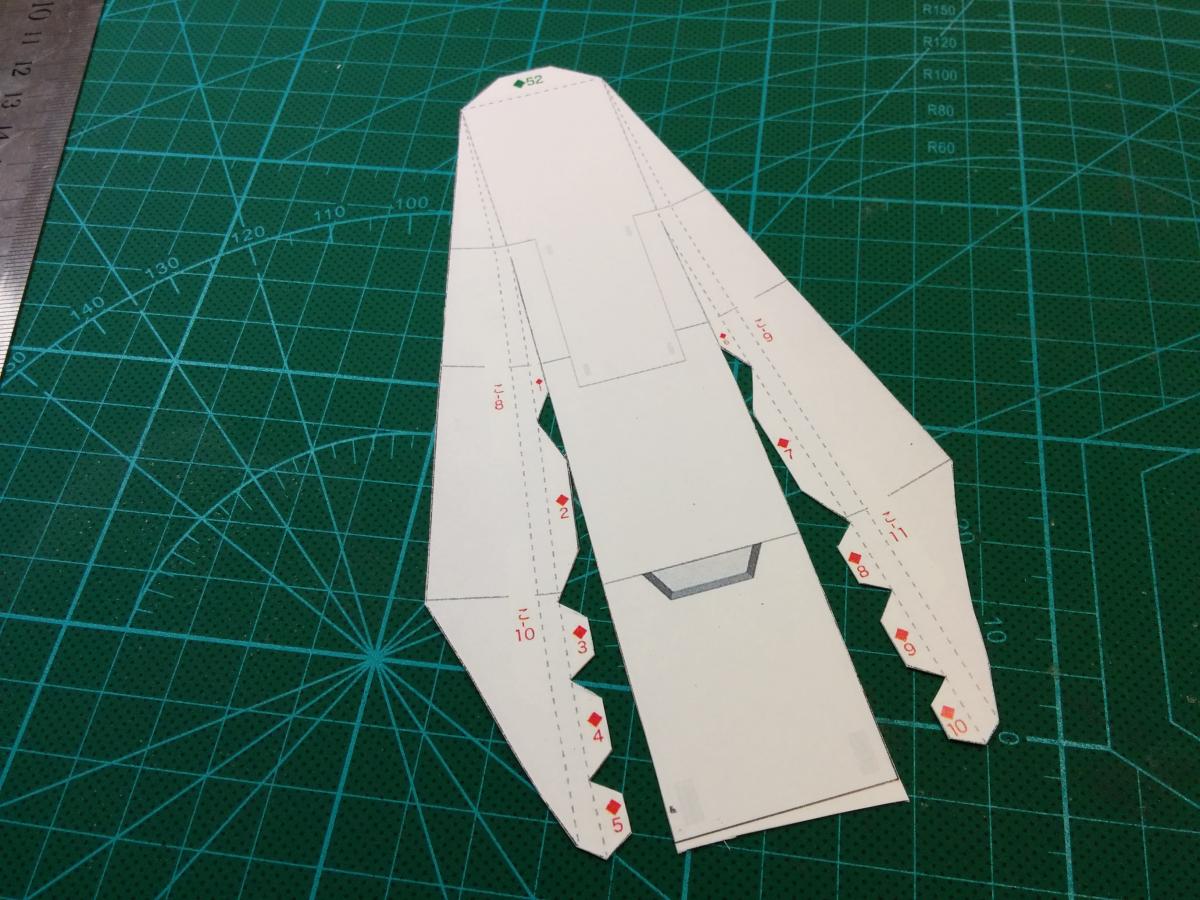

now not much left before assembly!!
post-14728-0-56482000-1430353800_thumb.jpg post-14728-0-62248100-1430353803_thumb.jpg
post-14728-0-66951300-1430353805_thumb.jpg post-14728-0-67212300-1430353807_thumb.jpg
post-14728-0-96946400-1430353810_thumb.jpg post-14728-0-96845200-1430353812_thumb.jpg

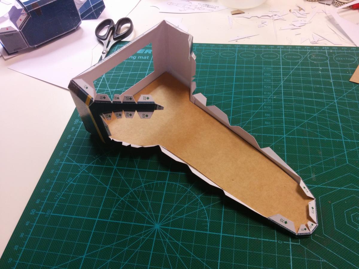

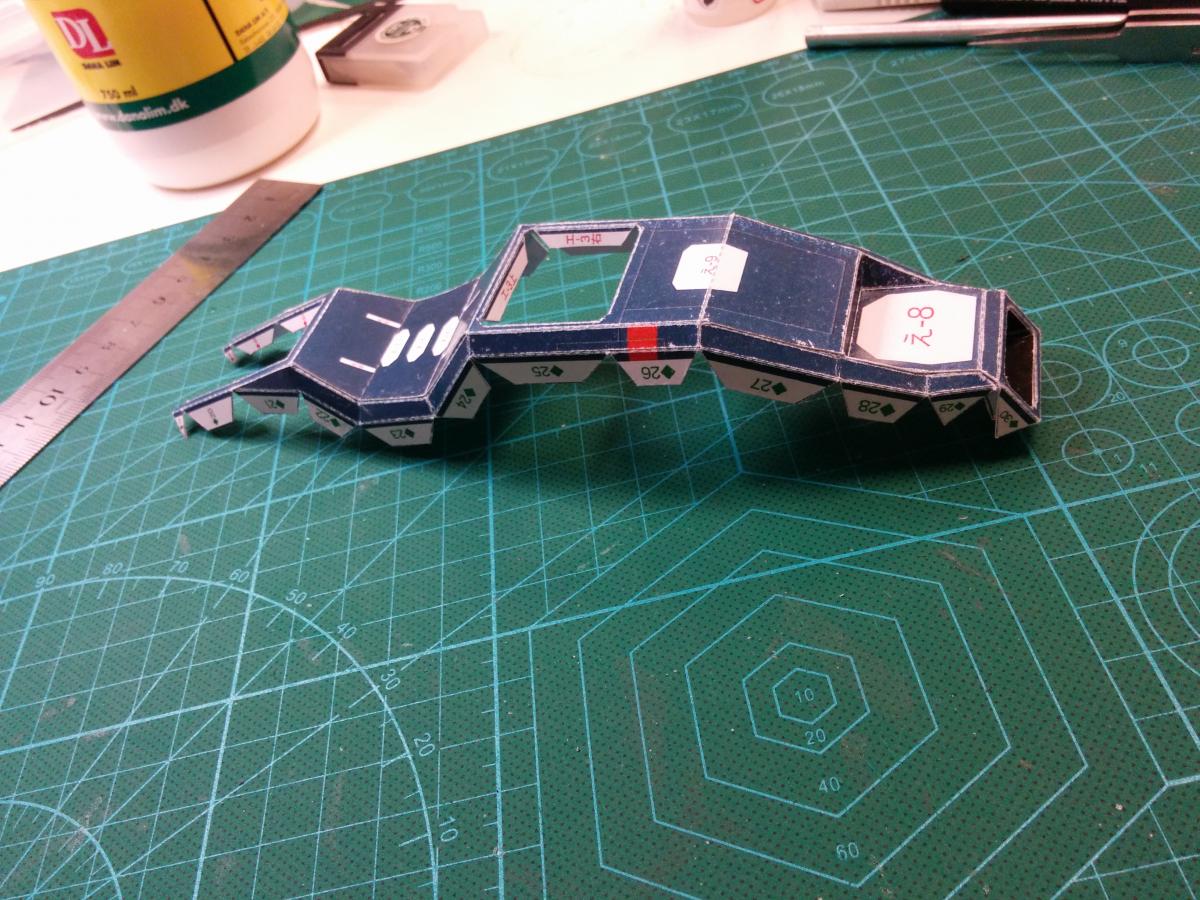

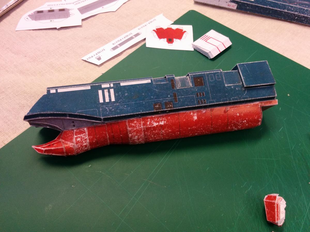

i devided the glue flaps into smaller ones for better roundness on the keel..
post-14728-0-34188300-1430353815_thumb.jpg post-14728-0-42310300-1430353817_thumb.jpg
post-14728-0-47097200-1430353819_thumb.jpg post-14728-0-47460700-1430353821_thumb.jpg
Nice job whipping that paper into shape!-MT

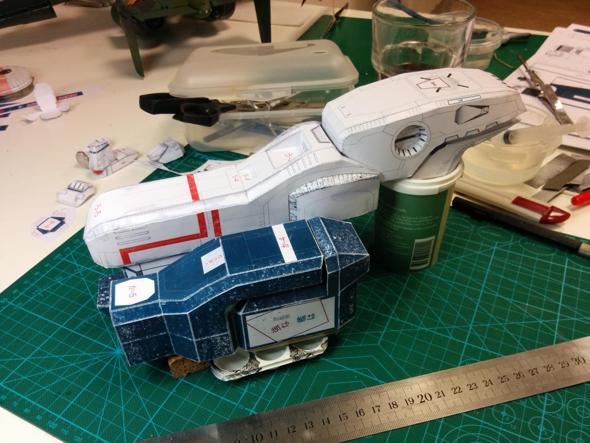

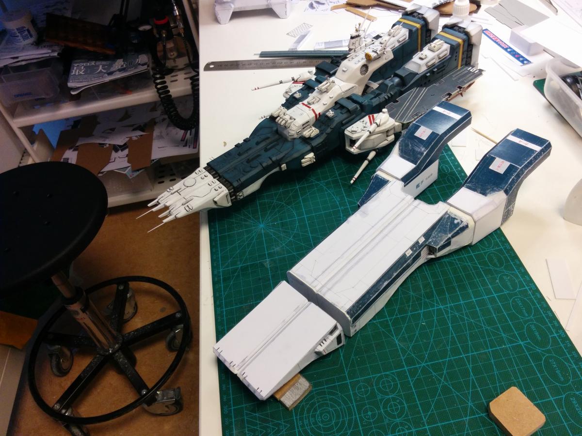

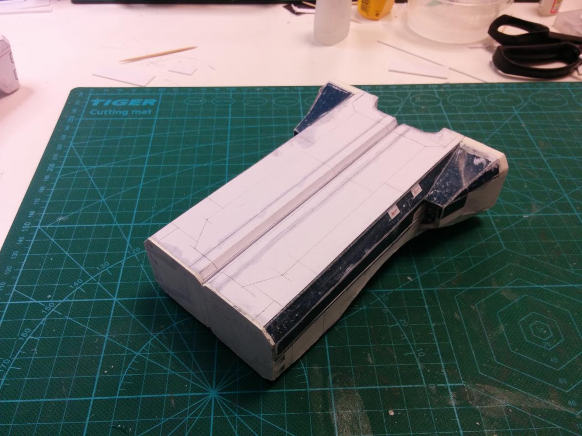

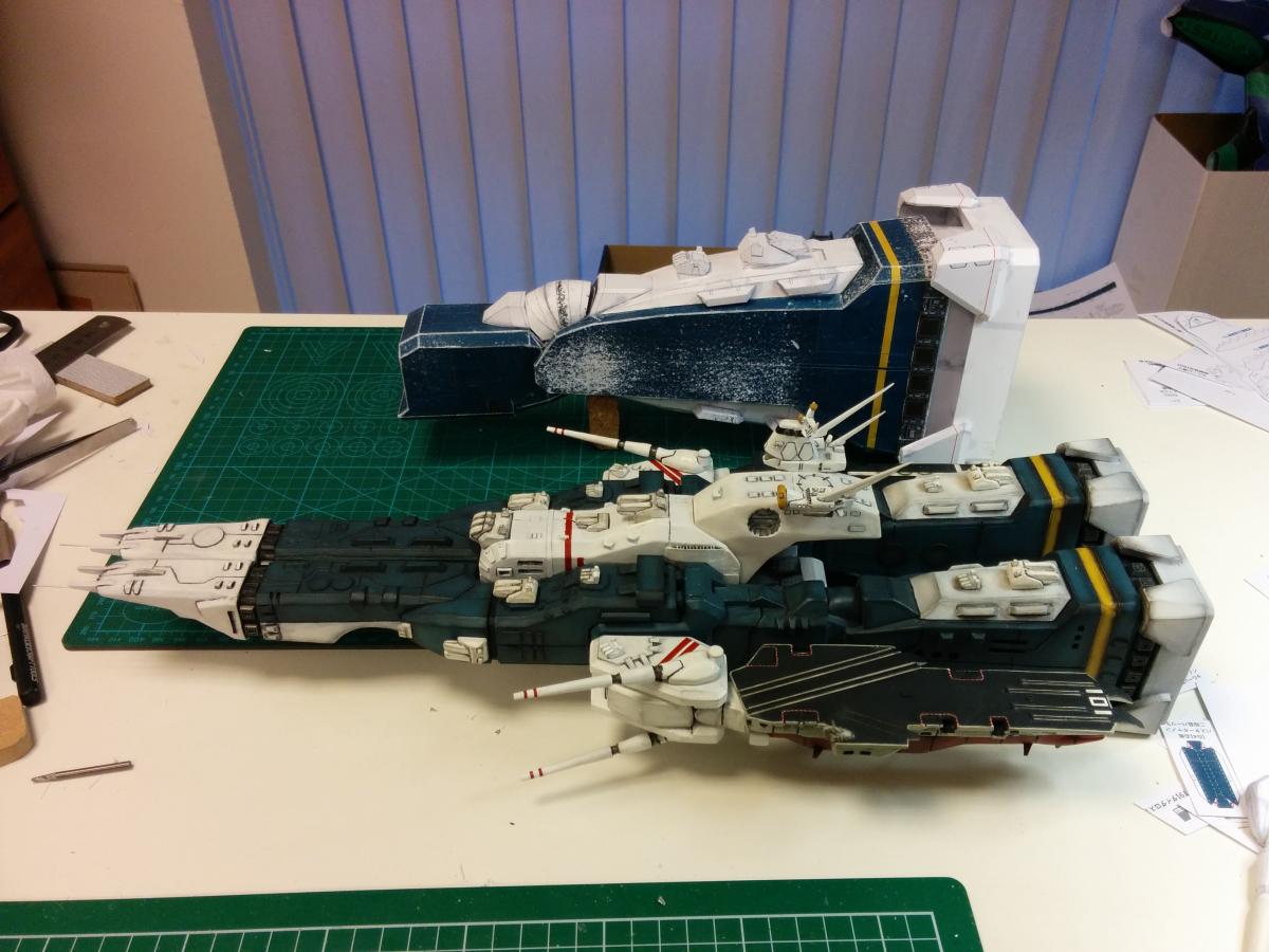

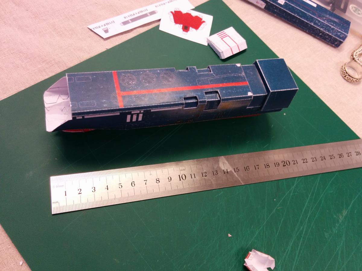

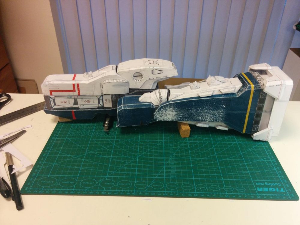

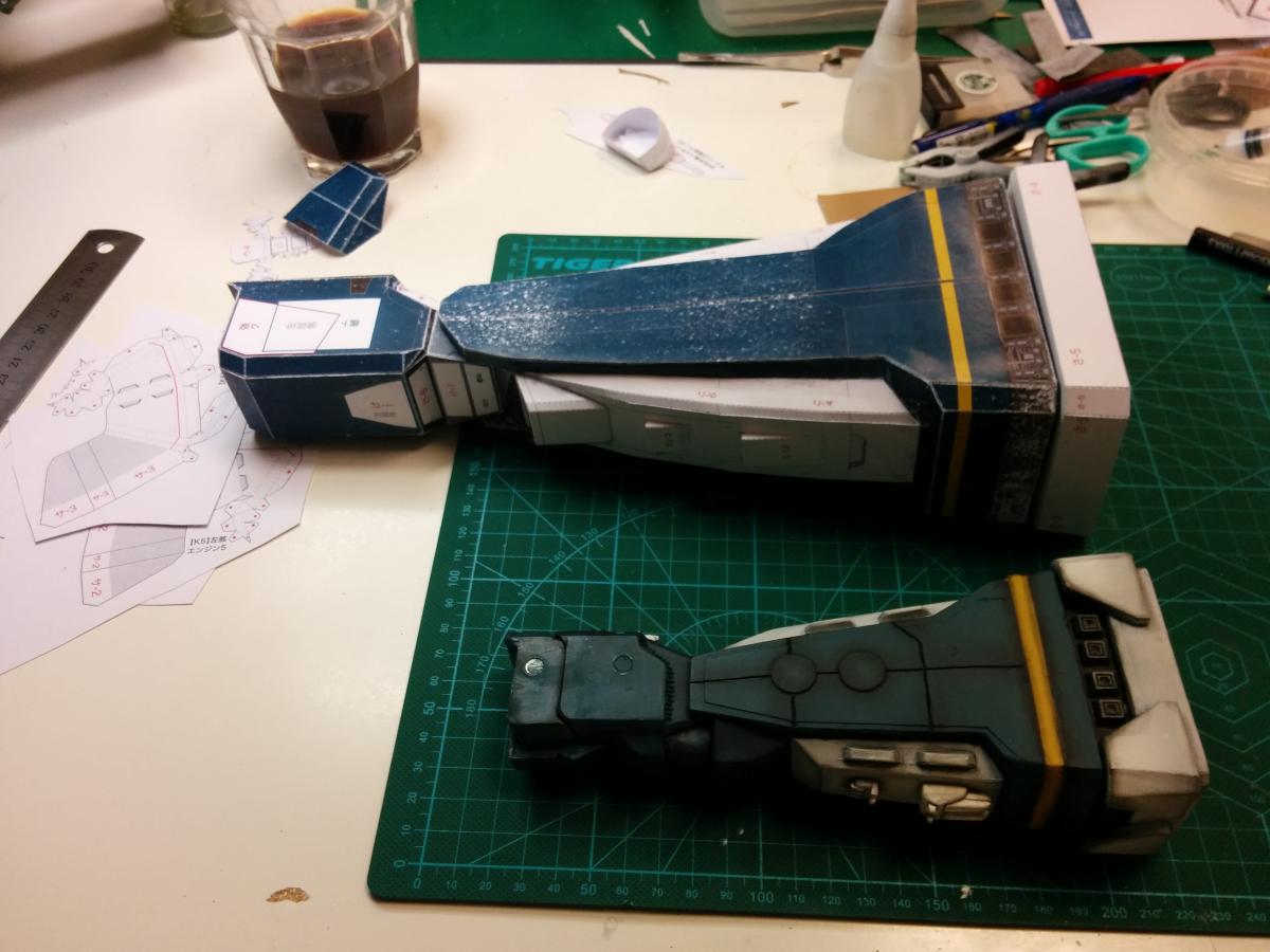

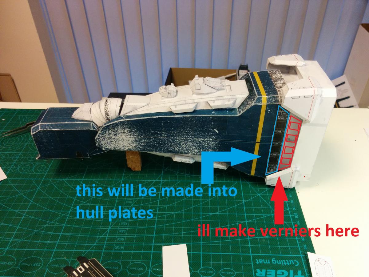

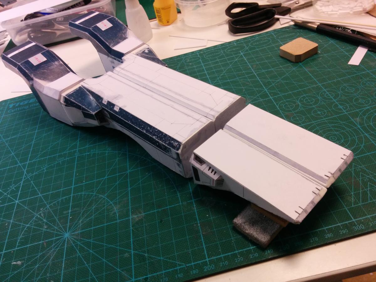

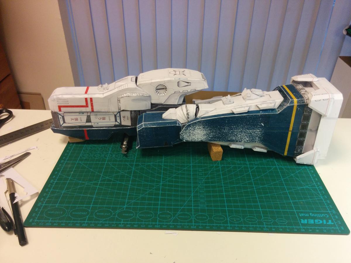

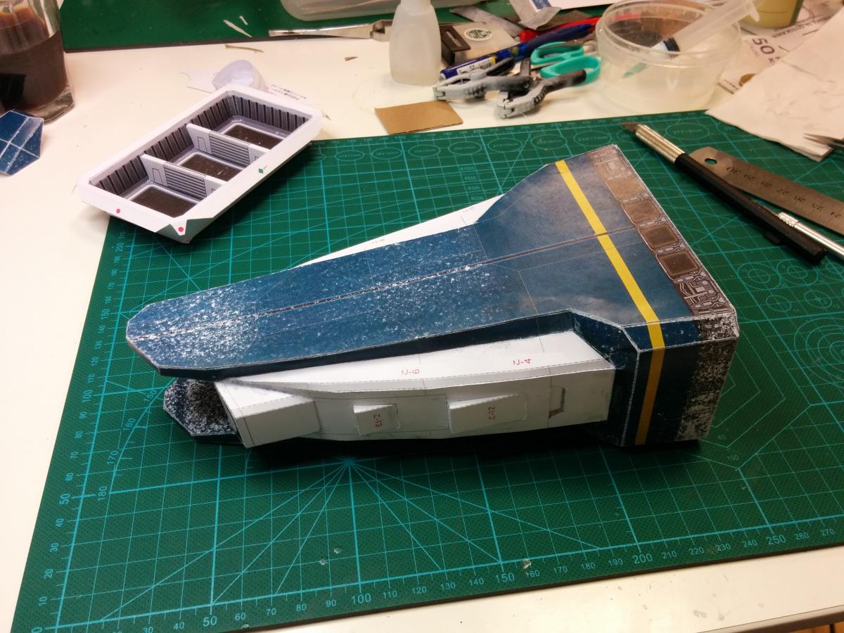

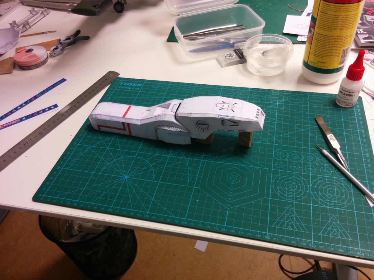

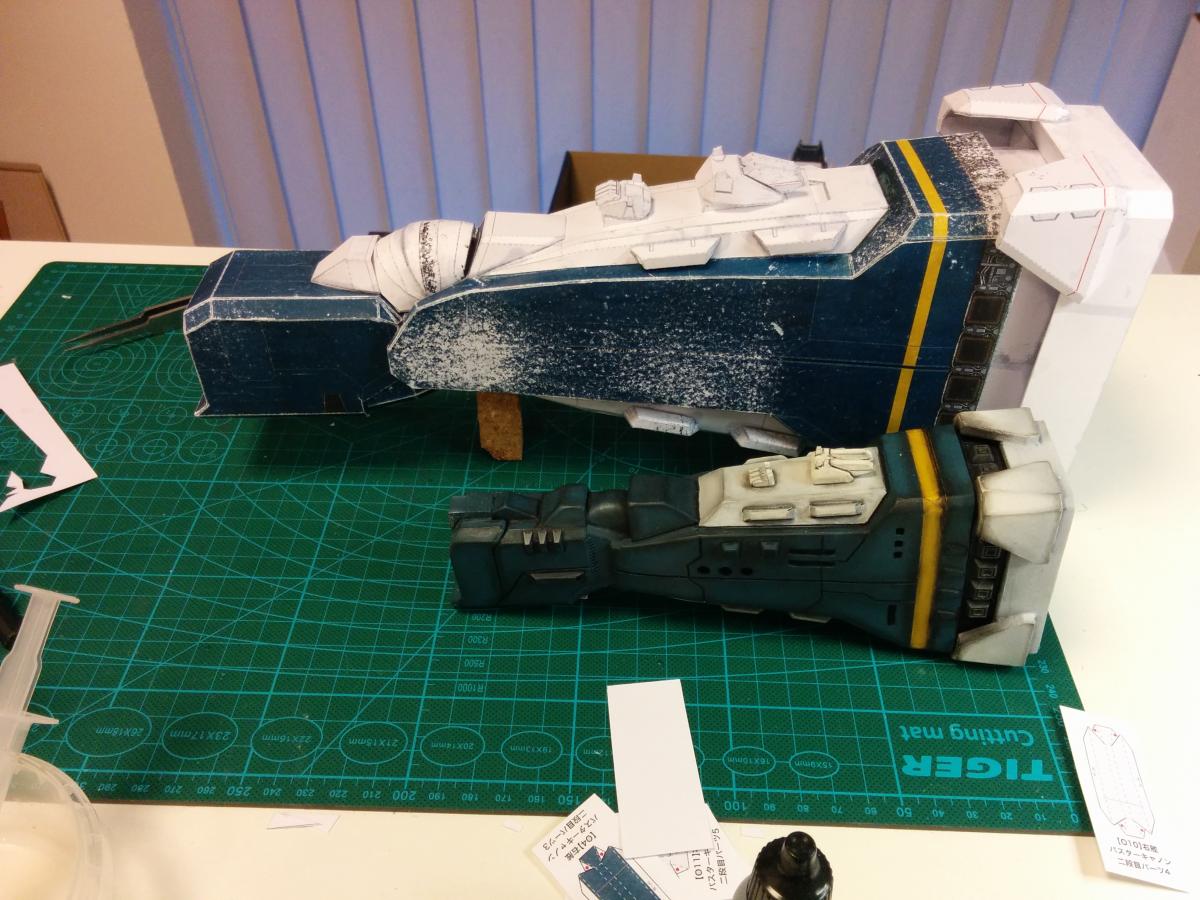

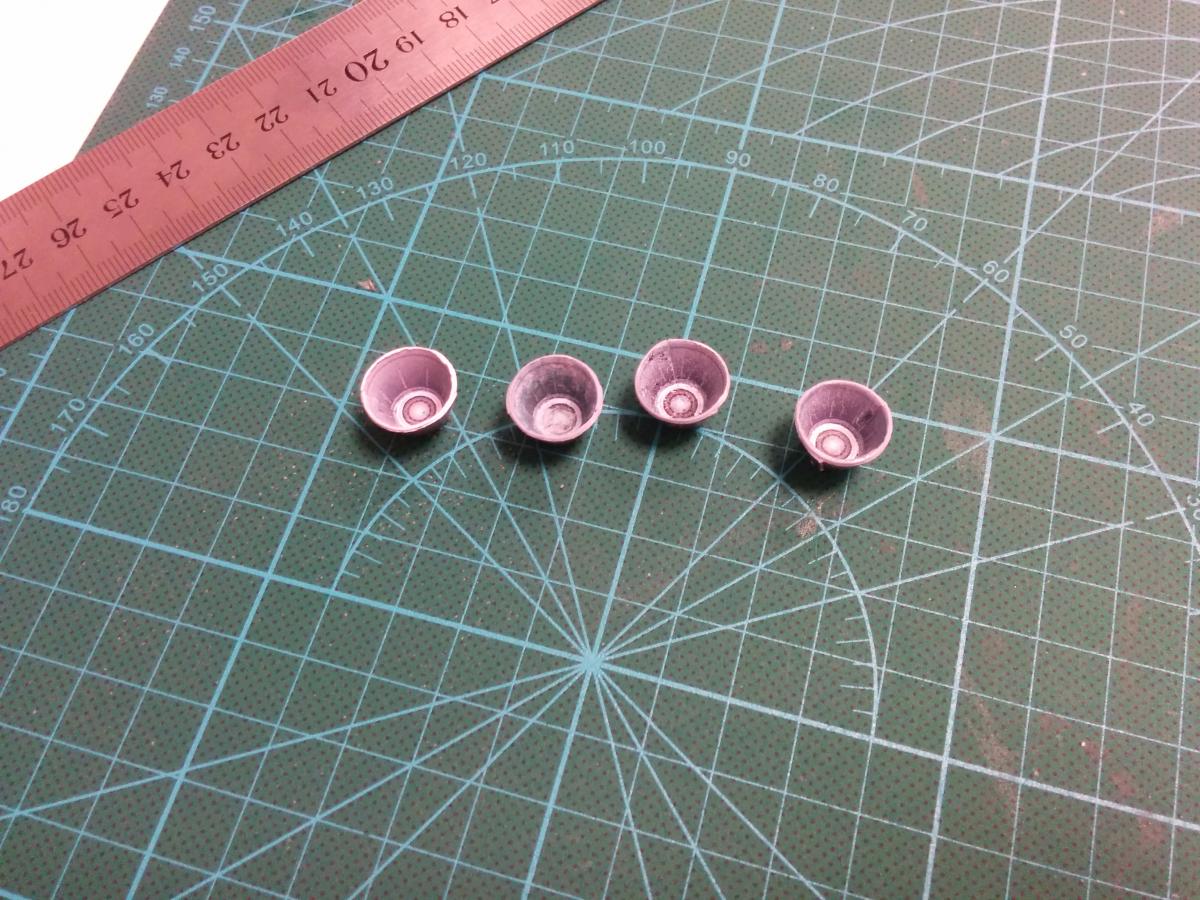

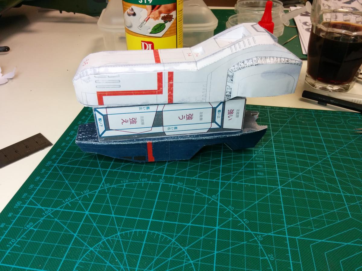

a little progress
with some already made alterations and some planned ones!
the thrust exhaust is made more wider...
in total, with room for verniers 2.6 cm
and some size comparison!
post-14728-0-95817000-1430947138_thumb.jpg post-14728-0-90122800-1430947140_thumb.jpg
thx learned a lot from my previous build....
the more narrow you make glue flaps, the more round you can make a object.

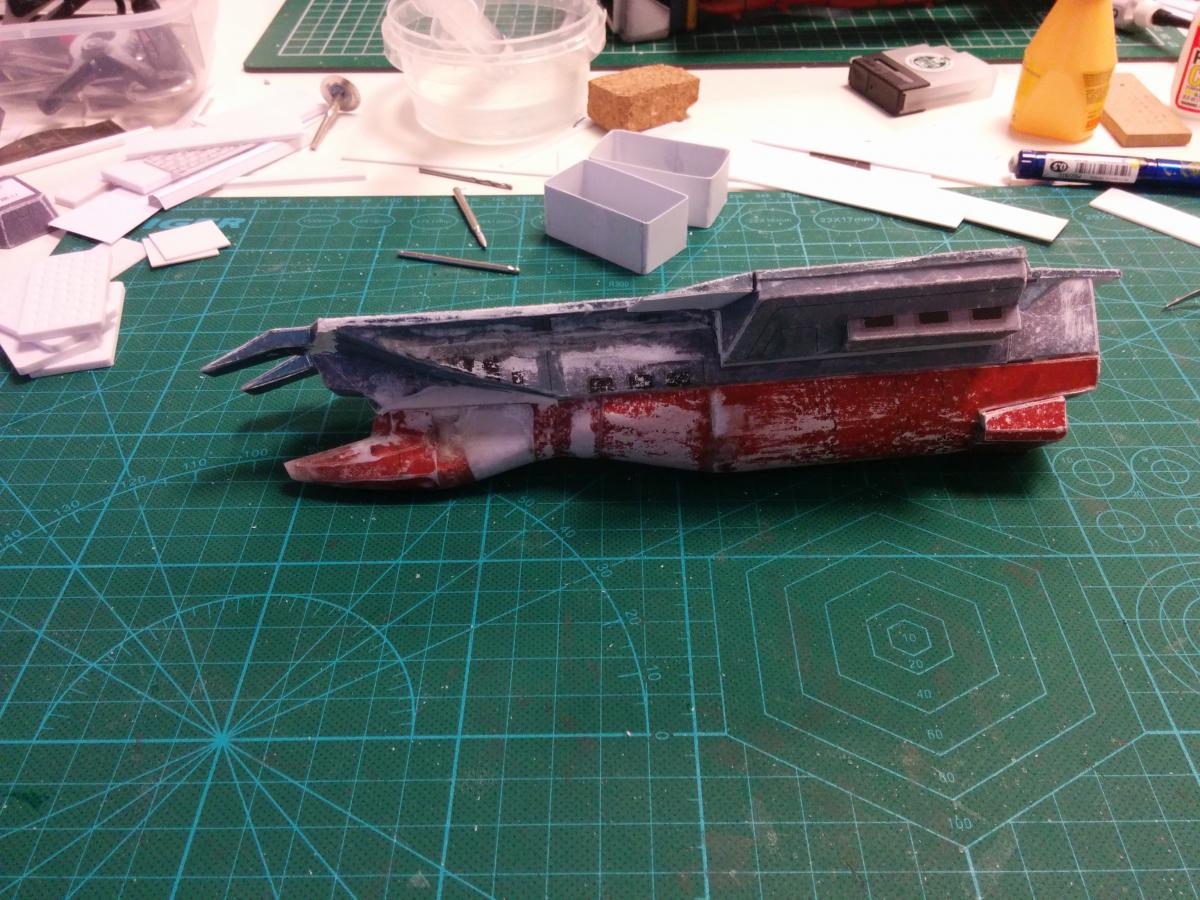

Why did you regret using a laser printer? If it's cuz the ink is rubbing off? It actually looks weathered.
well its not so much because it looks weathered, gonna paint it anyway...
The fold lines are missing in some places... which makes it kinda hard to figure out where exactly i need to fold...
the larger the piece the more precise the folds and cuts need to be...

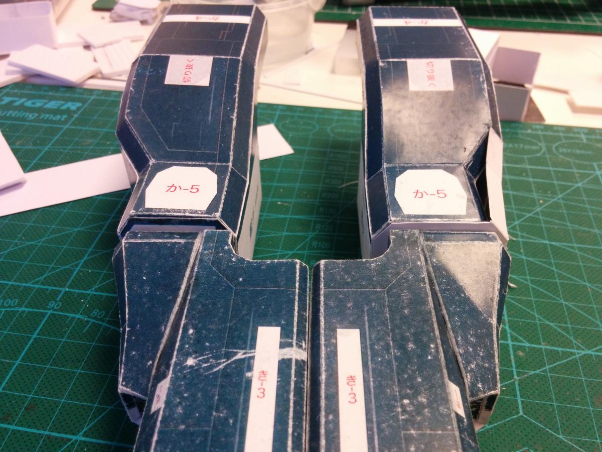

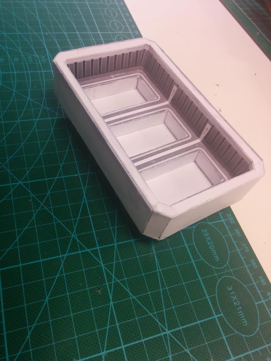

back again!

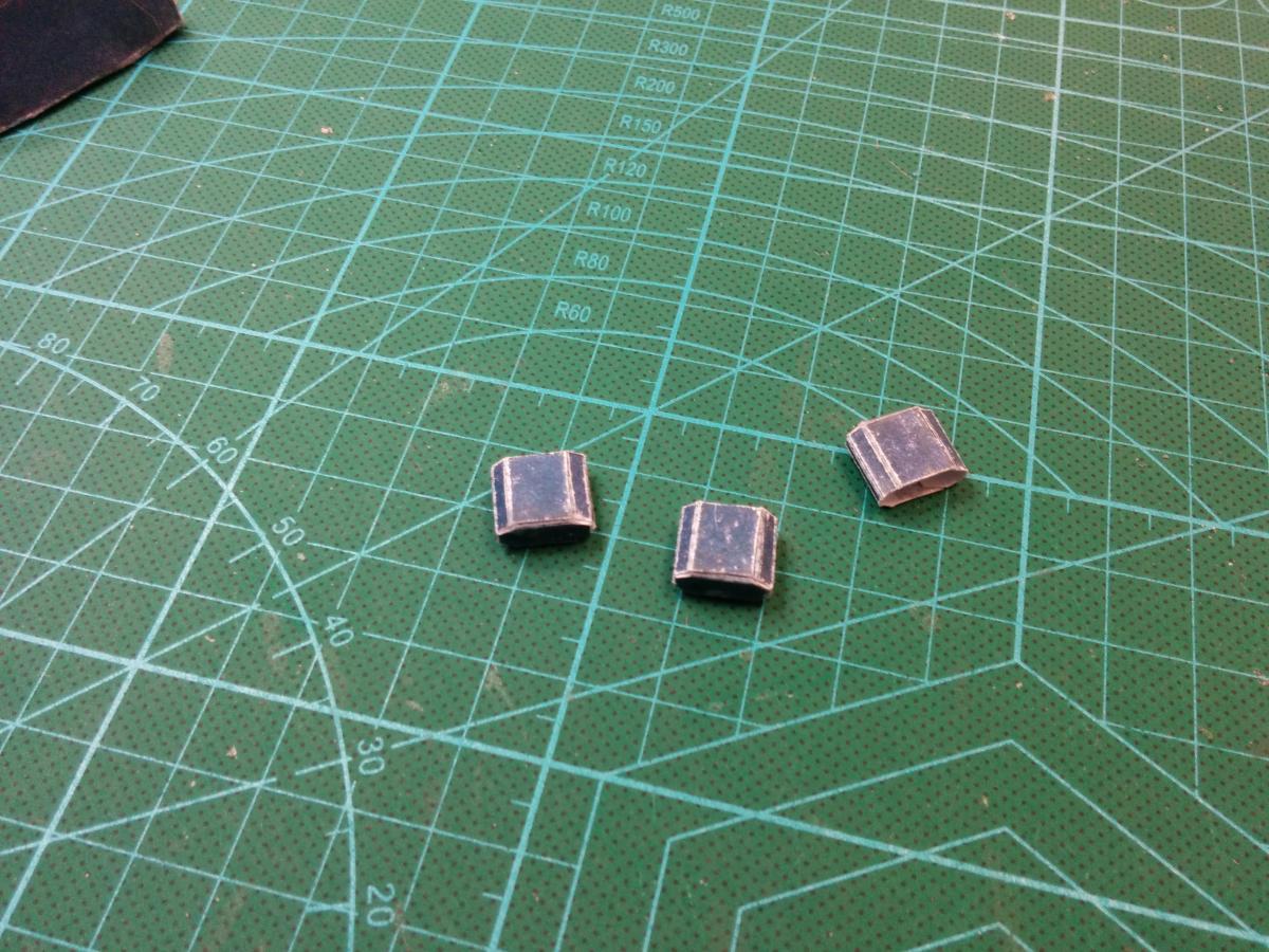

Ready for some glue xD
post-14728-0-14413400-1431549847_thumb.jpg post-14728-0-22542200-1431549850_thumb.jpg
made them a bit thicker to have them look like my old SDF-1, also made the holes deeper.

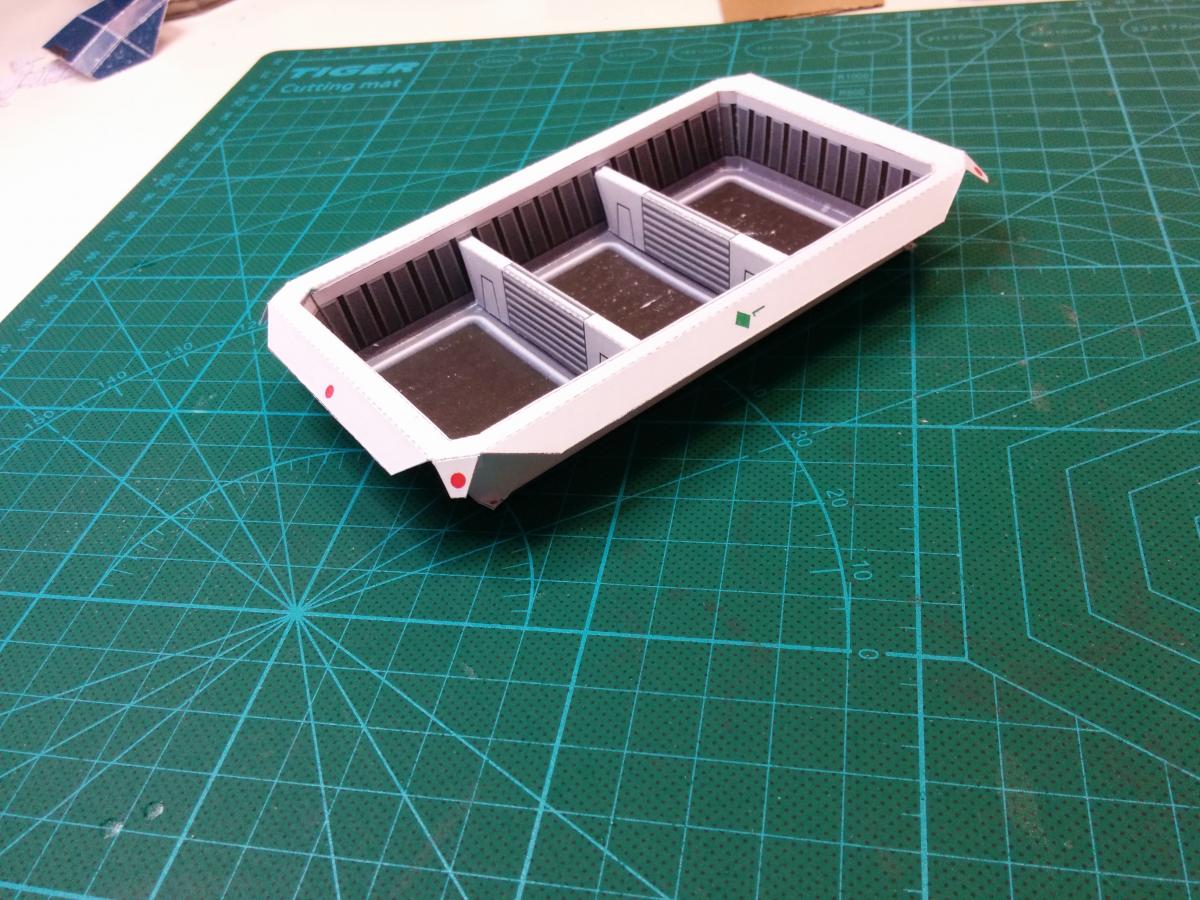

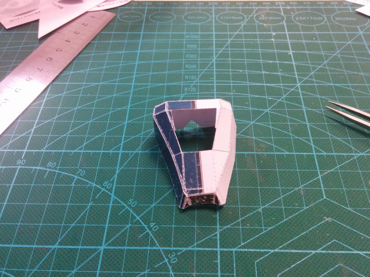

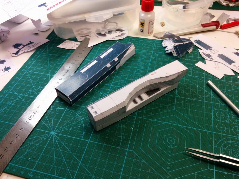

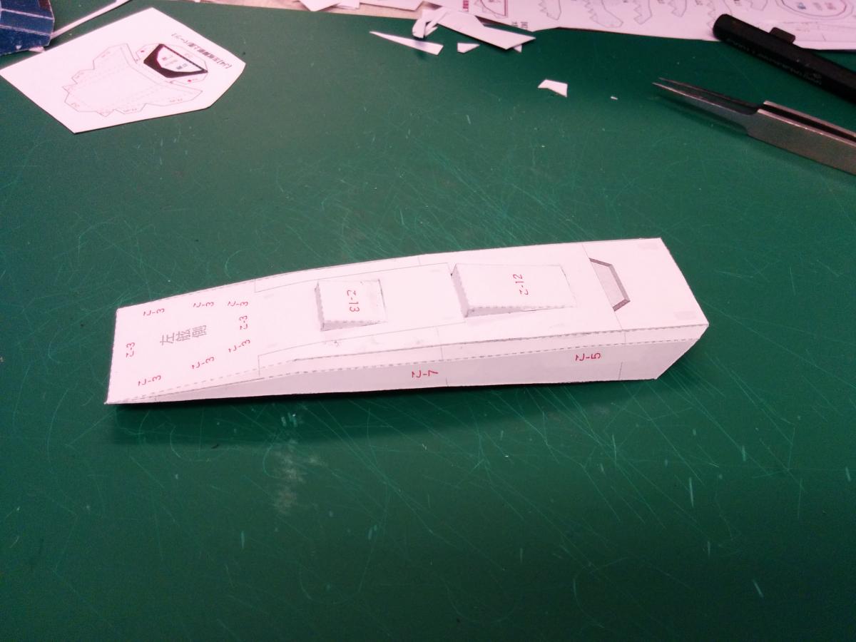

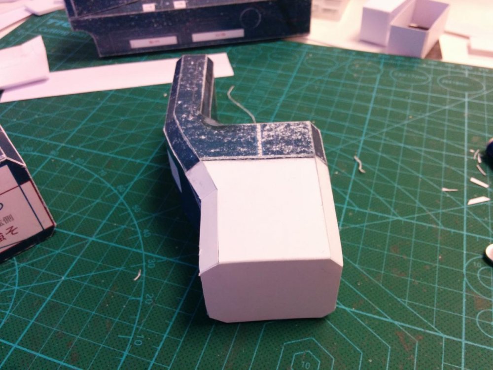

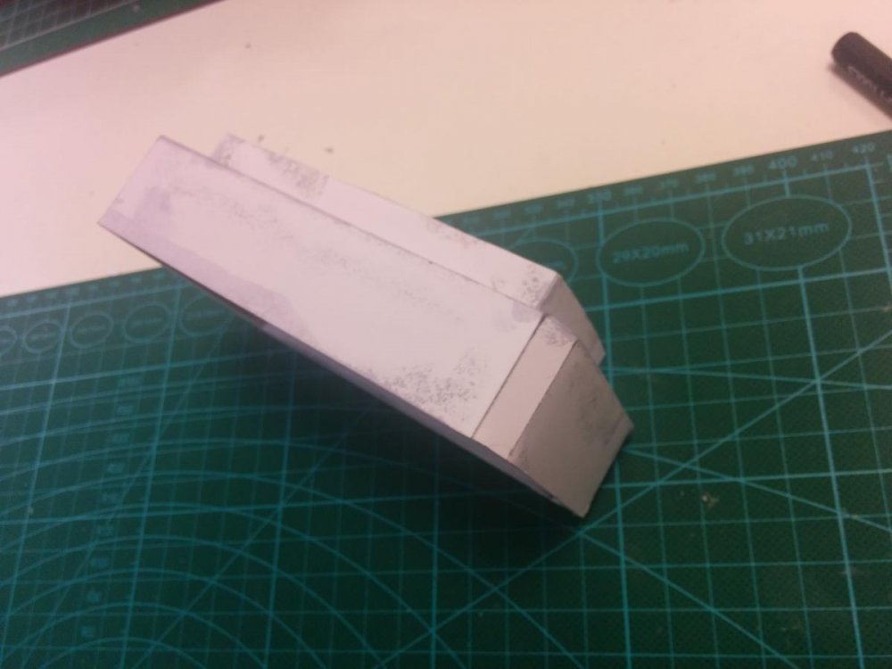

and adding more depth and details...
heavily modfied Keel...
Made a minor change here aswell!!
post-14728-0-77467000-1431646814_thumb.jpg post-14728-0-27172400-1431646818_thumb.jpg
post-14728-0-49452300-1431646820_thumb.jpg post-14728-0-61554200-1431646822_thumb.jpg
post-14728-0-09307800-1431646825_thumb.jpg post-14728-0-55623400-1431646827_thumb.jpg
the reason for this change is to widen the main cannon a bit...
