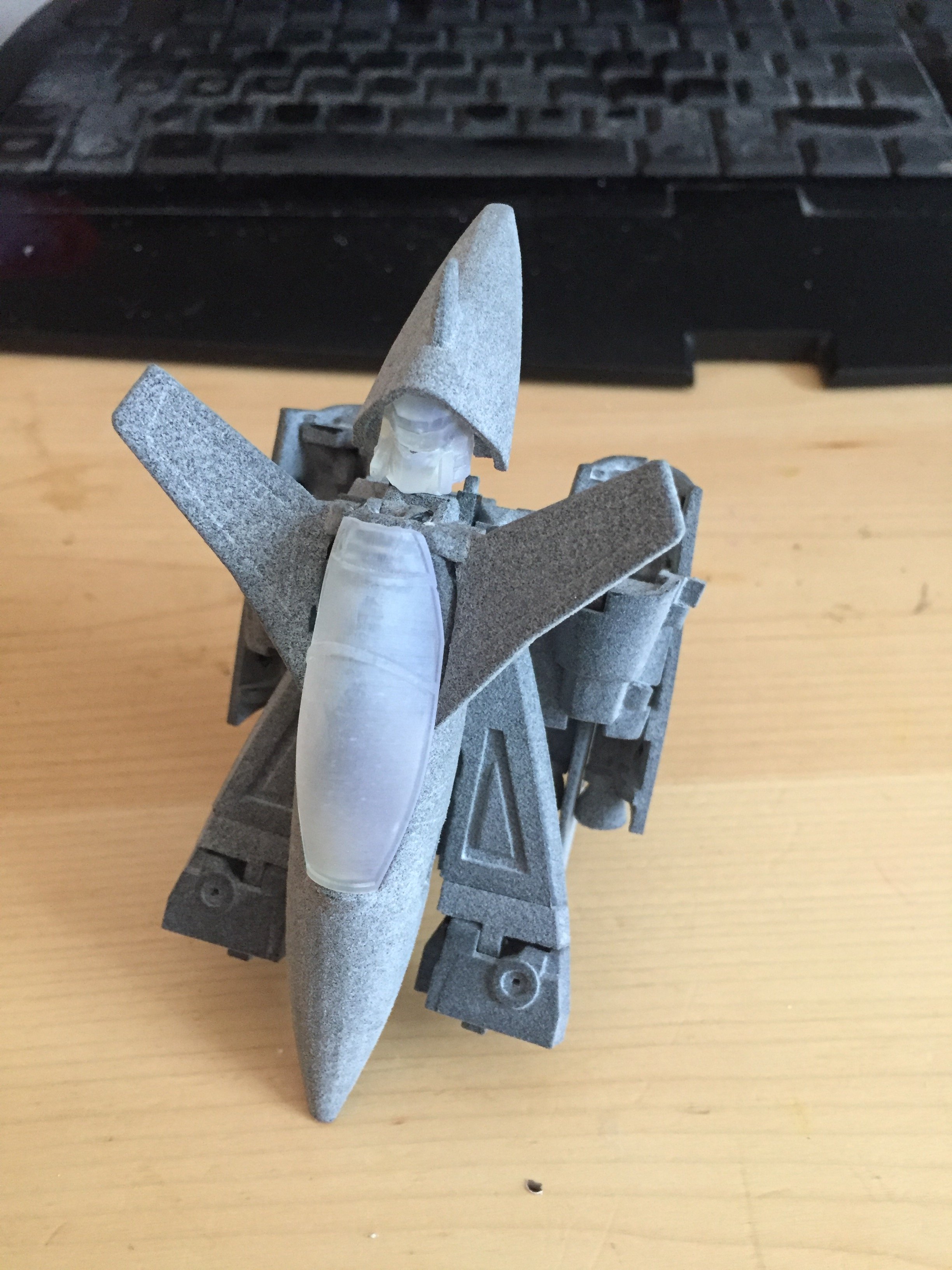

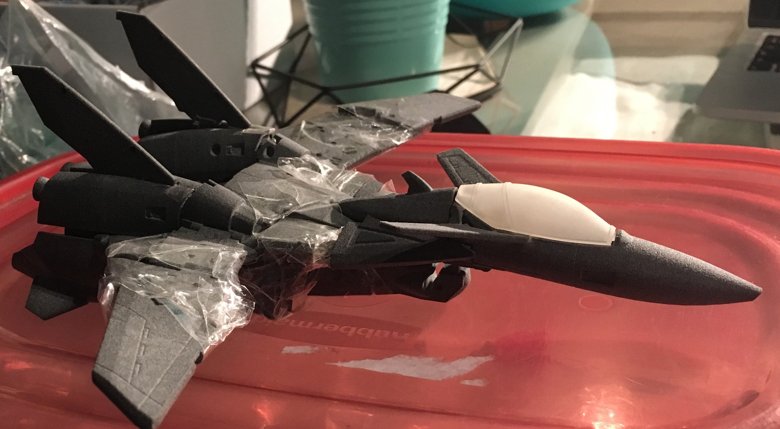

Jasonc Posted September 11, 2018 Posted September 11, 2018 6 hours ago, Xigfrid said: That's looking promising Jasonc, I am also curious to see how it will look like once casted. Here is how my Shapeways canopy looks like, and I am receiving soon a 3D printed copy in clear resin that will be much easier to work with. @Raptor One I wasn’t a fan of the VF-9’s Gerwalk but now that I have transformed it a few times, I surprisedly dig the gerwalk look. -except for the official awkward heel position, I prefer to the the heel in the standard feet position- That actually looks quite good. That material is nice and sturdy, and if I could get it completely clear, I'd just use it. I did notice that even after using a liquid polish, the material still had what looks like tiny ripples underneath the polished surface. it's probably just a part of the printed resin's characteristics, so I didn't want to go all out trying to fix that if it cannot be. I put the clear gloss coat over it last night, and it's shinier, so today after work, I'll be making the first part of mold. I need to work on a way to make it so that there are no seem lines, but can easily come out and I think I have a way to get a great recast. I'll show you once it's done, as the process will take me into later this week to finish, and I want a full cure time in the mold. Clear resin takes about 3-4 days at least to fully cure, especially if it is thin.

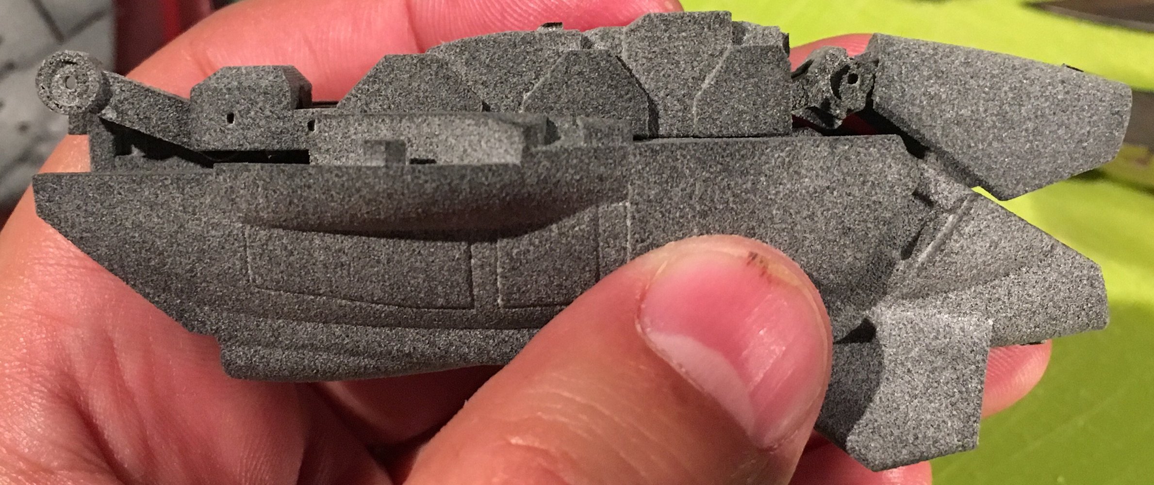

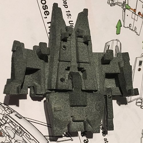

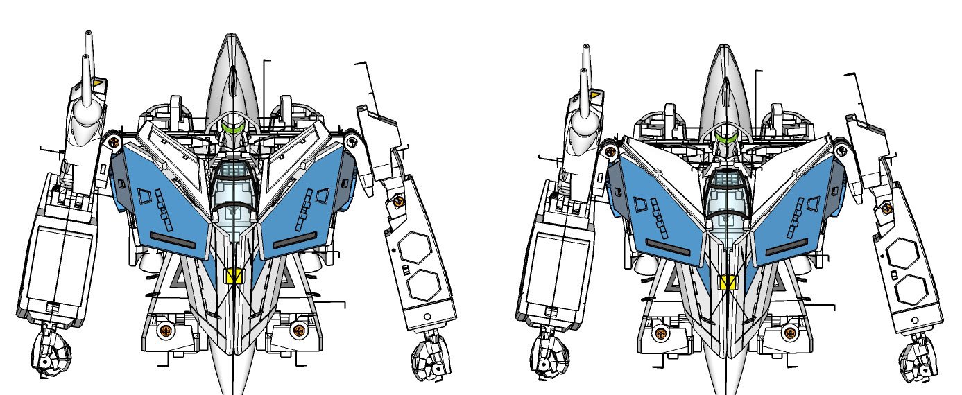

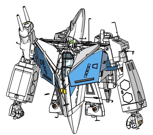

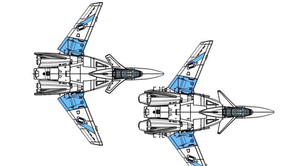

Xigfrid Posted September 12, 2018 Author Posted September 12, 2018 Hi guys, I have begun the Gunpod, that will take a bit of time to complete because I want to use standard plastic as the inside/sliding mechanisms core and High detail plastic for the surface details. This is a process I have used for my VF-31 speaker pod. I think that the Gunpod is small enough to make the increase of price almost unnoticeable compared to a full standard plastic design. Also: easier and faster addon! I made the VF-9 fins version 3. It is a more "line-art accurate" fins design for my VF-9 with the following mods: inner flaps removed, less surface detailing and the general shape modified to better fit the line art shape. This new shape will close better the battroid chest, so this is more like a battroid "lover" addon. Personally I prefer the previous version (version 2 illustrated on the left side, version 3 on right side) that comes with the standard VF-9 release, but feel free to add it on your next order if you feel so.

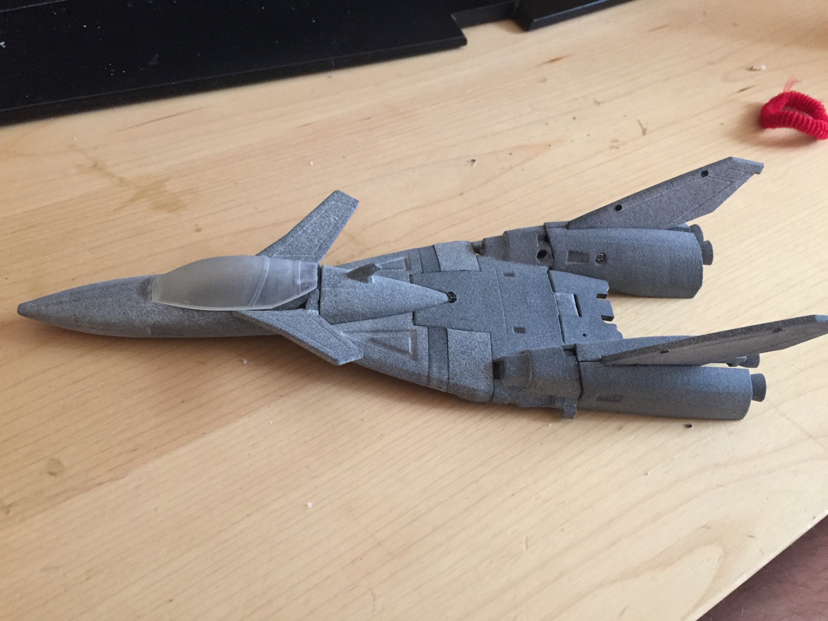

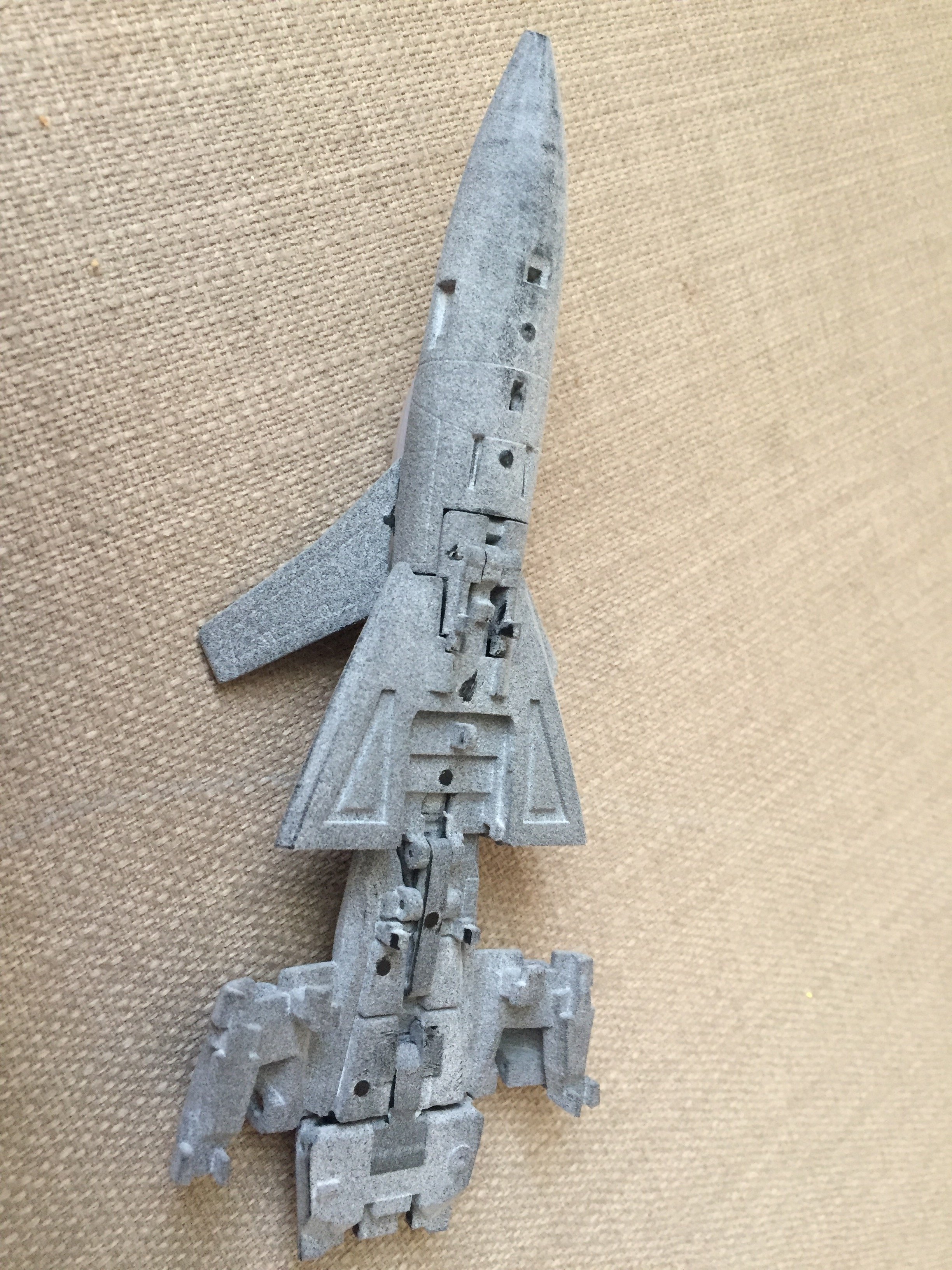

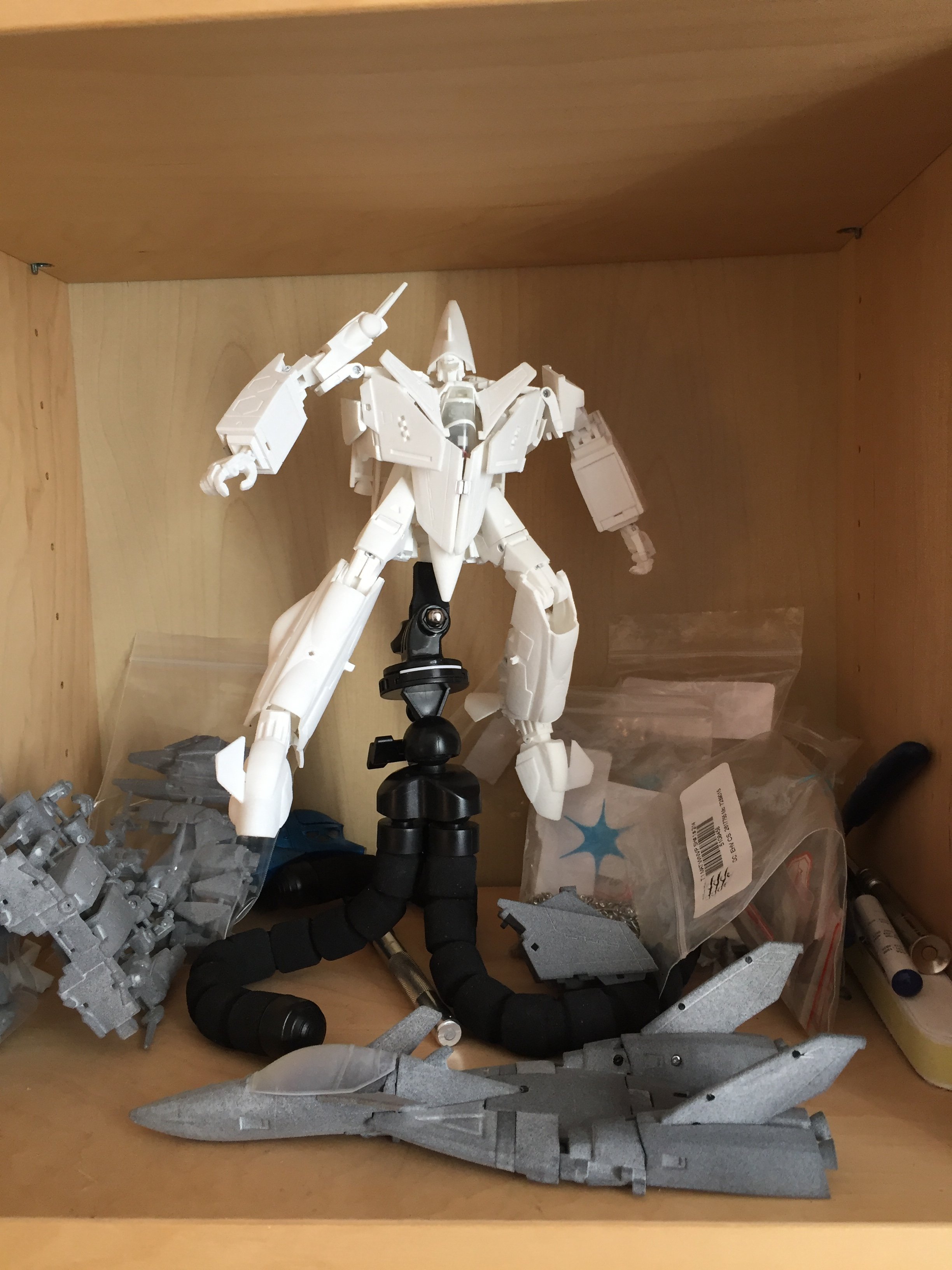

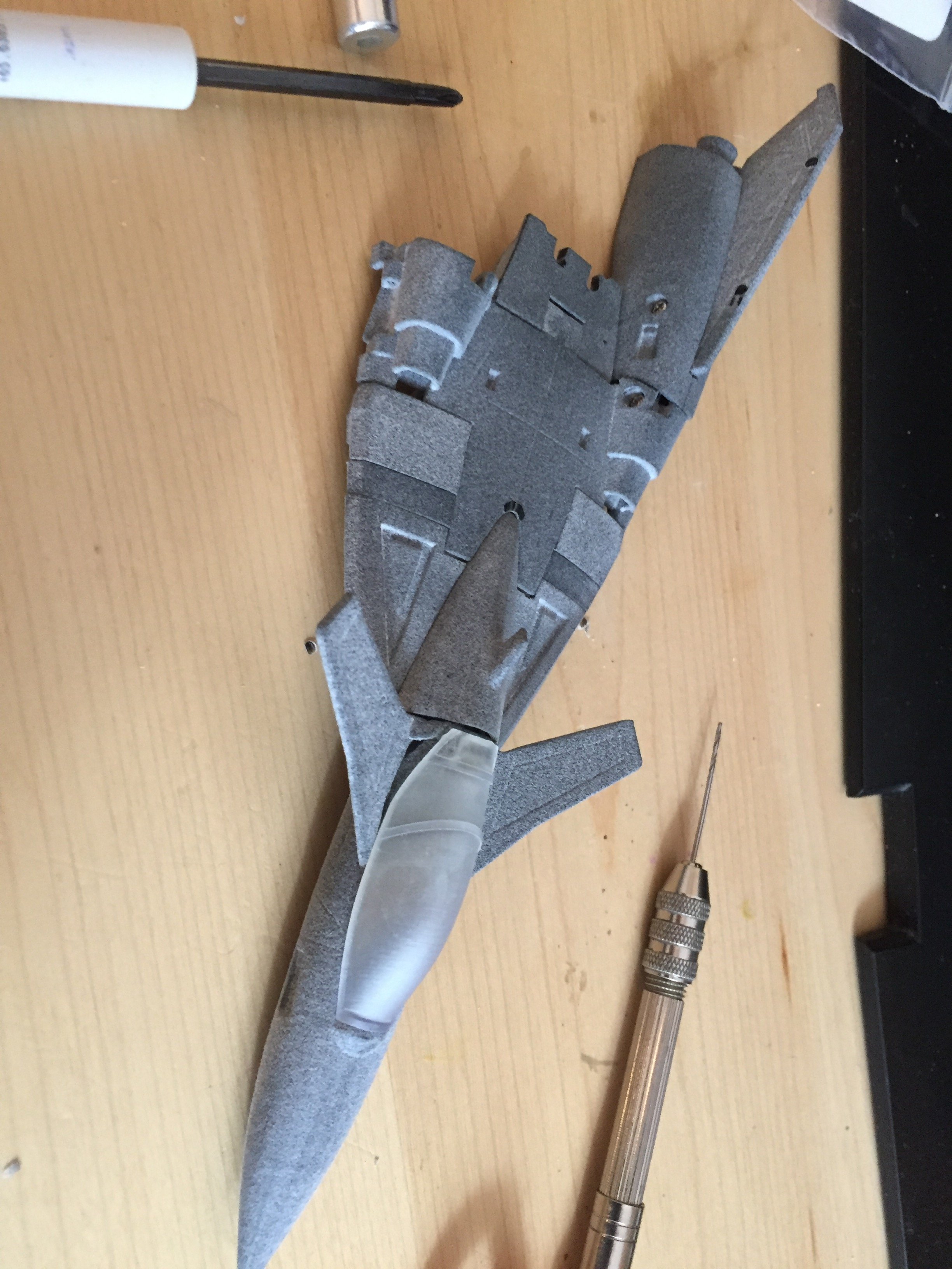

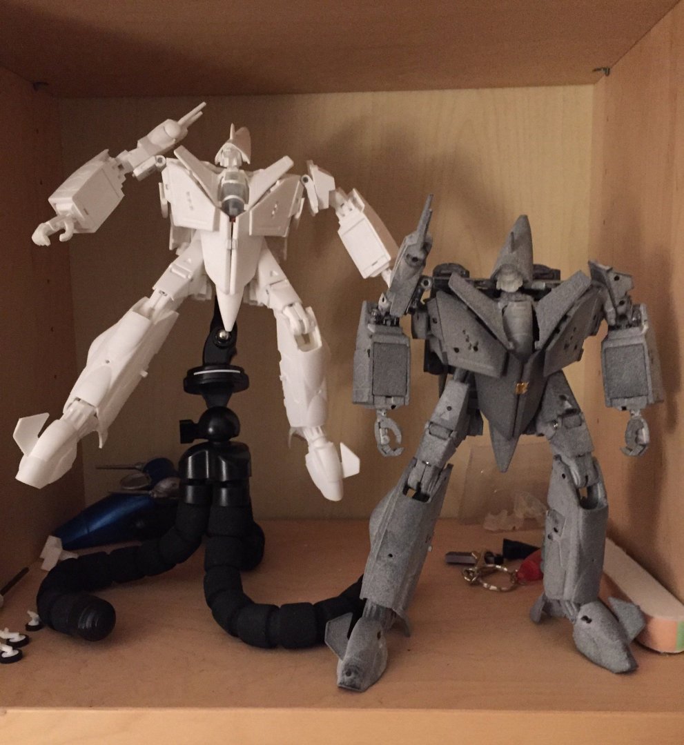

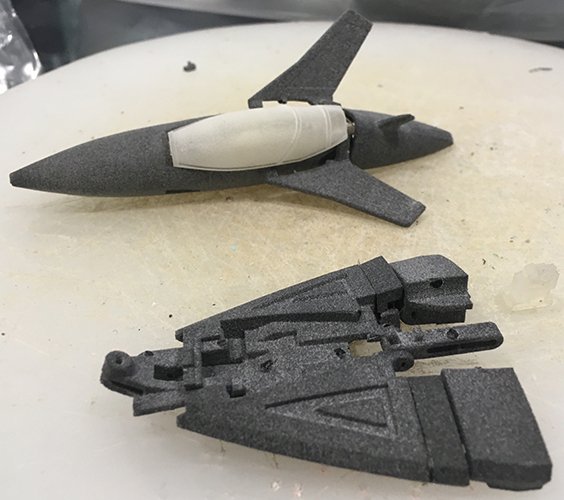

Xigfrid Posted September 15, 2018 Author Posted September 15, 2018 Thanks @valhary! I couldn’t resist or I love assembling Macross robots... but now I have a grey VF-9 on the bench too I have to admit the HP precision is a little better than the standard plastic, but a little more flexible. Both plastics are great, but the HP Version closes better out of the box. WIP
valhary Posted September 15, 2018 Posted September 15, 2018 a quick question is there any difference in the textures? or in white is less perceived?
Xigfrid Posted September 15, 2018 Author Posted September 15, 2018 (edited) The white is rougher on the surface compared to the HP plastic, thing is my white VF-9 has been sanded 3 times already and it needs only painting now. Edited September 15, 2018 by Xigfrid

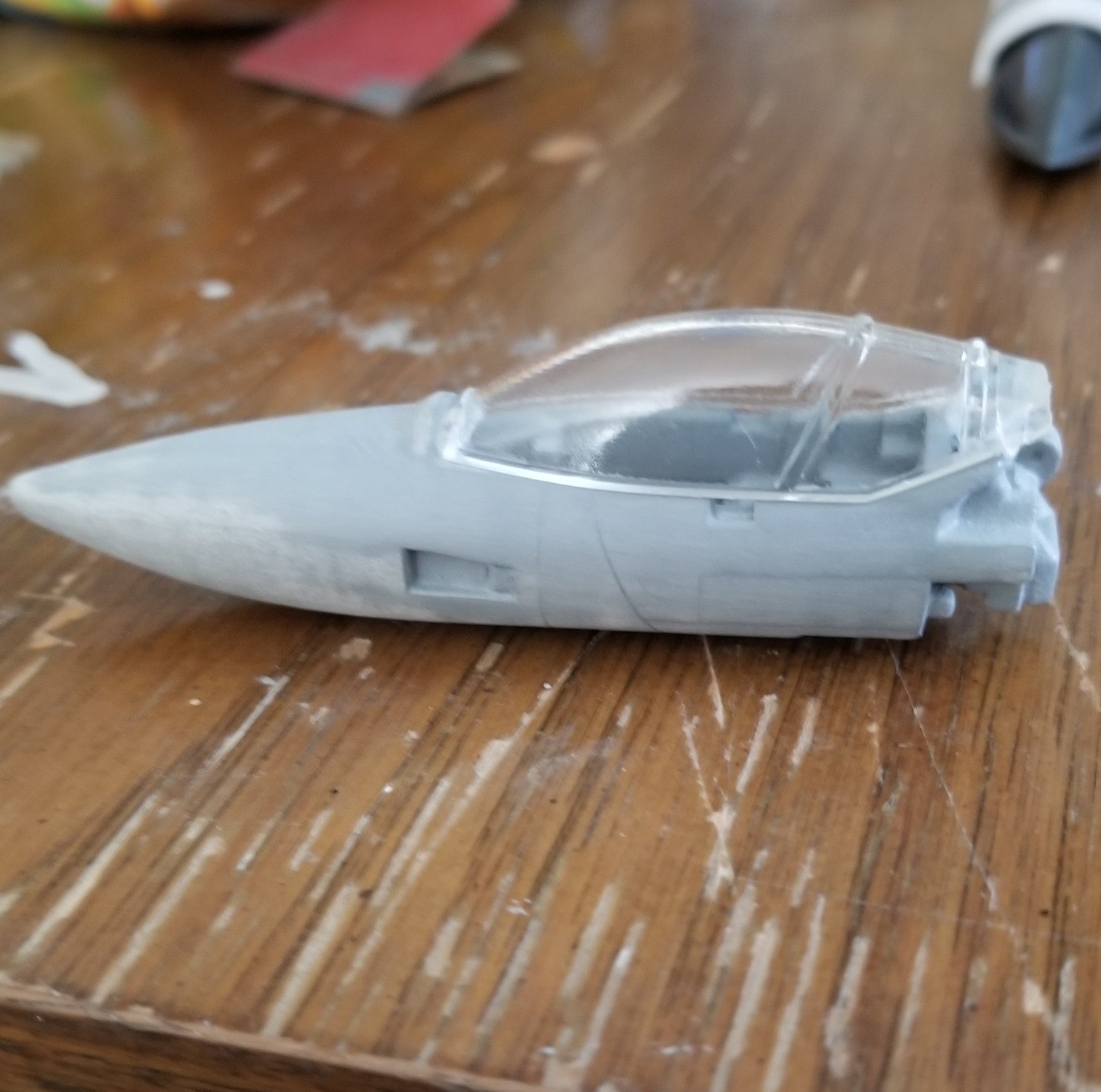

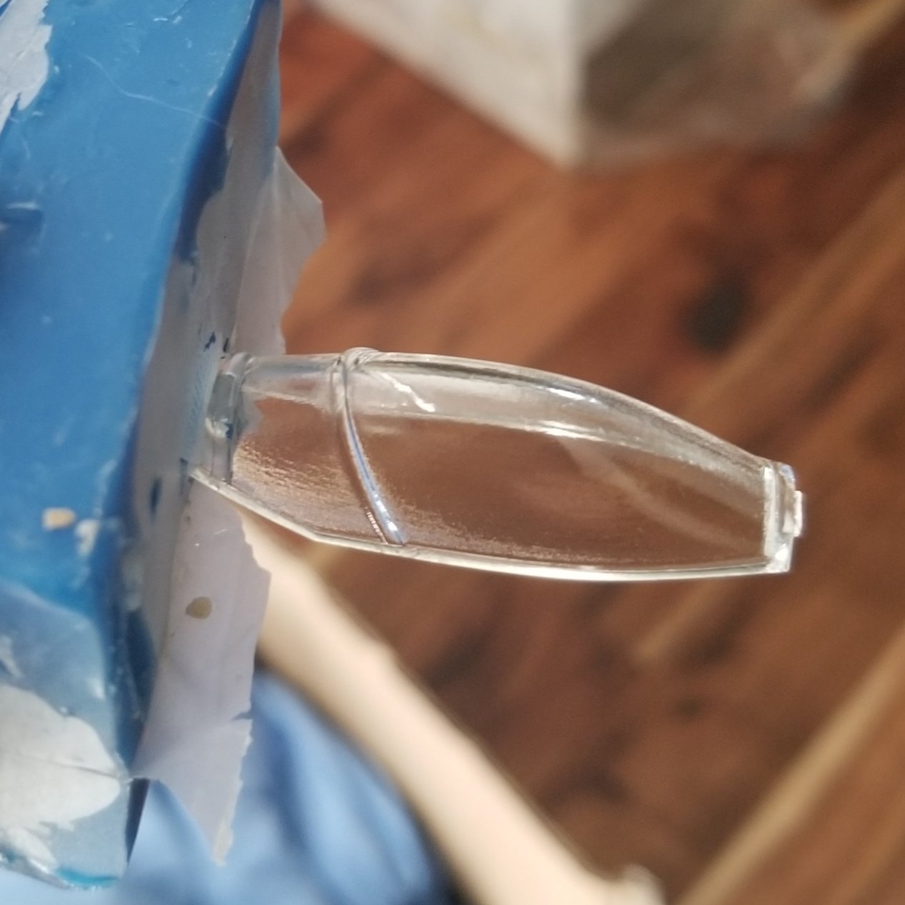

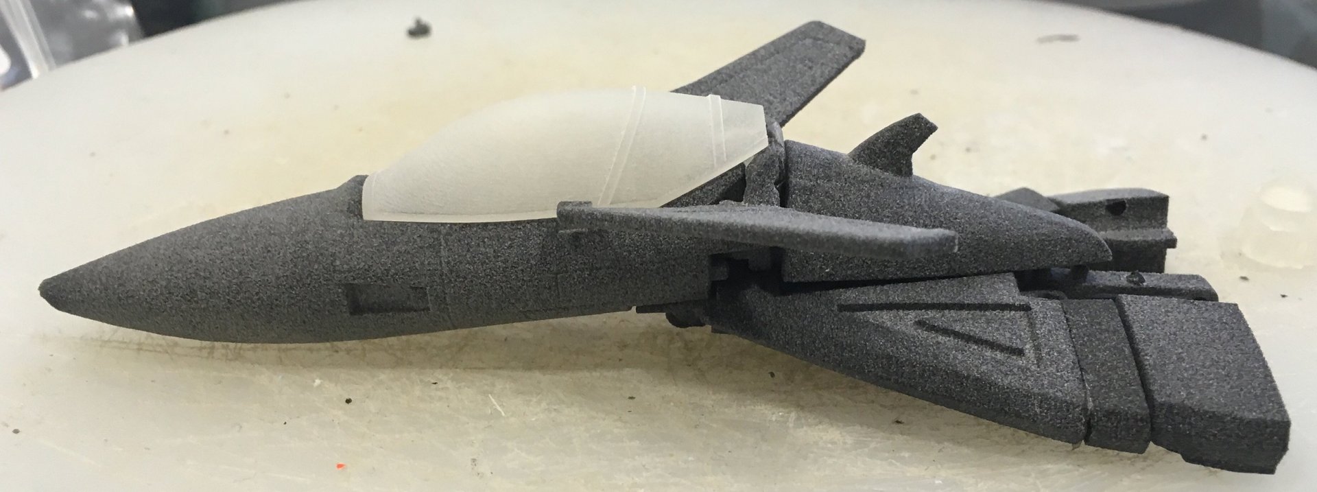

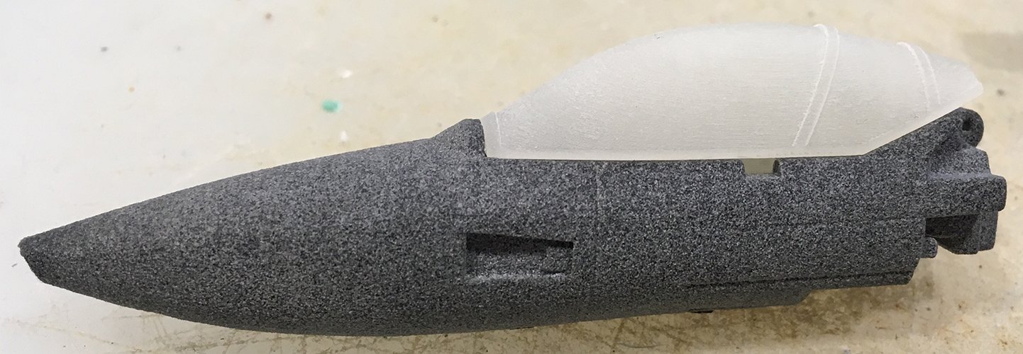

Jasonc Posted September 19, 2018 Posted September 19, 2018 (edited) The canopy came out exactly as 8 wanted it. I can't be happier with the final result. Apparently it's quite clear. It really doesn't need any sanding or buffing. Edited September 19, 2018 by Jasonc Added pic
DarkArchon3000 Posted September 20, 2018 Posted September 20, 2018 Yup nice and clear. That surface is looking smooth on the VF-9.
Jasonc Posted September 20, 2018 Posted September 20, 2018 13 minutes ago, DarkArchon3000 said: Yup nice and clear. That surface is looking smooth on the VF-9. Thanks. I just scribed the lines again after several bouts of paint and sanding, snd it's quite smooth. I may do one more coat before it is how it's supposed to be. 4 minutes ago, Xigfrid said: Looking great Jasonc! Thanks. I was actually quite surprised how clear it came out. I was expecting to need to do a lot more work, but it is not bad right out the mold, and it fits perfectly. This clear resin is pretty strong, too, so in a few more days, it'll be completely cured. I only used the back as the demos portion, so theres no real cleanup. I'm rather proud of this set. One of my finest works.
nightmareB4macross Posted September 20, 2018 Posted September 20, 2018 6 hours ago, Jasonc said: The canopy came out exactly as 8 wanted it. I can't be happier with the final result. Apparently it's quite clear. It really doesn't need any sanding or buffing. That looks really good. Would you mind casting me canopy? Xigfird has done an amazing job on this and I want to get this kit and build it.
Xigfrid Posted September 20, 2018 Author Posted September 20, 2018 Haha! That's exactly what I was thinking :) Jasonc let me know if the canopy is still workable to be assembled on the opening mechanism (I know the hole will need to be drilled again), if yes I would love to have a few recasted canopies (about 6x) for me

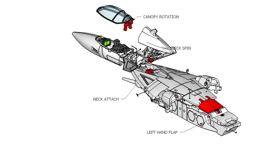

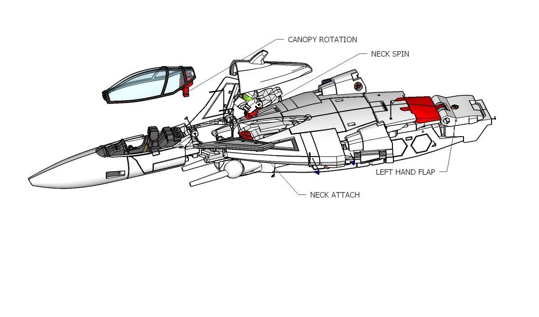

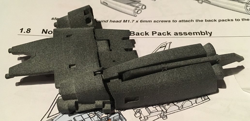

Xigfrid Posted September 21, 2018 Author Posted September 21, 2018 Nice shop indeed @Sanity is Optional, thanks for helping here :) Unfortunately I couldn't find the specific size of magnet (2mm x 2.5mm 5mm) required, perhaps this is possible to call them and ask to pre-order these ? @DarkArchon3000 and the others, after 3-4 assemblies, I made a short list of parts and I put them into a single 3D model. These spare parts that you may want if you plan to grab a spare canopy for instance. It contains 4 small parts that can be usefull to have in double / spare. They are colored in red. If you find another parts to be sensitive, let me know. For instance, I know the last portion of the wing is a bitch to assemble, and you may be cautious when you try to rotate it, if you do it wrong you may put an excess of stress on the pins. I will try to explain this clearly in the "transformation video"

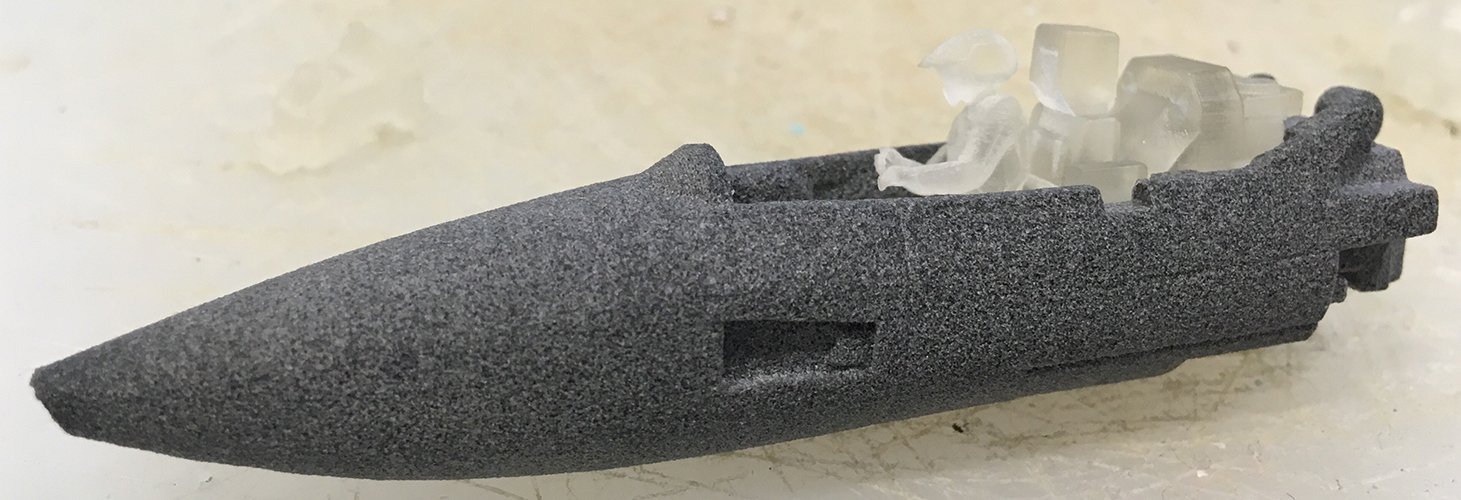

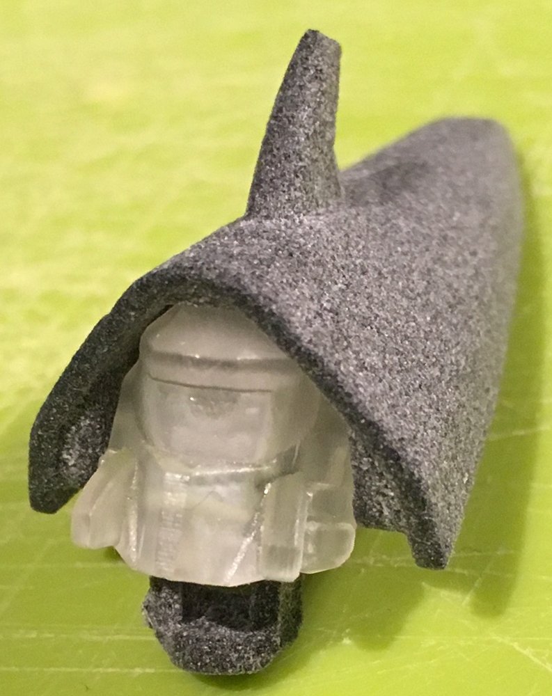

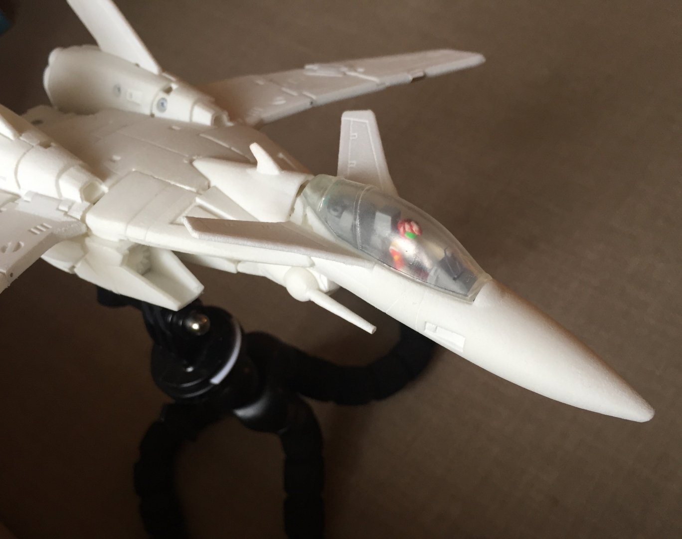

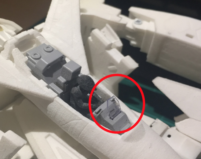

Xigfrid Posted September 23, 2018 Author Posted September 23, 2018 I don’t know exactly what you don’t understand, but basically the small printed part comes with a 1mm x 3mm rectangular hole where you can insert a small sheet of transparent plastic to simulate the visor screen (also call “head up display”)
