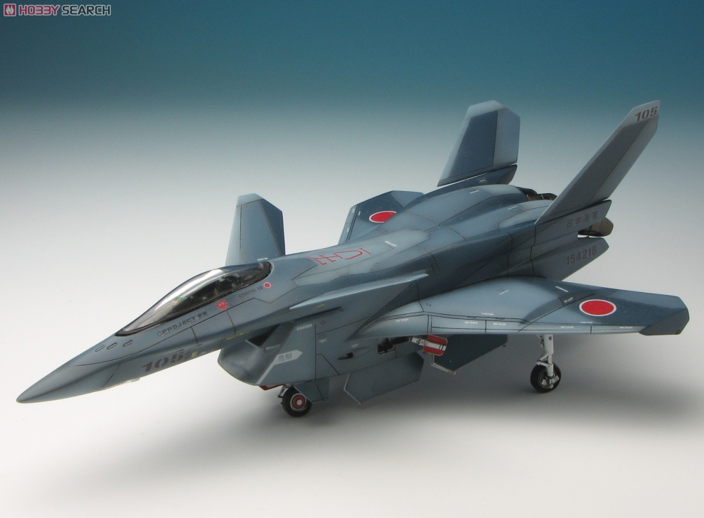

Valkyrie Posted June 1, 2009 Posted June 1, 2009 (edited) I'm still in shock... Platz actually made the may release date! Just barely, but still! Mine's prepping to ship too. Along with the 5 most recent issues of Macross Chronicle I'm going to be having a very good day sometime next week! Edit: Pics are up at Hobby Search! http://www.1999.co.jp/eng/10063747 And would you believe that it actually has a real cockpit?! The original Pla4U Wonderfest release did too, so it's no REAL surprise. But still, after the last 3 kits, it was almost like Platz just hates cockpits The canopy is clear resin, and looks quite nice. And it looks like the pilot's seat is straight out of a Hasegawa VF-0, just like the Pla4U version... Edited June 1, 2009 by Valkyrie

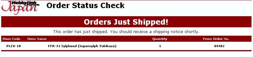

electric indigo Posted June 1, 2009 Posted June 1, 2009 Got the shipping note from HLJ today. Good thing that the Euro is quite strong again. The execution of the cockpit is great, I still had fears that Platz would fall back to their previous solution. Even the control sticks are there, but no HUD. With the VF-0 seat, I hope that a Hase pilot will fit in there. The decal sheet looks quite comprehensive. I'm still a little bit mad that the 1/48 line was never released, but I don't want to think about what the kits had cost.

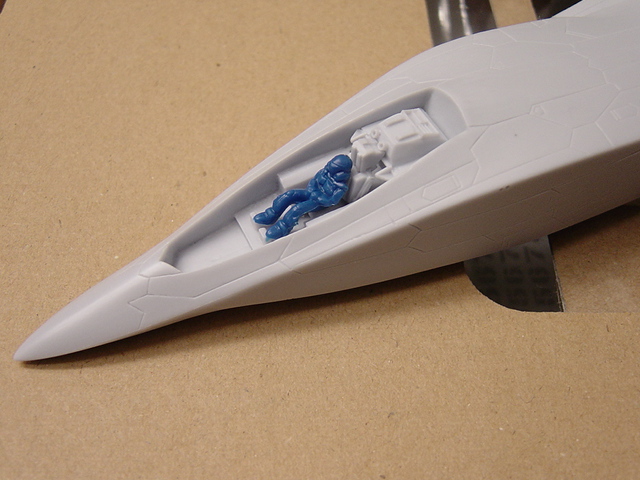

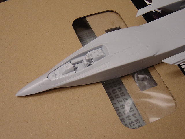

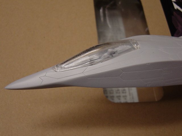

electric indigo Posted June 13, 2009 Posted June 13, 2009 The Sylphid has landed! So how's the canopy? And does a 1/72 Hase pilot fit in the cockpit?

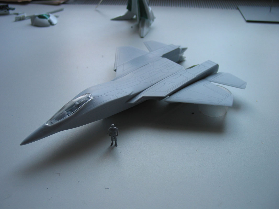

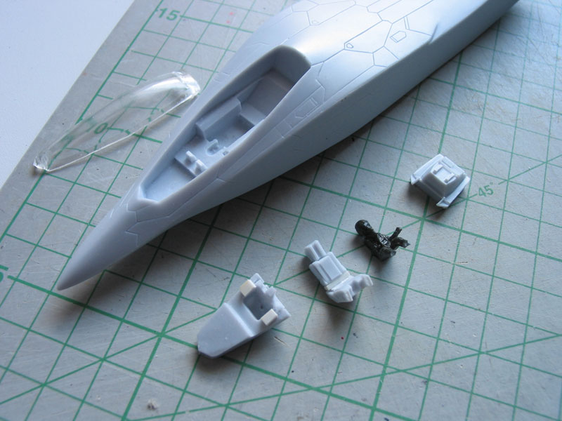

Highside Posted June 13, 2009 Posted June 13, 2009 (edited) So how's the canopy? And does a 1/72 Hase pilot fit in the cockpit? The canopy came out pretty good. It just needs some heat to make the fitting more precise. Some fine sanding and metal primer should make the cockpit detailing more visible. As you can see from the picture below, you'll be able to fit a 1/72 Hasegawa pilot in the cockpit. However, there's no room for the legs, so you'll need to open up some space yourself. Edited June 13, 2009 by Highside

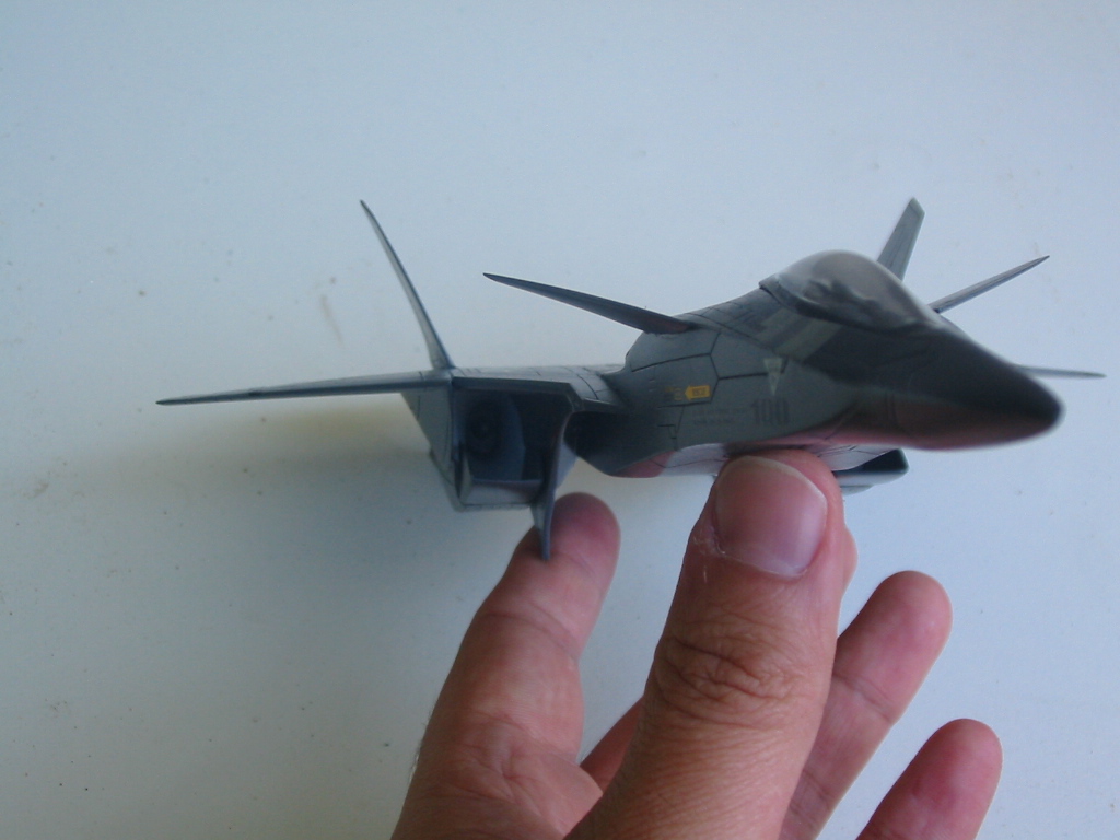

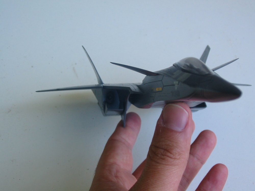

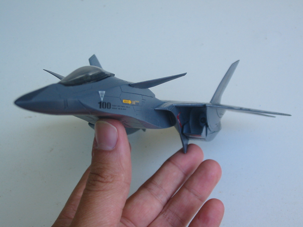

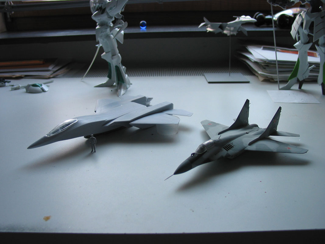

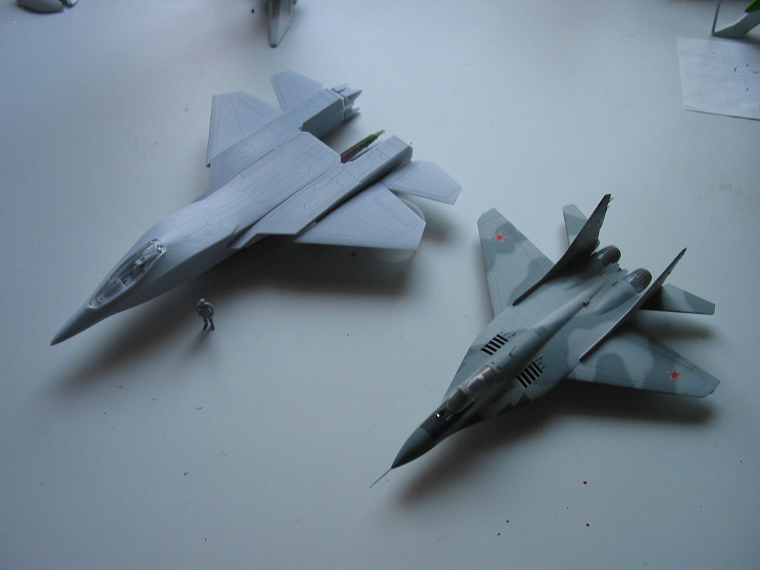

electric indigo Posted June 25, 2009 Posted June 25, 2009 Got my Sylphid today, man is the canopy fitting bad. But it's a beautiful fighter. Comparison with one of my few real-life jets
wm cheng Posted June 25, 2009 Posted June 25, 2009 Got my Sylphid today, man is the canopy fitting bad. But it's a beautiful fighter. Comparison with one of my few real-life jets WoW! that does look bad... for such an expensive kit to have that flaw, its pretty much inexcusable. I expect better from Platz.

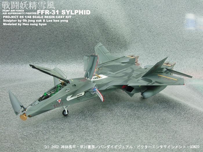

electric indigo Posted June 28, 2009 Posted June 28, 2009 Major Tom posted this link to a great build of the Shylphid in the model section: http://photos.yahoo.co.jp/ph/horton1485/ls...=ph&.view=t

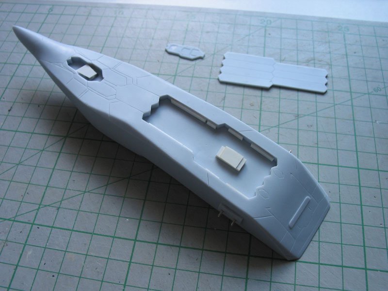

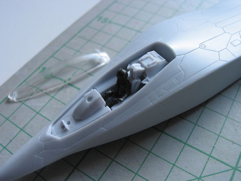

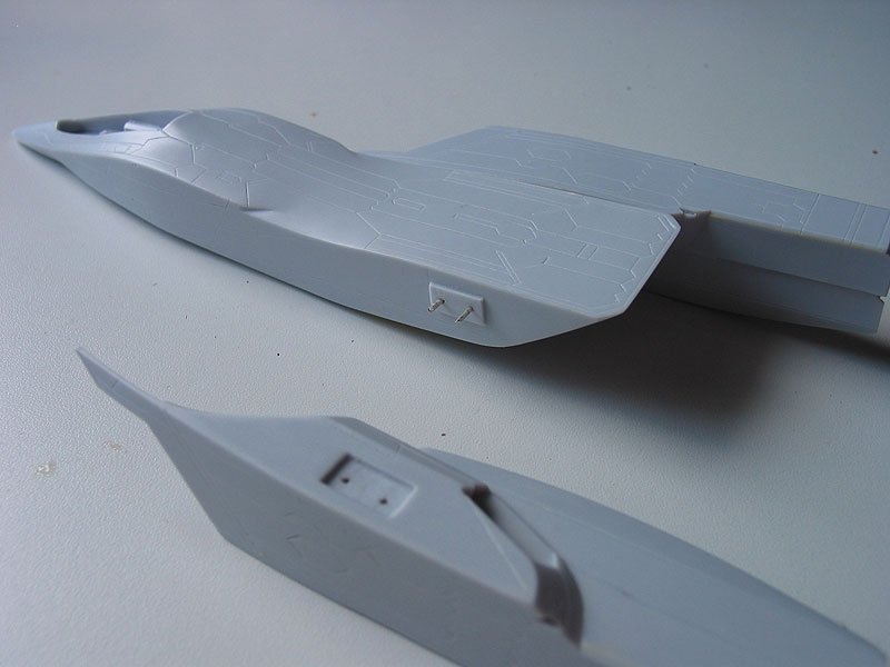

electric indigo Posted July 9, 2009 Posted July 9, 2009 Got some things done on my Sylphid kit: The missile bay was outfitted with strips of styrene to hold the door plate in place, same for the front landing gear. I elongated the back of the pilot seat so it will fit a 1/72 Hasegawa figure, also the dashboard was raised at the back end to suit the configuration with the pilot in place.
Dobber Posted July 9, 2009 Posted July 9, 2009 Cool, I'm about to start mine too. Which version are you doing? the "camoed" version or the standard one? Keep the pictures comming Chris
wm cheng Posted July 9, 2009 Posted July 9, 2009 Hey start a build-up thread... I'd love to see more of the work! What about doing the missile bay open - opportunity for scratch building! Will the canopy still fit after making all the cockpit gak taller? It looks kinda squished already.

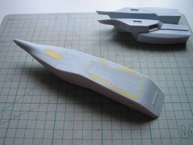

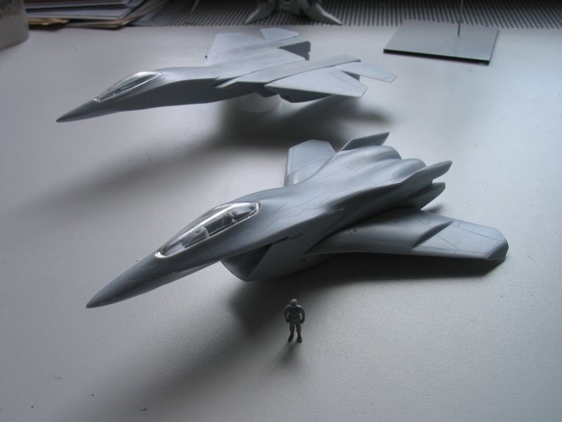

electric indigo Posted July 13, 2009 Posted July 13, 2009 Little progress so far - I puttied the underside and redraw the missile bay doors. I have to correct some of the edges of the puttied area where the MoriMori crumbled off. To align the engines flush with the back of the fuselage I had to cut the alignment blocks a bit. A small gap remained which was filled slowly with Mr. Dissolved Putty. Chris - I will paint it in the "normal" style - the crazy camo is a bit much even for me. WMCheng - the pilot fits under the canopy just fine. I even managed to eliminate the gap with the help of a hairdyer and a small vice. Oh and I got my F/A-27 today
Dobber Posted July 14, 2009 Posted July 14, 2009 (edited) Cool, I just started mine as well. My canopy had a gap too, it really was easy to fix, just some hot water and then moved it with my fingers till it fit correctly, once it fit I ran it under cold water and it fits perfectly now! I think I'm going to go with the insane camo, :s Chris Edited July 14, 2009 by Dobber

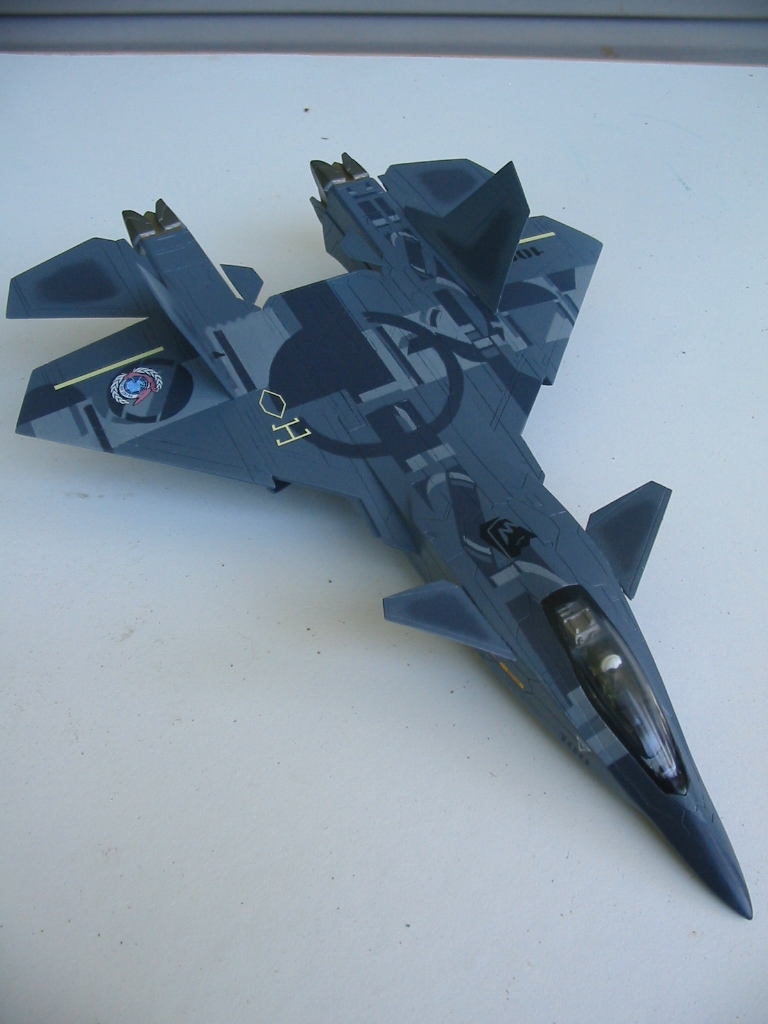

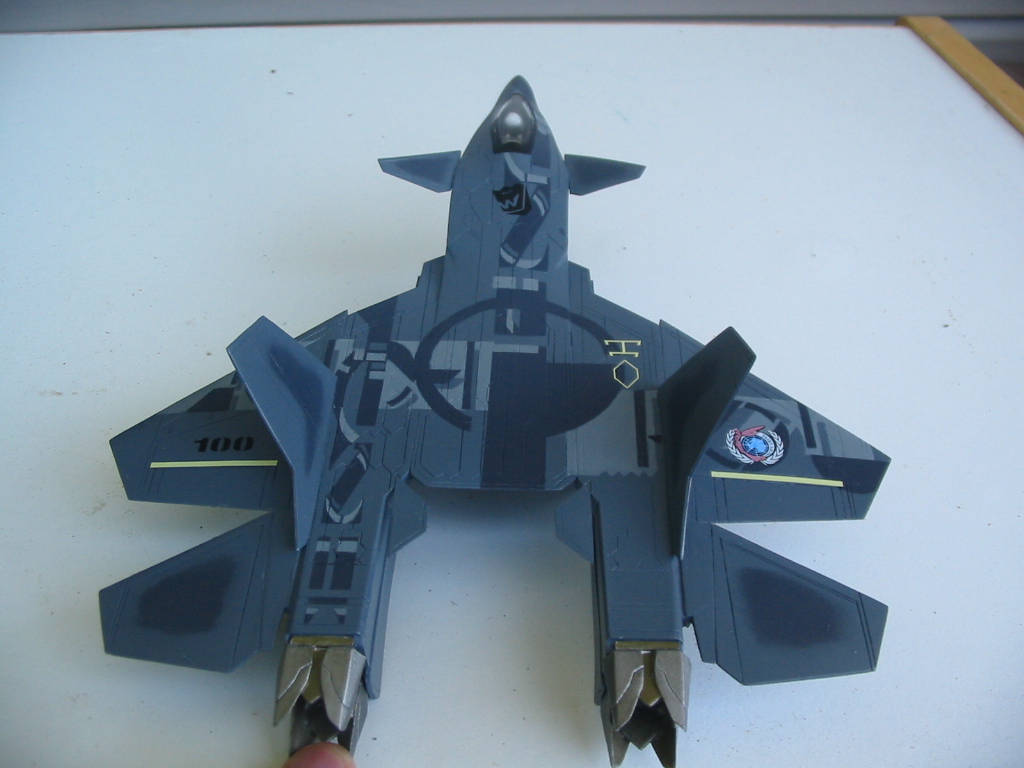

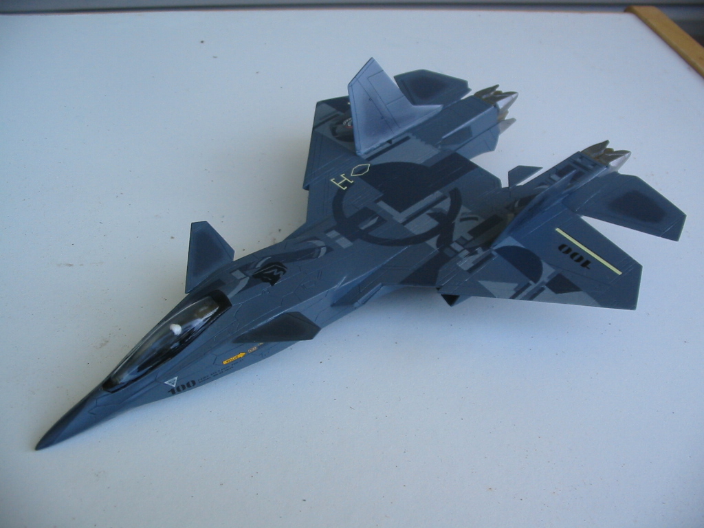

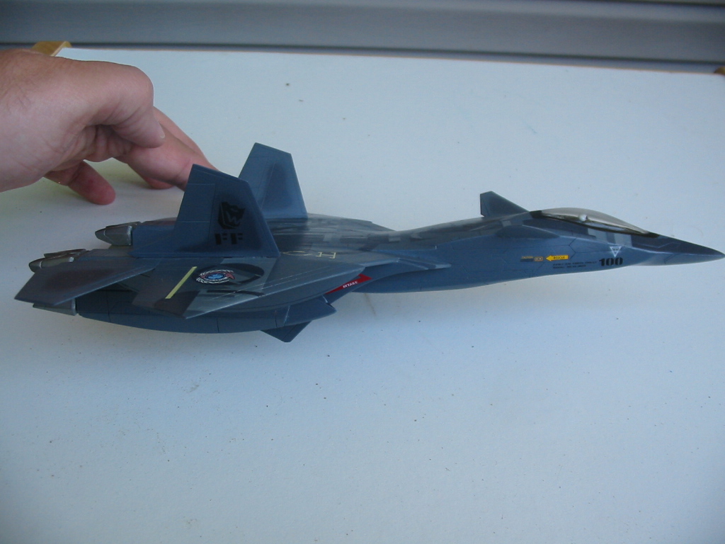

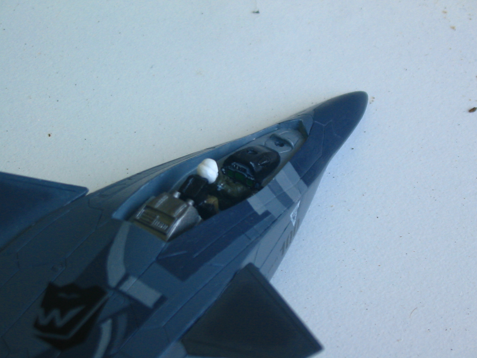

Dobber Posted August 6, 2009 Posted August 6, 2009 Here is my Sylphid still early in the decaling process with no weathering. I went with the crazy camo, I like how it came out but I think overall colors are too dark. Oh well Canopy is just resting in position and will be sealed after everything else is done. Chris
cowie165 Posted August 8, 2009 Posted August 8, 2009 Chris is the camo scheme decals or did you mask that?? Mark
electric indigo Posted August 8, 2009 Posted August 8, 2009 The camo is not a decal, so it's an excellent paintjob from Chris. Congratulations for that.
