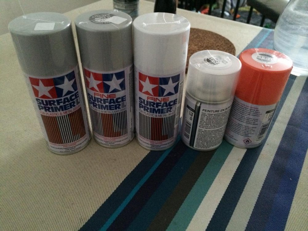

Xigfrid Posted June 8, 2015 Posted June 8, 2015 I am doing my best for these little dronies. I don't know yet if there would be a resin kit yet, but I know for sure that the first prototype is going to be very well treated ! I made my research about how to prepare WSF models, this is quoted from Shapeways forums, and I think this is the most complete method I foudn out 1. Wash the model in WARM water, towel it off and let dry completely. *I use warm water because that will help reset any bends the model may have incurred during shipping. 2. Sealer- I have read about several methods and tried most of them. I am not sure which gives the best results as the "layering" steps make up for a lot. a) Paint model with several layers of undiluted "Future" (or other) acrylic floor polish. *WSF is porus and will absorb the first layer(s) rather quickly; let it dry before moving on. b) Give it a coat of your favorite "rattle can" primer. c) Paint it with 1-2 coats of diluted PVA ("Elmers") white glue. * About 1:1 Glue /H2O. d) 1-2 coats of Clear Gloss spray sealer. * I like Krylon Crystal Clear. 3. Primer (if you have not already done that in step 2) 4. Base Color 5. Wash. * I use the "Magic Wash" method- "Magic Wash" is composed of 1 part Future floor polish to 4 parts water. I usually mix a small bottle for future use. Pour a small amount into a bottle cap (or other small vessel) and mix it with a small drop of whatever color paint/ink you like. Make it as thick or thin as you want. Let it dry completely before moving on. 6. Drybrush with primary color. 7. Paint secondary colors and details. 8. Pin-wash to bring out more detail. Pin-washing is done with the same "magic wash" method but using a fine-point brush and just edging details and recesses, rather than applying it overall. 9. Weathering. * Optional. 10. Touch-up and highlight details. 11. Clear Coat. * Apply one or more coats of clear gloss sealer. 12. Apply decals. * Optional (gloss coat again if you do). 13. Panel Lines- go over them with a very fine point drafting pen to further darken/define them. * Optional 14. Top Coat- I prefer Testors Dullcote or Krylon Clear Matte Finish. * Unless you want a high gloss finish. 15. Glass Canopies, etc... I like to go back over my canopies to give them a bit of a glass-like shine by painting them with a coat of undiluted Future floor polish. * Do this quickly as the polish will start to dry and thicken quickly and that will lead to visible brush strokes. The fact that I use multiple coats of "Magic Wash" is one reason I am able to get a (relatively) smooth finish as each layer contains the floor polish. The Clear Gloss top coat(s) really finish it off. Dullcote/Matte finish reduces the shine and also makes any remaining "roughness" less obvious. When you are done, you should have a model that is unique, attractive and durable.

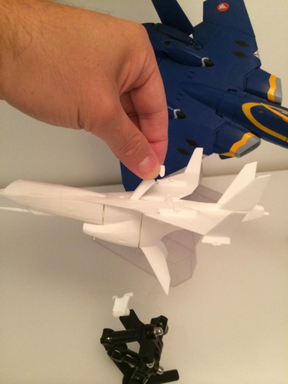

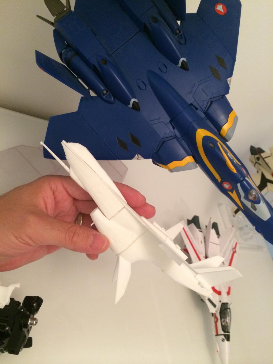

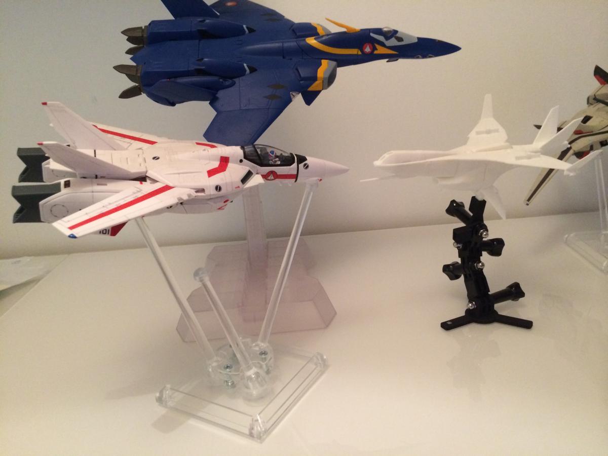

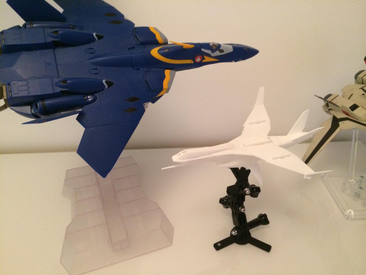

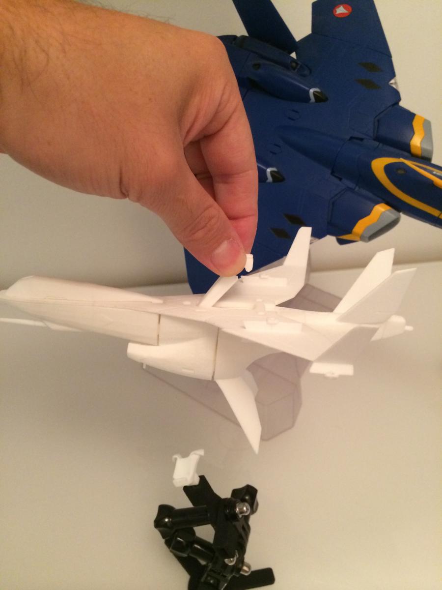

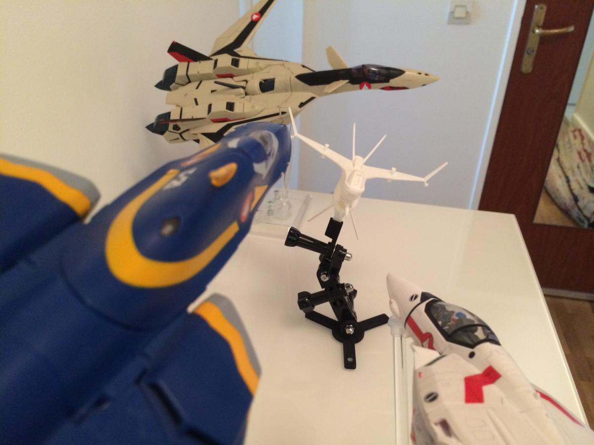

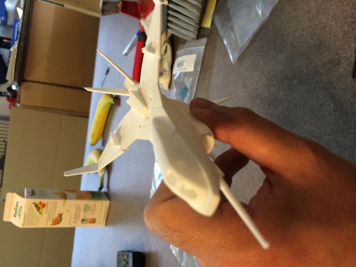

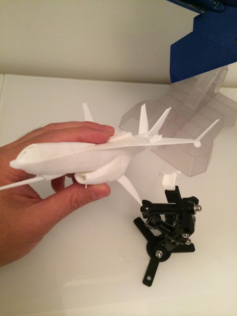

Xigfrid Posted June 15, 2015 Posted June 15, 2015 (edited) Hi guys, I received all the parts everything is snapping perfectly, I already made few design corrections and decided to make the 1/48 scale drone kit available NOW on shapeways in WSF. http://www.shapeways.com/shops/xigfrid3dshop?section=Drone+Fighter+1%3A48&s=0 I am working on the 1/60 and 1/72 scale versions to make them in resin with a highly valuable member of this forum, I should shortly take pre-orders for these. The resin kits will be limited run so keep an eye on the thread. The kits are 11 parts for the entire drone, plus a Yamato Stand adapter if you want a display solution. If you want to order the 1/48 kit from Shapeways, I also recommend the Laser canon in Steel instead of WSF, but it works pretty well in WSF. Here are a few pictures of the quickly snapped in out of the box. Sanding/prep/etc will come later but slowly because I am now focusing on how to make them in resin. Edited June 17, 2015 by Xigfrid

charger69 Posted June 16, 2015 Author Posted June 16, 2015 Great pics Xigfrid! What we are seeing in pics is 1/48 version right? Waiting for your 1/60 pre-order call!
Xigfrid Posted June 16, 2015 Posted June 16, 2015 Great pics Xigfrid! What we are seeing in pics is 1/48 version right? Waiting for your 1/60 pre-order call! The shoots are from the 1/60 version. This thing is bigger than you imagine !

GU-11 Posted June 16, 2015 Posted June 16, 2015 That kit is sexy. BTW, what's a "sealer"? It that used for smoothing out the print lines? I usually use decanted primer for the job, although I'm not sure it it's the proper method.
Xigfrid Posted June 17, 2015 Posted June 17, 2015 The sealer is just a gloss lacker in can in the example I guess.

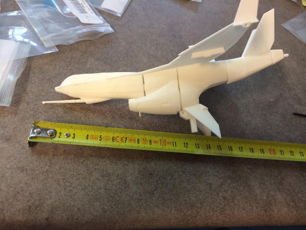

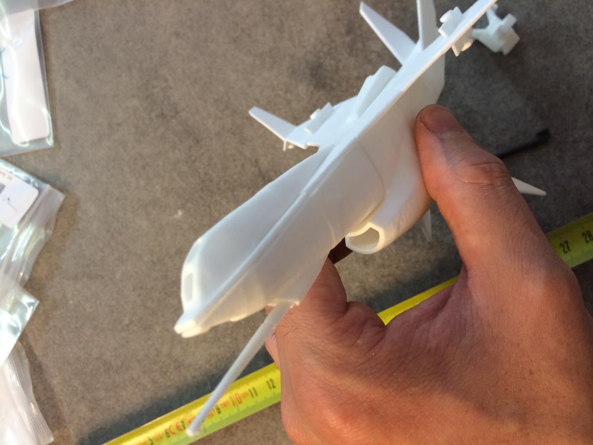

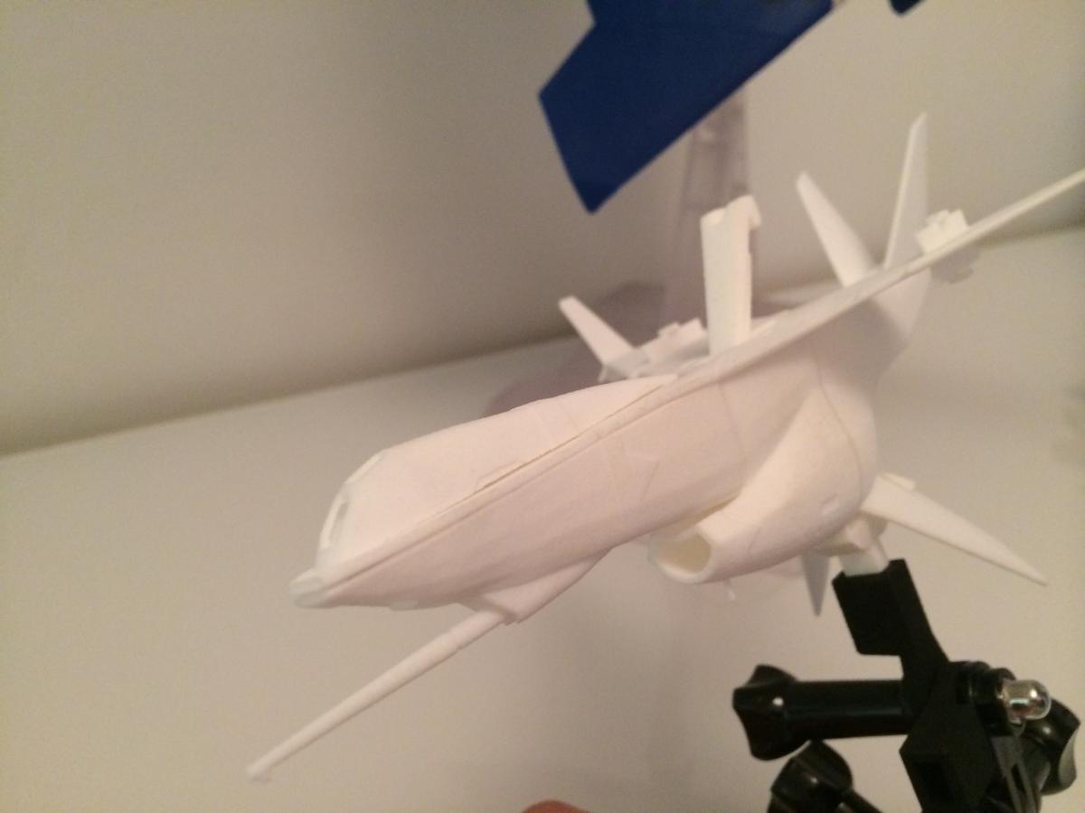

wmkjr Posted June 17, 2015 Posted June 17, 2015 More pics of the 1/60 drone for you to ogle. Thanks for putting these up!
