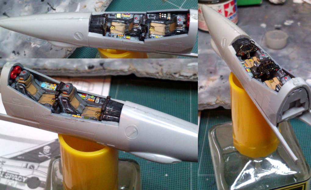

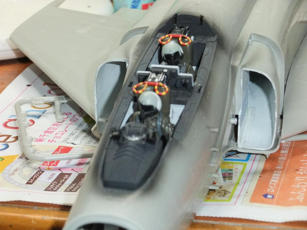

Cesar Enrique Posted October 12, 2013 Posted October 12, 2013 Working hard on scratch detail and painting for 1/72 hasegawa Elintseeker cockpit...

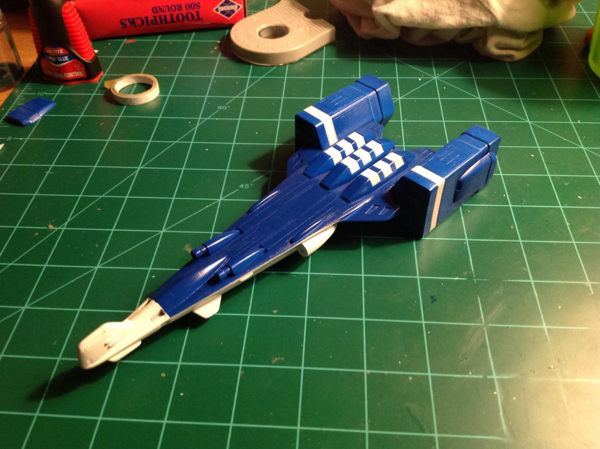

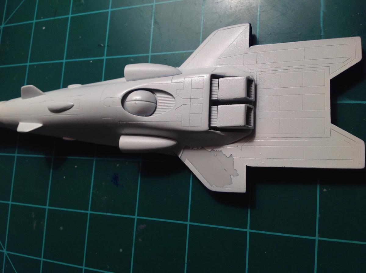

derex3592 Posted October 12, 2013 Posted October 12, 2013 (edited) Some progress......1 step forwards and two back....DO NOT UNDERSTAND why this happens.....uhhhgggg.... Edited October 12, 2013 by derex3592
wm cheng Posted October 13, 2013 Posted October 13, 2013 Some progress......1 step forwards and two back....DO NOT UNDERSTAND why this happens.....uhhhgggg.... Sorry to hear about that. It looks like you didn't wash off the mold release thoroughly enough and the paint was applied over a section with the resin mold release. I usually scrub down my resin kits with ajax and a toothbrush.
derex3592 Posted October 13, 2013 Posted October 13, 2013 I cleaned it with dawn dish washing soap thoroughly....maybe I'll try Ajax next time
derex3592 Posted October 13, 2013 Posted October 13, 2013 (edited) Tamiya Fine Surface primer. I think that's where my problem lies. It did not lay down well. I have problems getting primer to lay down smoothly, and my paint suffers because of it I think. I want my paint jobs to look smooth and even like all of Electric Indigo's do! Every time I use primer it gets me into trouble, but what choice do I have when you have to putty and sand? Edited October 13, 2013 by derex3592
Mechleader Posted October 13, 2013 Posted October 13, 2013 I let them soak in Engine degreaser. Then dish detergent and a toothbrush
Ahab Posted October 13, 2013 Posted October 13, 2013 (edited) What it may be..and I hope it's not... is the casting itself. Sometimes, during the mixing of the PU resin, If the A and B parts aren't mixed thoroughly, cavities of uncured resin can find itself in and on the surface. Years ago when I first began molding and casting, I came across this issue once. I washed the hell out of the piece with no success. I ended up dremelling out the problem spot and filling it with bondo and rescribed. the details. Good luck, man. -Ahab *I just re-read your post (#2034). Are you running into this problem often (on other kits), or is it that particular spot on the model? Edited October 13, 2013 by Ahab
Noyhauser Posted October 13, 2013 Posted October 13, 2013 Ive heard of of that specific problem ahab. I've never had it and it certainly does not sound fun. It might be the case since tamiya white is one of the better primers you can find.
derex3592 Posted October 13, 2013 Posted October 13, 2013 (edited) Well, I've had problems with a "rough" primer lay down before, but also with tape lifting off paint before to. I use Tamiya masking tape and the white paint had been layed down 5 days prior to masking it. I dunno..bad luck I guess. The order of coats was this... 1. Tamiya grey fine surface primer 2. Model Master light ghost grey enamel base coat 3. Model Master classic white enamel. Then masked for blue and the tape pulled off the paint/base coat/primer all the way done to the plastic. Edited October 13, 2013 by derex3592
PetarB Posted October 13, 2013 Posted October 13, 2013 I let them soak in Engine degreaser. Then dish detergent and a toothbrush This is exactly what I do. Then Tamiya fine primer. I have found it's the best for me. However I do not use Model Master, I exclusively use Tamiya acrylics. I've never had a pull-up issue.
derex3592 Posted October 13, 2013 Posted October 13, 2013 I can't easily get Tamiya acrylics locally and I don't really care for acrylics in general. I have used them before, with good results, I just prefer the enamels for a more durable finish and ease of 1 or 2 coats vs. a million to get acrylics to cover.
Ahab Posted October 14, 2013 Posted October 14, 2013 Hey Derex, The fact that the mask removed the paint/primer all the way down to the plastic (and its localized to the same problem spot) may indicate the resin as the culprit. If you don't want to do major surgery and decide to repeat the steps, try to take down some of the tack on the masking tape you're using and apply it to a piece of fabric (I use my jeans) before applying it to the model. This might help some..
derex3592 Posted October 14, 2013 Posted October 14, 2013 Thanks for the advice guys...I'll let you know how it all works out. Not really digging the color of blue either...lol..

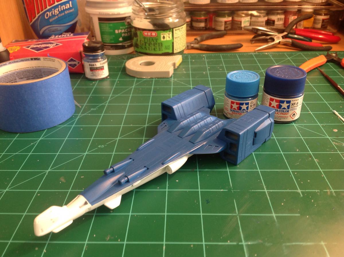

derex3592 Posted October 17, 2013 Posted October 17, 2013 Decided that I really did not like that color of blue so I stripped it off with Windex last night and today I repainted the blue with a custom mix of flat blue and Sky-blue from Tamiya..... what do you guys think ...better? Cause I do!
MechTech Posted October 17, 2013 Posted October 17, 2013 Derex, the color looks good. Hopefully it will stay down this time! Jefuemon, I didn't recognize it in gray (mine was green) and the fact I built it like 30 years ago! I forgot it had movable surfaces on it. Those hinged parts were thin and even broke on the sprue before building. The weapons load was cool too! The other biggie I got was the 1/32nd Monogram Tomcat - with REAL rubber wheels! - MT
modelglue Posted October 18, 2013 Posted October 18, 2013 That does look like a better blue IMO, derex. Seems like a more genuine space faring blue than the previous rendition!
derex3592 Posted October 18, 2013 Posted October 18, 2013 (edited) Thanks guys ! I really do think temperature and humidity make a lot of difference when painting . today was 70° with very low humidity and my paint laid down excellent. Here in Texas we do not get many days like this, I think if we had more, my painting would be a lot better and easier! Edited October 18, 2013 by derex3592

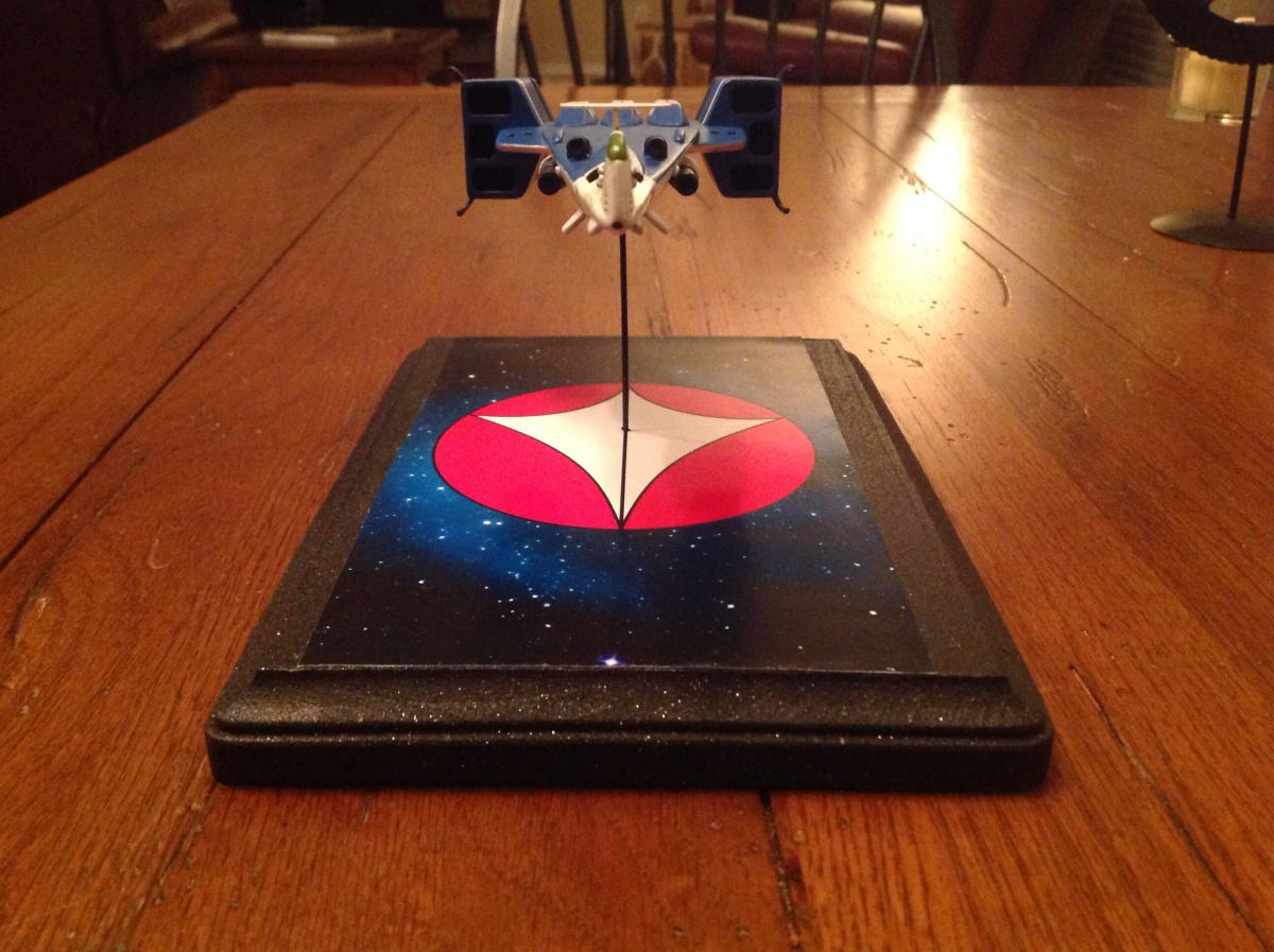

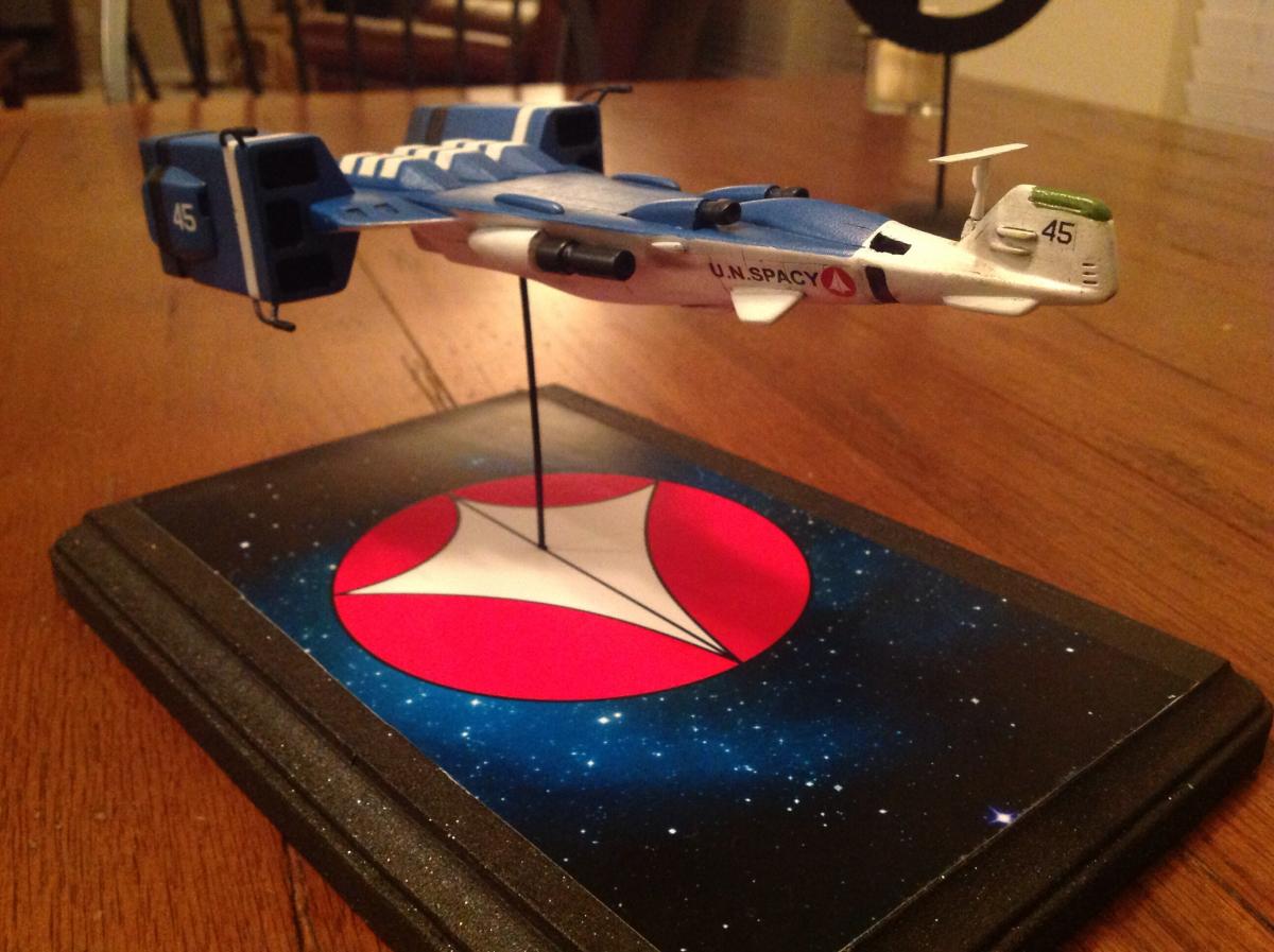

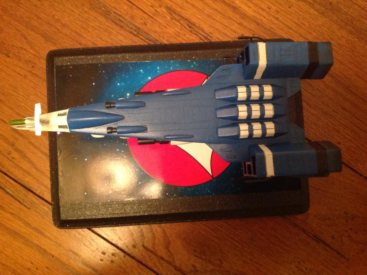

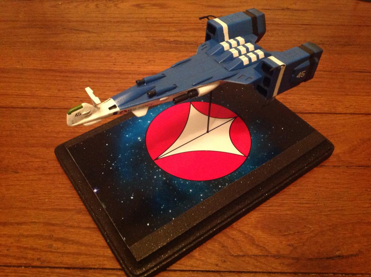

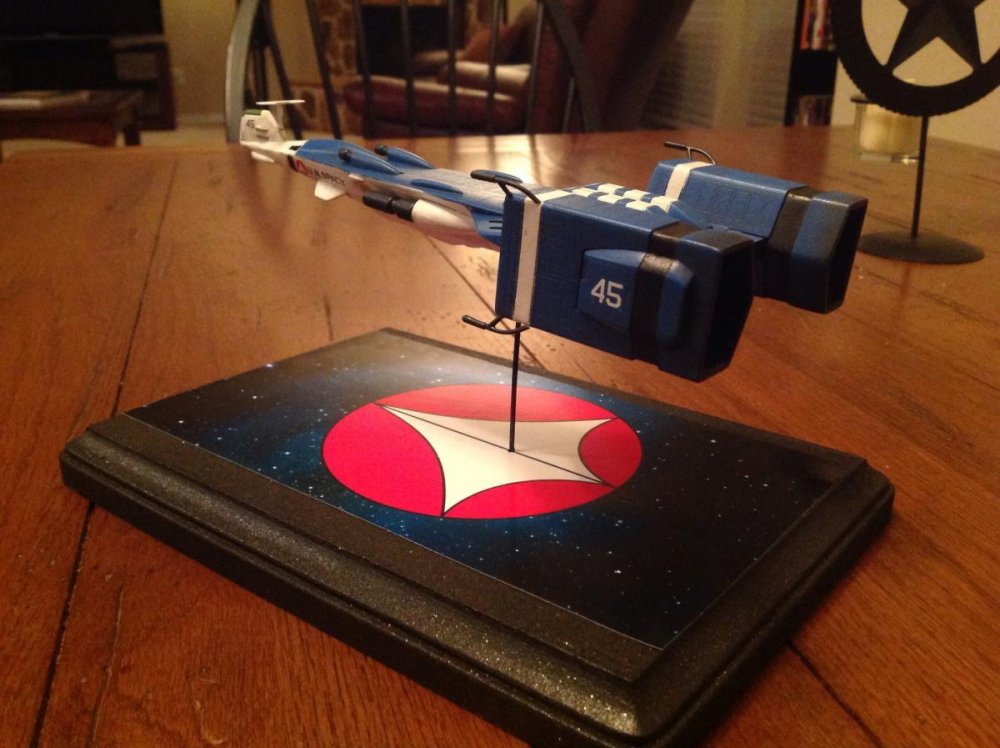

derex3592 Posted October 27, 2013 Posted October 27, 2013 Ladies and Gentleman....The Macross Heavy Missile Cruiser "Oberth"! ...built...(rather painfully because of horrible resin that would NOT hold paint)...by yours truly....enjoy! Seriously though....I'm soooo over resin kits not made by Captain America or someone reputable around here....this should have been a two weekend fun project, not the long drawn out ordeal it became!
Thom Posted October 27, 2013 Posted October 27, 2013 Awesome Oberth! You can't tell you did all that work. Which is a good thing.
