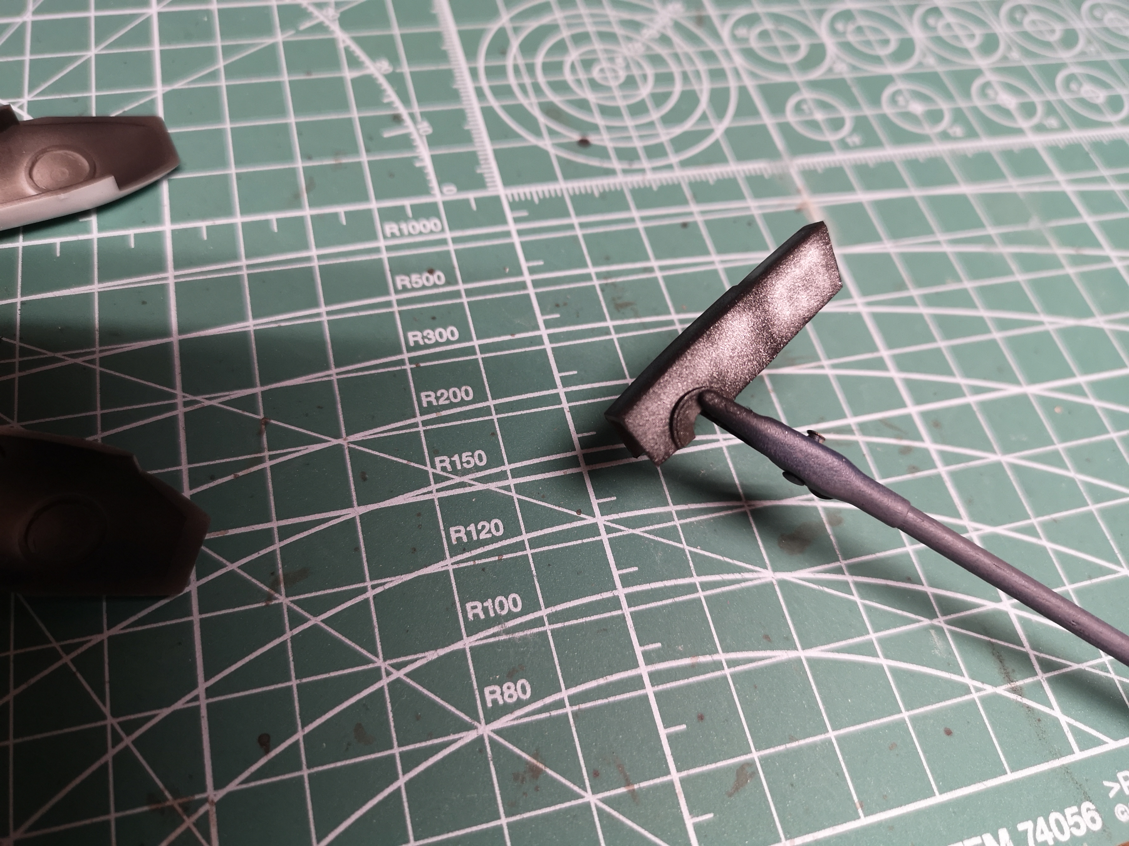

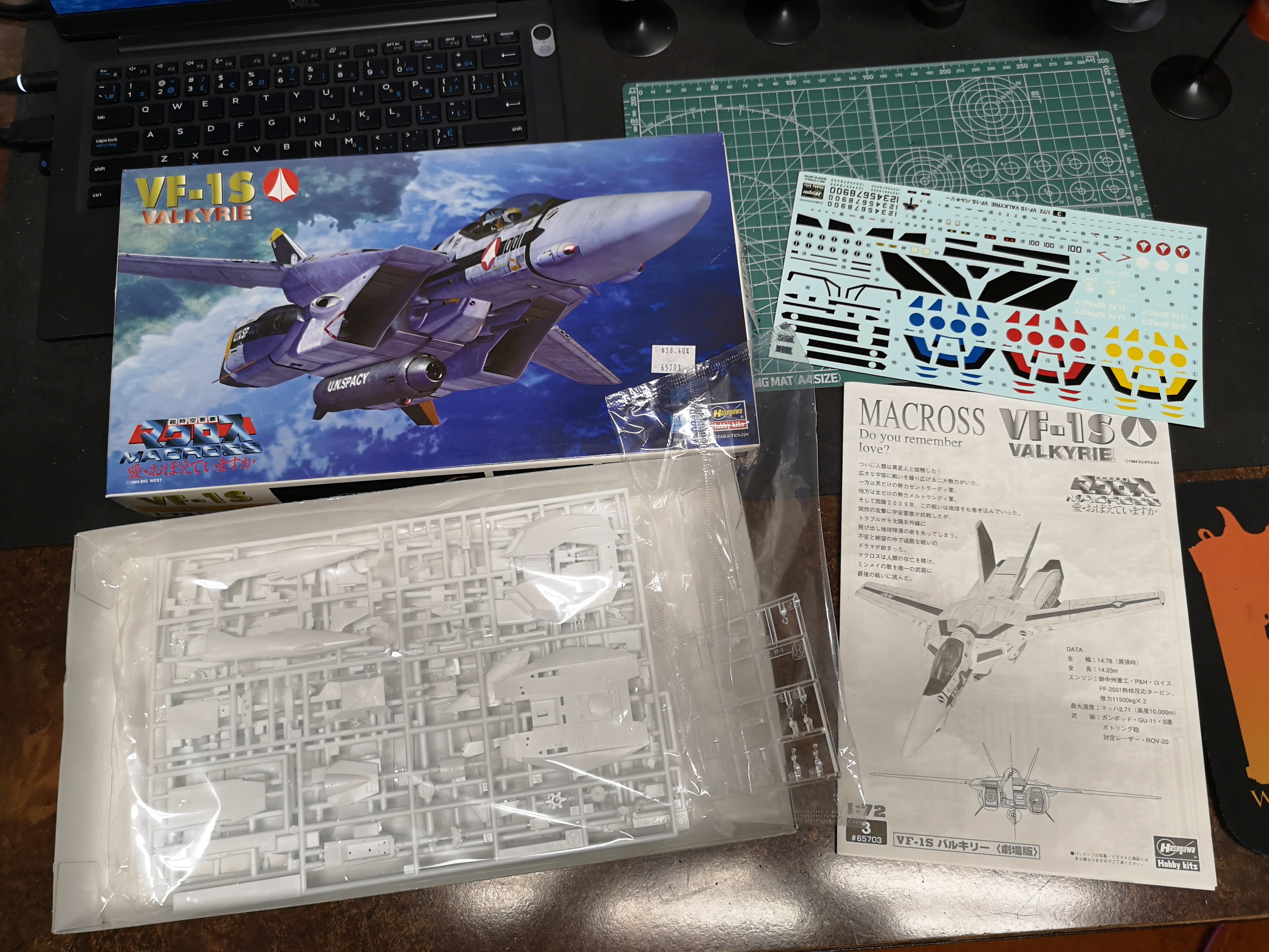

While I was watching the primer dry on the 1J, I decided to open the 1S.  IMG_20210331_163326.thumb.jpg.d6e13ac49319ea0a55047871b7146411.jpg
Figured it sat in my pile for almost 20 years, maybe I should get it going.
All my leftover TV missiles will come in handy for these TV builds.
I wasn't going to bother fixing it, but then decided I may as well practice and see how bad I screw it up.
Top leg is unmolested, bottom one is "fixed".  The IJ is mostly glued together so I won't mess with it, so just the 1S for now

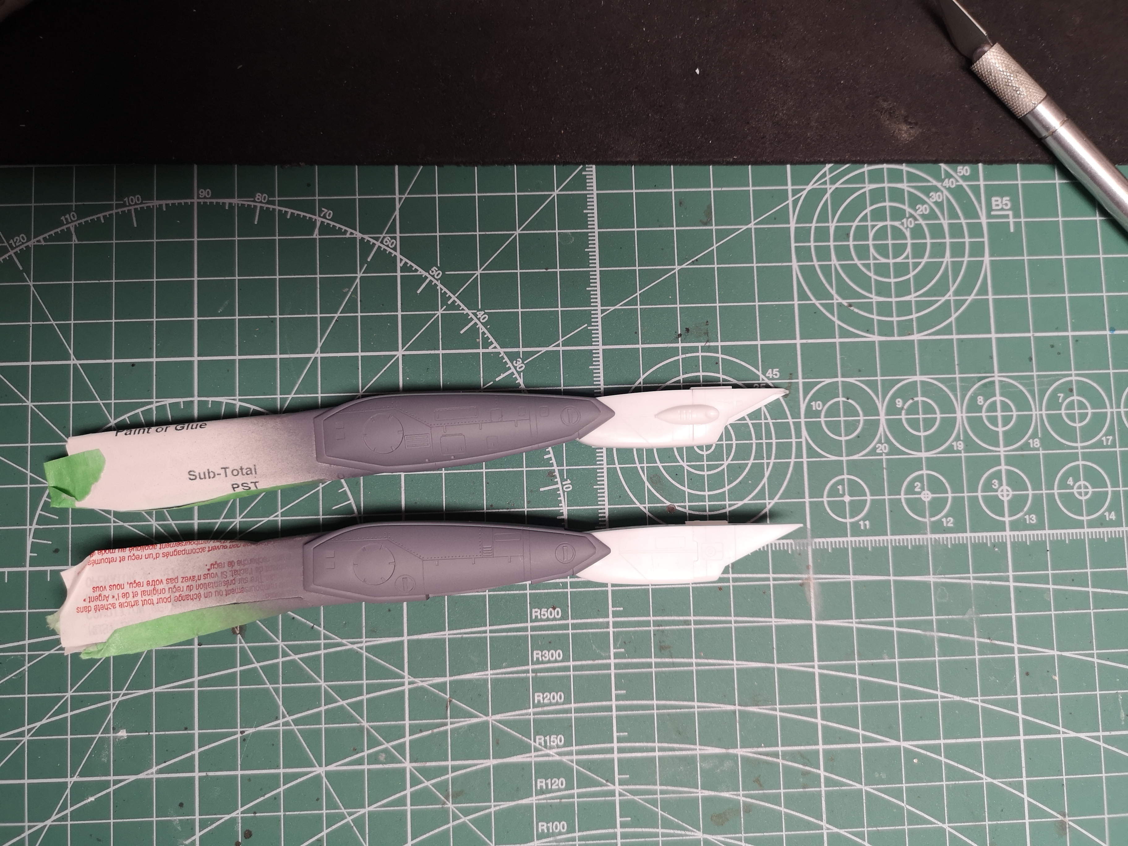

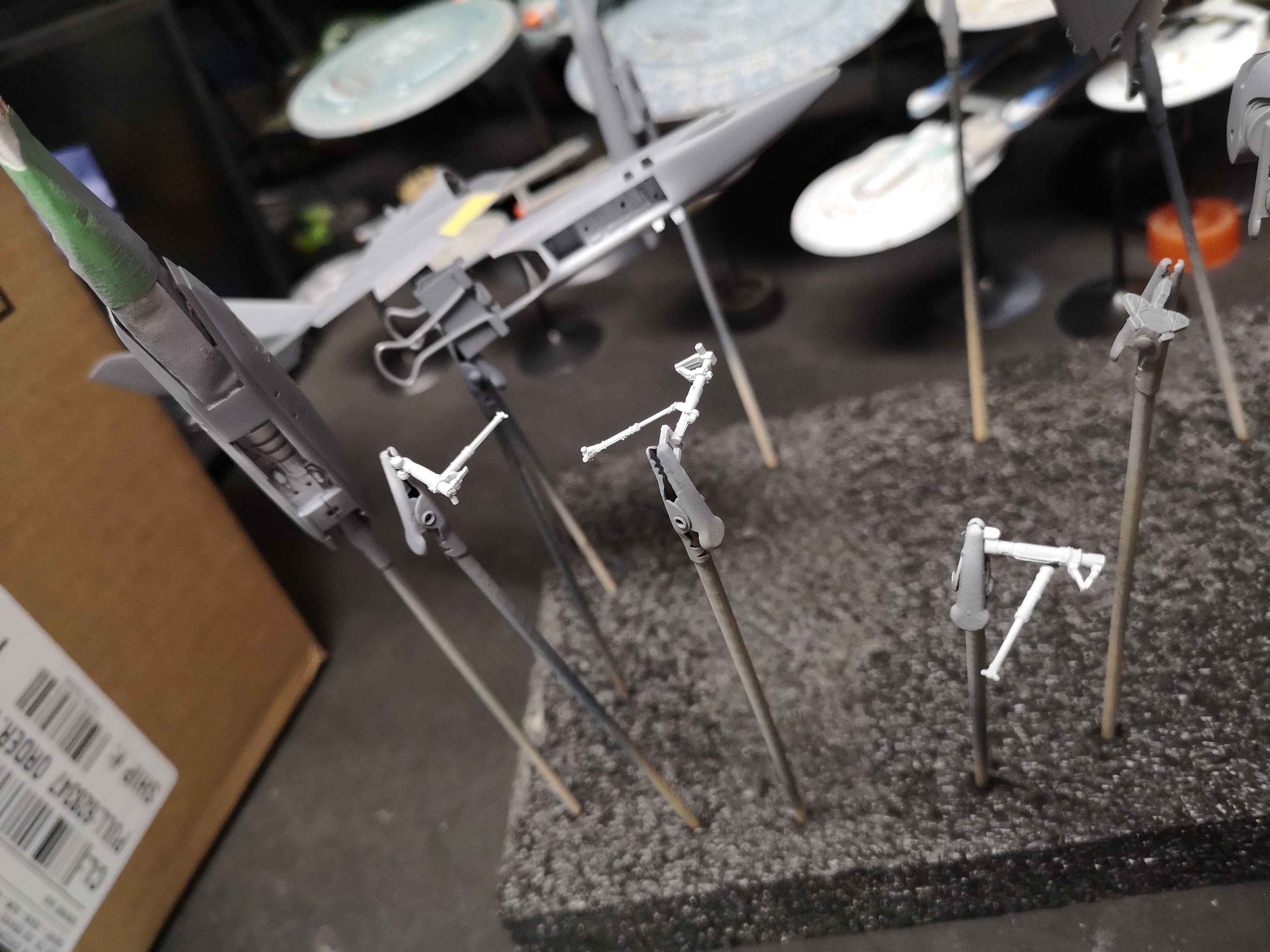

Now I'm finally getting around to models I bought 20 years ago, using up rattle cans and bottles of paint that are probably just as old.  Surprisingly still ok, though some needed some thinner.
Comparison between a regular nose gear, and a launch ready one....lol, can hardly tell the difference.IMG_20210401_125228.thumb.jpg.1aeea30bcef0a68c7ab8b9062665bd7c.jpg
Tried something different on the feet.....flat black base paint, then dusted on the Steel.  Ended up looking it it was sprinkled with stripper glitter. Side not and tip to the fellas here, that $hit is impossible to wash off so don't get any in you.....or so I've heard.
Top one was straight steel, bottom intake covers are stripper glitter over flat black.

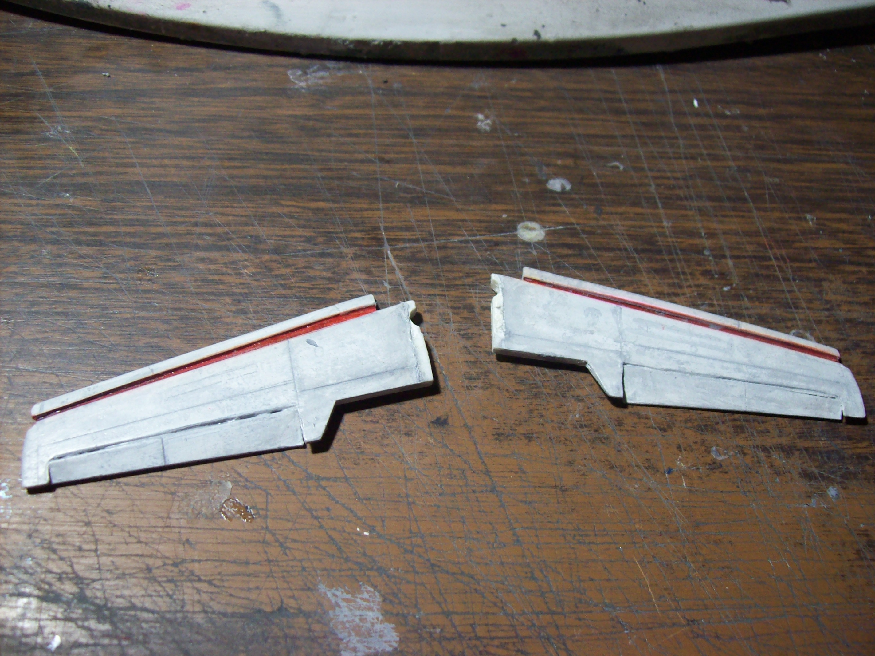

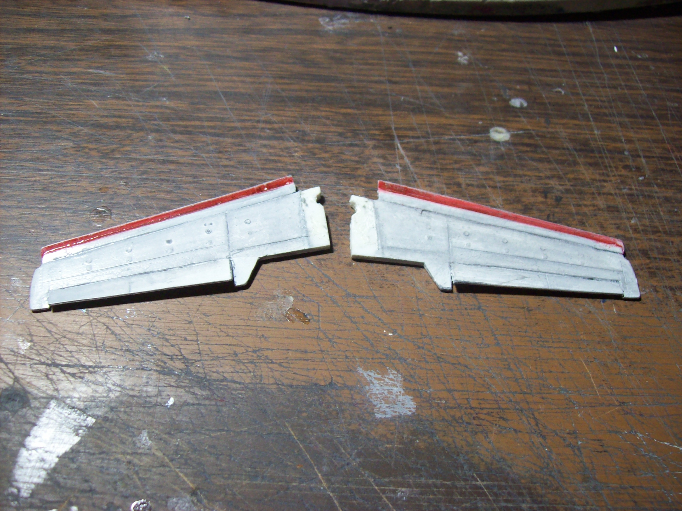

I remember building the 1S; I modded the wings to have "dropped flaps and slats". Not my best work, but passable:
1921294584_100_00711.thumb.JPG.388059ee0117d6063d191ea92802c108.JPG 323932568_100_00721.thumb.JPG.df2336d8280ab6074f571040b423d57b.JPG
Ended up not using them (model later didn't go so well), so I stashed these aside. Probably would need stripping and rework; the attachment bar they slid onto snapped off inside them, so that would have to be dug out.

Holy crap, that's well beyond my abilities.....and patience.  I would totally mangled the wings.  I couldn't scribe a straight line, let alone saw flaps off and reattach them like that.

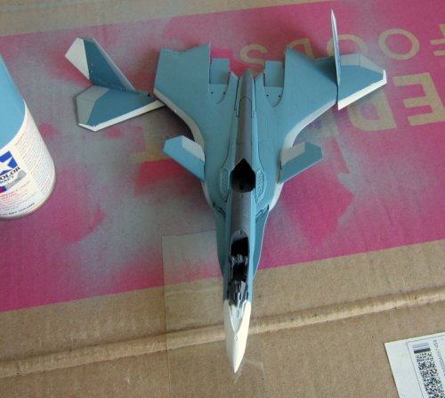

A bit more progress today with the 31A. B))
Nice work!  Love Tamiya rattle cans, spent a fortune on them over the years, lol!

Thanks @peter Yeah those Tamiya cans aren't necessarily cheap but man how the paint goes on evenly. :)
It's not that hard, because you have panel lines along which you can scribe/saw. You saw through the wings at the short edges, and then use a scriber to cut through the long edge.
If the wings actually use separate parts for top and bottom half, you can cut out the flaps on each halve and then fill up the remaining space with plastic card.
The only real problem occurs when the top and bottom half of the wings are not properly aligned with regards to the panel lines, and the wings are a single piece.

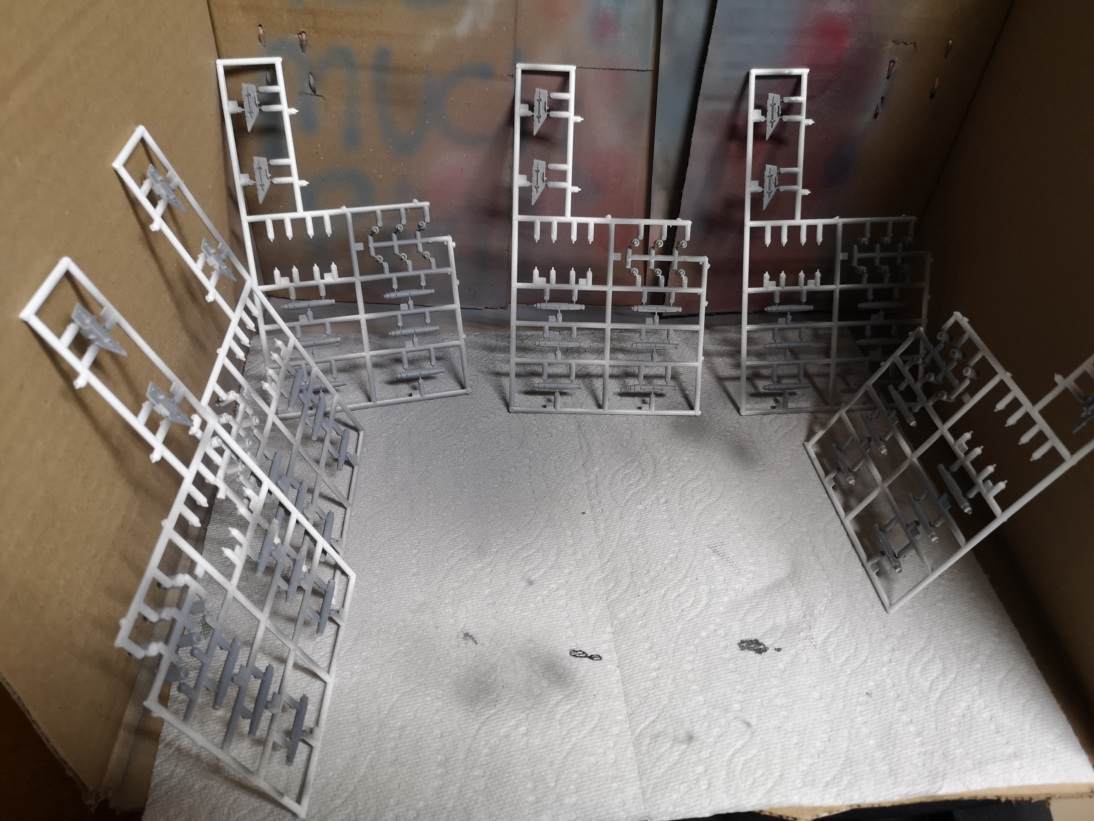

Not much to report on the VF-1 builds.  Just painted the white bits like the landing gear, bays and intakes.
I'd forgotten that white requires a lot of coats over darker primers.

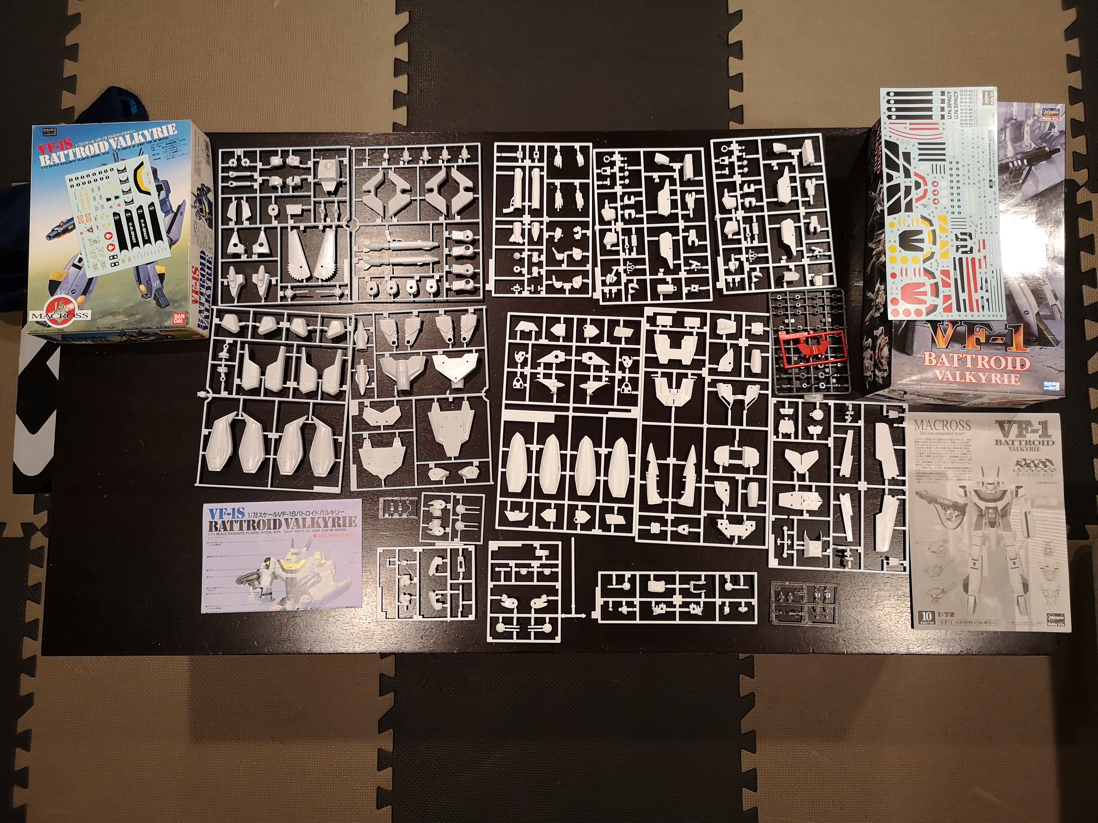

While waiting for the paint to dry, I got curious about a few Battroid kits I bought, also about 20 yrs ago or so.  I laid them out to take photos for a comparison, and next thing I know, I start cutting parts off trees and started to fit a few parts together.
Wow, the Battroid version is coming across as a lot easier to build so far.  The older Bandai might be a bit of a pain, what with captured parts.  I build a few of those old Bandai kits as a kid, and made a mess of them, so hopefully I can do better now.
Got some subassemblies slapped together, did as much as I could without my helping hands magnifier.  Left eh forearms open because it does capture a clear piece, so that might need some pre-painting before closing them off.
More to follow.

Personally, I use a small handsaw for the cruder jobs, and photo-etched saws for finer work (these literally come as a fret of photo-etched parts, and typically include saws you can hold between a few fingers and also versions that can replace your modelling knife blade)

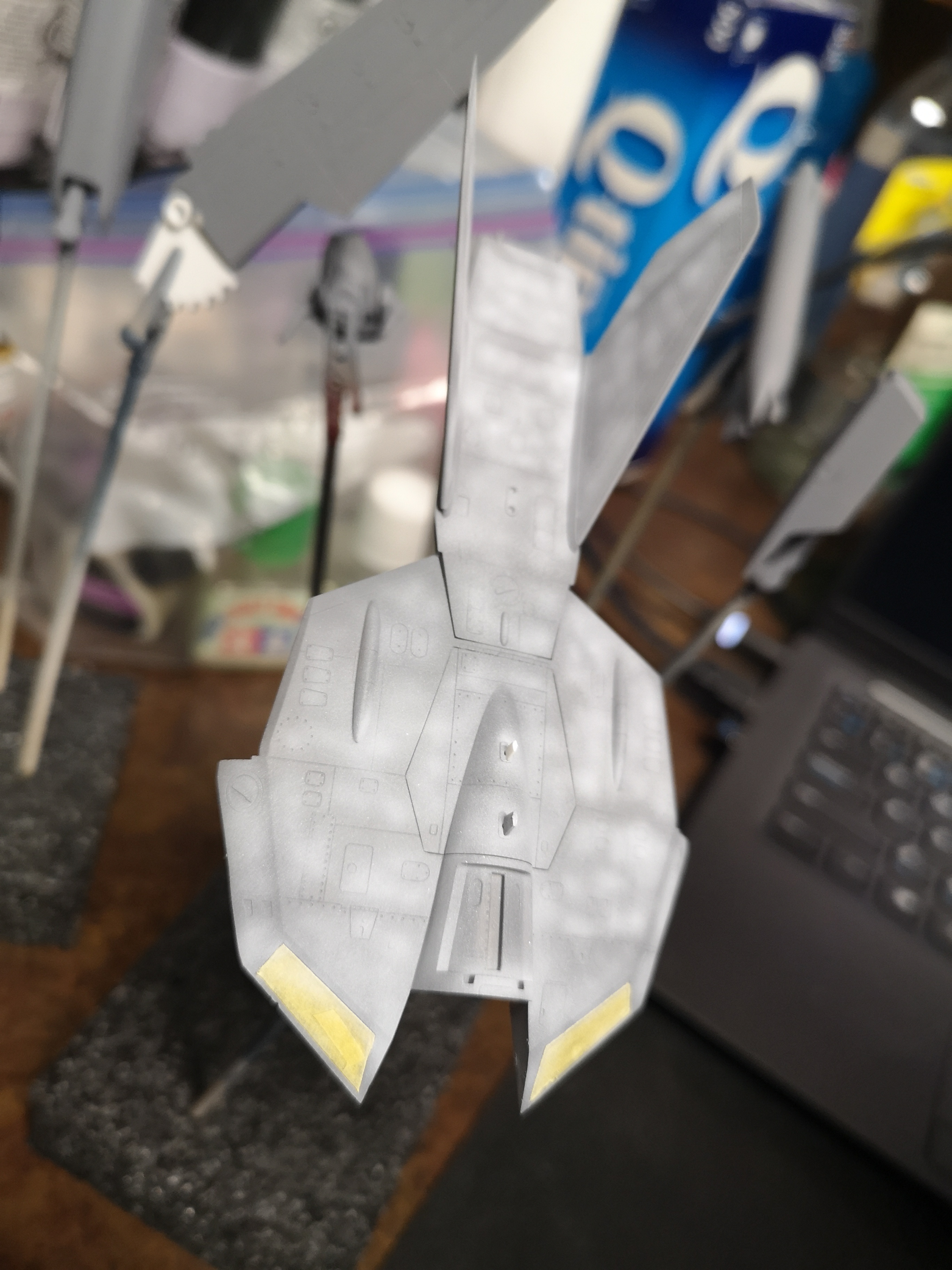

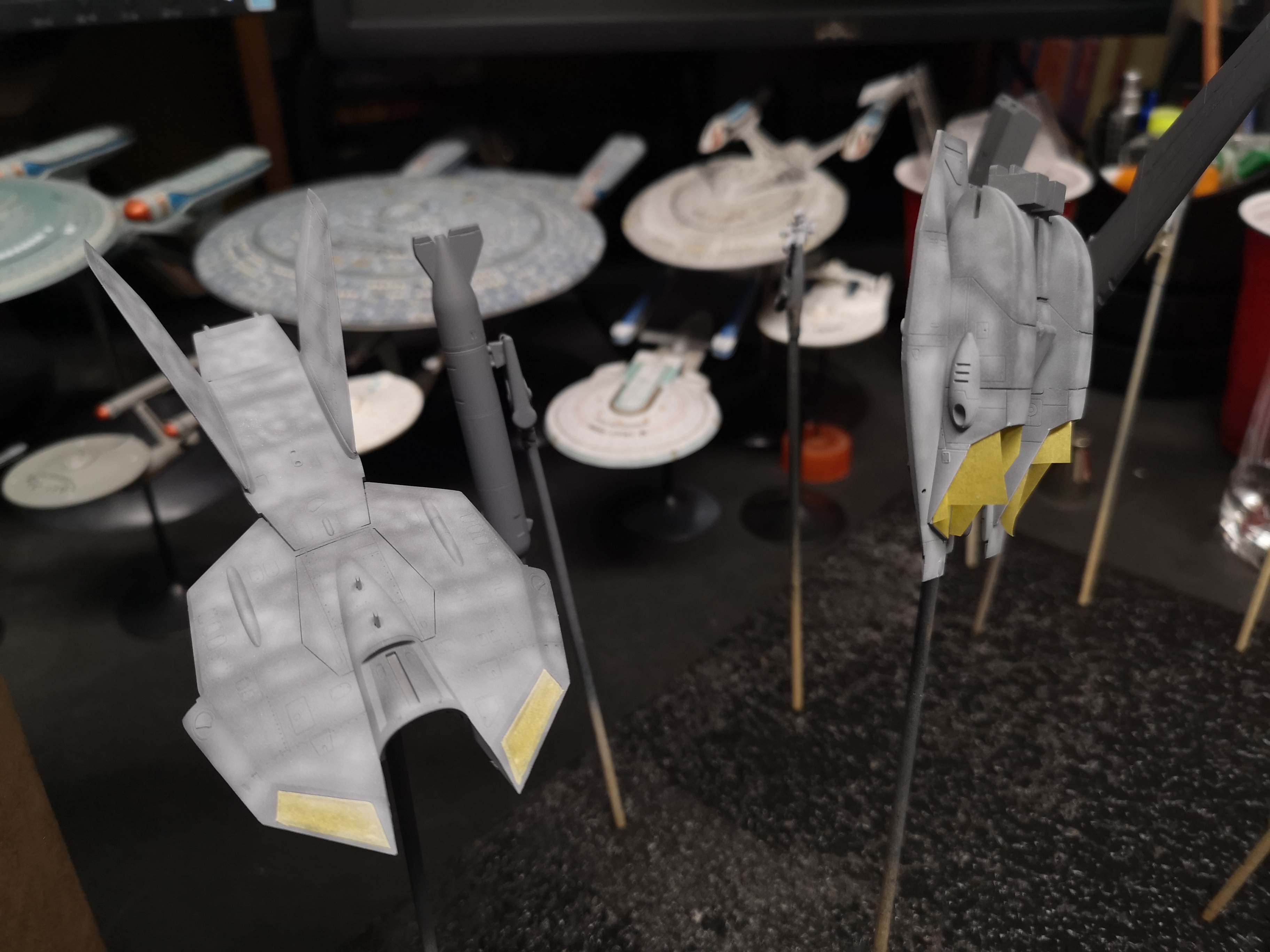

White on grey primer (actually, it's white with a few drops of gray)
I've only rattle-canned my recent Valkyrie builds in a light grey, so this was the first time I was going for white.  Also, first time painting a Valk with an airbrush.
Really digging the splotchy look.
A few more coats
I still sort of like the gray....I don't know if I want to go full stark white from the anime.  Also, worried if I go further, I'll lose the splotchiness.
Edited by peter
Edited for spelling
A few more coats
I'd stay with the splotchiness; it looks better. keep in mind that the anime wasn't exactly going for "photo-realistic".

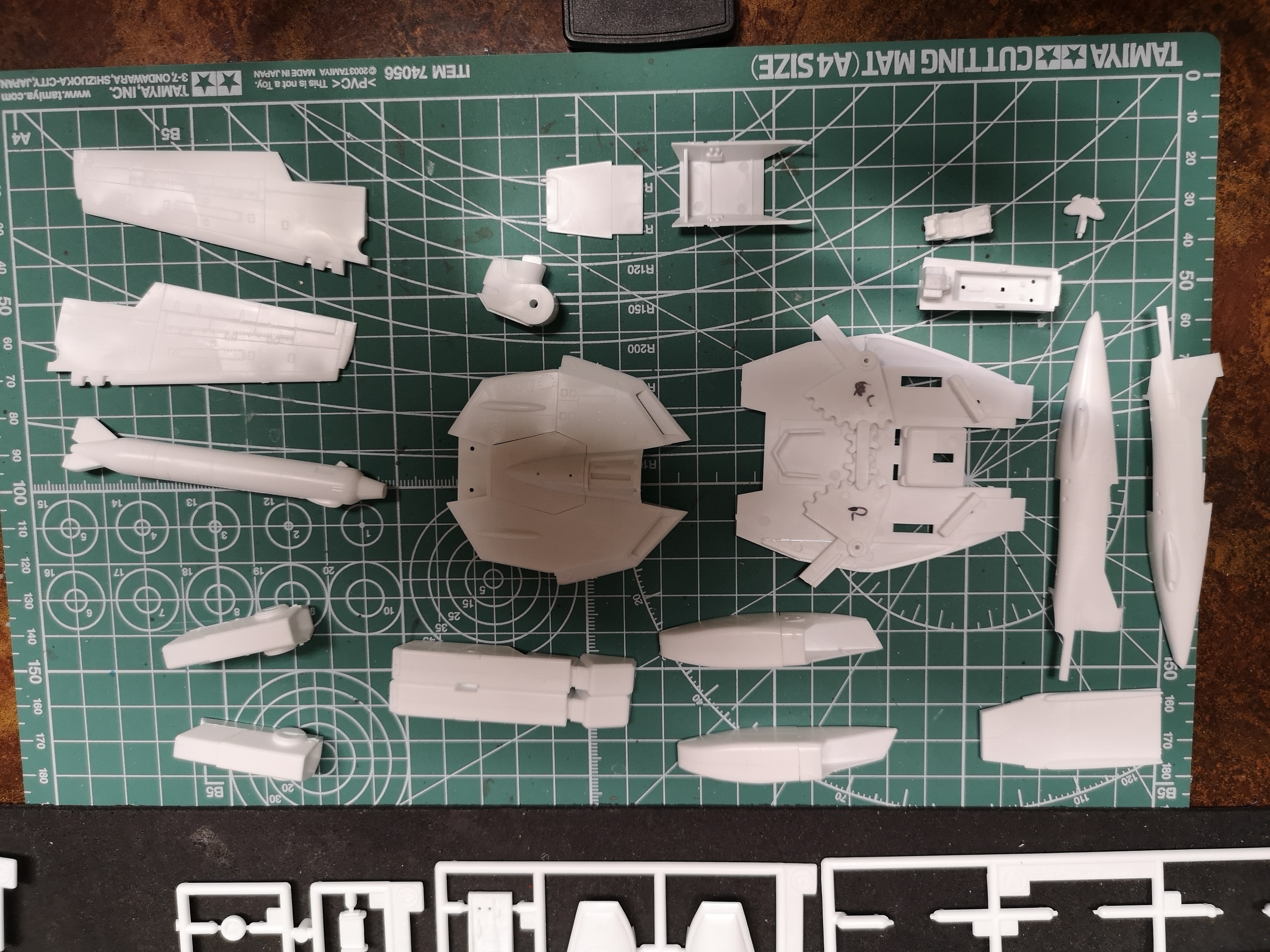

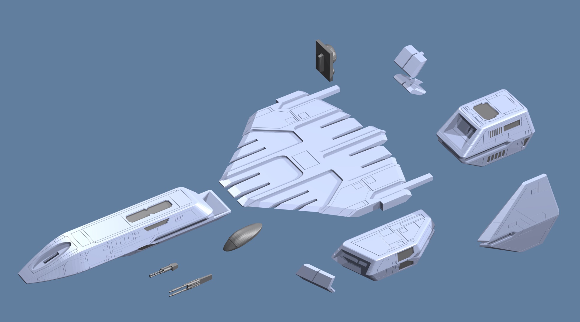

Building up that intake duct to print out got my 3D printing itch started again, so I figured it's time to see if I can't get the rest of the parts for this Excalibur model finally built up.  Spent a few hours engraving the rest of the panel lines, and got the parts actually what I would call "finished."
Now the "fun" part... test printing everything to see if it will actually fit together.  I've got the tails and engine exhaust panels done, so next up I'm trying one of the engine mounts (large pod on the far right).  Going to be a long ten hours waiting for this one, and I'm really not looking forward to how long the main wing will take. :ph34r:

Interesting...resembles the Hellcat from Wing Commander IV.
Hah.. good reason, it's a design from Wing Commander III, and got used in IV some.  Been building this model for literally decades, it started as an X-Wing vs Tie Fighter mod. :lol:
