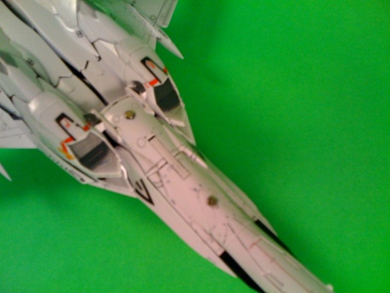

Lodizah Posted December 10, 2008 Share Posted December 10, 2008 (edited) I added magnets to the underside of the fuselage because my tab broke off into the cockpit. This conveniently filled the gap. I used 1/8 diameter magnets by 1/16 thick. It's really stable now. Thanks to WM for the magnet idea and thanks to Vince for the link to the magnet store. Edited December 10, 2008 by Lodizah Quote Link to comment Share on other sites More sharing options...

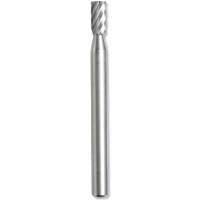

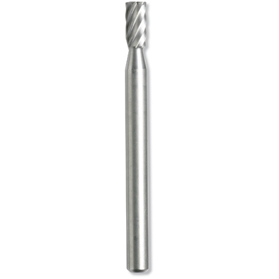

shiroikaze Posted December 15, 2008 Share Posted December 15, 2008 (edited) What do you guys use to make the niche for the magnets? A drill? Edited December 15, 2008 by shiroikaze Quote Link to comment Share on other sites More sharing options...
Lodizah Posted December 15, 2008 Share Posted December 15, 2008 What do you guys use to make the niche for the magnets? A drill? Use a drill bit to start the hole.Then use a dremel hi-speed cutter (size is 1/8). Quote Link to comment Share on other sites More sharing options...
shiroikaze Posted December 17, 2008 Share Posted December 17, 2008 (edited) Use a drill bit to start the hole.Then use a dremel hi-speed cutter (size is 1/8). Thanks alot. This thread and many other threads have lots of great information to get a model to look its best. Even though I have been building model kits for some time, I'm actually new to the painting and detailing aspect of it (I have a practice model thankfully). Pretty much I'm going through all related threads in the forums to gather as much knowledge as I can. Edited December 17, 2008 by shiroikaze Quote Link to comment Share on other sites More sharing options...

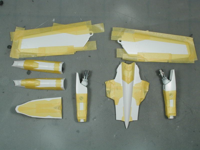

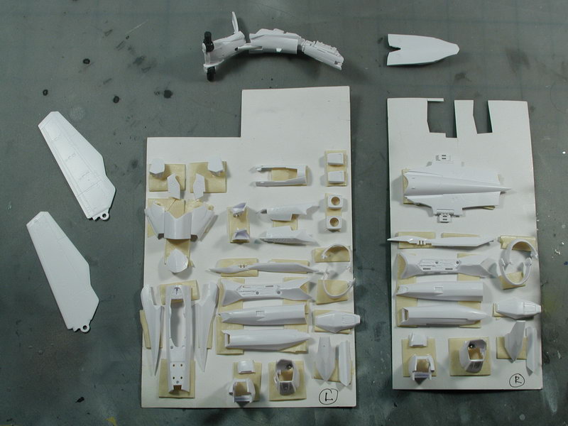

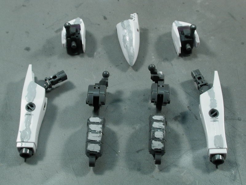

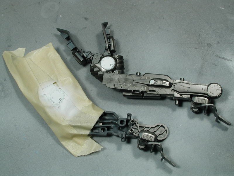

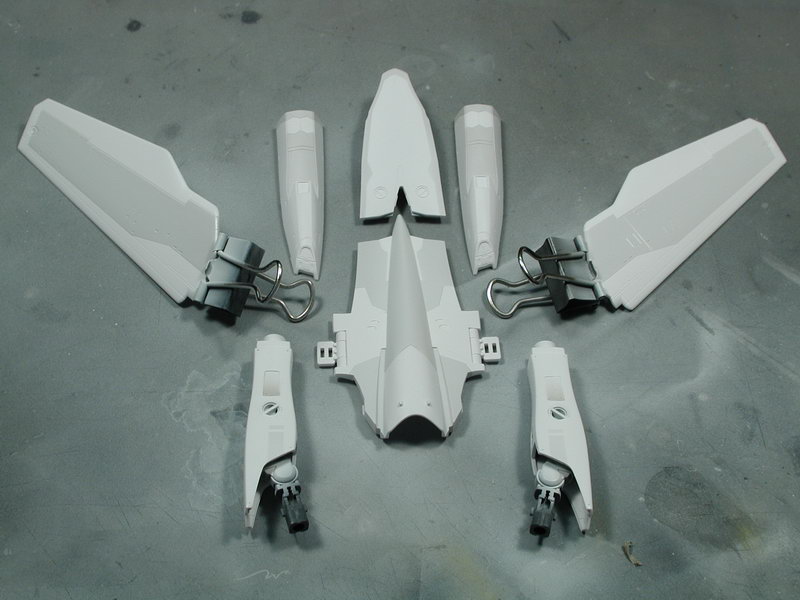

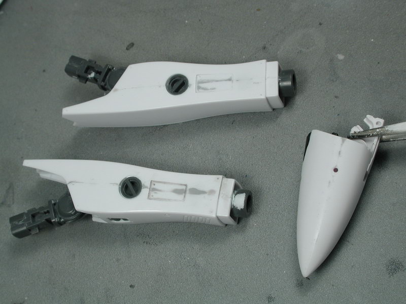

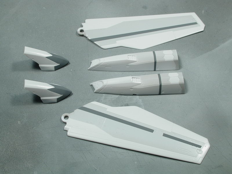

wm cheng Posted January 11, 2009 Author Share Posted January 11, 2009 OK, as promised some photos of the recent work I've managed to sneak off to do (sorry its a bit anti-climatic after all this waiting...) Basically I've separated out all the parts that get a white spray (it takes away the slightly purplish cast that the Bandai white plastic has) and taped them to a cardboard tray for painting. The key thing here is that the wings need to be fully finished, clear coated, decaled and weathered before attaching them back into the wing glove pivots so that can then be glued and the seams be filled and sanded, then painted, so we have to basically re-paint and seal that part all over again after the wings are finished. I also broke down the parts that needed filling to get rid of the seam, I used Tamiya putty for the bigger stuff and Mr. Surfacer 500 for the smaller stuff. There's a shot after the sanding too. Lastly I sprayed everything else Steel from AlcladII metalizer paints as the base metal skeleton to be detailed over top of. Then I masked that little circle detail on the ankle - it would of been so simple for Bandai to mold this piece separately as an add-on later, but they weren't really thinking about people who paint (it was a bitch to mask decently, I'm still not happy with the demarkation between the colours, but once I do the black oil wash over this part, I think it will hide the masked line nicely (I hope!). Today I've clear coated the flat white. I used flat white (Tamiya Acrylics) because it seems to have a better coverage, I find gloss white to be too translucent and requires too many coats to cover anything underneath. I then used ModelMaster clear-coat semi-gloss with some gloss added into the mixture to cover the flat white. The flat white is fairly fragile and is prone to scratching off if not protected. If I use pure gloss, I find the shine too much that it attacts finger prints, this semi-gloss mixture I find is just smooth enough to take decals and an oil wash sucessfully, but not glossy enough to keep fingerprints. Also I want to mask the white areas to spray varying shades of off-white and grey because I find the overall white too flat or dull, but I don't want to stray from the canon scheme too much, so I think some off-white (tinted light grey) panels will make the white plane jump out a bit in terms of paint finish. This clear coat allows me to use the masking tape without fear that it might pull up some of the white paint (which has happened in the past). So not much to show today, just the clear coat which doesn't look any different. Quote Link to comment Share on other sites More sharing options...

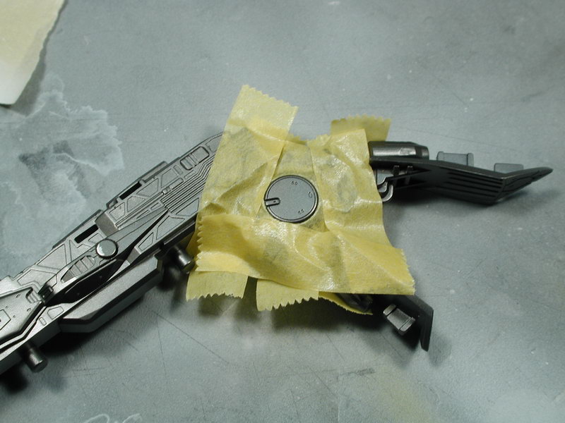

PetarB Posted January 11, 2009 Share Posted January 11, 2009 I'm too chicken to start mine, after looking at this! Still, impressive to see you mask around circles - that's hard, and by hard I mean very, very difficult to do correctly! Nice to see a bit of progress, looking forwards to seeing more. Quote Link to comment Share on other sites More sharing options...
Wicked Ace Posted January 11, 2009 Share Posted January 11, 2009 I also broke down the parts that needed filling to get rid of the seam, I used Tamiya putty for the bigger stuff and Mr. Surfacer 500 for the smaller stuff. There's a shot after the sanding too. Aren't the forearm seams supposed to be there (for removal to expose endoskeleton frame)? Quote Link to comment Share on other sites More sharing options...
David Hingtgen Posted January 11, 2009 Share Posted January 11, 2009 I hear ya on the ankle circle detail. I ended up just doing it "inside the groove". I tried doing it "properly" (with the curved outer ring white too) but it was impossible for me to mask. There's really nothing TO mask---the "not white" section surrounding the outer edge is less than .5mm wide for about 1/2 the circumference (the right side on the pics), and every masking tape type/size I had ALWAYS just "fell off" the edge and lifted up off the part in that area. (I am loathe to cut tape directly on a part to make a mask---I always try the "ultra-thin-strips wrapped around" method) PS---if you freeze-frame the show, you'll find LOTS of minor inconsistencies for how small details like this are painted. How Bandai did it is "only correct for 1 particular scene", if that. I don't worry too much about it being "correct" when there's obviously multiple models/texture maps used, and they're not identical. Quote Link to comment Share on other sites More sharing options...
electric indigo Posted January 12, 2009 Share Posted January 12, 2009 There are blades made for use with a compass, and you can cut a circle from airbrush masking film with that. It might take a few atttemps until you hit the perfect diameter, but I find this method much more convenient than the masking tape way in this kind of situations. Quote Link to comment Share on other sites More sharing options...

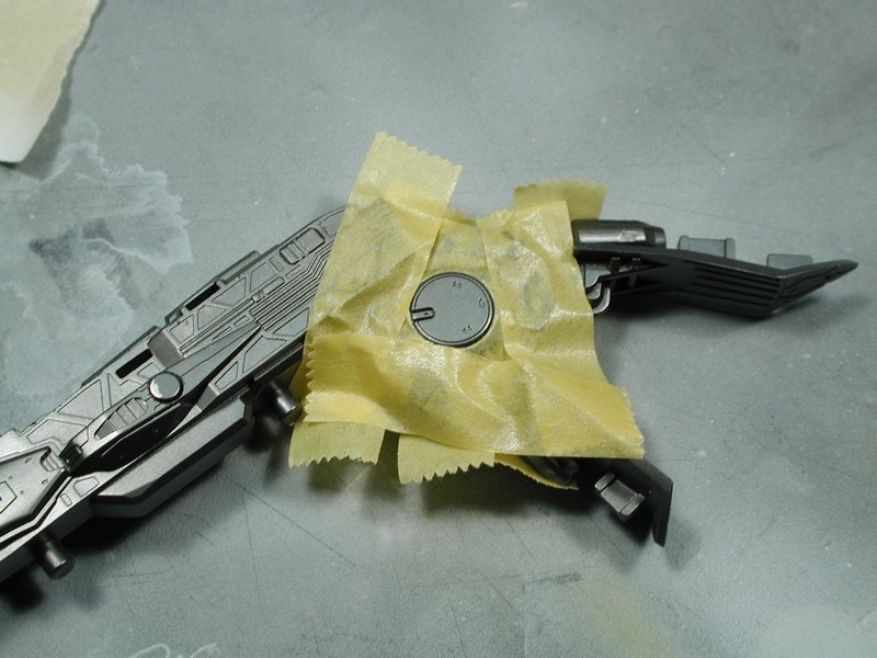

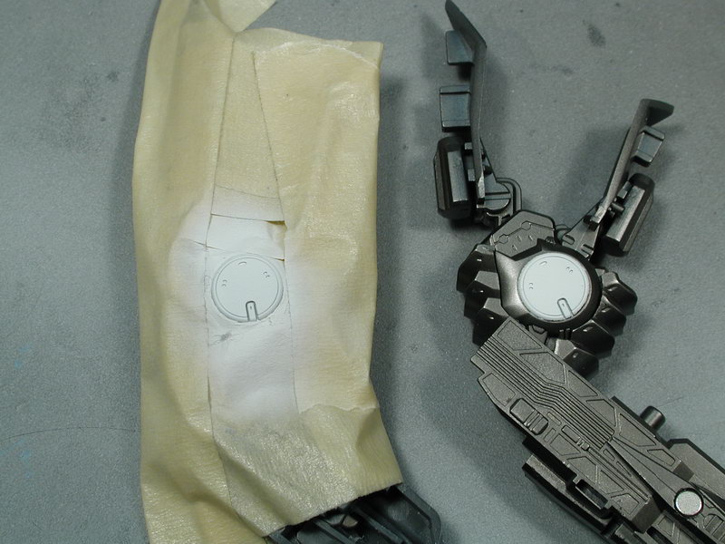

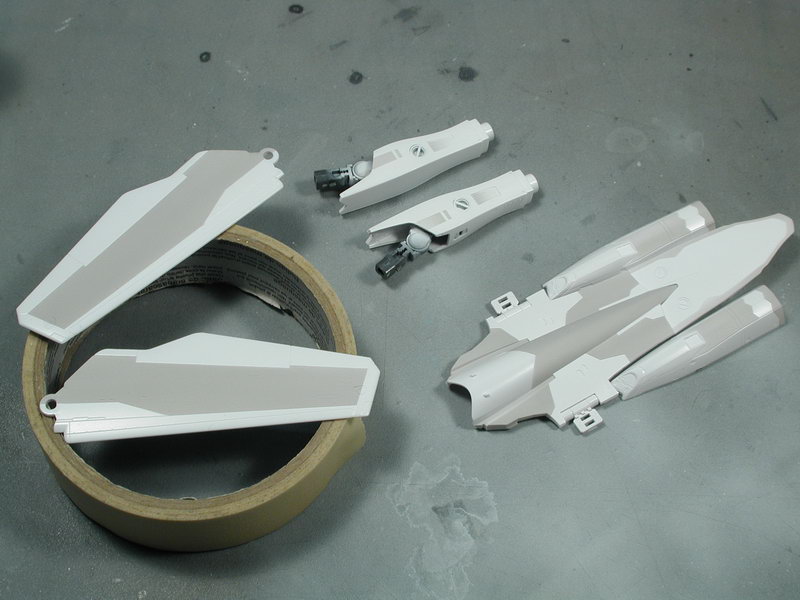

wm cheng Posted January 13, 2009 Author Share Posted January 13, 2009 What I did was use the back of my x-acto knife (the fine no.11 one) to trace a rough circle in pencil, then I cut the circle out of the Tamiya masking tape. The size was not crucial, just close was good enough. As it happened, the hole cut out was a bit smaller than the circle I wanted to mask, so I cut a slit in one side of the hole to open it up, and I "stretched" and massaged the cut circular opening around the circular ankle detail until it matched the curvature. I've found that you don't necessarily need to match the curvature that much as long as you're close (it wasn't even a true circle, just a free hand one...) but with these masking tapes, you can push, nudge, pull and bend it to fit the proper curvature. Because I had to open it up a bit, there was a small portion unmasked which I filled in with a small thin piece - I found that this way it was easier than with many built up pieces and that the curvature was too tight to do it with a small thin strip. Sorry I didn't take any photos of this process, I didn't really think much of it - especially because the edge wasn't that crucial since its in a crevice and a dark wash will be applied so the oil wash will hide any masked messiness. Quote Link to comment Share on other sites More sharing options...

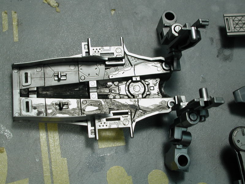

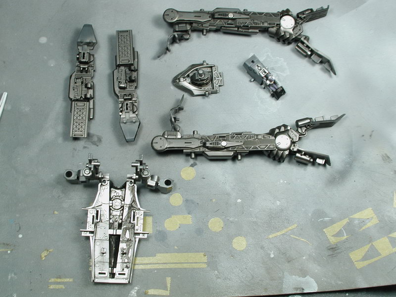

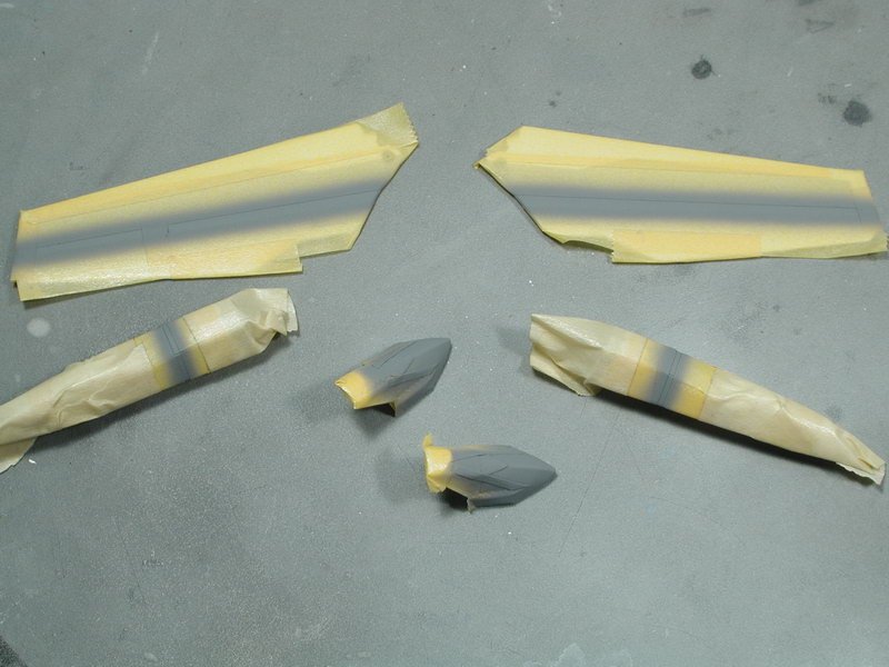

wm cheng Posted January 13, 2009 Author Share Posted January 13, 2009 Just some photos of the grey panelization process. Found out that I liked it better (from my YF-21 & starship Enterprise) that if it was a fairly straightforward scheme like an all white or all blue scheme that it adds interest to vary the panel shadings a bit - so I wanted to get some off-white/greyish tints in there, the overall end result will still be a white plane close to the canon scheme, but I thought that it adds interest. My first attempt was just to tint the white with Tamiya Sky Grey (its warm) - it looked fine in the airbrush cup, but by the time it was evenly applied, it appeared way too dark against the white parts. So I mixed up a batch of thin white again, and airbrushed over it to lighten the grey panels so there was more subtlety in the shading. Its still a bit on the strong side, but I will "post-shade" the panel lines (which will further blurr the edge distinctions between the white and light grey) weather on top and the relatively high contrast decals will all fight with the grey panels in the end. I still want to see the effect. My past experience with the VF-0 showed me that by the time all those other layers were on top, the panel difference was so subtle that it hardly showed through, so this time I was going a bit more heavier. If its still too heavy in the end, I can still spray a light coat of white over the decals to tone them down a bit and tie everything together a bit more as well as lighten any overtly strong paneling. Well... at least thats the plan. Now the next step is to completely finish the wings so I can glue the wing gloves together and fill and sand that seam. I think I will paint the grey stripes on the wings, was well as any of the grey decalled areas such as the back of the leg stripe and the knee patch. Firstly, I hate seeing screened areas on the decals - and unfortunately, the Bandai grey on their decals is a screened element, plus the knee and wing glove will be a "high-traffic" area (lots of movement - so the decal will be more prone to scratching and chipping) - so the hope is that the painted grey will stand up better than the decals. Quote Link to comment Share on other sites More sharing options...

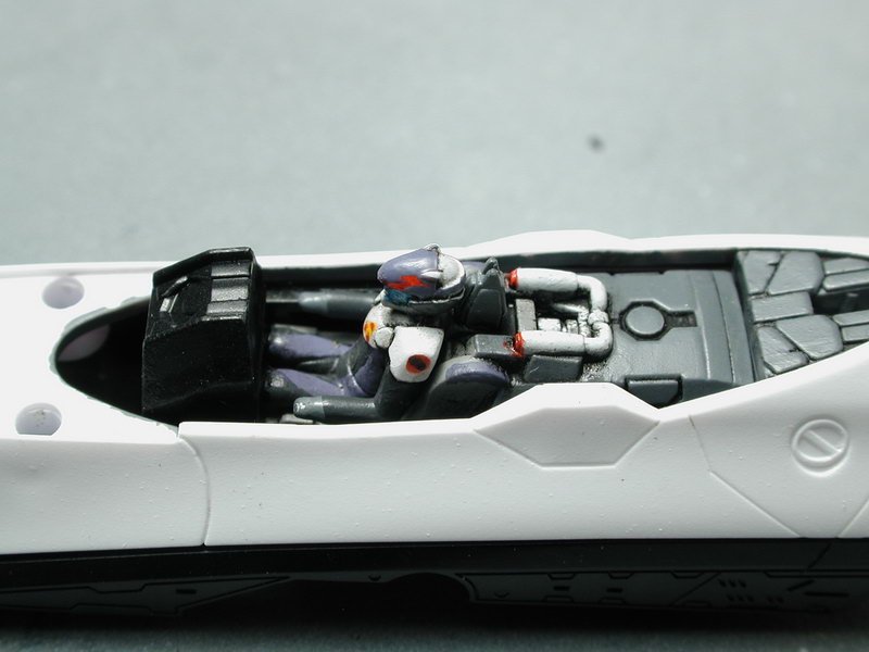

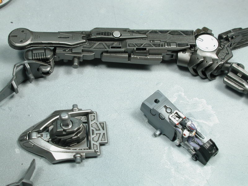

wm cheng Posted January 20, 2009 Author Share Posted January 20, 2009 OK, got to sneak in a few hours over the weekend to work on this bird, its finally starting to come together - but boy, Bandai certainly doesn't make it easy for you if you want to paint this model! I first concentrated on masking the areas that the grey stripe decals would be, since they were relatively simple, the knee part would see a lot of rubbing, binding or chipping and the fact that I hate seeing screened decals on any model, it made sense to me to paint these details. I mixed up a bit of White with Neutral Grey (I was going to use Tamiya Sky Grey, but it had too much of a warm tint that it looked a bit brown next to the white of the plane). Unfortunately only after I removed the masking did it appear too dark compared to the decals supplied, however between the various animation cel references, they sometimes appeared quite dark too, so I decided to leave it alone for now instead of re-painting it. I then hand painted the small details in the cockpit and pilot area. I actually airbrushed the pilot and the area immediately behind him (the two cylinder details) flat white to get a good white coverage first, then hand painted the greys and purple stripes. Then I brushed a bit of gloss clearcoat (to prevent the next step of the oil wash from staining the flat white). The oil wash really picked out the details. I then brushed some gloss clear coat over the helmet and white shoulder pads and flat clearcoat over the grey/purple body suite which really played the contrast well. You'll probably not see any of this well after the purple tint is applied to the canopy in the end, but you never know, I'll know how much I should detail after this one for the Ozma bird. I wished there were decals for the chest SMS logo, I ended up have to approximate something with a yellow marker and a red sharpie marker - it's okay to the naked eye, but by no means great. Maybe it would be a good thing to do a custom decal for as well as the shoulder patches (again they were just drawn on with a sharpie marker). Lastly I did a thick black oil wash over all the metallic parts to pick out all the nicely engraved techno gak! I love this part... and Bandai doesn't disappoint here! Quote Link to comment Share on other sites More sharing options...
