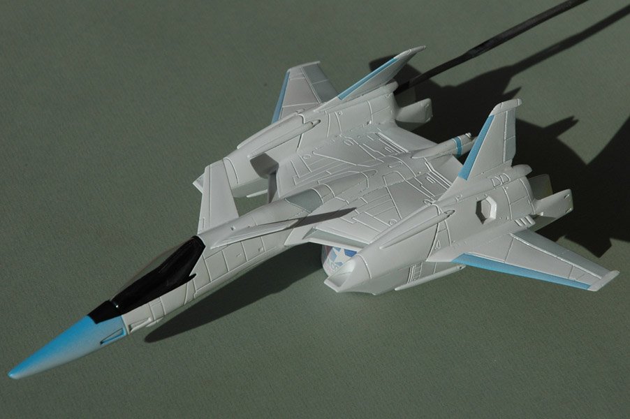

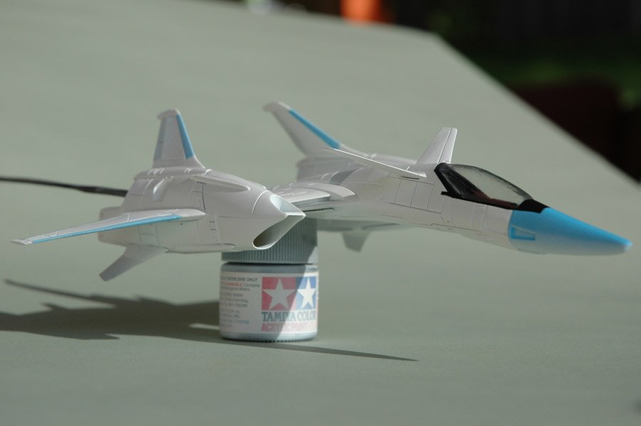

PetarB Posted October 18, 2007 Author Share Posted October 18, 2007 Well it's obviously a longer than a few days. Lots of stuff happening in life at the moment... ...anyway, I spared you the boring bits, which basically consisted of many fifteen minute sessions grabbed here and there of putty, let dry, sand. Then the other day I got a tube of Tamiya Light-Curing putty. Praise to Jesus Christ, Bodhisatva, Vishu and forest Kodama! This stuff rocks. Basically you put it on, away from sunlight, in a gloomy room. Spread it around. Walk outside into sunlight and it cures. In about a minute. I love it! After all filling and sanding, I used my new scriber to re-etch some lines. You can see here the little corkscrews of resin it pulls out, unlike other scribers I've used. I use Dymo label tape to give a straight line. Accidents do happen though...! Anyway here she is after 4 coats of white. I'm going to be putting a couple more on. Some of you might notice that the scribed panel lines are quite deep. A little too deep. If I wasn't so impatient I'd find some way to semi-fill them, but a few coats seemed as good a solution as any. I love the shape of this airframe. The more I look at it the more I like it. I have a non-canon, but very, very Macross plan for decals and trims, but the basecoat will be this white. The next part will be fun, but might be a few days until the next update. Till then, sayonara! Quote Link to comment Share on other sites More sharing options...
