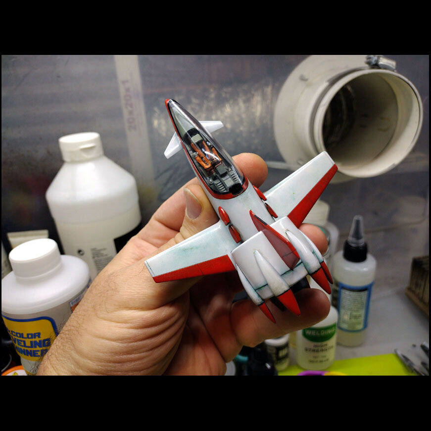

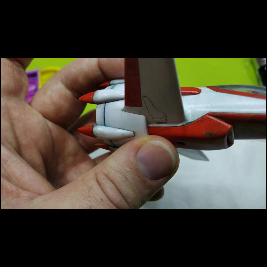

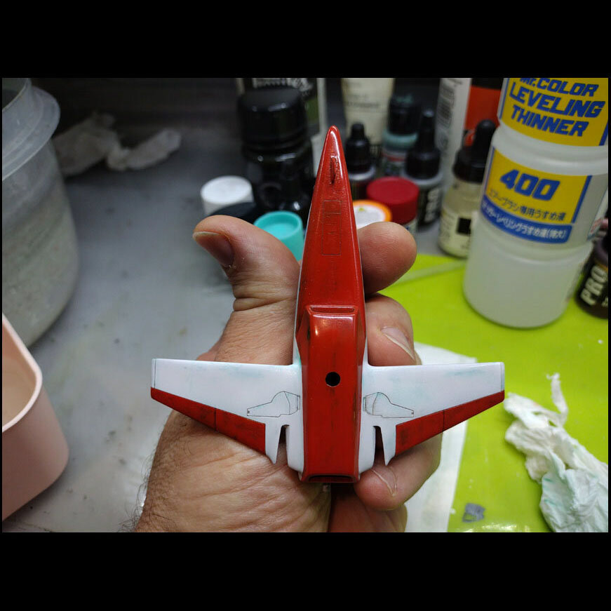

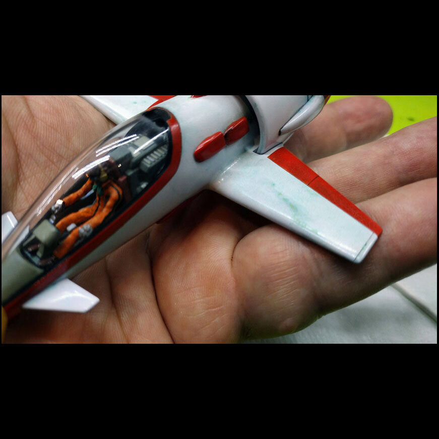

So what now? As they say "It's not a flaw, it's a feature." So I pivoted to implying a story with this kit. Instead of simply being Rick Hunter's Fanracer, this kit will now be Rick Hunter taking a last ride in his previously years-long abandoned Fanracer before embarking on the Pioneer Expedition. If you are a fan of Japanese (particularly WWII) aviation then you know what aotake is. And if not: It's a bright translucent (typically) blue/green laquer primer. My thought was to try to make it look like the aotake was showing through where the paint was worn or cracked. And in a few spots the base material (mostly yellow aramid fiber) would be seen too.
I then wet sanded the small parts with 6k then 10k (note: Japanese grit scale!), and polished with Tamiya's 3-step polishes. Liking the results I started wet sanding the main body... And then this started happening! Micro cracks slowly appeared all over the kit. Looking back I now suspect that my airbrush's water trap was too full and had stopped trapping water, contaminating the Tamiya hybrid acrylic and changing how it cured, which then got trapped under the airtight Future clear and that led to this. I sanded, VERY carefully, through the cracked clearcoat and polished as best I could. Worked fairly well on some of the smaller parts. But not as well on the main body. It was clear that the only way to get rid of the cracks was to sand down the the primer and re-shoot the model. BUT since I didn't know what had caused the reaction that didn't seem like a wise use of time.
