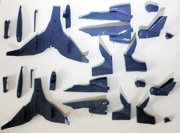

Xigfrid Posted August 12, 2015 Posted August 12, 2015 A few parts have been completed yesterday, more are in the final stage today. The rest of the parts should be finished soon. I can't confirm the date, but as you can see it won't took long now.
spanner Posted August 12, 2015 Posted August 12, 2015 ahhh very good! even in bits it looks great! Cant wait!!!

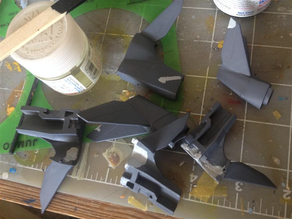

Jasonc Posted August 13, 2015 Posted August 13, 2015 Parts are just about done, which means, barring no emergencies, I can start making the molds for these next Monday, and hopefully start recasting same weekend, if not next weekend. really excited about how it's all looking. these should come out real clean.

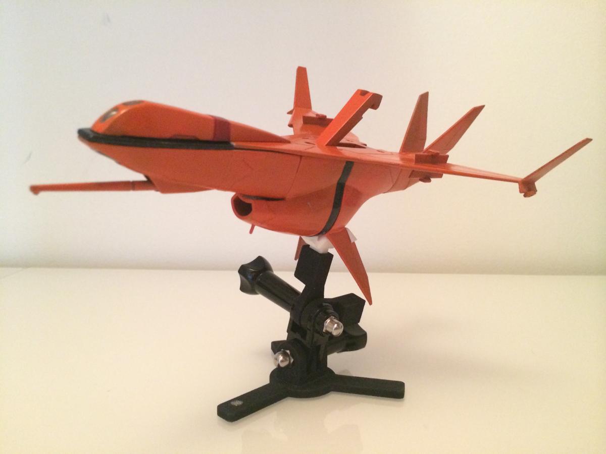

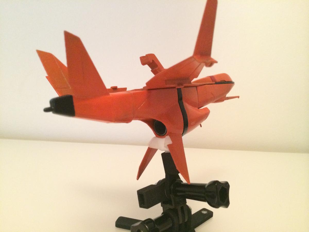

spanner Posted August 14, 2015 Posted August 14, 2015 are there any spots on the drone that could possibly accommodate a stand of some kind? I was thinking of maybe using something similar to stands from the Luca's ghost fighters sit on.. Like what the Bandai VF-19Adv comes with to support the boosters..
Xigfrid Posted August 15, 2015 Posted August 15, 2015 I made the stand adapter already. They fit a Yamato stand. I can make a different attachment end if needed, but trust me the drone won't hold on these little arms such as the stand from the VF-19 advanced (if they are the same as the RVF-25 ones). You will need a stronger stand. The adapter is in white in the pictures below: 1:72 scale link: http://shpws.me/JET6 1:60 scale link: http://shpws.me/HN78

spanner Posted August 16, 2015 Posted August 16, 2015 I made the stand adapter already. They fit a Yamato stand. I can make a different attachment end if needed, but trust me the drone won't hold on these little arms such as the stand from the VF-19 advanced (if they are the same as the RVF-25 ones). You will need a stronger stand. The adapter is in white in the pictures below: image.jpg image.jpg 1:72 scale link: http://shpws.me/JET6 1:60 scale link: http://shpws.me/HN78 ok that's cool. I will work something out and maybe even hang it up on fishing line!

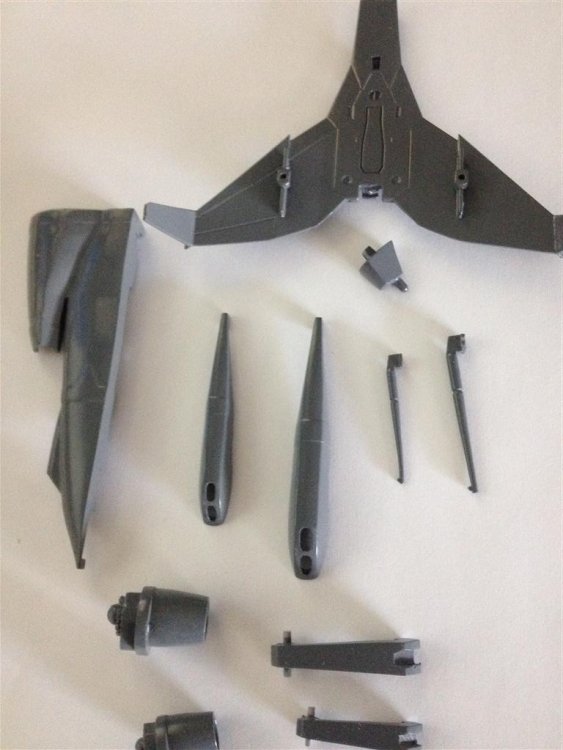

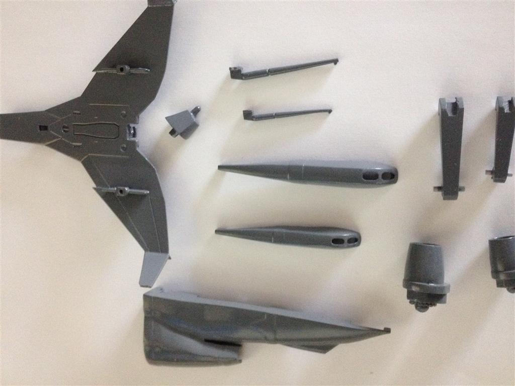

Xigfrid Posted August 17, 2015 Posted August 17, 2015 (edited) Hi guys, The masters are FINISHED! They are gorgeous as expected. I am sorry the picture below doesn't do justice to the work that was made to the parts but you can see that they are far cleaner than the prototype. I have asked to all the pre-orders to proceed to the second half payments so that the kits can be shipped as soon as they are ready. Keep in mind that the painted version will take a little longer to be shipped because they need more work and more time to dry between putty/paint layers. Anyway, I am sure Jasonc will update us. Edited August 17, 2015 by Xigfrid
spanner Posted August 17, 2015 Posted August 17, 2015 The parts in the photo look really good! Im busting to get my hands on this thing! Thanks for the update Xigfrid!

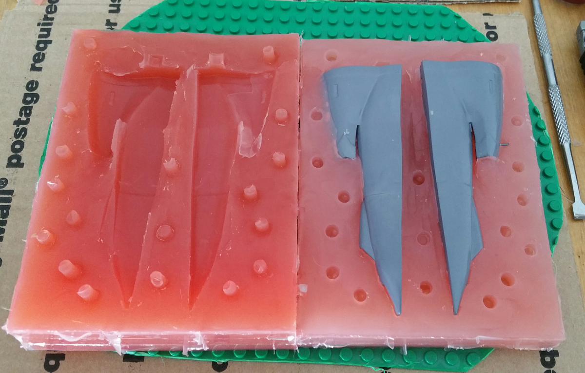

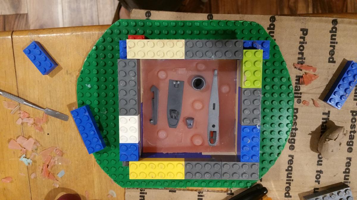

Jasonc Posted August 24, 2015 Posted August 24, 2015 (edited) OK, it's not a lot of progress, but I'm working with a stronger, longer lasting rubber with a quicker curing time, so that I can get the same quality, but at a faster pace. so far, it looks like it's coming out well. the pressure tank is doing well in keeping bubbles out of it. This one just needs the resin pour spout. Edited August 24, 2015 by Jasonc
spanner Posted August 24, 2015 Posted August 24, 2015 interesting looking process! Is there any finish quality loss from the original part when casting this way? Not that im worried, was just curious..

Jasonc Posted August 24, 2015 Posted August 24, 2015 interesting looking process! Is there any finish quality loss from the original part when casting this way? Not that im worried, was just curious.. There really isn't any loss in detail. The rubber forms around the plastic with minimal shrinkage, and will create an exact copy. My only challenge is that these are complicated pieces to recast, so creating a good angle and pour spot are crucial. Going to do some of the smaller parts today, and the tail and intake.

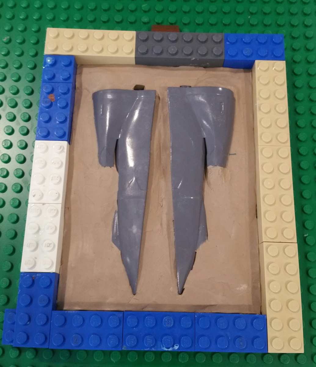

Jasonc Posted August 26, 2015 Posted August 26, 2015 (edited) More work done last night. More to do today. The work continues. Small parts are halfway done (the molds)...right intake cover is done. The wing is going to be a nightmare to recast, but it'll get there. Edited August 26, 2015 by Jasonc
Jasonc Posted August 27, 2015 Posted August 27, 2015 (edited) More. Just posting for sake of letting you guys know that I'm not slackin, lol. Edited August 27, 2015 by Jasonc
spanner Posted August 27, 2015 Posted August 27, 2015 Thanks for the updates! The progress looks great!
