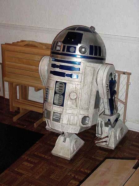

B-52 GUNNER Posted December 24, 2003 Posted December 24, 2003 Well, here ismy latest. It's a hand spun, laser cut Aluminium R2 Dome with Resin parts It will be years before I get this one finished.

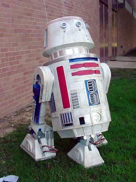

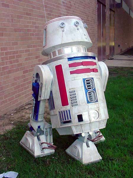

B-52 GUNNER Posted December 24, 2003 Author Posted December 24, 2003 Here's a couple Fan built Droids
GobotFool Posted December 24, 2003 Posted December 24, 2003 Insanely cool. I have always wanted a full sized R2 unit. Do these guys do commissions?
B-52 GUNNER Posted December 24, 2003 Author Posted December 24, 2003 GobotFool Posted on Dec 24 2003, 02:00 AM -------------------------------------------------------------------------------- Insanely cool. I have always wanted a full sized R2 unit. Do these guys do commissions? Sorry to say the answer to that is NO!!!!!!!!!!! They have a large resource of blueprints and some of the guys make parts like the dome, legs, skin, etc.. They range from $500.00 and up for all the parts and how much work you want to put into them. the less work the more expensive. Alot of the guys are trying to make all aluminium droids. Those range over $1000.00

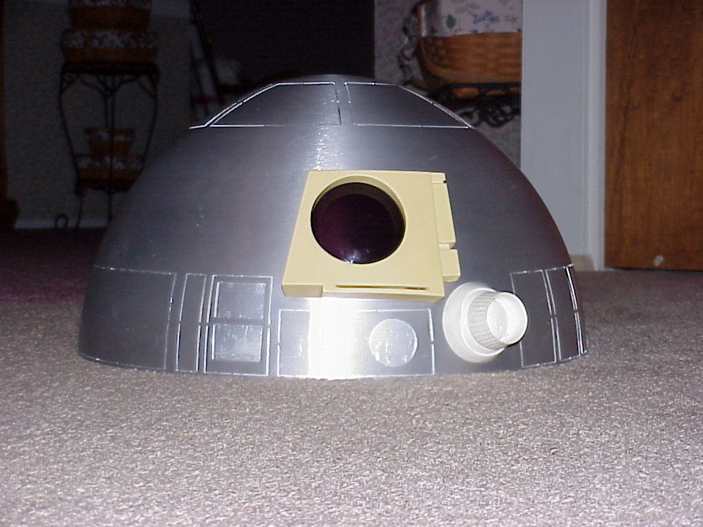

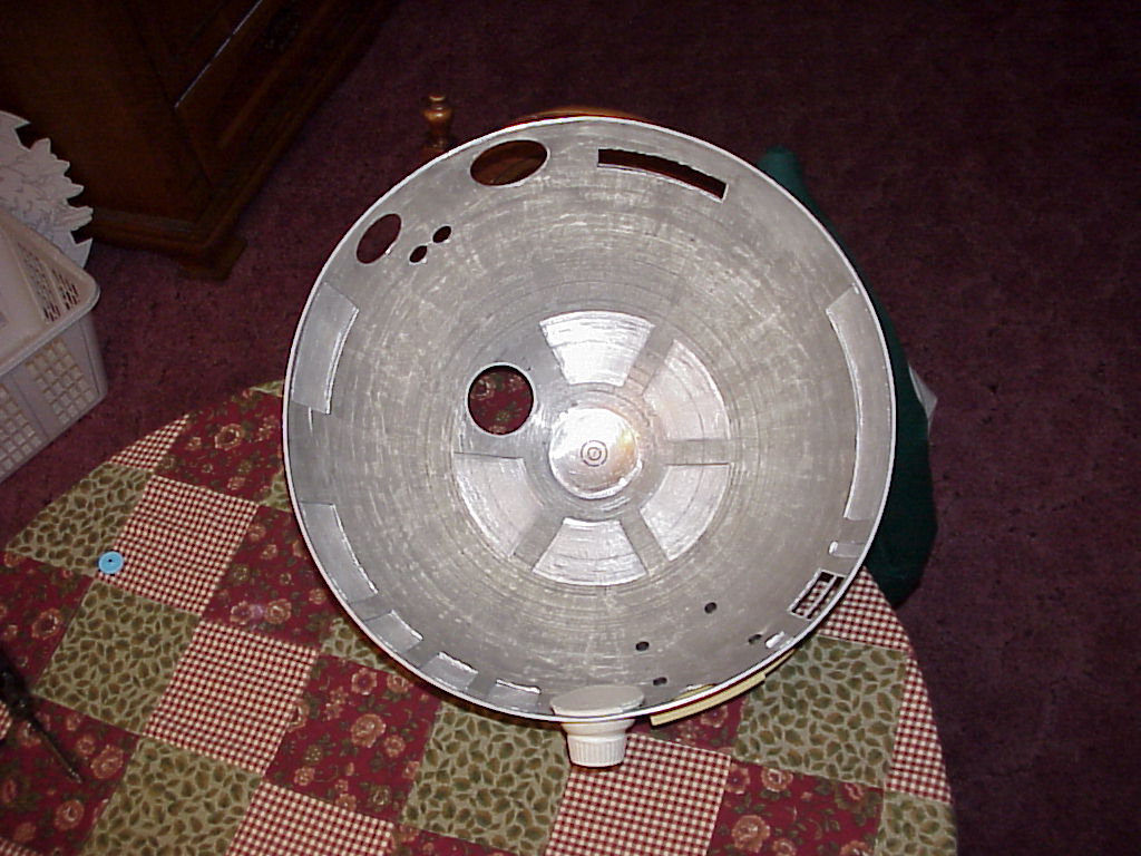

B-52 GUNNER Posted January 1, 2004 Author Posted January 1, 2004 I just finished cutting the inner Dome door openings. It took me over 2 hours of work with a Dremel but I finished it. Next I will weld hinges on the inside before I cut the tabs holding the doors in place. Here's a photo of my progress.

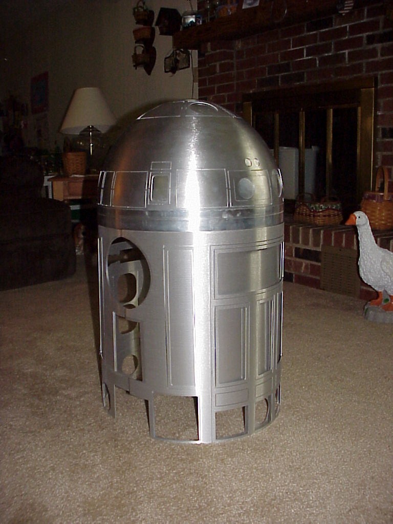

B-52 GUNNER Posted September 4, 2004 Author Posted September 4, 2004 Well, It's been 8 months since my last update on this project and I finally have some new info and photos to show you guys. I ordered my skins for my R2 on Wednesday and they showed up on Friday. Man was that fast! The skins are laser cut aluminum and fit onto an 18" frame that I'll have to design. I want to build a prototype out of Masonite and then after measurements have been taken off of it I'll build the real frame out of 3/16" or 1/4" aluminum plate. Hopefully I can get all the doors to open Here's a couple photos of my skins with my new dome. I had a friend that needed my first dome for a full size X-Wing he picked up on Ebay so he gave me a new one. I love friends like that. Enjoy the new pics. Scot

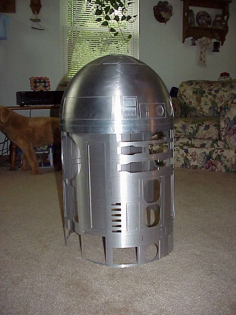

B-52 GUNNER Posted September 4, 2004 Author Posted September 4, 2004 (edited) and now the back side Edited September 4, 2004 by B-52 GUNNER

B-52 GUNNER Posted September 4, 2004 Author Posted September 4, 2004 The Dome is hand spun and laser cut. A friend of mine spent over $30,000 getting the dome perfect and he sells them for $390.00 shipped in the US. The skin is laser cut and roller on an 18" ID and is double layered .080 aluminum. THey run $175.00 shipped in the US. Next I need a frame, skirt, misc. parts and $$$LEGS$$$ Followed by a DUPONT white and a mixture of House of Kolor to get the Hypothetical R2 Blue BIG BUCKS but if you buy the parts one at a time it doesn't hurt as much. Scot
