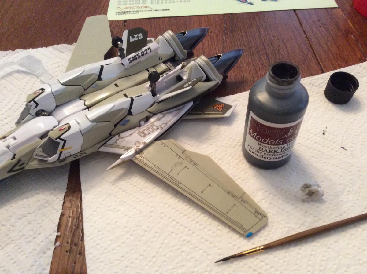

derex3592 Posted March 19, 2015 Posted March 19, 2015 (edited) Had some time this evening, so I decided to try panel lining on these. For the record...EASIEST thing EVER! The glossy plastic makes it super easy and forgiving....don't be scared guys! I'll post finished pics later. Edited March 19, 2015 by derex3592

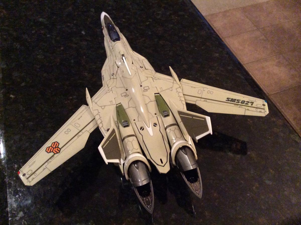

derex3592 Posted March 20, 2015 Posted March 20, 2015 Bout an hour. Top and bottom. Looks good! Gonna add some extra trimmed stickers for some extra detail later...
Guest davidwhangchoi Posted March 20, 2015 Posted March 20, 2015 Bout an hour. Top and bottom. Looks good! Gonna add some extra trimmed stickers for some extra detail later... stop making us envy! very nice
lancalot Posted March 20, 2015 Posted March 20, 2015 Bout an hour. Top and bottom. Looks good! Gonna add some extra trimmed stickers for some extra detail later... that looks great man
Ignacio Ocamica Posted March 20, 2015 Posted March 20, 2015 Yeah looking great!!! Adds a lot of detail.
abbadon Posted March 20, 2015 Posted March 20, 2015 Bout an hour. Top and bottom. Looks good! Gonna add some extra trimmed stickers for some extra detail later... Looks good, man! Crisp and clean!
chyll2 Posted March 20, 2015 Posted March 20, 2015 Had some time this evening, so I decided to try panel lining on these. For the record...EASIEST thing EVER! The glossy plastic makes it super easy and forgiving....don't be scared guys! I'll post finished pics later. I always wanted to buy that wash ever since jefuemon recommended that.
SaitouSad Posted March 20, 2015 Posted March 20, 2015 Had some time this evening, so I decided to try panel lining on these. For the record...EASIEST thing EVER! The glossy plastic makes it super easy and forgiving....don't be scared guys! I'll post finished pics later. Damn, those look nice. So you just take a very very fine brush, and dab some of the ink and let it run down the line, then wipe down the excess? Do you coat it thereafter? Does it bleed when you top coat it? Might wanna try it if i'm feeling adventurous
chyll2 Posted March 20, 2015 Posted March 20, 2015 Damn, those look nice. So you just take a very very fine brush, and dab some of the ink and let it run down the line, then wipe down the excess? Do you coat it thereafter? Does it bleed when you top coat it? Might wanna try it if i'm feeling adventurous for glossy finish this will work. you can use a very thinned oil or acrylic paint. once dry, use a little bit of applicable thinner in a cloth (very little to reactivate the paint in the surface) and lightly clean the surface. the one used by derex though is something sold in UK and is actually a clay suspended in thinner (might be water), once dry, you only need water to reactivate everything.
derex3592 Posted March 20, 2015 Posted March 20, 2015 (edited) Damn, those look nice. So you just take a very very fine brush, and dab some of the ink and let it run down the line, then wipe down the excess? Do you coat it thereafter? Does it bleed when you top coat it? Might wanna try it if i'm feeling adventurous You need a fine point paint brush, (red sable, not something cheap) I have one for putting on the wash and another smaller flatter one for any small areas I want to clean up. All I do is basically trace over the panel lines, don't worry about being too neat (on the flat finish of Yamato's 1:60 ver2 you have to be a bit more careful as the wash will discolor the pure white areas if you leave it on to long, which can be cool if you are going for a really weathered look). Then after a couple of minutes, take a dry or just barely moist piece of paper towel, (or lick your finger) and wipe away the excess wash. Lick the cleanup brush to get into tight areas to clean up. As the Pro-Modelers wash is clay based, any time I want to revert back to the original look, just grab a wet Q-tip or something and go for it. Presto --100% clean pretty Valk. These are great to learn on. As I said, the Yamato's are trickier. The VF-4 was a royal pain, but came out great. I don't clear coat them as I'm lazy. Then add stickers if you want. Edited March 20, 2015 by derex3592
