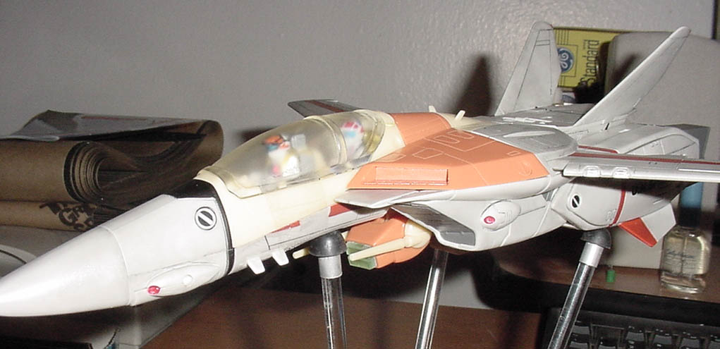

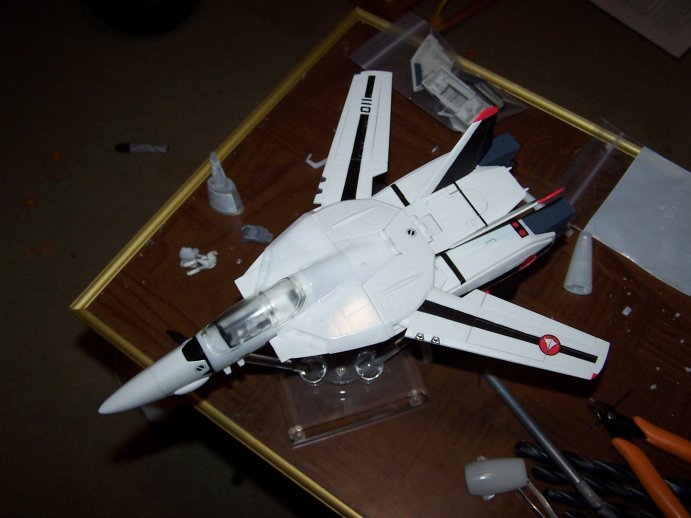

do not disturb Posted October 28, 2005 Posted October 28, 2005 godzilla, yes i got the heatshield, you have to take it on and off but it works. i looked over to see if there was some way the cap'n could've made it retractable but its impossible. the resin is pretty sturdy, kind of like rohby super stiff BP8 recast. just be careful removing each piece from its sprune otherise you might break something off that you can't fix or glue back on. as far as time, i put maybe 2-3 hours into it, if even that and that includes disassembling and reassembling the valk. actually i spent a bulk of the time making sure all the pieces fit and that it TFs without any problems than anything else. the parts are fairly clean, some parts/spots are tougher to get to than others but i have very little skill and i was able to knock it out without any real problems. i have some more pictures(and important info) i want to share but i gotta work a little before i get in trouble with the bossman.

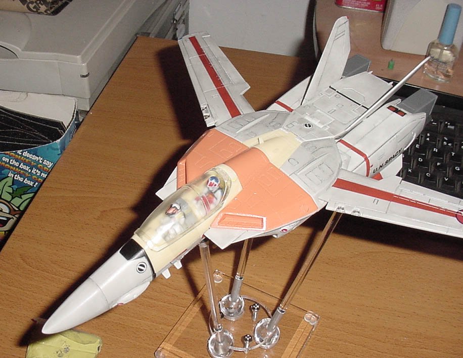

do not disturb Posted October 28, 2005 Posted October 28, 2005 heres one real quick.... for those who haven't picked up this conversion kit.....you're missing out.
kensei Posted October 28, 2005 Posted October 28, 2005 That's ultra nice Haterist. Can't wait till the final painted product. Keep up the good work. You have done awfully well to get it together so quickly after recieval.

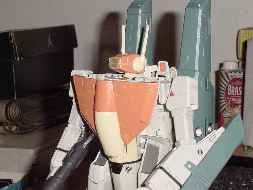

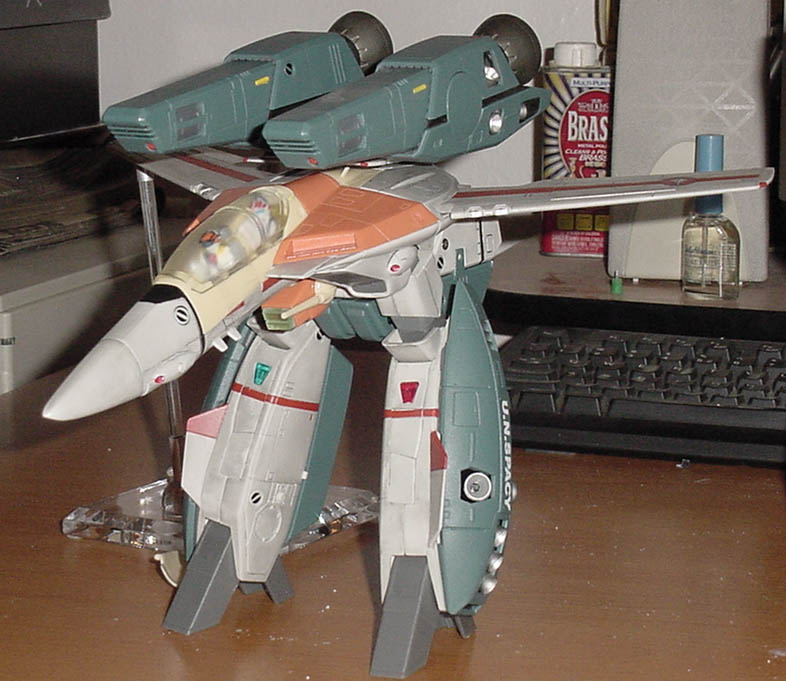

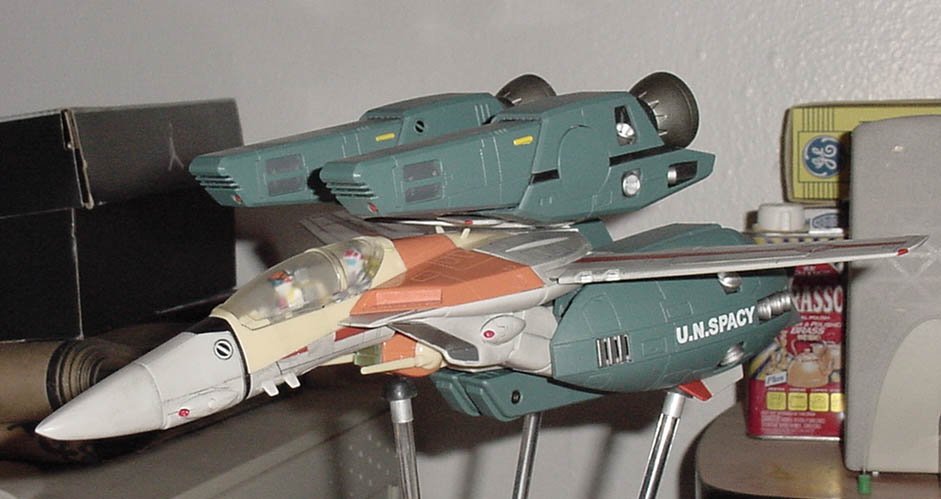

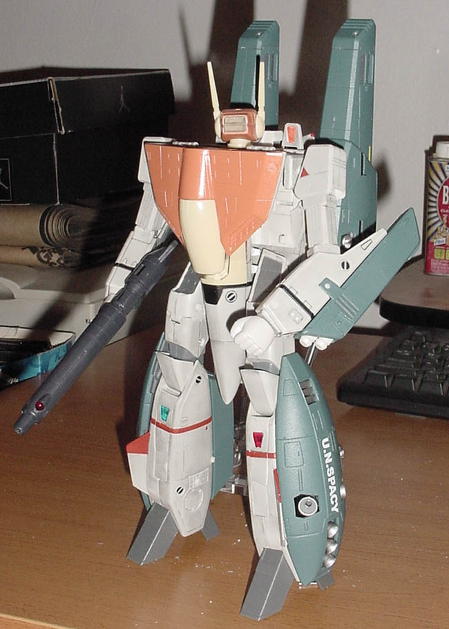

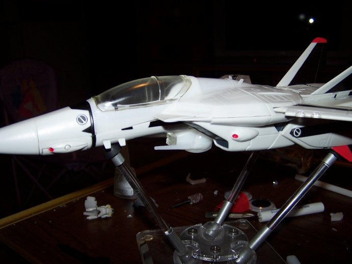

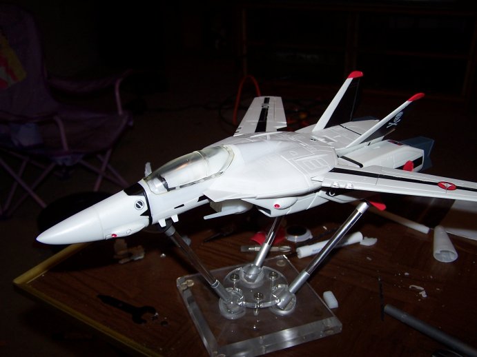

do not disturb Posted October 28, 2005 Posted October 28, 2005 heres some more pics. battroid w/FPs gerwalk w/FPs fighter w/FPs fighter non FPs fighter top
captain america Posted October 28, 2005 Author Posted October 28, 2005 Wow Gene, you're fast!! Got your 1D built-up before I did I'm prepping my parts as we speak, and I should have the instructions all done by wednesday.
do not disturb Posted October 28, 2005 Posted October 28, 2005 so the only thing i don't like about this kit is the floppy head. its floppy in battroid, floppy in fighter, its just plain floppy. theres not much you can do to remedy this other than maybe some clear nail polish? or an entirely new design of the head which isn't very likely to happen. in battroid mode, the head just sits there, it doesn't lock into place like the other 1/48s. it moves freely and it sits back tilted on an angle so its always looking up which was kind of bummer. i had to put the neck doo-hickie piece that comes with the FP kit to level it off and keep the head straight but it still doesn't lock into place. i'll probably have it displayed in fighter mode w/o FPs or battroid with the FPs, so it won't bother me too much. honestly, the head issue is my only real gripe with this set but looking at how it had to be made, there was not much cap'n could do about it....its unfortunate but some sacrifices had to be made for the cause. some additional tips on top of all the other crap i posted: head laser pieces - whatever you do, make sure you don't sand the pegs down too much. theres pegs that go into the neck piece(you'll have to drill a hole for the pegs) when its assembled. i made the mistake of cutting them a little short and that could be the reason for the floppy head problem. i'm probably going to buy a replacement part from cap'n cause this was entirely my screw up. i just hope that fixes this problem. the neck attachment piece - this would be the resin part that you put the screw threw into the head. he shaved a little off it(you gotta see it to know what i'm talking about) but it needs to be sanded down a lot more. you'll also have to sand down some of the neck swivel piece(the black thing attached to the bottom of the head thats swivels and spins) quite a bit. you'll have to do this if you want the fuselage to stay in place correctly otherwise it pushes the entire fuselage up a couple of centimeters and actually splits the fuselage at the seams....you'll see what i'm talking about when you try to assemble it. the most important tip i can give you guys.... DO NOT GLUE ANYTHING UNTIL YOU ARE 100% SURE EVERYTHING FITS PROPERLY. as you can see i used funtac and scotch tape to hold pieces together. even at this point, i'm 99.99% done and sure everything works but i still don't want to glue anything down as of yet. as they say, its better to be safe than sorry. closing: i thought this was going to be a big ol pain in the butt(i was even going to comission someone to do it) but it really wasn't too bad. before this, my only experience with resin was rohbys TV hands and S head which obviously didn't require much work. as i said the bulk of my time was spent trying to make sure everything fit properly and TFed smoothly. i don't know what else to add other than, this kit ROCKS! if you haven't gotten it yet, you're really missing out IMHO. and a very special thanks to the cap'n for making this happen. if anyone has anything they want to ask/add, i'll try my best to help.

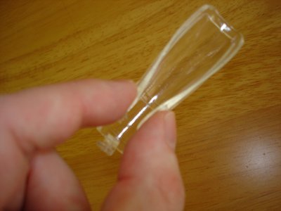

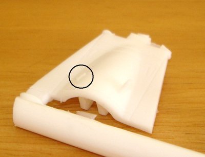

Majestic Posted October 30, 2005 Posted October 30, 2005 Cap, Thanks for the great looking conversion kit. A couple problems/questions here though. 1) There's a missing "antennae/aeleron tab" on the BP8 part, looks like it was snapped off. (see picture) 2) Is the canopy supposed to be so gel-like and rubbery? It warps considerably at the slightest touch... Thanks, -Kurt
promethuem5 Posted October 31, 2005 Posted October 31, 2005 OMG! That's about the worst clear resin cast I've ever seen. Clear resin is tricky and can sometimes not sure right if not mixed exactly right, but that's nuckin' futs.... I've never seen something that crazy...it's usually just tacky or has a slight give. The antenna fin is prolly just from packing....but holy crap, and cockpit is nuts.... Not to bash John, his stuff is awesome, but that's just out of the ordinary.
captain america Posted October 31, 2005 Author Posted October 31, 2005 Cap,Thanks for the great looking conversion kit. A couple problems/questions here though. 1) There's a missing "antennae/aeleron tab" on the BP8 part, looks like it was snapped off. (see picture) 2) Is the canopy supposed to be so gel-like and rubbery? It warps considerably at the slightest touch... Thanks, -Kurt 340881[/snapback] Hi Kurt. Yes, the clear resin has a tendancy to be quite tempermental, and I've had words with Smooth-On over this very issue. You can cook the canopy in the oven at 150f (not higher!) for about 4 hours and let cool. This helps to harden the resin and increase it's physical properties. According to Smooth On, even when the parts come out soft like that, they WILL eventually firm up, but because the material is very fickle when mixing, some batches will simply take longer to harden.
Majestic Posted October 31, 2005 Posted October 31, 2005 Hi Kurt.Yes, the clear resin has a tendancy to be quite tempermental, and I've had words with Smooth-On over this very issue. You can cook the canopy in the oven at 150f (not higher!) for about 4 hours and let cool. This helps to harden the resin and increase it's physical properties. According to Smooth On, even when the parts come out soft like that, they WILL eventually firm up, but because the material is very fickle when mixing, some batches will simply take longer to harden. 341013[/snapback] Thanks, I'll try this method. The canopy is seriously like gummy-canopy right now. I suppose I'll just fix the BP8 with some super-glued sheet styrene cut to shape.
