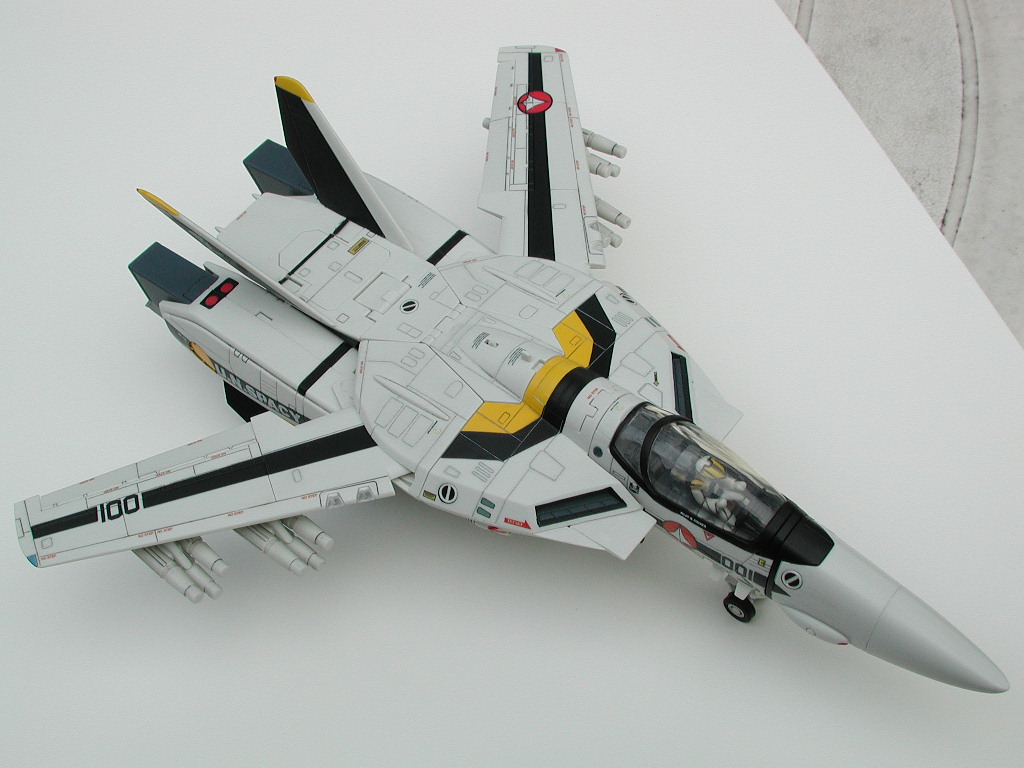

wm cheng Posted October 16, 2006 Posted October 16, 2006 (edited) I would not use the Gundam Marker, its just too thick and dark - unless you are going for the anime style... Pencil is a good idea - the grey will look good and its easy to erase. If you want something a little more permanent, I use thinned down oil paints, it has a slow drying time, so you can have lots of time to wipe off the excess. It mixes well, so you can have white (or light grey) lines in the black areas and different shades in the white areas. You can wipe away the excess with just a paper towel - or if you leave it too long, you can dip it with varsol (low odour is less strong) and wipe - it didn't harm the paint. Edited October 16, 2006 by wm cheng

Skull-1 Posted October 16, 2006 Posted October 16, 2006 I would not use the Gundam Marker, its just too thick and dark - unless you are going for the anime style... Pencil is a good idea - the grey will look good and its easy to erase. If you want something a little more permanent, I use thinned down oil paints, it has a slow drying time, so you can have lots of time to wipe off the excess. It mixes well, so you can have white (or light grey) lines in the black areas and different shades in the white areas. You can wipe away the excess with just a paper towel - or if you leave it too long, you can dip it with varsol (low odour is less strong) and wipe - it didn't harm the paint. An excellent example of less being more. That is a pretty good job right there. I much prefer that to a Valk that looks like it got dumped in a landfill.
