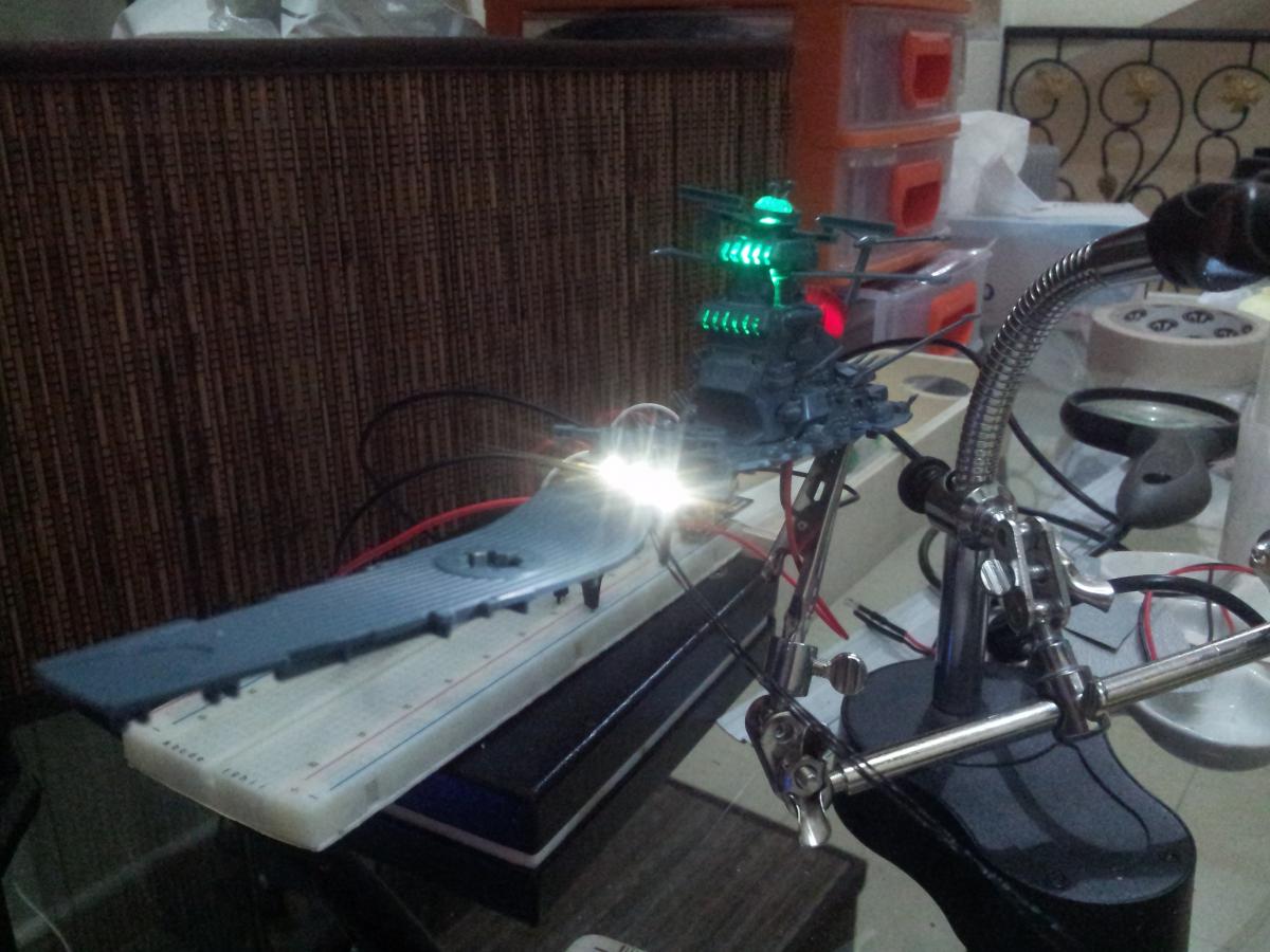

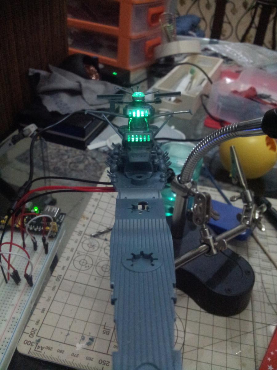

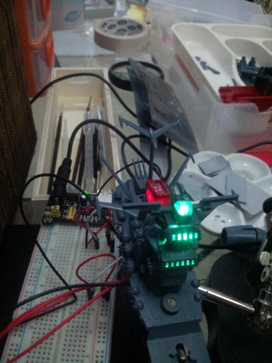

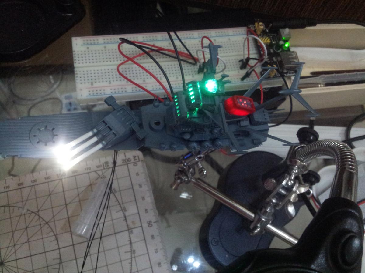

arbit Posted July 9, 2016 Posted July 9, 2016 (edited) Moving along here. I also have blinking signal lights ready for the bridge wings. One lesson I learned with lights is if you wire steady lights, blinking lights and flickering lights together, they all end up blinking...Duh! So I need to have separate wires to the power source for each type of light, unless there is another easy solution (I will NOT be learning how to wire circuit boards). Another lesson is too many wires and the hull gets jammed full... Edited July 9, 2016 by arbit

arbit Posted July 9, 2016 Posted July 9, 2016 (edited) After lots more dremeling. My pre-wired LEDs have too thick wires. I need to rewire with thinner ones. Not looking forward to it. Edited July 9, 2016 by arbit

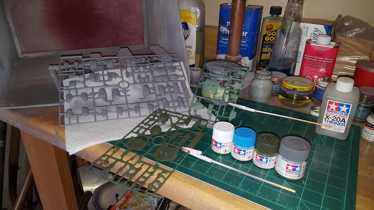

derex3592 Posted July 9, 2016 Posted July 9, 2016 Had an unexpected cool front blow through this afternoon so I thought I would get some painting done on Boba Fett. Tamiya acrylics sure are easy to mix with and lay down beautifully through an airbrush.. I will say that for them.

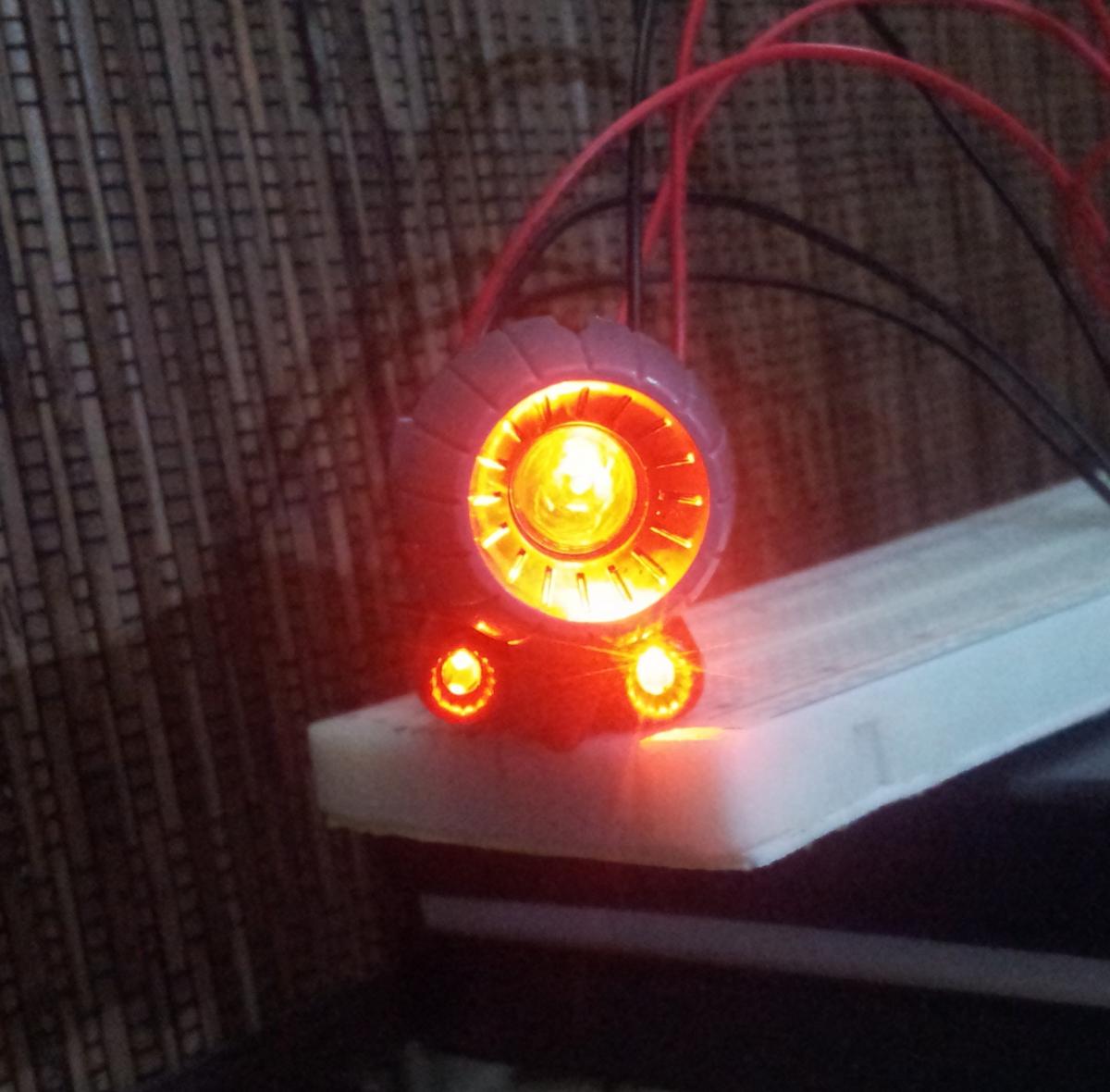

GMK Posted July 10, 2016 Posted July 10, 2016 Nice lighting on that Yamato. The engines look great. Seconded.
arbit Posted July 10, 2016 Posted July 10, 2016 (edited) Seconded. Thanks. Those are "candle/flickering" pre-wired LEDs which give that effect. But I'm finding that for our small kits, SMDs are the way to go for tight spots. LEDs are often too big. Edited July 10, 2016 by arbit

arbit Posted July 10, 2016 Posted July 10, 2016 Solution for the cable clutter problem is to use Enameled Wire. Its hair thin and carries enough current to run your LEDs. For SMDs try Neopixels, you get blinding light thats fadeable, they only need 3 wires to run them even in a daisy chain of 80 and you can still program and control them individually while daisy chained using a Trinket board. Thanks.
NZEOD Posted July 10, 2016 Posted July 10, 2016 (edited) Thanks. 10 neos cost me about $6NZD and each one is small enough to fit into the lens fitting on the 1/72 Wave Phalanx triple spotlight and still have room to run the enameled wires hidden down the shaft into the body. Thats how small the enameled wires are too. Edited July 10, 2016 by NZEOD

NZEOD Posted July 11, 2016 Posted July 11, 2016 super simple to wire... one 5v power, one ground, on data in... if more than are needed you just run a line from the first SMD's Data out to the next smd's data in. Literally seconds to solder. And the programming is super easy too with premade code (called sketches) ready to download. They are made by a chick for chicks to sew into clothing and costumes so a guy HAS to be able to do this just for prides sake. checkout Adafruit.com for ideas and tutorials and sketches.
arbit Posted July 11, 2016 Posted July 11, 2016 (edited) super simple to wire... one 5v power, one ground, on data in... if more than are needed you just run a line from the first SMD's Data out to the next smd's data in. Literally seconds to solder. And the programming is super easy too with premade code (called sketches) ready to download. They are made by a chick for chicks to sew into clothing and costumes so a guy HAS to be able to do this just for prides sake. checkout Adafruit.com for ideas and tutorials and sketches. Any link to the "sketces"? I saw the sketch library on the Adafruit site. And my apologies to all chicks on the Workbench who may have been offended. They can definitely do a lot more programming than I could. Edited July 11, 2016 by arbit
