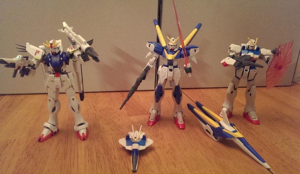

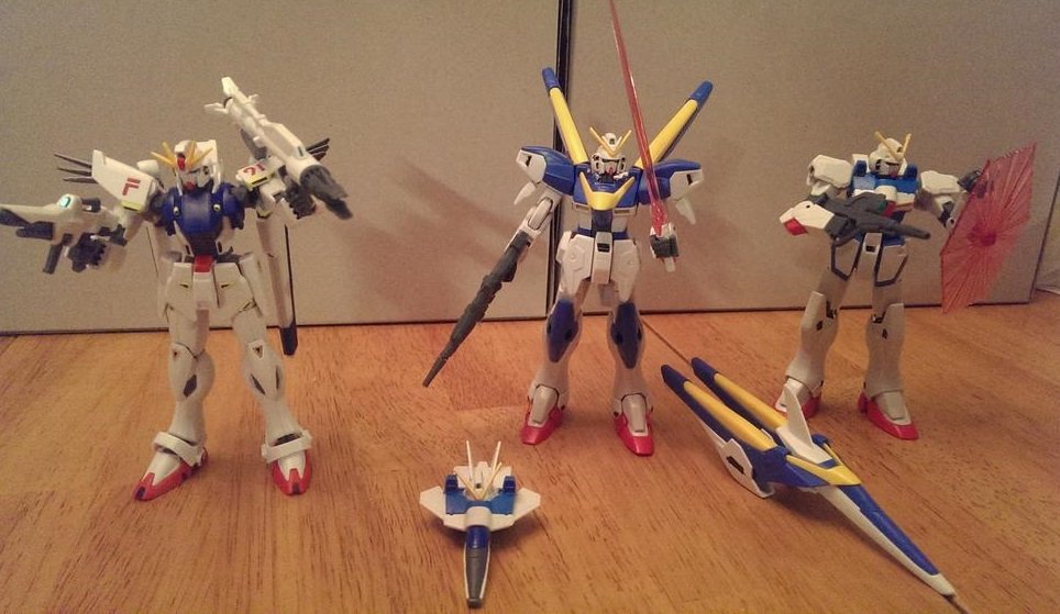

mikeszekely Posted November 26, 2014 Posted November 26, 2014 And... now I'm done with V2. I guess I don't have a lot to say about. It's got a lot of the engineering improvements that regular Victory has, and like Victory it's a fairly simple kit. The only thing that stands out as being very different is the backpack, but even that's cake after building RG Freedom's. I was a little disappointed, though. While regular Victory included black stickers for the large verniers on the front of the skirt armor and the shoulders (but not the ankles or knees, which got a little paint), Victory is back to the F91 route of being all but stickerless. So V2 took a little longer than regular Victory because I had to wait for paint to dry enough to handle different parts, but overall wasn't as bad as F91. Here's a pick of all three. They're mostly straight builds... there's no gloss clear coat or anything like that. The only paint is black vernier spots on Victory and Victory 2 (knees, hips, elbows, and ankles on both, backpack and crotch on V2), black vernier lines with yellow trim on F91's shoulders and front skirt armor, black lines on F91's midsection and feet, little dabs of black on the cheek vents of all three, yellow paint on F91's head vulcans, gold Sharpie on V2's head vulcans, green sights on F91's VSBRs, yellow thrusters on F91's backpack, and blue on the canopy of Victory's Core Fighter. Note the sloppy application, poor technique, and how the light yellow on F91 doesn't really match the yellow on the triangle stickers. (In all seriousness, I'm actually pretty satisfied with V2's head vulcans...)

Hikuro Posted November 27, 2014 Posted November 27, 2014 And... now I'm done with V2. I guess I don't have a lot to say about. It's got a lot of the engineering improvements that regular Victory has, and like Victory it's a fairly simple kit. The only thing that stands out as being very different is the backpack, but even that's cake after building RG Freedom's. I was a little disappointed, though. While regular Victory included black stickers for the large verniers on the front of the skirt armor and the shoulders (but not the ankles or knees, which got a little paint), Victory is back to the F91 route of being all but stickerless. So V2 took a little longer than regular Victory because I had to wait for paint to dry enough to handle different parts, but overall wasn't as bad as F91. Here's a pick of all three. They're mostly straight builds... there's no gloss clear coat or anything like that. The only paint is black vernier spots on Victory and Victory 2 (knees, hips, elbows, and ankles on both, backpack and crotch on V2), black vernier lines with yellow trim on F91's shoulders and front skirt armor, black lines on F91's midsection and feet, little dabs of black on the cheek vents of all three, yellow paint on F91's head vulcans, gold Sharpie on V2's head vulcans, green sights on F91's VSBRs, yellow thrusters on F91's backpack, and blue on the canopy of Victory's Core Fighter. Note the sloppy application, poor technique, and how the light yellow on F91 doesn't really match the yellow on the triangle stickers. (In all seriousness, I'm actually pretty satisfied with V2's head vulcans...) B3Zo5UVIcAAYh0l.jpg large.jpg Good straight build, now get those suckers lined I didn't think V2 was really all that hard to even paint, it was pretty easy for me but I guess it's cause I'm so use to painting 1/144's. But That stuff was NOTHING compared to all the detail I had to add just on a MG Double Zeta. Now the F91 that's a different story cause a lot of that is missing paint. Shoulder thrusters, front skirt, ankle bits have both yellow outline and gray inside! Holy crap was that hard! and the bazooka!!!

Nekko Basara Posted November 27, 2014 Posted November 27, 2014 That's a really cool trio, Mike! I think your experiments with detail painting look great. I'd say it's normal to be your own harshest critic, because you know everything in the build that didn't turn out how you wanted - but from the picture, all I see is three cool mobile suits. I will make one suggestion on the photo, though: get those legs moving! The suits are doing cool stuff above the waist, but below the waist they're just standing up straight. Legs that sexy deserve to do some posing, too!
