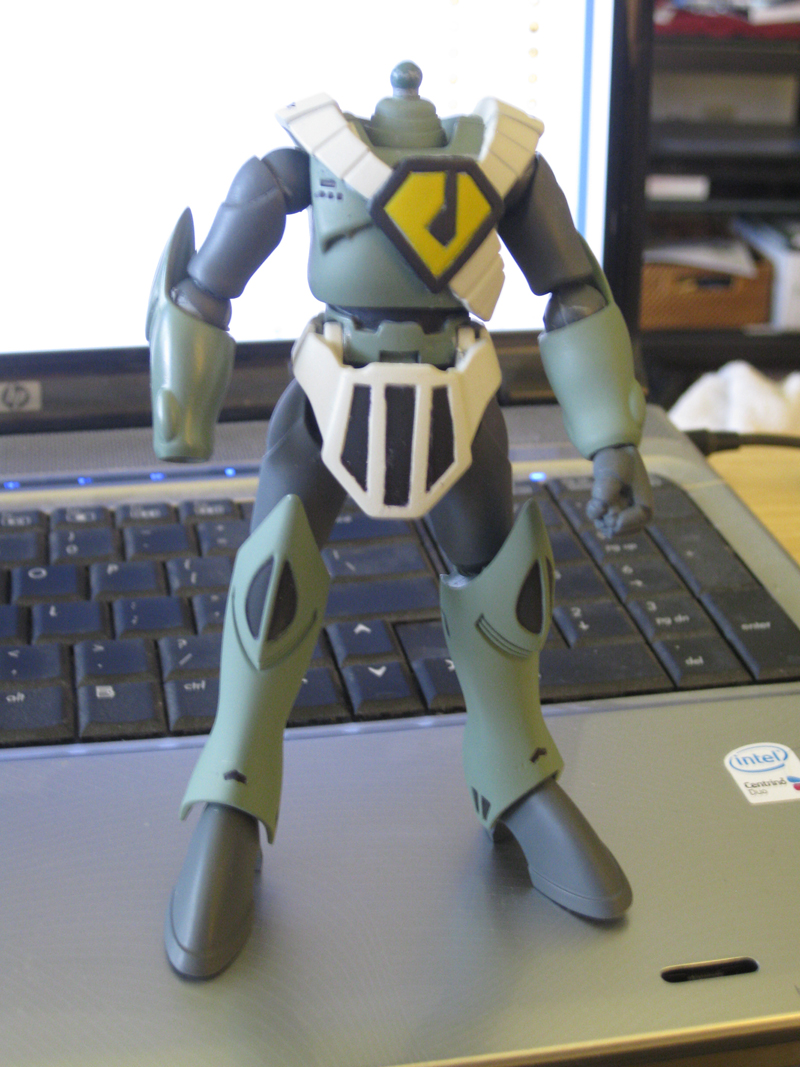

Jasonc Posted November 4, 2010 Posted November 4, 2010 OK, so I know this thread is a little old, but I've started to paint my figure and should have him done in about 1-2 weeks. Primer is now dry, so time to get the airbrush out again. I've worked with Exo and he helped me to get all the joints nice and tight on this guy. He should be pretty sturdy and better than an action figure. For the hands, I bored out the little plug, and inserted one of the sockets from the BJ-05 set in there, the result is a hand that has some posability, and won't fall off. Took some time, but it looks great. Pics will come up later in another thread.

Jasonc Posted November 6, 2010 Posted November 6, 2010 There's not much to painting this guy (unless you do the ultra realistic look. Being that it's meant to be moved around and all, I'm keeping pretty simple. For the chest, I just need to touch up what I missed from masking with the black chestplate w/ Zentraedi insignia. I'll probably also do another coat over the backpack section. For the white belt and strap pieces, I'm using what's called light camoflauge gry. It's basically a white with a little gry and tan in it. It works well with the green I've selected, which isn't as dark as the original green. For the joints, upper arms, thighs and feet, I'm using panzer gry, which is kinda drk, but stands out just right. I've also done the rifle in a gry primer, then gunmetal metalizer. What's taking more time, is prepping the materials to make the figure sturdy. The drilling, sanding, all that is some time, but not too bad. I found some metal rod that I have put inside the waist so that the figure can actually bend forward from the crotch area. So far, I'm still waiting on another BK-05 set for another socke for the other arm, also more for the arm/leg sockets. At this rate, he'll easily be done by next week, pending no major disasters. Will get pics tomorrow, as I can't find the chord to load them.
Old Man Posted November 12, 2010 Posted November 12, 2010 (edited) Would it be asking too much to get a step-by-step procedure on the assembly for this figure? I'm not the most skilled modeler, so any pics and whatnot would be extremely helpful. Edited November 12, 2010 by Old Man
Jasonc Posted November 12, 2010 Posted November 12, 2010 Would it be asking too much to get a step-by-step procedure on the assembly for this figure? I'm not the most skilled modeler, so any pics and whatnot would be extremely helpful. I'd put up some of a step-by-step, but I'm almost done with mine. Exo maybe more suited for it in regards to the styrene or rubber hose fix for the joints. Here it is so far. Still need some work on him, as well as one part for the other hand.

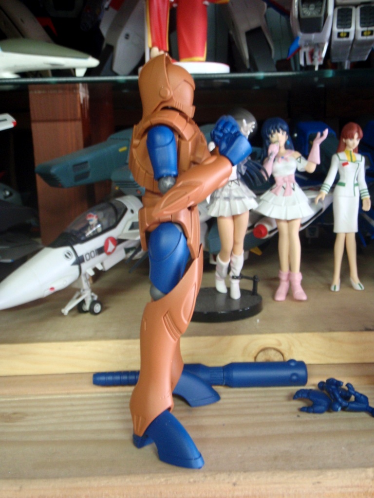

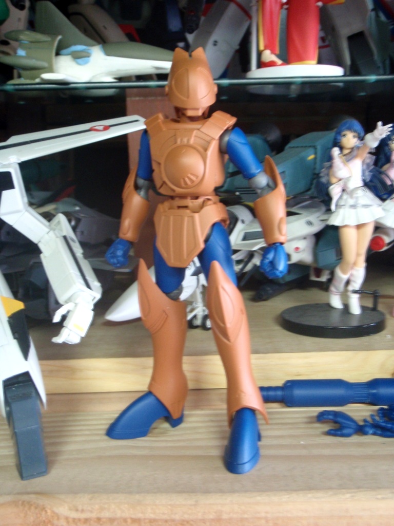

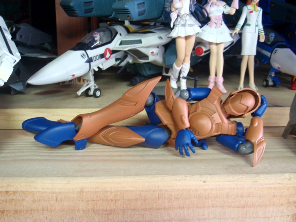

nightmareB4macross Posted January 8, 2011 Posted January 8, 2011 Just assembled my Zentradi soldier and found out you can use only Revoltech joints to assemble it and not have to use glue to keep it together. The resin ball joints on the neck and waist were removed. Then a hole was drilled in their place to accept a Revoltech joints. All the joints used fit in pretty well, but were a little loose. An easy fix to this problem was to crimp the shaft of the joints. This made everything fit well and snug. Also, a double jointed joint was used in the elbow for more poseability. The joint in the neck and the waist allow for more flexability, as well.
nexxstrait Posted January 8, 2011 Posted January 8, 2011 I'm afraid the torso should be the other way round (currently the front plate is the backpack).
ae_productions Posted January 8, 2011 Posted January 8, 2011 Just assembled my Zentradi soldier and found out you can use only Revoltech joints to assemble it and not have to use glue to keep it together. The resin ball joints on the neck and waist were removed. Then a hole was drilled in their place to accept a Revoltech joints. All the joints used fit in pretty well, but were a little loose. An easy fix to this problem was to crimp the shaft of the joints. This made everything fit well and snug. Also, a double jointed joint was used in the elbow for more poseability. The joint in the neck and the waist allow for more flexability, as well. This is awesome!
