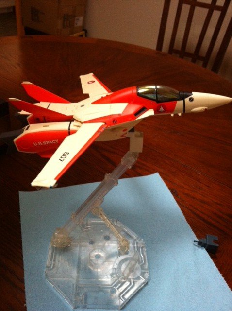

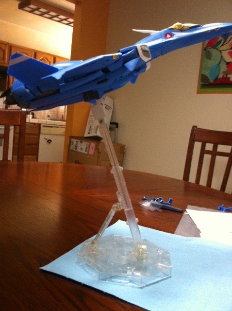

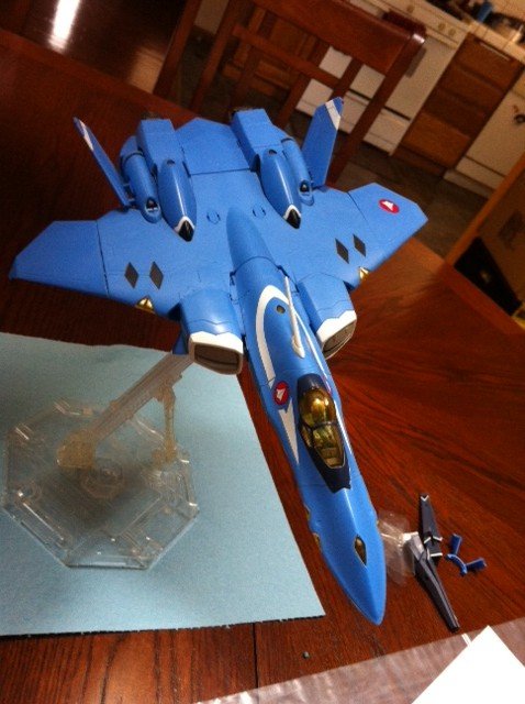

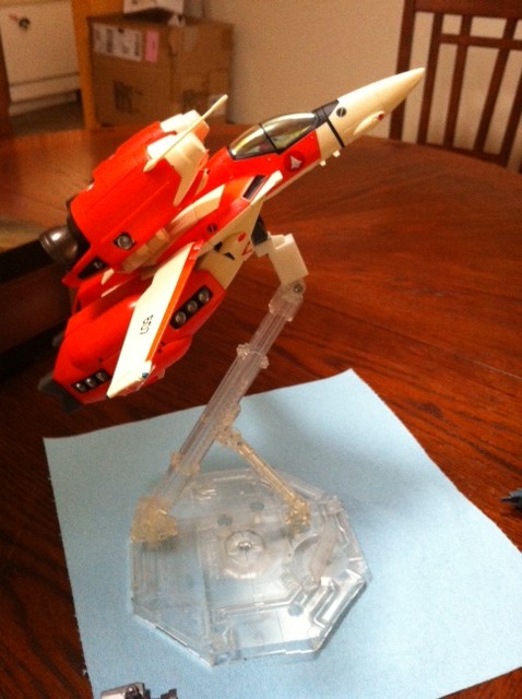

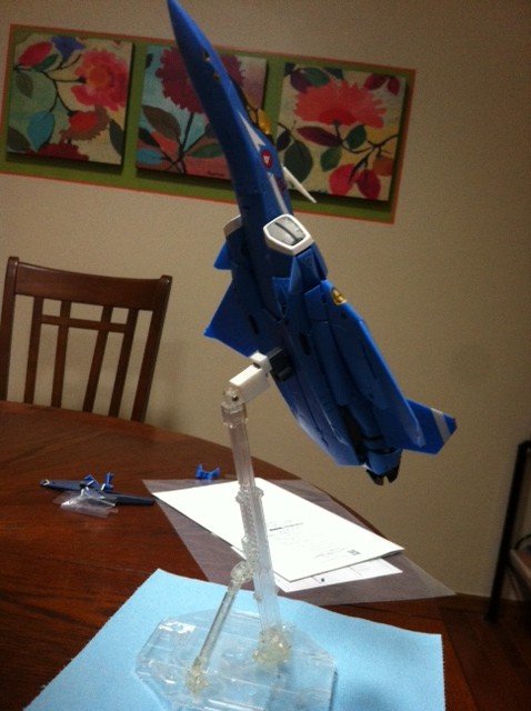

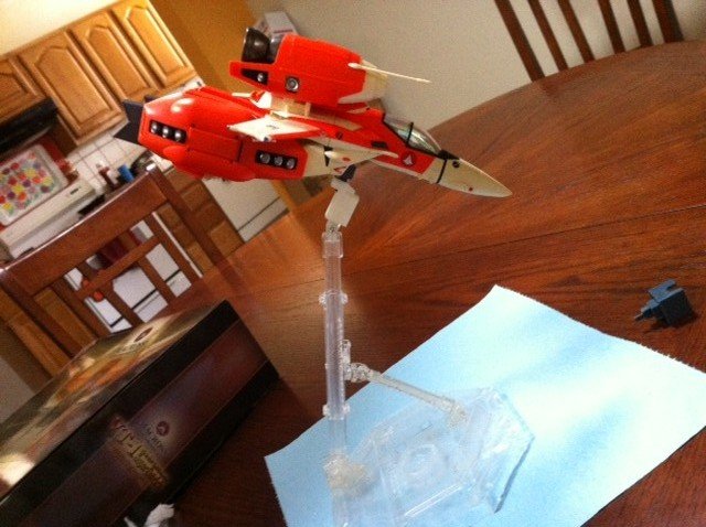

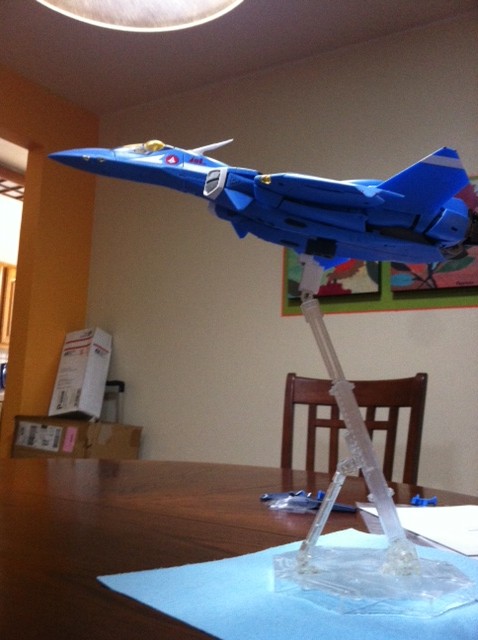

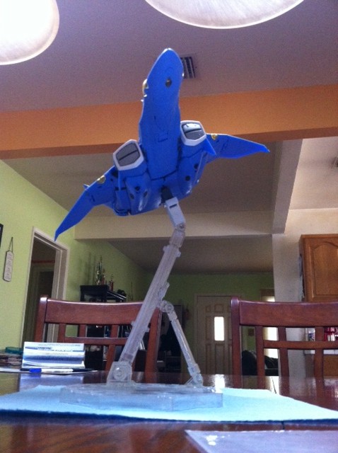

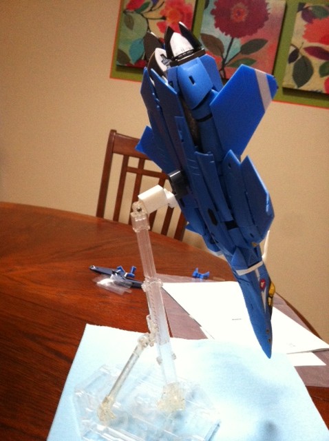

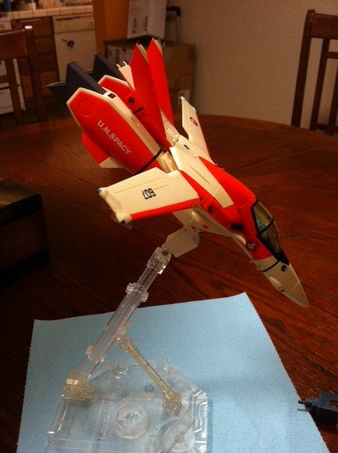

EXO Posted December 6, 2012 Author Posted December 6, 2012 I wanted to wait until I got the new adapters in but I'll post these here just to show how well they hold some of the other valks. I don't recommend 1/48s with the Strikes or Supers at all. But it can hold the valk by itself... probably on the heavy side. These are the prototype adapters. Coreyd has the ones on Shapeways on his pics. I don't have a 17 or a 19... sold my Isamu and haven't gotten an of the M7 valks yet. I'll take the adapters and the stands to someone else's house though to take more pics once my order arrives.
CoreyD Posted December 6, 2012 Posted December 6, 2012 I think I mentioned it in the other thread, but I tried a YF-19 and the screw mechanism on the gundam stand isn't strong enough to keep it upright.
Chronocidal Posted December 7, 2012 Posted December 7, 2012 Well upright, sure, but what if you just let it sag to however far it will go? Will the stand support the overall weight, or just collapse?

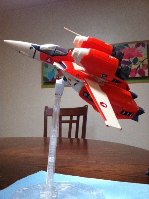

Chronocidal Posted December 8, 2012 Posted December 8, 2012 (edited) Ok, I didn't have my camera handy to take pictures here, but I've tested these stands out with pretty much everything I have now, with some surprising results. Note about the stands, they have a tendency to twist due to their construction. I'd recommend gluing them together, and avoiding heavily loaded sideways mountings. VF-11: No trouble really, packs included. I was able to give it a variety of pitch and bank angles, and it held up decently. The VF-11 isn't much heavier than a VF-1, so it's not too surprising. VF-0: REALLY surprised here.. but this goes to show how important the location of the stand mount is. Note, I wasn't following the instructions for how the stand mount was meant to attach, so I may have mounted it backwards. Doing it how I did though, the stand mount was firmly centered around the knee covers, and it balanced nearly perfectly. I was able to sit it on there, and pose it at any pitch angle. Then I added the Ghost booster to it, and it still worked. I didn't have it fully loaded, since I didn't want to dig for all the missile packs, but I'd say a fully loaded VF-0 has potential. I wouldn't recommend any sideways banked poses though. VF-19: Believe it or not, the stand will hold it up, but only in one position, and I'm not sure I'd trust it anyway. Basically, I mounted the stand pedestal with the legs spread as far as I could while keeping it stable. You'll want to use the small square add-on piece, and mount the stand in the center of that, with the second leg placed on the farthest hole on the opposite side of the base. Banking isn't possible, and you only get one pose: nose angled up, with the valk drooped as low as the stand's pivot tip will go before the adapter collides with the pedestal and holds it in place. It's also not very sturdy, so probably will need the stand glued together for this one if you want to risk it. Note on this one: It's actually decently well supported, but the weak point is how the adapter (badly) attaches to the VF-19. I actually had the valk fall back, with the mount still firmly attached to the stand adapter. It just doesn't clip on very well at all. VF-17: Same situation as the VF-19, though in this case the mount attaches very solidly to the belly, so no risk of the valk popping off. It'll sit in the same nose-up pose when the adapter stops the pivot. The thing I'm realizing though... I honestly do not think the folks at Yamato have even the slightest idea of what they're doing developing these stand adapters. The only one placed anywhere near the actual center of gravity of the valk is the VF-0, which is why it works so well even with the Ghost mounted on its back. The VF-17 is actually a facepalm-worthy case of this.. The stand mount is a long plate that attaches to the belly... and they put the stand peg on the front half of the plate.. they easily could have shifted the peg back another whole inch, and helped take stress off the stand, but nope. Anyhow, these are all done in fighter mode, and I'll see if I can get a few pictures up soon, possibly with some gerwalk and battroid poses as well. The issues in almost every case are just ones involving the center of mass of the various valks, so I'm expecting gerwalk and battroid to work much much better, even for the really heavy valks. Edited December 8, 2012 by Chronocidal
Chronocidal Posted December 8, 2012 Posted December 8, 2012 Update: Tried a couple gerwalk modes. VF-11 works fine. VF-17 actually also works decently, since putting it in gerwalk places that mounting point pretty much right at the center of mass, and you can adjust the angle decently without it tipping forward or back. VF-19 is pretty much a no-go though, unless you put it in an extreme nose-down pose. The mounting point is so far forward, moving the legs forward does nothing to shift the balance. Basically, bottom line about these stands: If you glue them together, or maybe reinforce some of the pivot points on them, they should be strong enough to support pretty much any valk (barring something huge like fully loaded 1/48ths and the SV-51). The ability to pose the heavier ones is very limited though. But the stands do look like they can potentially support even the heavy valks in terms of weight. Have to try battroid poses later, and hopefully come up with a few pictures of all three modes for everything I've tried.

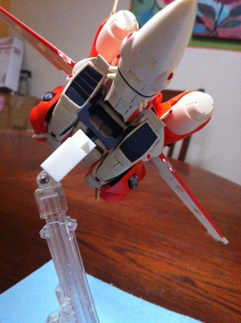

Froy Posted December 8, 2012 Posted December 8, 2012 Quick shots of the 17 This is the only point I found for the joint to hold it stable. (In my opinion is no no) Battroid is good.

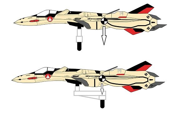

EXO Posted December 8, 2012 Author Posted December 8, 2012 So, I have an idea for a future version of these mounts. How about an adapter with a built-in offset? Basically, it'd be the same top and bottom, with some sort of extrusion between the stand mount and the valk mount, specifically to push the center of mass to a decent location. They'd probably cost at least twice as much, since you'd be adding a decent amount of material, but they'd be much sturdier in general, since the valk would be located farther forward. First of all, thanks Chrono for the review and images and to everyone else that has put up images and their opinions... It really helps decide on what type of valks to get these for. I'm not sure if an offset will work because the center of gravity will still be where the Yamato adapter will connect with the valk. For it to work, the adapter with an offset would have to make contact with the valk to carry that weight that is being offset. What would be needed is a new adapter that should be placed along the valks center of gravity. Like for the 1/48 VF-1. I would probably build a new adapter that could attach along the forearms in fighter mode. On the connections that the gunpod isn't using. It would need space for the gunpod also. I'm inclined to say that if the adapter was there we'd probable be able to display the 1/48 at a level position... nothing fancy like banks or dives.
Chronocidal Posted December 8, 2012 Posted December 8, 2012 (edited) Actually, no, the center of gravity is entirely unrelated to where the stand is mounted. That's actually the entire problem, because Yamato didn't even attempt to put the mounts near where the balance points of their valks are. It'd be nice if we could get the weight centered on the mount, but I don't know if it's actually necessary. The adapter isn't the point that needs the stress taken off it, it's the hinge. Here's a quick pic of what I'm thinking. This doesn't take the stress off the actual mounting point, which still could fail. All it does is shift the weight so that you don't have a ton of force acting way behind the stand hinge, making it droop. You might need to experiment on a good extension length so you could use this type of thing on multiple valks, but I think it'd be simpler than trying to make something like a cradle. The place where this gets complicated is that you'll definitely run into gunpods unless you keep the initial mount pretty tall. Developing new mounts entirely for everything might be a much better way to go though. I still wonder how hard it would be to find hidden places to drill holes for simple mounting points to use in fighter mode. Clipping around the arms would probably work on the VF-1, but you'll need something that attaches to the metal backplate for the VF-19, and I don't know what you'd attach to on the VF-17. Edited December 8, 2012 by Chronocidal

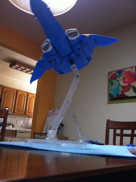

Froy Posted December 8, 2012 Posted December 8, 2012 More pics. sorry for the blurry pics. For my surprise VF-0 works really good. VF-11 is very decent. VF-1J GBP is nice too. And the VE-1, the stupid off of center Yamato stand adapter makes it lean to one side but the effect is not bad at all.
Chronocidal Posted December 8, 2012 Posted December 8, 2012 (edited) Yeah, actually mounting stuff off center or leaning like the VE-1 is what concerns me most about these stands. Unless you glue them together, they can flex around quite a bit, and they tend to twist under certain loadings. By the way, thanks for covering me on the picture side of things, Froy. Edited December 8, 2012 by Chronocidal

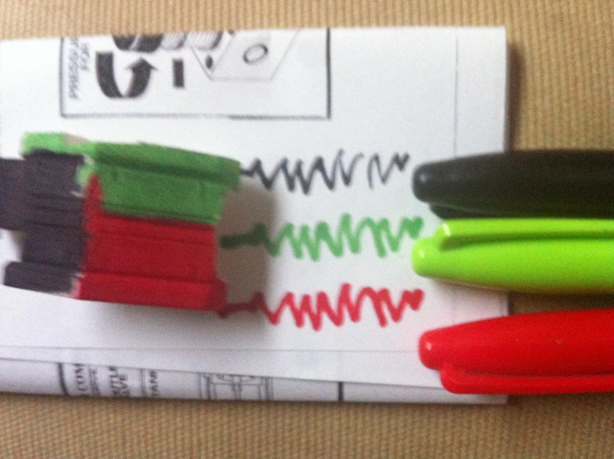

Chronocidal Posted December 9, 2012 Posted December 9, 2012 Tried out some coloring methods, and coloring these with a standard permanent marker works great. They seem to absorb the ink pretty well. Think this might have been mentioned before, possibly in the other thread.
EXO Posted December 9, 2012 Author Posted December 9, 2012 I was just sending this to my friend... he asked me how to color these things. As you can see the color matches the ink on the paper, not the caps. And try not to touch the color after you put it on the surface or it gets all over your fingers, then on everything you touch. Maybe do one side at a time. But the color lays on evenly. Better than dyeing because you can put different colors on the same piece for other stuff you bought on from Shapeways. I got to get me a set of Sharpies.
