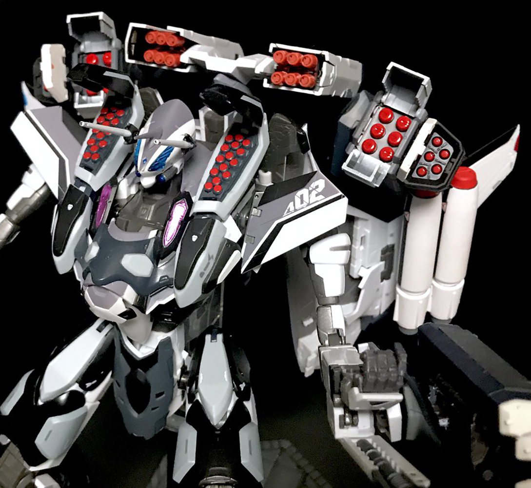

Sanity is Optional Posted December 15, 2017 Author Posted December 15, 2017 I'll be honest, I'm not a big fan of any of the mods I've seen that have the missiles pointing out from the break in the weapon pod.
Sildani Posted December 15, 2017 Posted December 15, 2017 Me either now I’ve seen them. What are those other launchers supposed to be? Coming from the wing boosters?
NZEOD Posted December 16, 2017 Posted December 16, 2017 I have those, they are an MS Upgrade part for Gundams
slide Posted December 16, 2017 Posted December 16, 2017 Just now, NZEOD said: I have those, they are an MS Upgrade part for Gundams like these: https://www.usagundamstore.com/collections/hiqparts-minus-molds https://hlj.com/search/go?lbc=hobbylink&method=and&p=Q&ts=custom&uid=364159030&af=selectmanufacturer%3ahiqparts for example.
kajnrig Posted December 16, 2017 Posted December 16, 2017 For what it's worth, one of the missile launchers is specifically this Kotobukiya MSG part: https://hlj.com/product/KBYMW-36 And I'd imagine the missiles in the backpack pod are repurposed fin funnels, either from a HG/MG Sazabi or from Bandai's Builders Parts add-ons: https://hlj.com/product/BAN991400 Personally, I don't dig the look, either. Definitely prefer the one Sanity is working on. Keep up the good work.

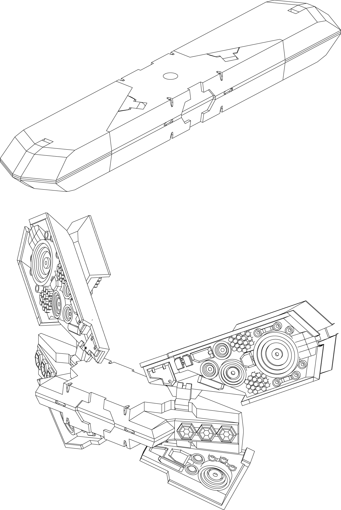

Xigfrid Posted December 27, 2017 Posted December 27, 2017 On 20/12/2017 at 7:38 PM, Sanity is Optional said: Good luck, all those details are beyond what I can model up in CAD. Working on it: so far so good: the model is almost printable. I am planning to make the external body in WSF and all the internal panels with speakers and intricate detailing in FUD. Still a few details to check though
kajnrig Posted December 27, 2017 Posted December 27, 2017 Getting flashbacks to the Heavyarms Custom's impossible missiles...
Sanity is Optional Posted December 27, 2017 Author Posted December 27, 2017 3 hours ago, Xigfrid said: Working on it: so far so good: the model is almost printable. I am planning to make the external body in WSF and all the internal panels with speakers and intricate detailing in FUD. Still a few details to check though Looking good, those details definitely call for FUD/FED printing. After getting a test-part, I would not suggest acrylate.
