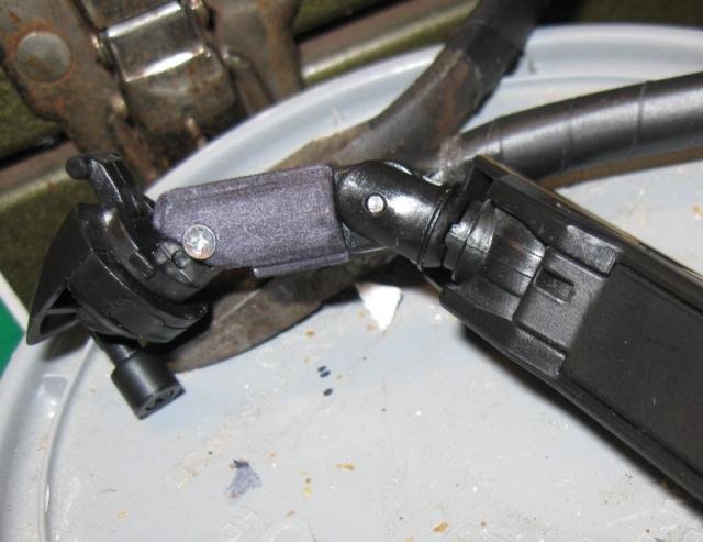

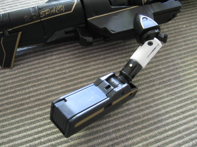

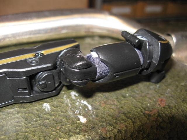

VF5SS Posted April 15, 2013 Posted April 15, 2013 It needs some tweaking but it works pretty well. The only problem is the bicep sleeve doesn't fit yet. It's really tight and I'm not sure how much I can tweak the thickness of the bicep itself.
VF5SS Posted April 15, 2013 Posted April 15, 2013 Alright it turns out I just needed to sand down the rail the bicep cover slides up and down on so now it works perfectly. I will try to tweak the rail a little bit but it will probably still need some light sanding to fit right. It's better to start out with more material to work with in order to compensate for Shapeways printing tolerances anyways. I should be able to get this part up for sale either today or tomorrow.

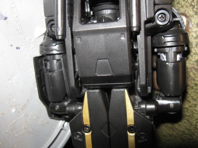

VF5SS Posted April 16, 2013 Posted April 16, 2013 Either white or black works well. Just be sure to do all your sanding before painting. I just used a sharpie marker just to demonstrate. The new part works perfectly when the arms are folded up too!

VF5SS Posted May 1, 2013 Posted May 1, 2013 I dunno if anyone got their replacement parts yet but I got my copy of the revised piece and it works pretty well. I think I should probably fill in that gap that somehow Shapeways added to the part on the front. However, the screw now threads through the hole beautifully after a little bit of sanding for parts fit.
