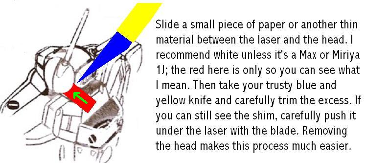

El Malufa Posted September 29, 2004 Posted September 29, 2004 Hi! I am brand new to the forums and I have a question concerning Yamato's excellent 1/48 Valkyrie line. I have a 1/48 VF-1J and have found that lately, the right head laser is so loose that it flops regardless of the position I place it in. I would very much like to get this issue corrected and was wondering if you guys wouldn't mind giving me a hand! -Thanks! El Malufa
Die, Alien Scum! Posted September 29, 2004 Posted September 29, 2004 Hi! I am brand new to the forums and I have a question concerning Yamato's excellent 1/48 Valkyrie line. I have a 1/48 VF-1J and have found that lately, the right head laser is so loose that it flops regardless of the position I place it in. I would very much like to get this issue corrected and was wondering if you guys wouldn't mind giving me a hand! -Thanks! El Malufa Here's my experience with loose lasers. Try turning the loose piece clockwise until it gets tighter. Both 1J lasers were loose on one of mine and this worked for me. However, this will only work if there's enough tension on the back side of the screw within the head. If the screw is too loose and simply continues to spin, you can either disassemble the head and tighten it the old fashioned way, or you can try to shim it until you get the desired tension. I shimmed a loose 1S laser with a small piece of paper and carefully trimmed the excess with an Exacto knife. Hope this helps.
El Malufa Posted October 1, 2004 Posted October 1, 2004 Hey Alien, I appreciate the advice, but could you please tell me what shimming is and how to do it?
Die, Alien Scum! Posted October 1, 2004 Posted October 1, 2004 Hey Alien, I appreciate the advice, but could you please tell me what shimming is and how to do it? Shims are thin pieces of material used to fill the gaps between two parts. In this case, it will add tension between the laser and the head. You may need to try a few different widths of material until you get the desired effect. See below and don't cut your fingers.

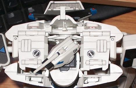

Dat Pinche Haro! Posted January 8, 2005 Posted January 8, 2005 the part on the back (in battroid) on my VF-1 1/48 is kinda floppy...it doesn't really stay well there...and it tends to make the backpack fall down too...is there any way to tighten that area? btw...the floppy part is BP9
Die, Alien Scum! Posted January 9, 2005 Posted January 9, 2005 Try pushing the BP9 past the tabs like shown below. They lock it into place so the backpack won't flop around. This is a necessity if you want to use the "neck brace" for added strength when adding the Super/Strike boosters. If the tabs won't hold, I'm not sure what you should do.
Dat Pinche Haro! Posted January 9, 2005 Posted January 9, 2005 are you suppose to do that?! looks like it might wear on the toy itself
Die, Alien Scum! Posted January 9, 2005 Posted January 9, 2005 Yes, it's made to be done that way. Just don't use excessive pressure and you'll be fine. You may need to twist the BP9 a little bit to get it underneath the tabs, but it'll go. You can see in my pic that mine is a little crooked.
zeo-mare Posted January 9, 2005 Posted January 9, 2005 yep that is the only way to keep it up, when i first got the strike parts for mine i did not realize it until i read a thread like this that stated how to do it. i had mine on the shelf for about a week with the strike parts somewhat hanging of , i could not figure out why it was like that.
