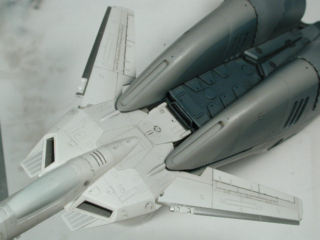

wm cheng Posted October 25, 2005 Author Posted October 25, 2005 Spatula, don't be discouraged, the wing tabs and sprockets become misaligned all the time, exactly what Grayson said and you have them back in order! When you attach the wings, it will never do that again. Try to leave them operable - you'll be happy you did in the end. Which lights dropped? The wing tip or the two wing root lights? You can always file a new light from the clear plastic sprue that the lights were attached too. If you're sanding is good, you can glob on some gel-type crazy glue where the light is supposed to be and file back down to get the proper profile (careful that the crazy glue is harder than the styrene). I usually use white glue to glue the clear pieces on. Ok, I just sanded any little imperfections left and re-coated the Valkyrie with its final coat of white. Then I sealed it in with the ModelMaster Acryl semi-gloss clear coat. No pictures of that - just a boring white Valkyrie for now. Probably will start some patches of grey on certain panels with some post shading tomorrow. I concentrated mostly on the booster for tonight. After I got the base coat of colours down, I started to weather it, with a reverse post-shading technique, mainly where ever I would normally shade dark, I used a lighter Sky Grey to pick out the leading edges of certain panel lines. I also sprayed a very light gradated overall coat of Sky Grey from the front to the rear - blending in the various shades of grey (the idea is that the front gets worn a bit and is lighter) also to lessen the contrast between the booster and the Valkyrie. I want to add interest to the greys so that there are no solid patches of colour - always some type of variation. I got out my old VF-1A super as a guide to the weathering and colour range for the booster. Lastly I sealed this very delicate light misting of Sky Grey in with ModelMaster Acryl semi-gloss clear coat again. I plan on a dark oil wash tomorrow to pick out some of the details.
Gabe Q Posted October 25, 2005 Posted October 25, 2005 That thing looks absolutely beautiful. The paint is so perfect. I just want 10% of your skill with an airbrush. That would be enough...
jardann Posted October 25, 2005 Posted October 25, 2005 That post-shading technique really brings the booster to life! Great work as always Wm!
Ido Posted October 25, 2005 Posted October 25, 2005 (edited) Personally I don't like very much that colour scheme but technically its wonderful. Yes, lacquer paints sand better cause its a tough film, the acrylic layer its samewhat soft, one of the many reasons I like better modeling lacquer over modeling acrylics. I don't suggest to clean your airbrush sprayng alchool cause its not the paint thinner, it doesn't thin the paint but make it soft and weak, its works great for cleaning stains on your stuff but I fear it can glog the airbrush. ps Thanks for the decal tip, it worked like a charm. Edited October 25, 2005 by Ido

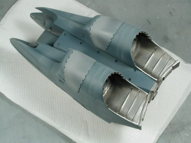

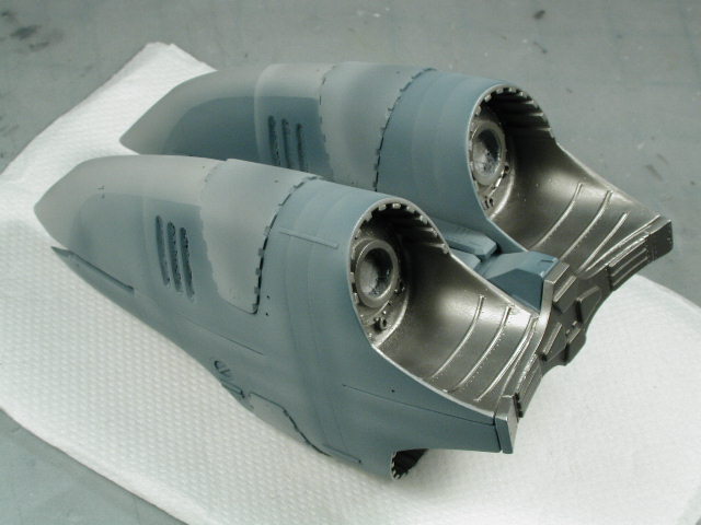

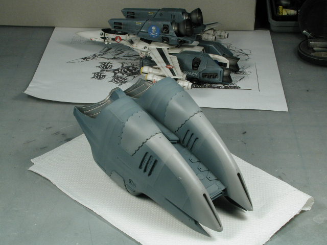

wm cheng Posted October 26, 2005 Author Posted October 26, 2005 Thanks for the kudos! although, Ido, I'm beginning to know what you mean about the blue/grey colour scheme (i'm not that confident about it - partly because its departing from canon - and seeing Bertt's sure looked nice ) But I'll reserve judgement until I get a little further along and get them both together (its all an experiment ). I'll just hold off the decalling of the booster till I'm sure. Glad the decal worked for ya though. OK, I'm on to masking for the metalizer steel portions that couldn't be painted separately. It was great that the Captn' provided the resin cast of the modified intakes - however, since it was molded in once piece (which saves construction and sanding) the intake covers couldn't be painted separately. Additionally, I didn't use the Photoetched parts for this kit (which would of made painting them separately a breeze). So I have to mask out all the white around it leaving only the leafs of the intake cover exposed to the metalizer. Now with hindsight, it would of been easier to paint the portion metallic steel or grey, then mask it off and paint everything else white - but hindsight is 20:20! oh well... I've gone a little overboard here wrapping up my Valkyrie like a mummy, but I hate overspray especially on white! Again the yellow is the good stuff - the Tamiya masking tape, and the rest is the cheapo regular masking tape after I stuck it to my jeans first to get some of the stickiness off.

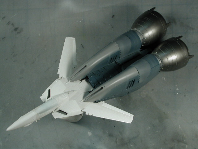

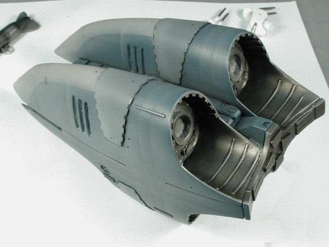

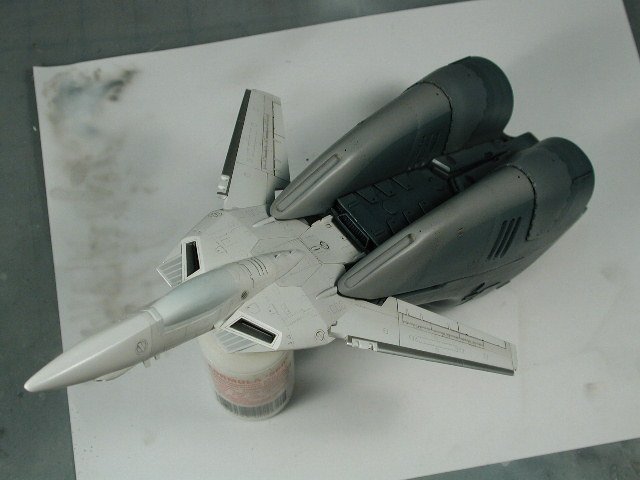

wm cheng Posted October 26, 2005 Author Posted October 26, 2005 Here's a shot of it done - with the masking removed. Its really not that dark - but because its highly reflective, it seem darker than it is.

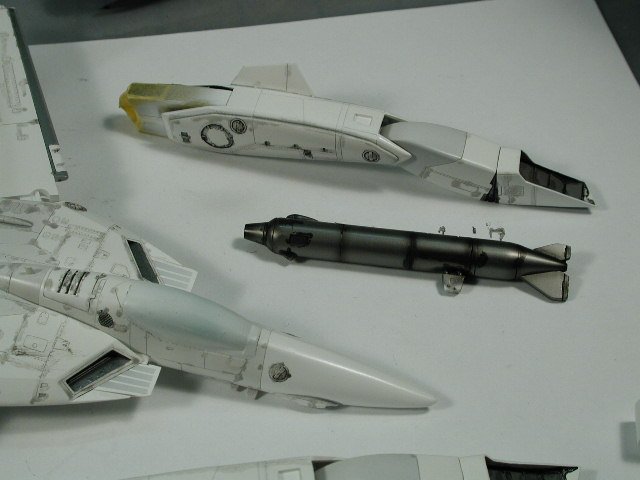

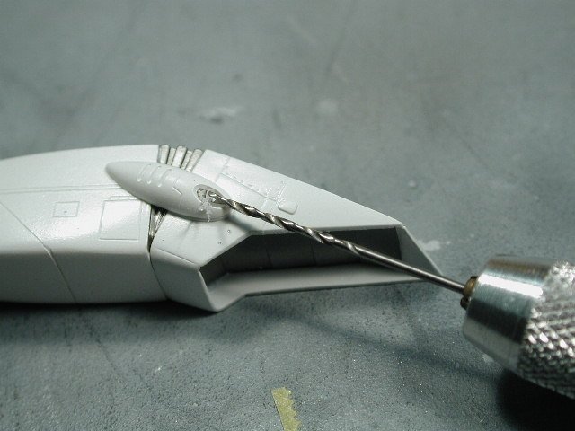

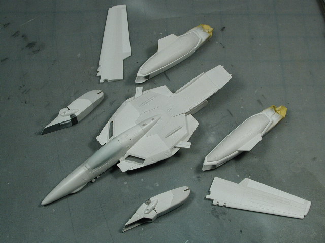

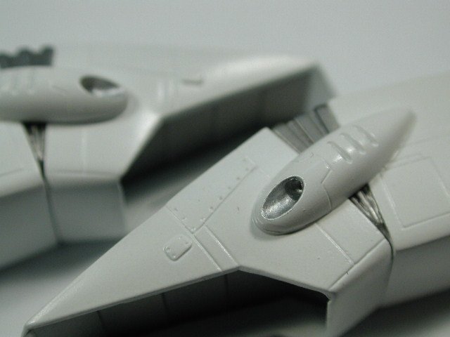

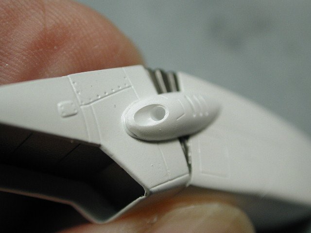

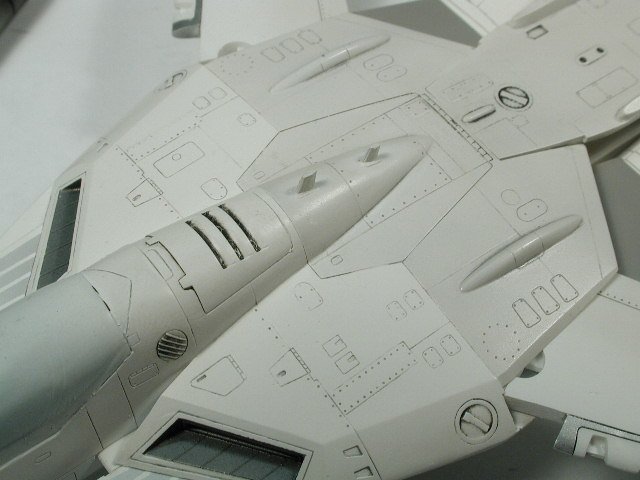

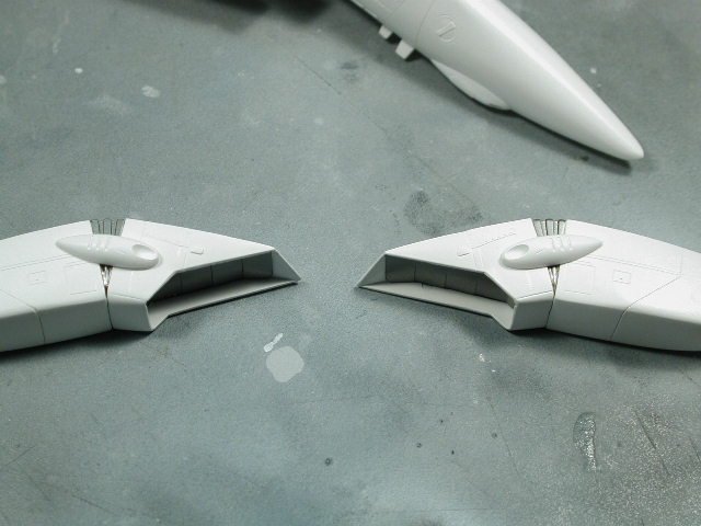

wm cheng Posted October 26, 2005 Author Posted October 26, 2005 I can finally add those little bumps on the side of the intakes - I keep worrying that I'd loose them. I crazied glued them in - since its styrene being attached to resin (actually with a layer of paint on top - but I didn't think it matter too much since these bumps don't take much stress) Now, I thought while I still had the intakes as separate pieces, I'd drill out the bumps. It looks better as an intake or vernier thruster, so the hole adds some detailing especially when we come to the dark wash. Again, I start with a smaller pin-vise bit to locate the hole then work up to the bit of the intend hole size. Here's a shot of the competed hole, you don't have to drill too deep.

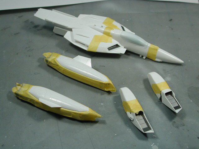

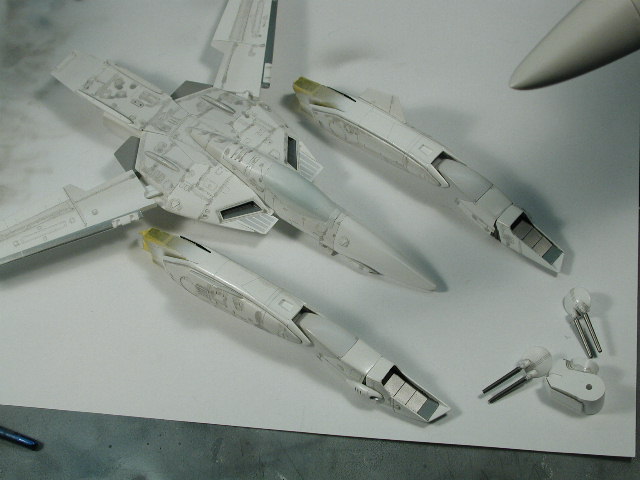

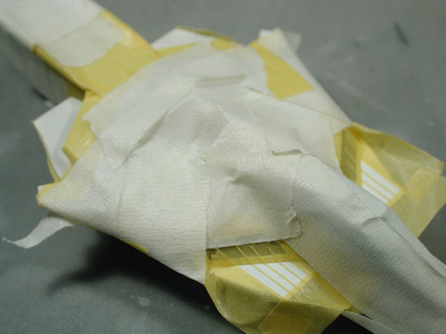

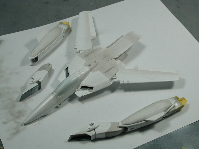

wm cheng Posted October 26, 2005 Author Posted October 26, 2005 Now I am masking the white portions off to do a dual tone light grey on the Valkyrie. I want to darken up the Valkyrie so it doesn't appear to stark white against the Boosters, but I don't want a grey plane, I still want it to appear essentially white. You can have quite a bit of latitude since eventually, the black lines of the decals are so stark - it hides a lot of tones of grey. I essentially want to subtly shade the Valkyrie from light to dark towards the tail at areas that are in direct contact with the Boosters (if I'm successful in the end - one shouldn't notice the shading too much - the Valk and Booster should look like they belong ) My first past was really too strong - I went over some areas too many times. The contrast was just too much here; I should take my own advice; build up in layers! Well, not to worry, I just went over the entire thing with white again - this lightens the grey and evens the shading a bit more to my satisfaction. That abrupt change from white to grey at the chestplate area will be just fine when I apply the yellow & black stripes - you'd hardly notice the difference - that area won't be stark white hitting the front of the Boosters. Wow! its late - I've just put on another coat of semi-gloss clearcoat to seal in the shading and provide a protective layer for my post shading tomorrow (in case I don't like the post shading, I can strip it back (undo) to this point). And I'll let it dry overnight without my meddlesome impatient fingers getting all over it!

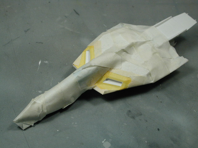

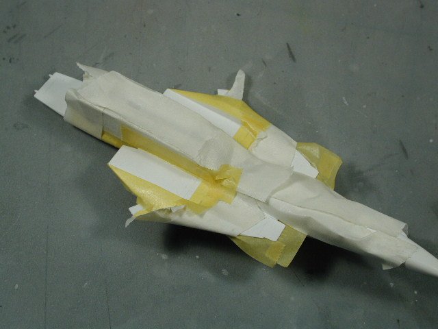

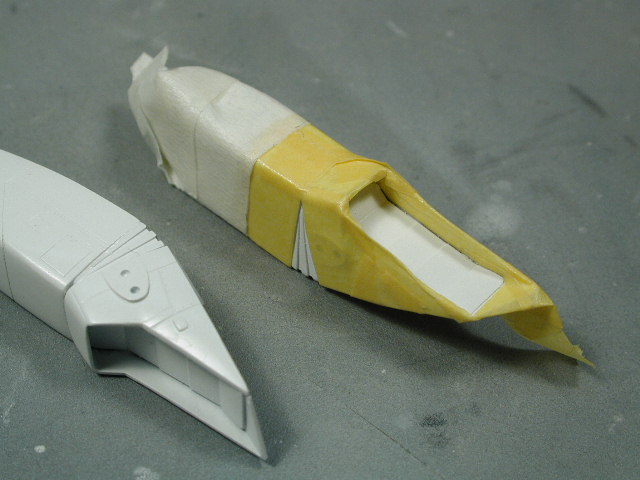

Ido Posted October 26, 2005 Posted October 26, 2005 I've gone a little overboard here dry.gif wrapping up my Valkyrie like a mummy, but I hate overspray especially on white! Again the yellow is the good stuff - the Tamiya masking tape, and the rest is the cheapo regular masking tape after I stuck it to my jeans first to get some of the stickiness off. Don't even mention to go overboard in masking, overspray is a bitch I perfectly understand why you did that, "better sure then sorry" we say in Italy The gray/white vf-0s looks good so I suppose the vf-1 will look good in the end too, personally I will do the postshading freehand for a more subtle effect.

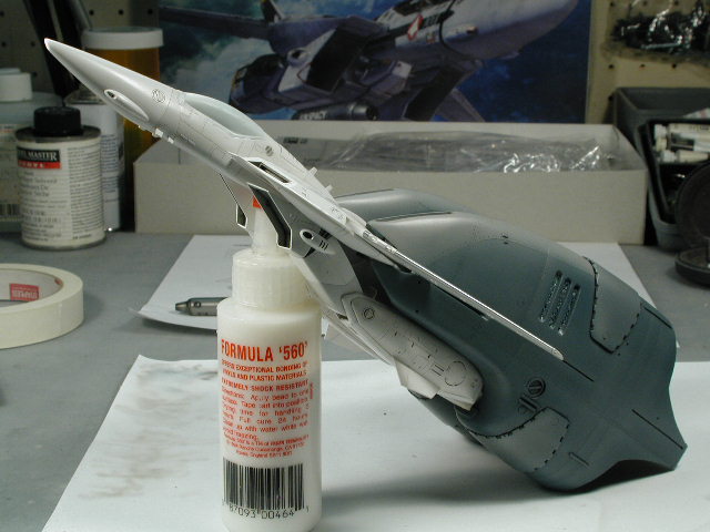

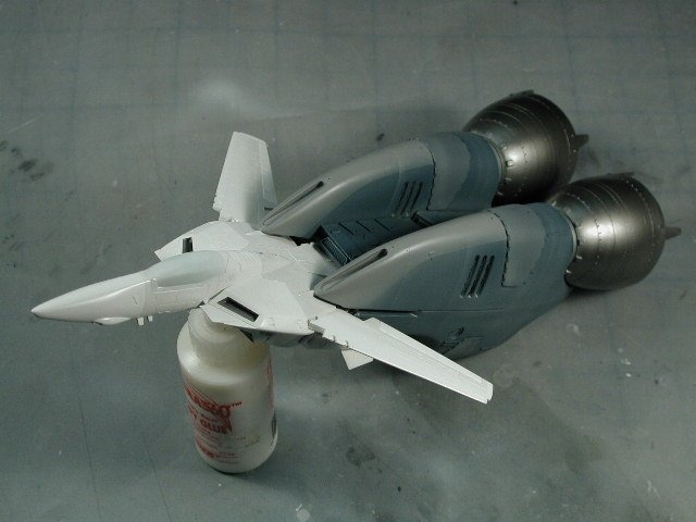

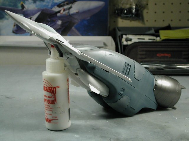

wm cheng Posted October 27, 2005 Author Posted October 27, 2005 Just piecing everying together for a looksee...

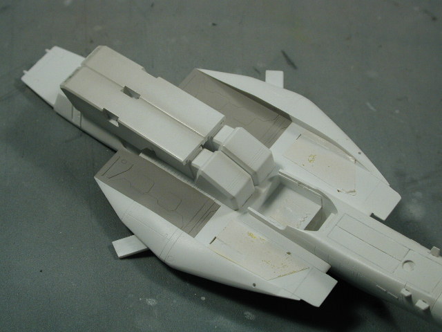

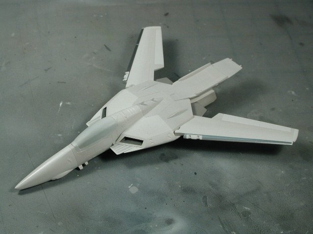

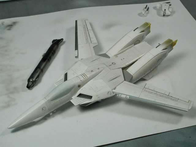

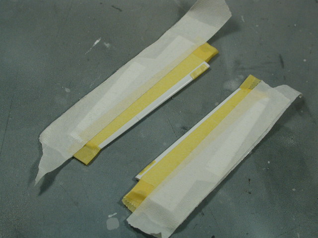

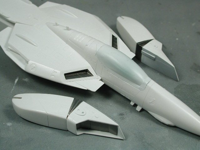

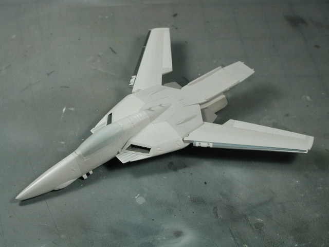

wm cheng Posted October 27, 2005 Author Posted October 27, 2005 Just looking over that amazing Tenjin Valkyrie book for more ideas to darken the Valkyrie up (more patches of grey) So more masking again, for areas that will get a coat of sky grey such as the area behind the swing wings, underneath the fuselage where the legs swing down, since they are exposed now (without the leg fast packs) and I found some neat light grey markings that Tenjin puts on in front of the forward intakes.

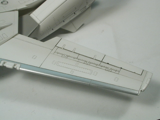

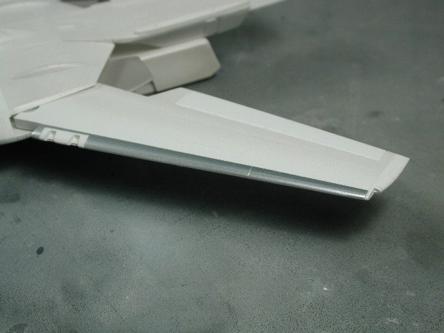

wm cheng Posted October 27, 2005 Author Posted October 27, 2005 A shot of the grey patches with the masking removed... Ah, since I'm slightly departing from the canon - I thought I'd make the leading edge of the main wings silver (like the F-14s) - plus I've seen some paintings of the Valkyries with this leading edge slats in silver. Man! I love this Alclad Metalizer stuff! - I sprayed it with Polished Aluminum. I masked around the lights - I wasn't sure what to do here, but I thought it adds a bit of interest. Lastly, I thought I'd paint the interior of the side bulges on the intakes silver, they seem to always be silver on the Hasegawa box art. And of course, I coated the entire Valkyrie in another coat of semmi-gloss clear-coat to protect everything. I'm ready for my panel wash now...

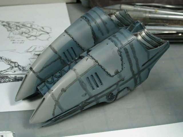

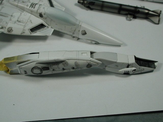

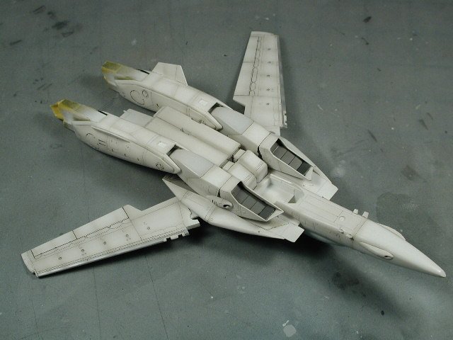

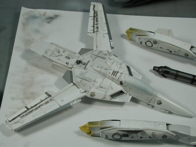

wm cheng Posted October 27, 2005 Author Posted October 27, 2005 On to one of my favourite parts! The panel oil wash. As most of you already knows, this is a solution of thinned down artist oil paints with low odour varsol applied with a thin brush to all the cracks, crevices, revits and panel lines of the model. I only use 3 colours, white, black and brown - I can mix all the shades I need with these. This thin solution seeps into all the engraved details - and after a little while, I wipe the excess off with a paper towel. I always start off light, mixing a mixture of white and black to get a very light grey - this will highlight all the rivits and non-moveable panel lines thoughout. I thought I might as well panel wash another Yamato 1/48 Valkyrie I recieved reciently. (Some of you may know that it was my best friend's collection of Macross stuff all the way from when we were in high-school together - we had such a competition collecting this stuff... now I have doubles of everything... since he died - I hope he approves ) As you can see - it gets pretty messy - there are dab marks all over the place, but don't worry, it all wipes away easily (especially since I sealed all the previous work behind a layer of semi-gloss clear-coat) Now I start adding other layers of oil wash - mixing each layer darker. The dark washes are in areas I think are moveable such as access hatches, or flaps and control surfaces. Lastly, I mix up a batch of pure black for the vents. I also mix up a batch of brown for areas I think hydraulic fluid may leak from.
Spatula Posted October 27, 2005 Posted October 27, 2005 Thanks! Yeah these decals aren't as bad as I thought, and I find them more forgiving then Revell's decals when I put on the USS Enterprise. Those were a pain since you had these long strips that had to be perfectly aligned. I got most of my experience from that so these Valkyrie ones are easier. However I find that since you have so much texture under the decal on the Valkyrie that it masks all your hard work. I also go back over the decals with a very light controlled oil wash to pick out the rivits and panel lines. On the black portions, I go over them in a white/grey wash - so it shows up. Which tone (black or white or grey etc) do you use for this wash?? I might still be in luck to get a nice finish. I'm thinking light grey to oil white (flat) with my testors oils. I only have a dark grey Humbrol for oil, the rest are tamiya acrylics. Also, isn't it quite late where you live now in Toronto? Like 1:30 ish? 11:30 here.

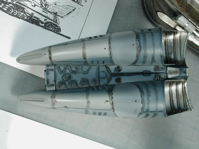

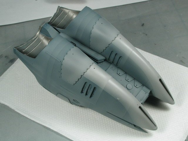

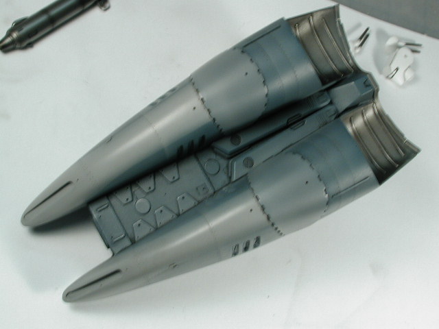

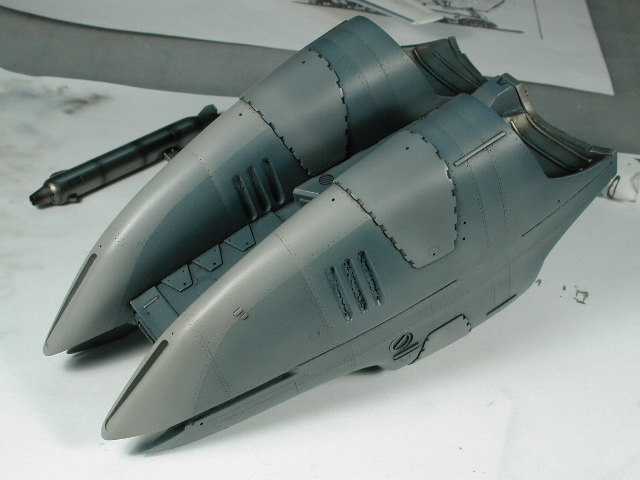

wm cheng Posted October 27, 2005 Author Posted October 27, 2005 I also apply the wash to the Boosters - but I start at a much darker shade so it shows up against the darker basecoat. Now all the nice revits the Captn' put in will be shown.
wm cheng Posted October 27, 2005 Author Posted October 27, 2005 Hey Spatula, yep its late here - but I'm not working at the moment (in between assignments ) I usually only model when I can get a real chunk of time - once I start I get quite obsessive about it. Don't use model paint - I use artist oil paints. They can be bought from an art store in a tube. The main thing with the wash is that it must be of a solution that is different from your basecoat of paint on the model - so that the thinners and solvents from the wash does not eat or interact with the paints you applied to your model. I use an alternating sandwich of paints as I layer up my model so that each layer does not interact with the previous layer underneath it. I start with a laquer primer on the styrene, then a Tamiya Acrylic paint surface, sealed with a ModelMaster Acryl (actually a laquer) clear-coat, then the oil paint wash - to be sealed with another layer of clear-coat. Be very careful that whatever your wash is will not take off the paint underneath. That will be disaster if the wash interacts with the paint below. That's why you can wipe the excess away afterwards without affecting your paint. I use a dark grey to pick out the panel lines on top of a light coloured decal and a very light grey/white on top of a dark decal.

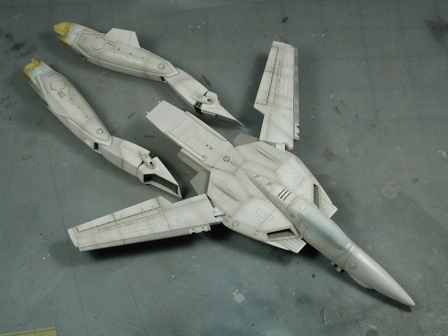

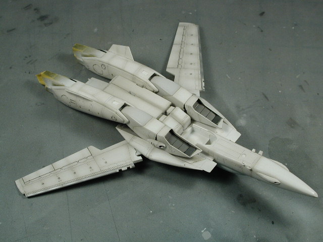

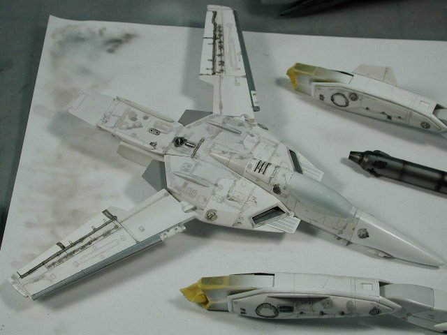

wm cheng Posted October 27, 2005 Author Posted October 27, 2005 I waited half and hour or an hour - just so there's no shine/wetness to the applied oil wash. Here's a shot of them Valk after I wiped it down. Don't worry if you wait too long - you can also damp the paper towel with a little low odour varsol and it will take off any excess that may have dried. However if you don't wait enough, then when you wipe, you will remove all of the wash including the stuff in the panels. These shots show the different washes - I find that by varying the greys it gives a bit more life to the panels - instead of just a monotone wash over all the panels. YOu can see the flaps and spoilers get the darkest treatment - because they move. Where as some of the detail on top of the plane never gets opened - they are there just for the intial construction of the plane - so they are much fainter.
wm cheng Posted October 27, 2005 Author Posted October 27, 2005 The booster came out great - the dark wash added a much needed depth. (its too bad the photos don't seem to do this justice )

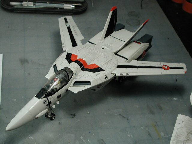

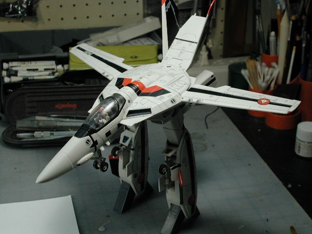

wm cheng Posted October 27, 2005 Author Posted October 27, 2005 The Yamato 1/48 VF-1A toy turned out pretty well too!
wm cheng Posted October 27, 2005 Author Posted October 27, 2005 Time to go to sleep... Some parting shots as I leave it to dry without my impatient hands putting fingerprints all over it! The next step would be to do a light post shading over the panel lines and seal it in with a semi-gloss clear-coat. Ready for the weathering and decals!
nightmareB4macross Posted October 27, 2005 Posted October 27, 2005 Your thread is very addictive...I can't wait to see what coming up next. Excellent work as always!!!. Are you planning to lightly spray the wings leading edges in white. I think the extra clean aluminum contrast is too much when overviewing the valk with the boosters on.
Ido Posted October 27, 2005 Posted October 27, 2005 From the dirt look of the thing looks like you don't use capillary action but just paint over the panels, isn't it a bitch to wipe up the excess after? About the vf-1 decals, they are thick but they got no problem in conform to the panel lines with some solution, but they really have tough times in conforming to irregular surfaces like the airbrake piece, the best thing its to do some pre-cutting on the paper before appling or cut them in more pieces. I also saw that some decals are too long, how is the canopy frame decals fitting?
